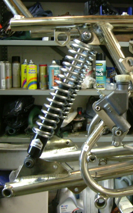

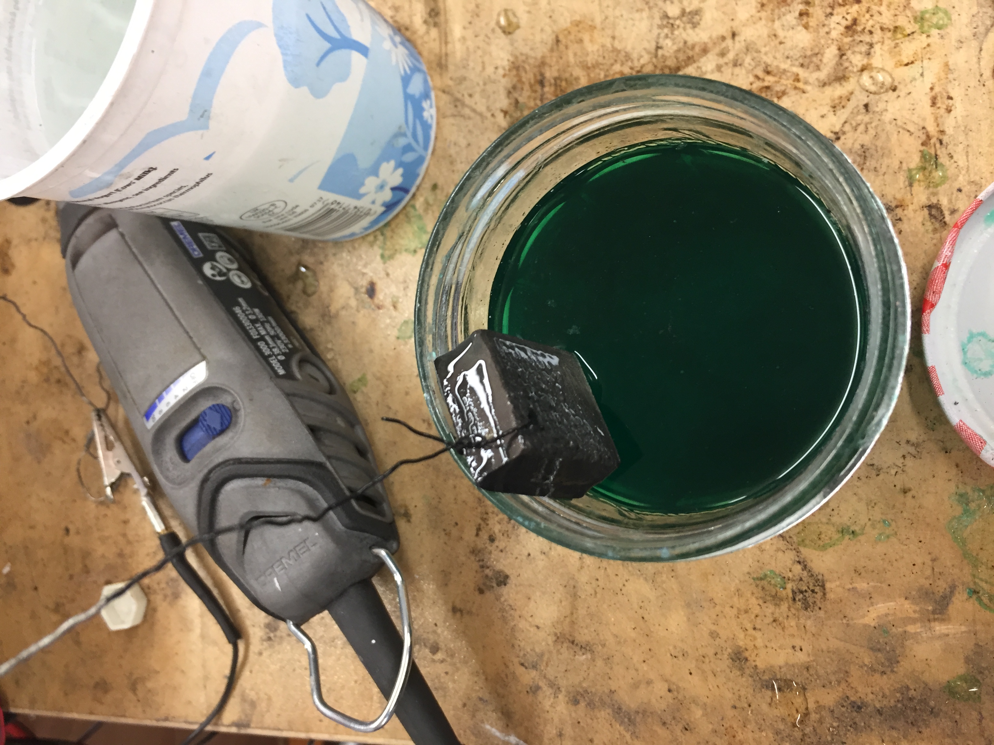

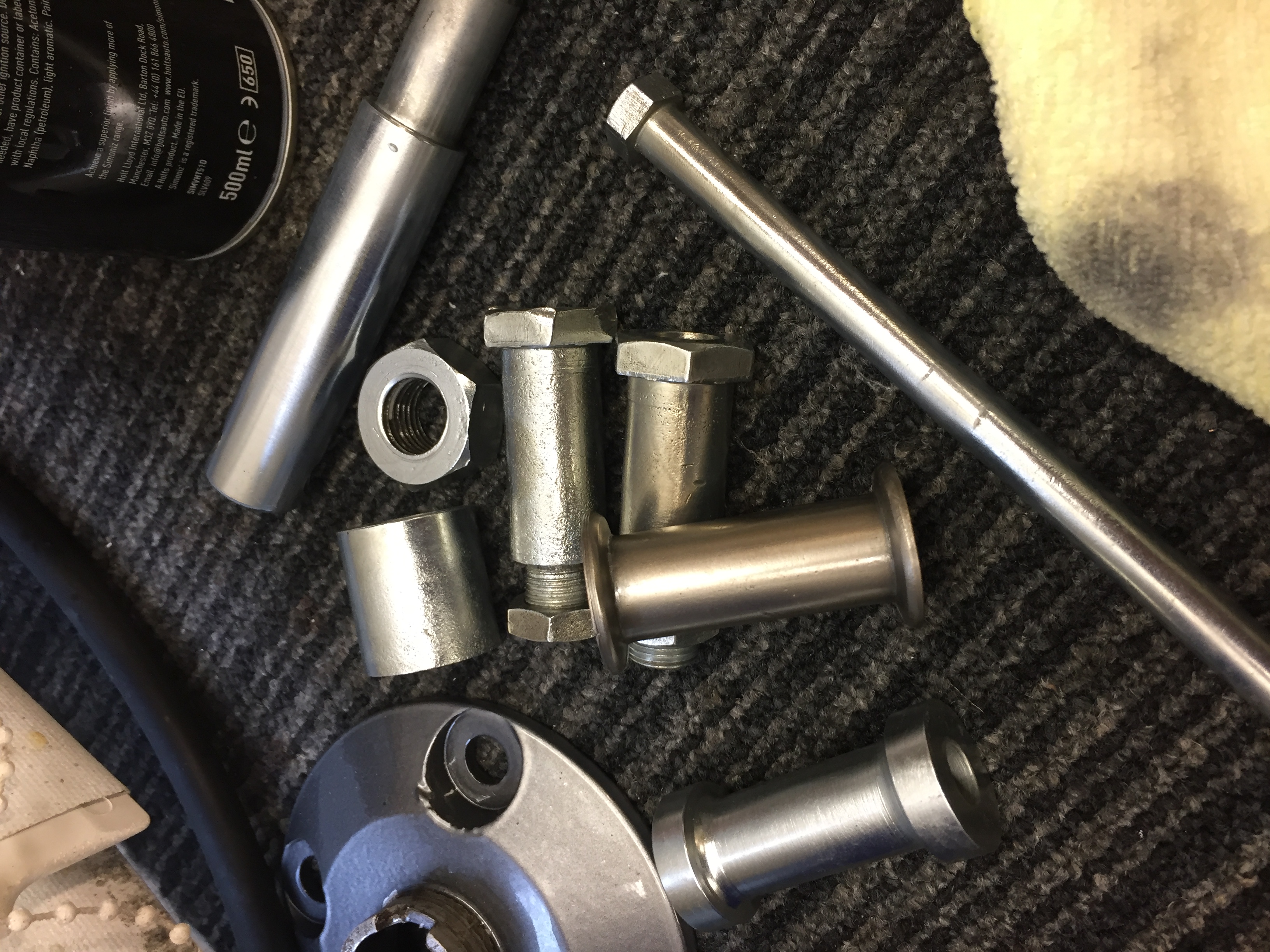

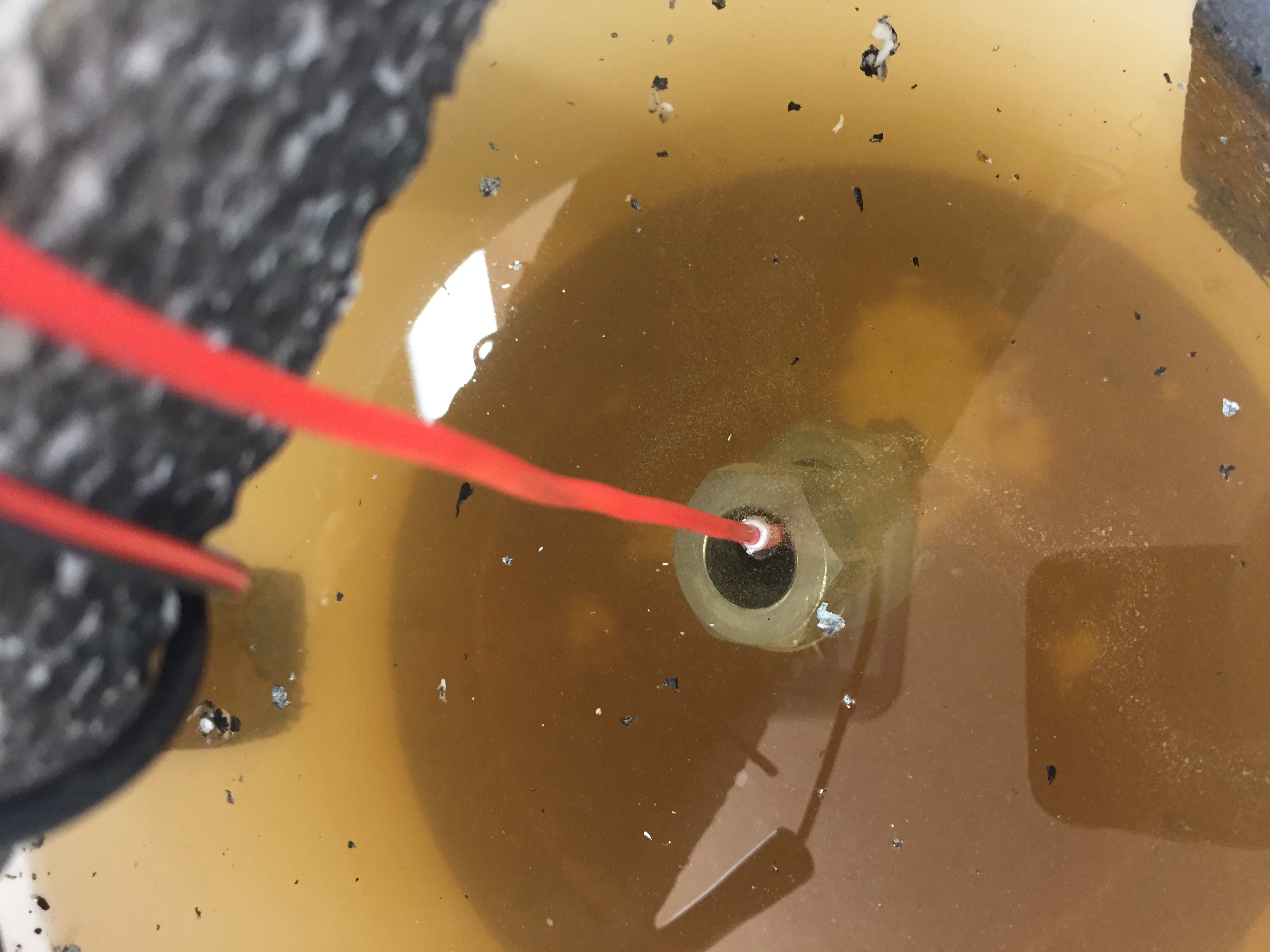

RAYZ1 wrote:The original Girling shocks refinished , dampers still fine , springs powder coated , were painted black originally, nickel plated the collets in a jam jar with 5v
Ray

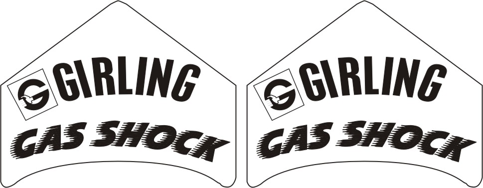

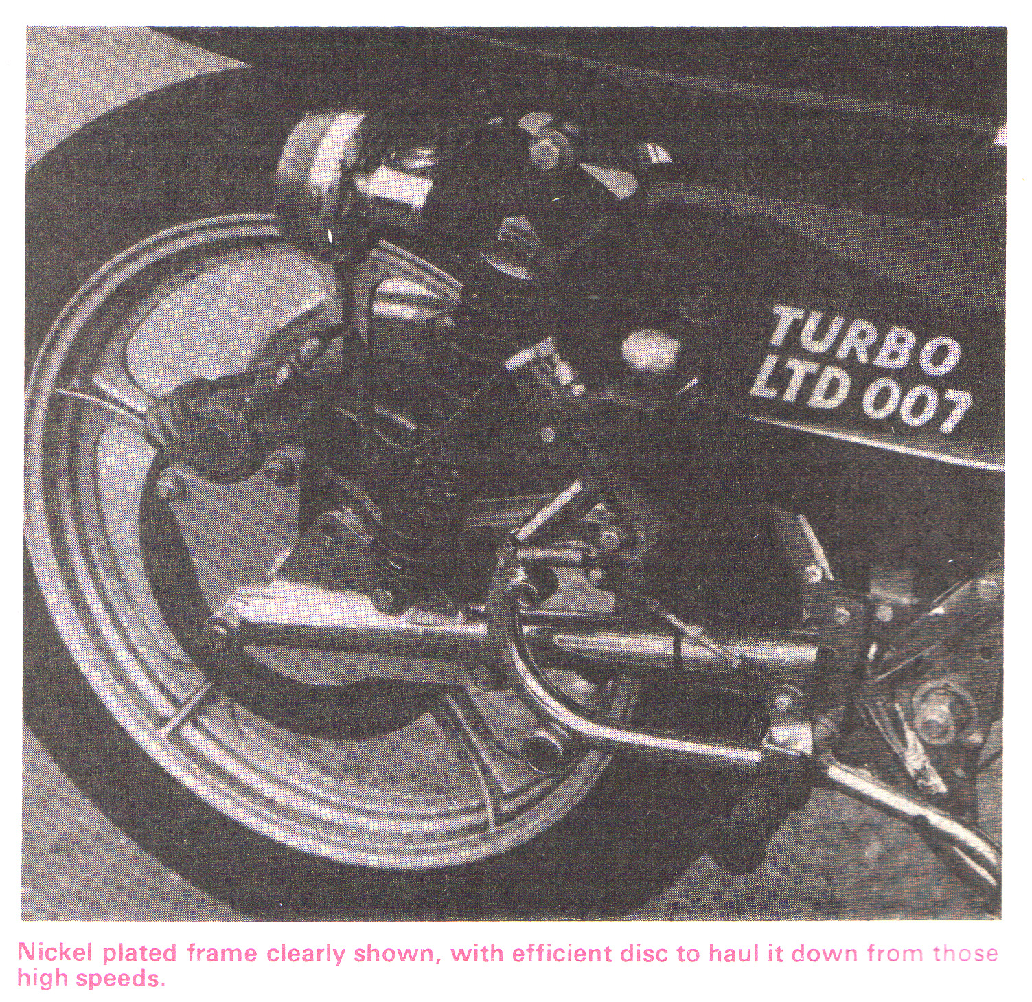

Very nice job on the Girling shocks... I can supply the correct decals if you want, just let me know.
I also noticed that the way thay are fitted to Alan Stoole's LTD 007 is correct for all production Silver Saxons (according to my other pics on file). I've check and all the others are USD with the decal fitted the right way up. I personally just fitted them the way I liked them (conventional) then fitted the decals.
.... Just had a scan on the web and found these so it's not worth me making any at this price, way cheaper to buy here. https://www.fastguystuff.com/product-p/fg-369.htm
GGS decal.jpg (69.91 KiB) Viewed 11758 times
Girling shocks.jpg (152.25 KiB) Viewed 11758 times

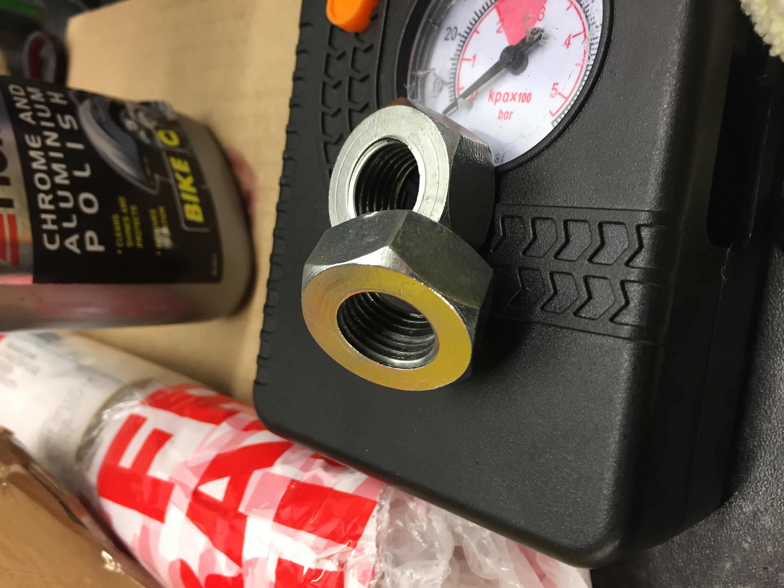

I will digest that in more detail once I have the engine in place , thank you for that level of detail as it’s very helpful, currently (no pun) going some spindles and nuts in the zinc and nickel jam jar , I would normally send stuff away but for this amount I don’t mind having a go , all the general nuts and bolts will be new s/s

Yes the shocks are to be fitted what looks upside down , that’s also how they were on #oo8. Didn’t see those stickers anywhere so bought 4 of the small Girling stickers, I will maybe get a couple of sets from the guy on the link - is that your Saxon (my) with Girlings in the photo? - the bike in the MCN page also has the the reservoir at the top
I dont know if this is true but I have seen bits on the net that gas shocks must be fitted in the right way up otherwise they wont work correctly- sort of see the logic as the gas would be at the top of any oil (assuming oil is present!) and the valves and plates internally would be either in gas or oil - so they have an optimum/correct design install . I dont understand the principle of the pressurised gas but it must account for the change in viscosity? remember the FVQ shocks by H , - fade very quickly .. someone can educate me pls - My 80s kawas all have pressurised forks and rear shocks with air - without the air they are saggy and soft - so does the gas take the place of a spring and its still the oil damping
