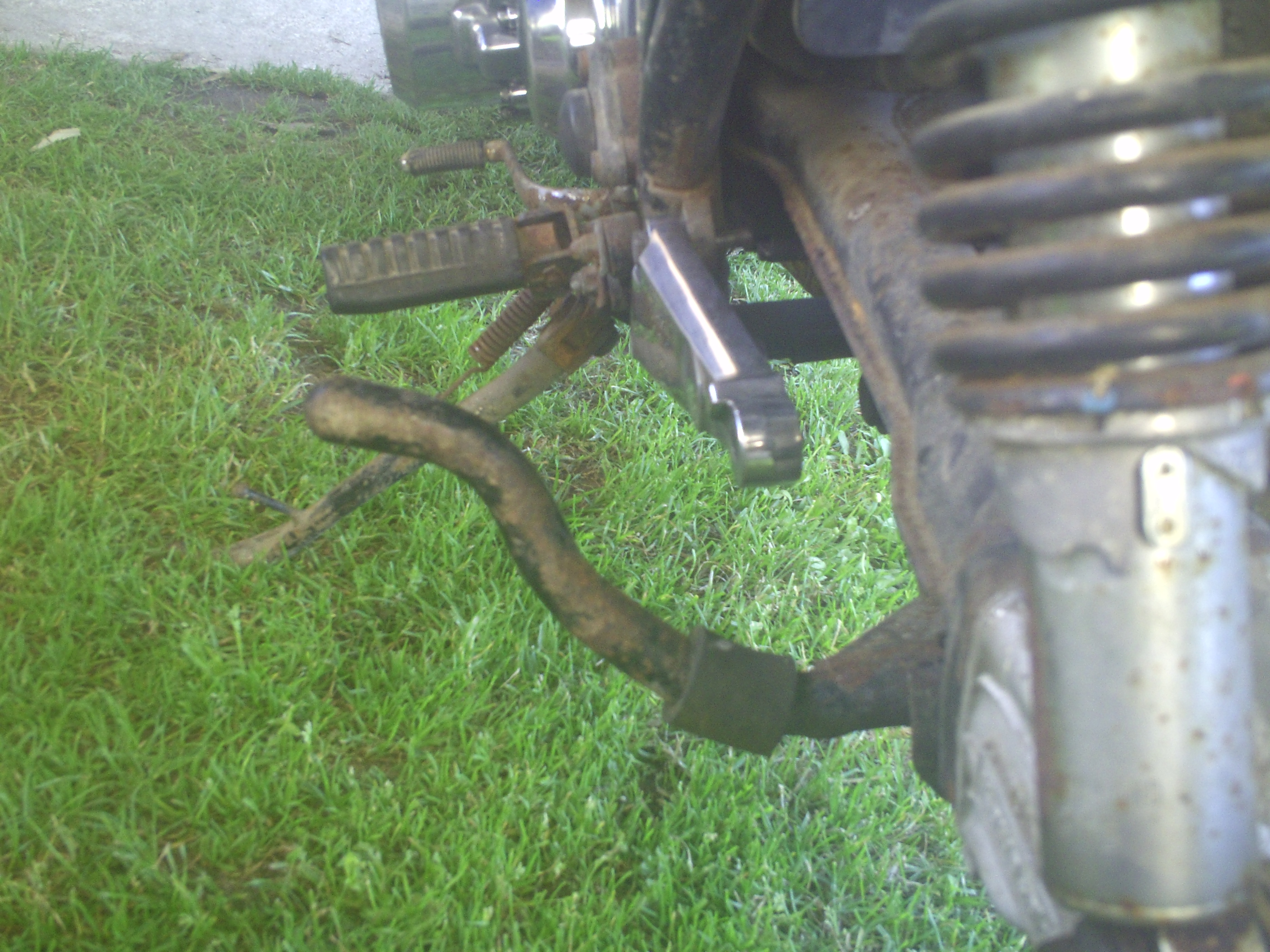

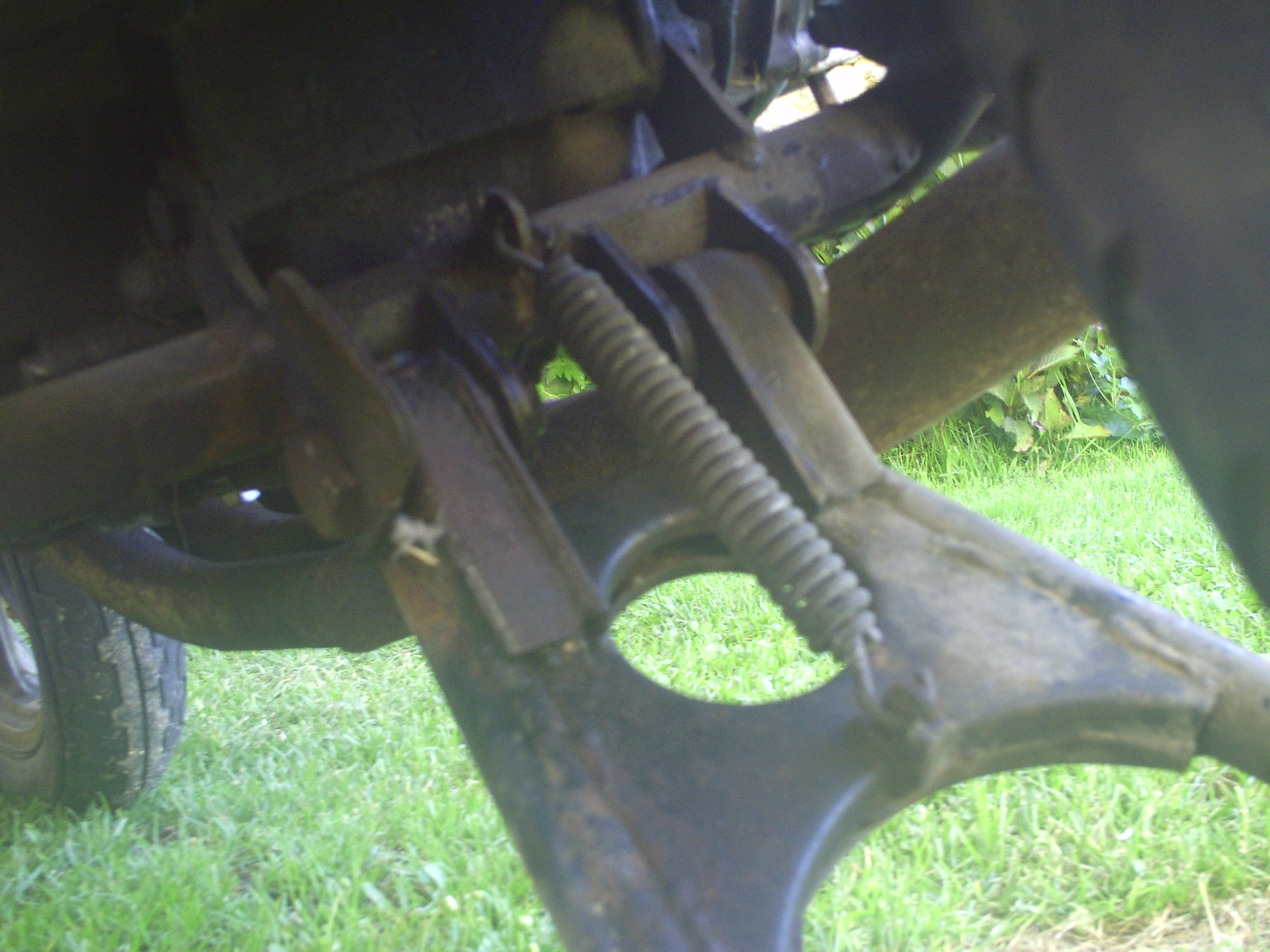

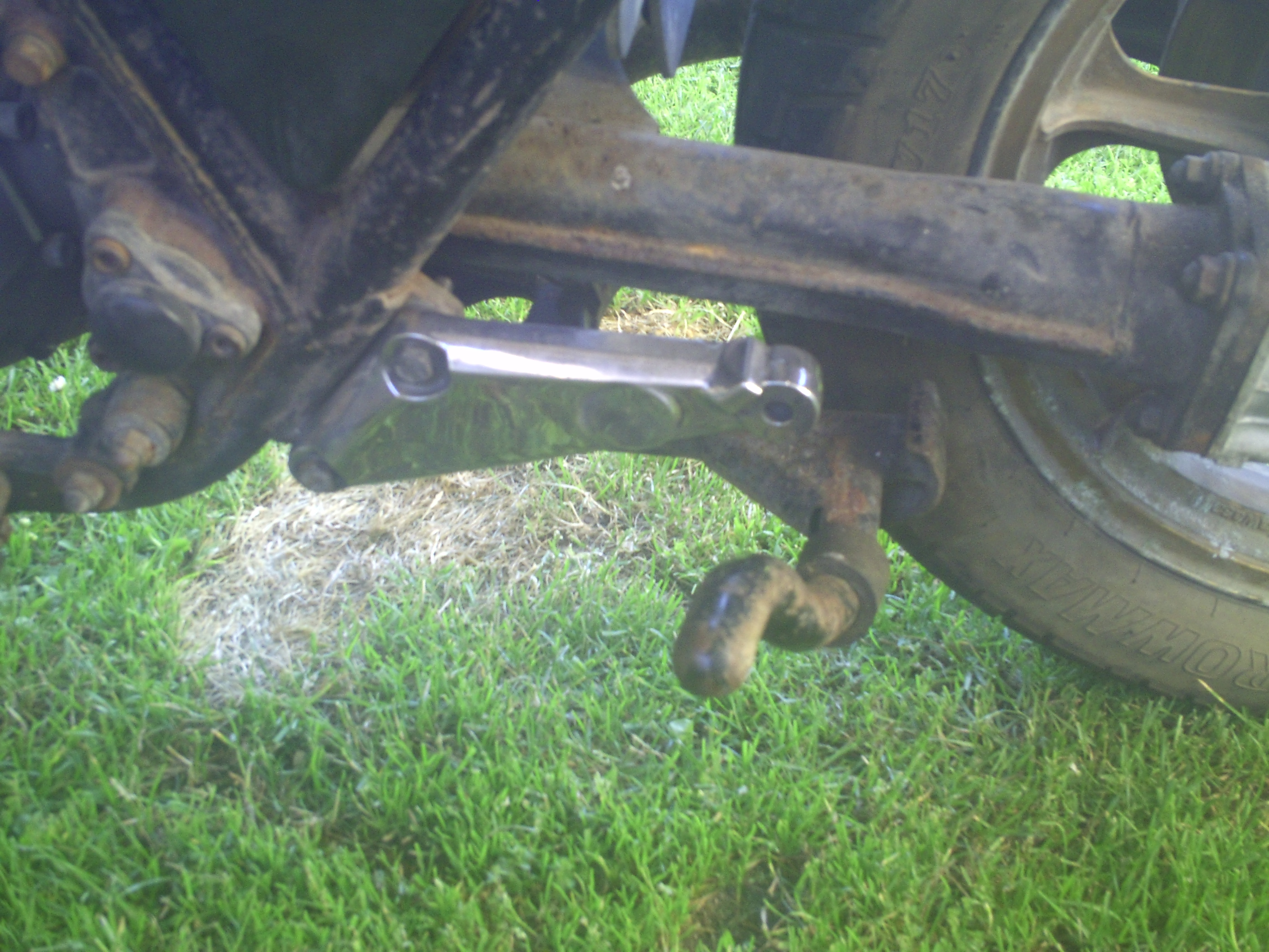

A quick question if I may?
The centre stand touches the LH rear peg and doesn't seem to have a stop. It flaps about a bit. Is it bent? There is also a bracket underneath next to the LH ctr stand mounting bolt that doesn't seem to do anything?

Re: ST recommission
Hi Pete
the stop for the centre stand is located on the left hand exhaust bracket... but your ST has a 4 - 1 exhaust, so no centre stand stop.
About the bracket next to the left hand centre stand mounting bolt, it's there on all the ST I've ever seen and I don't know the purpose of it. (perhaps the intended mounting point for some sort of centre stand lock as on some Z1100ST)
As far as I can see your centre stand is not bend. I would suggest you mount a new centre stand spring and a stop on the right hand side to avoid the flapping about.

Re: ST recommission
Thanks Philippe,
Just researched it following your post and the bracket is indeed a centre stand lock.
3rd pic
https://www.ebay.co.uk/itm/Kawasaki-KZ1 ... 0804218311
and after rechecking the parts diagram
https://www.kawasaki.com/Parts/PartsDia ... /KZ1000-E1
parts 12, 13 and 17 show the fixing.
The spring is OK, because there's no stop the stand goes past it's high tension point.
A little fabrication is in order.

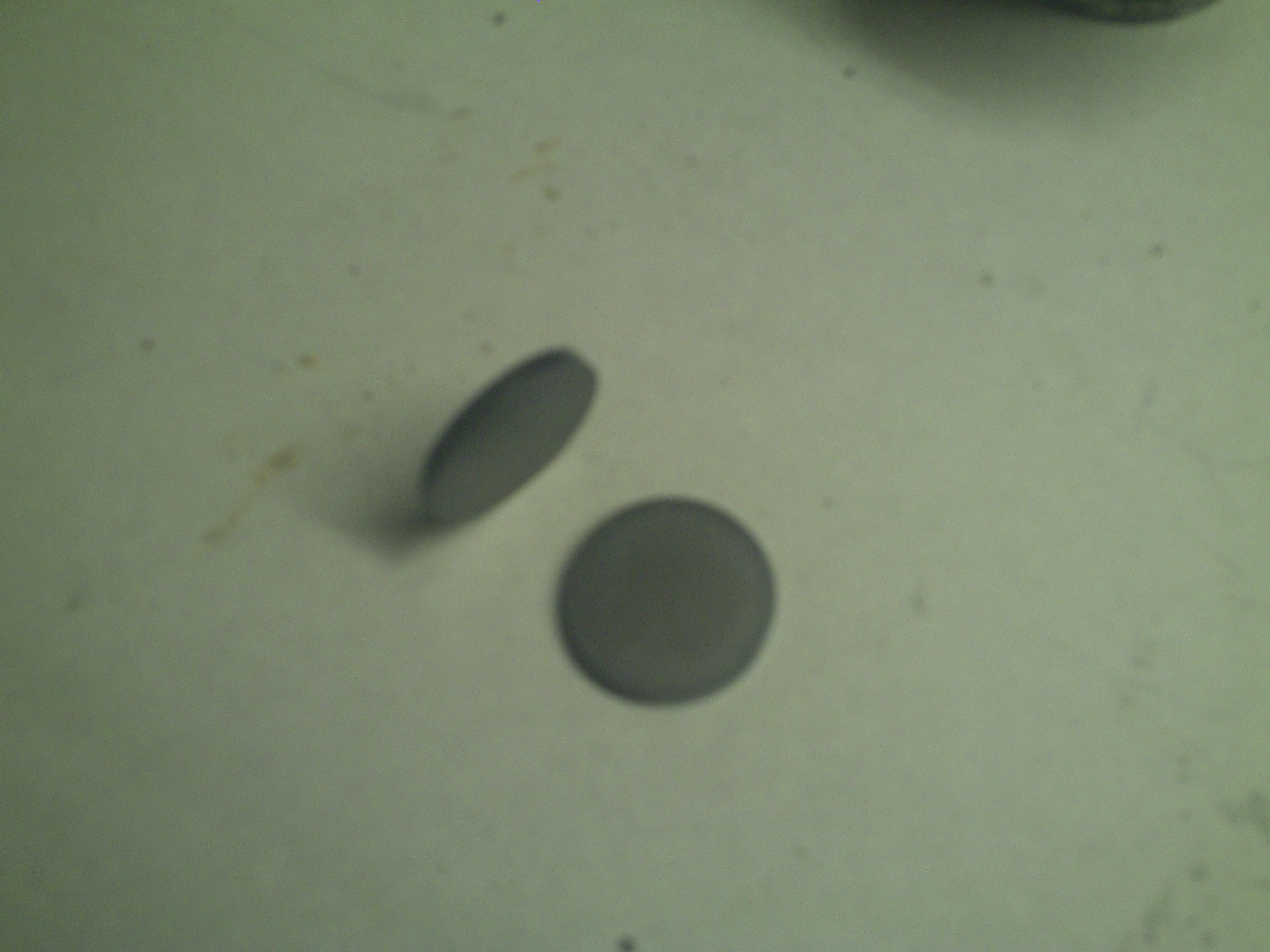

Re: ST recommission
Just about to put the fork oil in and remembered the metal disk that was sandwiched between the spring and the fork bolt.
When I dismantled the forks I remember having 1 in each fork. I now have a 4? I've checked on the parts diagram and they don't exist, having said that the diagram shows 2 springs in each fork and I have 1. Either these discs were stuck together with oil and they are a preload spacer on the spring ( I remember my progressive suspension on the Zeph had a preload spacer, actually a piece of 40mm plumbing evacuation pipe cut to length) or 1 should go at the top of the spring and the other below it? The latter I'm wary of due to the diameter of the disc is very close to that of the fork tube and would restrict oil flow. Has any one else got these in their forks?

Re: ST recommission
Hi Pete
the "European version" has only one spring in the fork leg, the "US version" had two springs, so don't worry about it.
(I think you have a US parts diagram)
The metal plates don't belong there, maybe someone putted them in there to act as a preload spacer.
Measure the fork springs, they should have a lenght of 586 mm (standard) or at least 576 mm (service limit).

Re: ST recommission
Thanks Philippe,
European vs US specs, that's that mystery solved, Cheers.
Looks like preloaders then. I'll leave them out to start with then, they can go back in later if it's a bit soggy.
