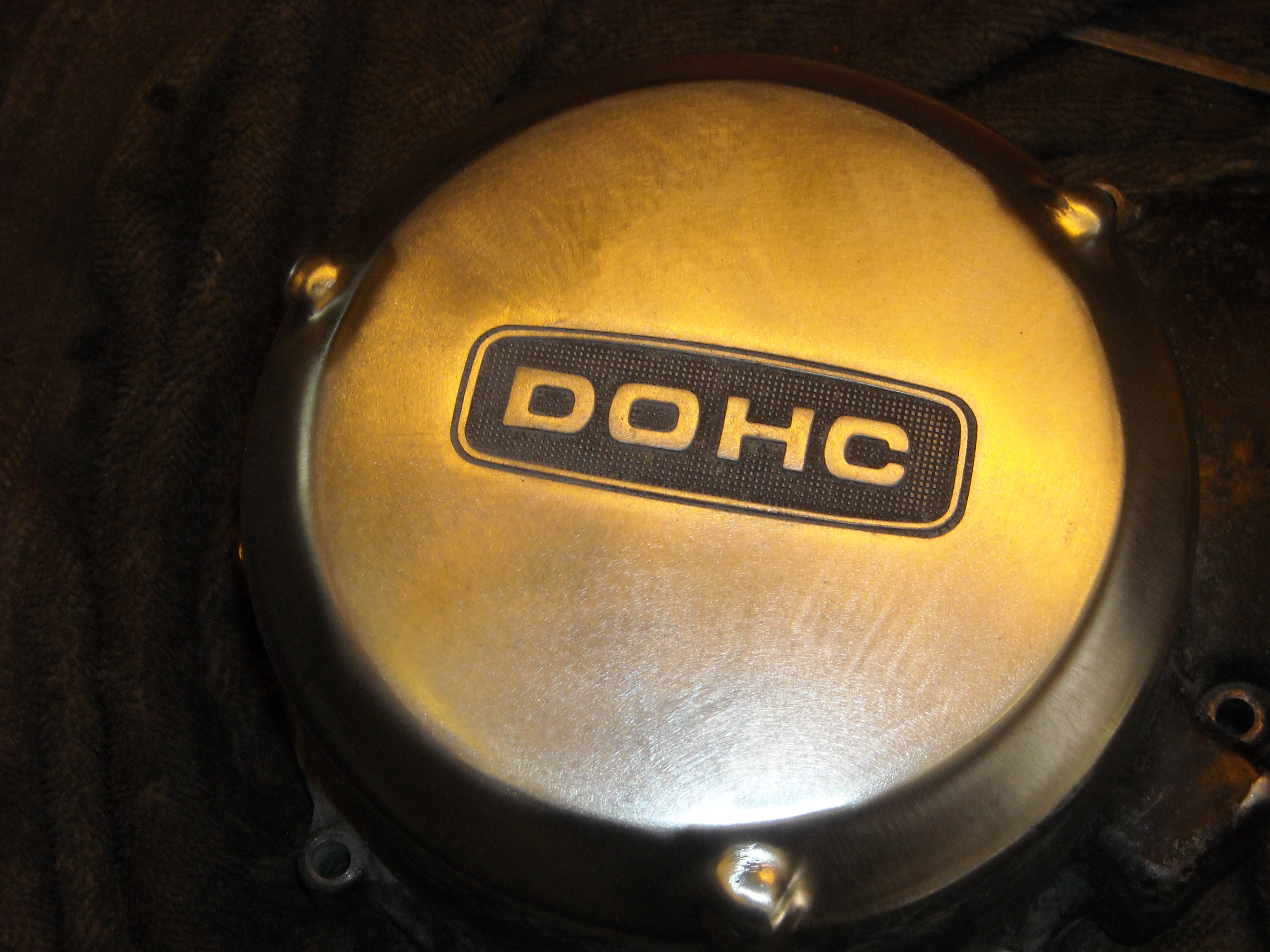

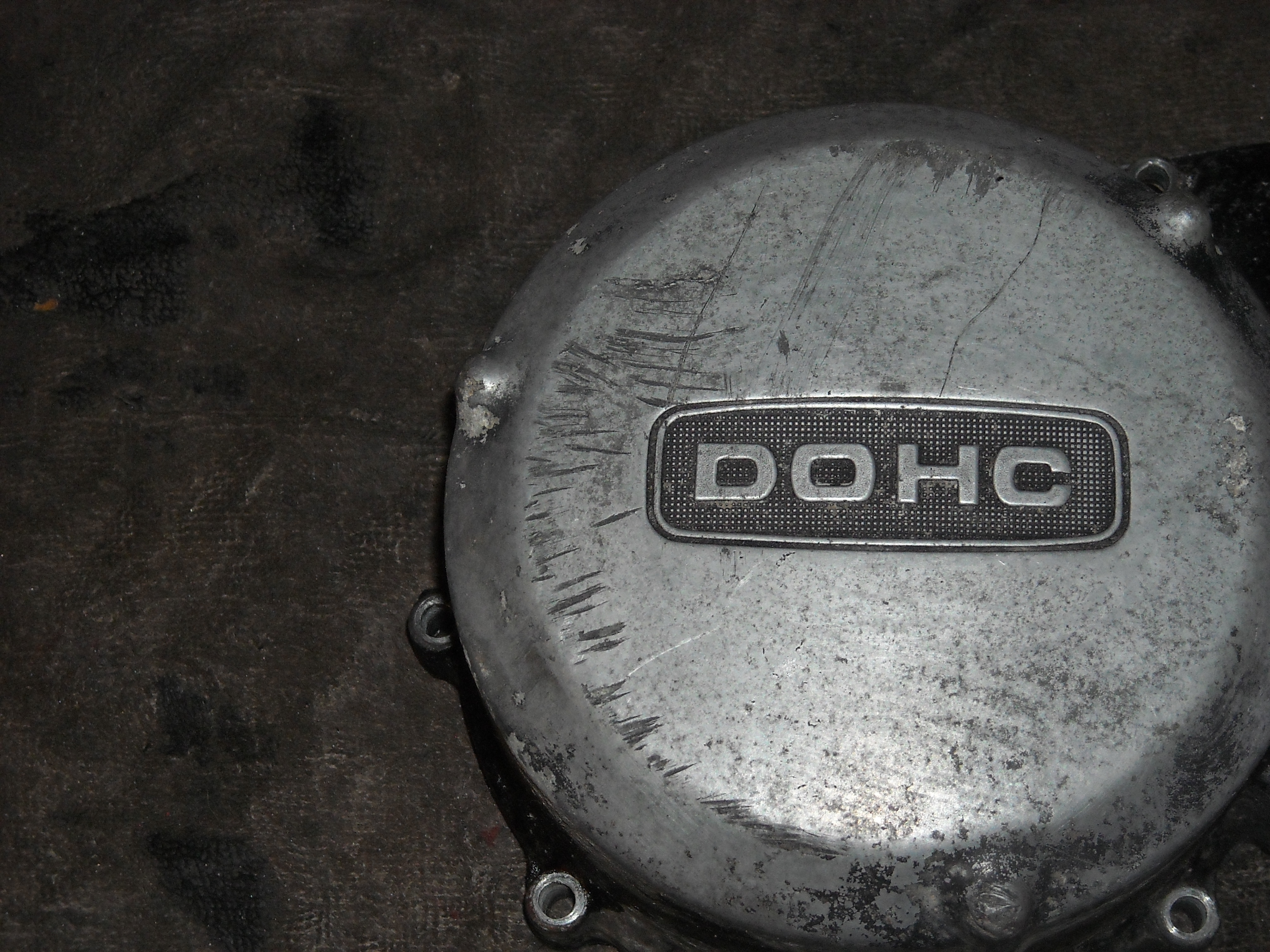

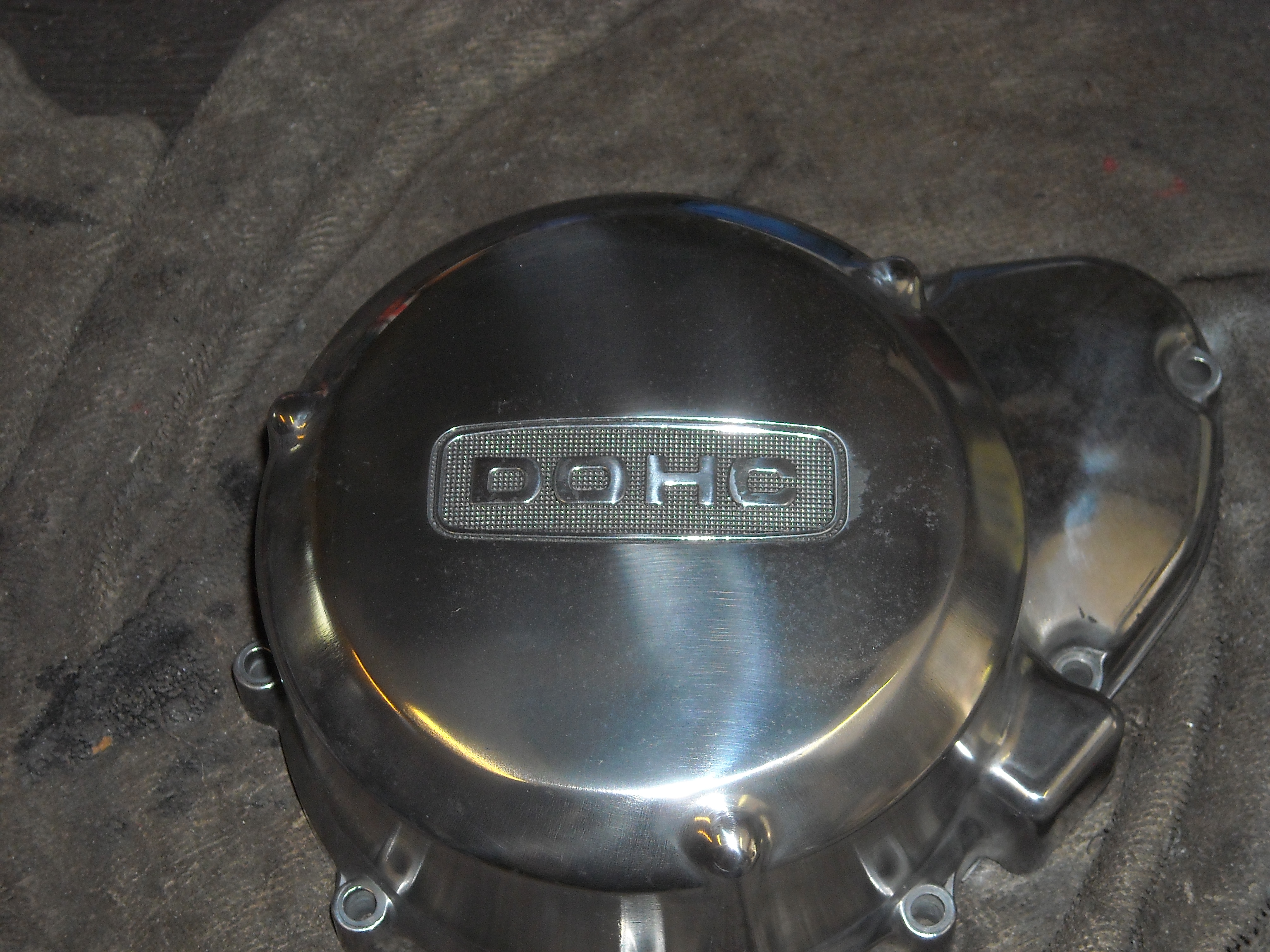

I started cleaning up the alloy engine covers :
The alternartor cover showed signs of a fall, deep scratches...
After grinding with sandpaper 120, 180, 240, 400 this was the result:
No more scratches...
And this is how it looks after polishing:
So you see that a lot is possible with the correct tools and with patience.
The other covers are treated the same way with more or less the same results.

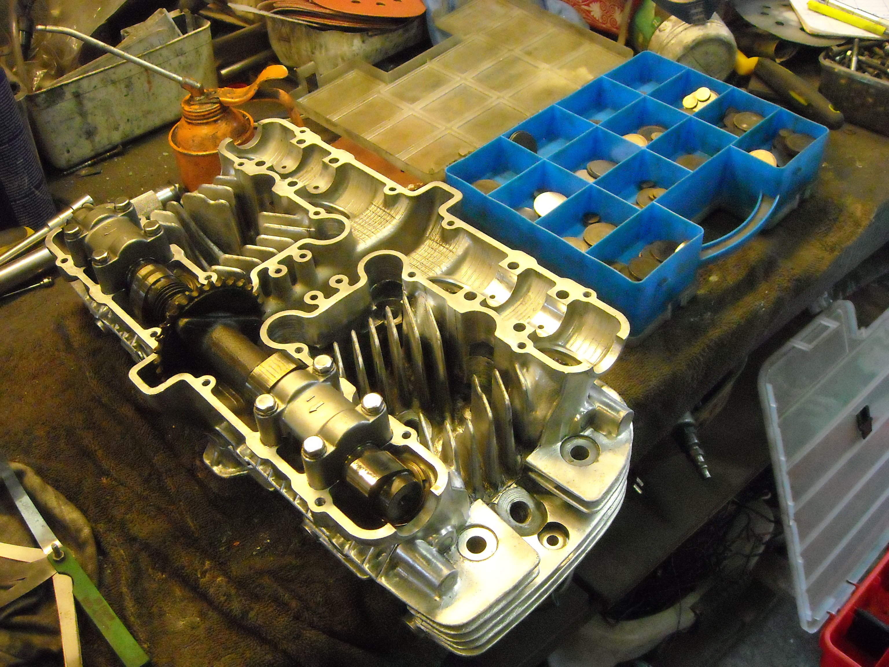

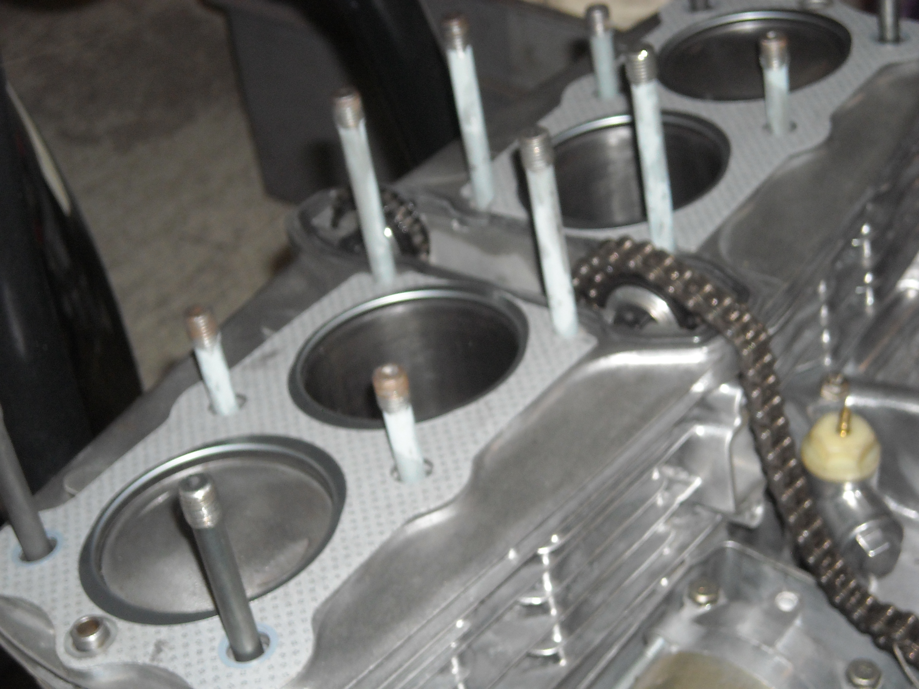

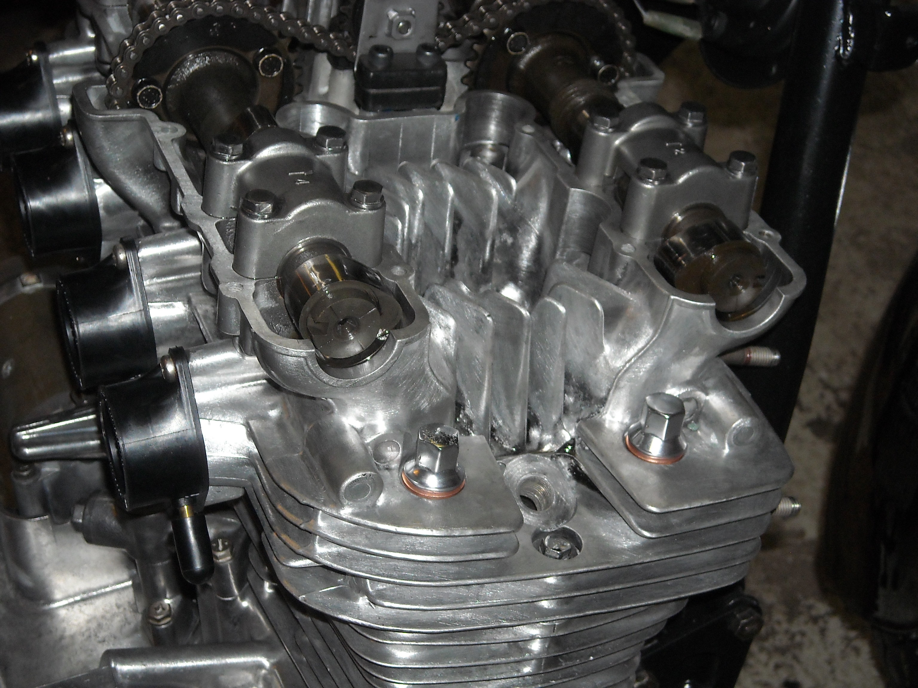

I also spent a lot of time on cleaning the cylinder head.
After about 2 days the results were good enough for me so I started to assemble it.
The valves were all lapped and then the assembly commenced.

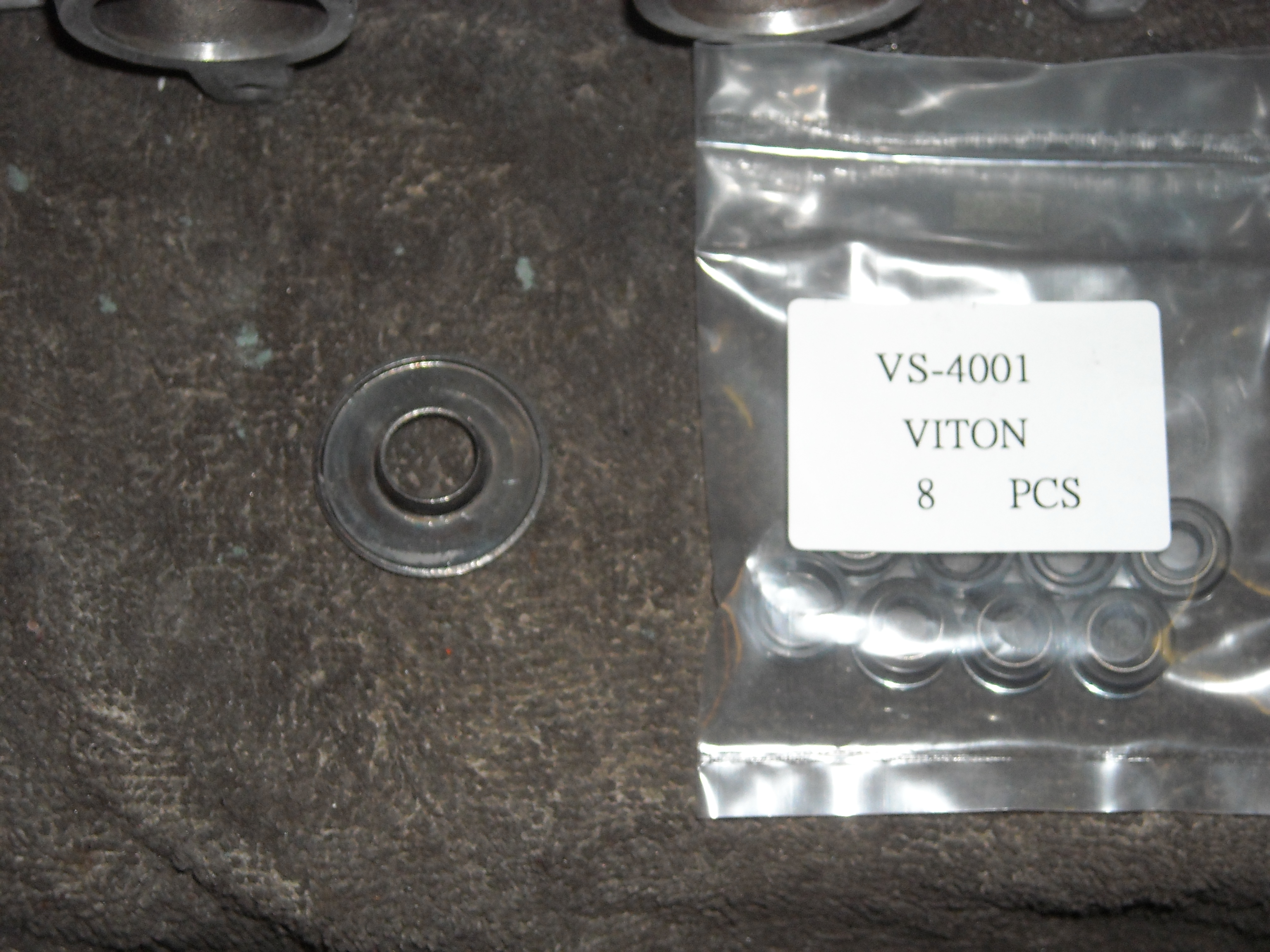

Just an advice for people who do this for the first time:
don't forget to put the spring dishes in the head BEFORE you put the valve stem guide caps on!
If you don't do it that way, you can't put the spring dishes in after the guide caps are in place and you'll have to remove the caps and thereby causing damage.

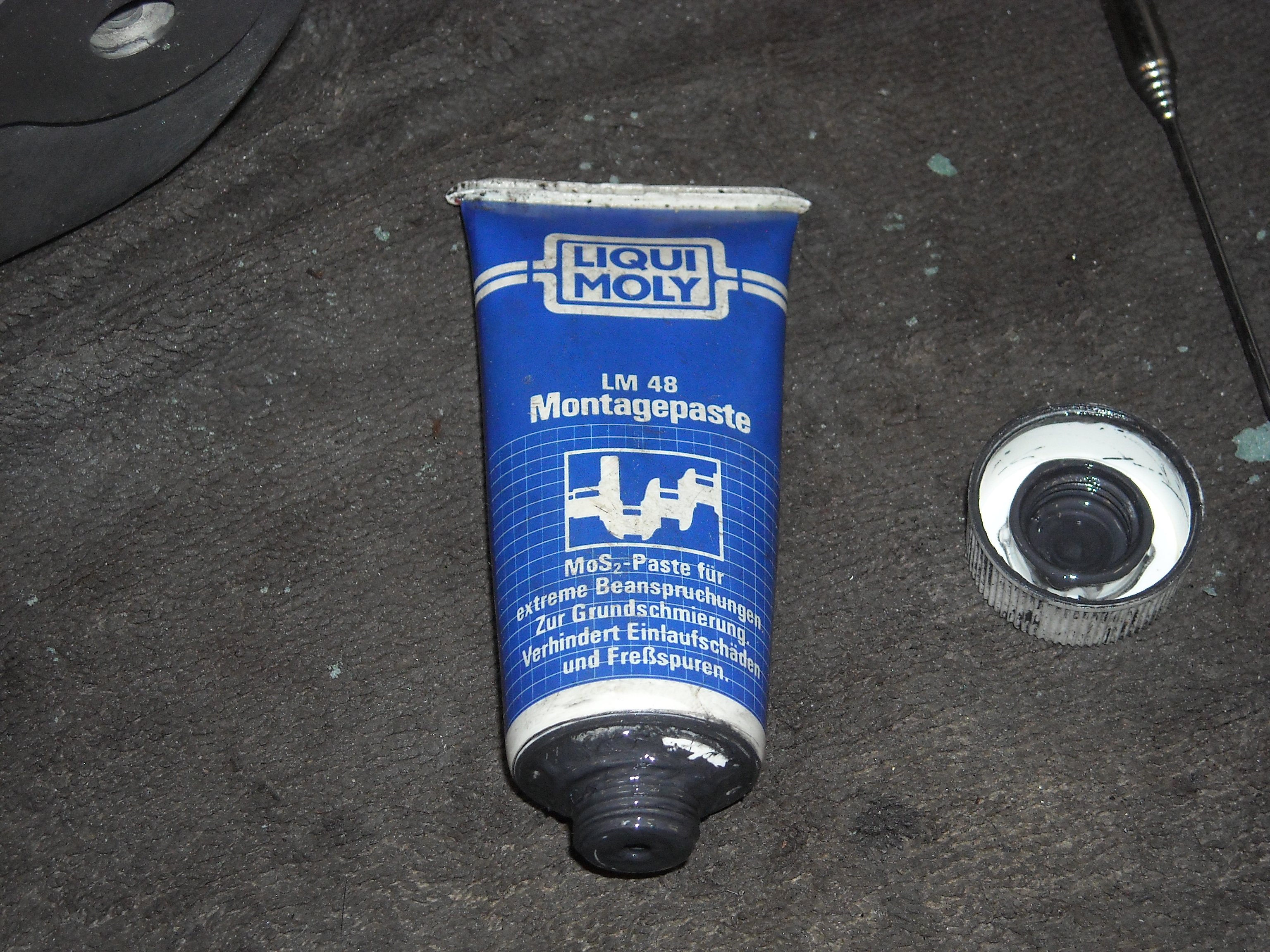

When I put the valves in the guides, I always use a bit of special grease on the valve stems.
After all the valves are installed in the cylinder head it's time to shim them up.
Keep in mind that when lapping the valves, you can have a difference in the thickness of the valves and that you have to adjust the shims to get the correct amount of play.
When doing that with the head off the engine, always install one camshaft at the time, never the two at the same time.
If the two camshafts are installed at the same time, there's a big chance that an exhaust and an intake valve can be opened at the same time and that they damage each other because there's no timing between the two camshafts.

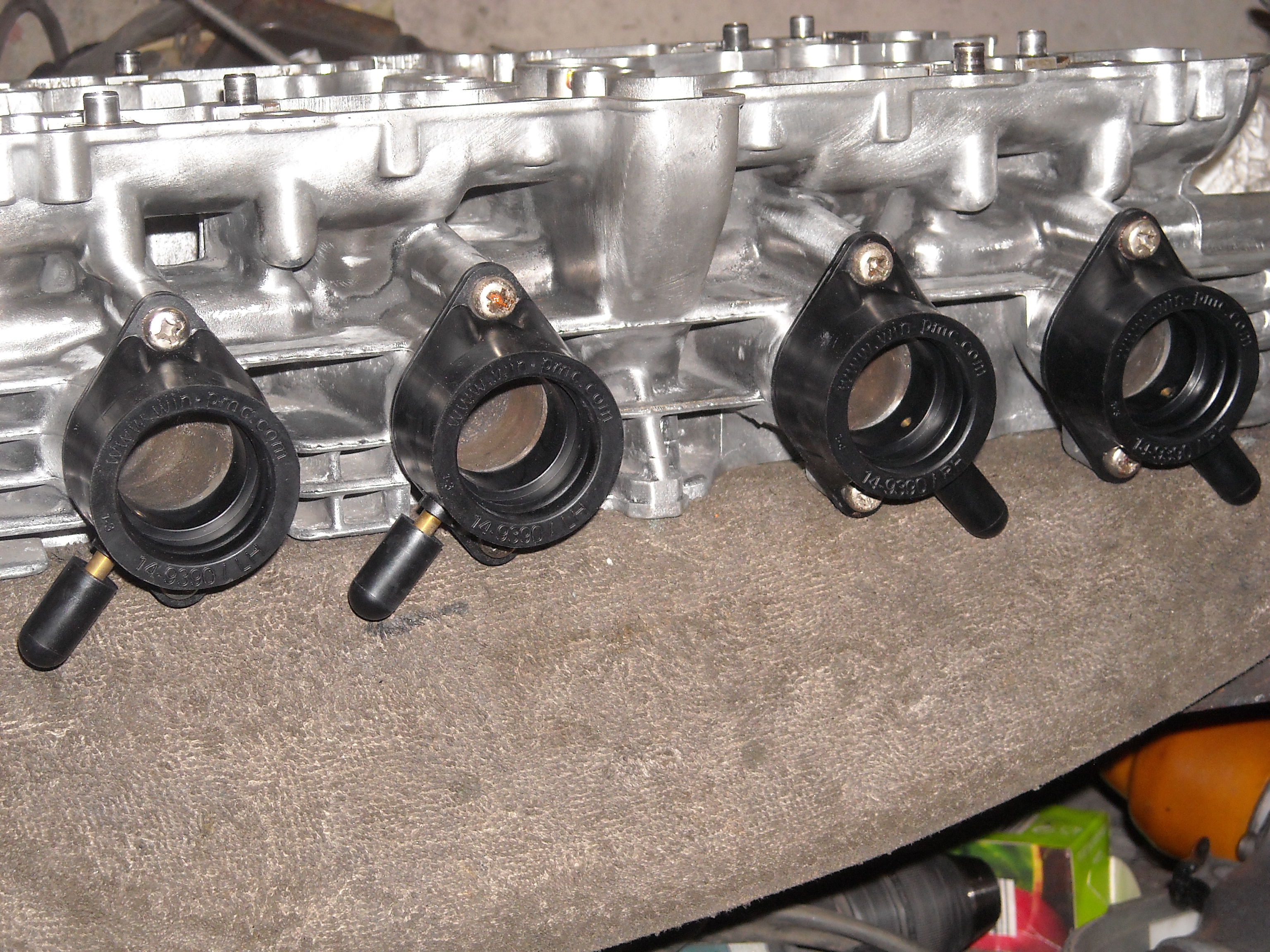

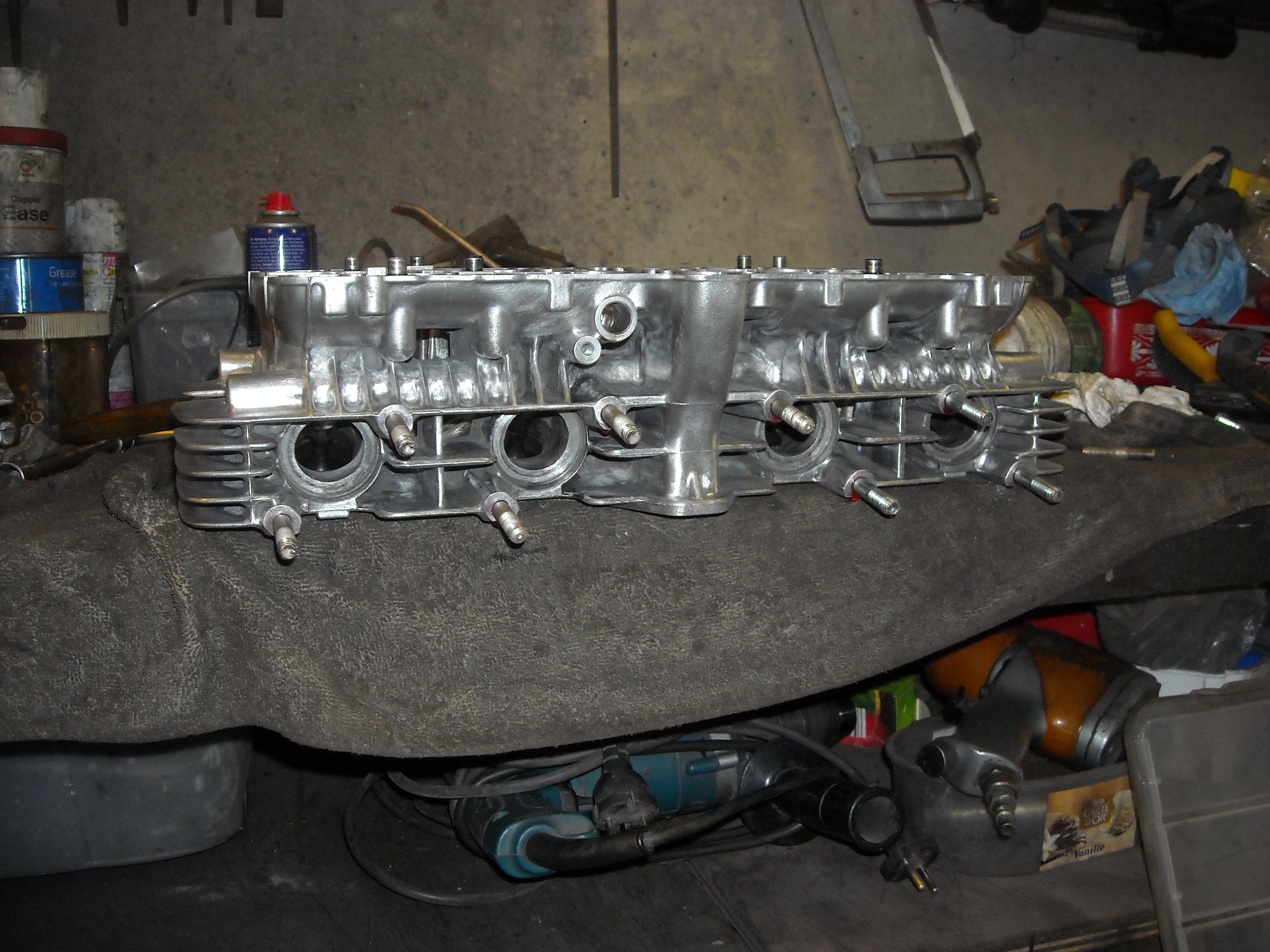

After all the adjusting the cylinder head was prepared for instalment.
The exhaust studs were mounted and the intake rubbers were also mounted.
It's easier to do it at this stage, you have all the room you need to secure them tightly.
The other camchain parts were installed, the gaskets put in place and the head was mounted.
The timing was set and this is the result of a days work.

Hi Phillippe thats good stuff, may i ask did you do the alloy rubbing by hand or in a drill etc? Reason i ask i need to do the same as mine are scratched too, i bought a pack of wet and dry in multiple grades but seems to hardly touch it, hence query, if i can get them anywhere like yours ill be chuffed.
After seeing your wheel resto and looking at mine, decided to have a go at that too as they were a bit rough, never done a wheel lace up before but hoping it will go like yours, it certainly came apart easy, the rear rims been replaced at some point as no markings and chromes good, fronts a takasago, but bit rusty in places, spokes and hubs have been sprayed silver, not that well either!
Posts: 2052
Re: Restoration of a Z1000A2
#51 PostAuthor: Philippe » Sun May 07, 2023 3:00 am
Hi Gray17
the sanding is done with a circular (exentric) sanding machine. There's a picture of it at the start of the topic.
It takes time and effort but at the end it's worth the while. Start with the coarse sanding discs and end with the fine.
The "secret" is that you always keep moving with the machine, little bits at a time, don't hold it still at one place. Even a movement of 1 cm is good to remove the deep scratches. It's a matter of experience and practice.
Good luck!

Thanks Phillippe, I have a random orbit sander, but mines air driven, will get some stick on circular coarse and fine discs and give it a go, i bought it, then never used it, guess experience of how long and how hard to press comes the more you use it. I also have some flap wheels and an angle grinder, or is this too abrasive?

don't use an angle grinder, it rotates much too fast, you'll destroy the covers, alloy is soft!

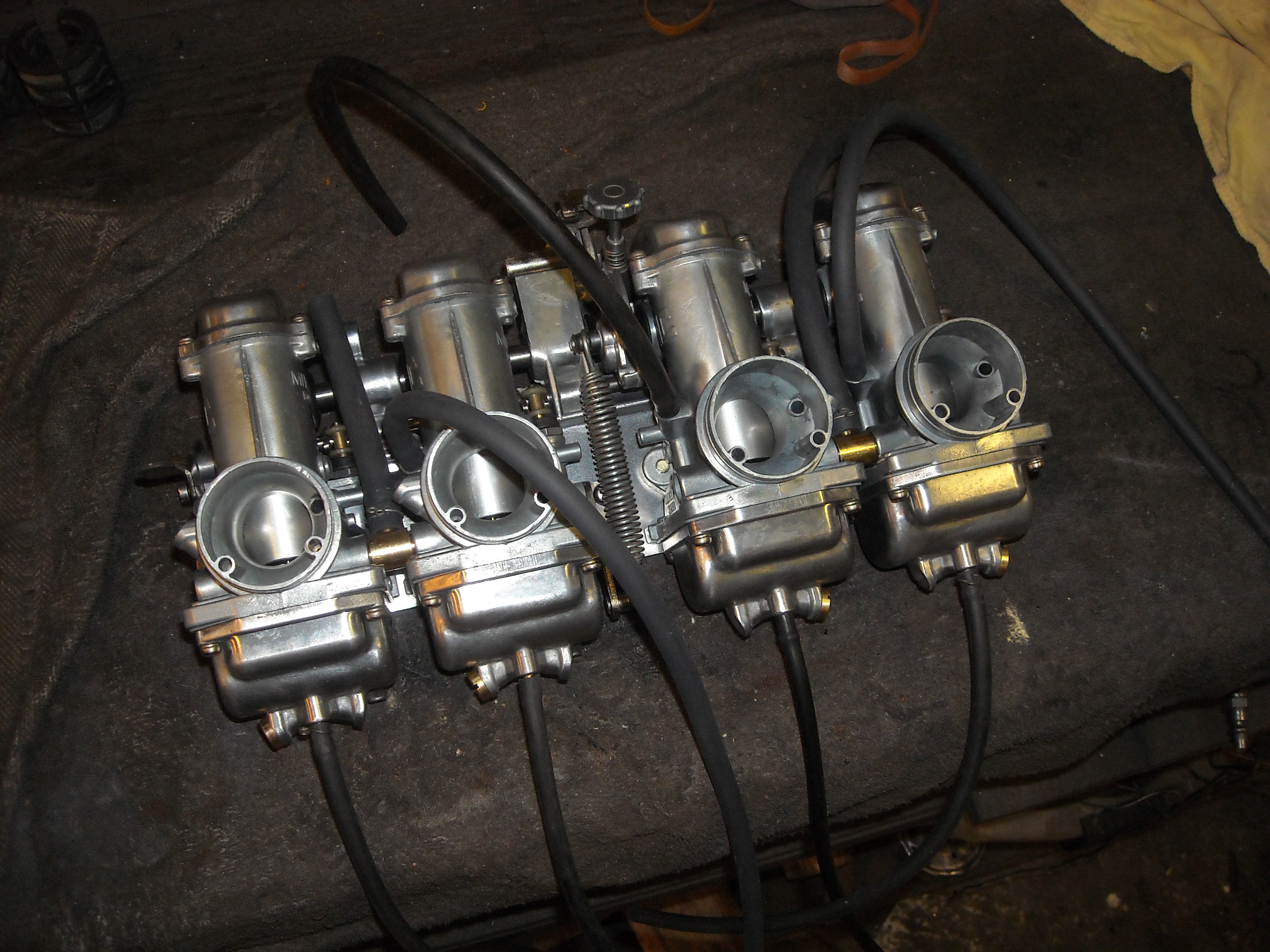

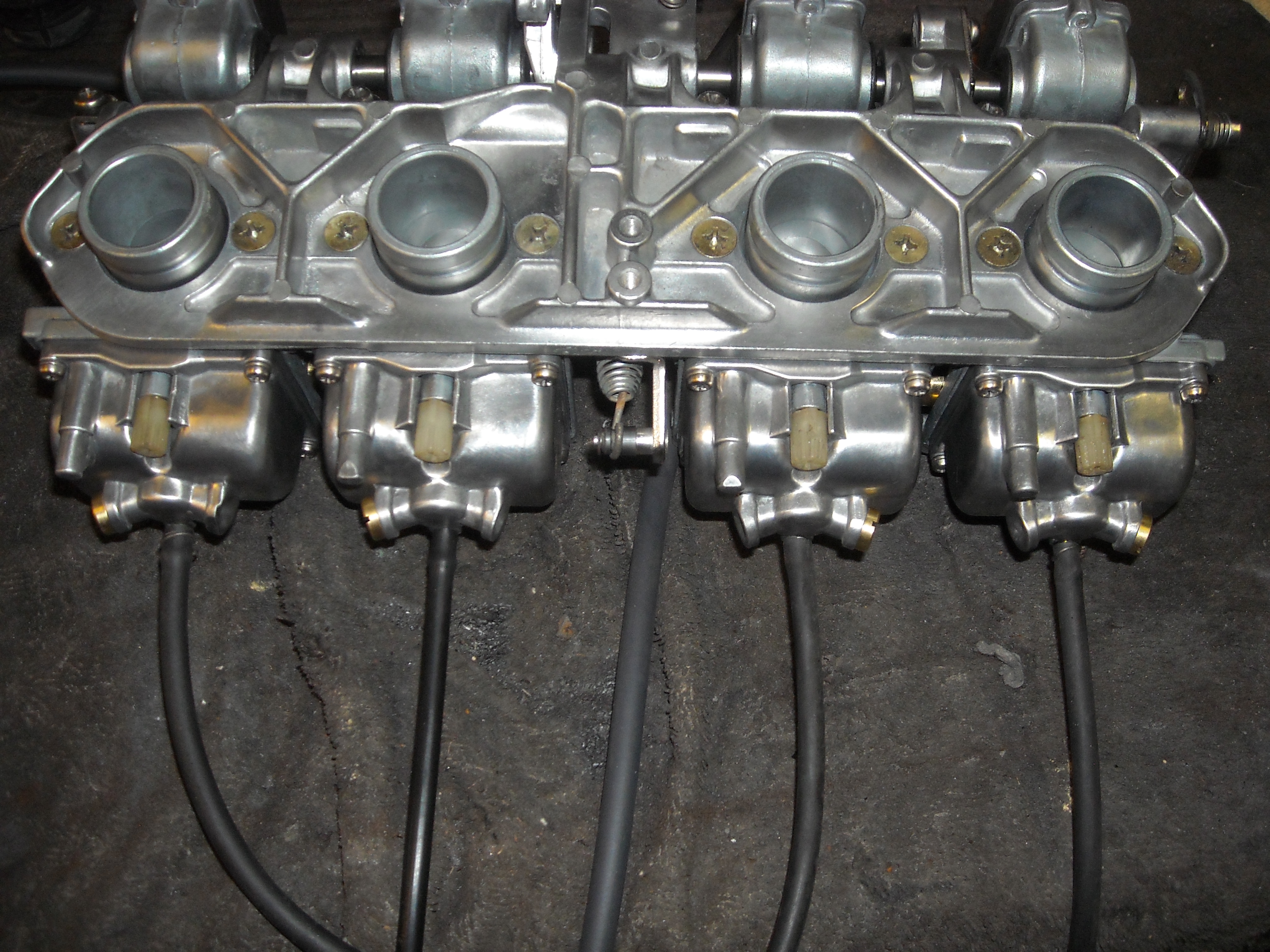

Yesterday morning I assembled the carbs, after the assembly the stationary synchronisation was performed, the float level hight adjusted and they are ready to be mounted .
Even the plastic caps over the needles are in place! Most of the time these are gone but they were still present when I bought the bike.
In the afternoon the engine covers received the last treatment before the clear coat was applied.

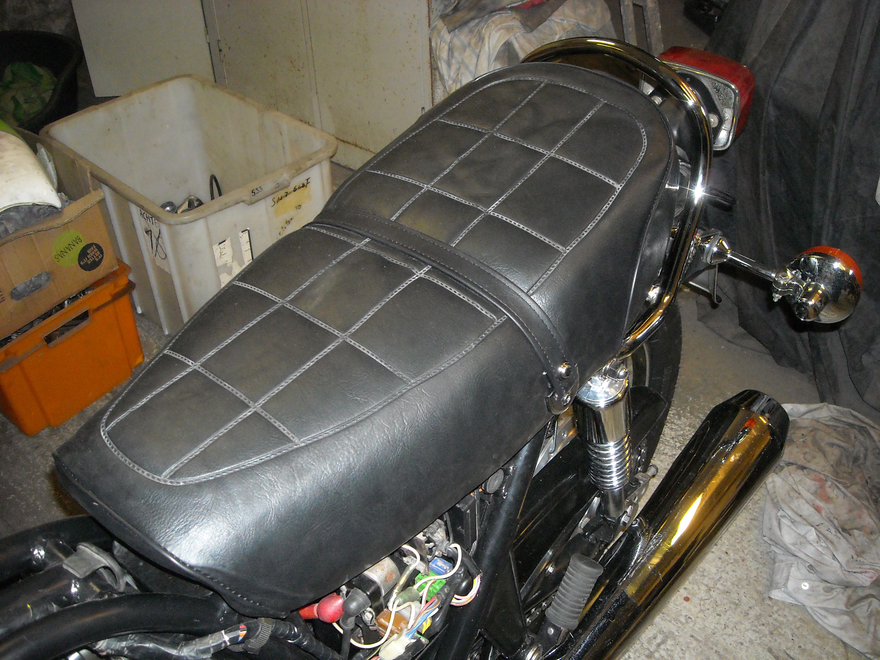

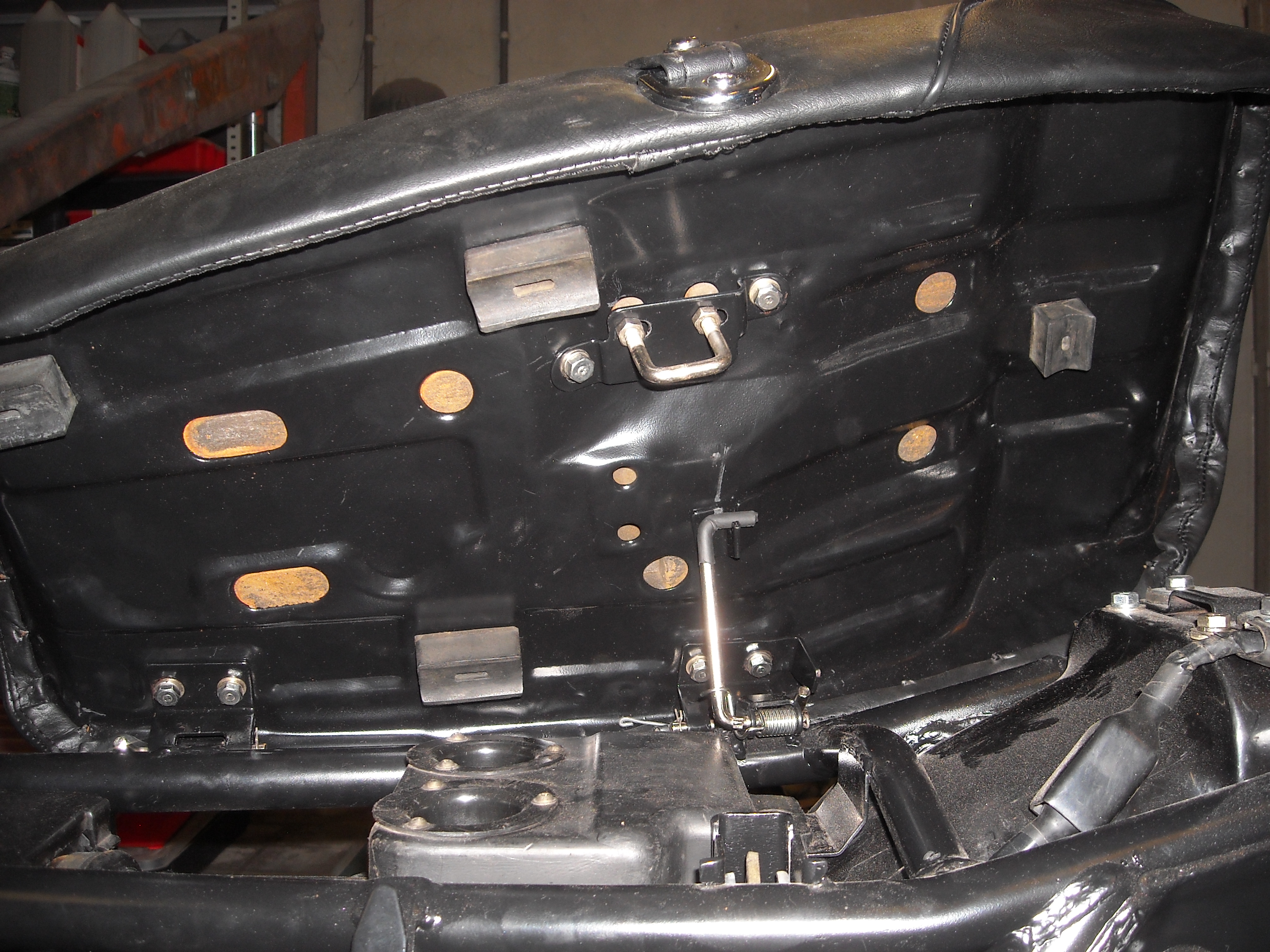

Today I started with the seat.
A new seat cover and strap were installed
The hinges, the lock loop and the dampers found their place and the seat was mounted on the frame.

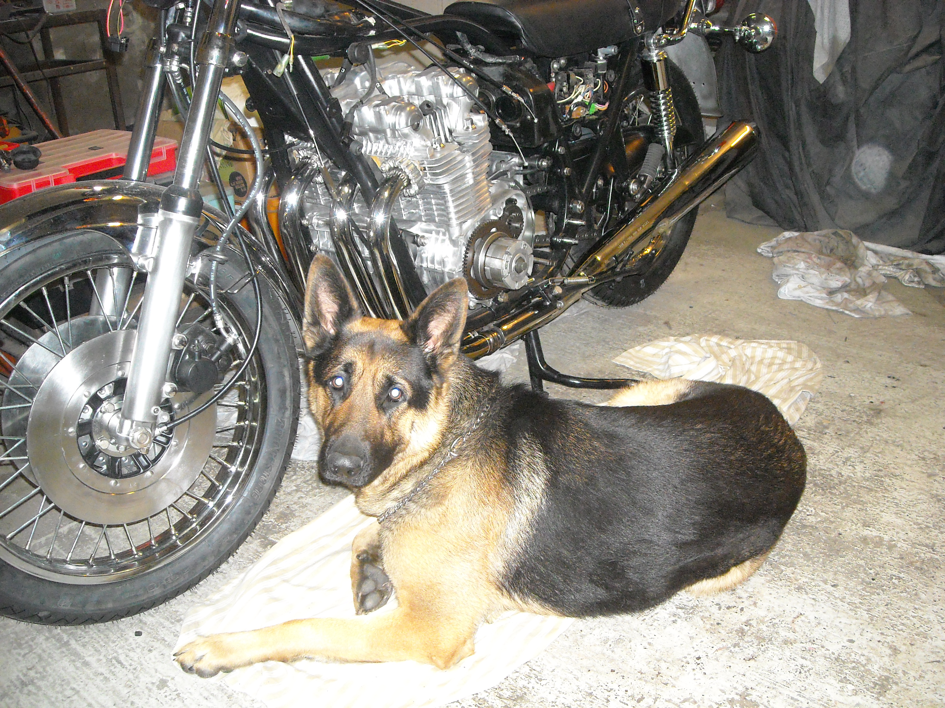

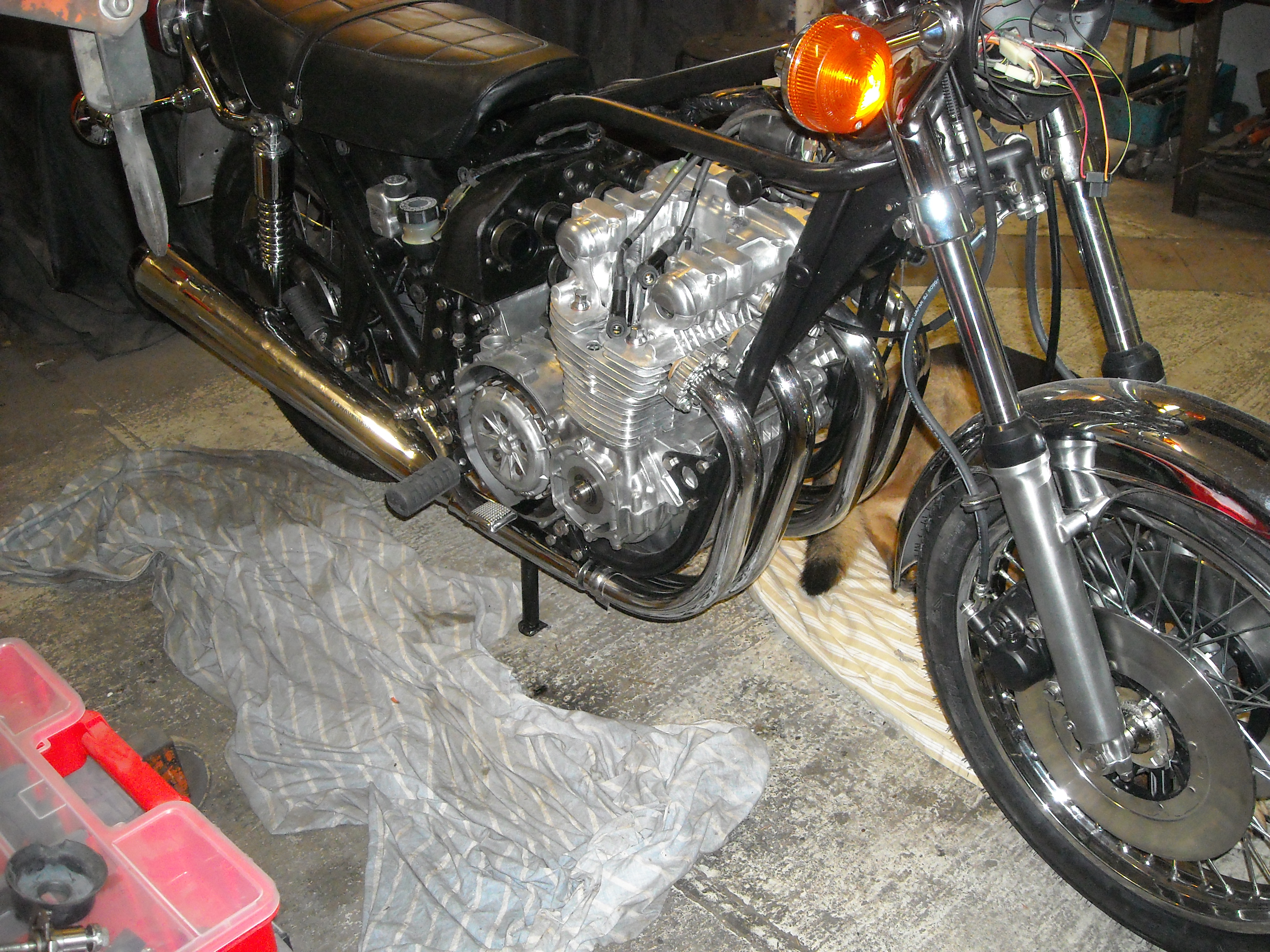

After that I mounted the exhaust.
It's not a new one and it has some scratches but it's an original!
As you can see I got some help of Thorben, my partner in crime, he kept the blanket warm that I had spred on the ground in order to prevent the silencers get more scratches...
There are still a few things to do but the restoration gets towards it end.
If the weather permits, if there's not to much rain, I'll start removing the old paint from the bodywork.
Perhaps more good or bad news tomorrow...

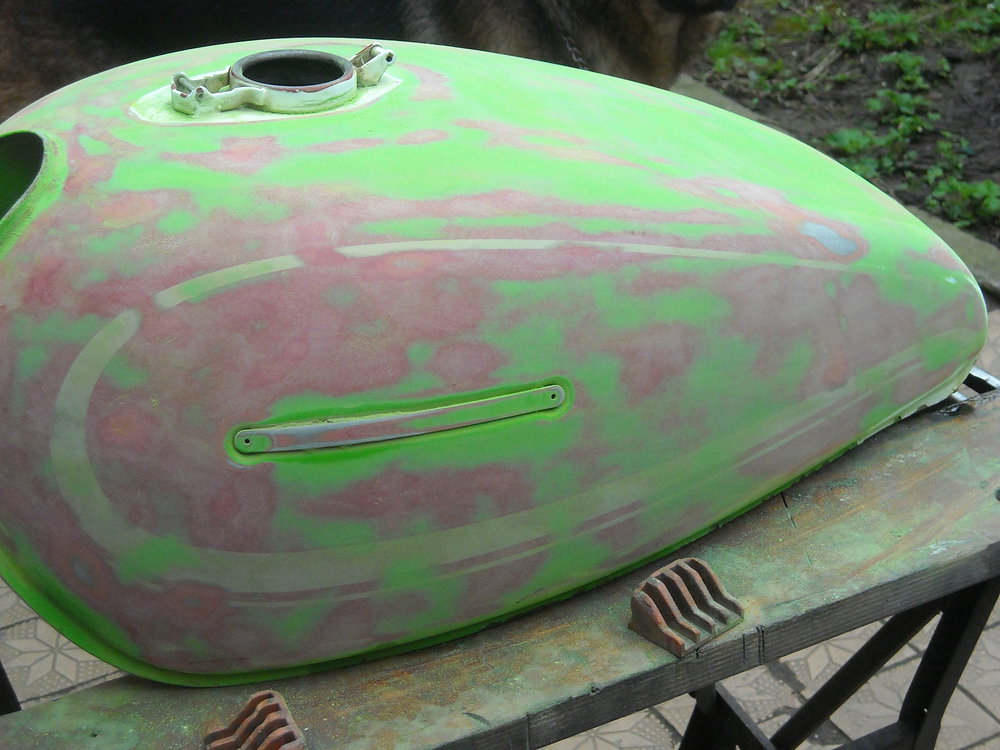

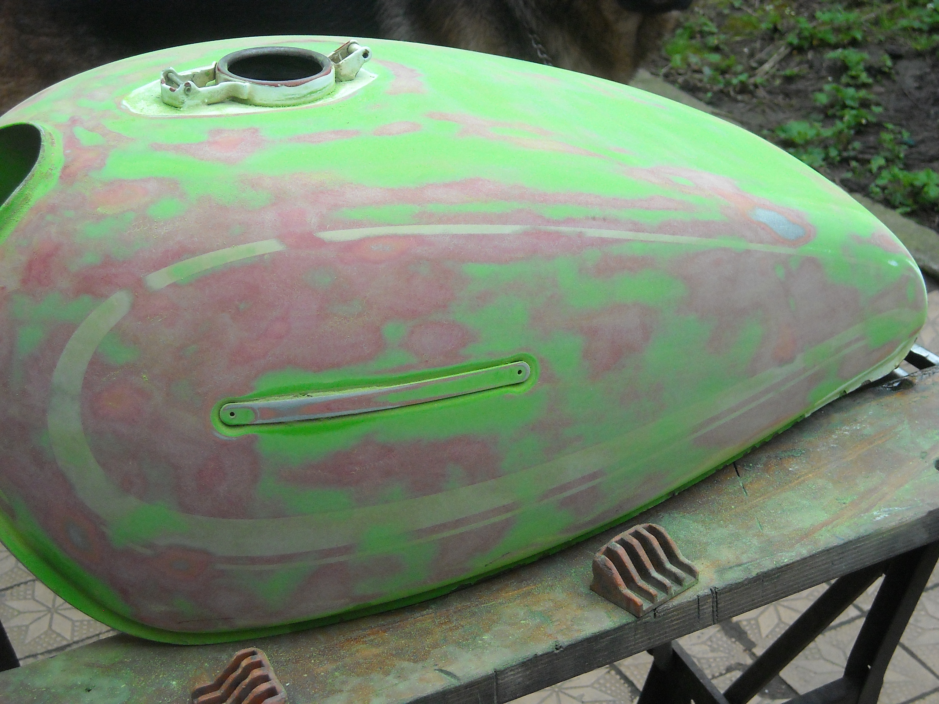

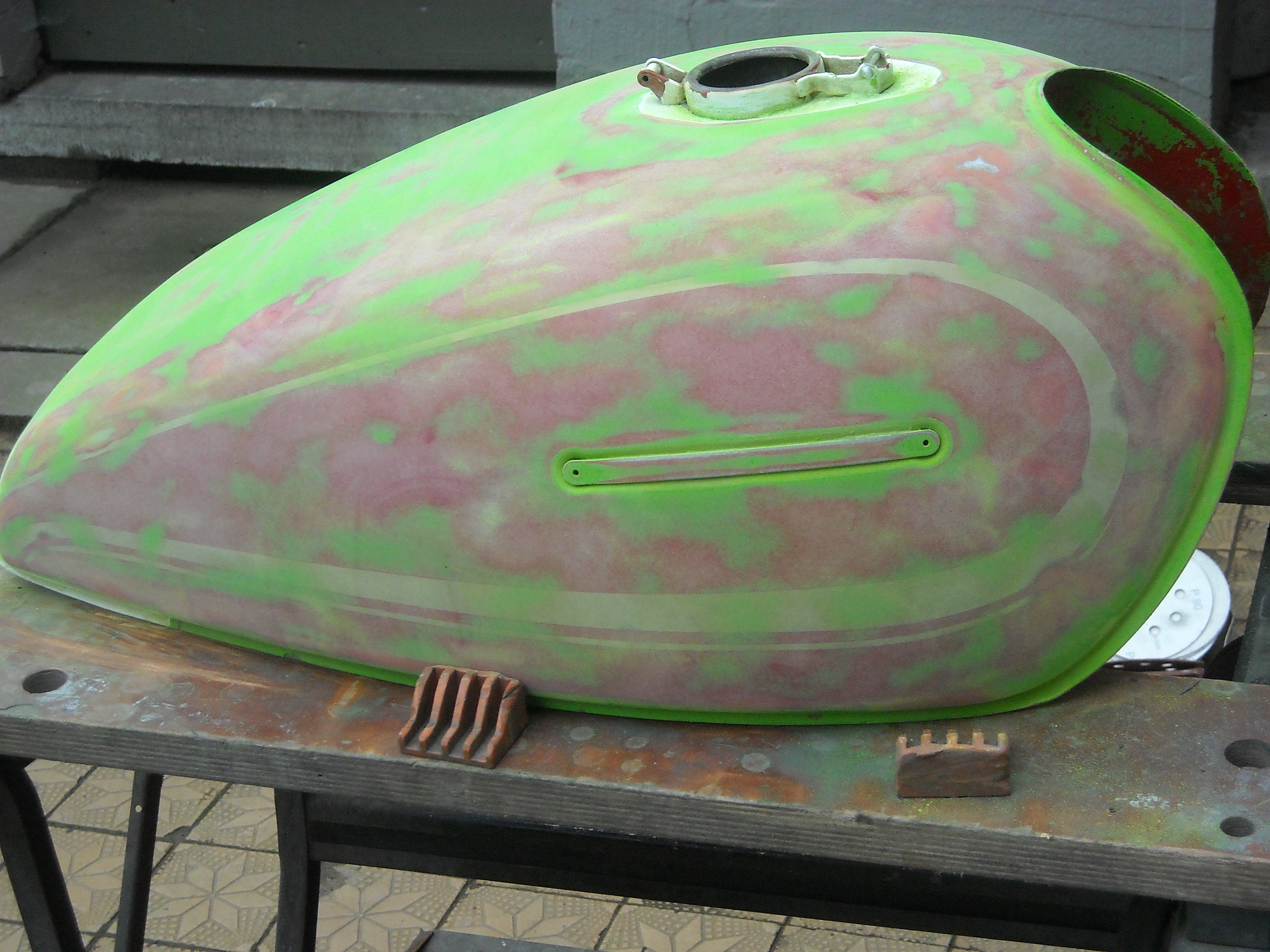

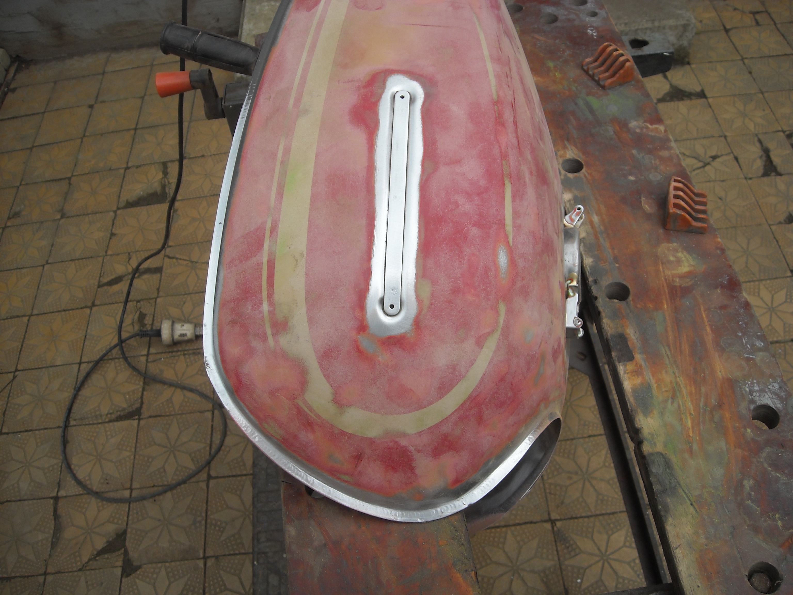

After a bit of fiddling with the clutch, I started the stripping of the fuel tank.
Remember the scratches on the alternator cover? I was afraid that the fuel tank would be damaged.
After a bit of sanding this is what I found:
No filler or damage on the left hand side...
and no filler or damage on the right hand side!
Yes lucky me!
There were no signs of damage, only a lime green and a white overspray and underneath the original color with even the striping stil present.
It's the first time that I don't have to fill dents or scratches on a +40 years old fuel tank.

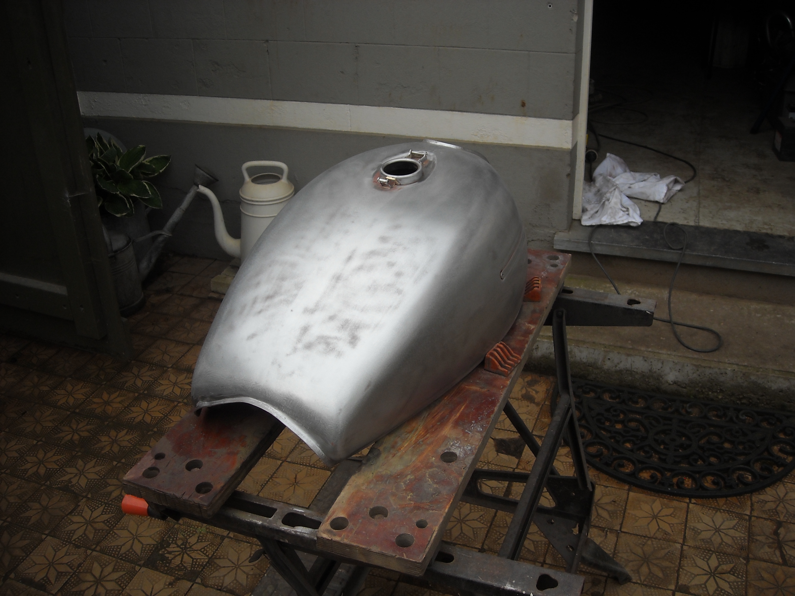

The inside has no traces of rust and looks like new.

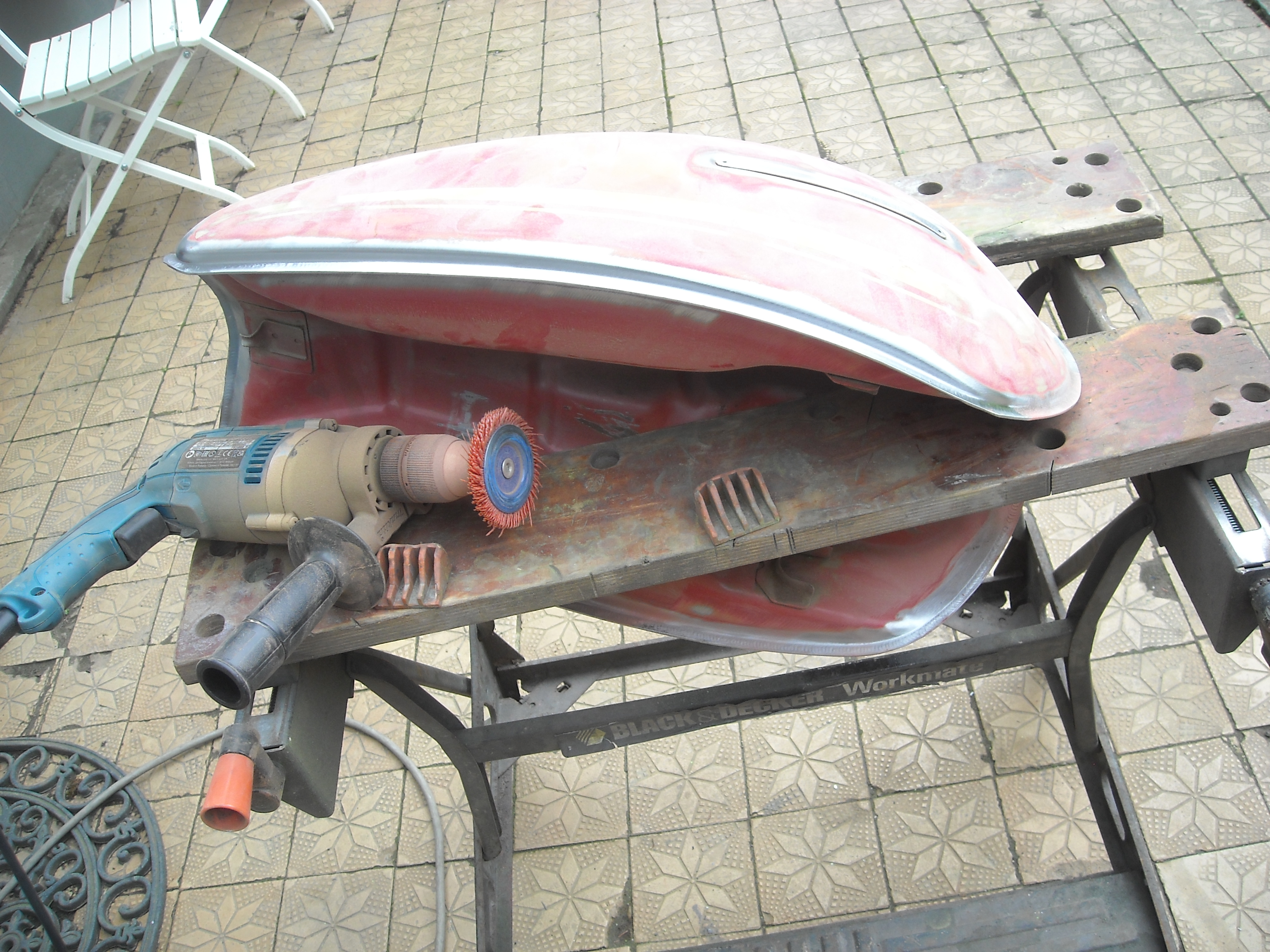

The stripping continued .
The sides of the fuel tank where the upper and lower shell are welded together, the fuel filler hole and the places where the tank badges are attached were cleaned with the "magical" nylon rotating brush.
An easy and fast job.
This afternoon, by 5 PM the upper surface of the fuel tank was completely stripped.
Perhaps I'll strip the underside of the fuel tank tomorrow, we'll see.
