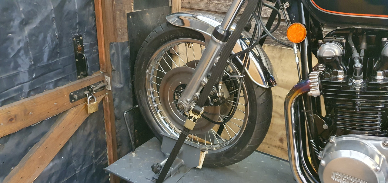

front wheel done and fitted, but not after an issue !!!! when i nipped up the spindle it went tight, i thought it was something to do with the speedo drive but it turned out the middle spacer was missing :shock: who fits bearings without the spacer :?? anyway took the one out of the mag wheel and all sorted :) still waiting for the paintwork :roll:
