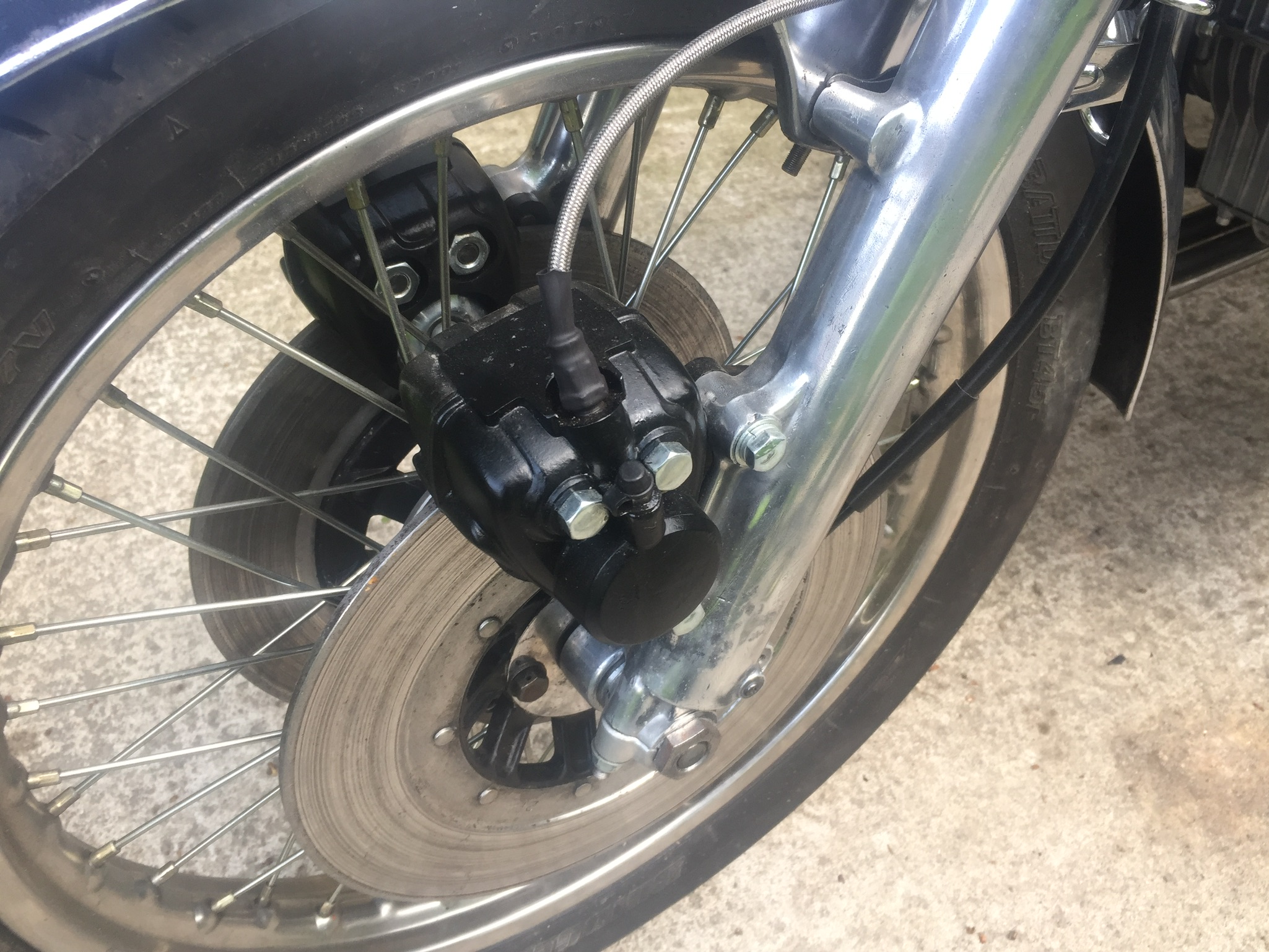

Rear brake sorted - only took 3 days, half a litre of fluid and an acute case of RSI to bleed the sod through, BUT now I have a beautiful set of fully functional Powerhouse refurbed calipers.

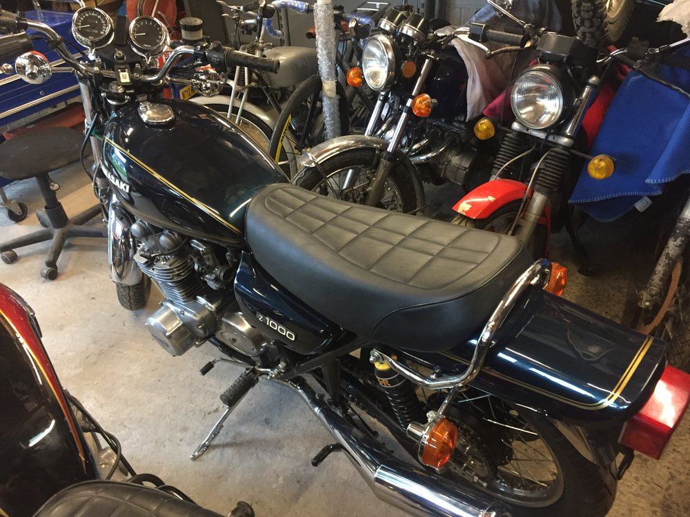

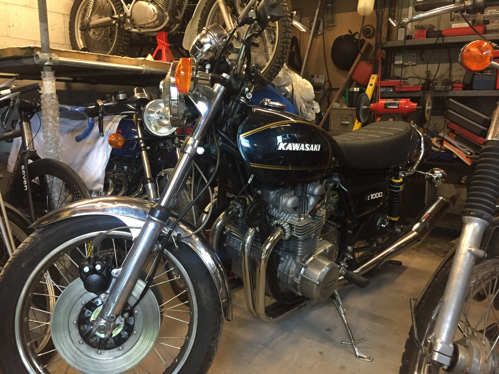

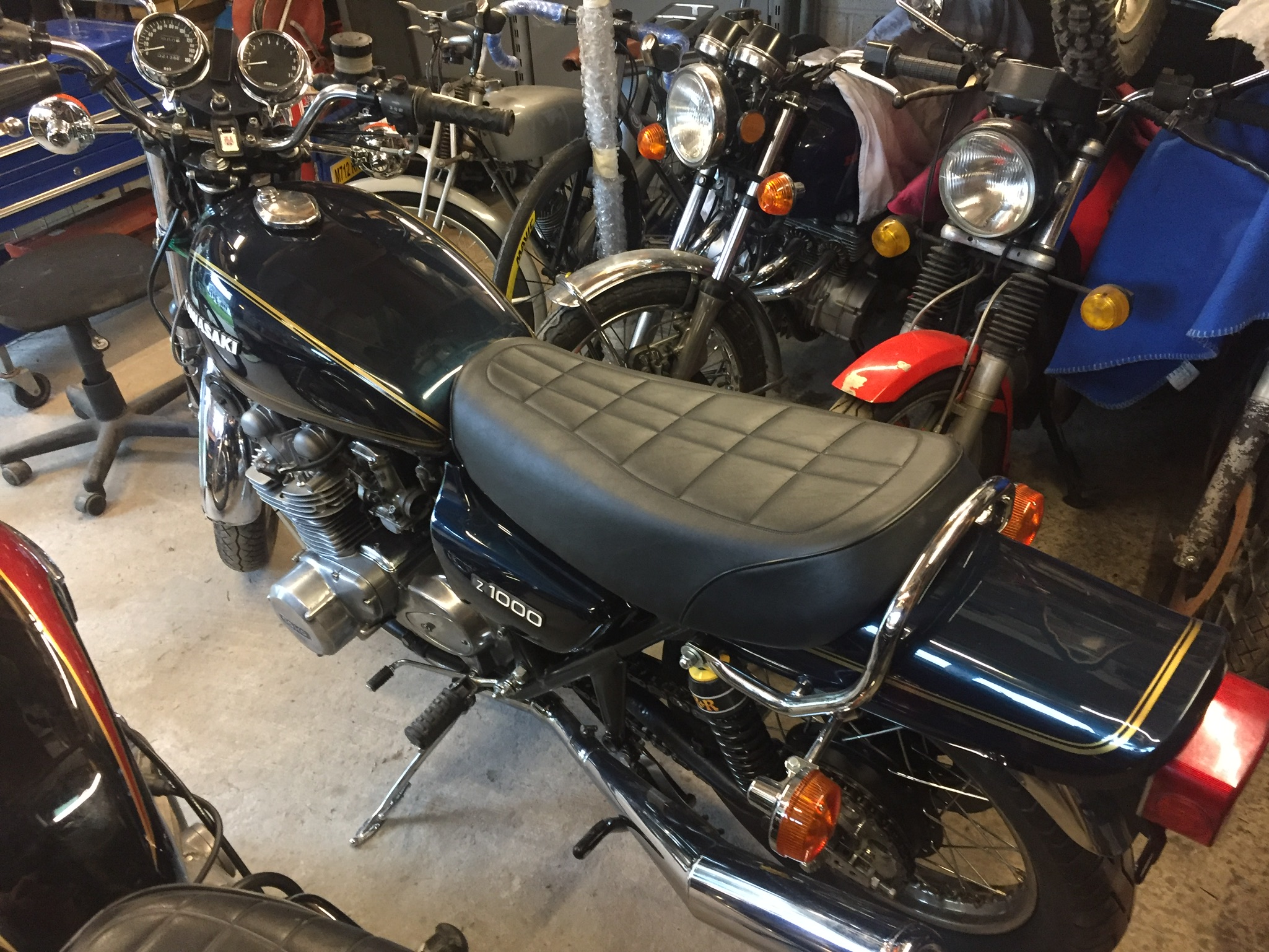

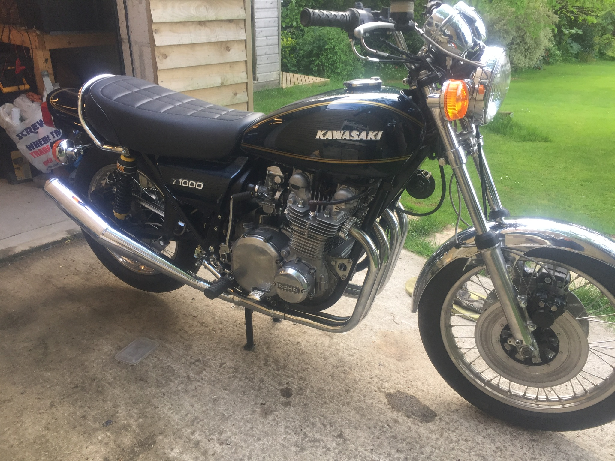

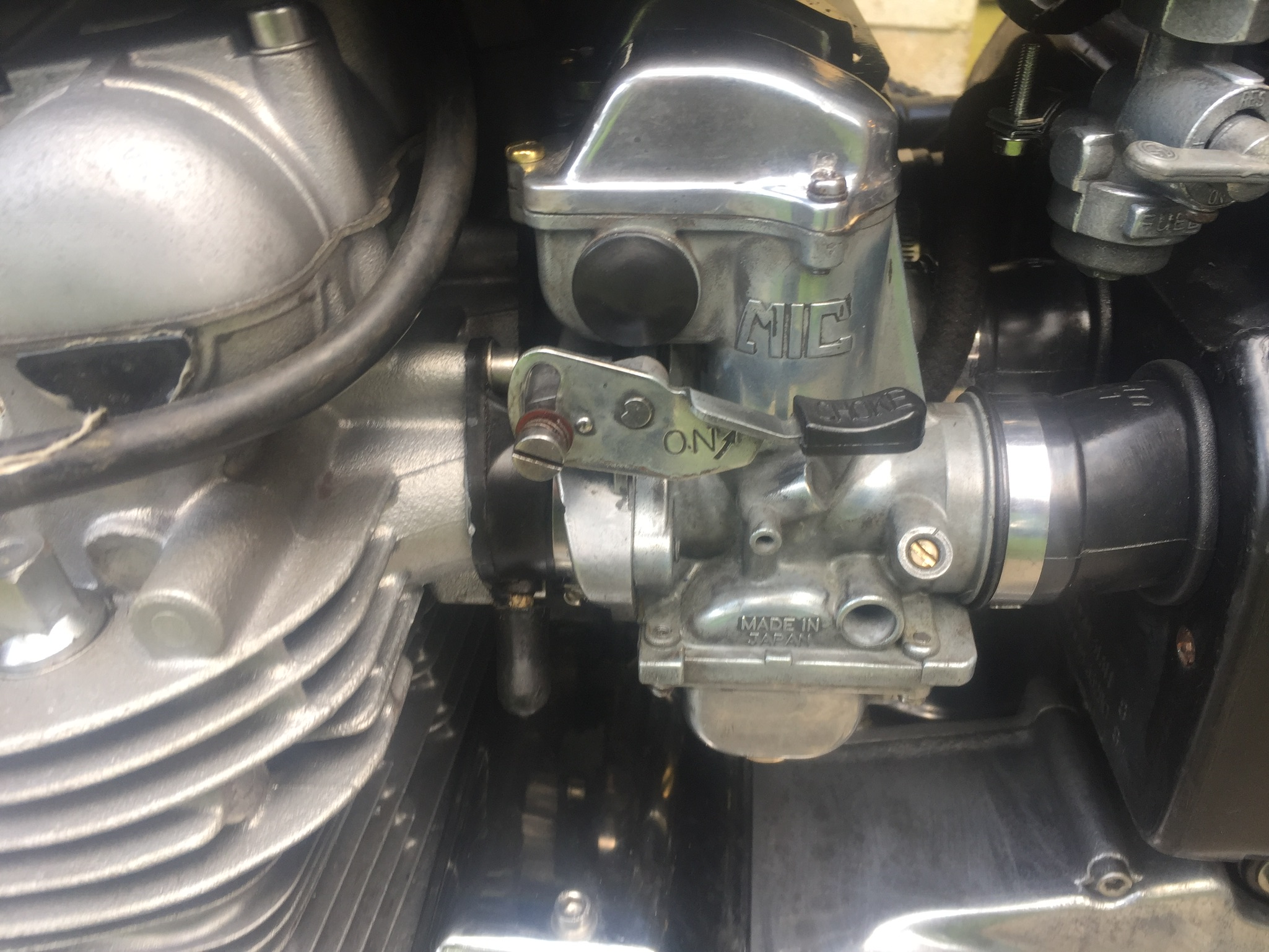

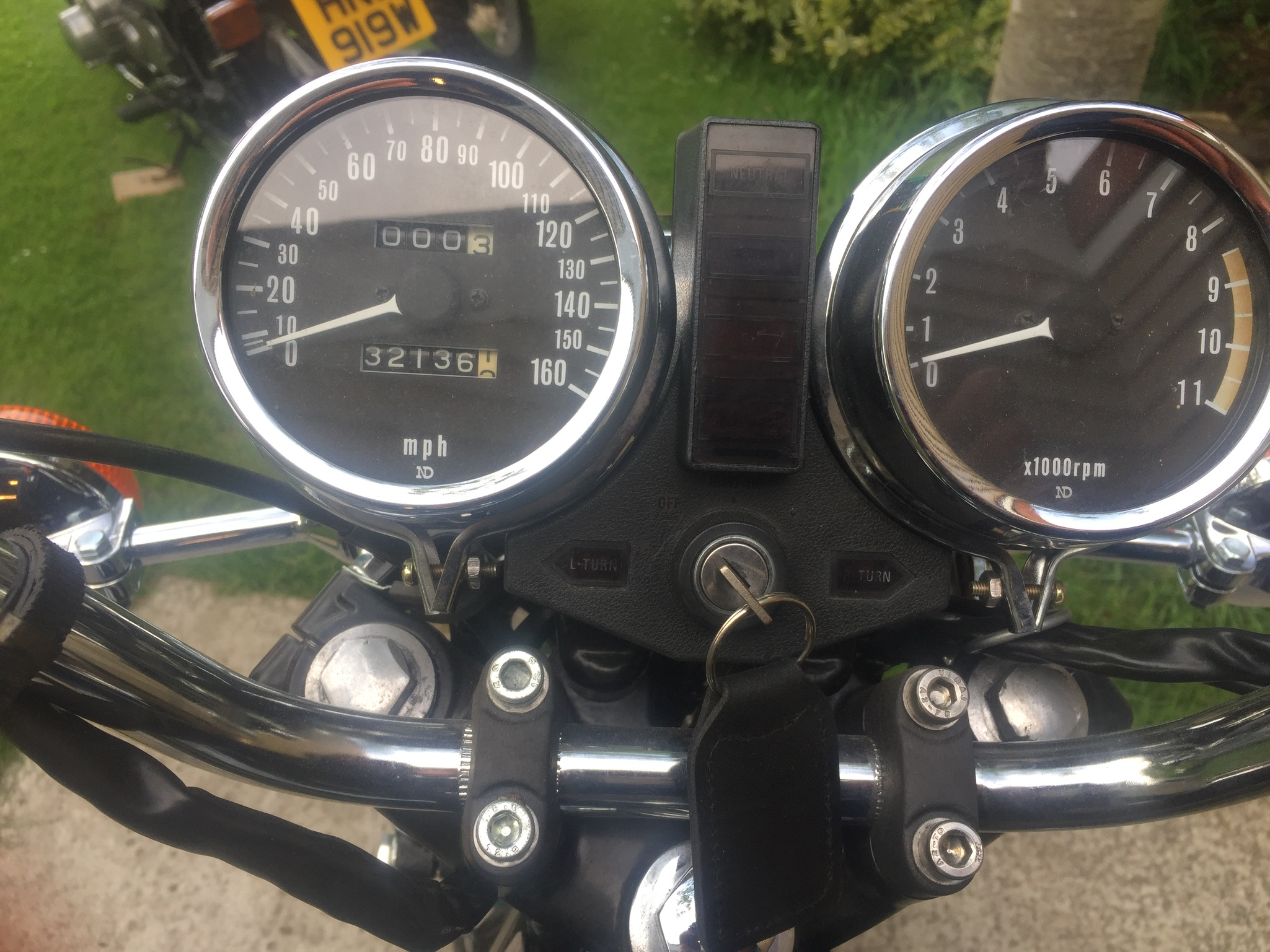

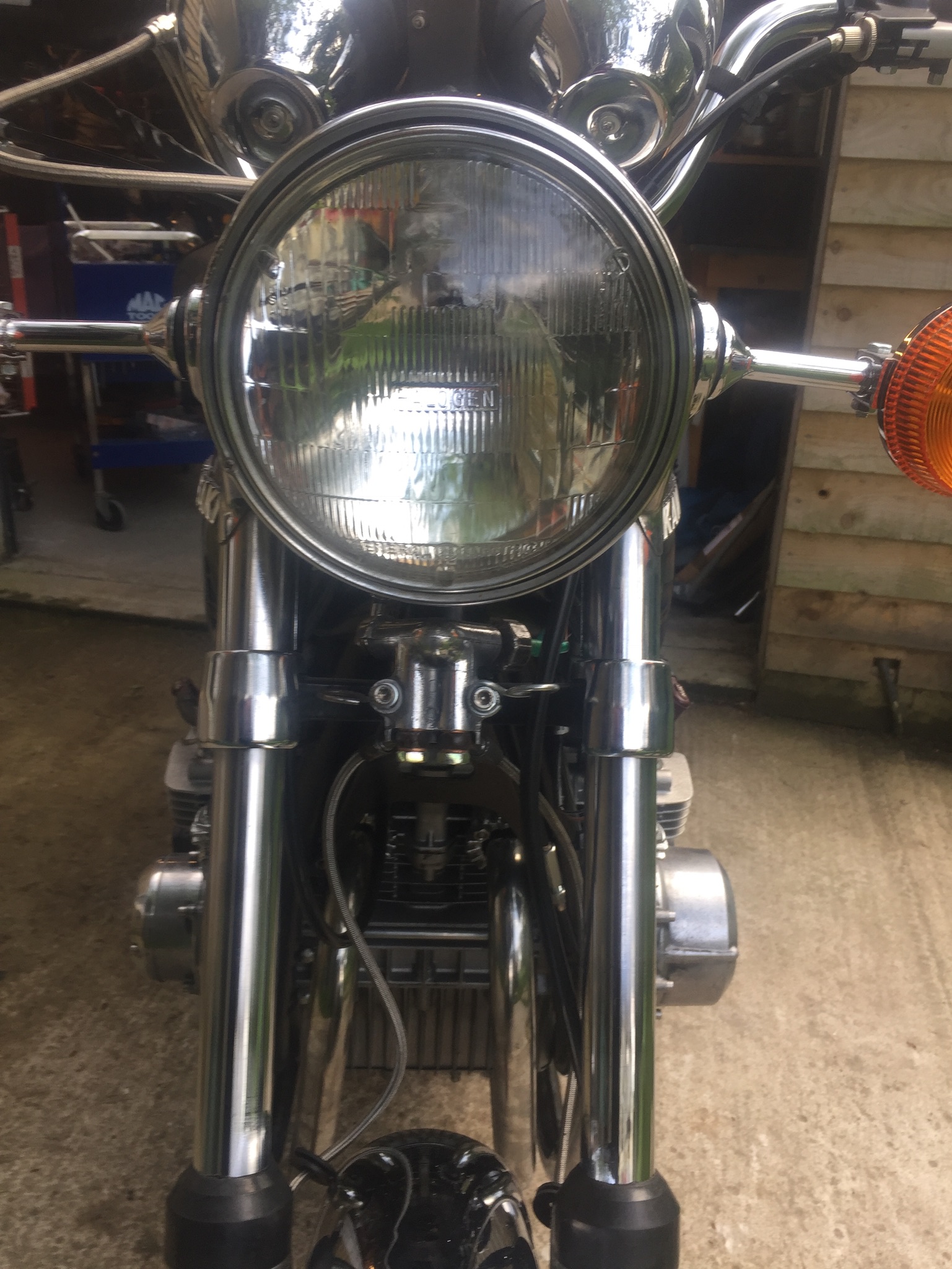

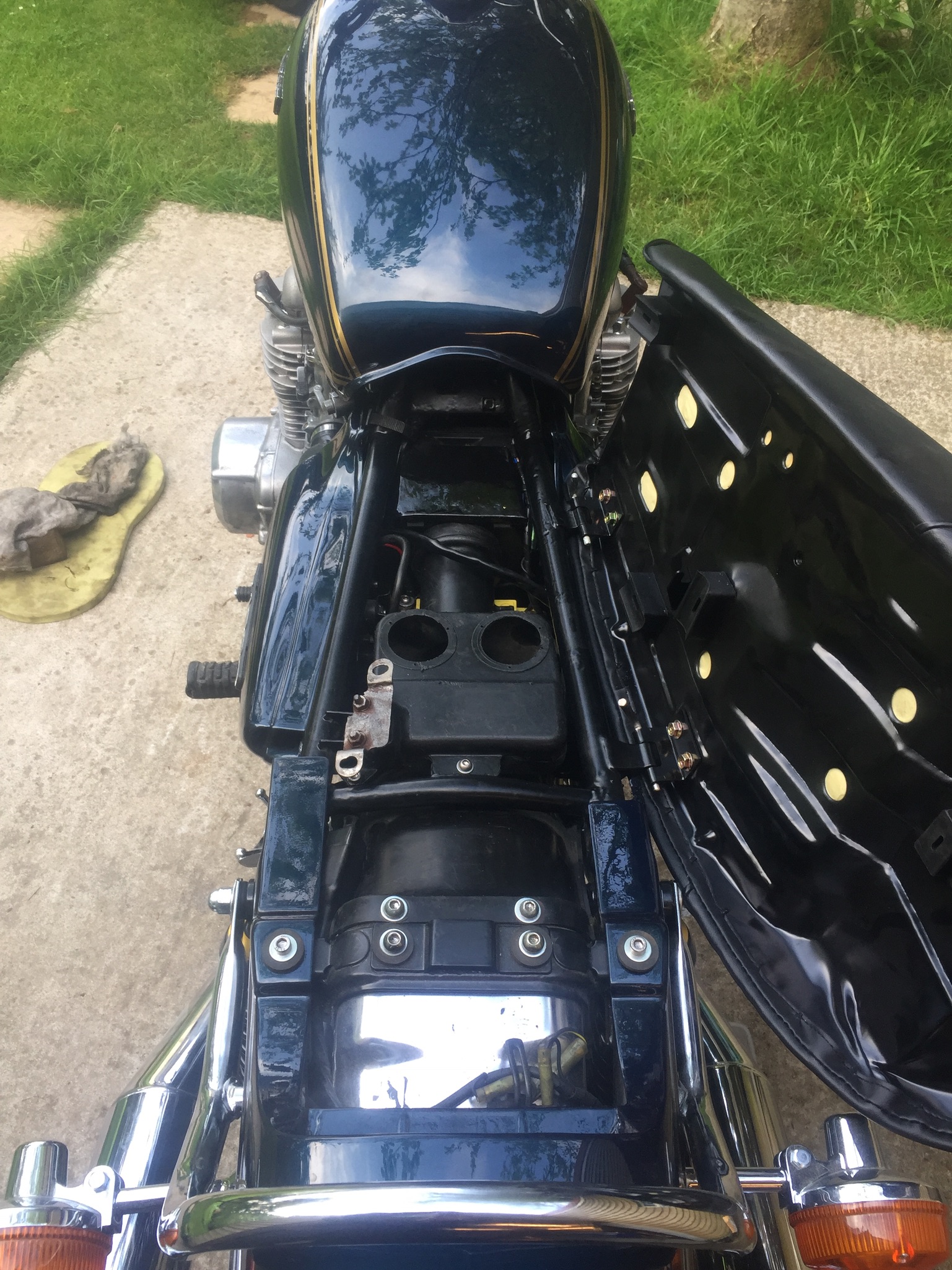

Full day today - fitted the carbs, airbox and silencer - sorted the exhaust and de-seized the seat catch although the lock barrel itself is toast. Re-bleed the front brakes and actually had a little ride up the lane. Surprised how small the bike feels. Possibly the shocks might be a little short. She starts easily and runs sweet apart from the smoking left bank which is coming from number two cylinder. Pretty sure that I messed up on a valve stem seal as all the bores were really nice and number 2 cylinder gave me 150 psi on a comp test.
Anyway - pretty much finished - have some pics
I got to do something with the seat latch but I have really run out of steam now - whats the going rate an a Tax and MOT exempt UK Z1000A1?

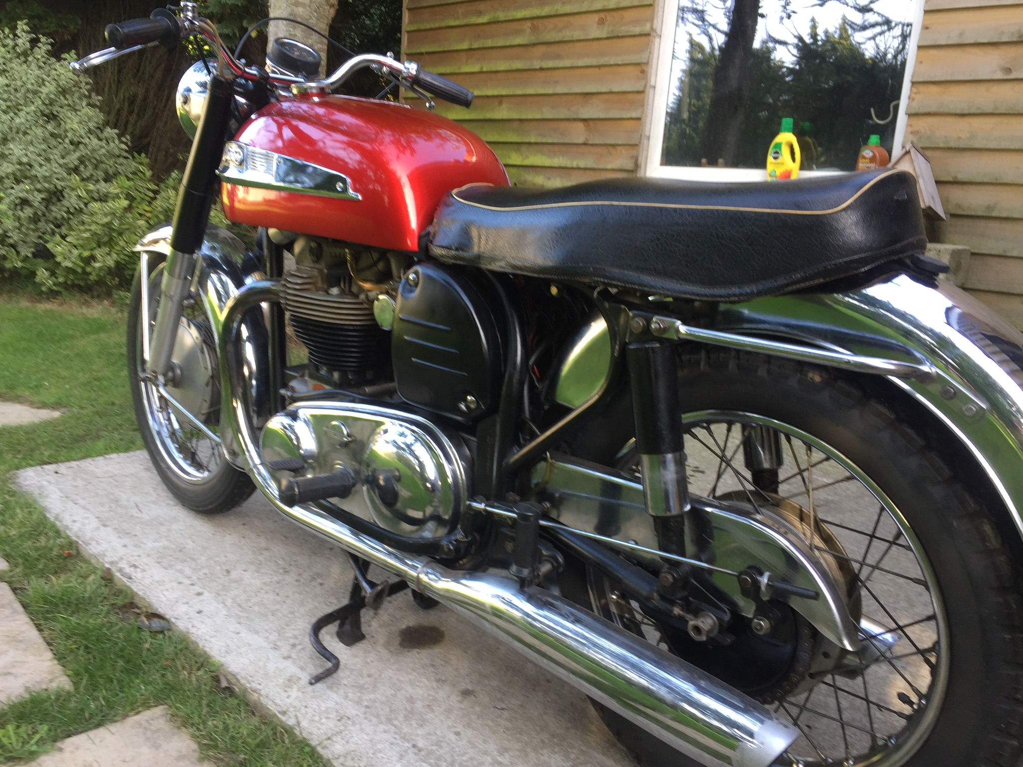

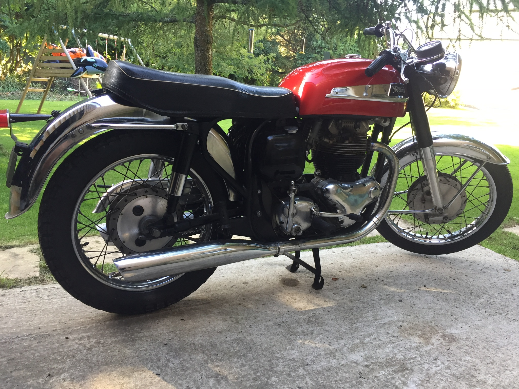

So now I am officially Ex Z'edded. having just done a deal for this
