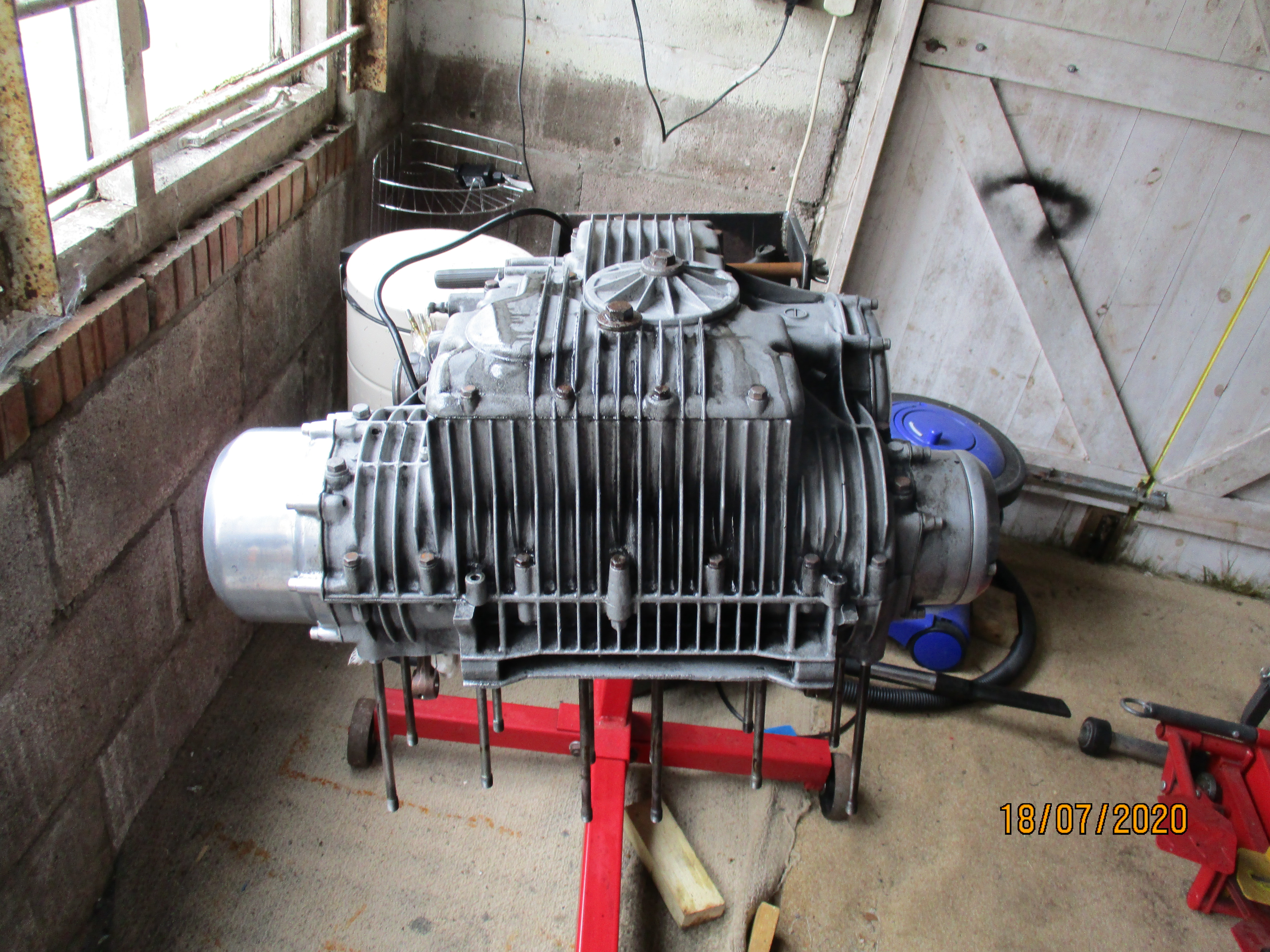

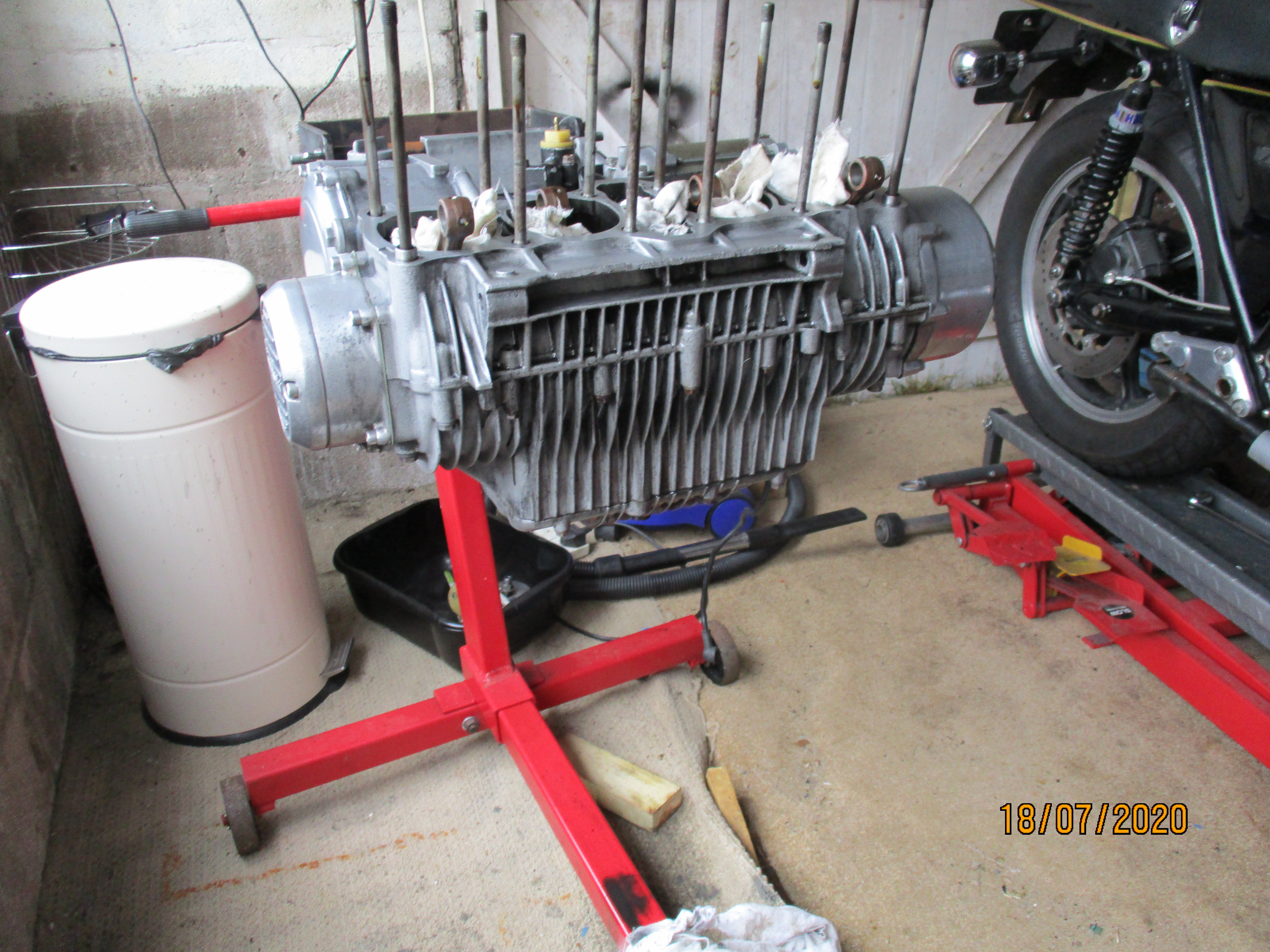

Have now started to strip off the old paint, with petrol coming off a bit to easily.
Not sure what paint to use for spraying the casings with.
Re: Z 1000 St E2
#62 PostAuthor: Philippe » Sat Jul 18, 2020 4:02 pm
Hi Dunlop4
if you want my advice: take the whole engine apart, strip all the paint of the casings, degrease them with aceton, tape them off, use a good 2 component heat resistant paint and spray them.
I use the "Restom" paint and I get very good results. Have a look at my "projects" to see how I do it.
Good luck with it.

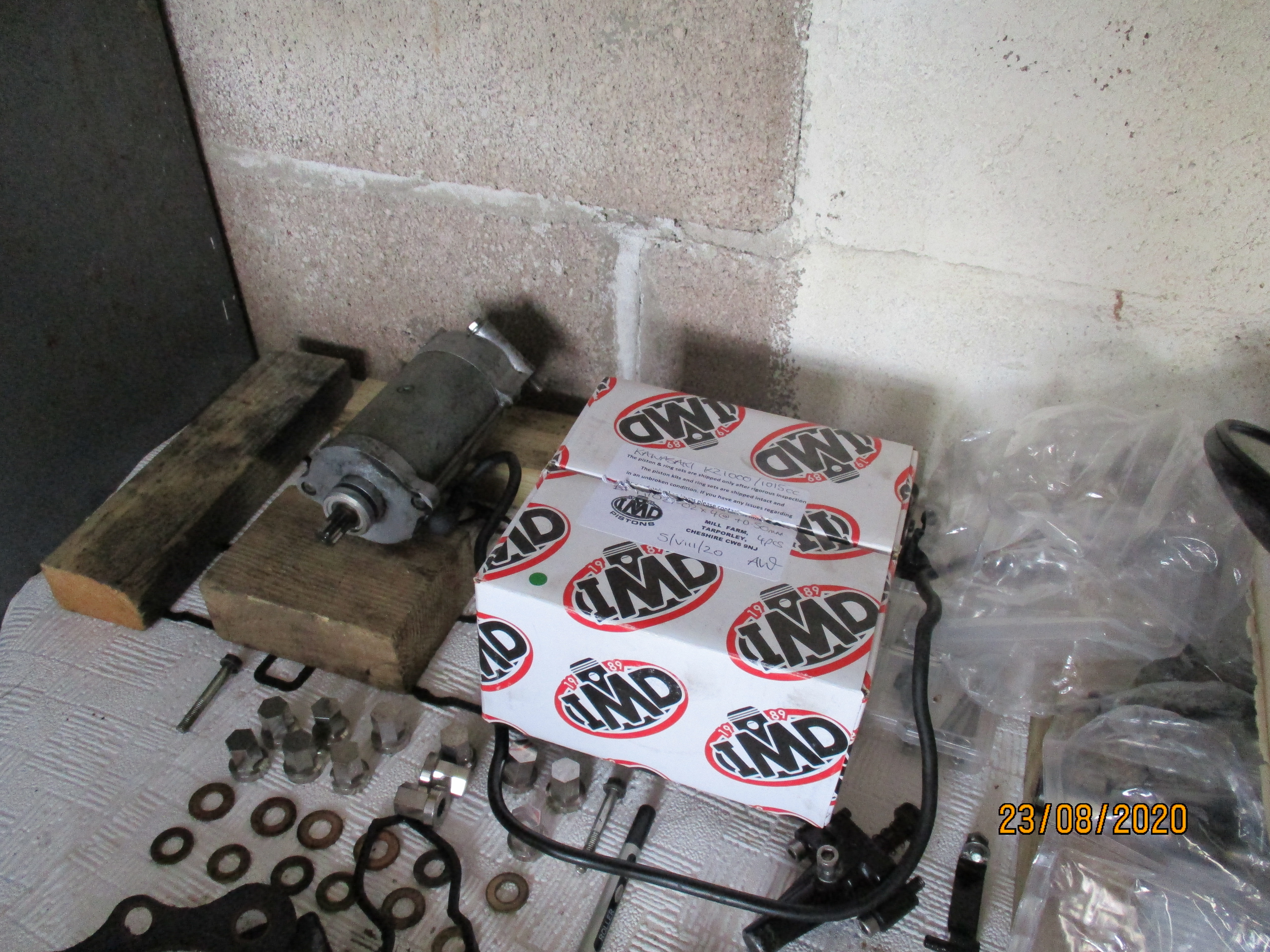

#63 PostAuthor: Dunlop4 » Sun Aug 23, 2020 4:01 pm

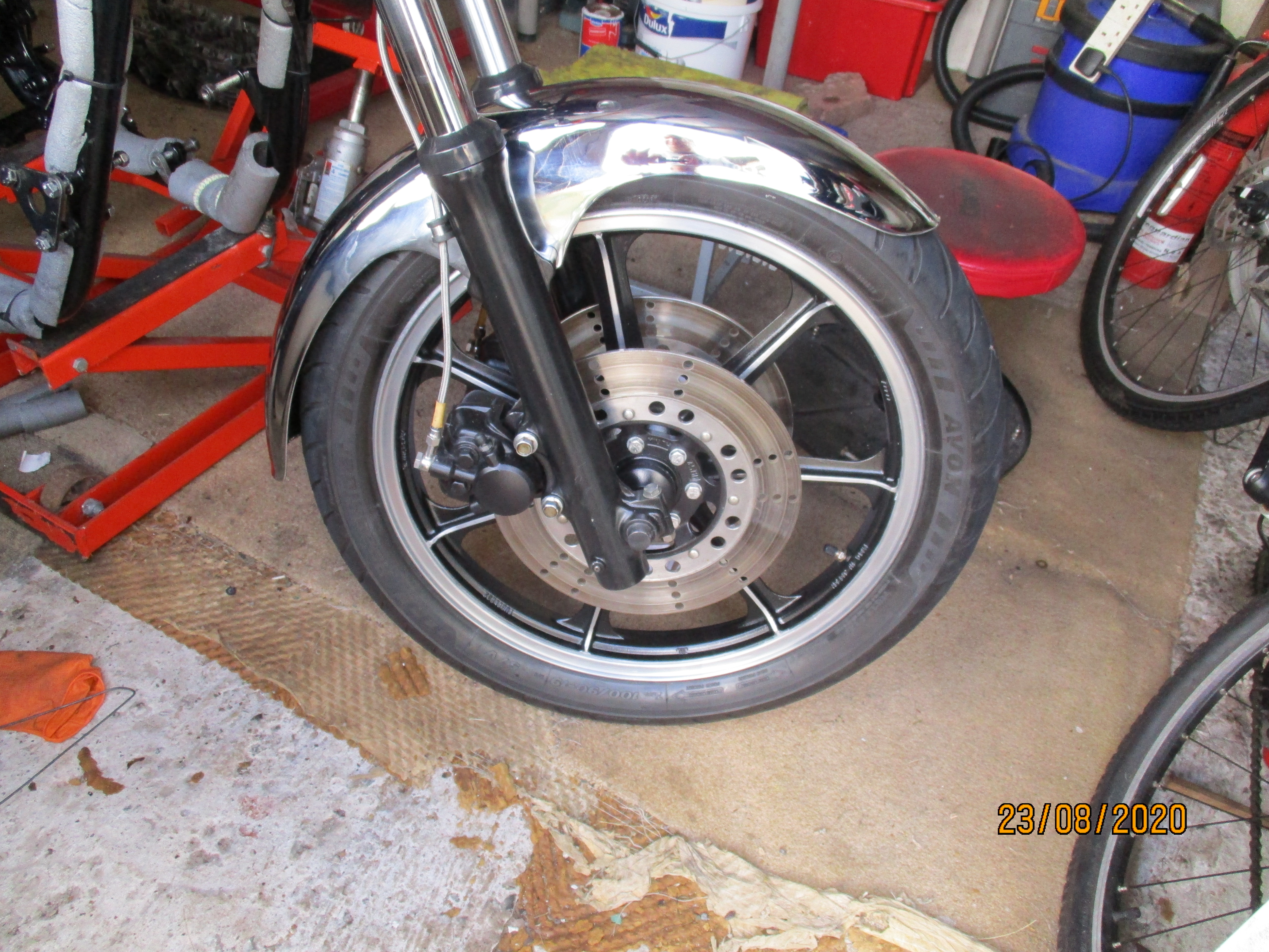

I haver decided to take the whole engine apart to have the it sprayed black. The rebore has been completed and have new pistons from IMD. The cylinder head is off being welding repair at the rev counter drive and barrels are having damaged fins repaired.
In the mean time i have repainted the lower fork legs, wheel, and brake calipers.

#64 PostAuthor: Philippe » Sun Aug 23, 2020 6:32 pm
Hi
very, very well done!
You took the right decision to take the engine apart!
Try to find an ST front mudgard. It'll add up to the originality!

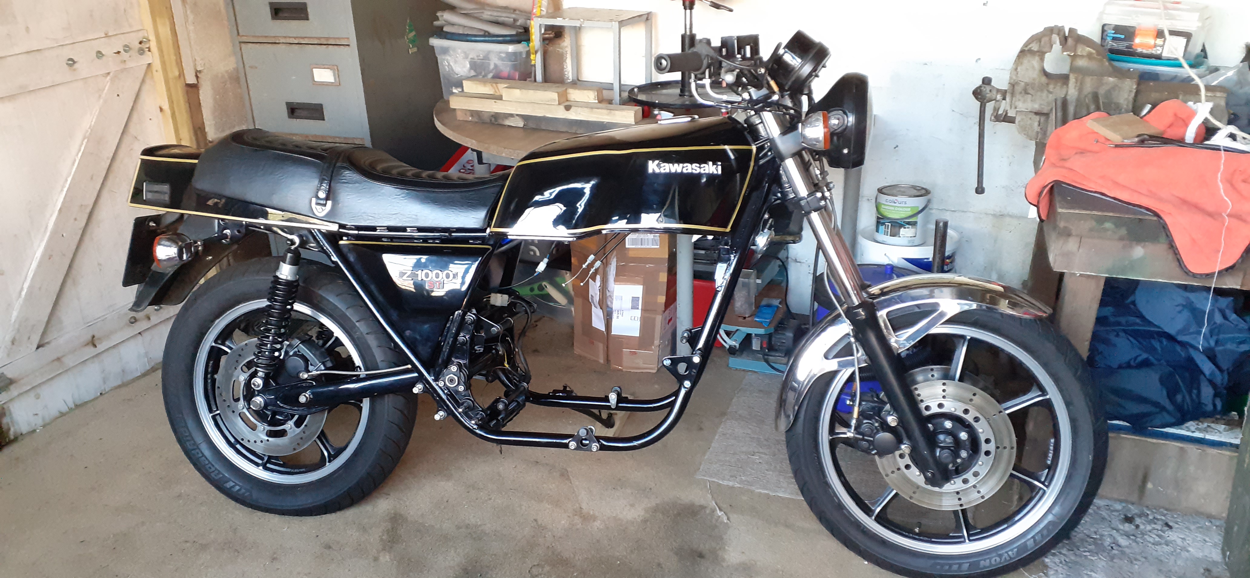

#65 PostAuthor: Dunlop4 » Sun Feb 28, 2021 2:59 pm
I have managed to source an original front mudguard and clean up various components ready for installation of engine.

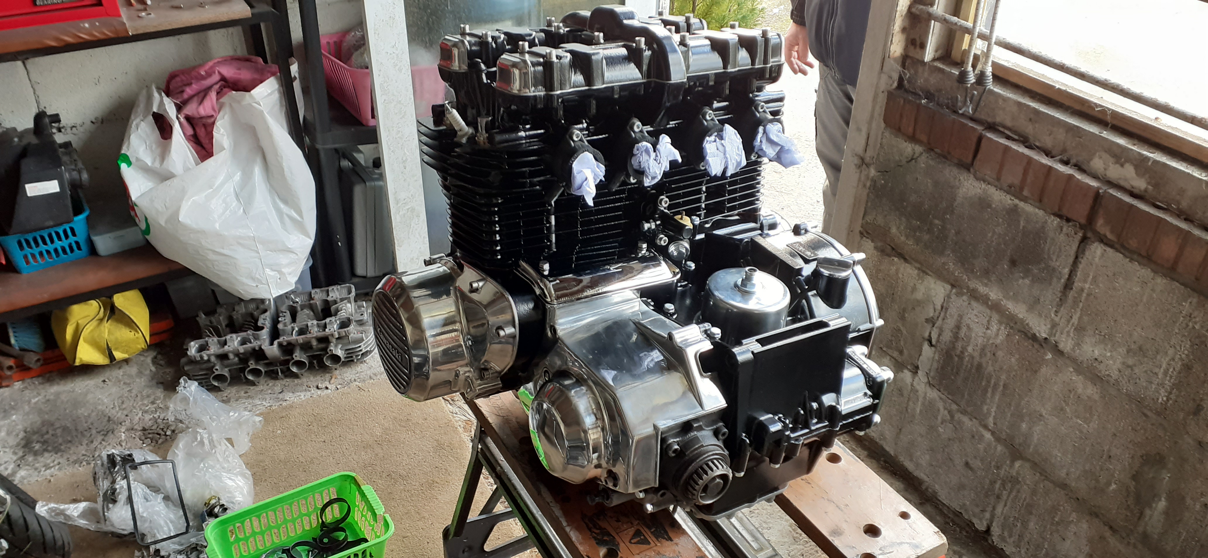

#68 PostAuthor: Dunlop4 » Sat Mar 13, 2021 10:51 am
Engine ready for installation

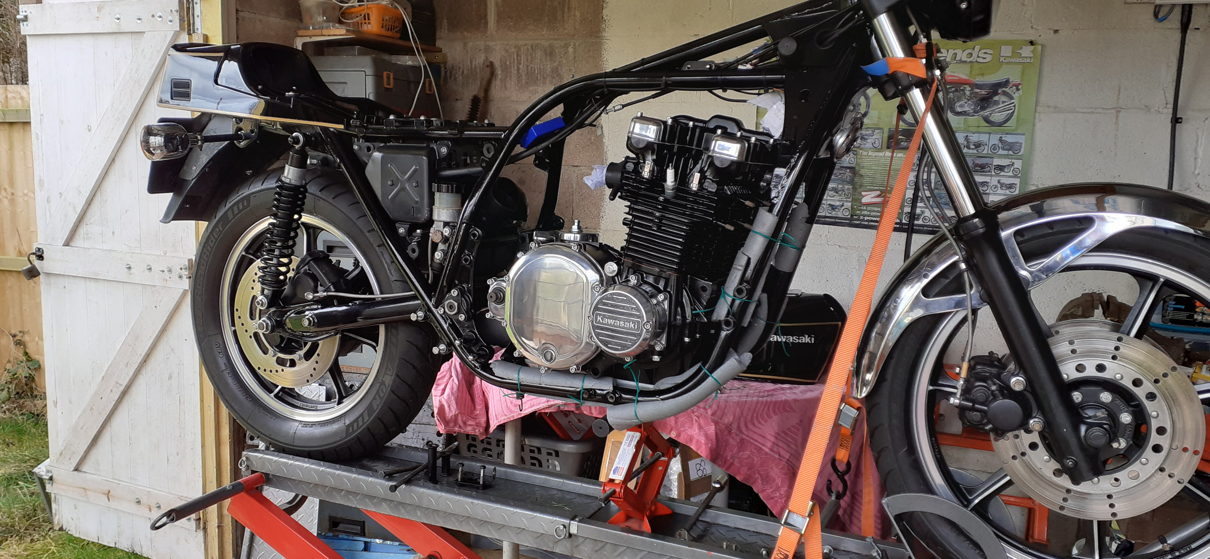

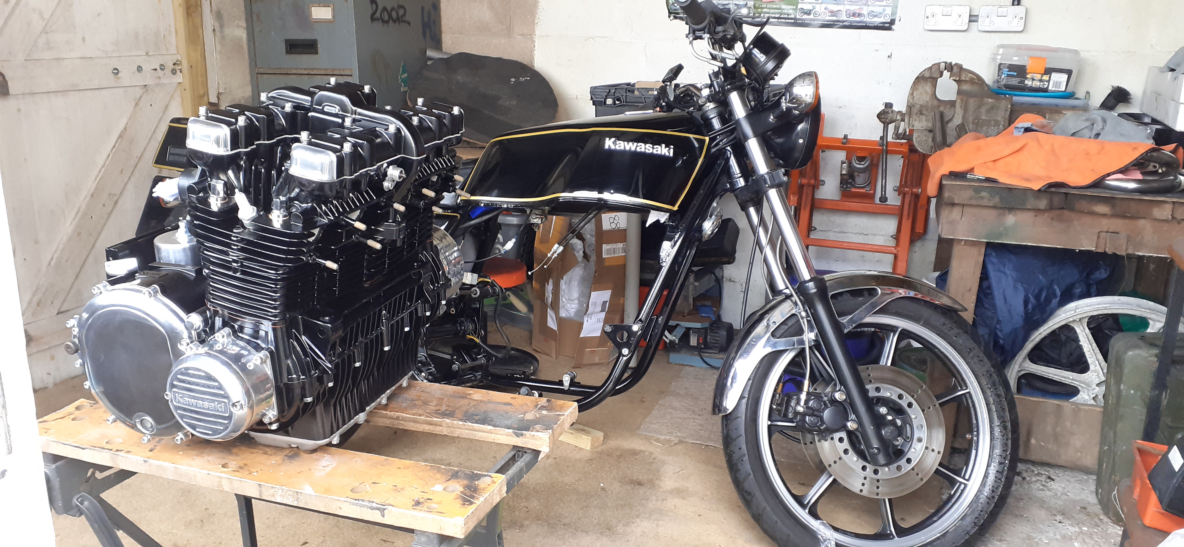

#70 PostAuthor: Dunlop4 » Sat Mar 13, 2021 1:33 pm
Another view of engine
Re: Z 1000 St E2
#71 PostAuthor: Philippe » Sun Mar 14, 2021 4:47 am
Hi Dunlop4
That looks stunning!
I hope you have someone to help you to get the engine in, it's a heavy lump of metal (more than 90 kg) !!! Mind your back!
Don't scratch the engine or the frame, put isolation foam tubes over the frame and tie them down.
Oh and one more piece of advice; remove the camshaft cover, you'll have a bit more place to get the engine in.

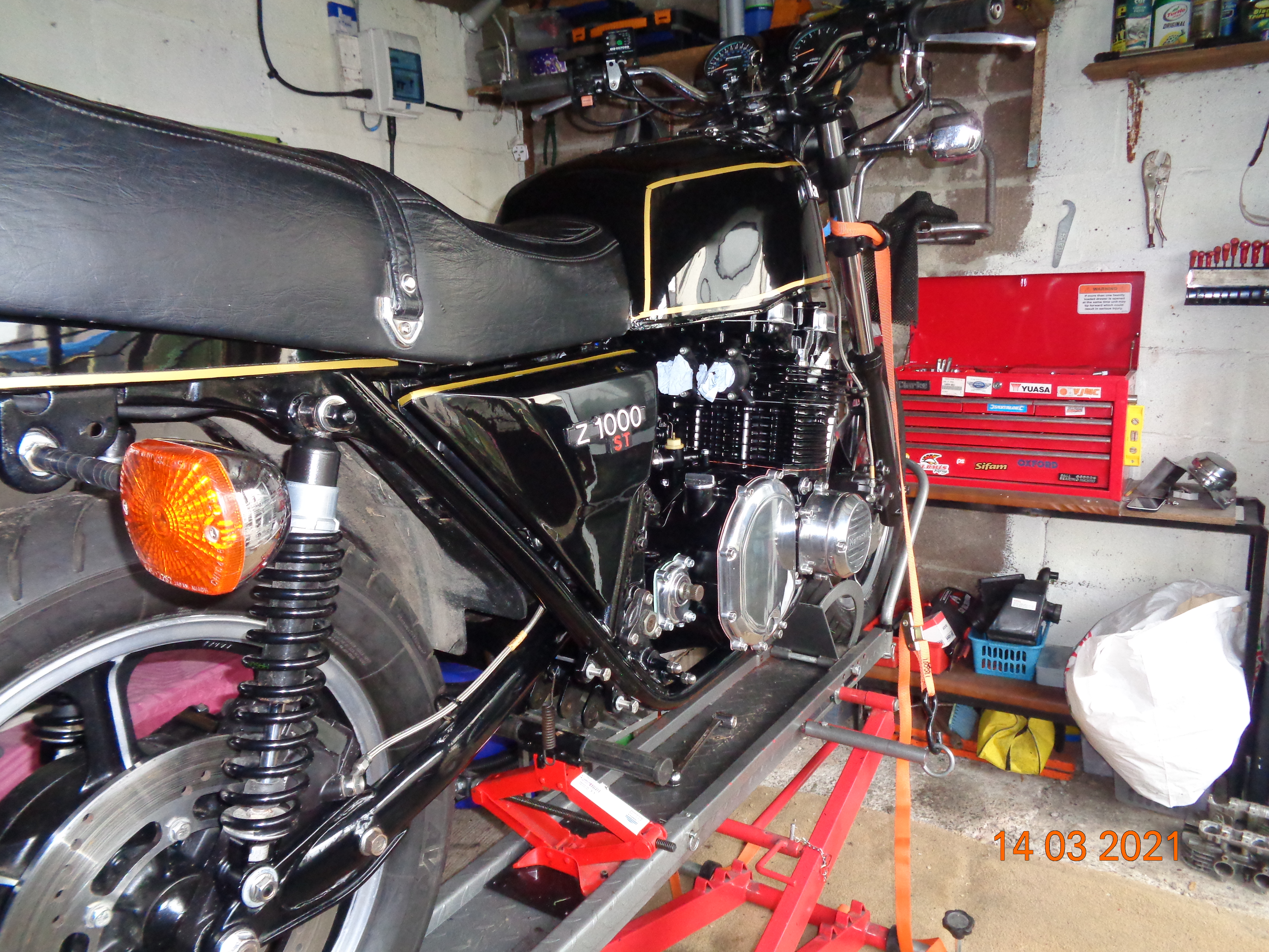

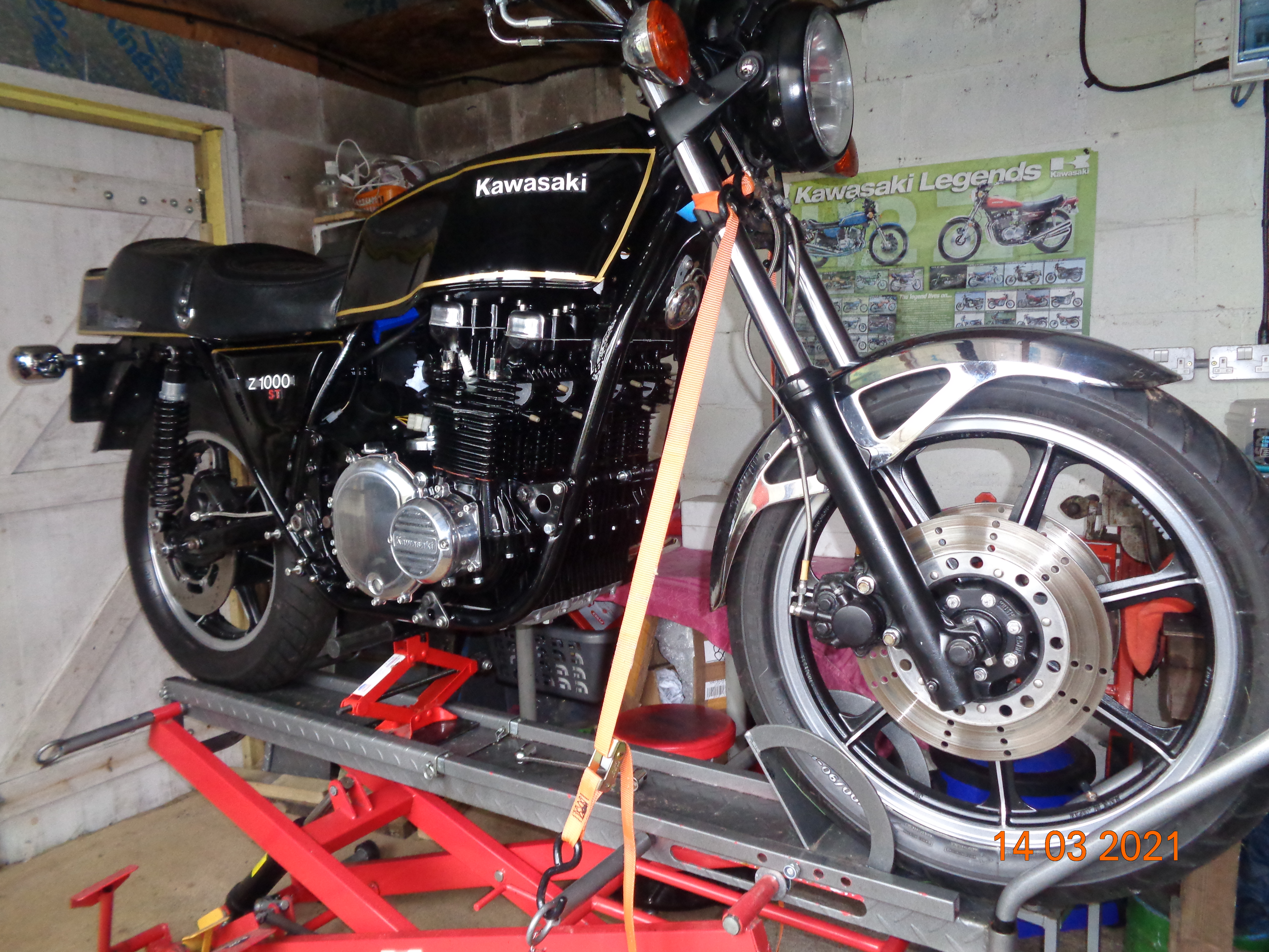

#72 PostAuthor: Dunlop4 » Sun Mar 14, 2021 12:51 pm
Hi
Yes I put pipe insulation on the frame first.
Dunlop4
Posts: 224
Joined: 17th Sep 2015
Location: Cardiff
Re: Z 1000 St E2

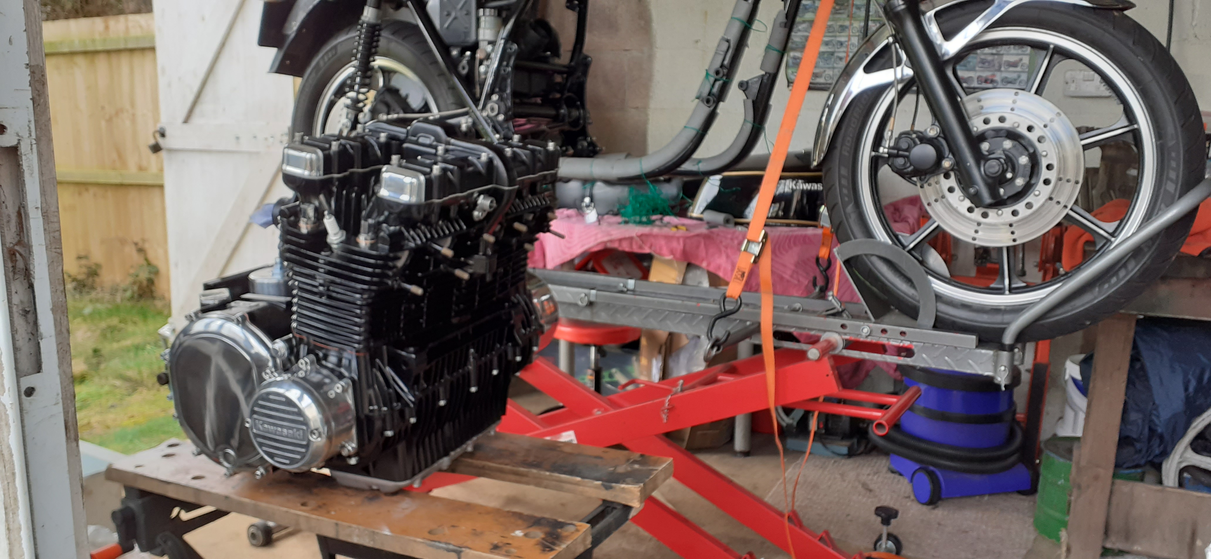

#73 PostAuthor: Dunlop4 » Sun Mar 14, 2021 12:52 pm
Lift across into frame
Dunlop4
Posts: 224
Location: Cardiff
Re: Z 1000 St E2

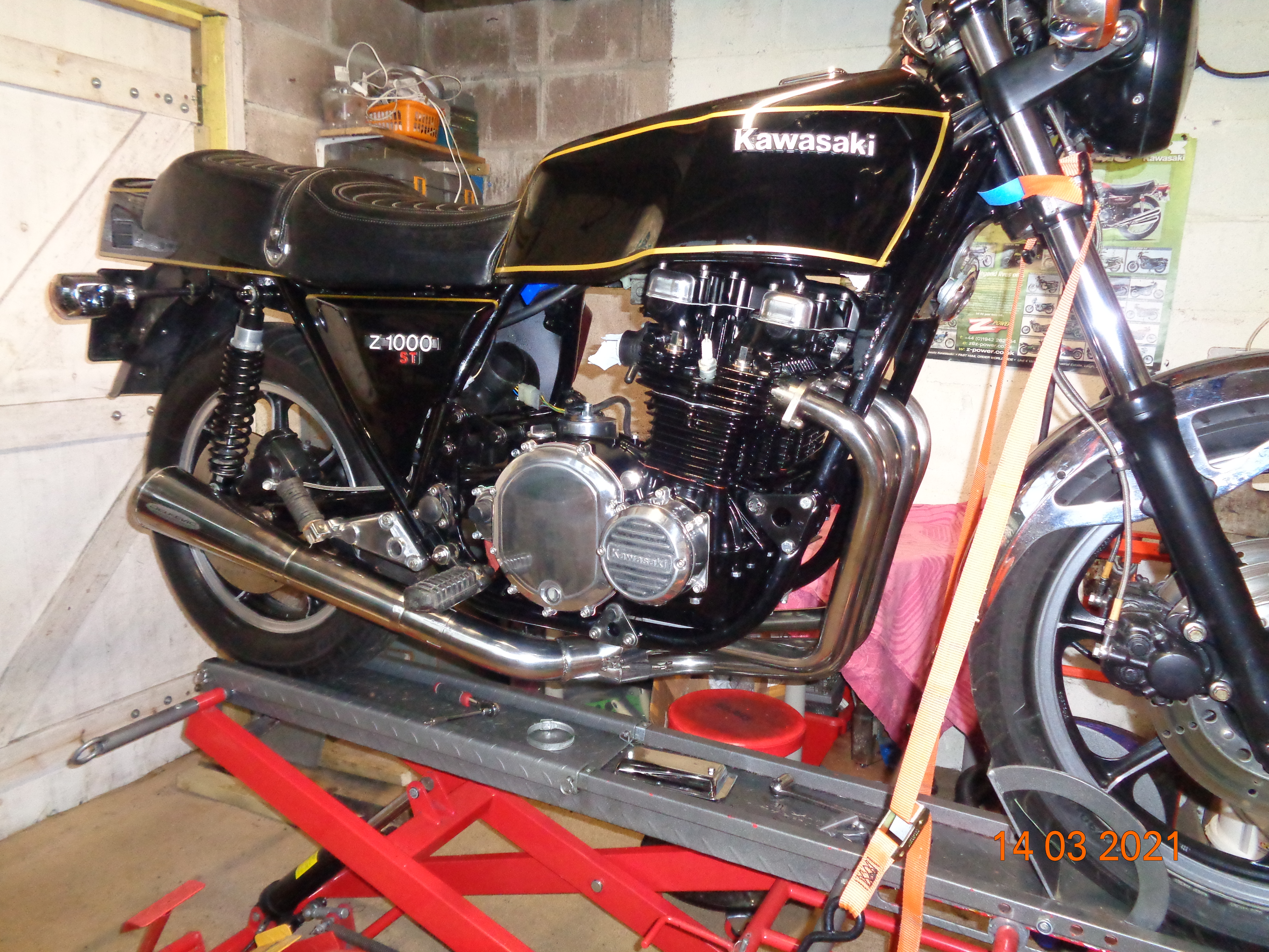

#74 PostAuthor: Dunlop4 » Sun Mar 14, 2021 12:57 pm
I have put some panels back to see how it is going to look.
From a different angle.
Dunlop4
Posts: 224
Location: Cardiff
Re: Z 1000 St E2
#75 PostAuthor: Dunlop4 » Sun Mar 14, 2021 1:59 pm

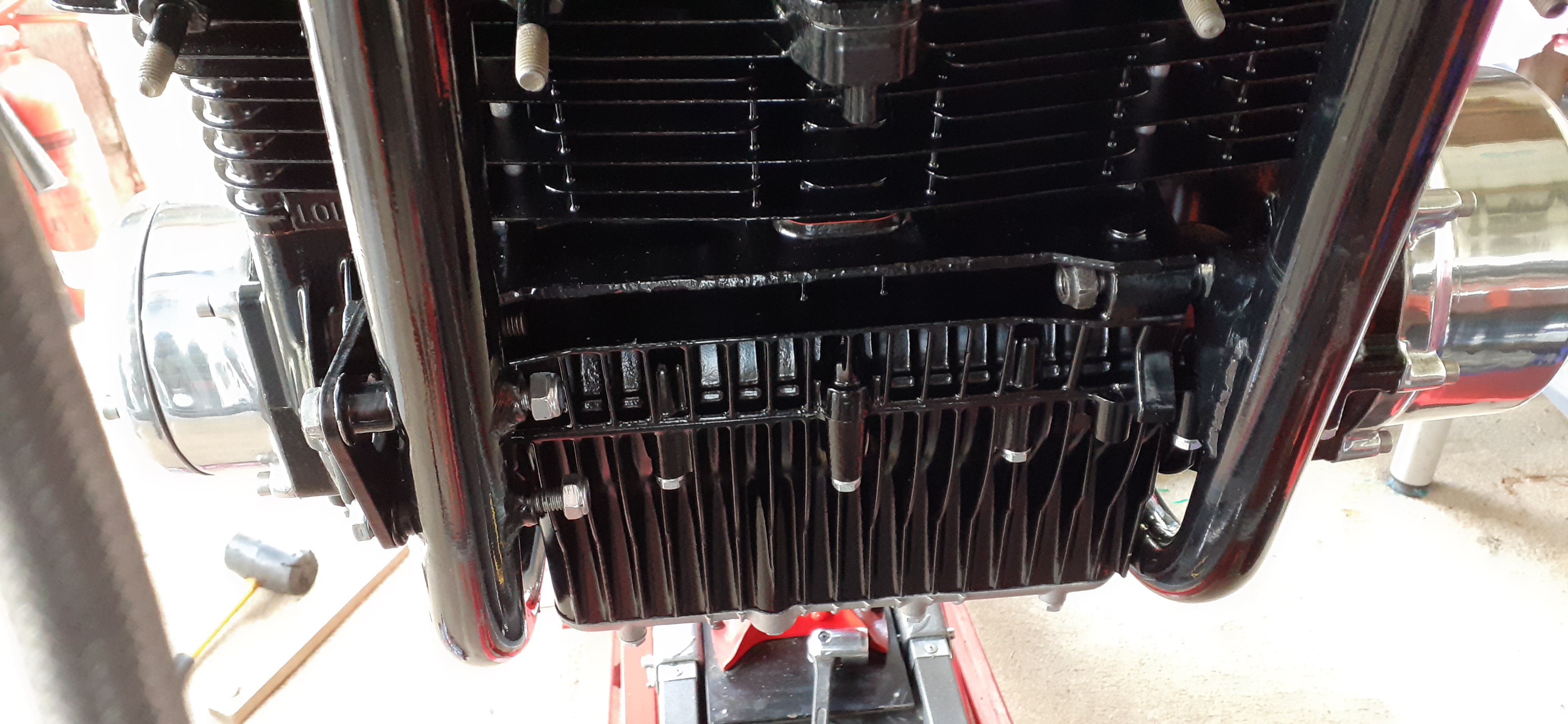

Not sure if this is right, I have got two short bolts to the front engine mounting.
The exhaust is fitted.
