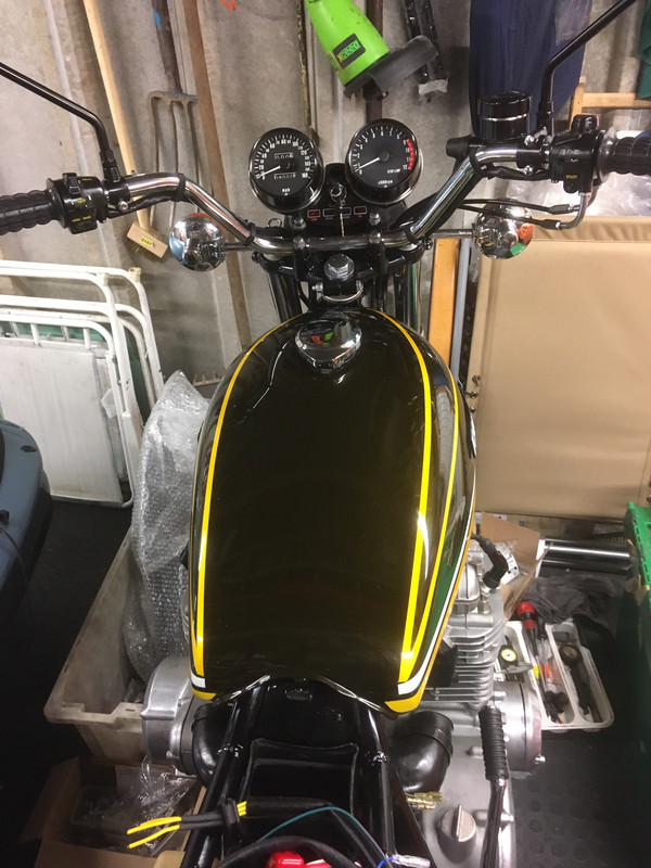

The first thing I did this weekend was make sure that my new 7" Lucas H4 RHD headlamp fitted in the old Stanley rim / adjuster ring arrangement, which it did perfectly, once I had cut a seized up retaining screw, the head of which was completely chewed up. I struggled to find a replacement screw until I remembered that I had a new and unused CB750 rim and retaining ring that I'd bought from Germany and found it wouldn't fit, I was able to borrow a screw from that. The screw holes were spaced differently on the CB750, or I might have used the whole set, my Z1A rim has a little patina, but many think that's no bad thing if its original.
I was going to try wiring up the lights and indicators, even considering pinching the battery from my CL450 so I could actually have power in the electrics for the first time. Than I learned why buying the cheapest headlamp connector block on eBay isn't necessarily a wise move, as the ceramic block fell to bits when I pulled it of the old headlamp bulb after I'd tried it. I've ordered a plastic one now, it should be more durable, and at least i didn't have it fail out on the road somewhere.
Anyway, next up I'm considering fitting the coils, horn, throttle cables etc, which will restrict the room around the cam cover. However when I come to ignition timing. starter motor testing etc, the engine is going to be turned over, and having been rebuilt an unknown time ago, it was concerning me that everything might well be bone dry in there. I'd already squirted some oil into the bores (pistons and valves are all new, looking in the plug hole with a torch), but I was concerned about the cams. deciding it was now or never, I whipped the cam cover off. As expected all was dry in there, but no rust, and the cam lobes are all in good shape.

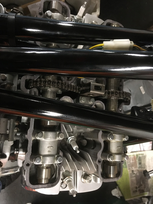

I put a smear of Redline Assembly Lube on the cam lobes, and squirted some oil around the cam bearings, although how much ever gets in the bearing is doubtful until I have oil pressure one day. At least now I'll worry less when I turn her over, I did use the kickstart to get lube all round the cams, everything moved freely, and there was compression with the plugs in.

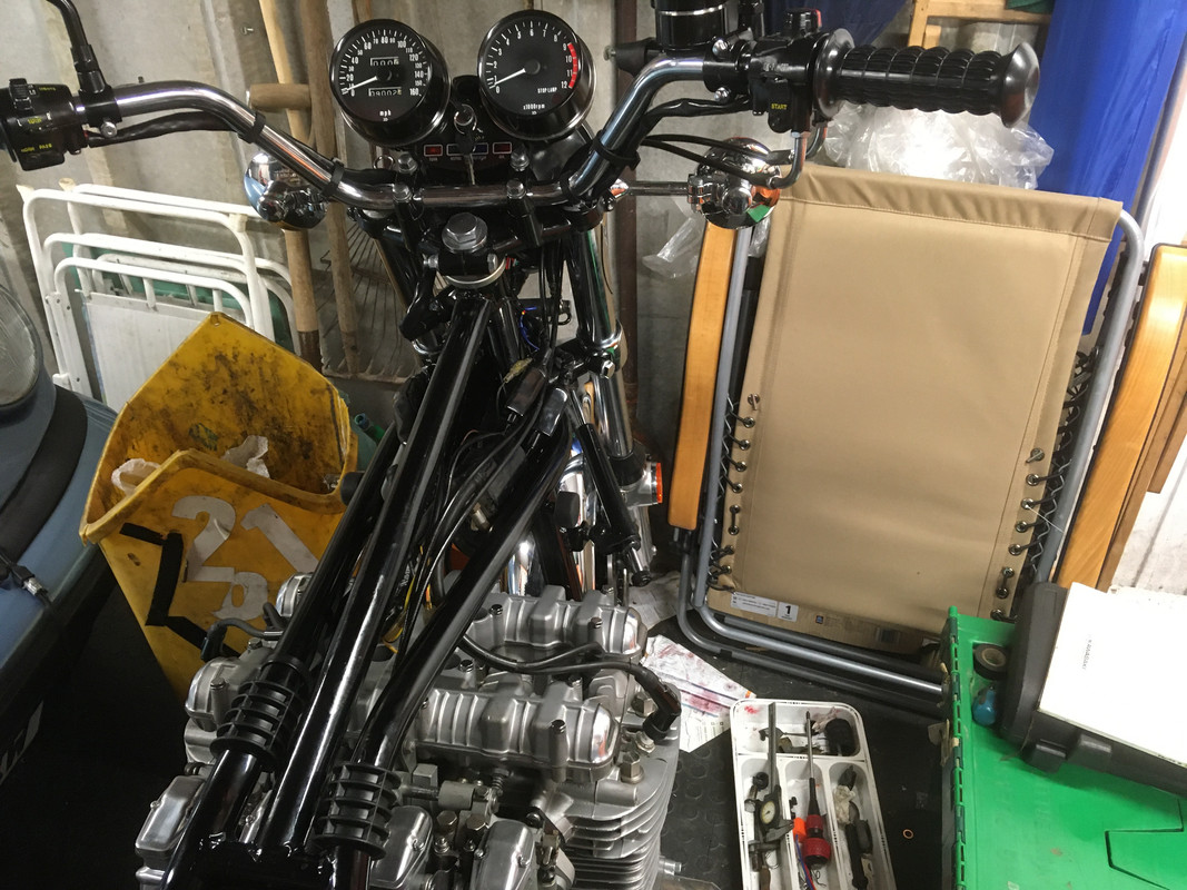

This weekend I didn't get a lot of time in the garage, but I wired up the lights, horn, coils,and HT leads with new plug caps also I fitted the throttle and speedo cables.
Now I can open the throttle i have a slight problem with #1 carb. As it comes off its stop there is a noticeable 'click'. Removing the polished top and looking down at the slide I can't see anything fouling, but its not right.Something is catching, either the opening mechanism, the slide or possibly a bent or displaced needle.I am loathe to take the carbs off again to dismantle the carb body, but I may have to if I cant fix it as it is. I may be able to ignore it, but if its not right, now is the time to sort the problem out. Any suggestions?

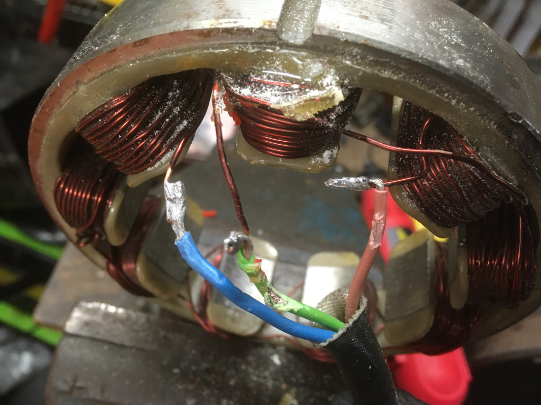

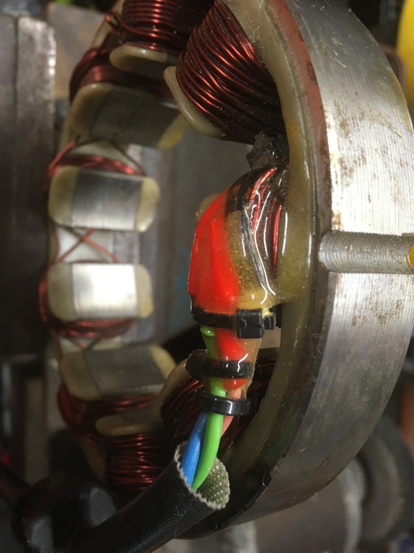

My first job this weekend was replacing the lead for the alternator coils. I failed miserably attempting to solder the little metal sleeves that came with the kit. Basically not enough room for the wire and solder inside the sleeve, and no way to get the tip of the soldering iron in there
. I have soldered the copper stator wire to the harness wire, but I'm not happy with the result, especially considering the current that will go through these joints when charging. I'm considering unsoldering, and trying a crimp on the sleeves, as the wires only just fit, the connection should be tight, and better than my soldered effort. Which crimp toll and how tight (to grip the wire firmly but not distort the sleeve too much) will be trial and error. Any of you used a crimp?

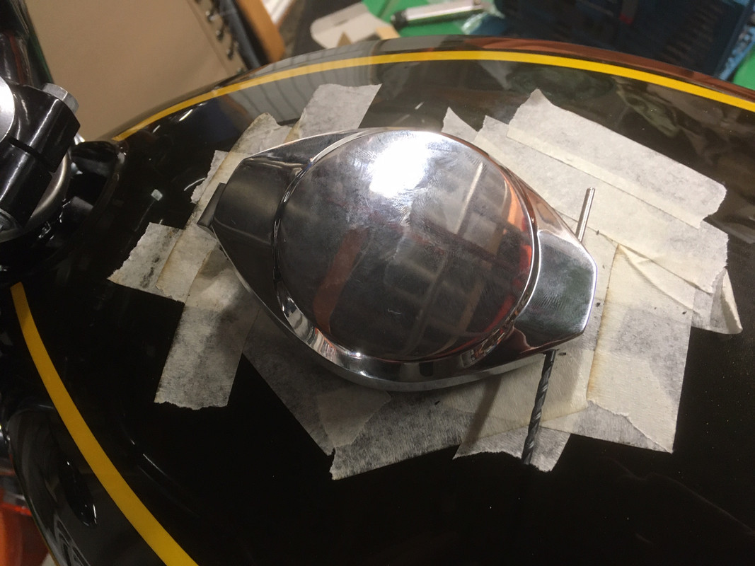

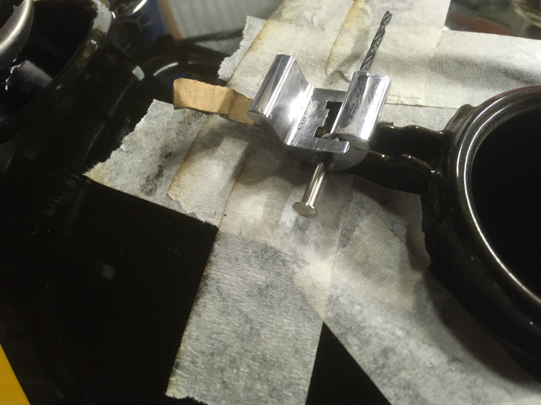

Finally, how to fit a fuel cap. I've recorded the stages for posterity, in case anyone else finds it trickier than it looks. I dug the tank out from its box in the attic, Its not been tried on the bike before, and its as stable a place as any while I fitted the new cap. Firstly I put masking tape all round the filler, using craft knives and drill bits very close to my fresh paint, what could possible go wrong
? Next I cut some paint from around the hinge mounts so the cap and latch fitted over the hinge pins, I then measured the diameter of the roll pins, and used a drill bit that size to ream the paint out of the holes they go in.
There were no instructions with the cap, so I had to work out for myself how the latch works and what goes where. Here's the parts for the latch, I found the tip for using a strip of cardboard to keep the spring in the right place on a US KZ forum, you pull it out when you've finished.
Then I assembled the latch using a smaller drill bit - before I tried that there was near disaster when the spring flew away into the crowded garage, after a long hunt I luckily found it, in completely the opposite direction from where I thought I'd heard it land. Once I had the parts in place the drill bit was drifted out with the pin....
Once the latch was in place and working properly, it was pretty much the same process with the cap hinge...
The finished result:

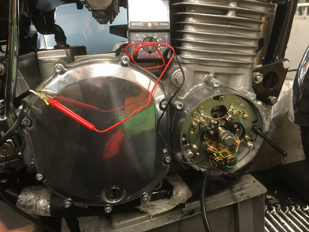

Just a quick update. I rebuilt #1 carb, using a new (and rare) emulsion tube and needle. That cured the 'hanging' problem. It also gave me an opportunity to bench synch the carbs as best I could. I couldn't find a 0.7mm drill or wire, so I have all 4 carbs just releasing (from the tiny cutout at the front of the slide) a 1mm drill at the same time. Once the bike is on the road one of its first trips will be for a professional carb synch and strobe. I also took the opportunity to paint the red infill 'ON' and arrow on the choke release lever. The carbs are now back on the bike, it was much easier to fit them second time round, as I now have a tube of red rubber grease which I bought to assemble the brake calipers.
I've taken the alternator cover off, and fitted a starter drive gear and spindle which I got from DK, the original was inexplicably AWOL. I'm not happy with my soldered joints between the alternator coils and the replacement cable to the regulator. Ashley from the H***a forum is sorting me out with some spring sleeves and lead based solder to do a better job, as its a high current join I want to do it as best as I can.

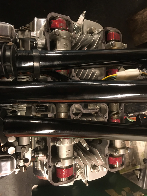

I did refit the throttle cables, all now works as it should, and also a set of genuine HT cable clips, which tidied things up no end. Also it stops sparks and shocks from the HT leads, I once had a Triumph T110 that was a beggar for electrocuting my knees in the wet!
Also I fitted the replacement advance retard unit I got from Dave Marsden, then finally bit the bullet and set the ignition timing. It was a pleasure to time a bike using brand new kit, usually there is at least one screw seized in place, often with a totally chewed up head, made from silver chocolate. Here I am using my multimeter, set to resistance, one probe to the points lead, the other to earth, looking for that moment where the points are just opening. You can see the timing mark on the A/R unit lined up with the pointer on the engine.
