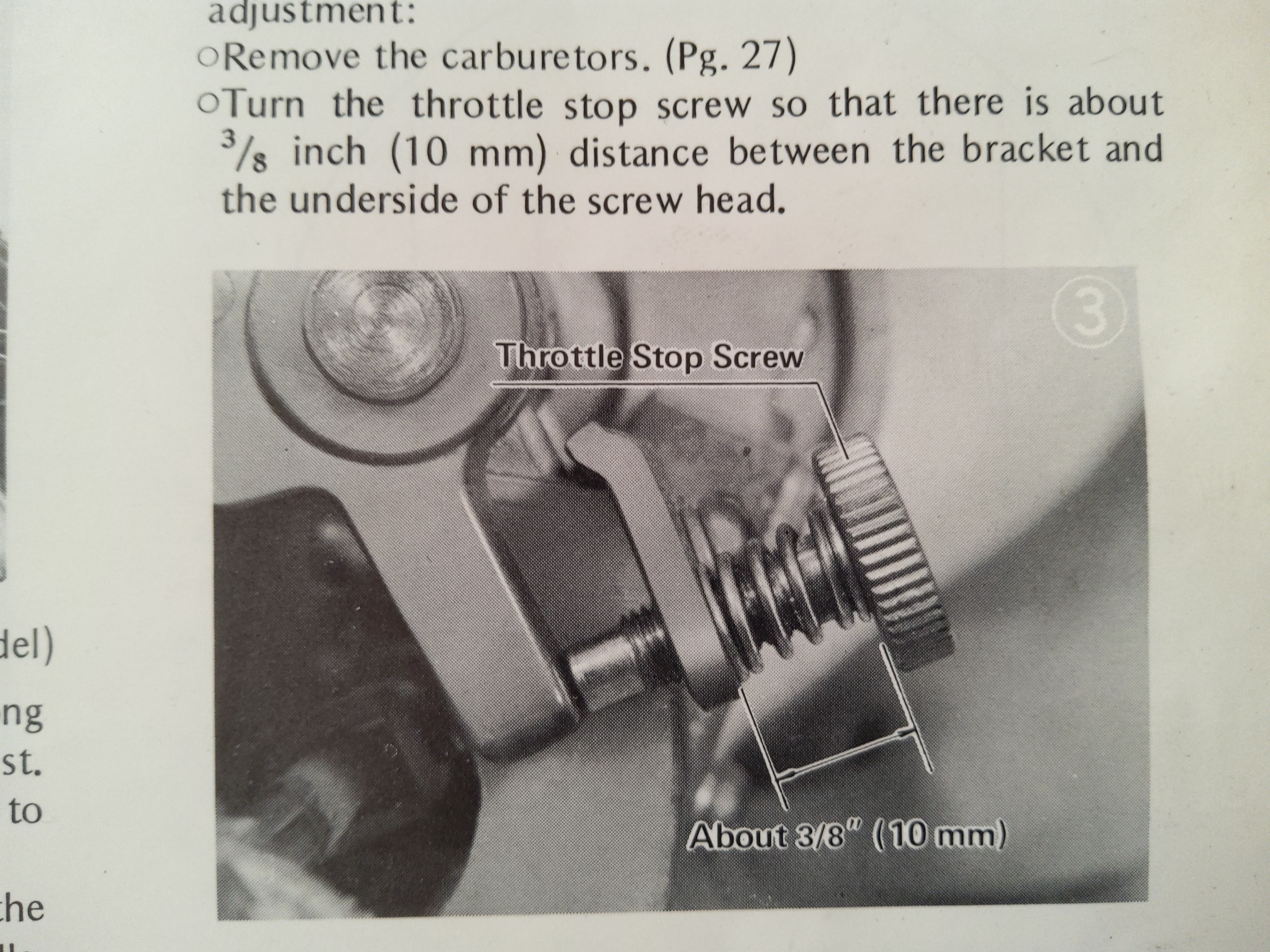

One oddity I noted which I'd be grateful for advice on is regarding the static position of the Throttle Stop Screw. Manual says there should be a 10mm gap between the screw head and bracket (see pic) but if I set it to this on mine there is a gap of about 3 or 4mil between the end of the screw and the bracket. Have I assembled something wrongly?

By throttle stop screw I assume you mean the screw to adjust the tickover revs. If this is not touching the throttle shaft and you still have revs, then 1 or more of the slides must be bottomed out and forcing the throttle shaft to open all the throttles. I would suggest removing the carbs and setting the synchronising on the bench using a .7mm or thereabouts piece of wire under each slide until they are all exactly at the right height ( after having set the throttle screw approx 10mm out).

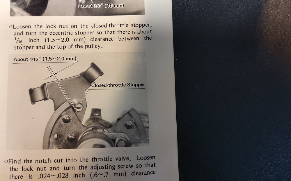

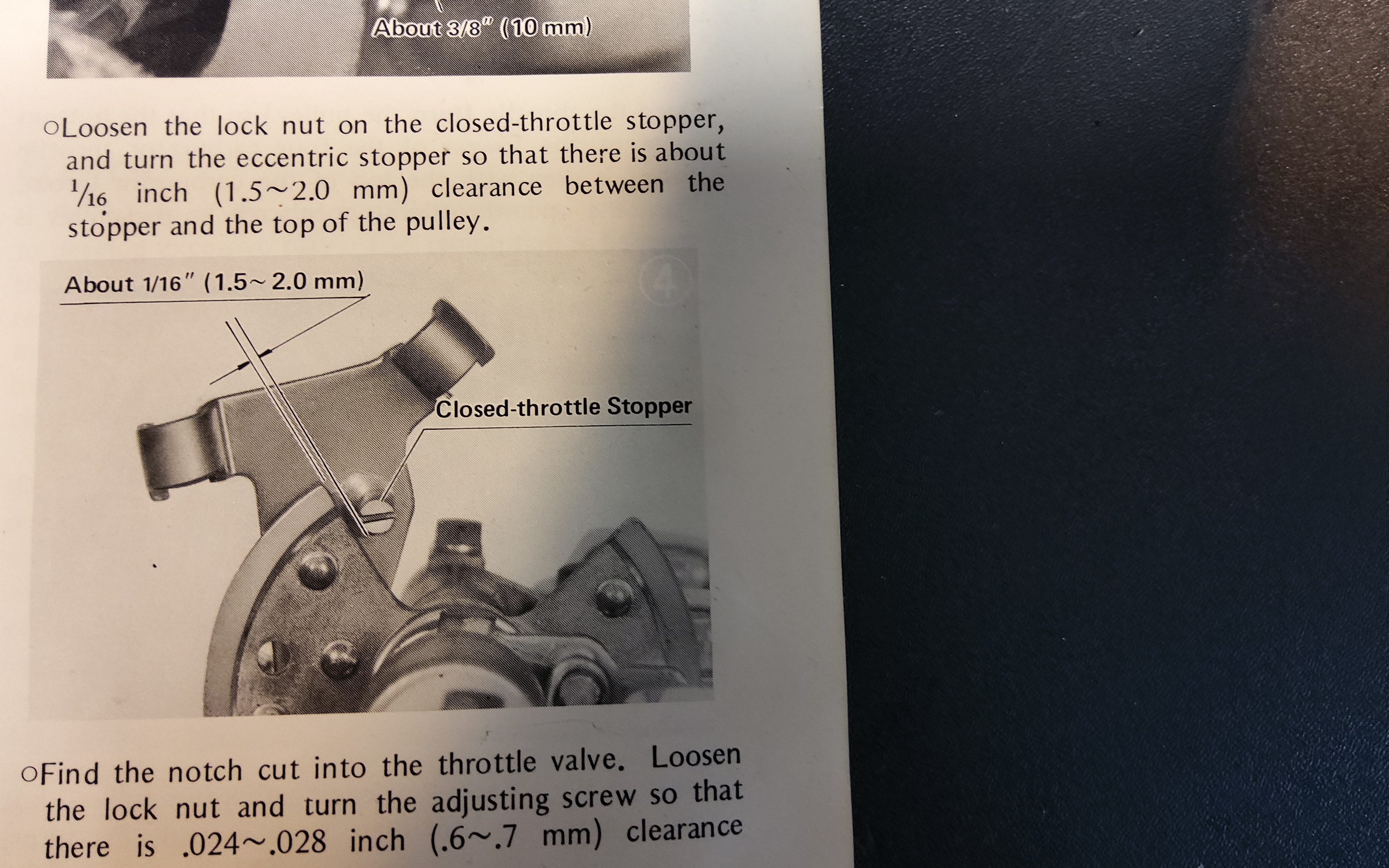

PUM 710
steve452
Posts: 636
Joined: 3rd Jun 2014
Location: Chandler's Ford
Re: Z1-B resurrection after 43 years
#67 PostAuthor: steve452 » Thu May 13, 2021 11:18 am
Many thanks for the advice. I did set up the carbs on the bench originally using a .6mm wire which was the closest I could get to the recommended spec, although I couldn't find the notch that is described in the SM.
I would hope the inlet rubbers aren't leaking as they are brand new genuine parts from Z-Power.
Looks like I'll be bench setting them yet again (5th time!).
Z1-B, 360bhp ZX1000NGF
#68 PostAuthor: Philippe » Thu May 13, 2021 12:52 pm
Hi Steve
practice makes perfect !
Try to attach a weight on the wire you're using.
The notch in the slide is very tiny and sits on the engine side of the slide, at the bottom.
When performing a static synchronisation, loosen all the adjuster screws of the 4 slides, put the idle screw as described and go for it.
When the wire is in the notch of the slide, hang the carb you're working on, over the edge of the workbench and slowly adjust the slide by turning the adjuster screw in.
At the moment the gap is the thickness of the wire, the wire will fall out of the carb and then you can gently fasten the nut without moving the adjuster screw.
Do the same procedure with the other carbs.
I hope you succeed. Good luck!
steve452
Posts: 636
#69 PostAuthor: steve452 » Thu May 13, 2021 2:52 pm
Cheers Philippe. I will do this.
Mind you on first reading I thought you said hang the CARB off the bench on the wire and adjust until it falls off :D Had visions of the carb bouncing across the garage floor!
#70 PostAuthor: Philippe » Thu May 13, 2021 3:46 pm
Hi Steve
I know, my English isn't that good. :down .. but giving you the advice of dropping your carbs on the floor...I would feel deeply ashamed if I had written that. :shock: Fortunately I didn't :D
All the best with synchronising your carbs !
steve452
Posts: 636
#71 PostAuthor: steve452 » Tue May 18, 2021 12:49 am

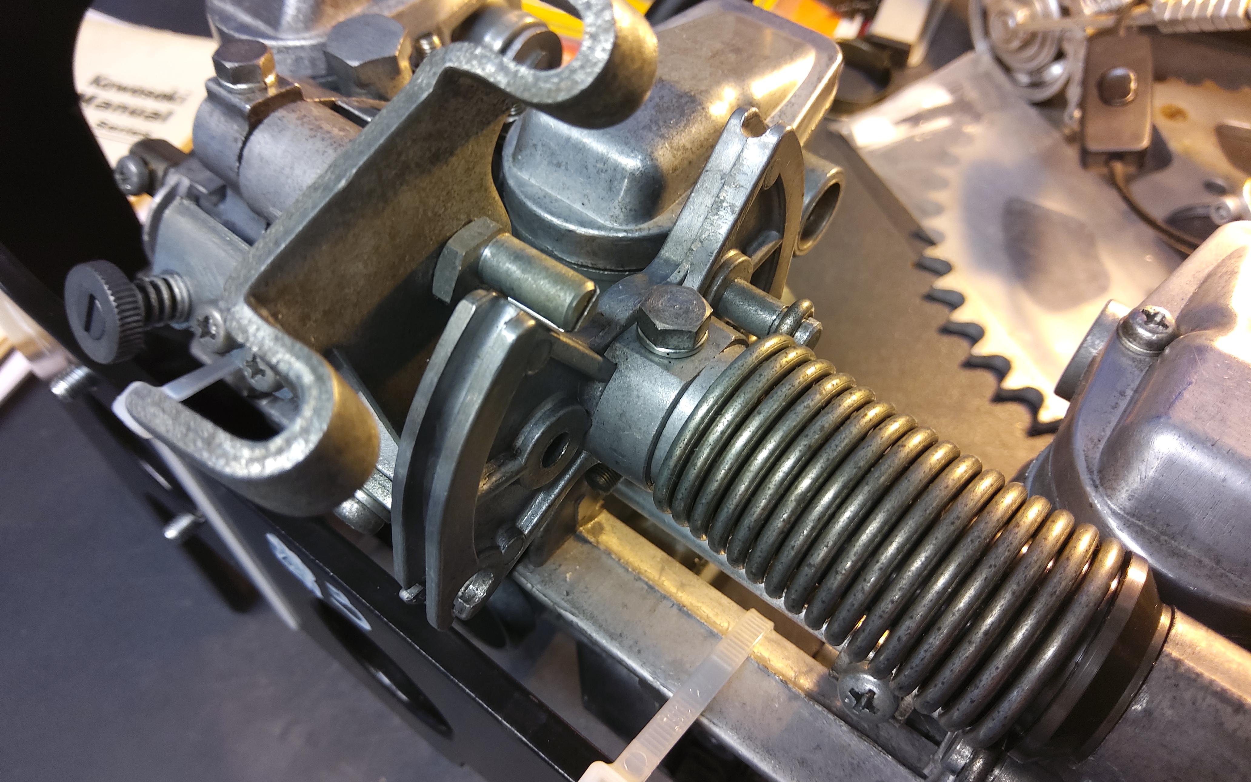

Well I couldn't find a decent enough length of wire so I used one of those ties that you twist onto freezer bags the measured about .67mm. Couldn't attach a weight as it was too short so pulled it with one hand whilst turning the adjuster screw with the other. Those notches are practically invisible but I reckon I've got about as near as I'm going to get with my 69 year-old eyesight (see pics of two of the throats after adjustment). I then hit another problem with the "closed throttle stopper" screw (see pic and SM graphic). The SM says turn the screw until you get a gap between 1.5 to 2.0mm. In fact this gap is for the earlier carbs. Mine should be 2 to 3mm as noted in the SM Supplement. The widest gap I could get was a tight .35mm. Still it is what it is and I've now got to the stage where if this doesn't work when I reinstall them tomorrow then there's going to be some scientific experimentation regarding the bounceability of 28mm carbs off a steel garage door. These carbs are doing my head in.
wheelysteve
Posts: 980
Joined: 10th Mar 2014
Location: Wokingham, Berks
#72 PostAuthor: wheelysteve » Tue May 18, 2021 8:56 am
The shaft may be twisted. You can check it, but of course this means taking them to bits again :(

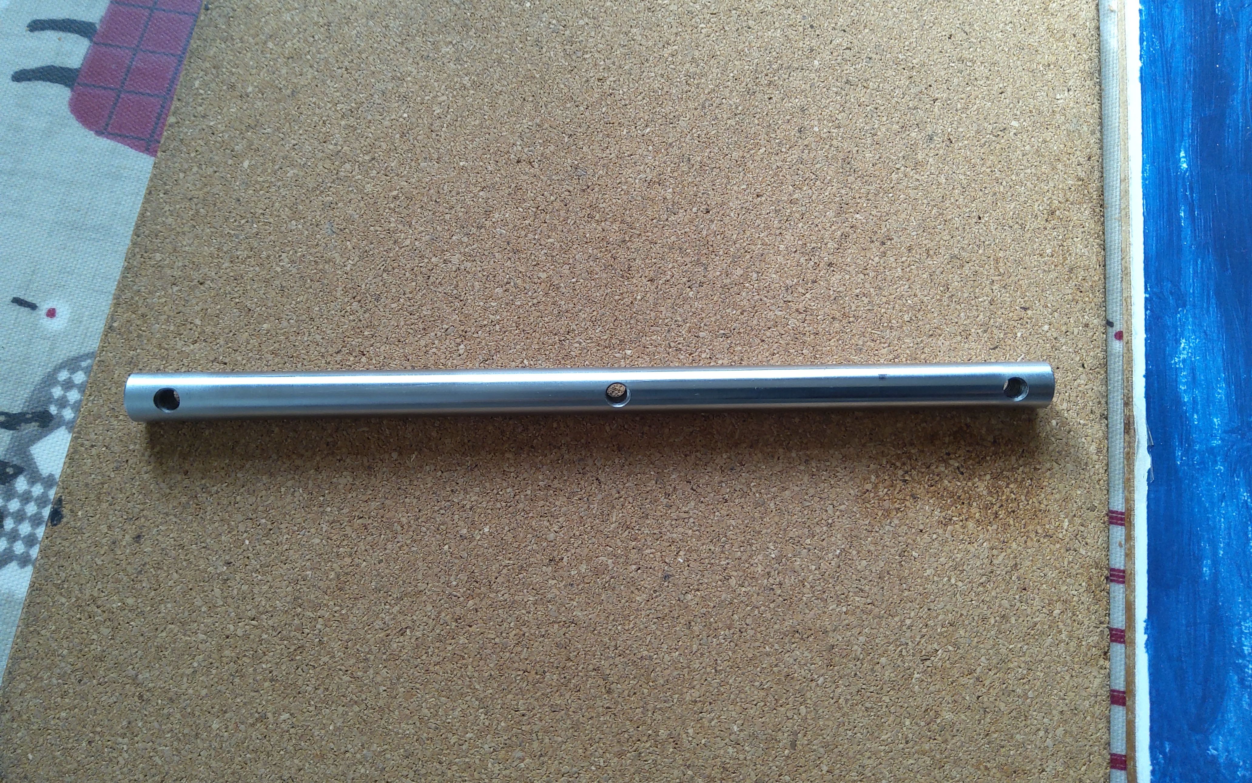

#73 PostAuthor: steve452 » Wed May 19, 2021 10:58 am
wheelysteve wrote:The shaft may be twisted. You can check it, but of course this means taking them to bits again :(
Got the shaft out without pulling too much apart. Have checked it against a straight edge and rolled on flat glass. It's definitely not bent or twisted within reasonable limits (certainly not enough to give the symptoms I had on tickover). One odd thing I noticed though was that when adjusting the closed throttle-stopper screw it requires you to adjust it up as the lowest throttle slide has just reached the top of the throat. Looking into the throats when doing this both #3 and #4 carbs are just at the top of the throat but #1 and #2 are about 2 to 3mm below the top so clearly visible by about the same amount. I've rechecked all the adjustable bits but cannot find any issues. Is it possible that the throttle slides are different lengths or are seated differently? All the carbs components bar the float bowls of #1 and #2 are from my original set (#1 and #2 float bowls are from an original 217 set which I bought for spares).
