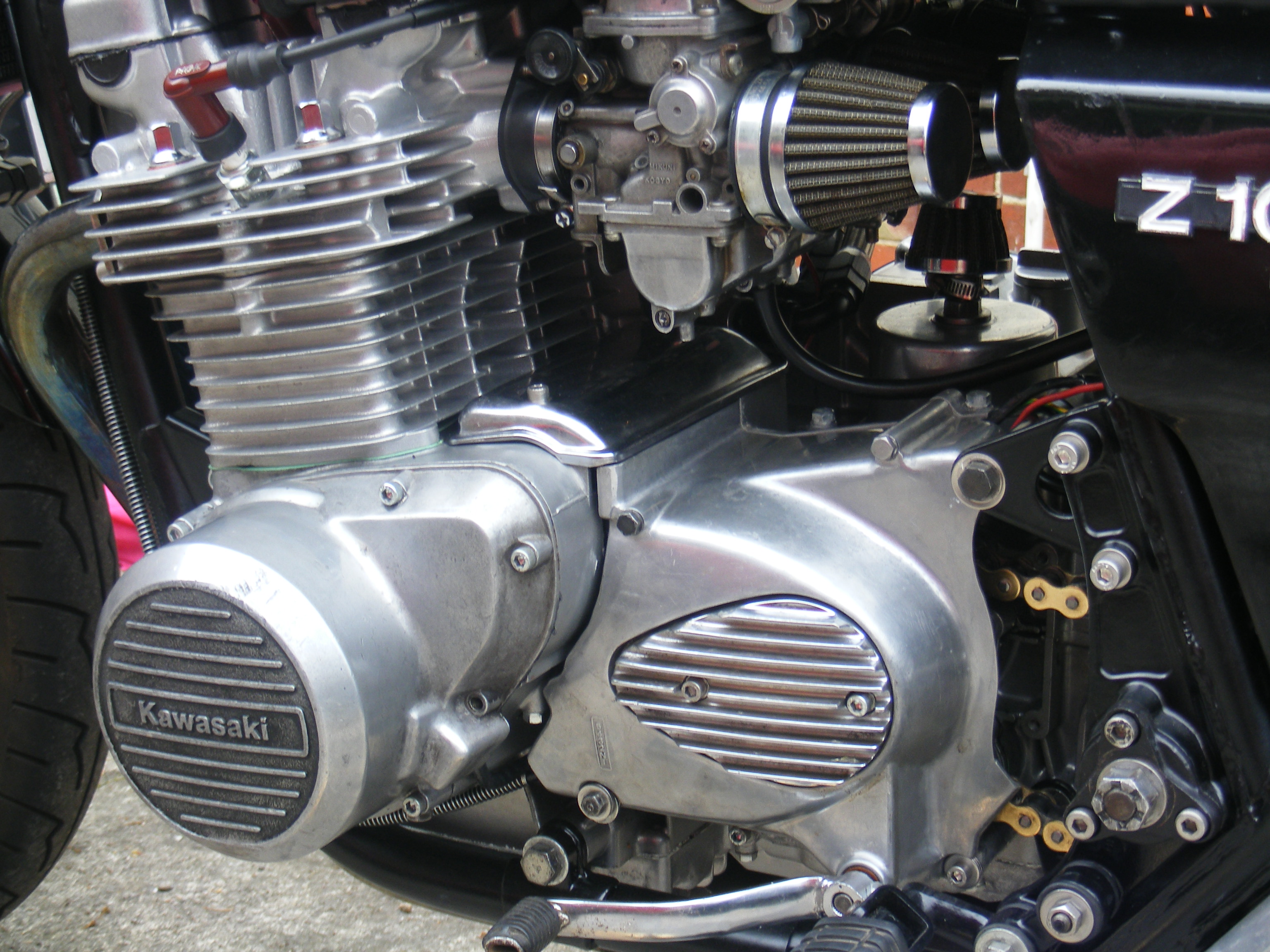

Once again ive only had limited time to devote to the Z ,unable to ascertain if I had the correct gear shifter ,I decided to make the one I had work! ,had it shortened ideally I wanted it 10mm overall but ended up about 7mm once welded ,it seems to work now but ill be keeping an eye on it once the bikes on the road.
,the pawls are now catching the pins a an angle similar to that before the shifter was moved,next problem was the inner sprocket cover ,looked correct and lined up nicely but it fouled the end of the selector drum ,it transpires that the drum on the ST protudes further out that chain drive models as theres more room! ,had another selector drum baut couldnt use that as the neutral indent was 180 degrees out,Ray at Debbens machined down the middle spacer on my drum to the same as the chain drive model and suggested I swapped the pins ,however this made no difference! turns out the pins on chain drum sit deeper in the shaft as the holes are drilled deeper! ,so Debbens shortened my pins to finnally achieved the desired result,other problems are bolts heads needed modifying as theres less clearance now between levers etc,Satisfied that all should be o.k now ,ive pressed on got cases together and fitted pistons and barrels today and then with help from Stepson fitted motor.Picked up chain and sprockets today and bumped into a fellow forum member who was dropping off his motor by the look ? good to meet you but sorry didn't catch your name!,fitted the rear sprocket and loosly fitted the front as wanted to see how they lined up! tbh I havt checked it with a laser yet but it looks pretty dam good to me!

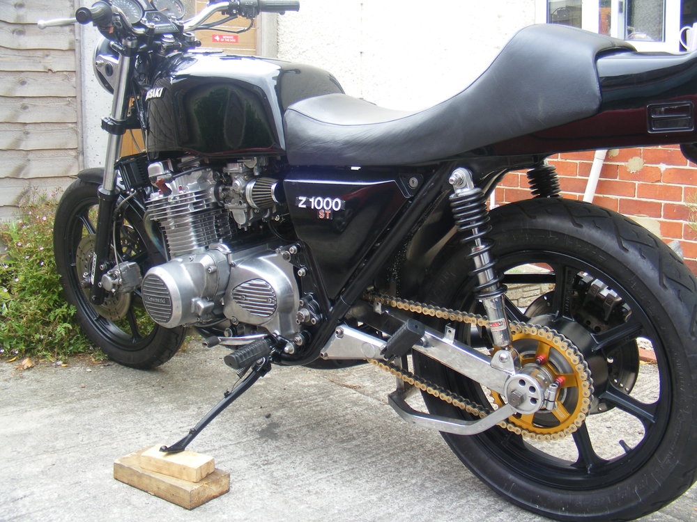

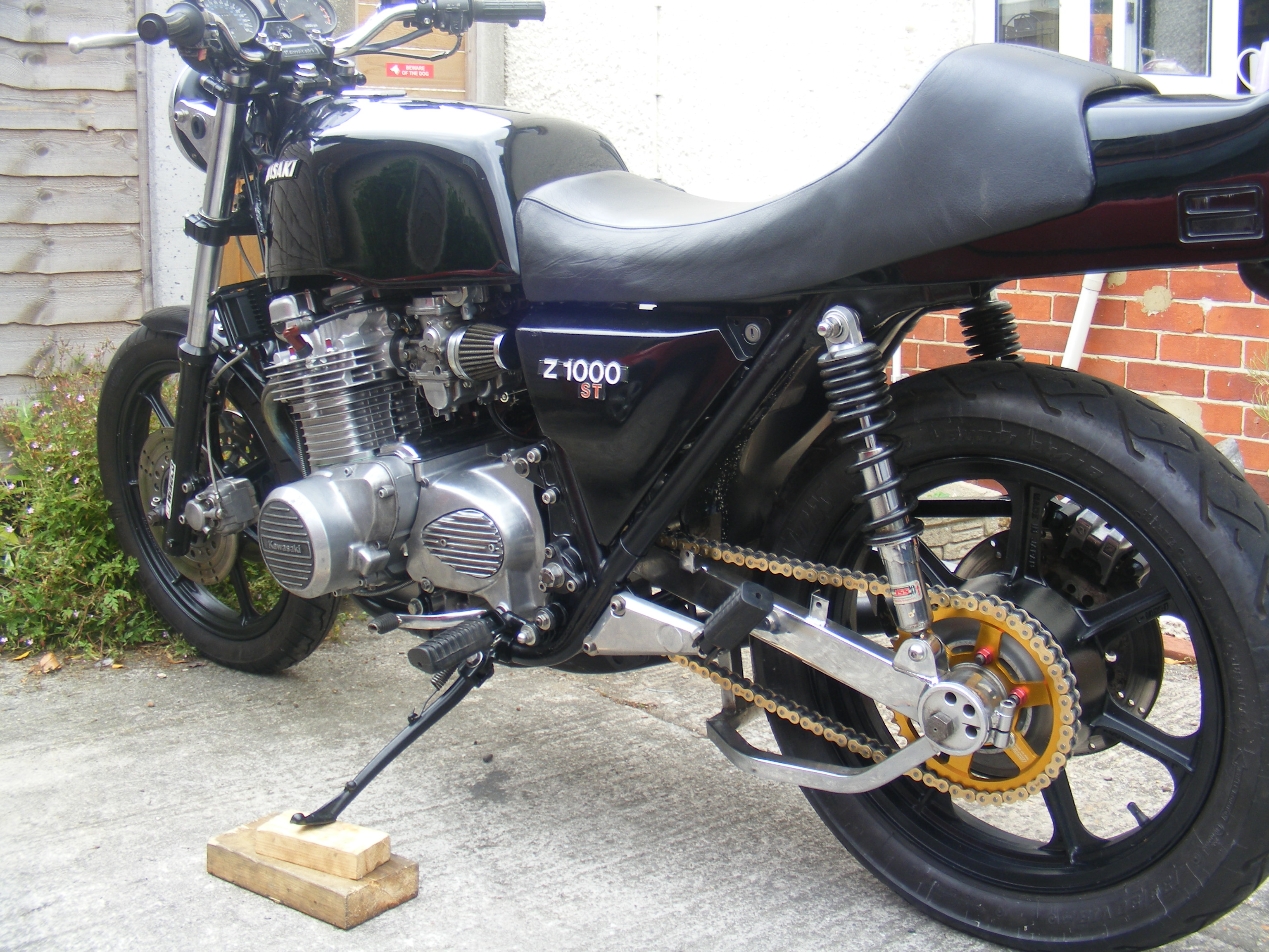

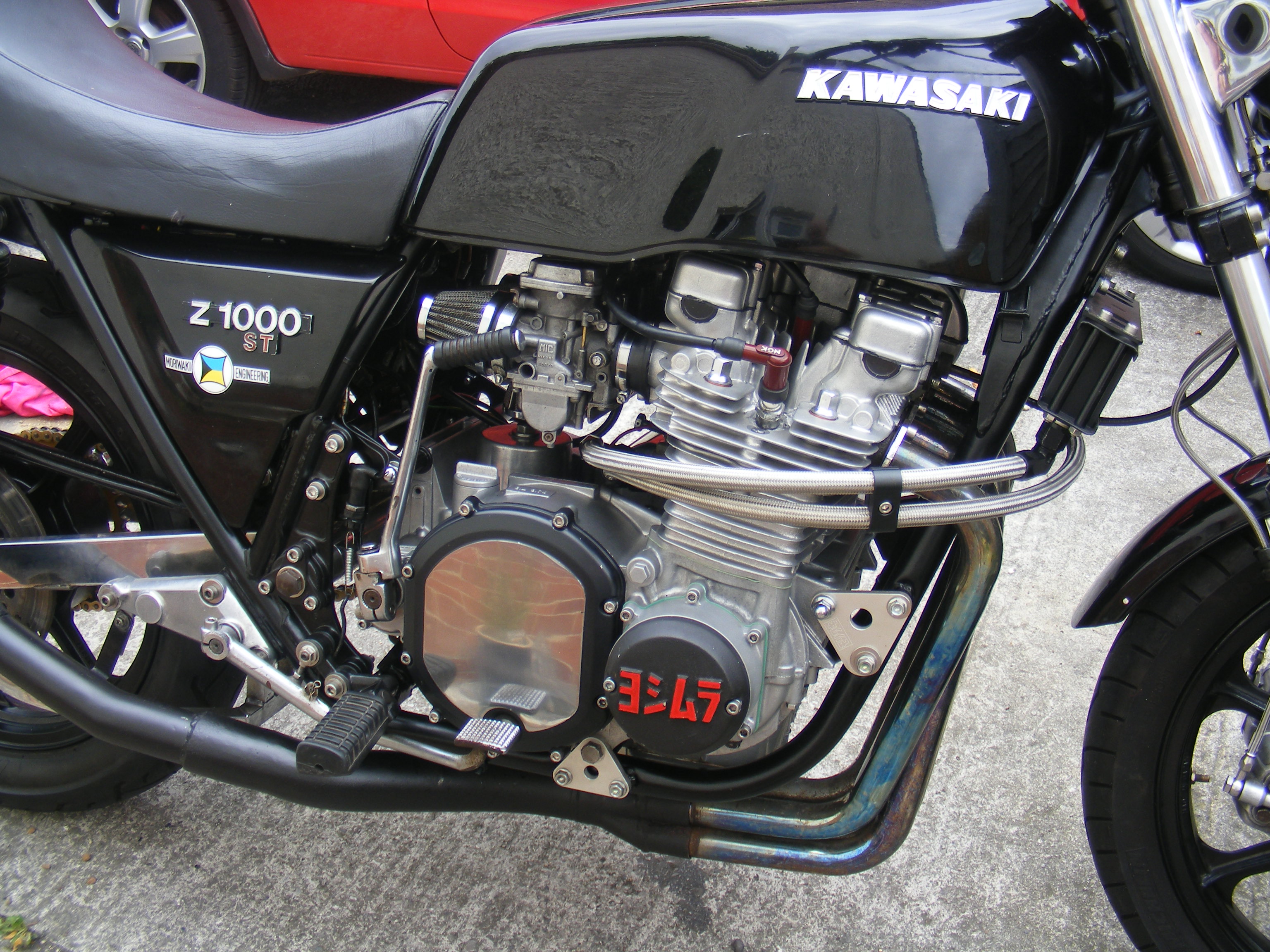

A few pics of bike to date ,taken this afternoon after a short ride round town ,have had a few teething problems since getting it running a few weeks back ,the gear change jammed once the engine was hot ,transpired the pin on the lever arm was catching on the inside of the sprocket casing ,this was in part due to me having to shorten the arm down to work at all ,resolved the issue by shaving a bit off the inside of the casing and also to be safe I doubled up on the gaskets to give extra clearance ,since then it has been fine,all in all I happy with the final result ,I don't know why I had a bee in my bonnet about converting a shaft to chain ,used to have an xs750 years ago and also thought that would look great as a chain drive bike!,from a financial point of few its probably not worth converting a complete st unless you already have some bits lying around ,its surprising how it adds up if you factor in ,swinging arm ,disc ,rear caliper ,wheel etc etc ,however the actual engine side of things dosn't cost much tho it is hassle as Ive already tried to explain the ST selector drum isnt designed to run behind an inner chain sprocket ,mine only cost so much as I bit the bullet and had the crank checked while the bottom end was apart ( this was then reconditioned etc by Debbens as bearings were on their last legs!),also fitted new bearings on both shafts and did the cam chain so as I say it all adds up!,its now running nicely and rides well ,gear change actually seems smoother than before ,also its a lot easier to push it out of the shed now! cheers all Stan.

Unfortunately can't see any pictures. Good to hear you are up and running
I think you need to reload the pictures straight from your computer. Just drag and drop.
Photobucket will not let you copy onto another website, unless you pay them for the privilege.

ur kidding ,mm so only I can see them then?

Fantastic result, I like that a lot.
Re: Stan's z1000st project
That is much better. Looks lovely mate.

Looking very tidy that! I like it..
oh well done ,that looks great
Great job - well done for sorting out the chain conversion - ace bike
