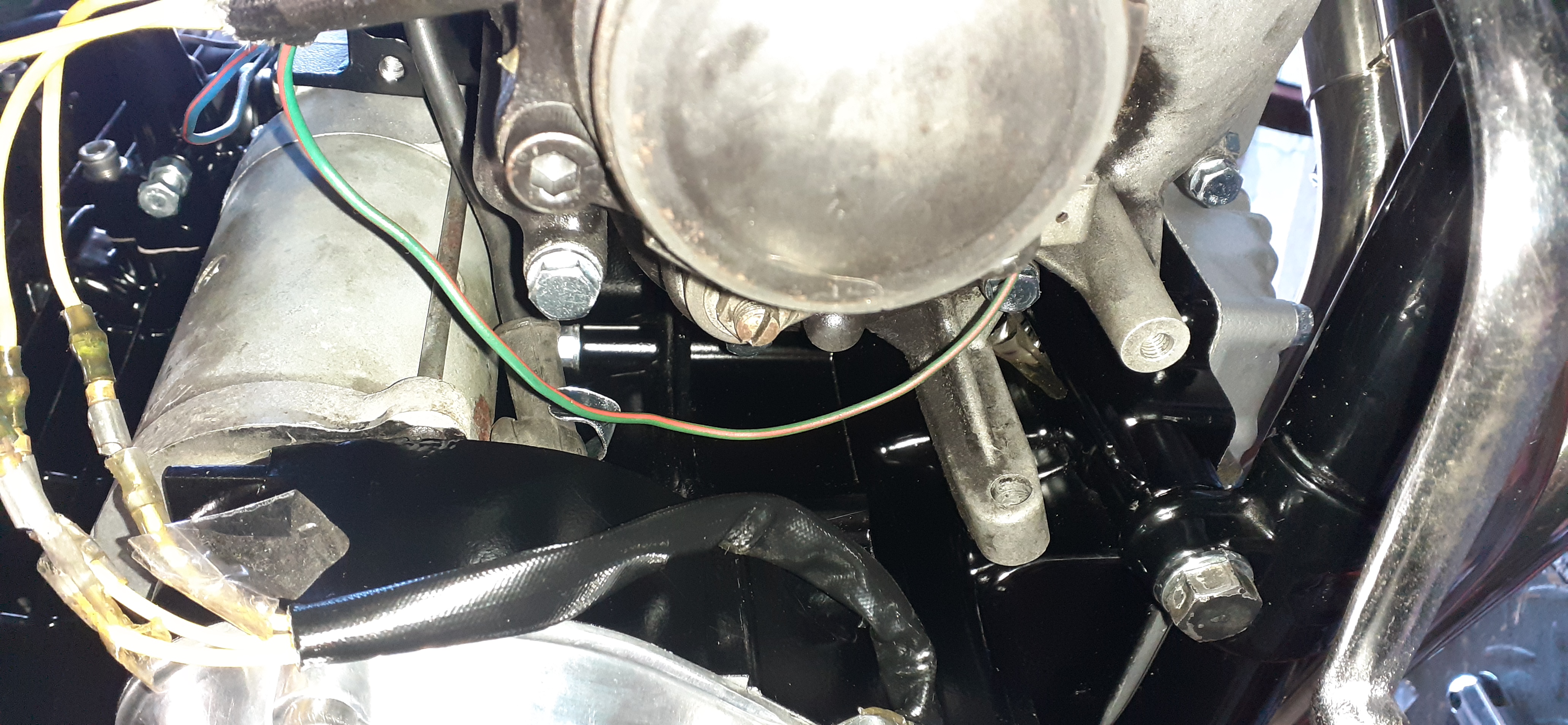

Fitting the starter motor cable was a bit fiddly.

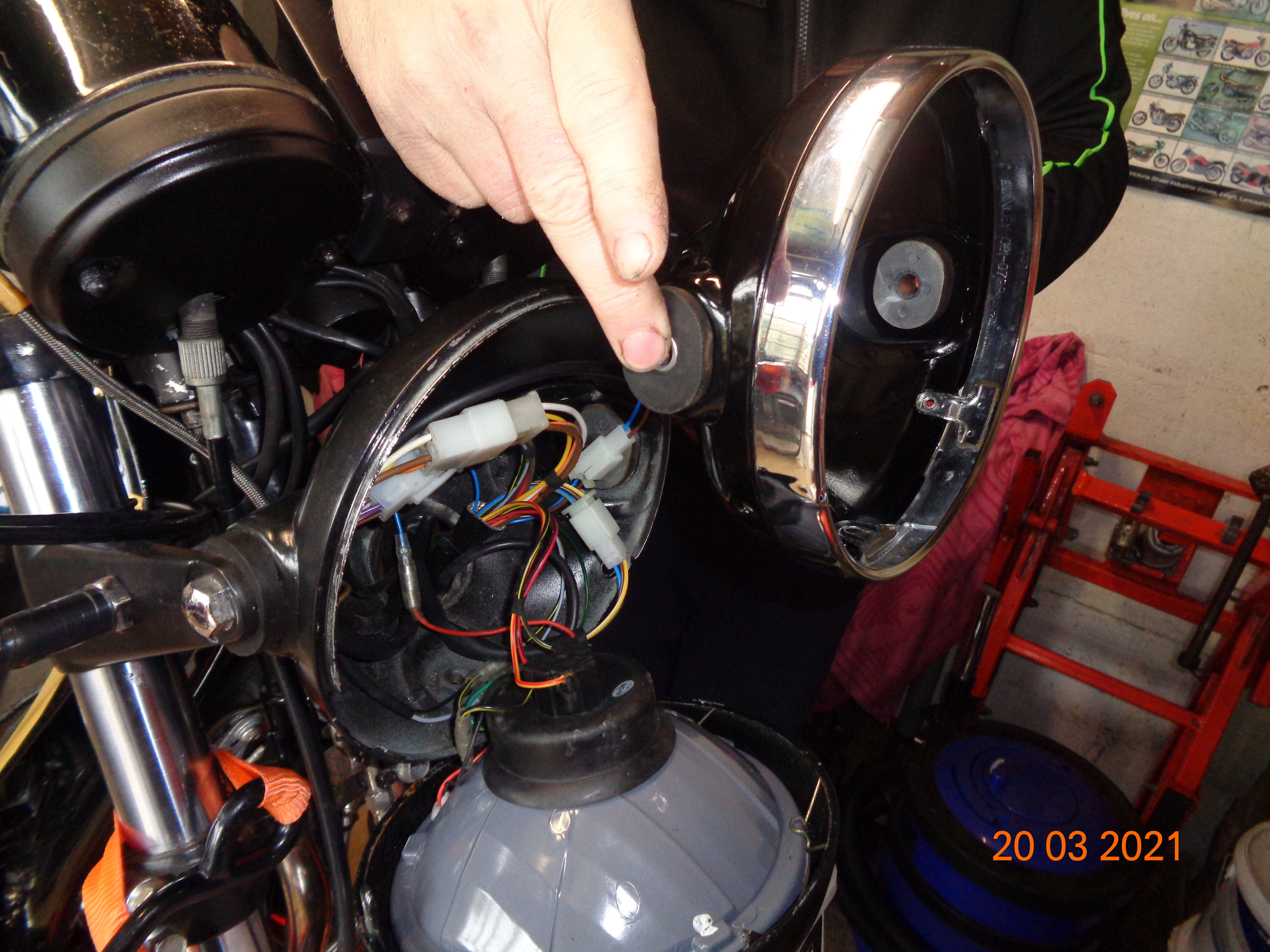

I have fitted a secondhand headlamp bowl and rim, unfortunately the rim is different.

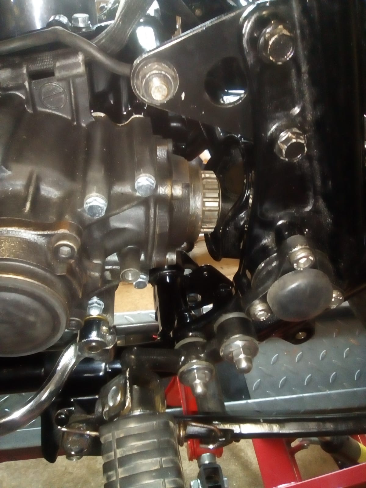

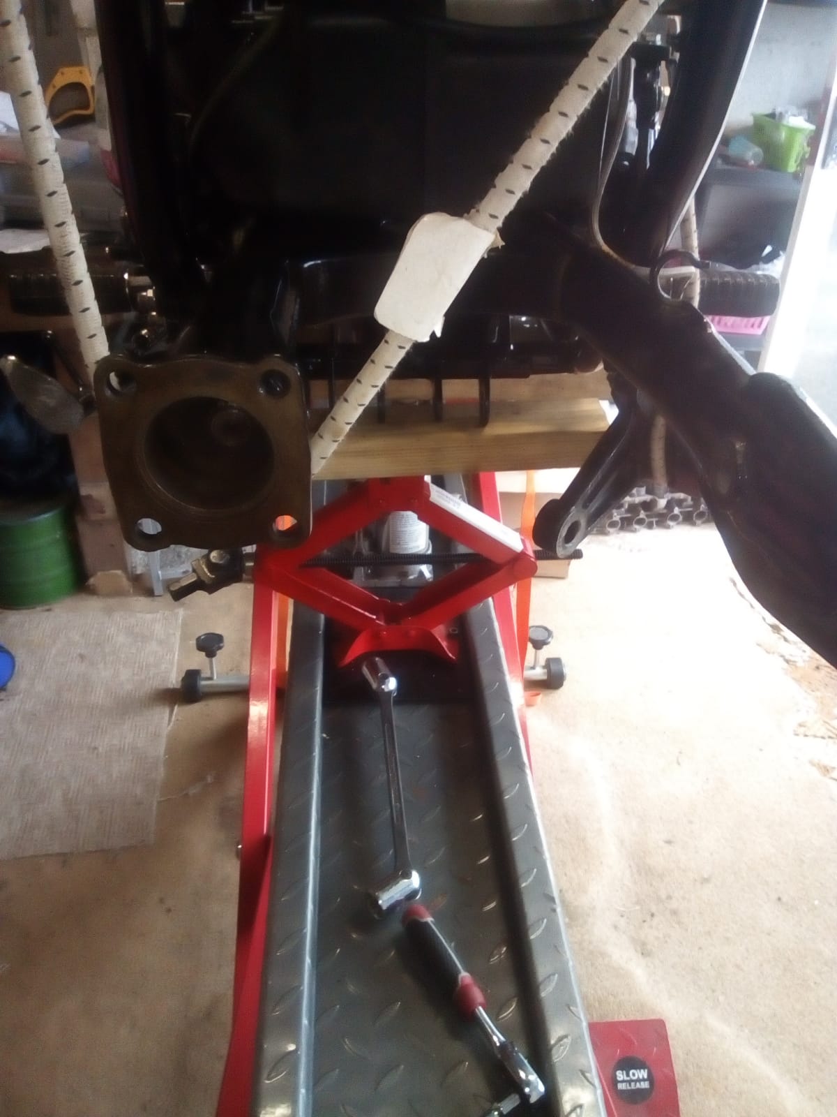

Connecting driveshafts
Dunlop4
Posts: 224
Joined: 17th Sep 2015
Location: Cardiff
Re: Z 1000 St E2
#80 PostAuthor: Dunlop4 » Sat Mar 20, 2021 3:36 pm
Remove swingarm.
Dunlop4
Posts: 224
Location: Cardiff
Re: Z 1000 St E2

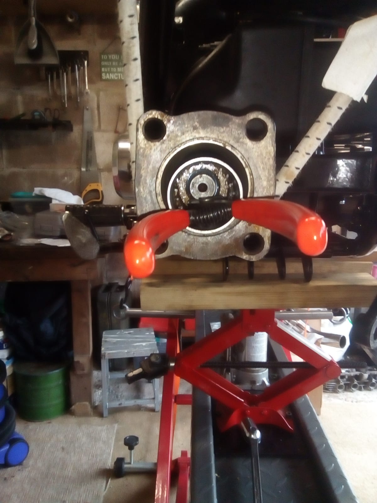

#81 PostAuthor: Dunlop4 » Sat Mar 20, 2021 3:38 pm
Connecting circlip.

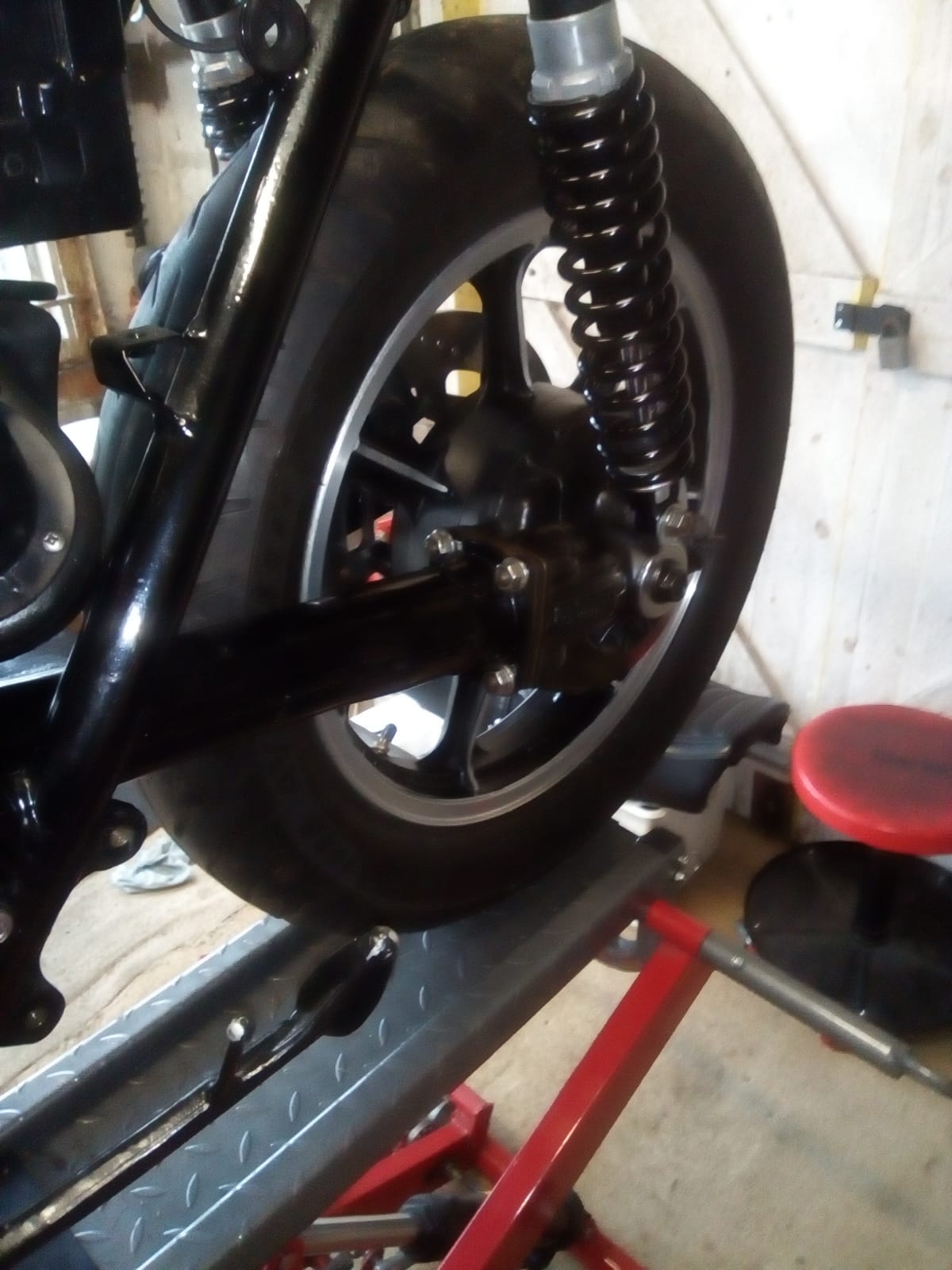

Swingarm back on.

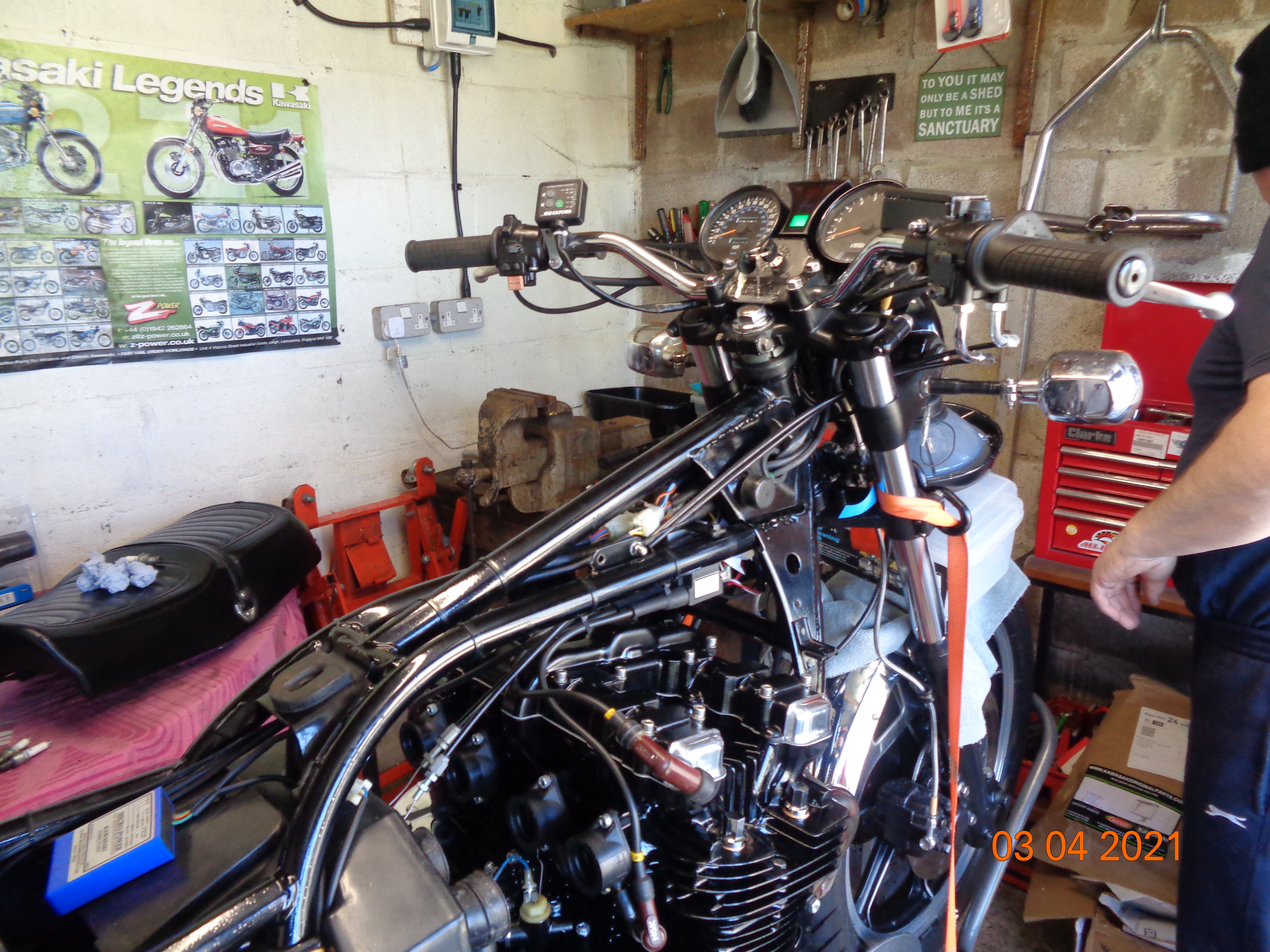

I have fitted the airbox and electrics, the brake lever was difficult to fit and still seems to high. \perhaps it has a bend in it.

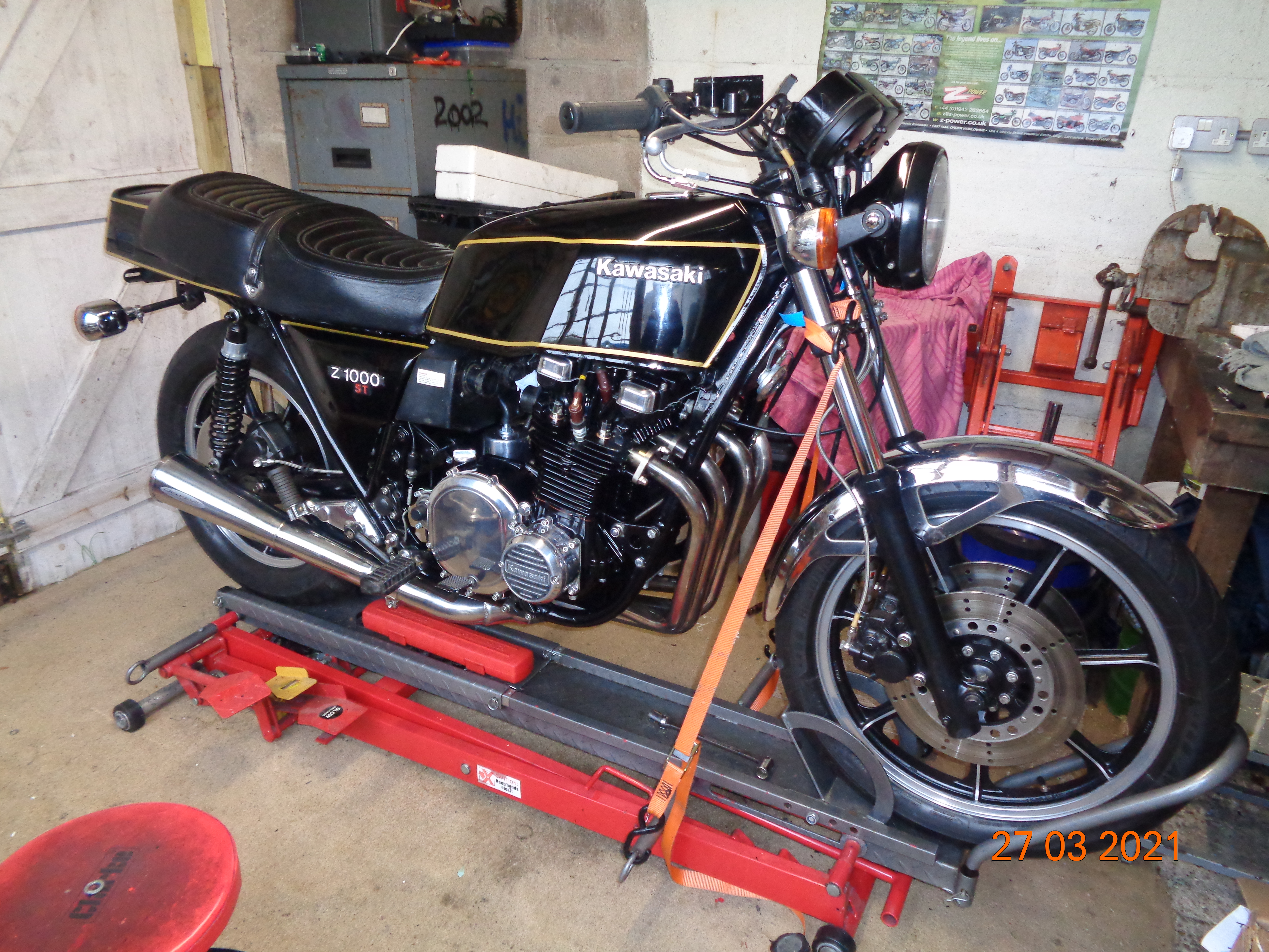

#84 PostAuthor: Dunlop4 » Sat Mar 27, 2021 2:45 pm

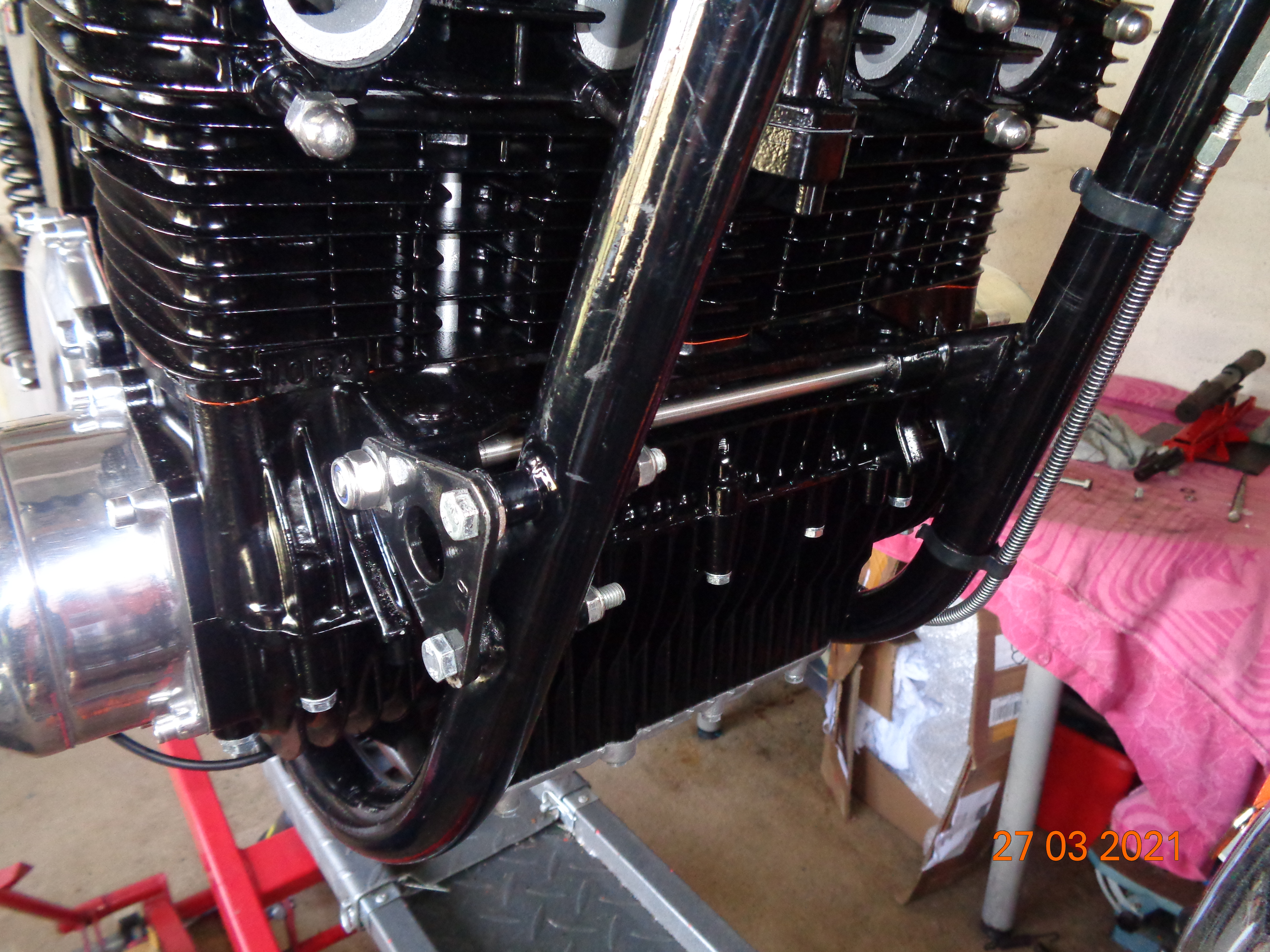

The front engine mounting rod was missing unable to get an original one, so i sourced this one from zed parts.
Dunlop4
Posts: 224
Location: Cardiff
Re: Z 1000 St E2
#85 PostAuthor: Dunlop4 » Sat Mar 27, 2021 6:02 pm

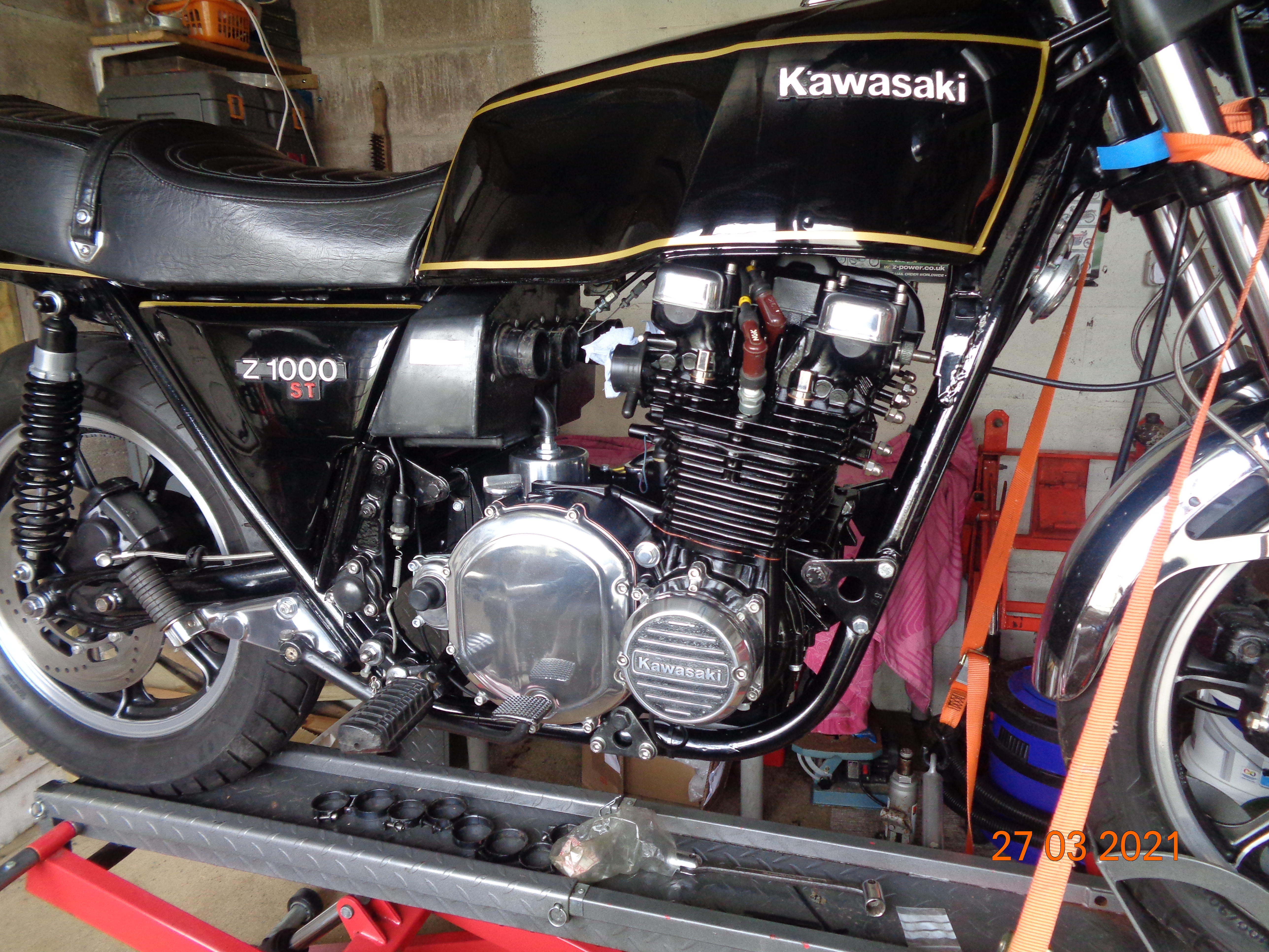

Fitted the exhaust, enough for today.

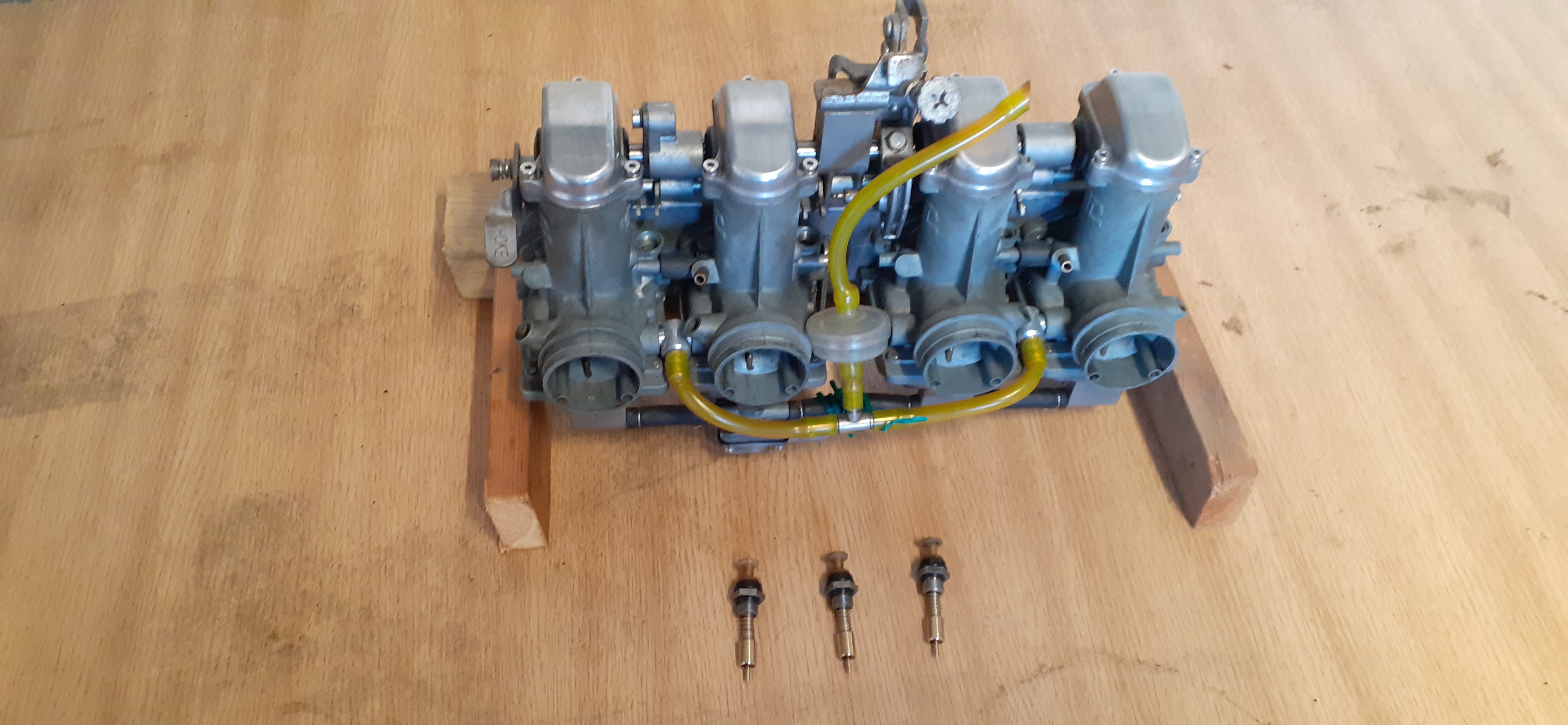

#89 PostAuthor: Dunlop4 » Sat Apr 03, 2021 5:01 pm
Choke plunger seats were replaced by Zed 1015 arrived this morning, refit these then refit carbs to bike.

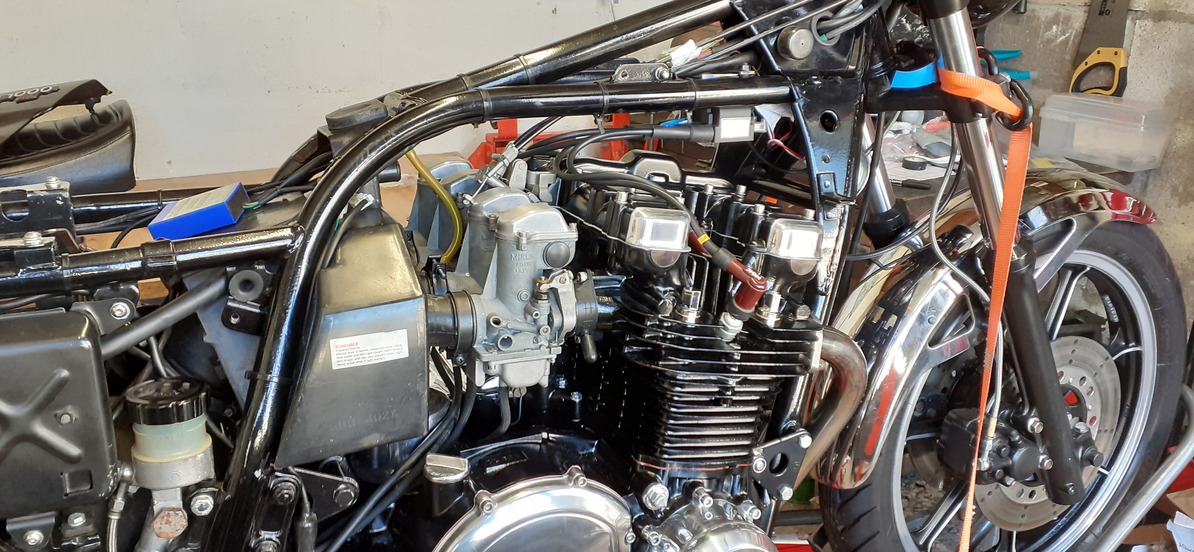

#90 PostAuthor: Dunlop4 » Sun Apr 04, 2021 11:38 am
Carbs fitted.
