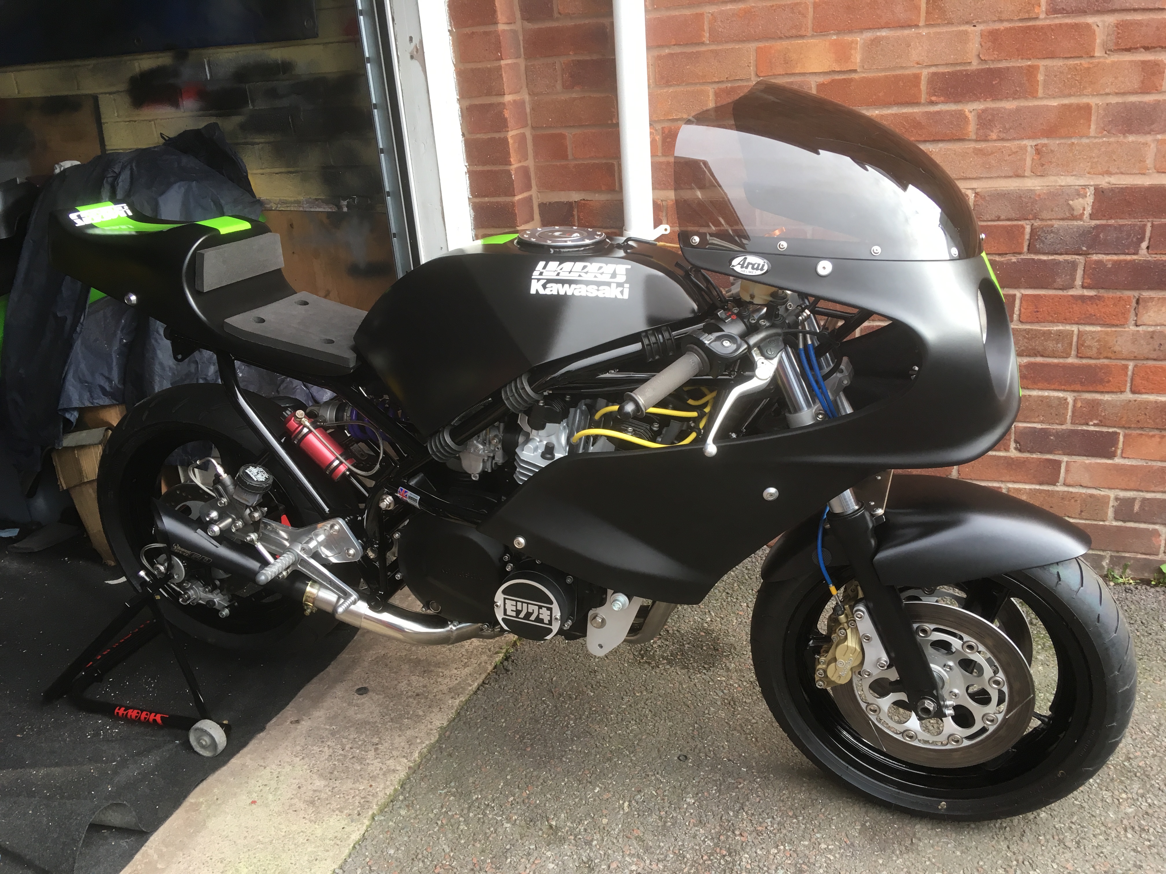

No updates for a while but a little bit of progress made.
Changed the cut down Harris fairing for a half fairing purchased from Dynodave that he got from Ragged Edge, quality was ok apart from one edge where the fibreglass hadn't bonded to the gel coat and there was an air bubble that was about a foot long that had to be filled and shaped but turned out ok in the end and feels nice and solid now :)

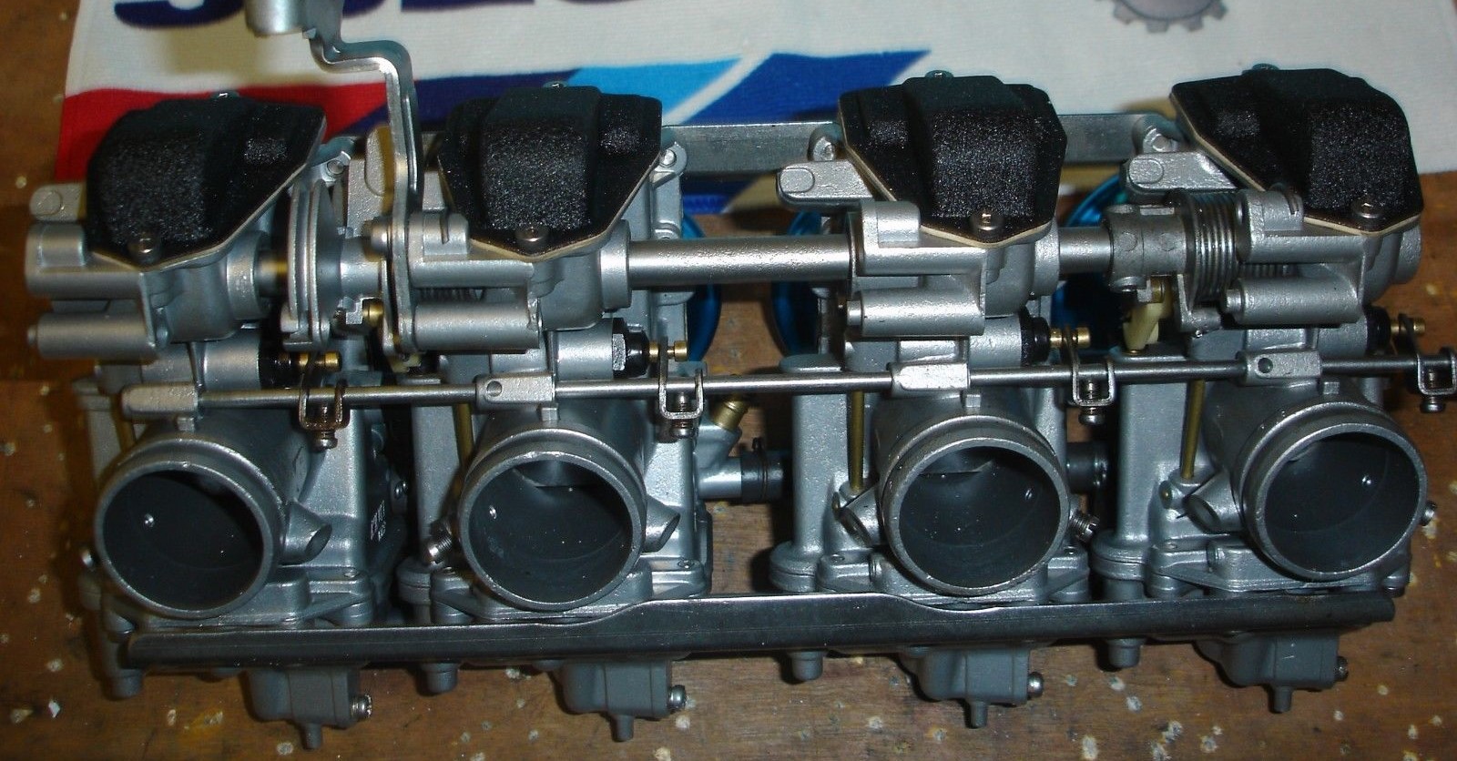

Also splashed out on a set of flatslides as I think I may have had a few problems setting up the 34mm z1000j carbs I'd got so bit the bullet and picked up a set of 29's bored to 33 that hopefully will do the job.
Couple of pic's.

Just the wiring to sort out now and a couple of bit's and pieces to tidy up.

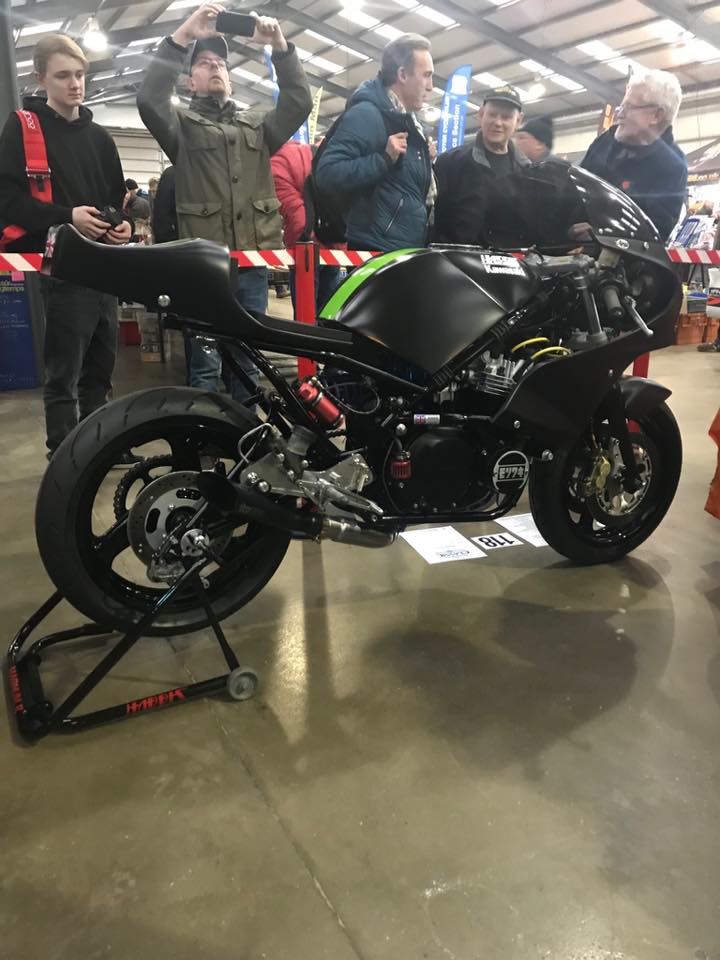

Picture nicked from fb.

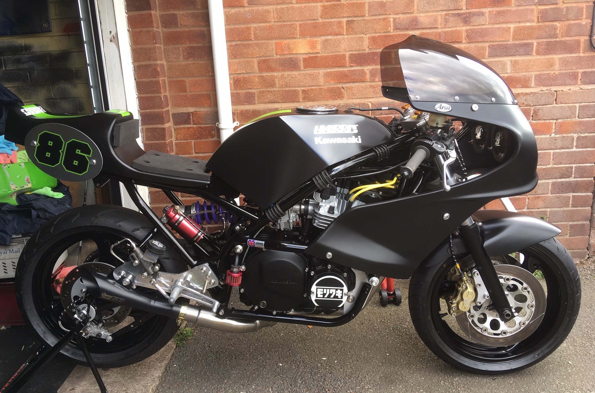

Not much of an update but the wiring is 95% finished, got a nice fat spark and the charging system is all wired up. Almost ready for firing up :D I'll probably wire up the lights at later date and just stick a daytime MOT on it for now.
