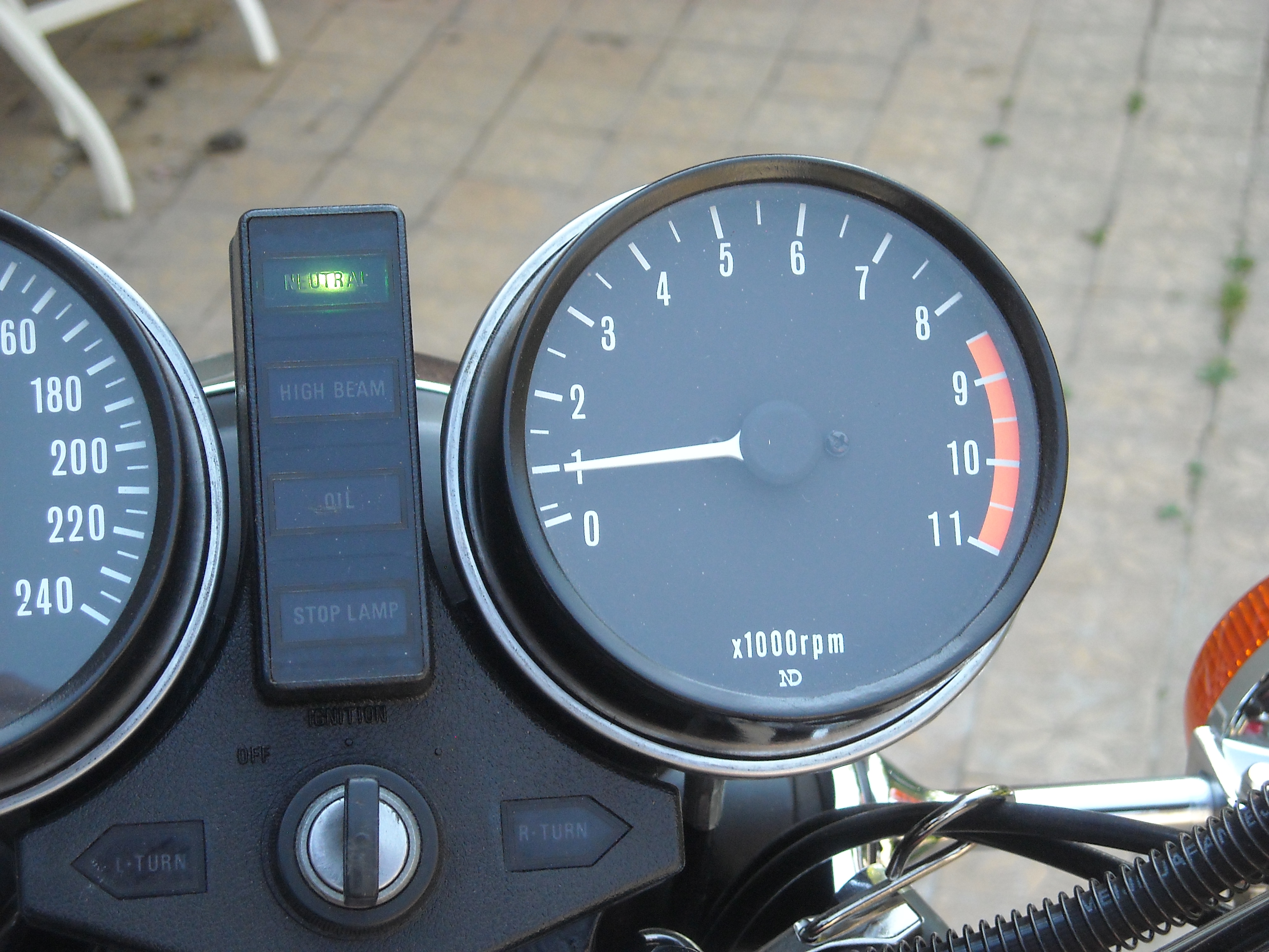

After a few minutes the revs were stable at approx.1200 Rpm and I lowered them with the idler screw to a nice 1000 Rpm.
