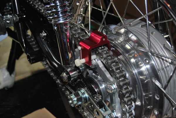

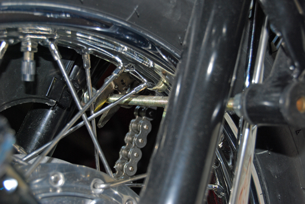

I had already done a rear wheel dry fit when I measured up the rear sprocket, so installation was a doddle.
I did take some pics of the chain riveting process but they got deleted by accident - needless to say all went well with no drama's.
Chain alignment tool takes the guess work out.
Chain guard was fitted with the polished stainless bolts and washers - the guard is the original - so has 39 years of patina!
Rear wheel torqued up - split pin in - chain tension checked.

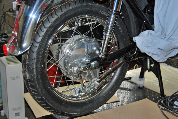

Grand Prix over the rear brake got fitted up and adjusted.
Brake arm and Wear indicator are the originals re-chromed, bolt is a polished stainless item.
Brake rod is a PMC stainless kit.
Torque arm is the original re-chromed, fitting kit is a PMC stainless one.

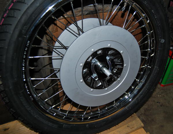

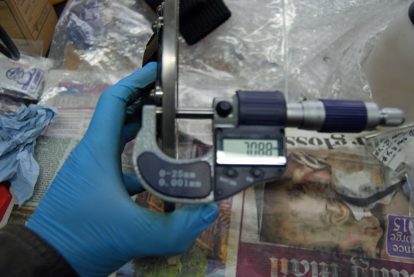

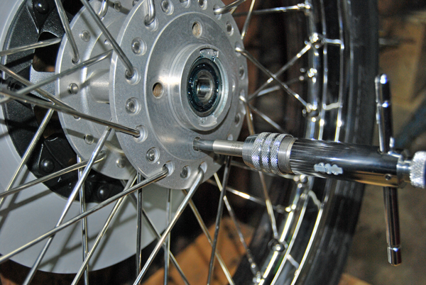

I then made a start on the Disc's - the nearside was the original and a bit rusty - the replacement for the missing offside was in better condition but a touch later in date.
Both discs were thickness checked - both well in spec.
There was slight surface scoring on both, none were particularly deep so deemed acceptable - no need for a skim.
With a bit of masking - a coat of Bright Zinc Spray will stop the rust returning - the over spray on the pad area will get wiped off by the pads leaving a neat edge.
I have used clear lacquer for this job in the past - but I have found the modern namby pamby formula we get now peels off in no time.
As this bike will be used and may well get wet - the Zinc Coating is not going to be cosmetically pleasing to the eye - but it will be practical.
All threads were yet again cleaned prior to assembly - all bolts lubricated with alumslip.
I couldn't initially find the torque figure for the disc retaining bolts - so I did them the book figure for M10 x 1.25 which is 30lbs/ft.

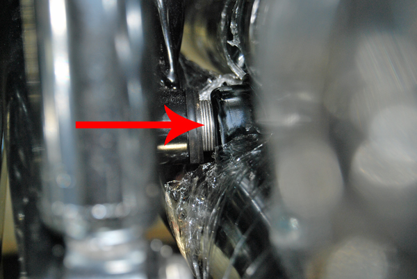

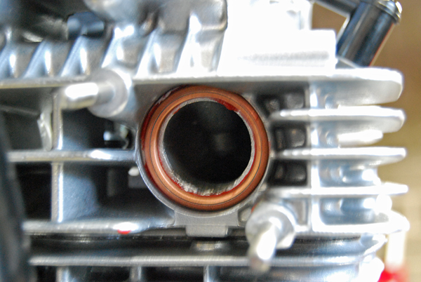

I removed the oil cooler to find the oil cooler take off's are both facing the same direction so I am unable to loop them like I did on the Ltd - so It's back to a standard set up - without one to hand a quick scout on flea-bay showed 16 Euros for a new one from CMS was the way to go.
I then opened the large expensive box from Dave, Ooooh shiney - no gaskets in the fitting kit - bugger! add a set to the CMS order - more bloomin parts.......

Jay1969 wrote:Excellent attention to detail Alex, does the chain alignment tool do the same job as the laser chain alignment tool?
They both do the same job - I would imagine the laser would be more accurate as it would go further up the chain - the rod is quite short but I find it long enough - and better still it was cheap!

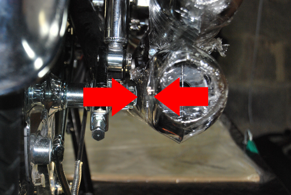

However there was a gap between the silencers and the rear mountings - exactly 10mm each side.
Both pipes would pull in to the mounts, but this would put tension on the headers - and make the gaps to the axle wrong - bugger!
Some investigation showed the exhaust mount location measurements were spot on, when the frame was jigged they were checked and found to be 280mm centres which they told me was the book spec - Mmmmmm
[img]http://i241.photobucket.com/albums/ff247/vulpip07/Z900A4_230315_11.jpg
After many hours of research I found out just how much trouble these mounts can be with alignment.
I had already measured some other bikes to see what measurements were the norm.
And I found - There is no norm........
Fearing a world of hurt was lurking round the corner - I inserted a bit of threaded bar with some nuts and washers and gently pushed them apart.
I wound them out to 20mm over what I wanted - then wound them back - measurement came back at 286mm.
This gave me 4mm more offside and 2mm nearside.
I wound them out 30mm over and this time it came back to 290mm.
Breathing a sigh of relief and not wishing to push my luck any further by at best cracking the powdercoat - I stopped there.
So I ended up with 5mm more offside and 5mm more nearside - Peachy
The pointer shows where I started. A very risky thing to do - but it paid off.
[img]http://i241.photobucket.com/albums/ff247/vulpip07/Z900A4_230315_14.jpg
Pipes back on and we now have a 5mm gap each side as expected.
With this gap, the nearside gap to the axle bolt looks spot on at 20mm.
So wherever they got the 280mm book spec from is probably wrong - or there is a possibility the Doremi pipes have a touch different mounting thickness which would explain why the mounting bolts are at least 5mm too long.
[img]http://i241.photobucket.com/albums/ff247/vulpip07/Z900A4_230315_12.jpg
I added some washers as approximate spacers and torqued them up.
Offside looked a tad wide at 5mm worth of washers, the rim measurement came up a tad over at 174mm - so a 4mm spacer will be made.
[img]http://i241.photobucket.com/albums/ff247/vulpip07/Z900A4_230315_16.jpg
Nearside looked about right at 5mm worth of washers and gave a rim measurement of 170mm - so a 5mm spacer will be made.
[img]http://i241.photobucket.com/albums/ff247/vulpip07/Z900A4_230315_17.jpg
Offside Axle nut to pipe gap was a touch big at 25mm, confirming a smaller spacer is required.

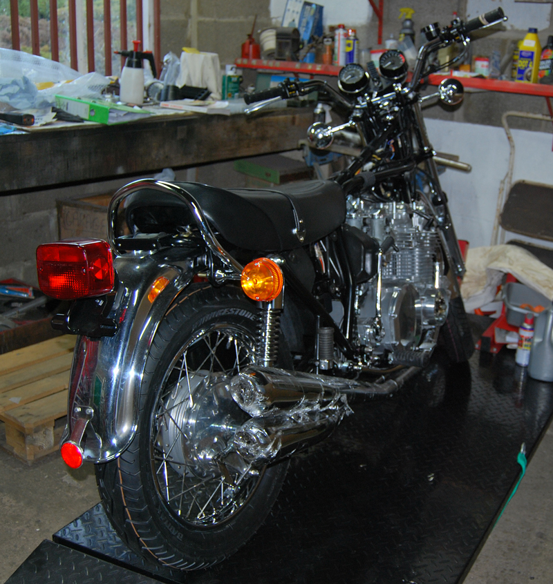

Off the centre stand for the first time -
Off the ramp this weekend - YAY!!!!!
Oh! and I'm definitely not going to mention the blocks of wood under the side stand..........

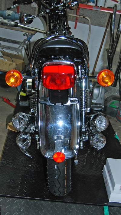

So, now we are looking a little more like it...
[img]http://i241.photobucket.com/albums/ff247/vulpip07/z900a4_230315_21.jpg
Headers now sit right and are equally spaced to the frame rails.
This was a huge sigh of relief as the offside frame rail was bent by a careful previous owner when he fell off.....
Those who have the chromed tubular engine protectors that bolt onto the engine mounts may want to think again - the covers will be easier to replace than straightening the frame! - all that force has to go somewhere!
The offside pipes look a touch too far out - such a lot of fuss over such a small thing
Such Fun
