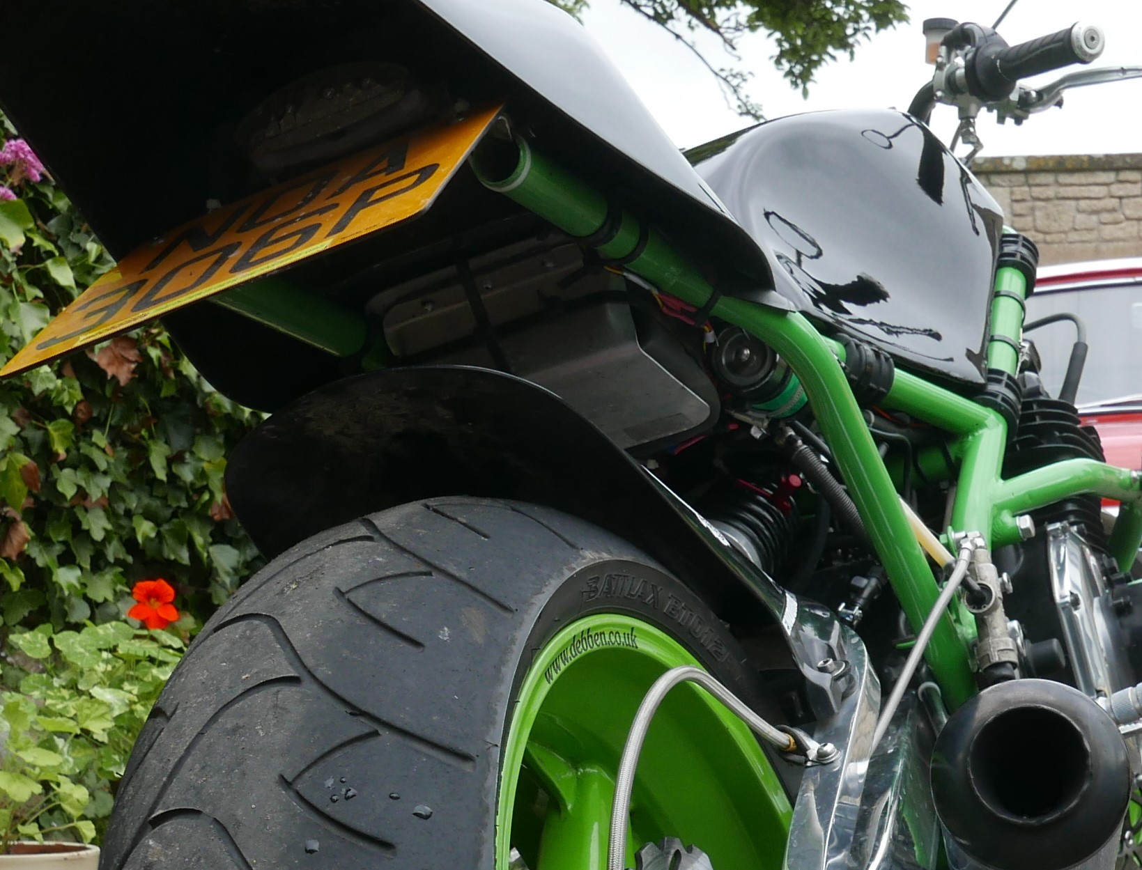

I'm running an li battery on me Harris - been on the bike 3 yrs now with no problems. I do top it up a couple of times over winter - it's got a set of 3 x LED's to show charge status.
http://www.ebay.co.uk/itm/Kawasaki-Z900 ... SwiwVWRIdu
Excellent cranking power & weight F.A.

The listing has smallest height of 133mm and i am limited to 110mm height, i already have a small LI battery so i will try using that otherwise i could use one of these and lay it on its side :idea

#96 PostAuthor: Pigford » Thu Mar 09, 2017 8:32 pm
Yeah, mines on its side - strapped under the seat unit.
