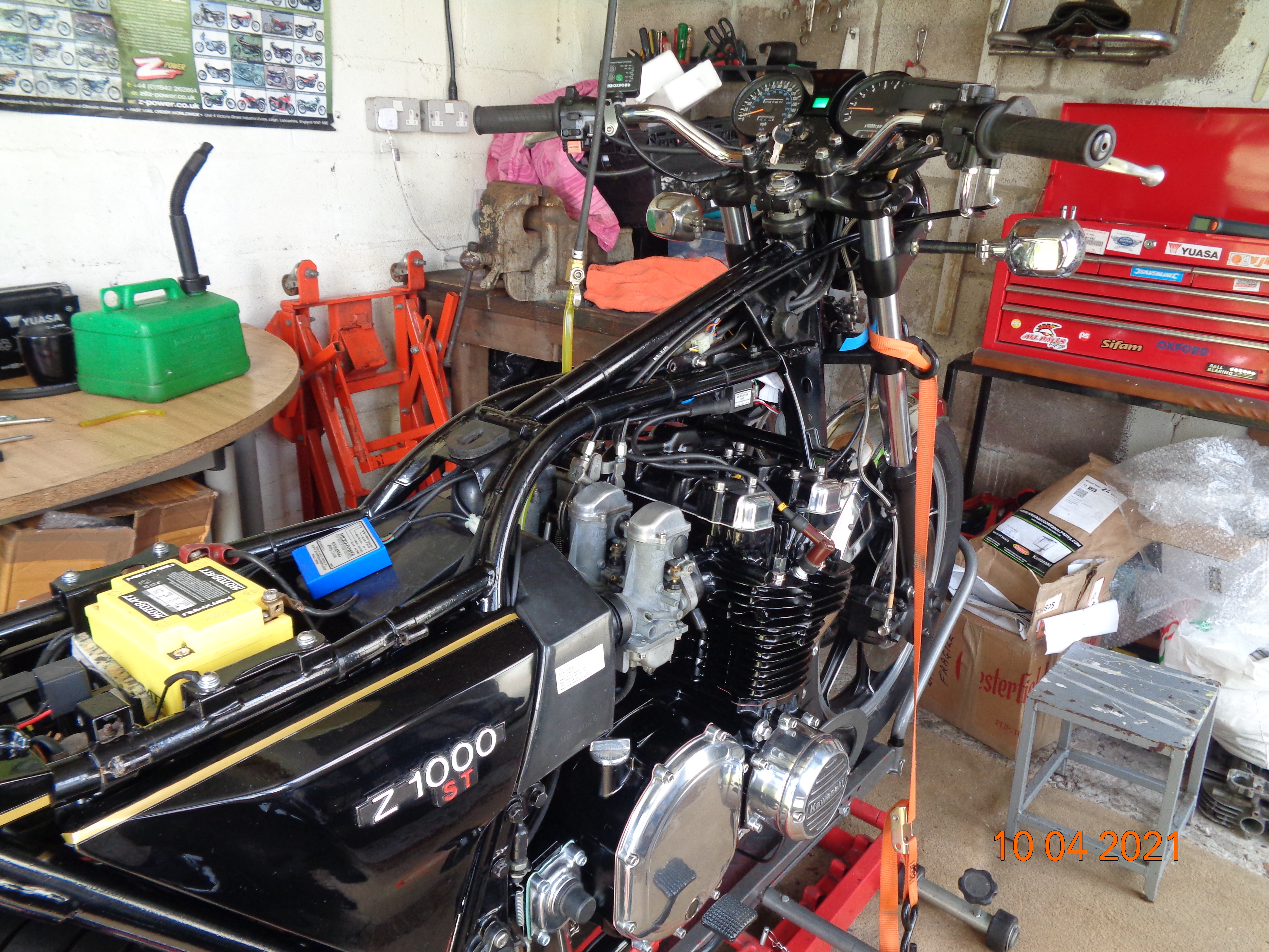

First start up successful.
The ignition needs setting up, it is a boyer bransden and some new fuel pipe.

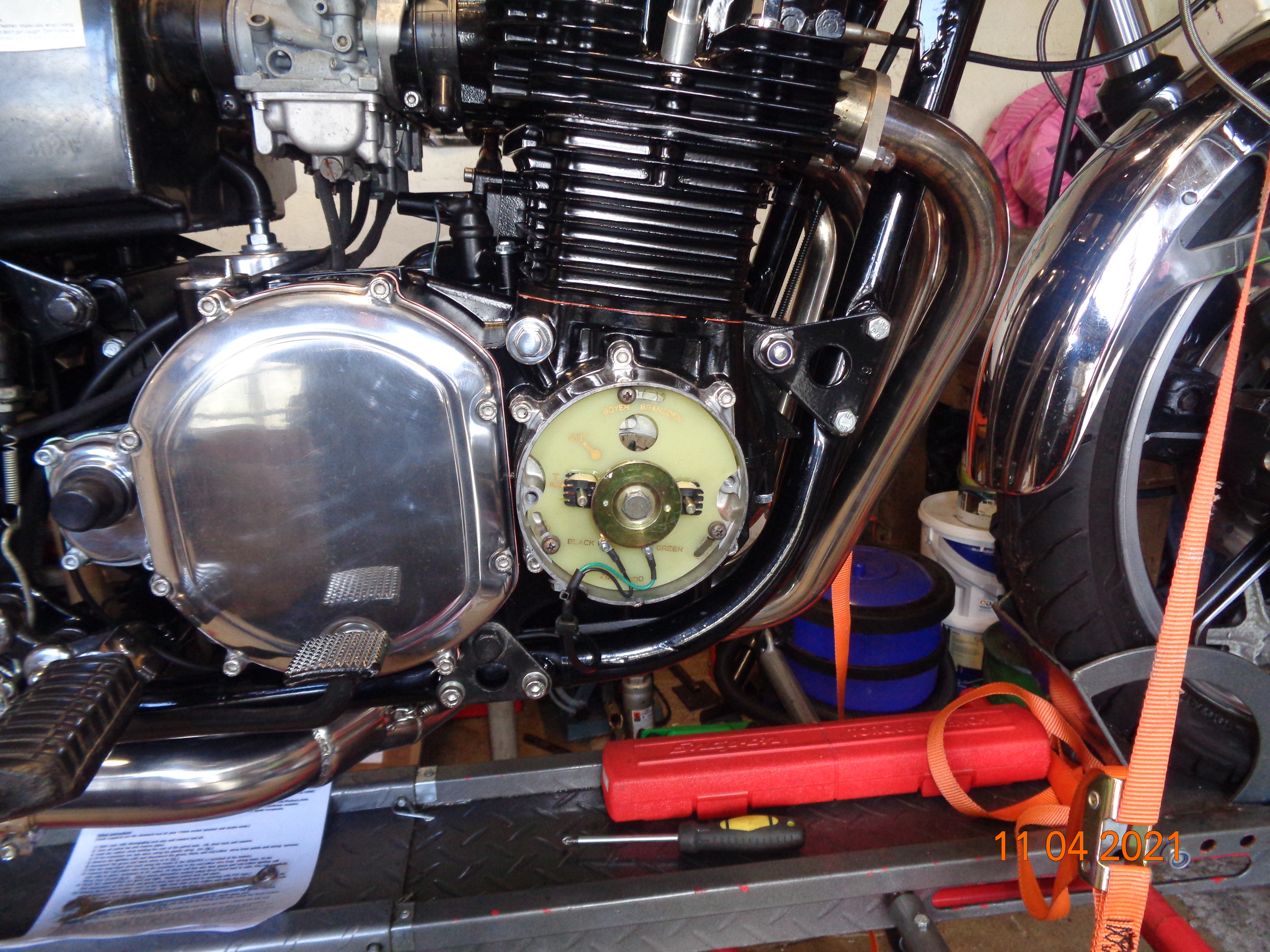

#92 PostAuthor: Dunlop4 » Sun Apr 11, 2021 1:17 pm
I removed the Boyer Bransden and refitted as per instructions. It says to set the full advance at 5000rpm, with a strobe.
I will get a couple of hundred miles on the engine first.
The startup went a lot smoother this time. It cannot be far off.
Re: Z 1000 St E2
#93 PostAuthor: Pigford » Sun Apr 11, 2021 5:38 pm
Dunlop4 wrote:I removed the Boyer Bransden and refitted as per instructions. It says to set the full advance at 5000rpm, with a strobe.
Just set it at the stated 5000 rpm now - that won't do any harm in a fresh motor, especially as it won't be under load, wrong ignition timing is more damaging.

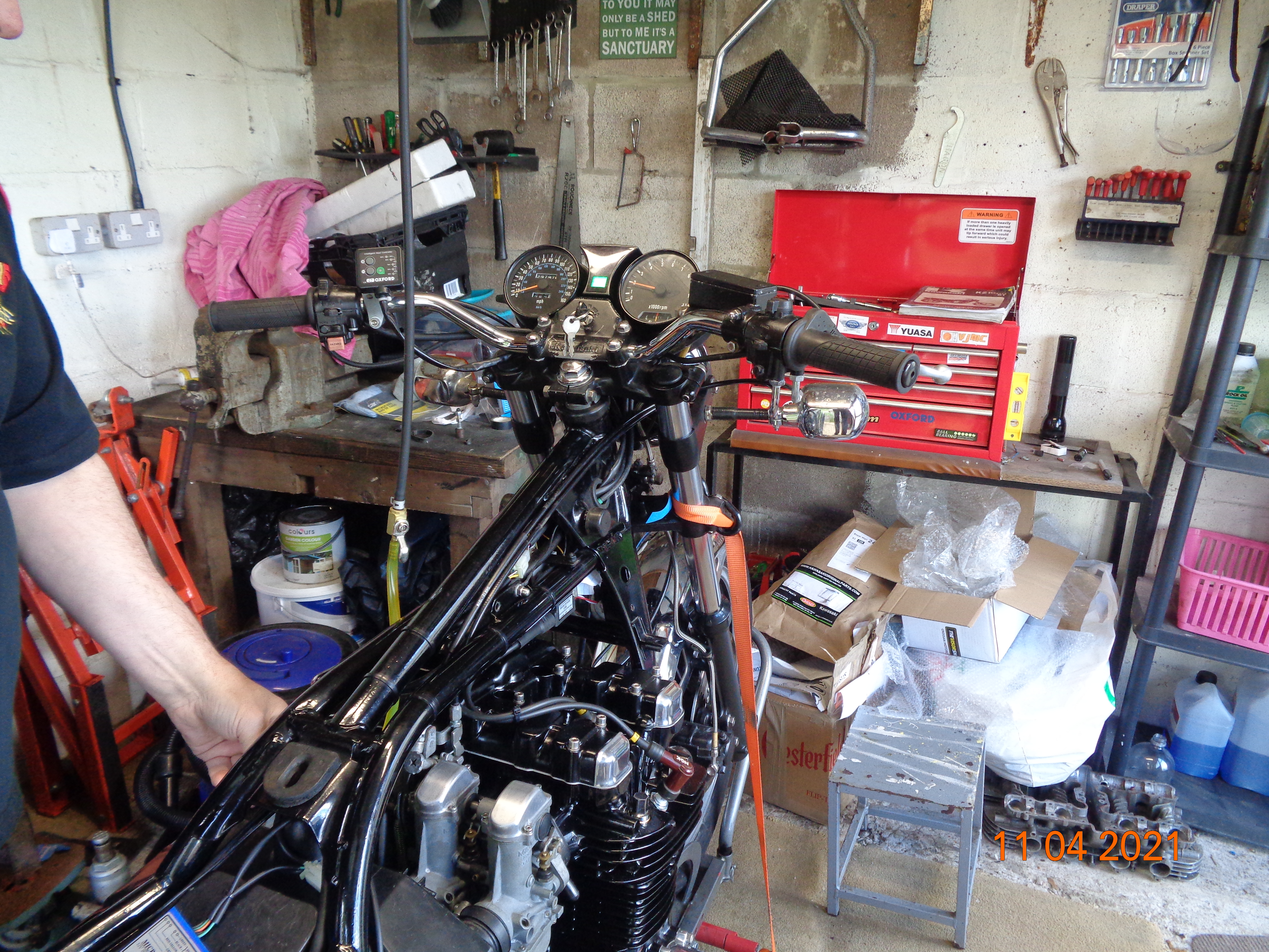

#94 PostAuthor: Dunlop4 » Sat Apr 17, 2021 9:23 am

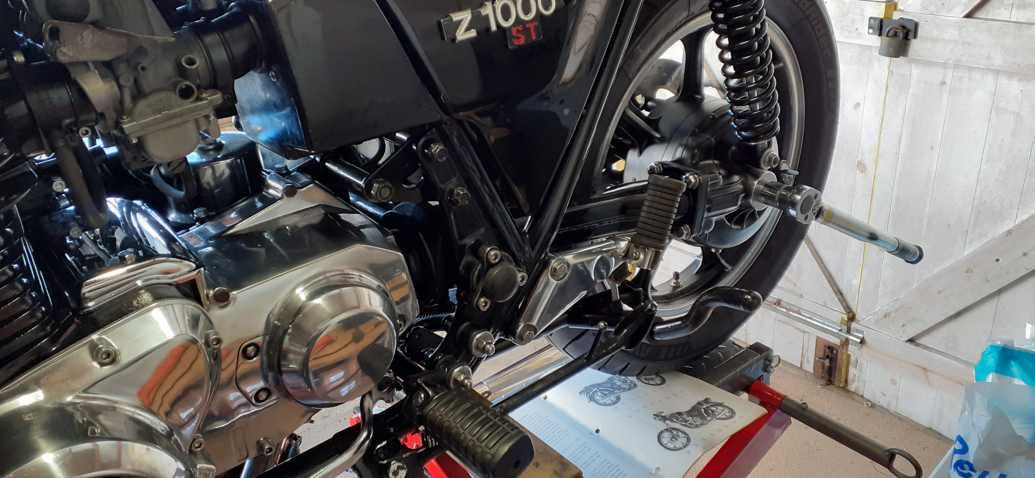

Checkin torqe settings for mot Monday. Rear spindle was in wrong way round.
Have corrected this, working my way through rest of bike.

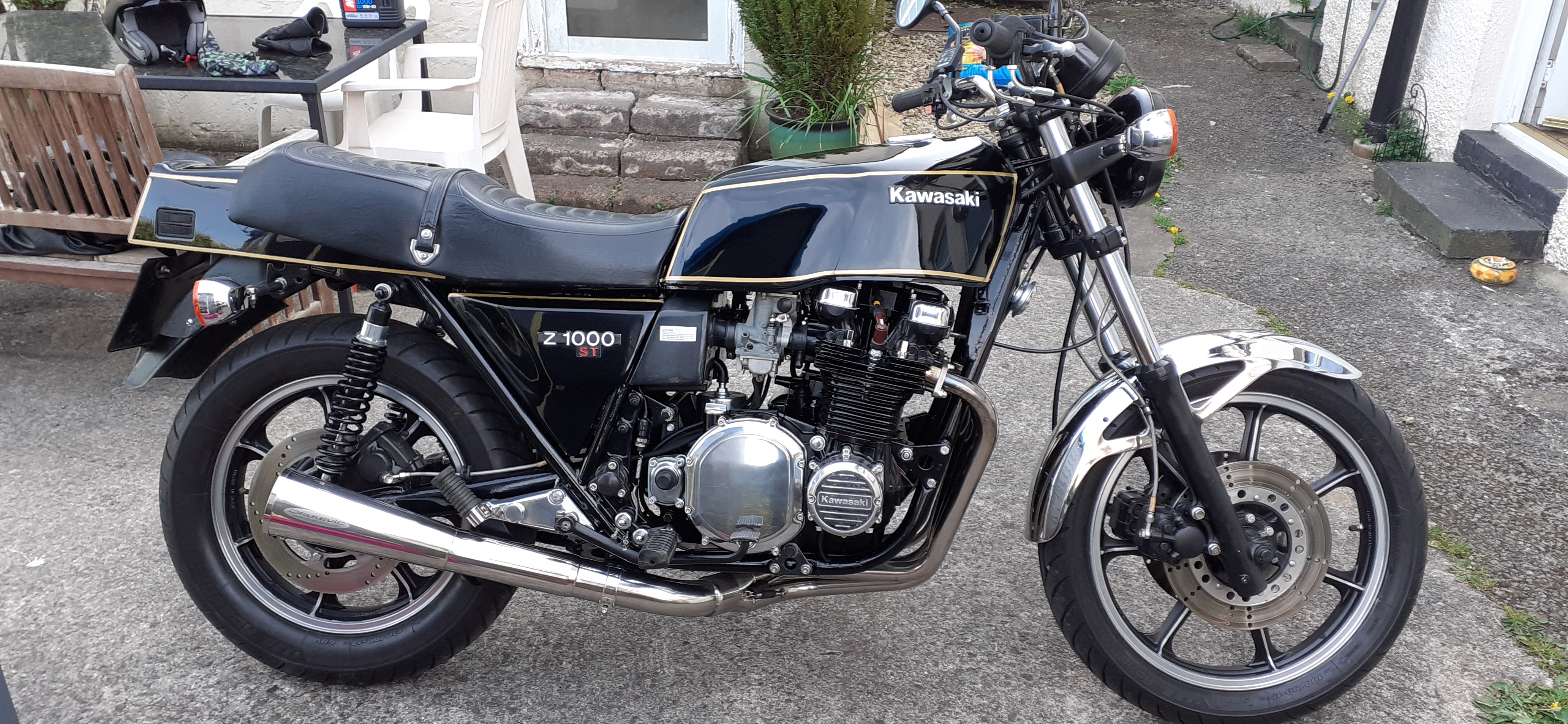

#100 PostAuthor: Dunlop4 » Mon Apr 19, 2021 4:11 pm
Passed mot, fork seal starting to leak.

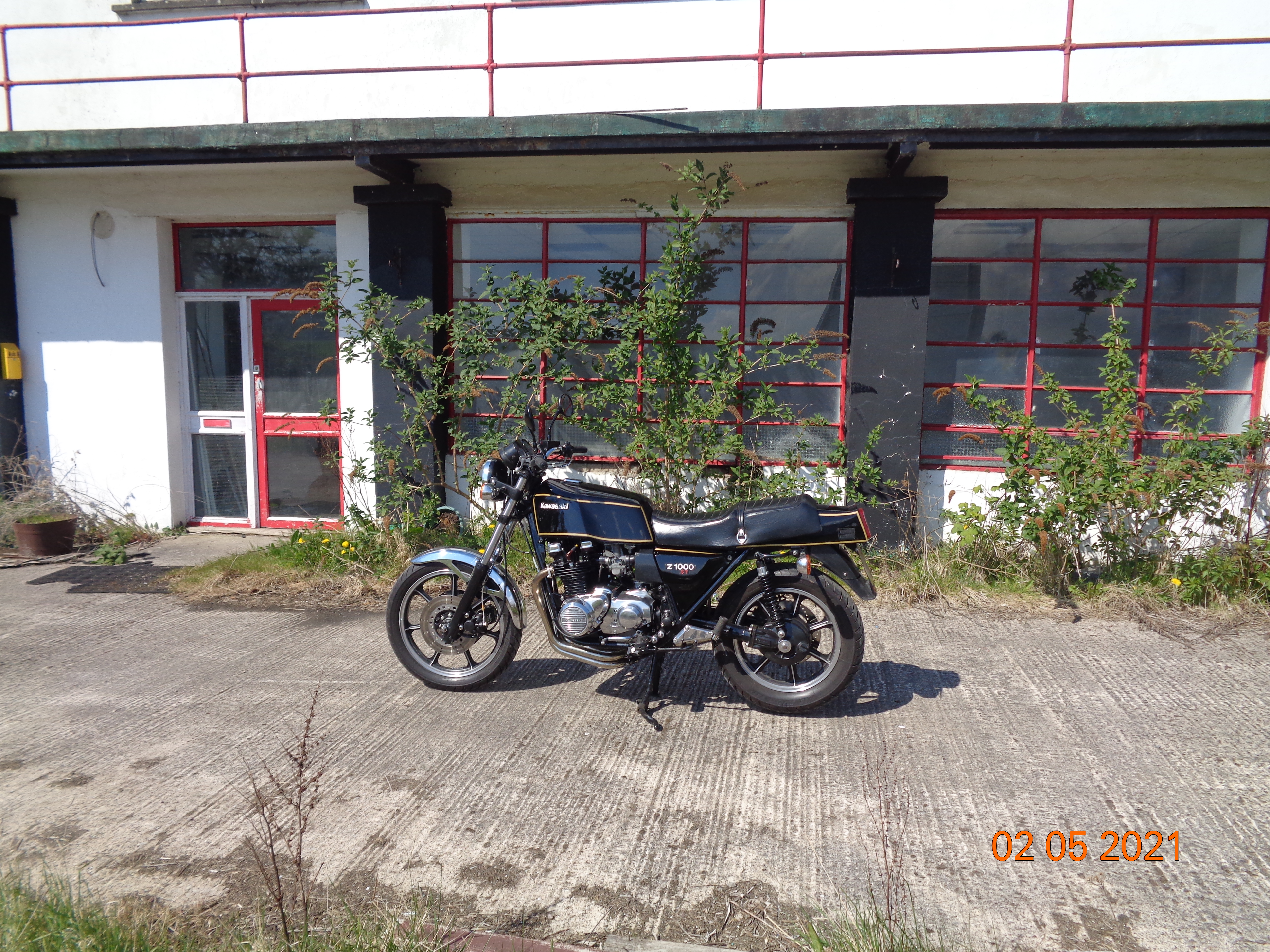

#102 PostAuthor: Dunlop4 » Sun May 02, 2021 6:58 pm
Took the ST for another shake down run today, up to 400miles. Engine starting to loosen up.
Oil is leaking from the top of one of the fork tops.
