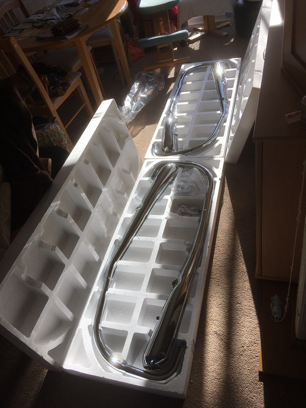

As reported elsewhere, the Delkevic exhaust set arrived on Friday, all present and correct, but now stashed in the attic, as I can't fit the pipes until the bike is off the crate and on its own centre stand.

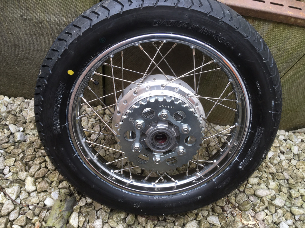

Before the bike comes off the crate, first I need to fit the back wheel. A plan to fit the back tyre came to nothing when I unwrapped the inner tube that came with the bike. Oddly it was another front one, 19". A suitable 18" Michelin tube has been ordered off the bay of fleas.

#94 PostAuthor: MrDavo » Tue Apr 06, 2021 11:51 am
The whole job got held up because of the sticking gearchange, see the help thread for details of that.
Now that has been resolved and the trans cover, footrests etc are back on, time to make some progress with the rear end. I fitted the new BT46 to the rear wheel, which had been rebuilt by Hagons. I was surprised how quickly I got the tyre on, not Moto GP standards, but quick for me, using the right lube and experience helps (no smutty giggling at the back, thankyou). Here is the back wheel, a new set of damper rubbers and ready for the sprocket carrier.

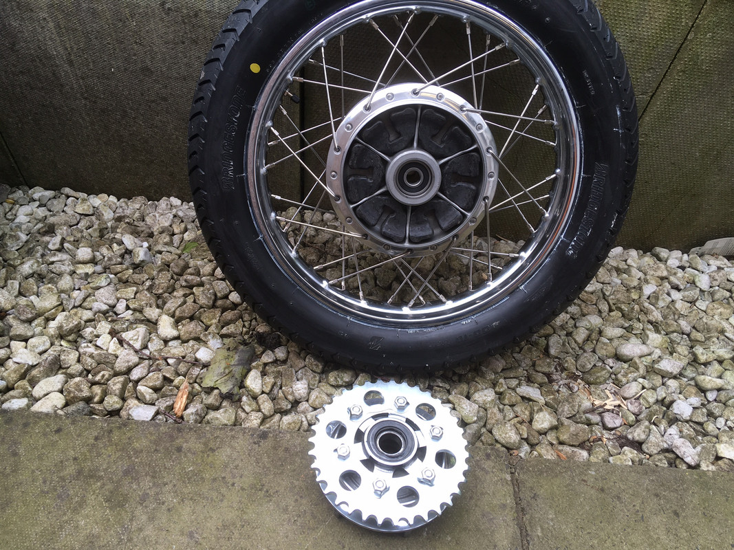

With the sprocket carrier and rear brake fitted, ready to go in. although the first pair of locking tabs for the sprocket nuts were done with a hammer and screwdriver, after some thought I did the rest super neatly using a socket drive extension.
Wheel in place, at last the bike looks more like a motorcycle than parts of one. All went in straightforward, but I can't fasten up and get the bike off the box until I have the stoppers that bolt into the end of the swing arm (ordered from Z Power). The spindle has to come out one more time as the marks on the chain adjusters are in the wrong place, I didn't know there was a wrong way round for these until they were!

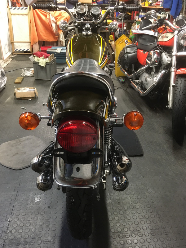

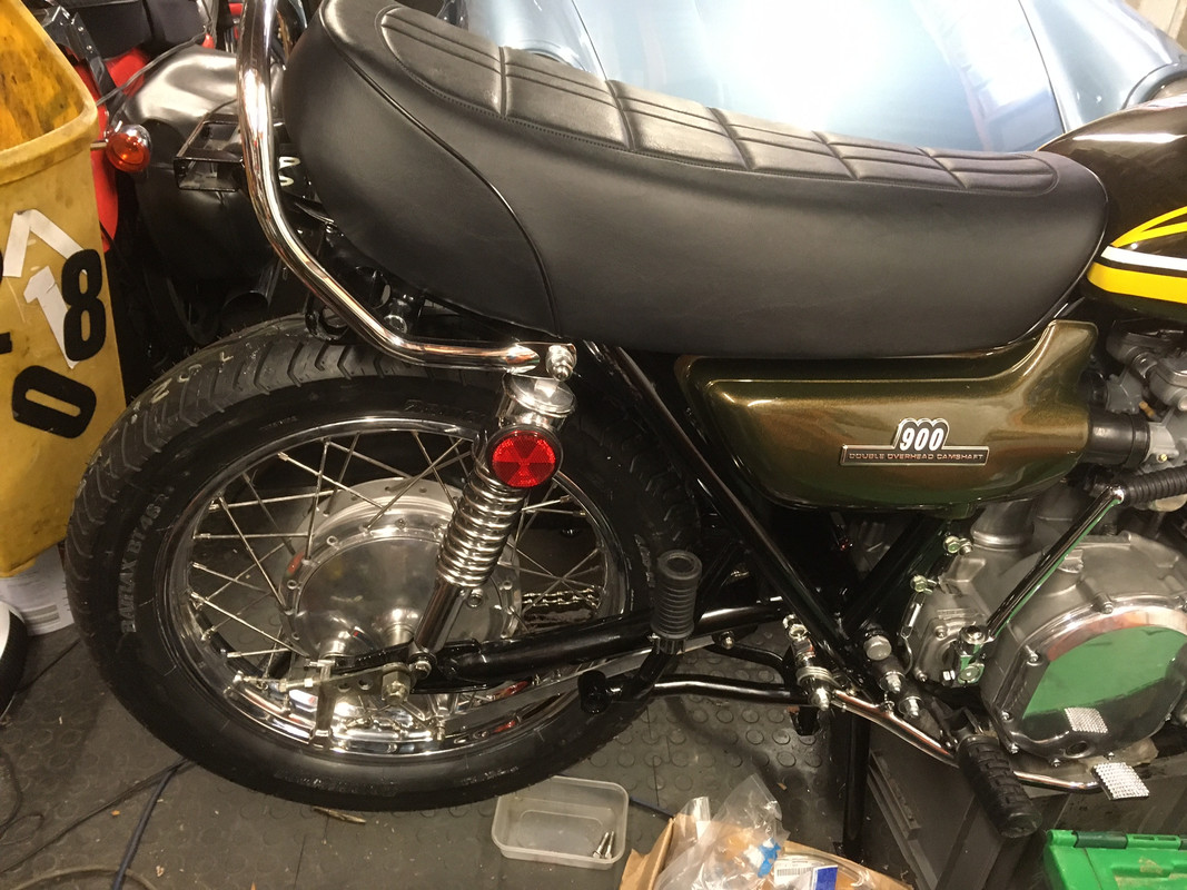

Next are the rear indicators and mount the tailpiece properly, then the rear light. I've also been weighing up batteries, my other 2 bikes both have Motobatt ones, although I did notice another brand of gel battery that looked a lot less yellow. Also I have to rebuild the fuel tap, I have an O ring kit ready.

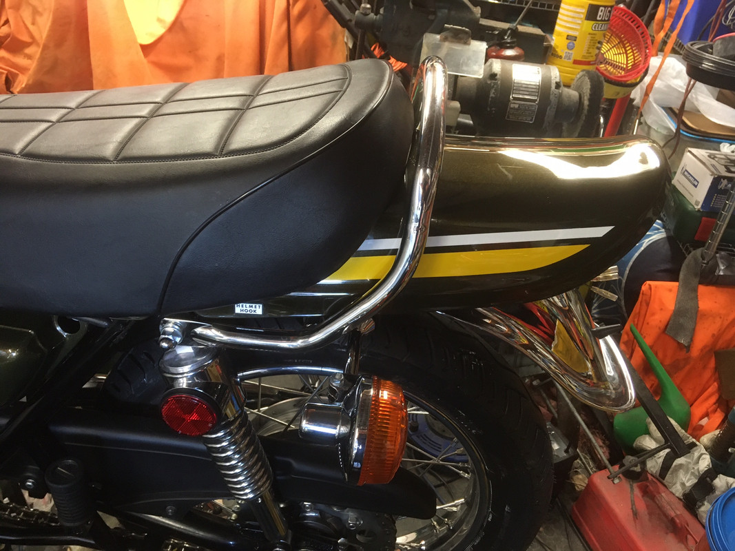

This weekend I have practically finished adding parts, there is mainly setting up and snagging left to do, plus the exhaust and oil once the bike comes off the plastic crate that I've built it on. First I got the rear ducktail finished, stickered up and fitted, complete with tray, rubber and wiring diagram sticker. I also got all the rubbers and washers in the right order to fit the indicators, plus I swapped the pattern lenses for real Stanley ones.
I cleaned up and fitted the rear light, which is the real thing, and date coded March 1974, matching the swinging arm. I fitted a new stop/tail bulb, from a box of new bulbs given to me by a mate who allegedly half inched them from Greater Manchester Police when he worked there! The tanks and r/h side panel were removed for safe keeping while I do the electrics and fuel etc, wrapped and put back in the attic. Now all the electrical components and wiring are in place I fitted the new battery, to see what we've got. It wasn't so good at first. The console indicator light came on, and went out when I put her in first gear, so that's the neutral light in the wrong place. Also I had the oil light lit, the horn parped, and a brief poke of the starter turned the engine, but only for a second as there's no oil in yet.

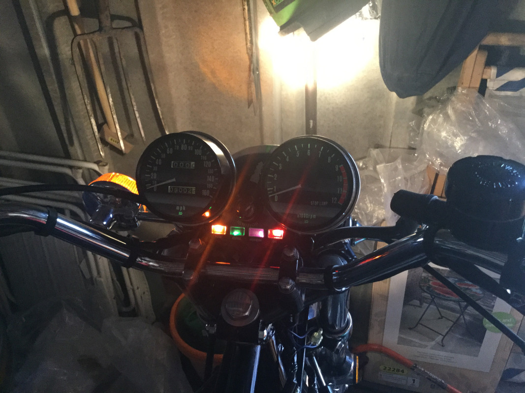

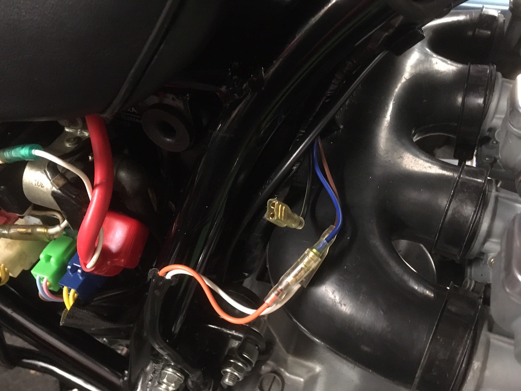

That however was that, no lights or indicators at all! I was a bit hacked off about this. I never expect everything to work perfectly first time, but as all wiring and switches are brand new and connected up, I expected more, and was unsure what to try next.
Later I got curious about an unused yellow and black (earth) lead with a female spade connector, that pops out of the loom at the same place as the brake light switch wires. Its in the middle of the photo below, there was nothing at all obvious to connect it to, so I'd just left it.
Acting on a hunch I temporarily connected it to the the battery, and everything worked!! :D I made up a lead with a spade at one end and a loop at the other, and connected it to the earth point on the engine. I crimped and soldered the joints, as losing your lights at speed is no fun at all, as I have learned by experience. Anyhow, I now have a full selection of lights, clock lights, indicators, plus brake and idiot lights. also the red brake lamp warning lights up when you apply the brakes. The lights go slightly dimmer when I turn the ignition on at the kill switch. Again, I don't want to check for sparks at the plugs until there is oil circulating.
The only issues to be sorted are firstly the neutral and indicator warning lights need swapping around, to do this I have to take the headlamp and clocks off before I can get at the console. Secondly, although I don't have a pilot lamp yet (on order) the headlamp lights up when the bar switch is in the PO position as wellas when it should. There's some funny business with blue wires from the switchgear that plug into each other, in an undocumented way, over and above the wires that use the white block connectors. I'm guessing that's where my problem lies, but I'll wait till I have the pilot lamp fitted before I start to play around.

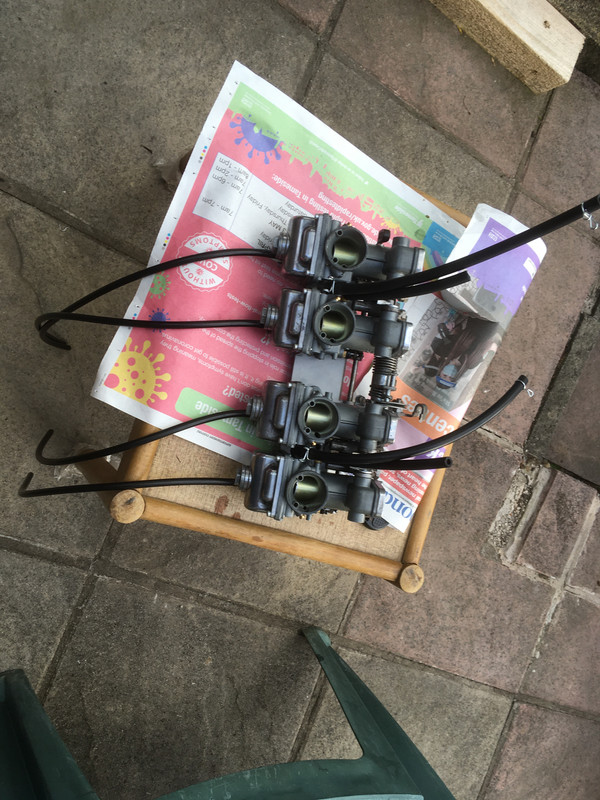

The drama I had with the float levels finally sorted out, and the slides bench synched, here are the carbs, complete with pipework, about to go back on the bike.

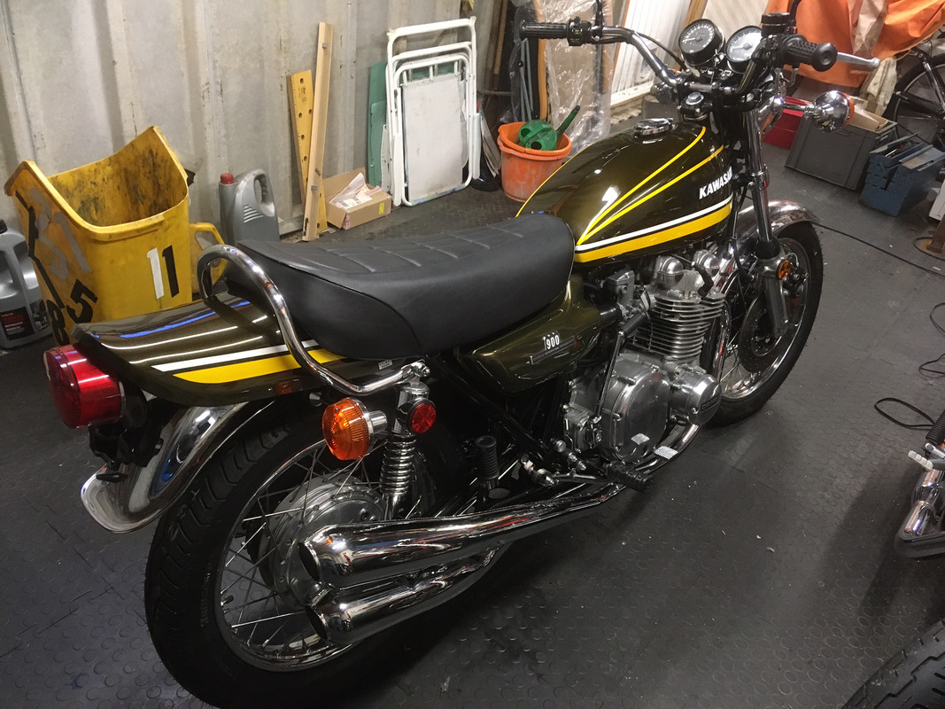

I got to the stage where to do the remaining jobs (oil & filter, fit the pipes and sort the front brakes) I needed to finally get the bike off the grey plastic box that I have built it up on. I gave my mates a ring on saturday, and behold! we have a rolling chassis (well, with dragging font discs due to the wrong pads). The box is looking a bit worse for wear but surviving well considering I've built a Harley and a Z1A on it.
I didn't have an oil filter to fit when the fame and engine went on the box, so I've been unable to turn the engine over at all. I fitted the filter, and chucked 4L of 10/40 in, and started to turn the engine. I took the plug out of the oil gallery, and peered in. No sign of oil, worrying, my CB750 had dramas at this stage due to an airlocked pump - I had to prime it with Vaseline before it would work. This time I pressed the starter and suddenly the oil light went out. Looking down there was a welcome pool of oil on the floor, from the oil gallery, so I put the plug back in, and at last could turn the engine over in search of sparks. I also fitted a set of the little plug lead number tags, from PMC.

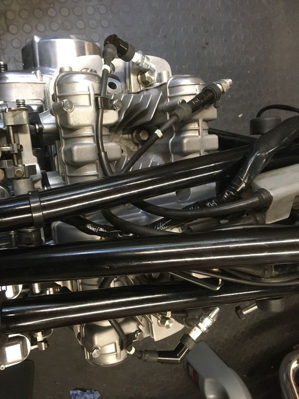

Happy with that I fitted the plugs, next I got the tank out of the attic again to sort out fuel. A big disappointment here, despite new O rings, my genuine fuel tap does not understand the concept of 'off', fuel still drips through. This seems quite a common problem, some research reveals OEM ones to be unobtainable, and most cheap replicas to be a waste of time. I did read however that PMC have upped their game, and found a better source. We'll see, I've had to order one, not much option other than a real cheapo one that I know will be rubbish.
So no attempt to start her up yet, but I've put the exhaust pipes on. A couple of issues with bolts too short, and nuts that don't match the thread on the long bolts, but here's a sneak preview, better pics when I can drag her out of the garage at last. Note that the plastic box is now in service as a box again, with all the remaining Z1 bits. When I bought the bike it filled five large boxes.

#104 PostAuthor: MrDavo » Tue May 25, 2021 10:37 am
Thanks for the advice about the exhaust bushes, I finally got these sorted properly last night. All I need to do now is to sort the front brakes out, and fit a non leaking petrol tap, then I can see if she fires up! Once ready I'll fit the number plate and get some insurance so I can start to run the engine in. I am watching my emails like a hawk, waiting for notification that the tap is on its way.
Thanks also for the comments, I took these photos yesterday when I was maneuvering the bike to the back of the garage, so I could get my car back in out of the rain.

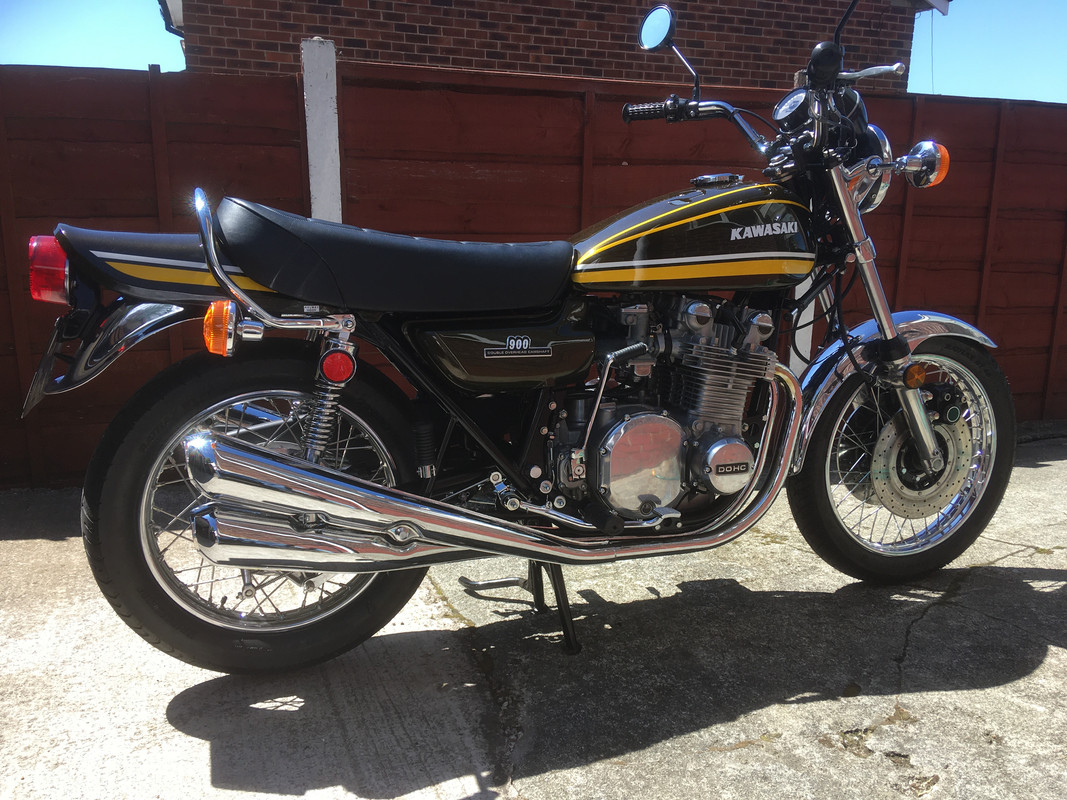

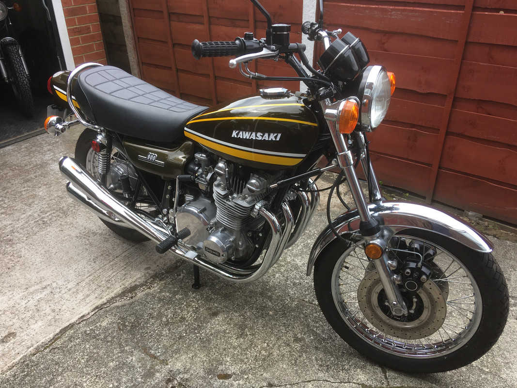

Fuel tap fitted Friday, I tried to start her on Friday evening. Much to my surprise, she started straight away, and was soon warm and running off the choke.
Saturday she was dragged into the sunlight for the first time, for the first test.
I also got the see the metal flake in the paint 'popping' in the sunlight.
A couple of trips around the block, to check it all works, and then off for the first ride. Here we are by the Holmfirth road at the site of the 'Isle of Skye' moorland pub. The bike ran smoothly, with a familiar whistle from the airbox, similar to my Triumph Daytona 1000 four.
Number 4 header was a little straw coloured when I got back. scared of irreversibly blue pipes I whipped the carbs off, and applied a smear of silicon under #4 carb manifold, and tightened the clamp screws tight. No more yellowing, and I polished out most of what there was. I'm running her in by the book, and changing up at 4,000 rpm for the first 500 miles. We are now at 160 miles, she runs a little rough below 3k, not sure if that's because we are on the verge of stalling or if the setup isn't quite there yet, also if you set the tickover at a particular temperature, if it gets hotter/colder it won't tick over that well without using the throttle a little bit. I'm hoping to get the timing strobed and the carbs vacuum balanced ASAP, we'll see how we are then. The wife isn't coming pillion while running in, she wants me to get on with it, so we can 'go for a blast' on her first ride out.
