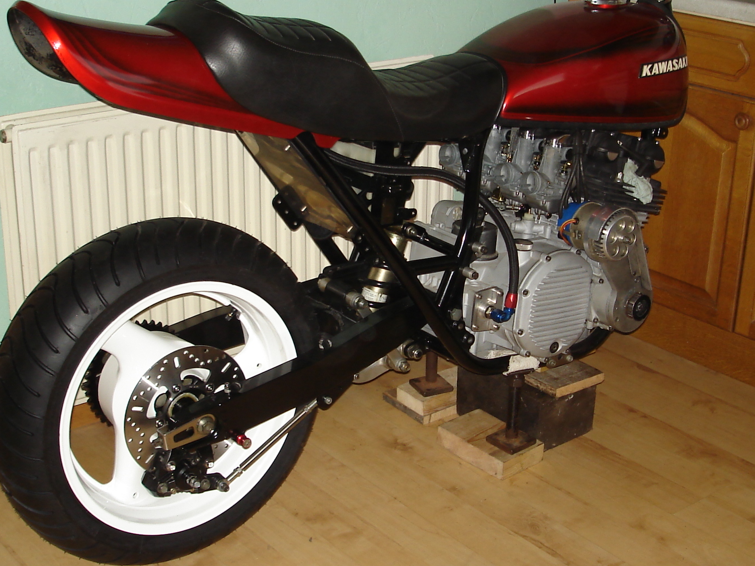

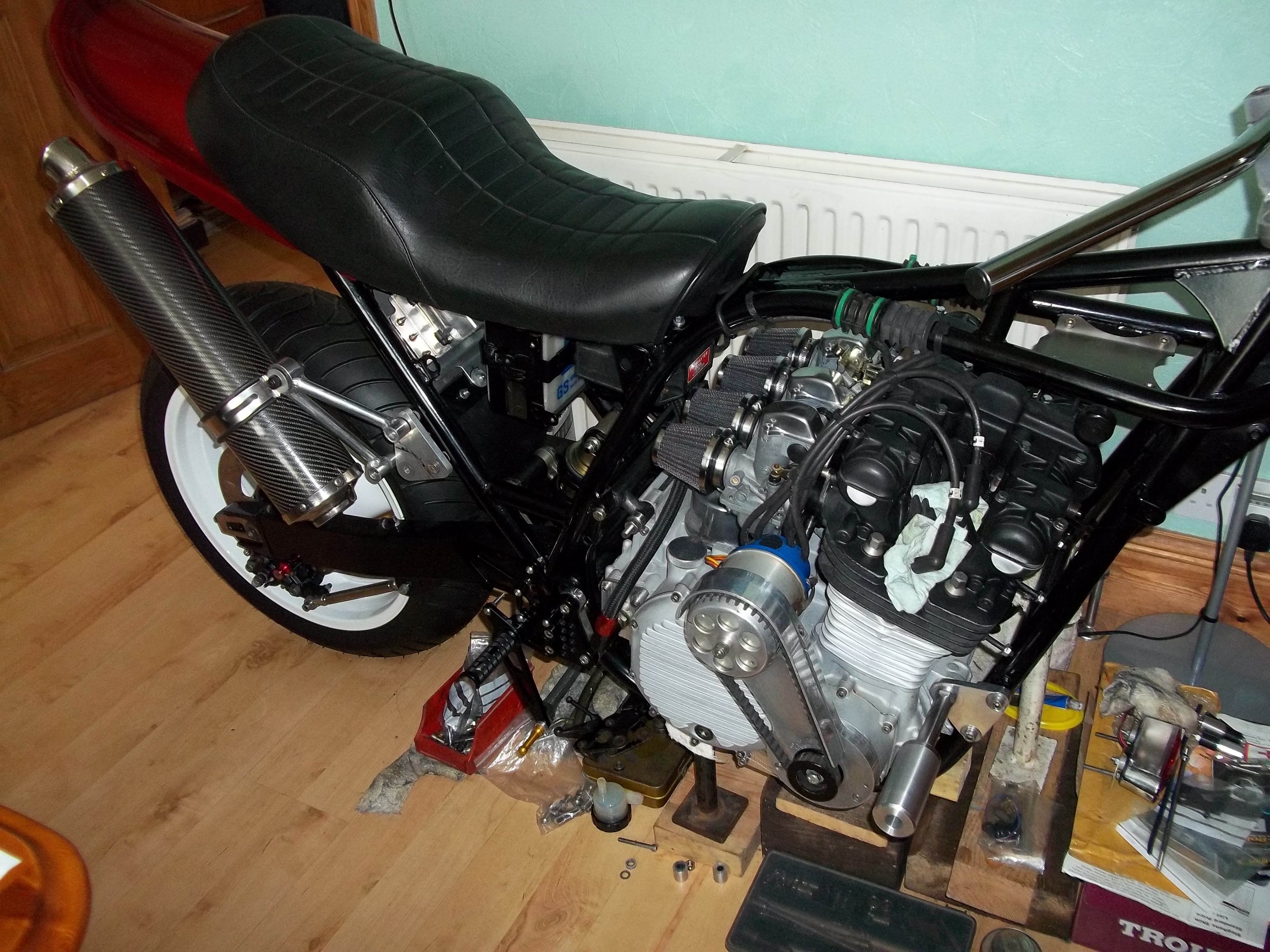

Without backtrackin' the last year, time to restart afresh.
Most recent pic of whats in the kitchen

#2 PostAuthor: Crofty » Sat Jun 11, 2011 8:53 am
Well done on keeping us up to date so quickly, like what your doing, Crofty

#3 PostAuthor: Padders » Sat Jun 11, 2011 10:28 am
If the standard stays the same until the end then this is going to be a belter of a bike.

#4 PostAuthor: paul doran » Sat Jun 11, 2011 11:12 am
thats looks awesome

#5 PostAuthor: sanderz » Sun Jun 12, 2011 8:12 am
Thanks for the encouragement lads :up
Padders wrote:If the standard stays the same until the end then this is going to be a belter of a bike.
Cheers Padders - i'll give it me best shot.

#6 PostAuthor: GUYZED » Sun Jun 12, 2011 9:58 am
Looking very nice there sanderz...keep the pics coming.

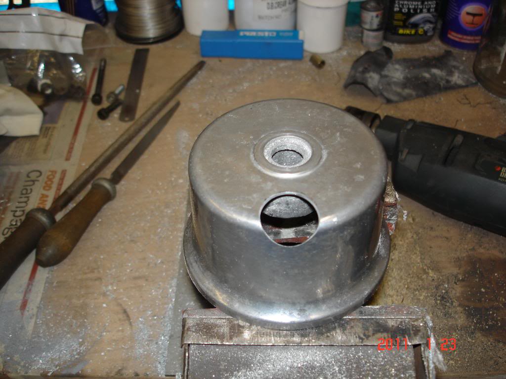

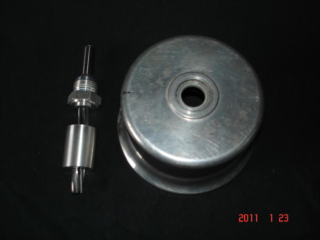

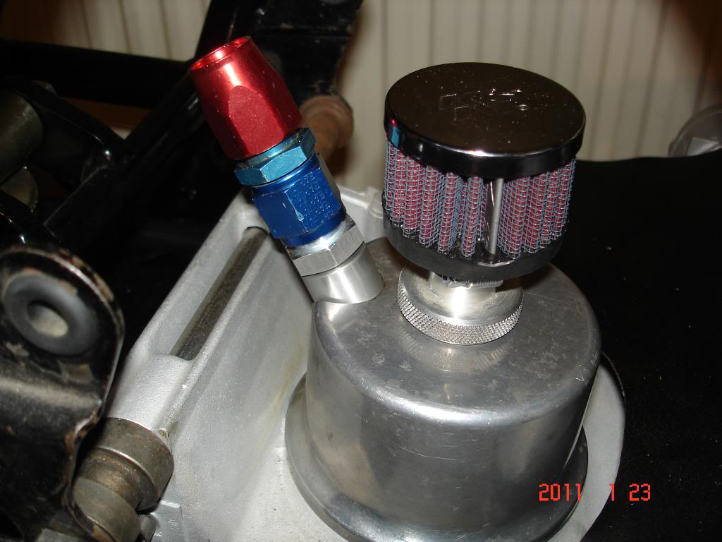

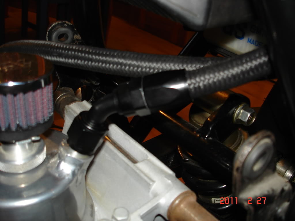

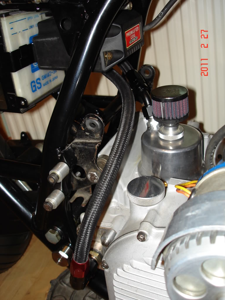

The Crankcase breather is now welded -
The start of the idea
Drilled
Trial fit
Welded

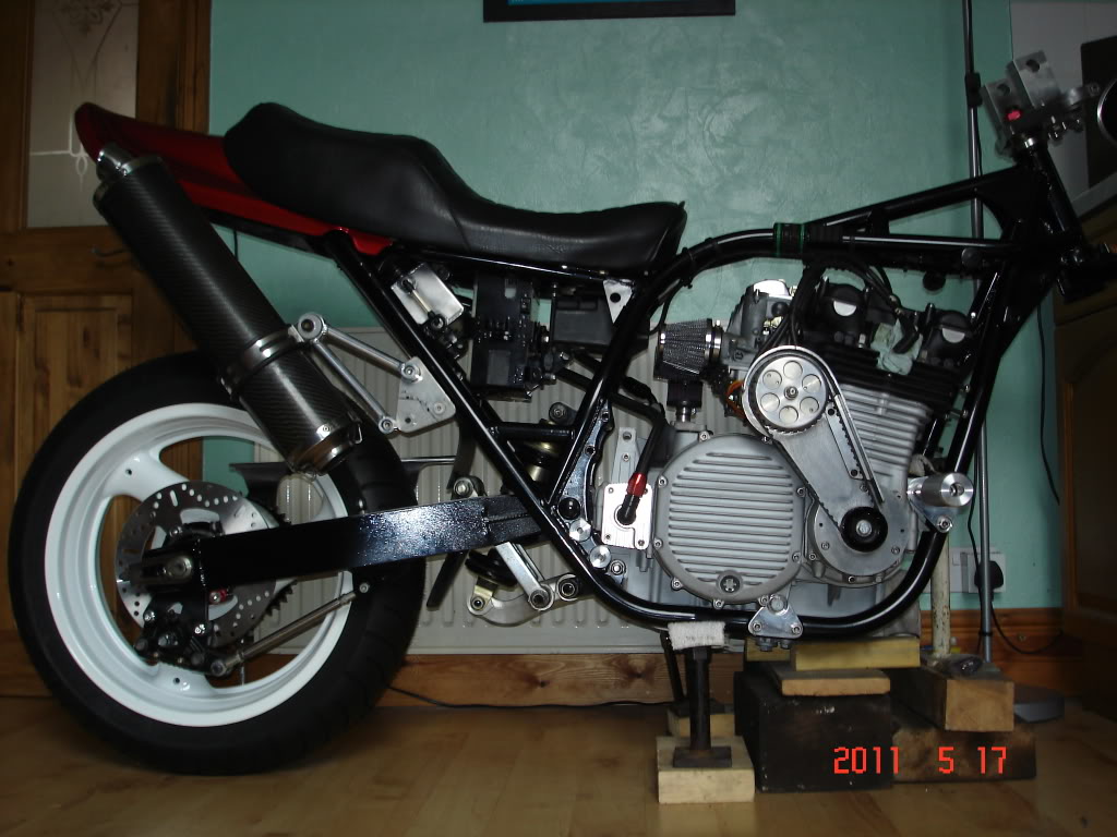

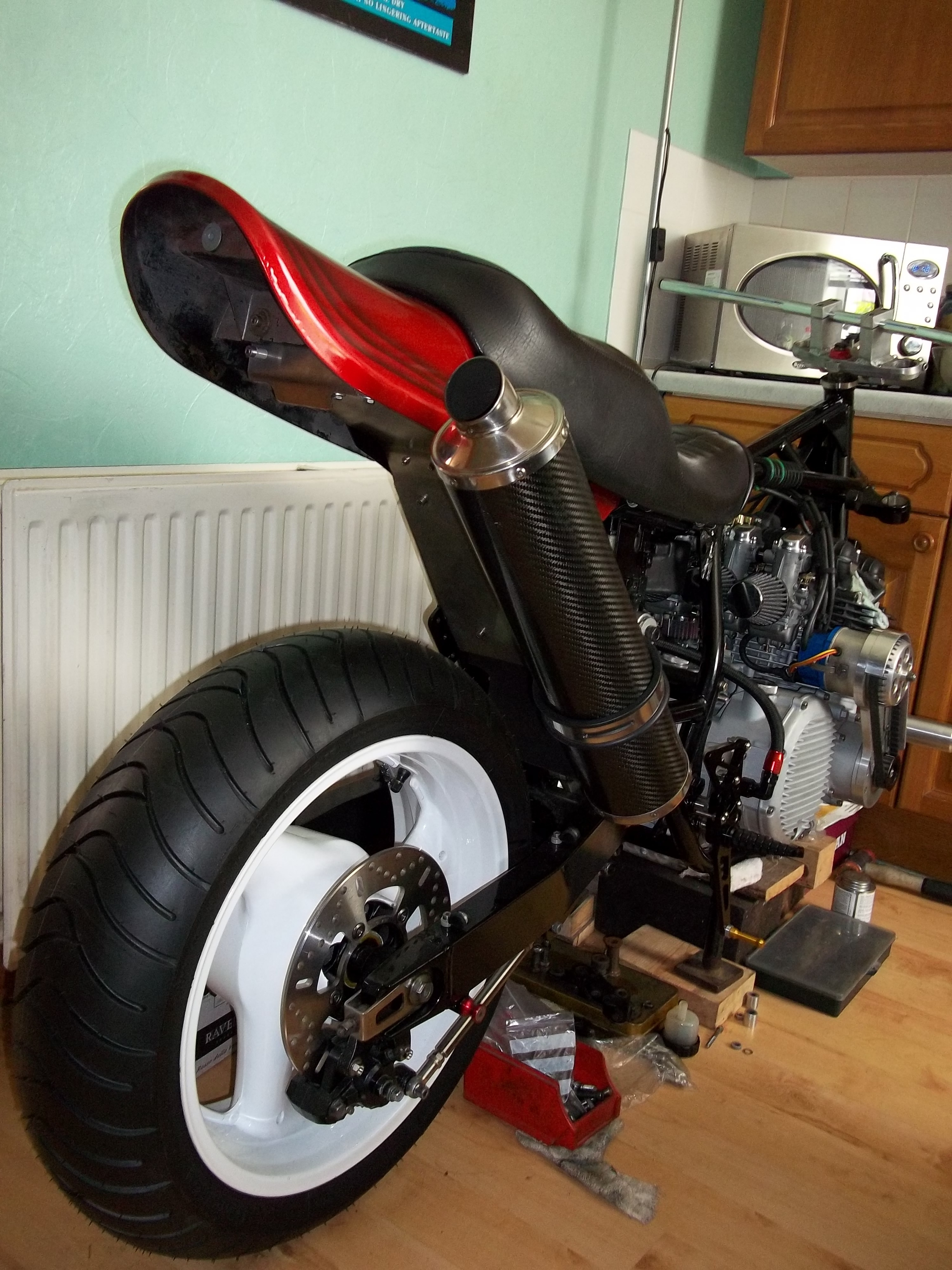

Anyhow to 'recap' on the build of parts used
Z1B of 75 vintage - frame braced & delugged, rear upward frame rails extended 3"
Rear end - GSXR 750L swingarm and linkages,1100M wheel FZR 1000 Monoshock.
Front end - FZR 1000 Genesis ('88 41mm forks) with welded & bolted 3" risers on FZR yolks

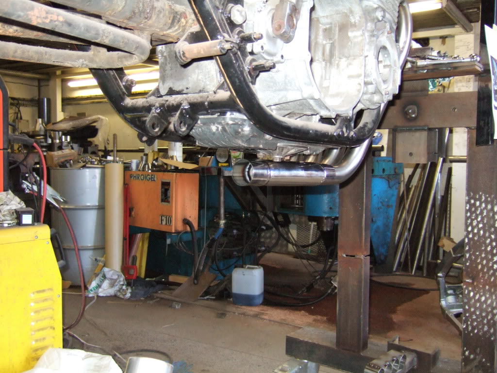

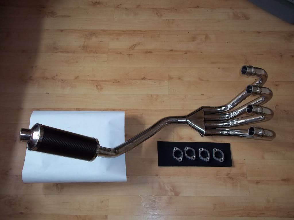

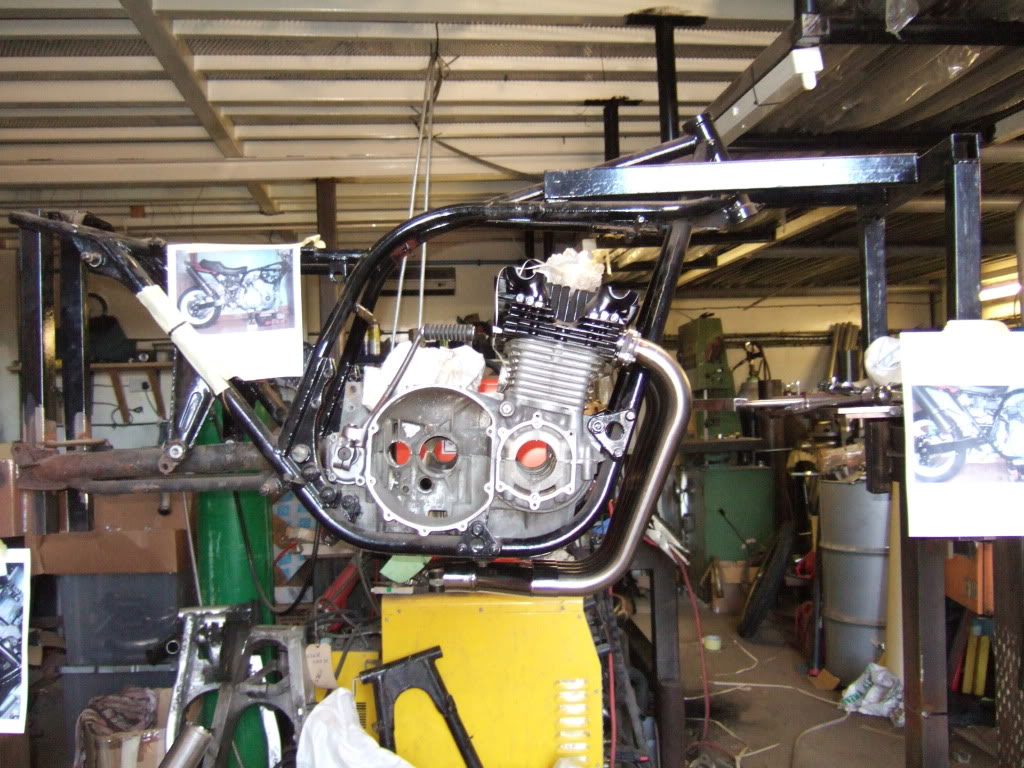

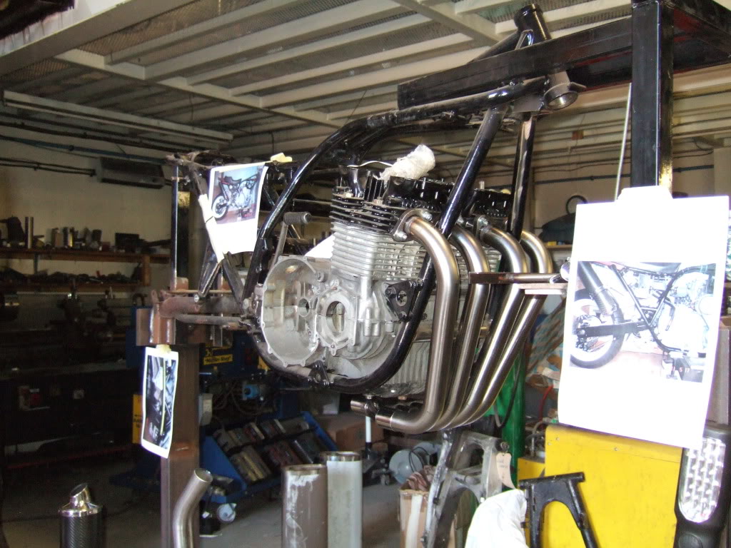

In work' at the moment is the exhaust.

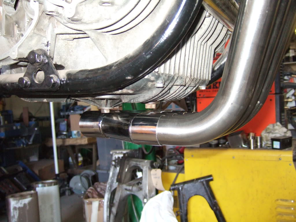

Exhaustcraft is currently making the pipe, which i believe is the first Zed he's made with a flat collector - main reason for this requirement for me, was ground clearance with 17" wheels.
Dave sent me these pictures of progress -

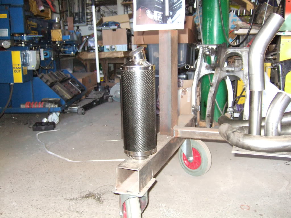

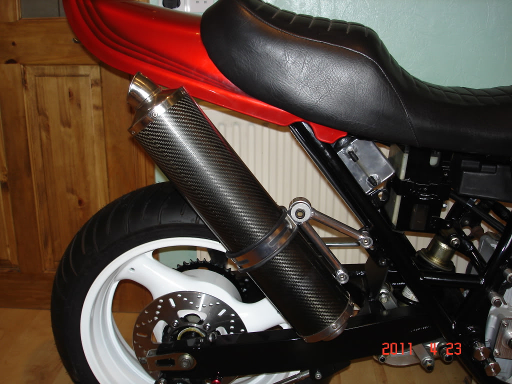

End can has been shortend from this -
To this -
Exhaust in the making -

#9 PostAuthor: sanderz » Fri Jul 08, 2011 9:42 am
Well impressed by the quality of workmanship.

#11 PostAuthor: Mr Puffin » Fri Jul 08, 2011 5:50 pm
Very Nice Work :D The Flat collector looks Real good :brav like one of those Marving ones normally seen on German Zeds/GS`s etc, should give a good few needed centimetres of clearance

#12 PostAuthor: PJ » Fri Jul 08, 2011 6:45 pm
OOOhhhhhh Love that - the lines are just right, great work!!

#13 PostAuthor: Padders » Fri Jul 08, 2011 6:47 pm
Very Very nice exhaust

#14 PostAuthor: GUYZED » Fri Jul 08, 2011 10:32 pm
That pipe looks awesome...bet it's going to sound brill.

#15 PostAuthor: sanderz » Fri Jul 22, 2011 10:30 am
Related background -
http://www.youtube.com/watch?v=vEjUQ15l ... re=related
Yeh Instant Karma when this arrived last week. Quality job from Exhaust Craft, i'm well chuffed with it :up

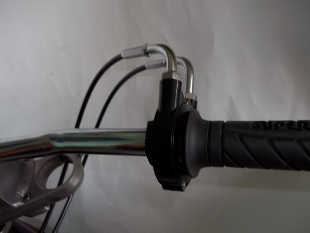

Makin' room in the workshop, movin' 'shite' around - never throw owt away tho' :oops: found this in one of the many tins -had a little chuckle to meself (easily pleased & who says the drugs don't work :lol: )... if memory serves me right, i'd bought this around '81 from Hadleigh Custom - anyone remember them?
Still in reasonable condition, bit of a clean up, add some Z1R cables & away yer go -
