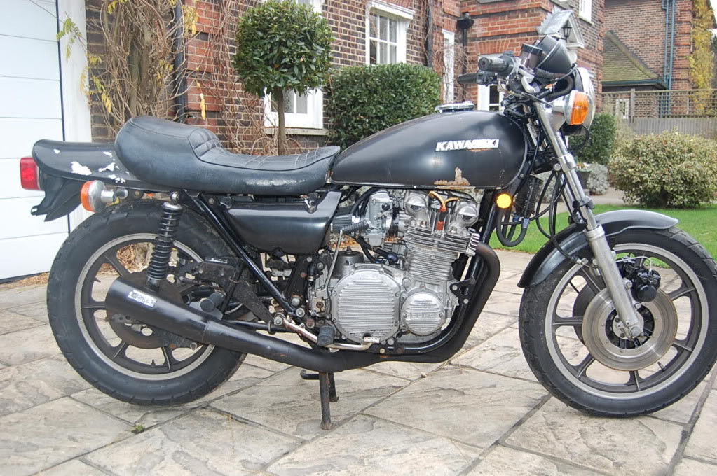

This is my 'new' bike. Having owned it for all of 5 days now, there are some interesting features (other than the fact that it doesn't run). Some previous owner has spent money upgrading it. It has:
2 front discs (1 was std in the US)
Kerker exhaust and K&N filters
Unidentified alloy wheels
Somewhat crude rear disc conversion
What looks like an aftermarket oil cooler
Finned engine side covers
....and an engine with no serial number. I guess the crankcase has been replaced at some stage. I have no idea what's inside, and probably won't get time to dismantle it until next year.
I am going to focus on the frame and suspension first. Have looked into Japanese swingarms but 1) horrifically expensive and 2) no chain guard mounting. I think I will buy a Kipkawa S1 arm instead.
Still trying to get a price for Ohlins forks but Harris have suggested XR69 replica forks with Ohlins internals, which will look more original.

I think you bought well. :up wheels look like Morris mags,fingers crossed :wink: Take a plug out and shine a torch down there,hi comp' pistons
Take the cam cover off and look for I.D on camshafts.
P.S. I like the seat :D

....and an engine with no serial number.!!!!!!
Id get that sorted sooner rather than later,
