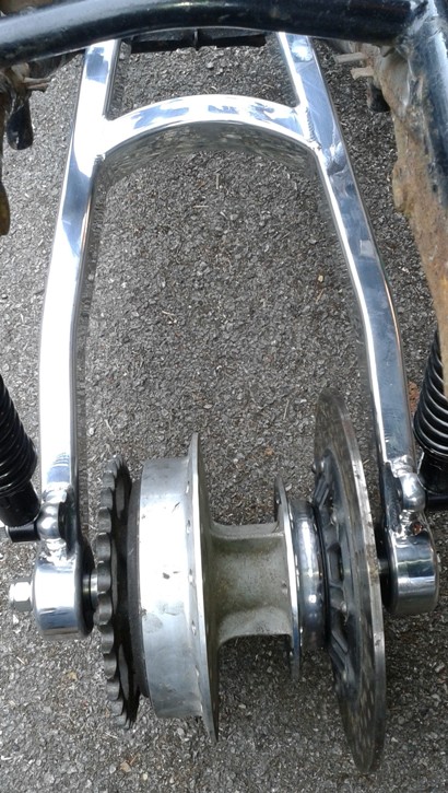

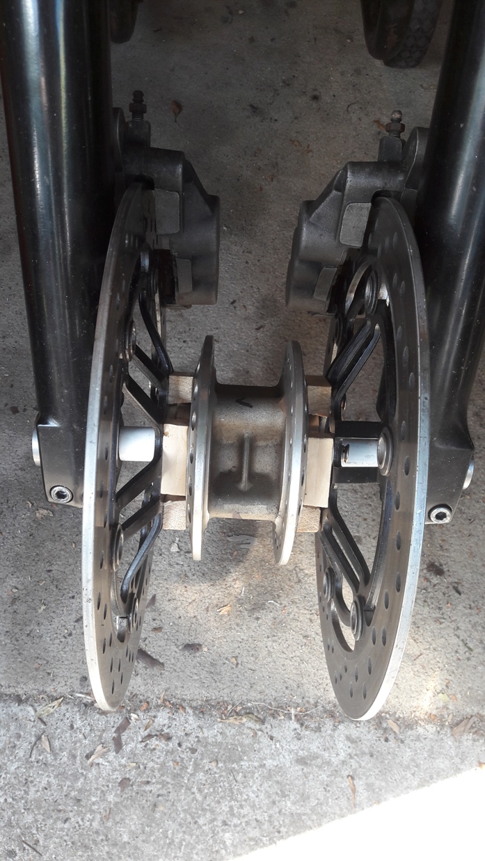

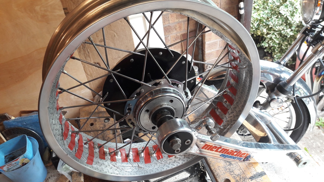

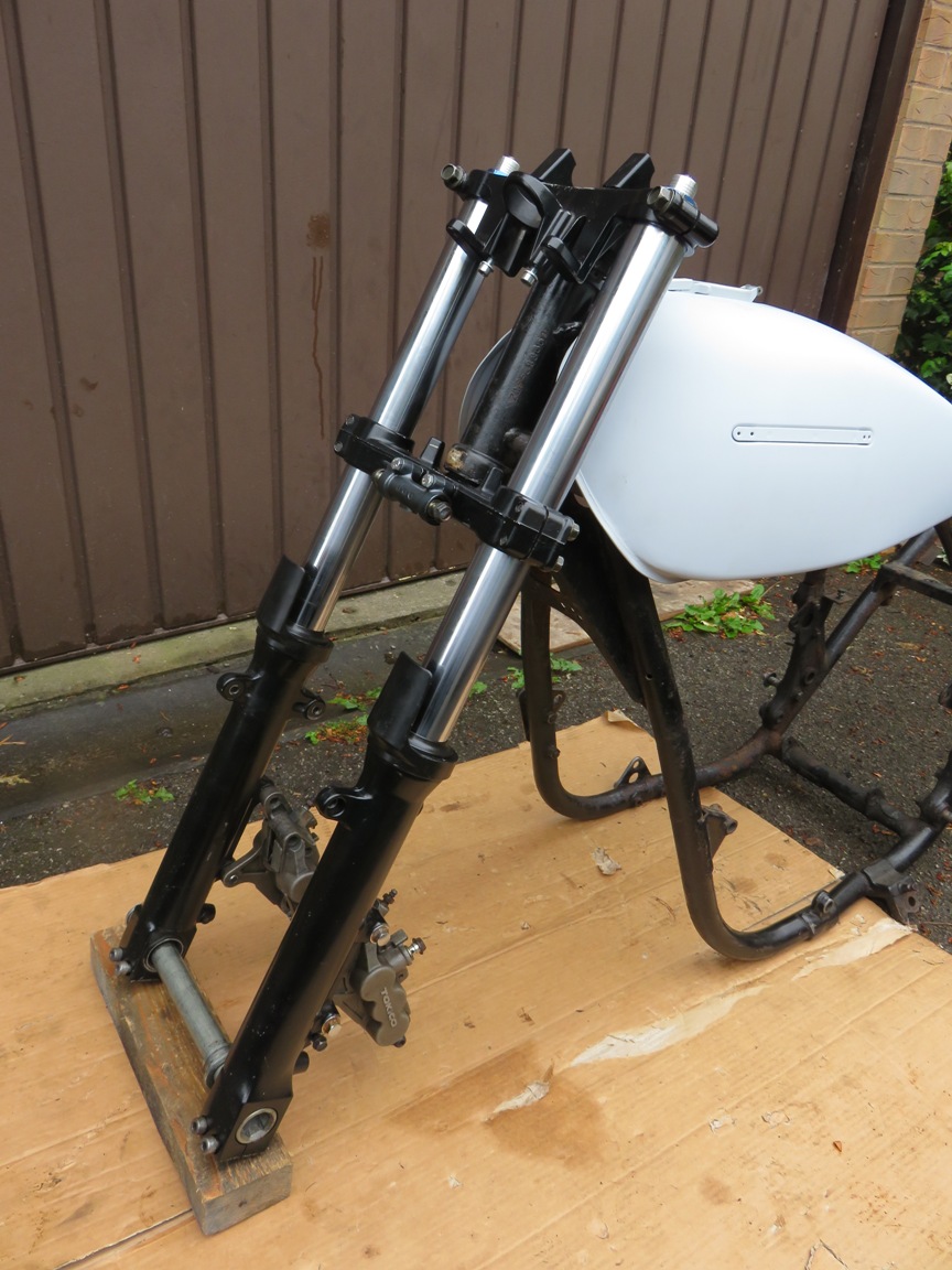

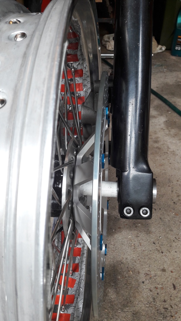

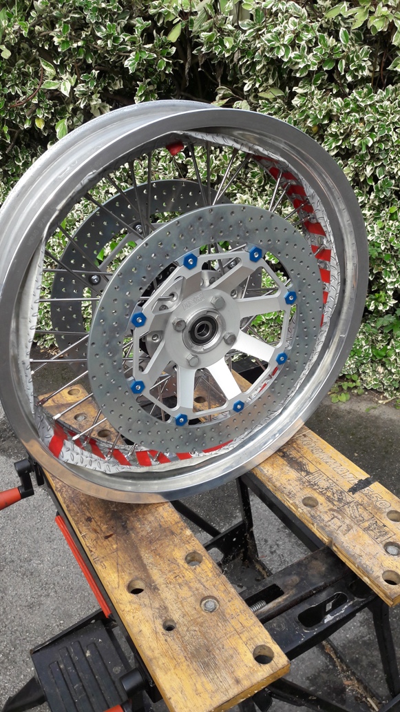

In April this year I decided that if I don't make some progress I never will! So I have started the build. Here are some pictures of progress to date:-
Replacement ZRX forks and brake calipers:-
Front wheel mock -up
New front wheel with discs
Front end mock-up with new wheel
Swing Arm and rear axle arrangement
Rear wheel in swing arm
More to come, but hoping to get some tyres fitted once I am happy with the wheel rebuild.
