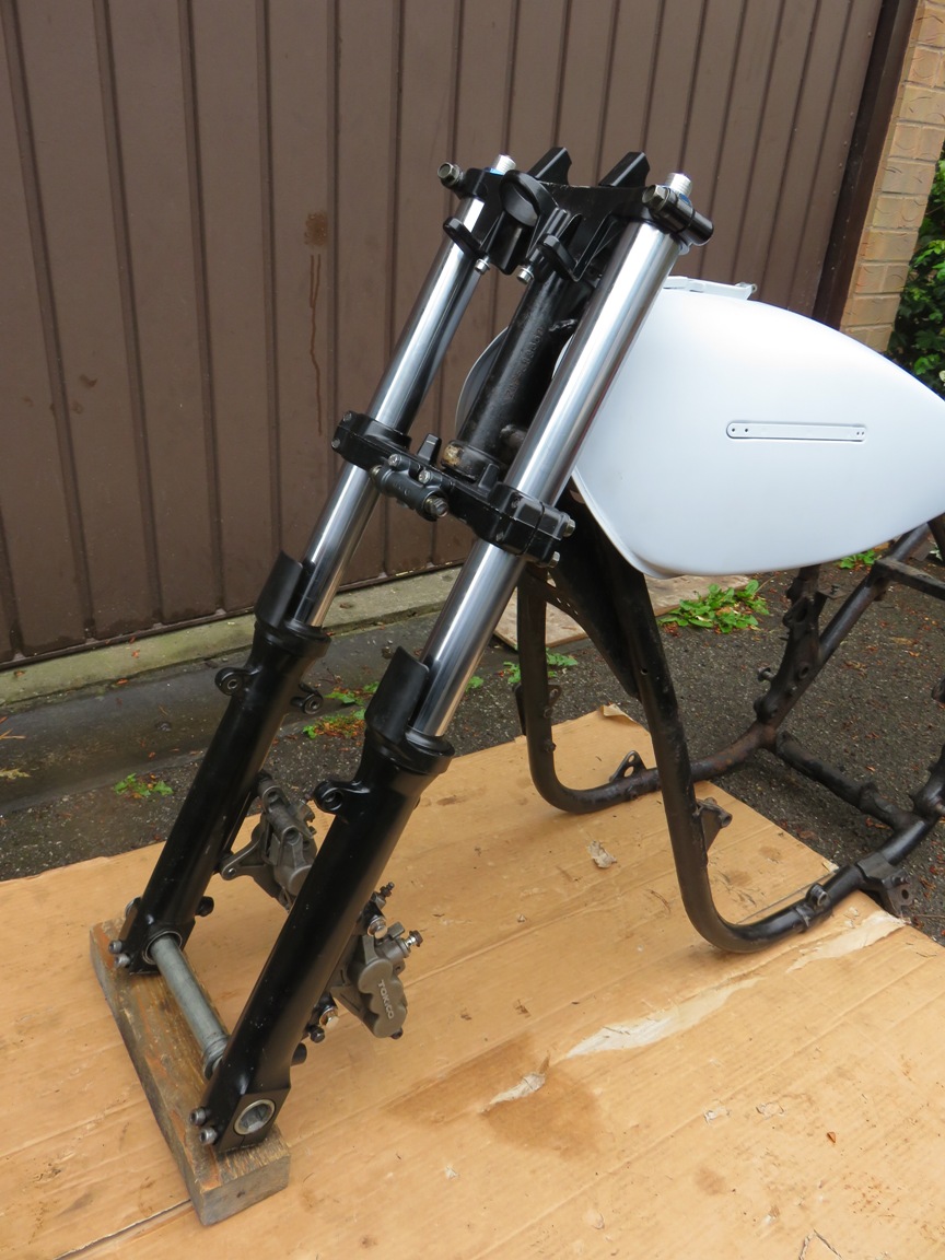

Replacement ZRX forks and brake calipers:-
