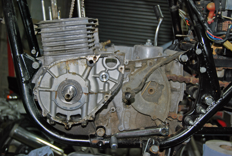

Not content with one Zed it's time for another to keep the Ltd company.
Picked up this little beauty - which does require a little attention.
Some investigation shows it's a June 1975 build.

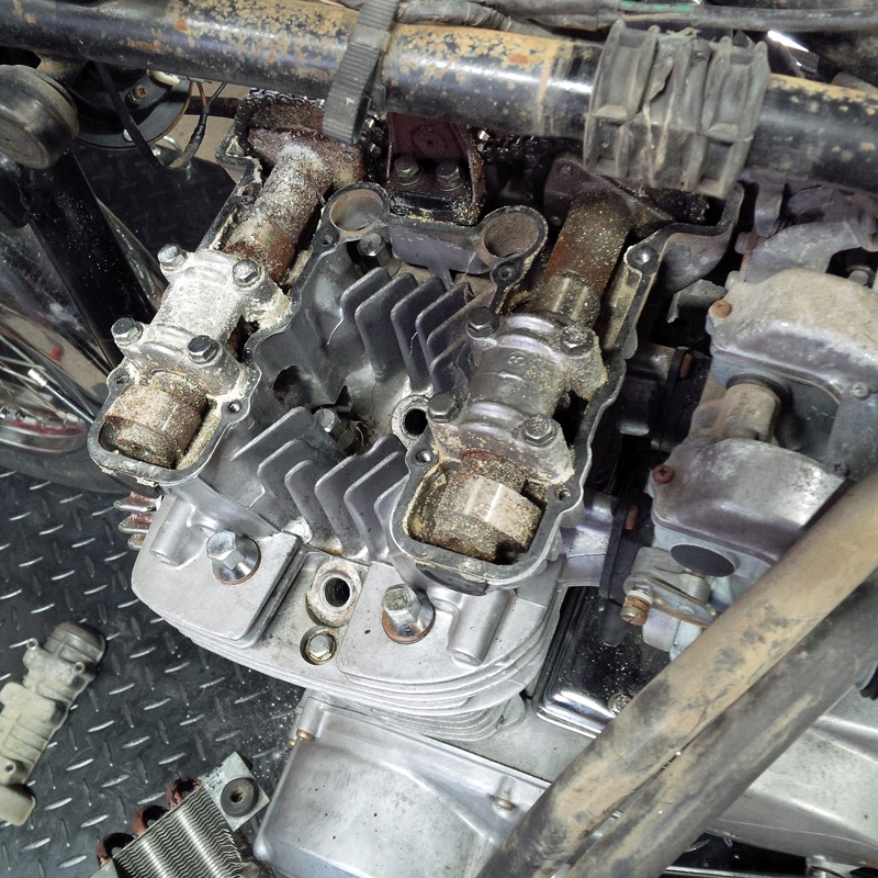

It's always a tad worrying when there are no plugs in a motor that won't turn - but it was cheap.
The motor was locked solid, cam cover off and what wasn't covered in corrosion was very clean and showed little sign of wear.
With the centre idler removed the inlet cam would turn - but the exhaust cam and crank were stuck fast.
I think this is the reason the bike was retired from use, well you can't really miss it!!!!
Still won't turn though - Mmmm - pistons are at matched heights, soaking in plus-gas at this time as #3 bore was red rusty.
It was nice that every bolt on this motor was original and looked untouched, they all came undone without drama all the threads are clean, no helicoils this time nor any silicone gasket or loctite, even what was left of the oil was clean (ish).
I know these motors have a reputation for being tough - but I'm expecting at best a bent crank, I'm surprised the cam cap wasn't broken.
Going to take a while this one...

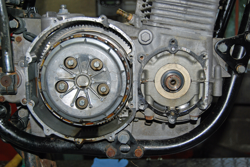

Things are going fairly smoothly with the strip down, the generator cover took some determination to remove.

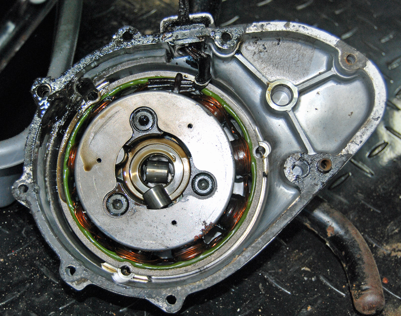

Not a screw head was marked - well they were after I removed them.
Interesting the rotor coming off with the cover – the bolt was loose in the cover - crank woodruff key in place and not broken.
(I removed the screws in the generator ring to get the bolt out before the pic was taken.)
Nothing amiss with the clutch, all looks good - no advance mechanism when I removed the cover - the points plate looked new (ish).

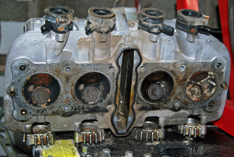

The picture doesn't do the head justice - it should clean up well.

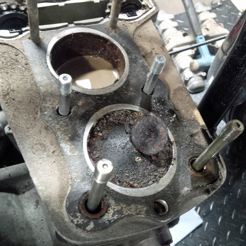

As suggested the valve head must have come off due to a timing issue.
There are no deep gouges from the valve head bouncing around, the seat looks rusty but ok, the guide is not split.
Plenty of surface corrosion in #1 and #4 combustion chambers.
#3 exhaust valve is rusted open - nice!

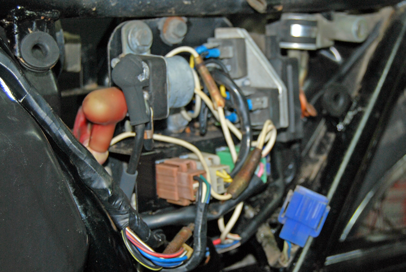

The strangest wiring set up I've seen - blue crimp connectors - Yuk!

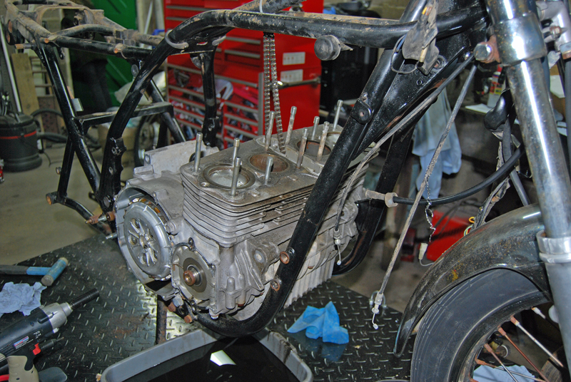

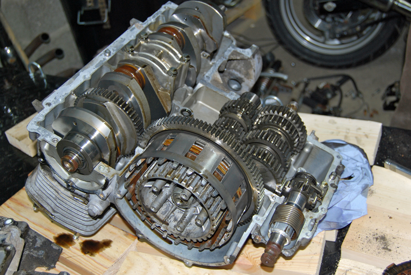

Stripped to a bare frame for ease of motor removal.
Frame ready for jigging - offside down tube is bent in and there's a crack on the front oil cooler mount to weld.
Unhook the front end and it's ready for flipping on its side.
With the frame lifted off a quick inspection showed no obvious nasties - nice and clean with no wear on anything, this hasn't done much work.

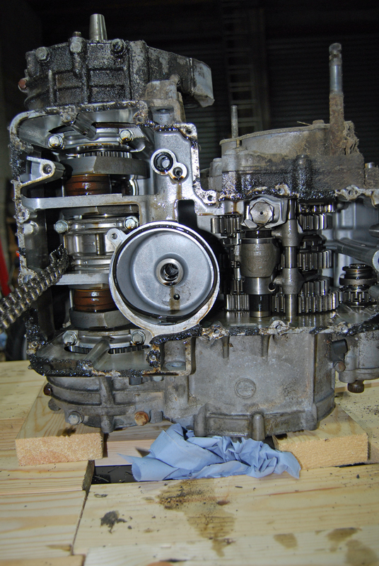

With the motor flipped on it's back it's time to separate the cases.

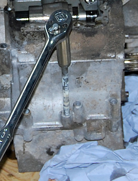

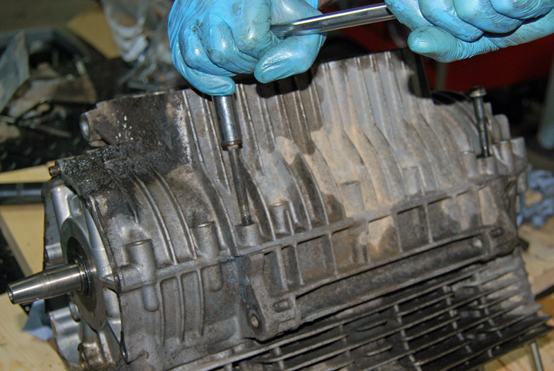

TIP! - For those that don't know - the three un-used threaded holes in the lower crankcase have a hidden purpose.
The threaded holes are usually full of crud, this will require cleaning out before you can use them.
Inserting a generously lubricated M8 bolt (I use the ones from the crank case) into each of the threads takes the worry out of splitting the crankcases.
They thread in and push on the upper crank case, take care to tighten them evenly to avoid over-stressing the lower case.
Make sure all the bolts holding the crankcases together have been removed - they are on both upper and lower sides.
Missing one of the M6 bolts of which there are loads - will result in a broken case.
The one at the back.
Very simple internals.
The size of everything is impressive, more akin to a car than a bike.
TIP! -The gearbox internals and kick start mechanism can now be lifted out, take care not to loose the bearing C clips that locate the gearbox bearings to the upper case.

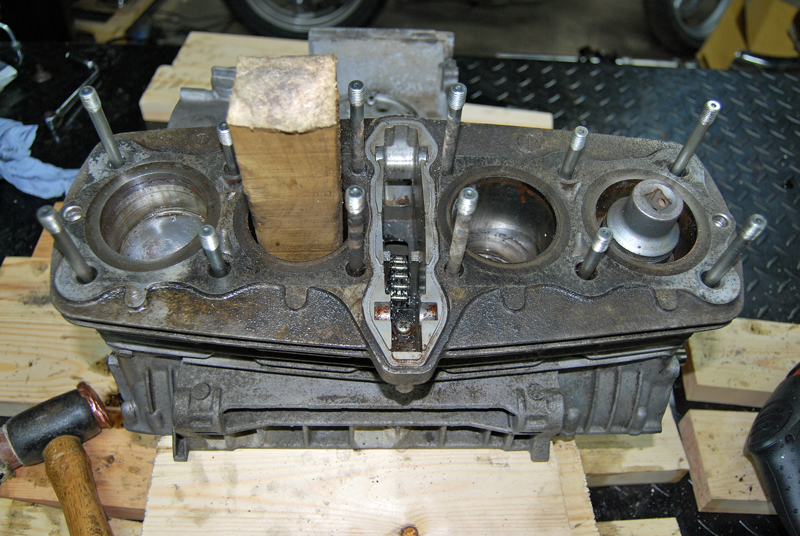

With the four M8 bolts removed from the centre crank support it's time to flip it over and remove the seized pistons.
With a large amount of heat and a bit of gentle persuasion - using factory tools :ws ......The crank falls out the bottom!
Off with the pistons and the crank is ready for overhaul.

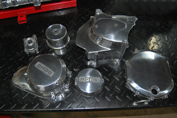

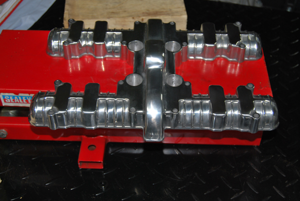

Popped down to collect the polished covers from Mikey, Jay1969 came along for the ride.
To polish the corroded Cam cover was a tall ask, I'm very happy with the outcome...
Stunning......
