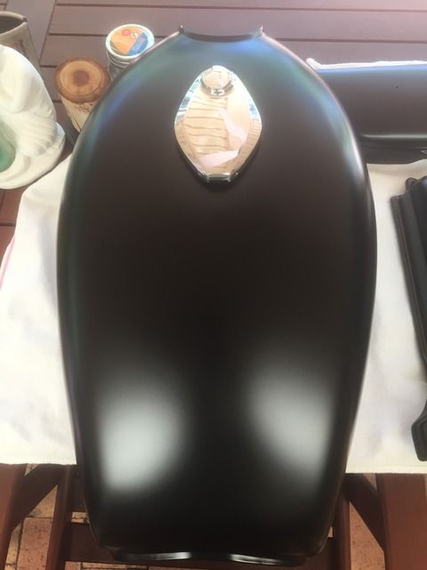

Not too much progress has been made apart from getting the paintwork back. Alas on inspection there was a hiccup with the tail piece and a very embarrassed painter has taken that bad to be redone. I have sourced a local bloke who does vapour blasting, everyone else I talked to said that its best to have the motor fully stripped for blasting whereas this guy does it fully assembled, So I am in the process of dowelling a few passages and making blanks fro the inlet / exhaust ports then its off for blasting,
Still looking at the frame, it doesn't look too bad, a light rub down with 400 then a touch up with rattle can should suffice for this build as it will be the daily. I'm a bit over the place with this one, nowhere near as methodical and organised as the MkII but meh what the hell.
A few pics of the satin black - :

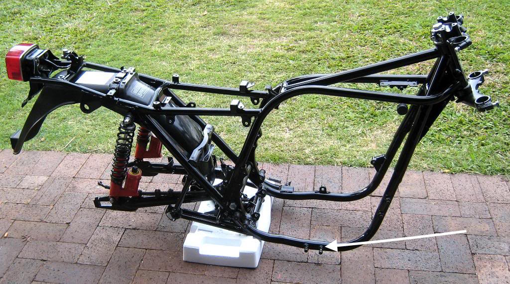

A little hiccup.
On removal of the motor I found one of the two bolts holding the right lower engine mount plate had snapped. Worse still was someone had 'glued' the bolt head onto the snapped portion FFS. And even worse still was a drill hole had been started that was completely bloody off-centre.
So step one - drill out larger and try an ezy-out but that failed. Step two was to drill it all the way out which took lots of patience and a few drill bits.
Now with he original guide hole being off centre I think too much meet has gone from the reel to be able to re-tap for another bolt. So two options
1. Use a long bolt that goes right through, flat washer, spring washer and nut then torque up
or
2. Grind the weld to tap out the threaded reel, source or machine and tap up a new reel and weld back in.
Is there any issue with using option 1 considering there is two support bolts and could even use a high tensile bolt. Didn't seem to be an issue with the bloody bolt head glued on.....
This is the reel ( or bobbin) I am referring too. - Pic lifted from the web because I forget about photos when drilling, hammering and cursing

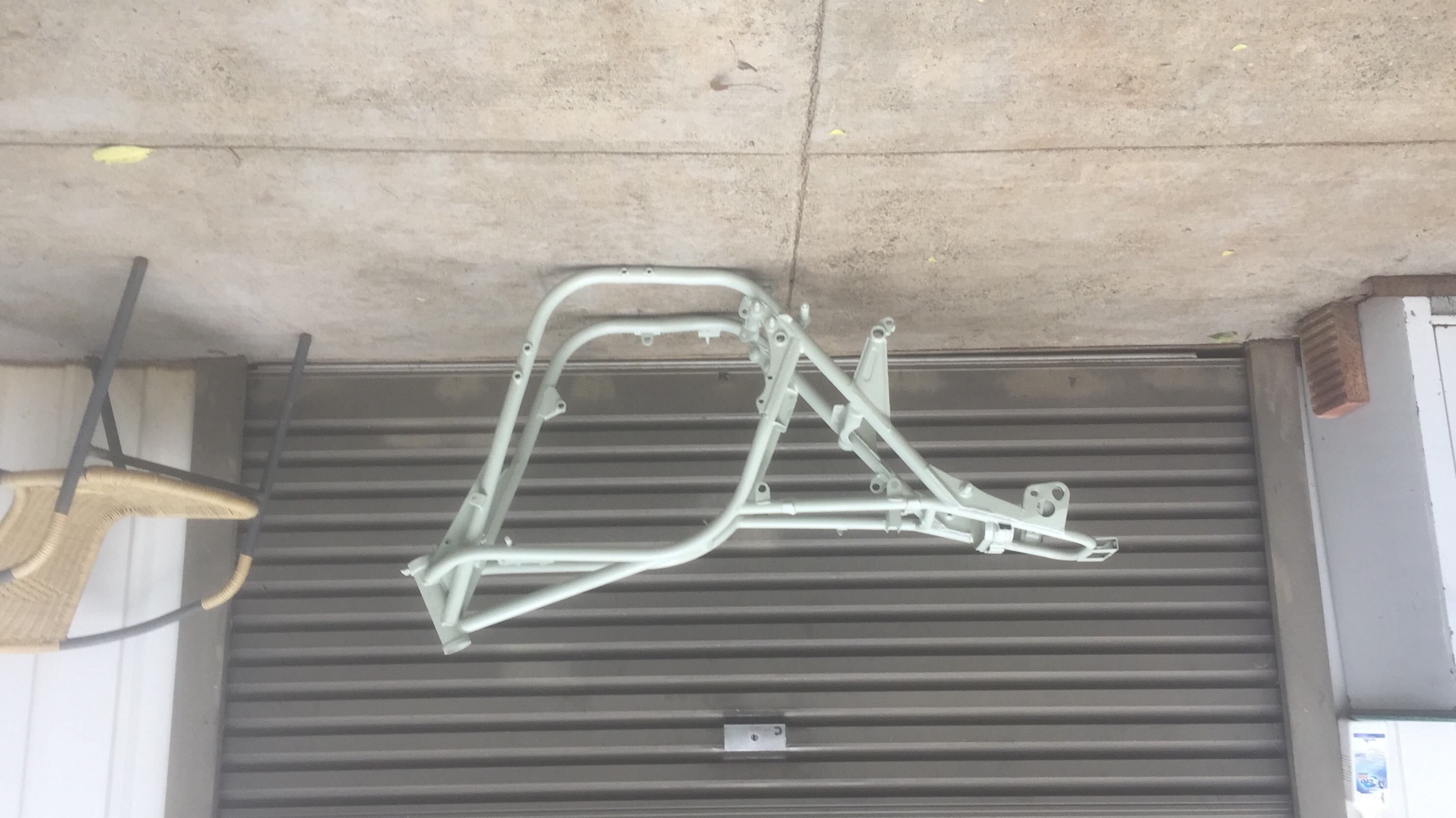

#6 PostAuthor: nicomkii » Wed Mar 22, 2017 12:25 pm

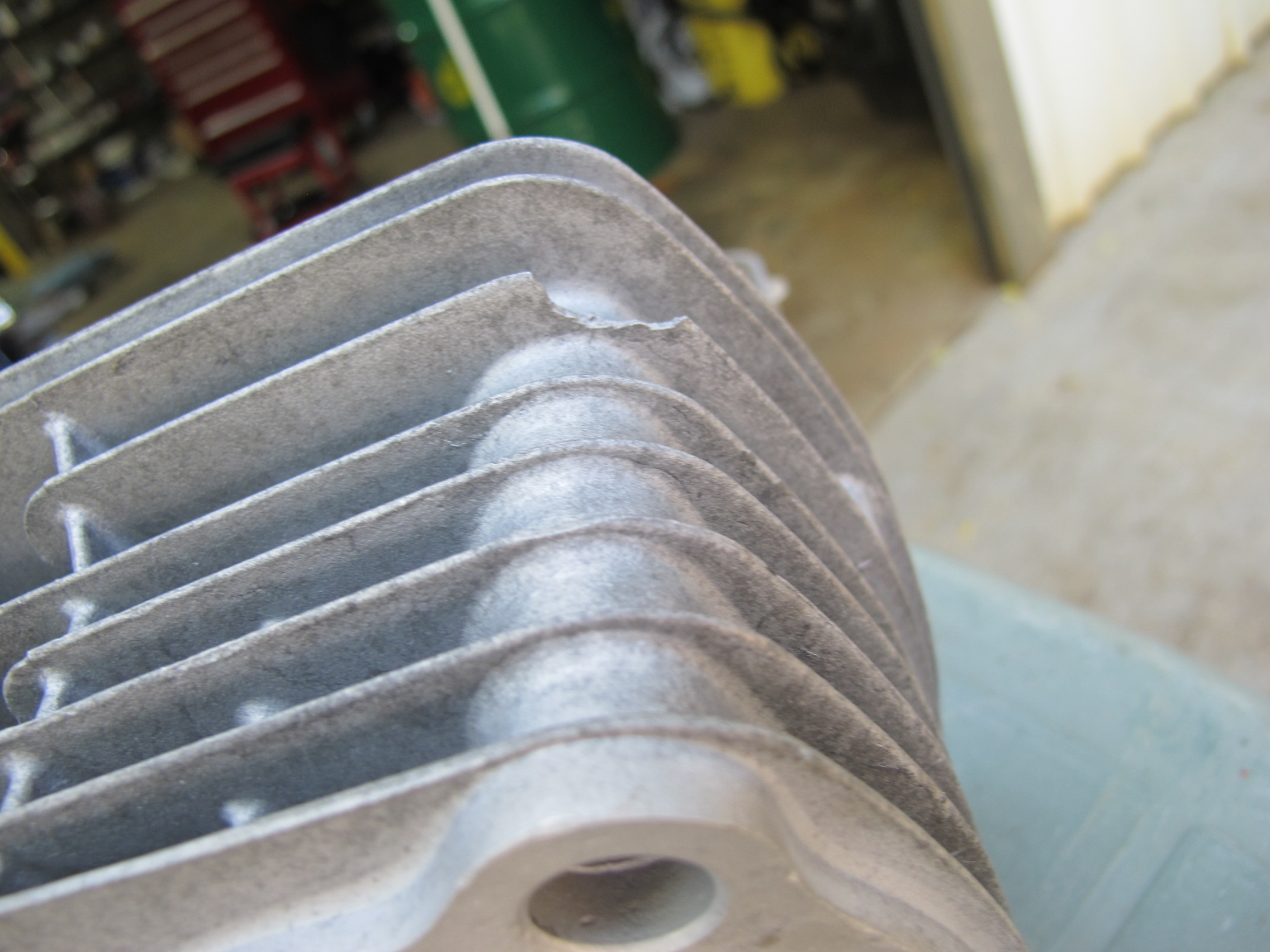

Things are moving along quite nicely, frame has been blasted and undercoated. Too much rain around at the moment to spray it with two pack, hopefully the weather gets better in the next week or so.
In the meantime the engine has been completely stripped, degreased and dropped off for vapour blasting. All internals look spot on, just one fin with a small break off to be built up. Also the raised part for the locking bolt on the tacho drive has snapped so will try weld that as well.
(** Don't know why the frame pic is upside down. When I click on it to expand it the photo is correct way up !! )

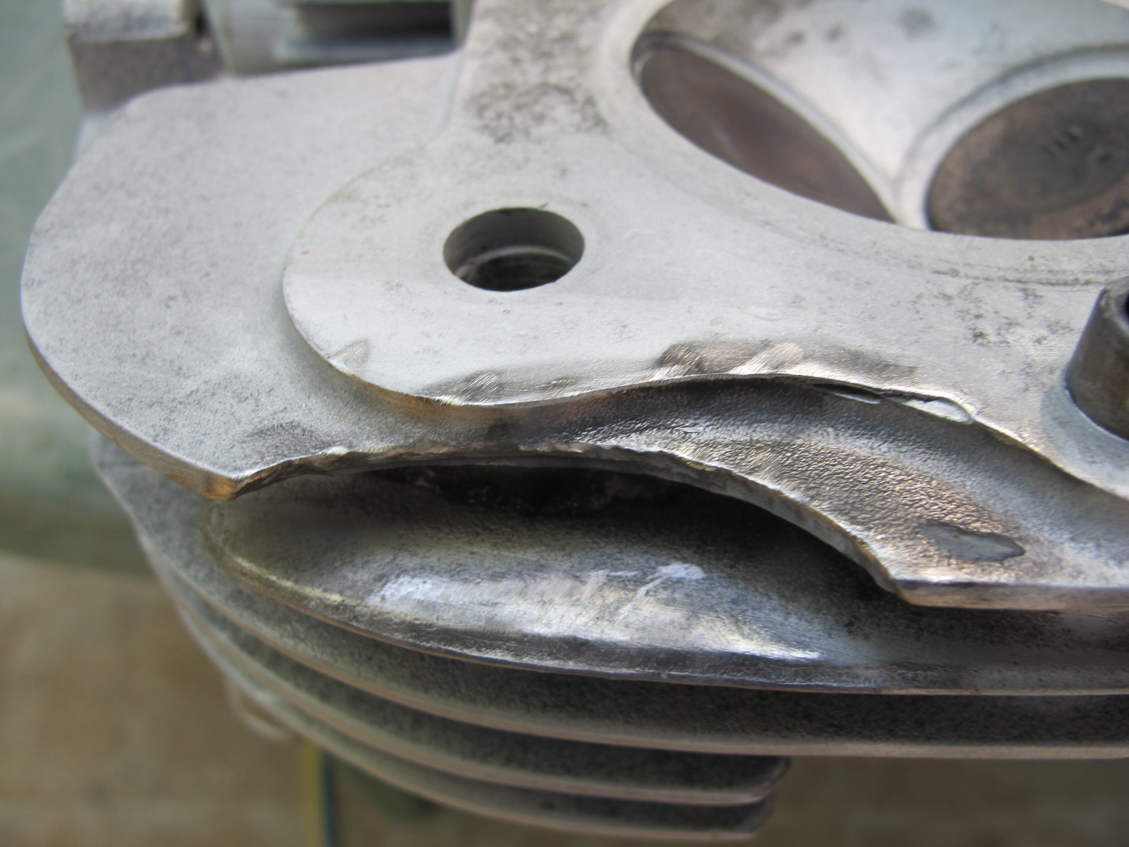

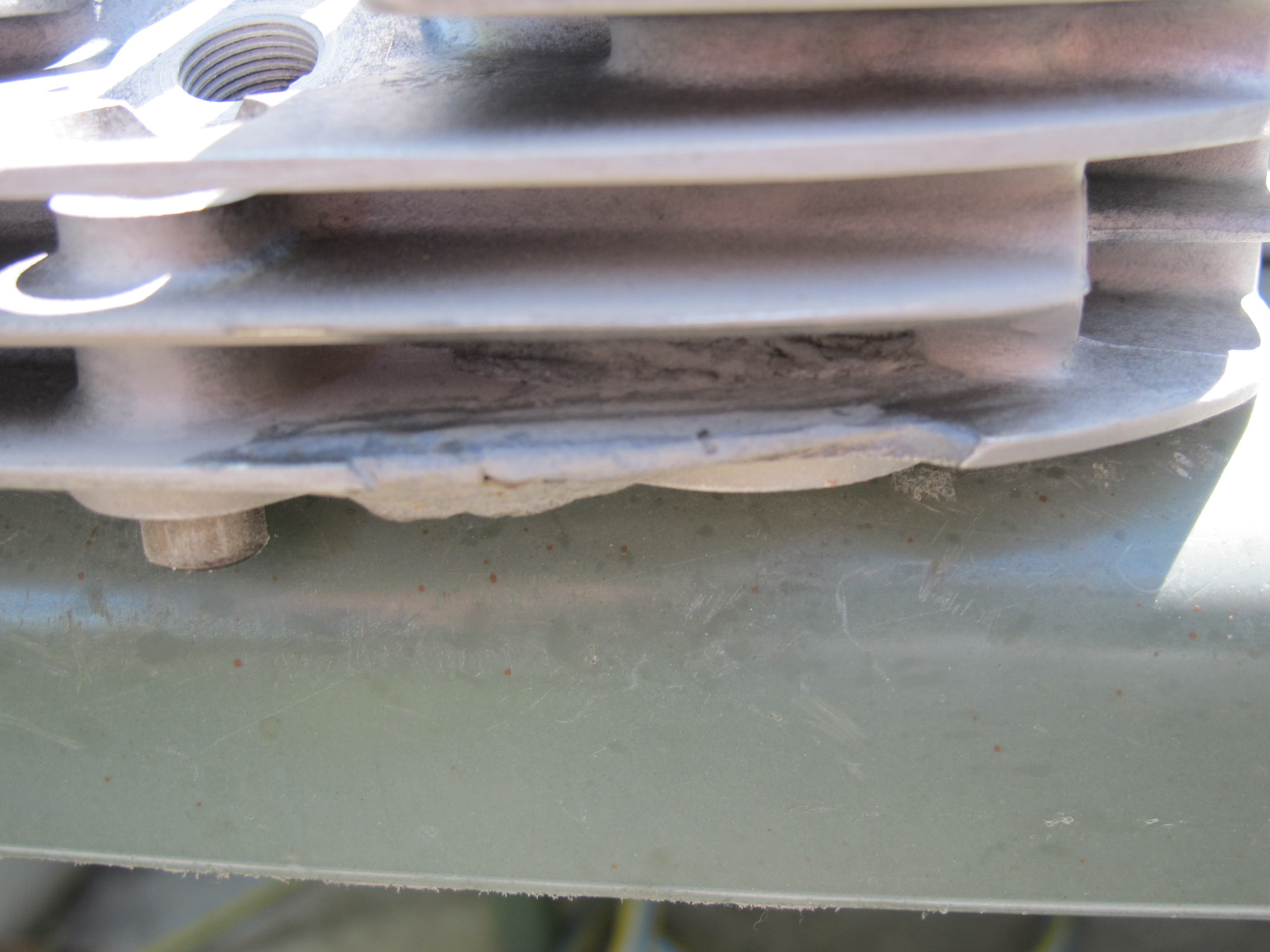

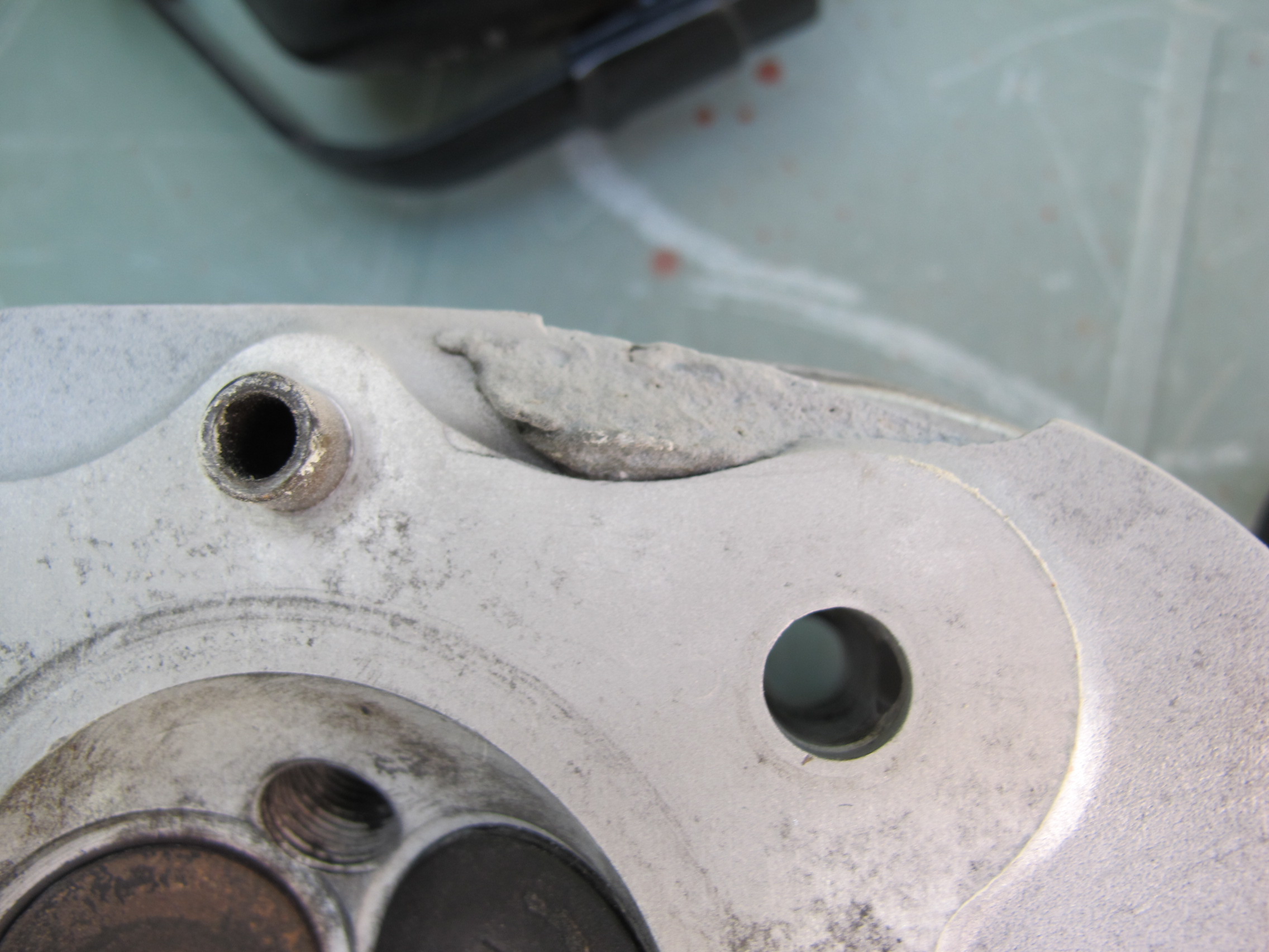

There's always a eerie anticipation on what lurks under a cr@ppy ripple paint job on the motor. I already knew there was a smallish portion of a fin to repair on the barrel,
But when we got to the head things began to get interesting
The classic wad of resin had been thumbed in and roughly shaped at some stage in a past life then some good old shite ripple paint applied to hide the sins. when the paint was off it was a little more obvious
Got rid of that dusty crud quick smart and this is what we are left with to build up on, not too bad
So the head and barrel will go of to get welded then refreshened at Rays here in Perth while I start the painting on the bottom end. Going full black with exposed fin edges and polished ends on the cam cover as the MkII was done on this to compliment the Satin Black paint work.

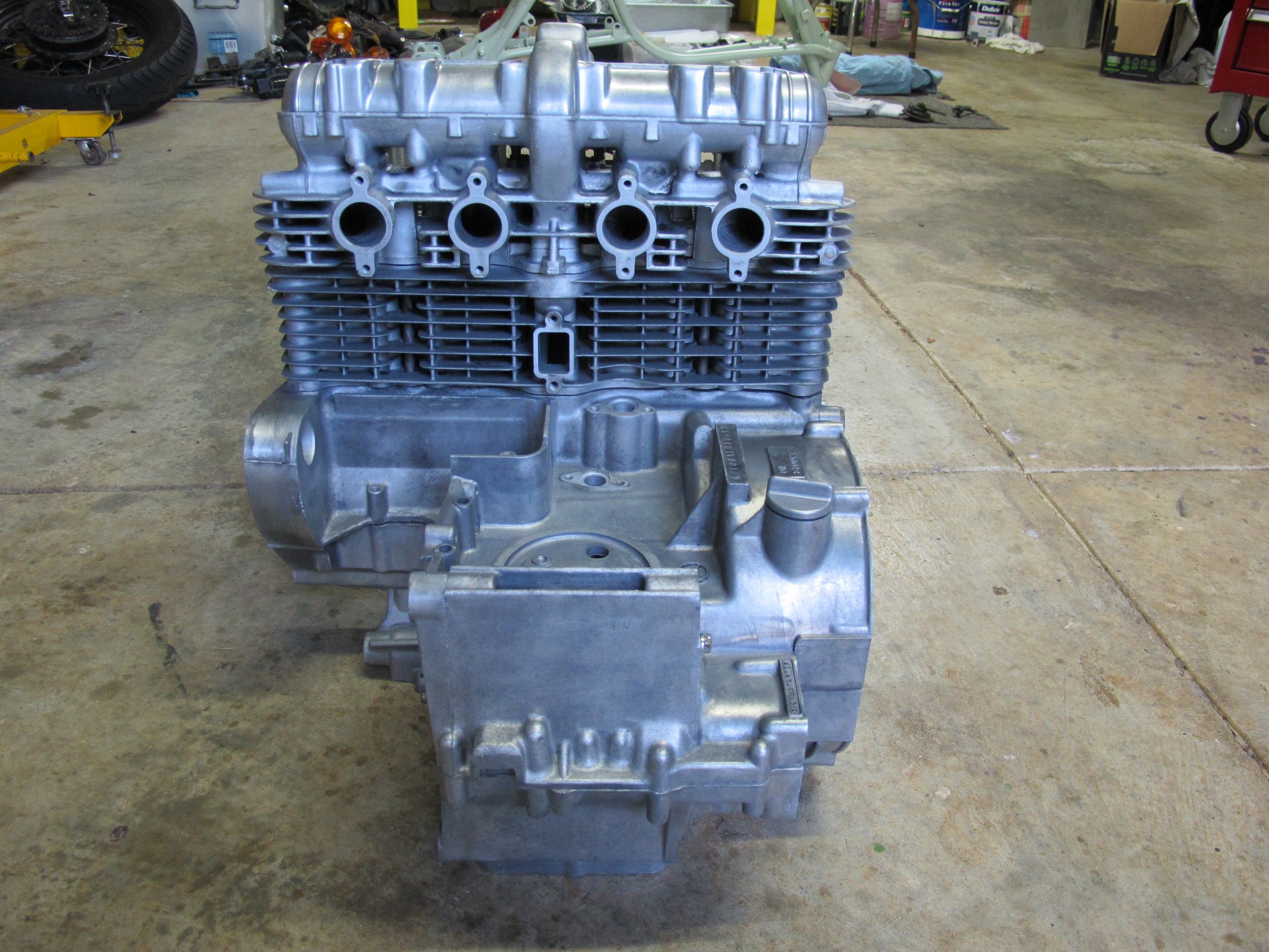

#9 PostAuthor: nicomkii » Sat Sep 16, 2017 1:07 pm
Took me a while to find this thread, didn't realise its been that long. Its been a wet long winter down here but finally getting some decent weather to lift the covers off things and getting the drive back to continuing down the rebuild road.

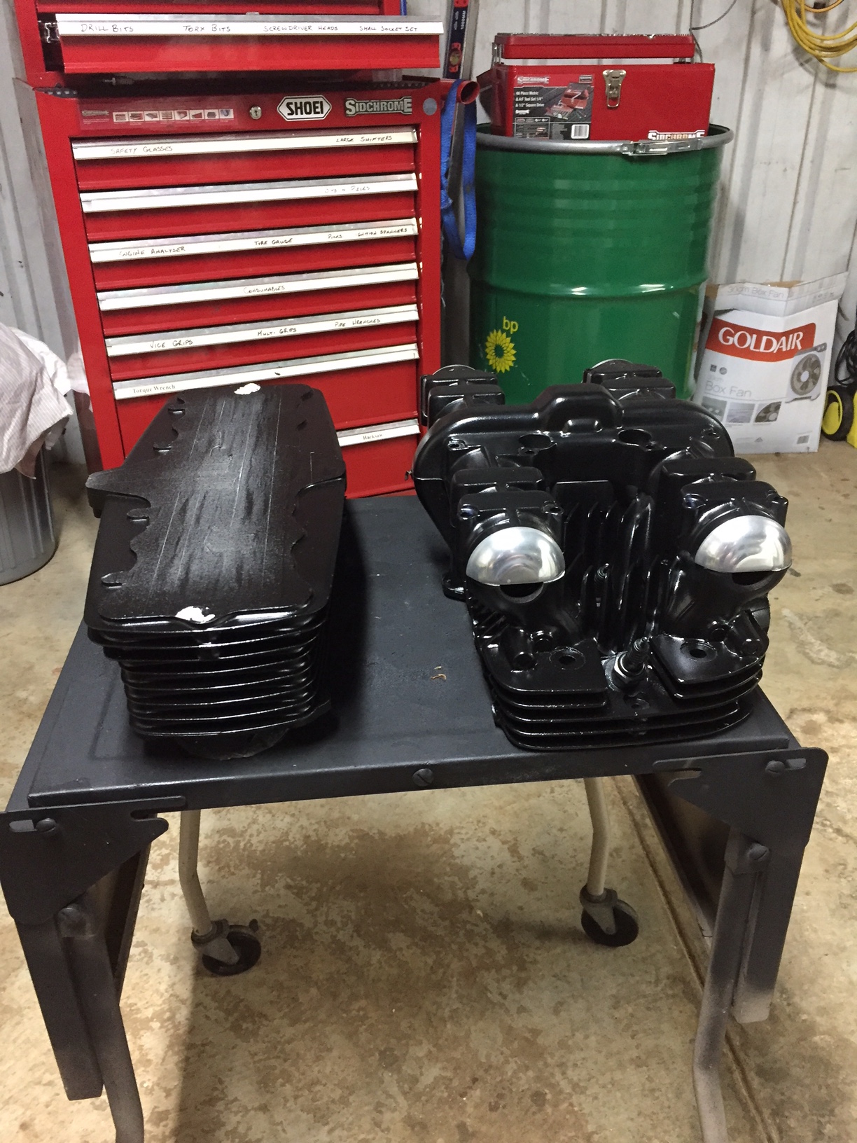

Barrels have been measured, honed and cleaned up. Head work also complete with valve work complete, a quick polish job and a couple of broken fins built back up. Been waiting a few weeks to get the weather just right to paint barrel and heads. I'm using the same method I did on the MKII, its got over 10,000kms on it and the paintwork on the engine is still as good as day dot. No fancy paint booth here, just make sure the wind is down, sit the gear out in the sun for a few hours to get the heat right throughout then a fine coat of KBS Motor Coater. Repeat 3 times and then leave sitting for a month or so before running up engine.
Looks ok in the shed tonight but will look again out in the sun tomorrow, may go one more coat, then will polish off the edges on the head to give it that just nice look.

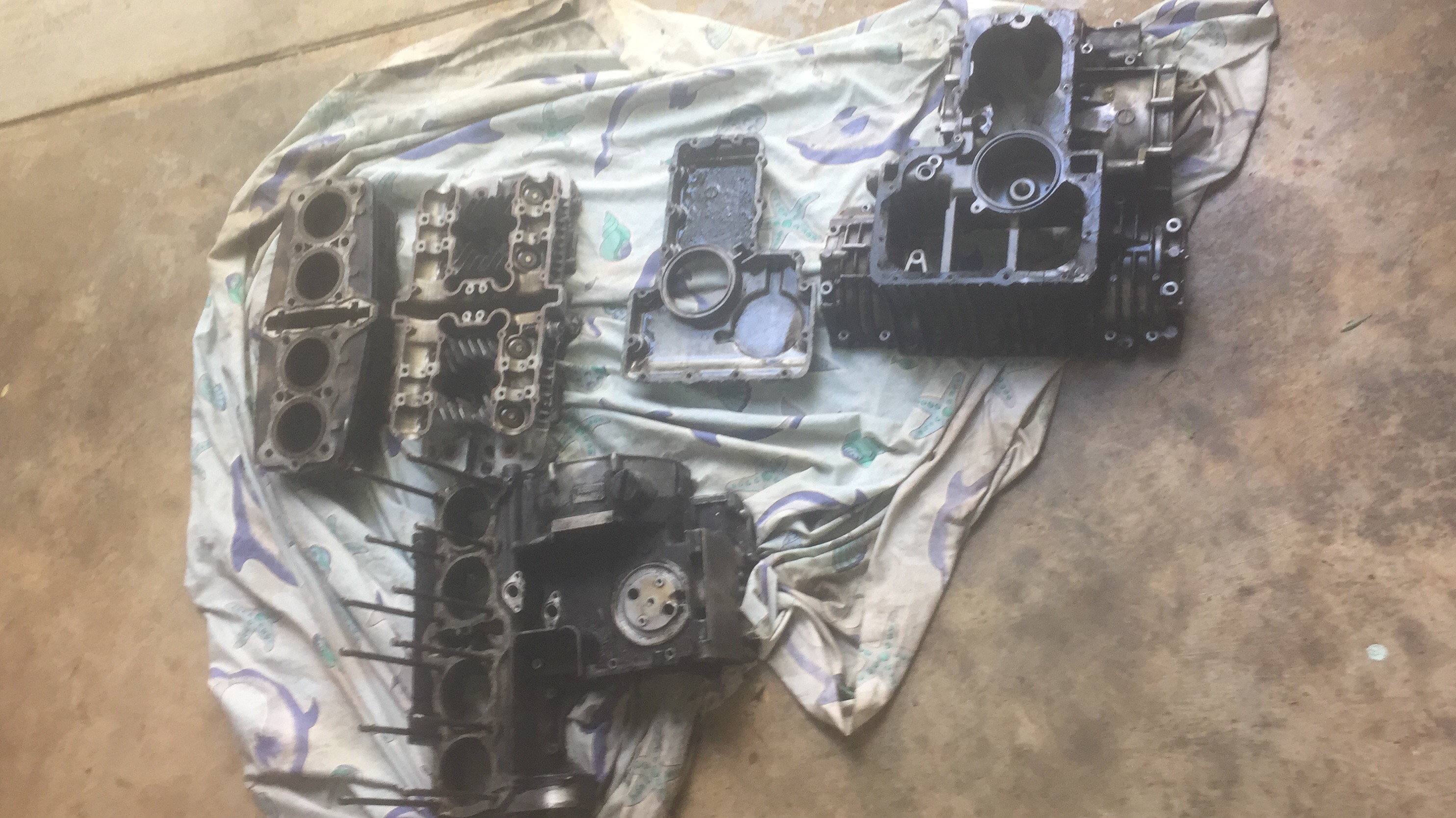

#11 PostAuthor: nicomkii » Sat Sep 23, 2017 4:23 pm

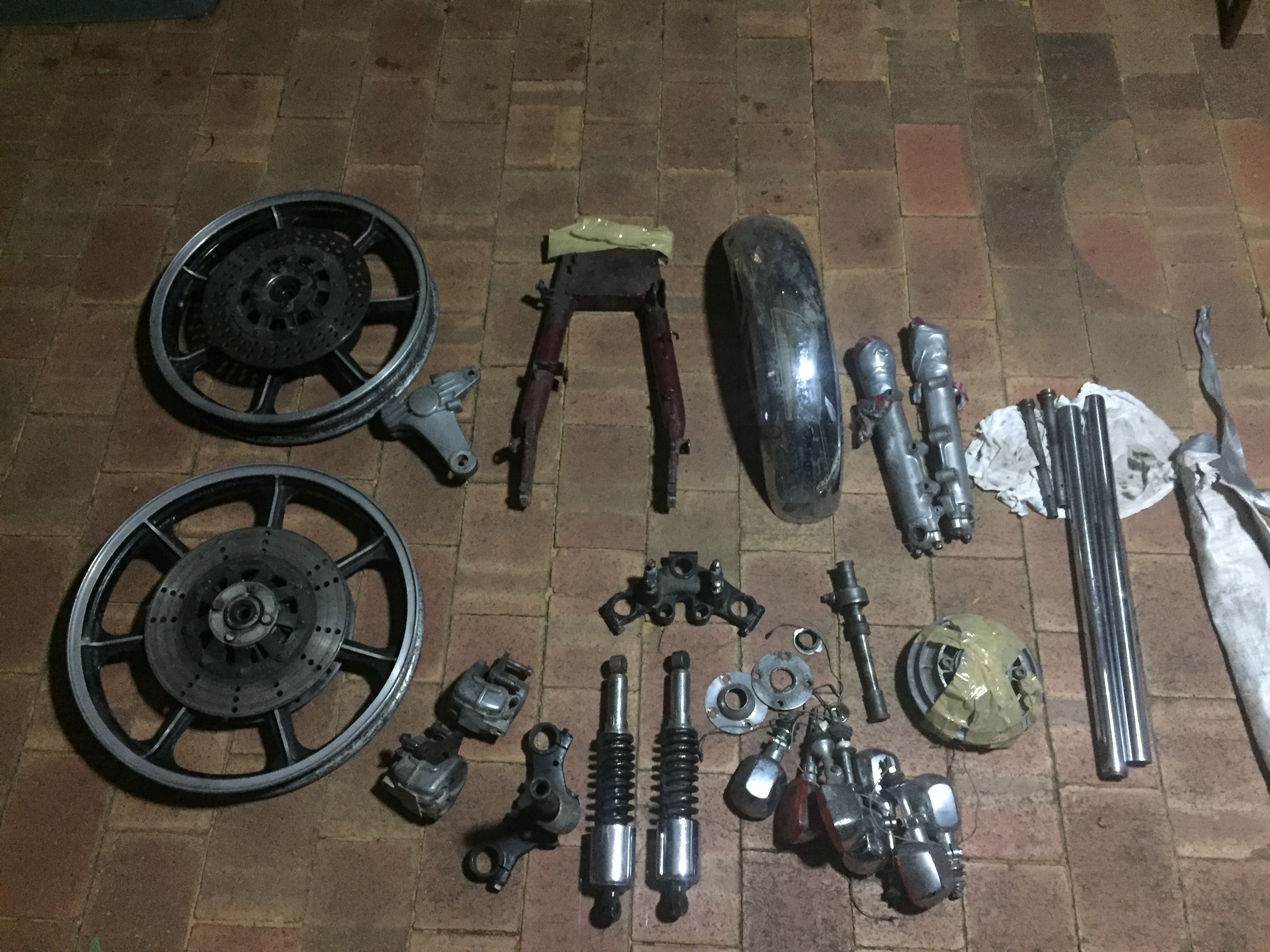

Another Zed bloke on the other side of the country was offloading some parts to finance his J project so figured I'd grab them and see what I could use on the A1. Thinking I might go the mags and leave the wire wheels in the shed for now.
Rotors are 6mm without grooves and will totally rebuild and repaint the calipers. Spares cant be a bad thing and if need be can be used as a bartering tool for other parts required.

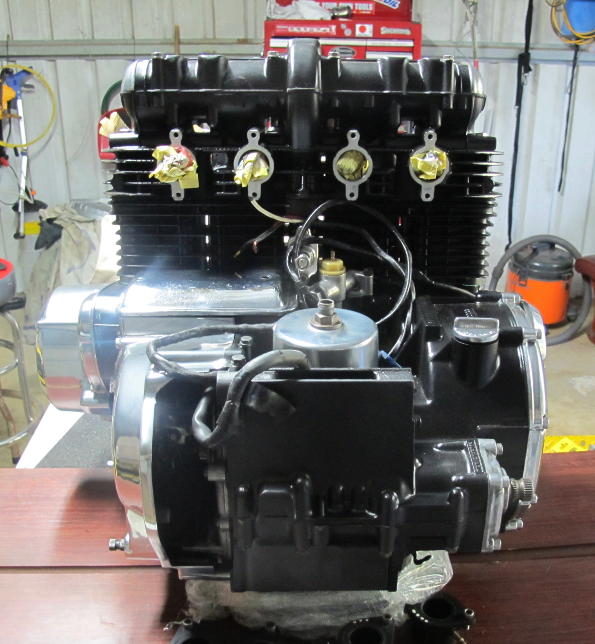

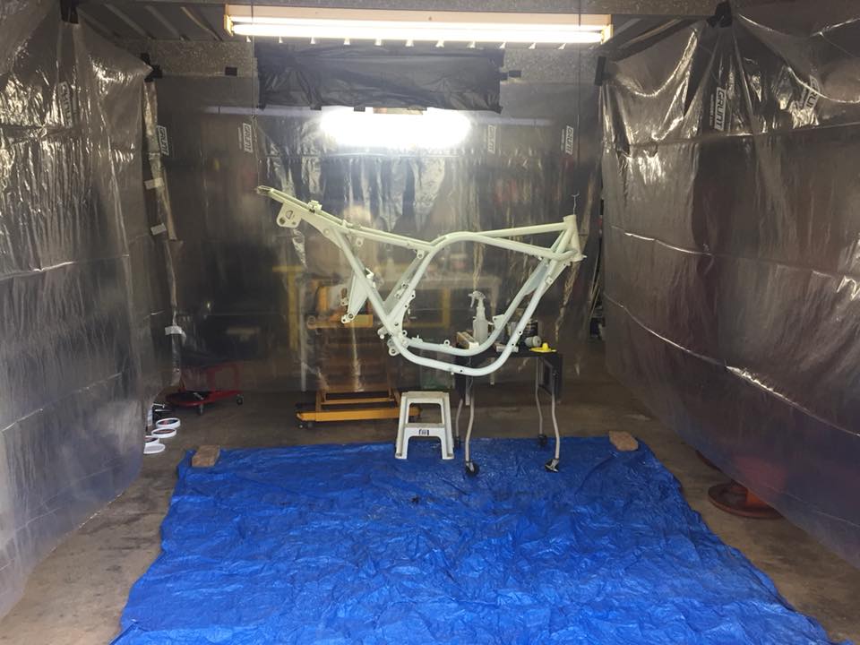

#12 PostAuthor: nicomkii » Sat Mar 03, 2018 7:57 am
Bloody hell I didn't realise how long its been, definitely not a rush job this one.

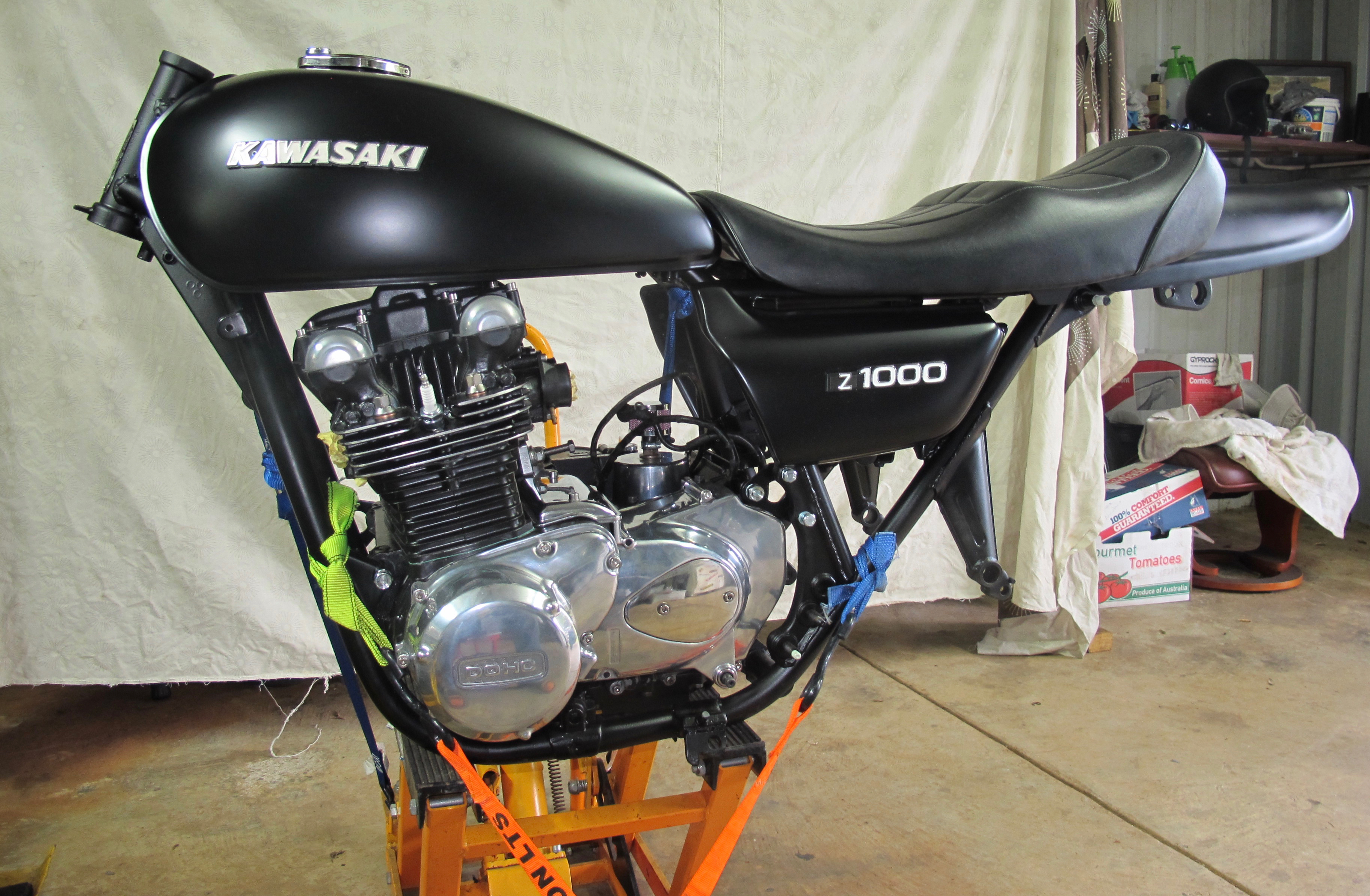

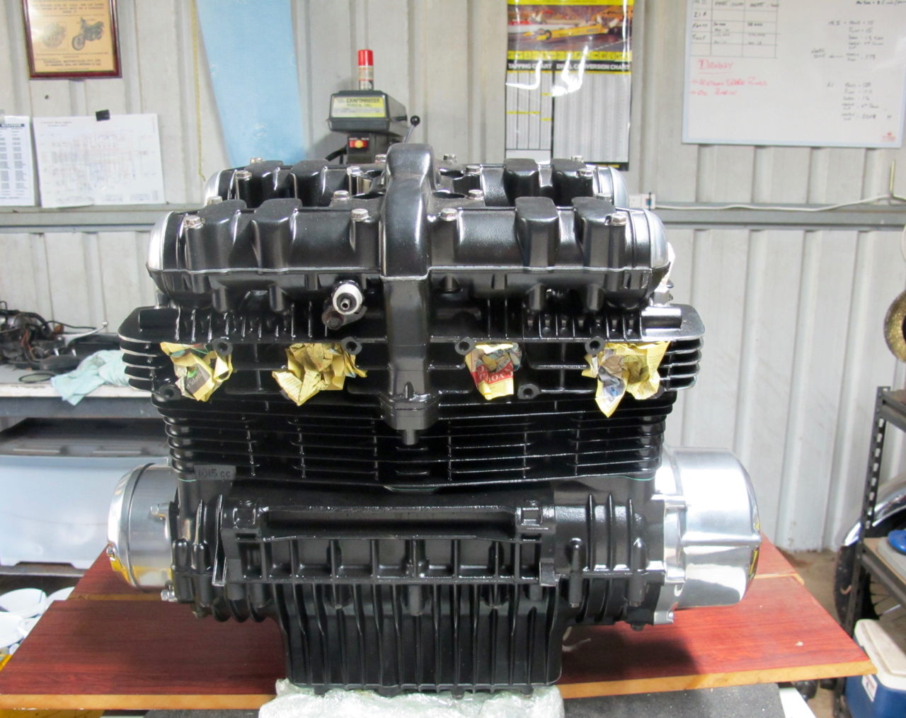

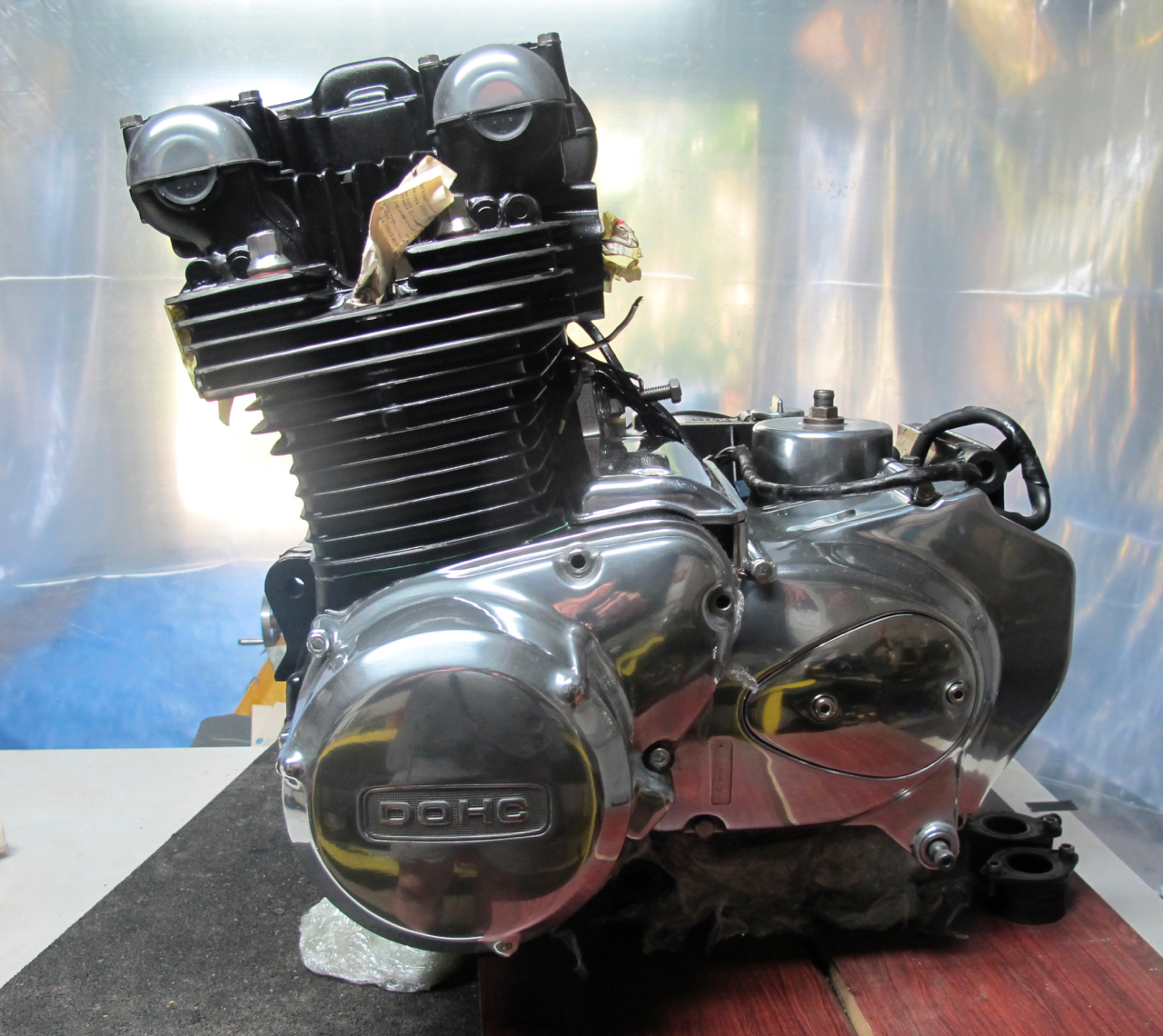

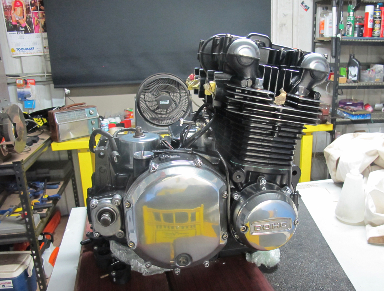

Finally have the motor totally rebuilt, just need to get some stainless bolts for covers etc to totally finish it. Pretty standard with the motor as she ran well to begin with, just needed a clean, broken fins repaired, repaint and give the head some loving before putting back together

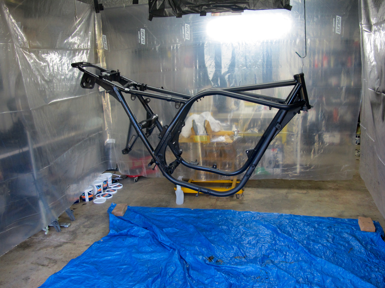

It's been a reasonably mild summer this year so spent a lot of time in the yard and out riding the other bikes. Bit hard where I am as its near the hills so when working around the house all I hear is bikes going up through the hills for a ride, commitment to the task at hand isn't one of my strongest traits.
Finally though have set up the shed to do some spray painting
And finally got the first coat of Satin Black on today. Satin to match the tank and covers, only shiny bits on this one will be the alloy and chrome
Respect to the masters of painting frames, getting into all the tight spots without creating runs takes time and patience, especially behind the head stock. I managed to only get one run that will be sanded back but still need to get that top coat on right.

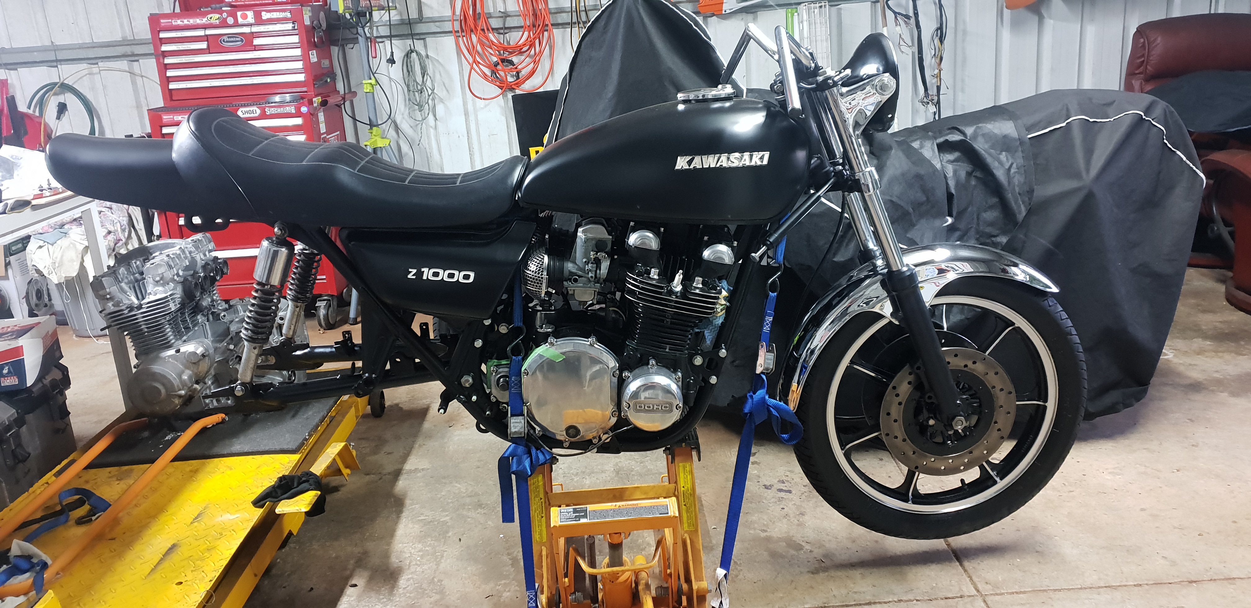

#14 PostAuthor: nicomkii » Thu Dec 13, 2018 2:37 pm
I have been slowly plodding away in the back ground on the the old girl. I do a bit of Adv riding which takes up a bit of shed time and having to earn an income to pay for these bad habits doesn't leave to much idle time. have the engine in frame now, sadly a few scratches so ave bought an airbrush for a few touch up jobs.
Re assembled the front wheel and fitted the tyre. Forks on and front end put together.
just having a spacer machined for the rear wheel and hopefully will have her rolling in the next few days if I can sneak into the shed. Grannies visiting for xmas so what be getting too much done.
