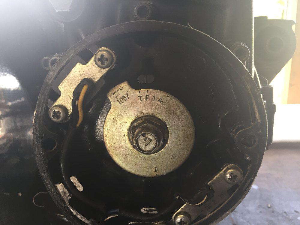

Doing a bit more today.
Checked out the ignition, I have not seen one like this
Can anyone enlighten me?
- What type of ignition is this . ??

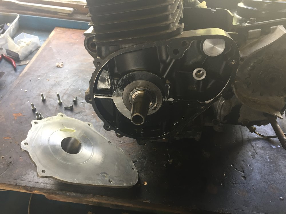

Also removed the race alternator cover.
So I will need a starter gear assy & a rotor.
Are the rotors all the same on these ??
- Rotor & starter gear assy Required
Anyone have one they want to part with?
Stu

Looks like GPZ1100 Unitrak to me if it's connected to the Igniter it is probably in a plastic case
Looks like a unitrac output shaft so may be a whole unitrac motor See what the engine number is.

Z1100R has a Unitrak engine, that ignition pickup is standard Unitrak, if you want to fit a Dyna ignition you'll need a J engine casing
