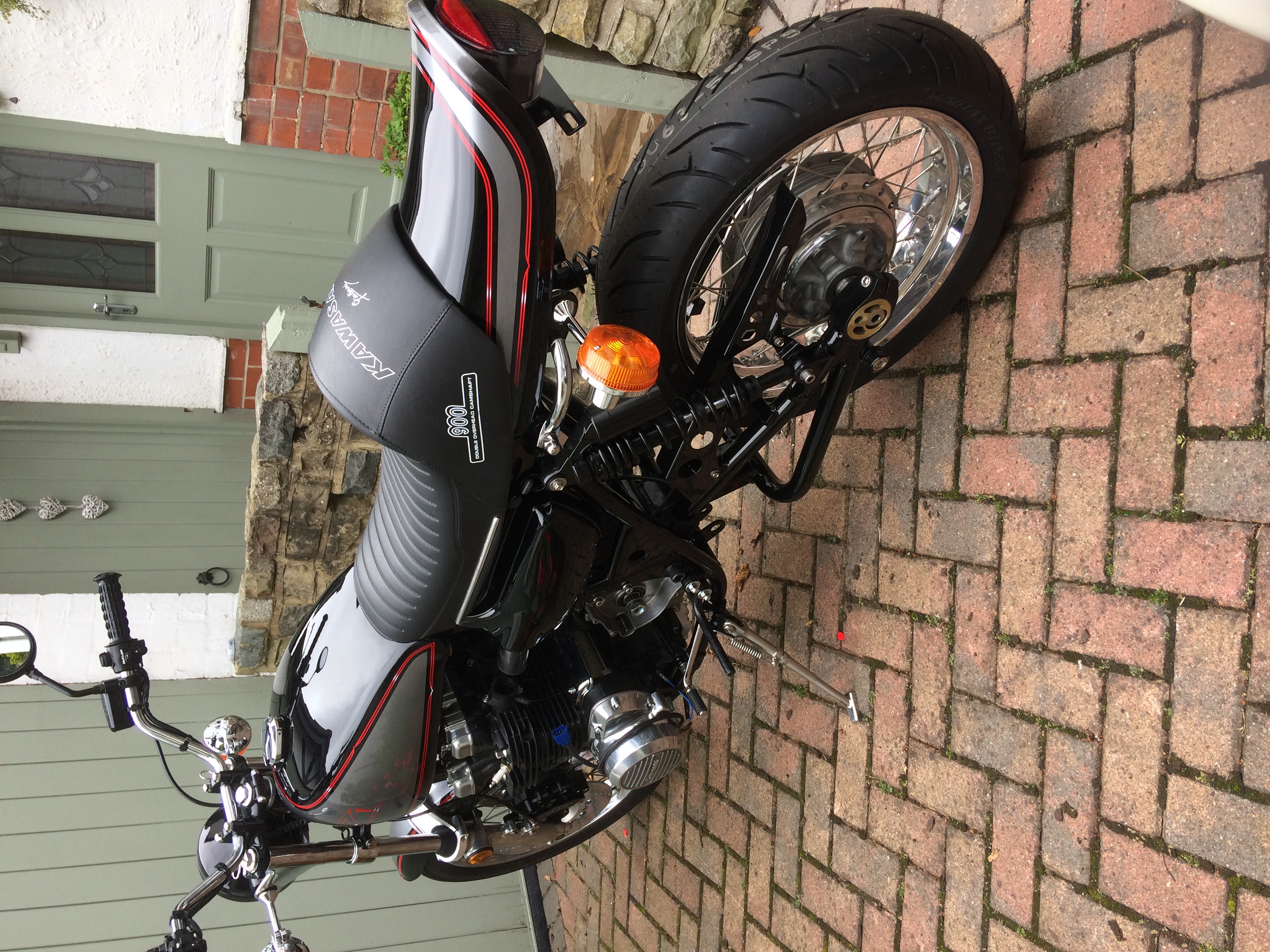

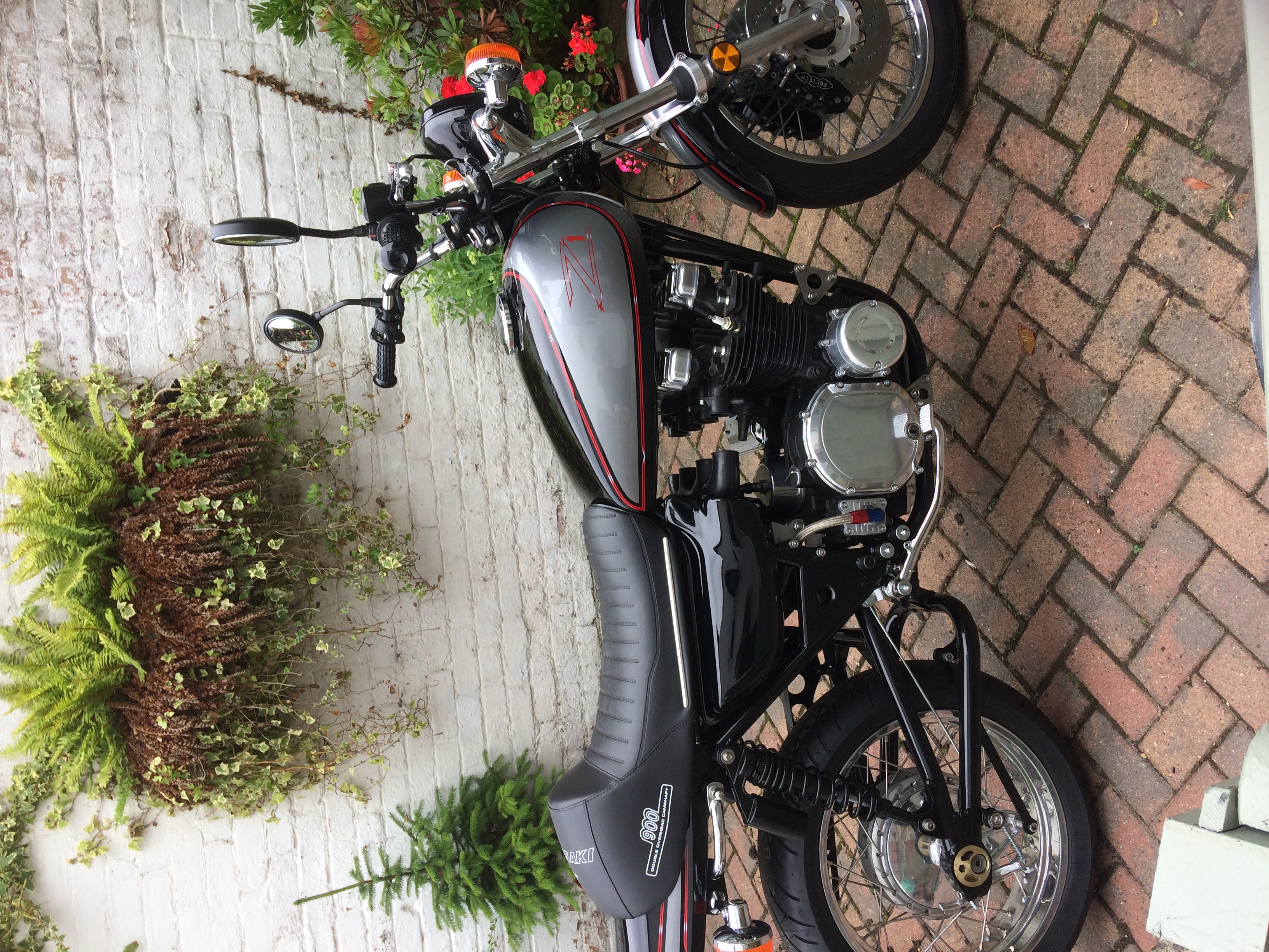

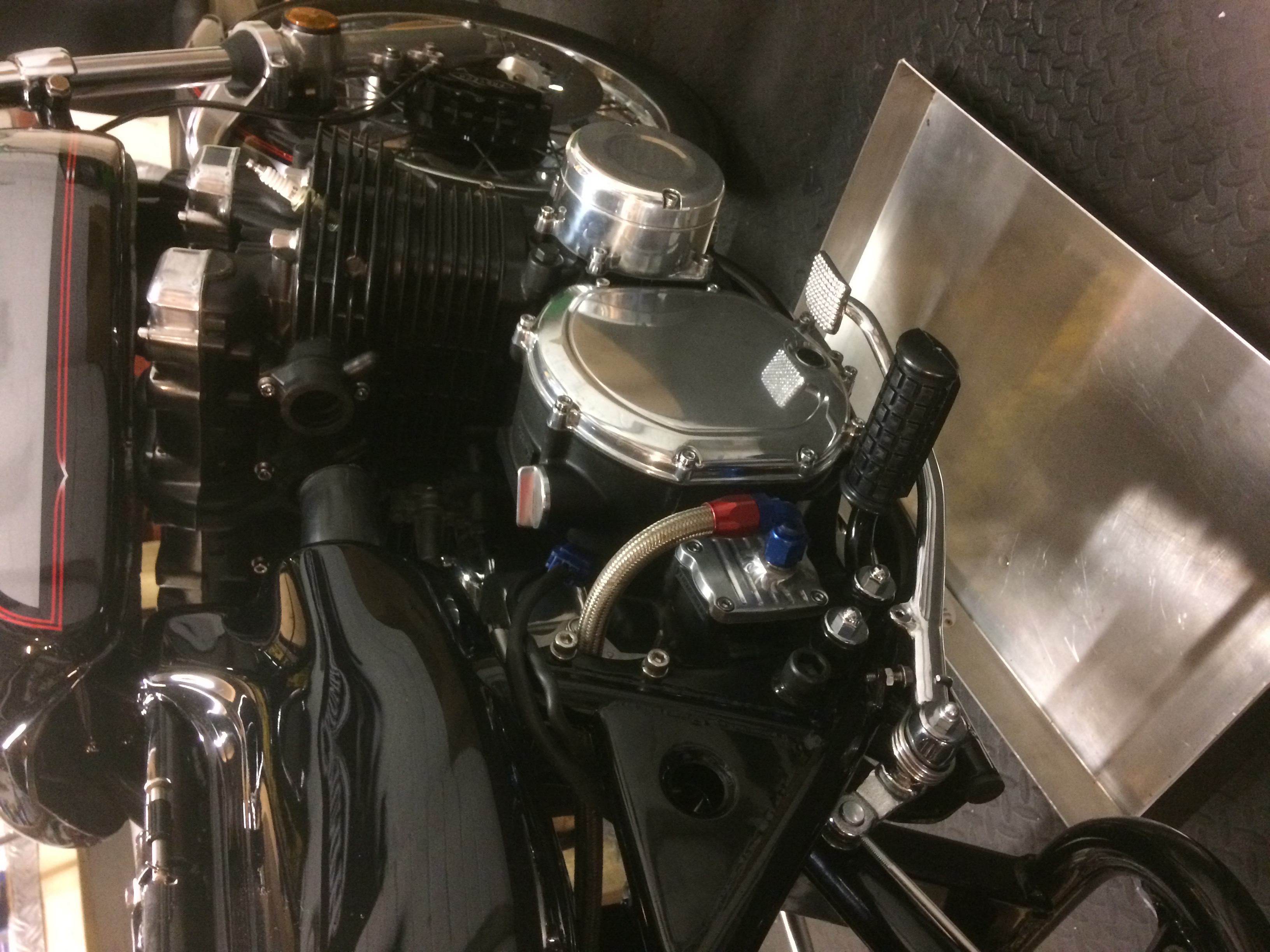

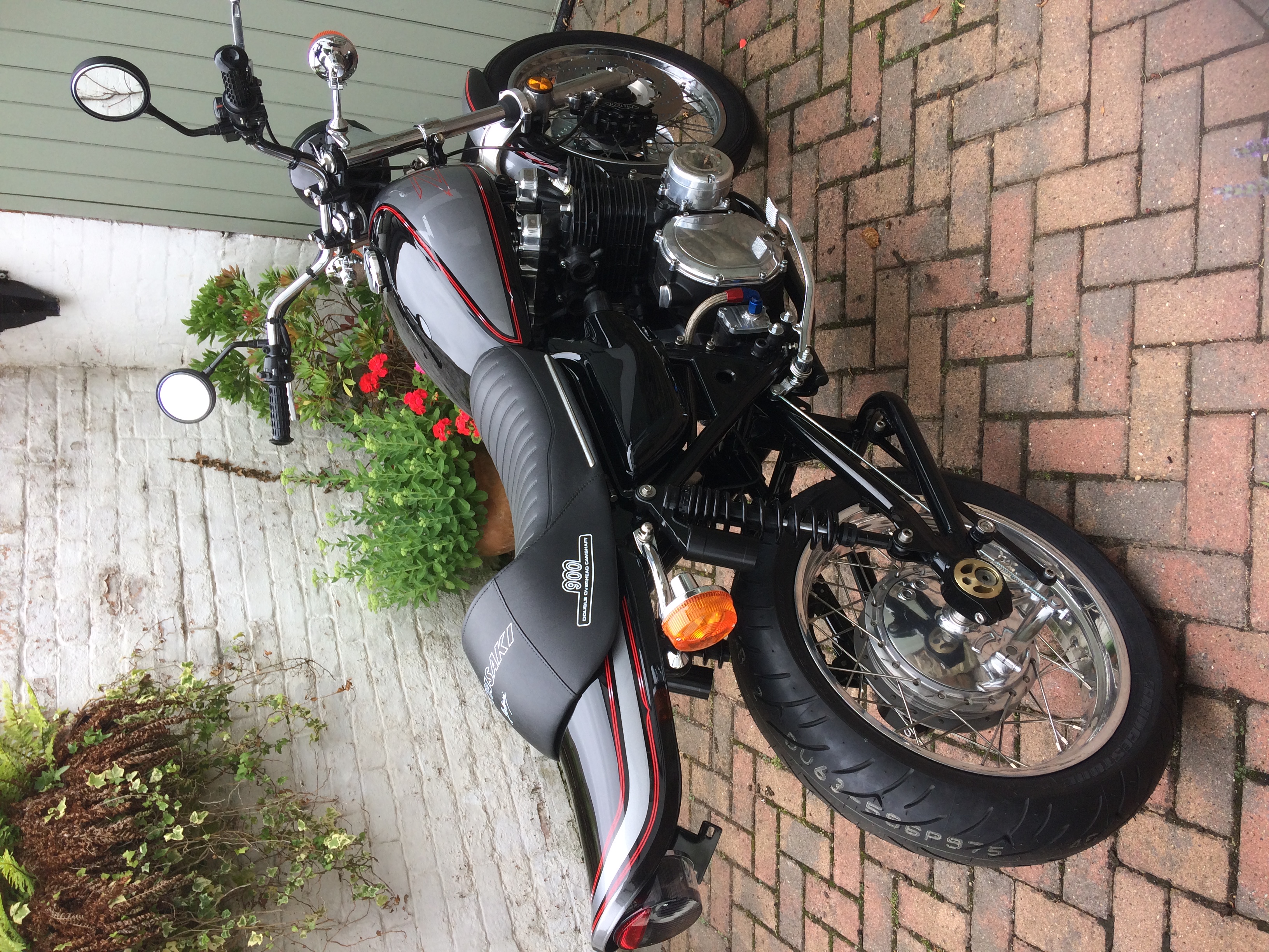

Having built and sold more bikes than I care to remember I finally decided to build a bike to keep (stop laughing at the back) This all started out with a 72 Z1 frame Chris Rivett had for sale. This had already had some modifications including the left hand exhaust/footrest bracket being removed. I had it modified further with lower top shock mounts left side exhaust/footrest mount removed and some additional bracing whilst also fitting a ZRX1100 swingarm. The engine is a Z1000st converted to chain drive. I have lowered the back end a bit since the photos below were taken.

Lovin' the paintwork - looks spot-on Padders - we want more photo's please :twisted:
