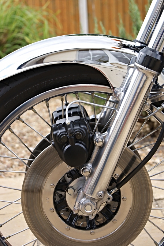

Re: Don't you just love Jigsaws
Posted: Sat Nov 04, 2017 4:07 pm
Author: Philippe
Hi AJAyre
By what I see I think your Z1000 is an A2 model with the brakes behind the front fork or am I wrong?
When you want to give it a fresh factory look don't forget that the front fork wasn't polished but brushed!
It all depends on your own taste, so go for it!
And about robbing a bank...don't do it, they'll find your finger prints!!! :twisted:
Good luck with the restoration!
Posted: Sat Nov 04, 2017 5:51 pm
Author: AJAyre
Phillippe
ho
My Model is an a1 And the callipers should go infront of the fork tubes...although these are a2 forks so i am assuming the bike is something of bits
your correct about the brushed finished however with this level of corrosion i think its best to get an even level of finish with polishing before i put the brushed finished on with a scotch bright pad
Adrian
Posted: Sat Nov 04, 2017 5:57 pm
Author: Garry.L
AJAyre wrote:Phillippe
My Model is an a1 And the callipers go infront of the fork tubes...
The forks pictured are A2, the oil drain is on the same side as the caliper mounts. The A1 has the drain opposite the calipers so in both cases it's at the lowest point if the forks are fitted their correct way round.
My old A1.....
Posted: Sat Nov 04, 2017 6:20 pm
Author: AJAyre
The search for some a1 fork lowers begins ...thanks guys for info ..if not the impending frustration :|
Posted: Sat Nov 04, 2017 6:45 pm
Author: warren3200gt
Ade, 650 b1's are the same Im pretty sure.
Posted: Sat Nov 04, 2017 6:53 pm
Author: AJAyre
Warren thanks for that it might make life easier :)....although CMSNL have a new pair for just £800 ....Ouch
