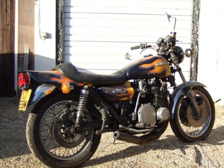

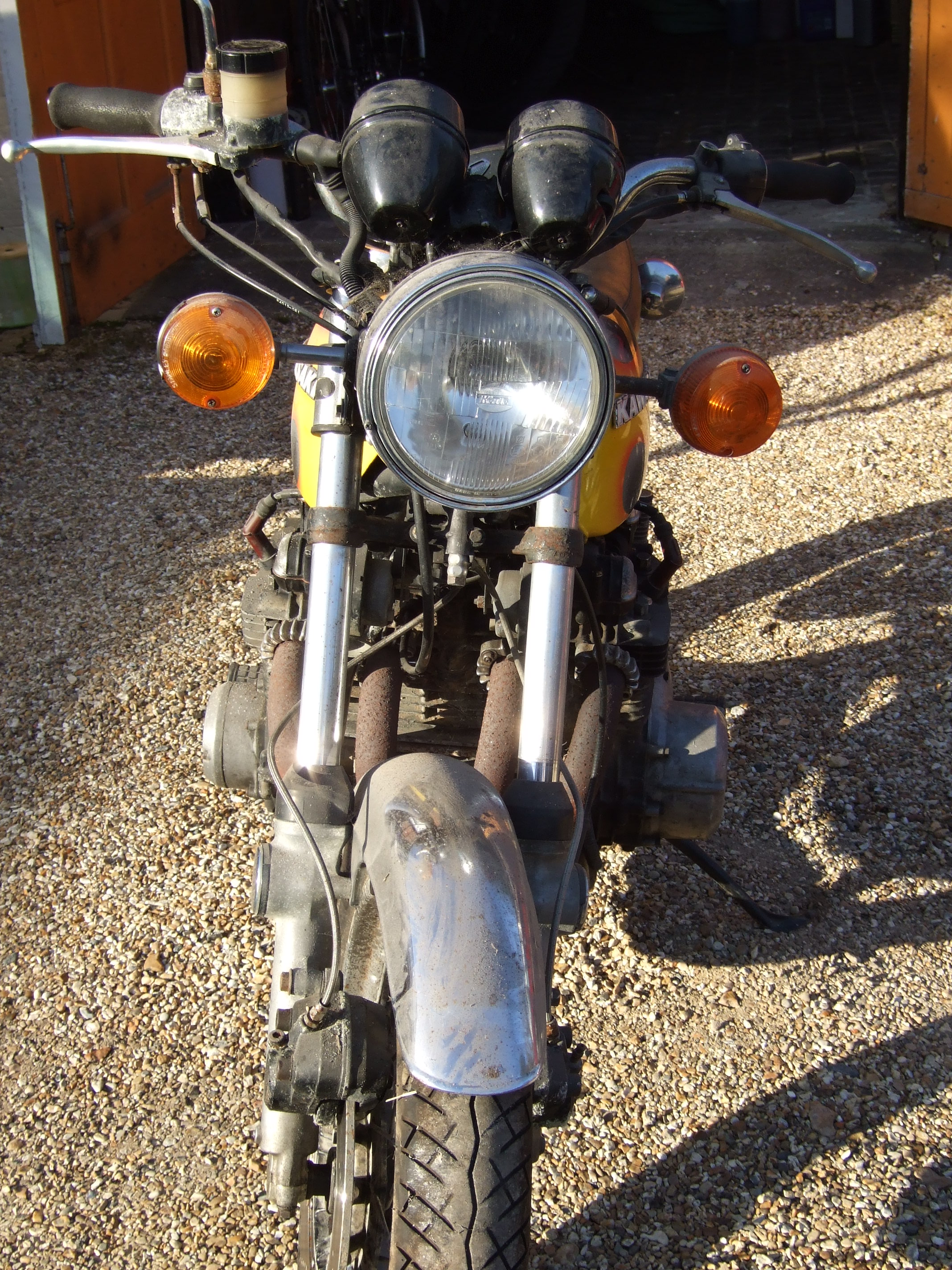

Well after putting this in the garage about 6 years ago soaked in spray oil and having moved twice, changed job and spent a year building a bike to race at Bonneville Speedweek.
It's now time to start on "Mishmash" as its now called.

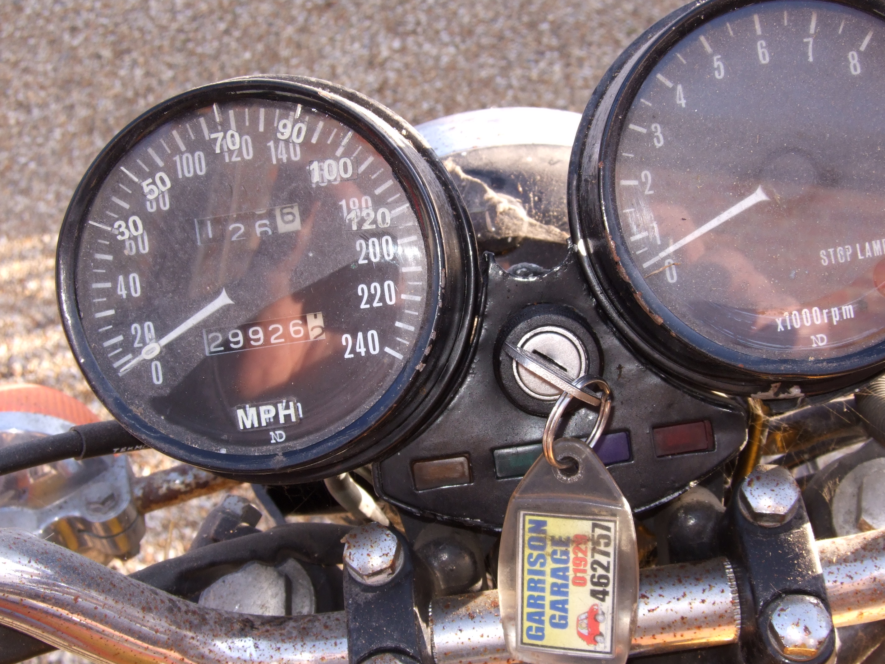

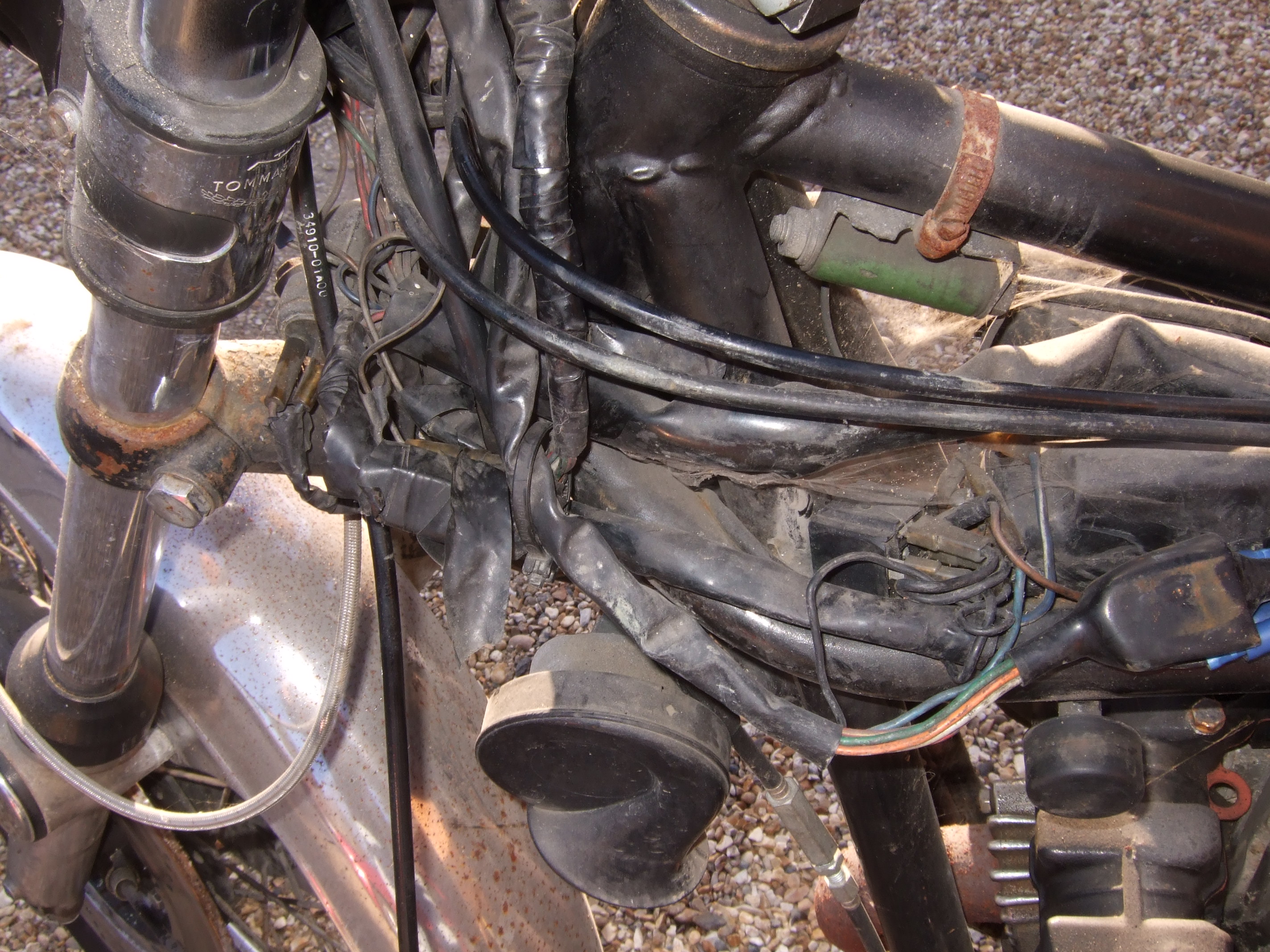

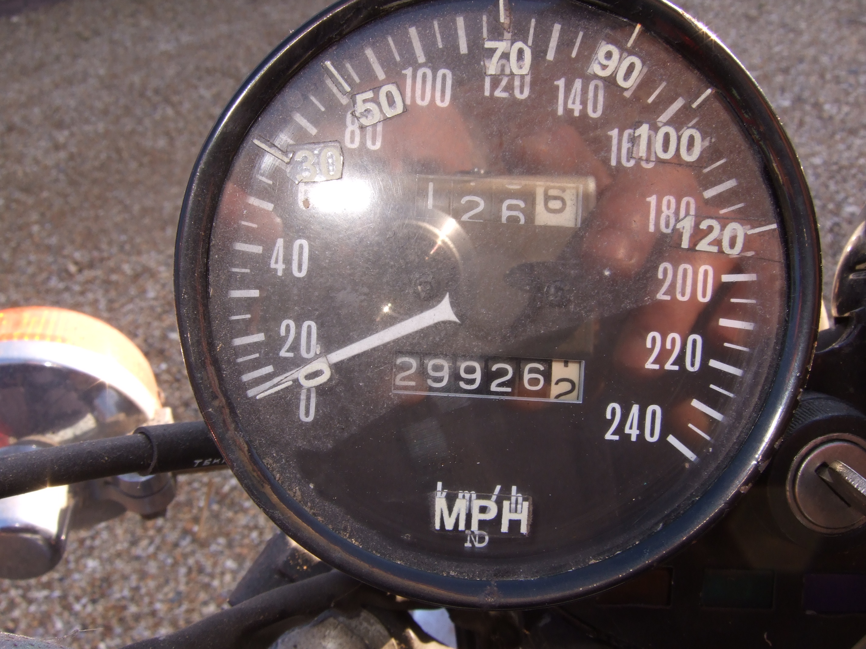

It's a Italian import rather than US so European spec woohoo. Due to all the date codes being mismatched etc.. It has a 73 Z1 engine in a 1974 Z1A frame with early switch gear & what appears to be Z1 dash, but not sure about the clocks, a Z1000 swingarm, later model carbs to warrant a restoration.
All the wiring is brittle & not the best so I have got all new looms, switch gear, reg/rec & stator from Z-Power, as I don't need the drama of trying to sort out 43 year old wiring.
I have already stripped & ultrasonically cleaned the carbs & rebuilt them, checked the valve clearances & only one tight shim which was changed.
Done a compression test which showed a cylinder slightly down on spec, i suspect a gummed up set of rings, so put in some mystery oil to see if it will bring up the psi after a week or two soaking & turning the motor over.

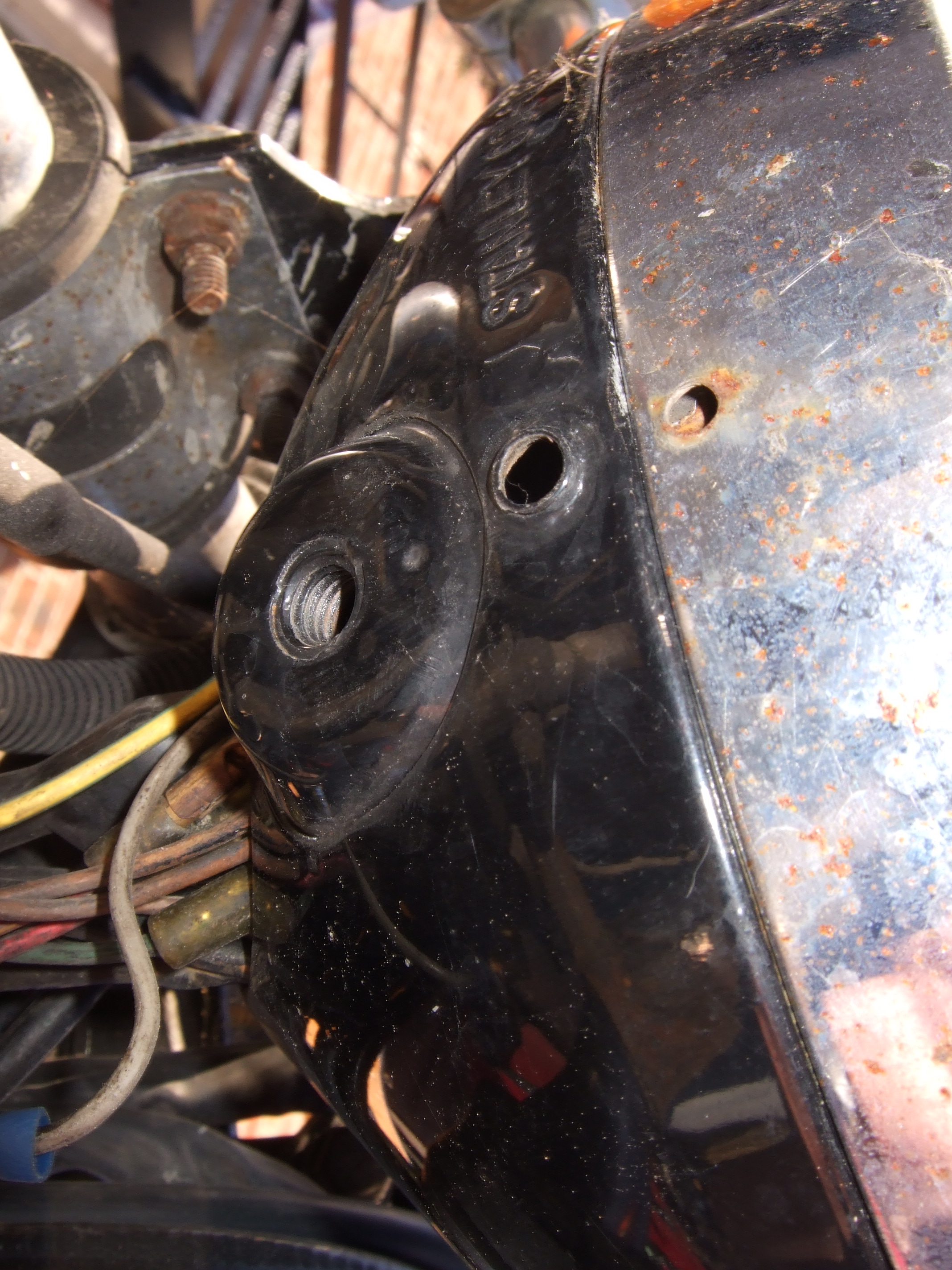

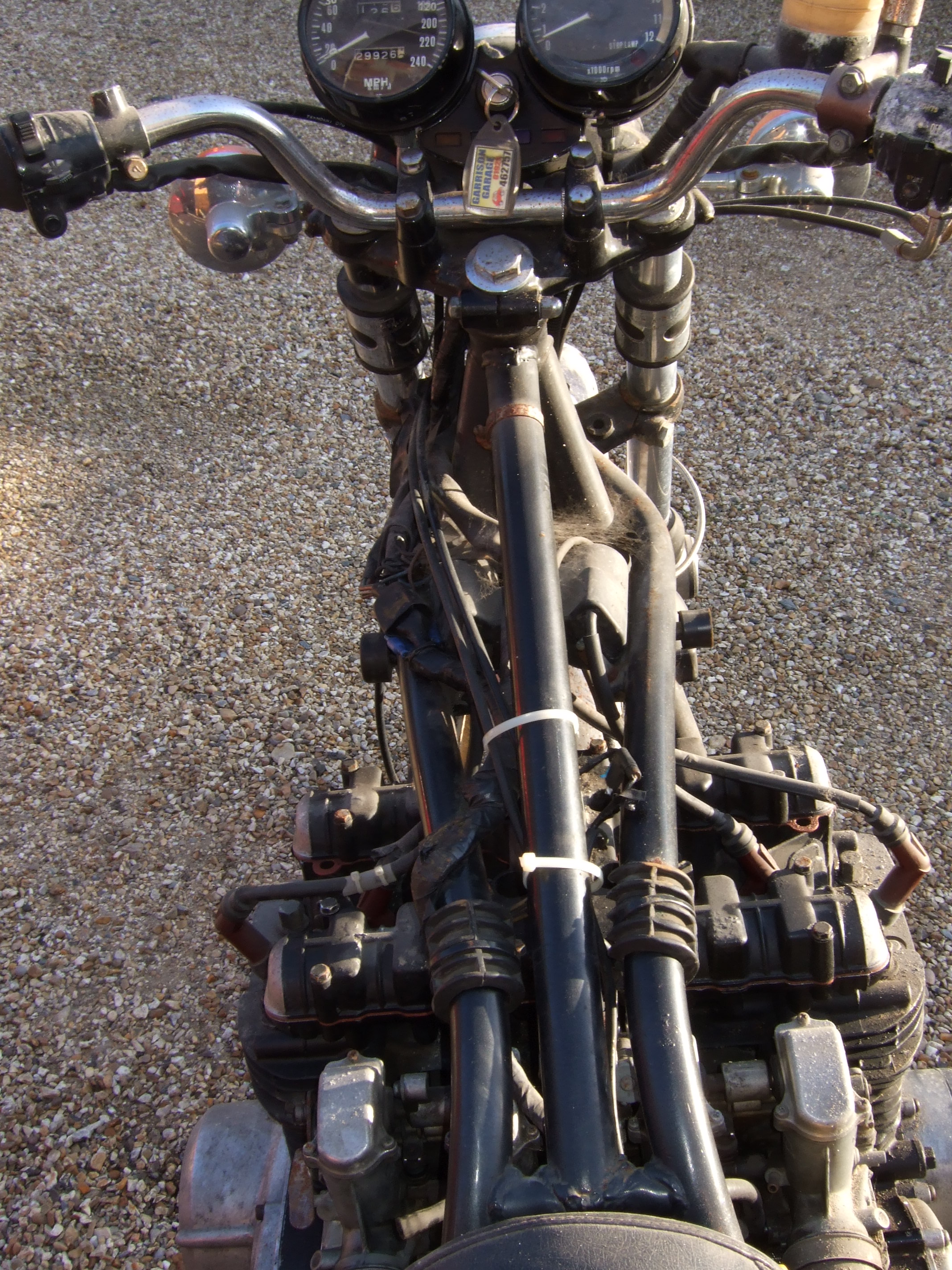

I will be doing all the brakes etc to put it safely back on the road as it is. I'm not going to clean it up at all so it has all the patina you see in the following pics.
All the original parts that are coming off, are going to be saved & put up for sale to help others with their builds.

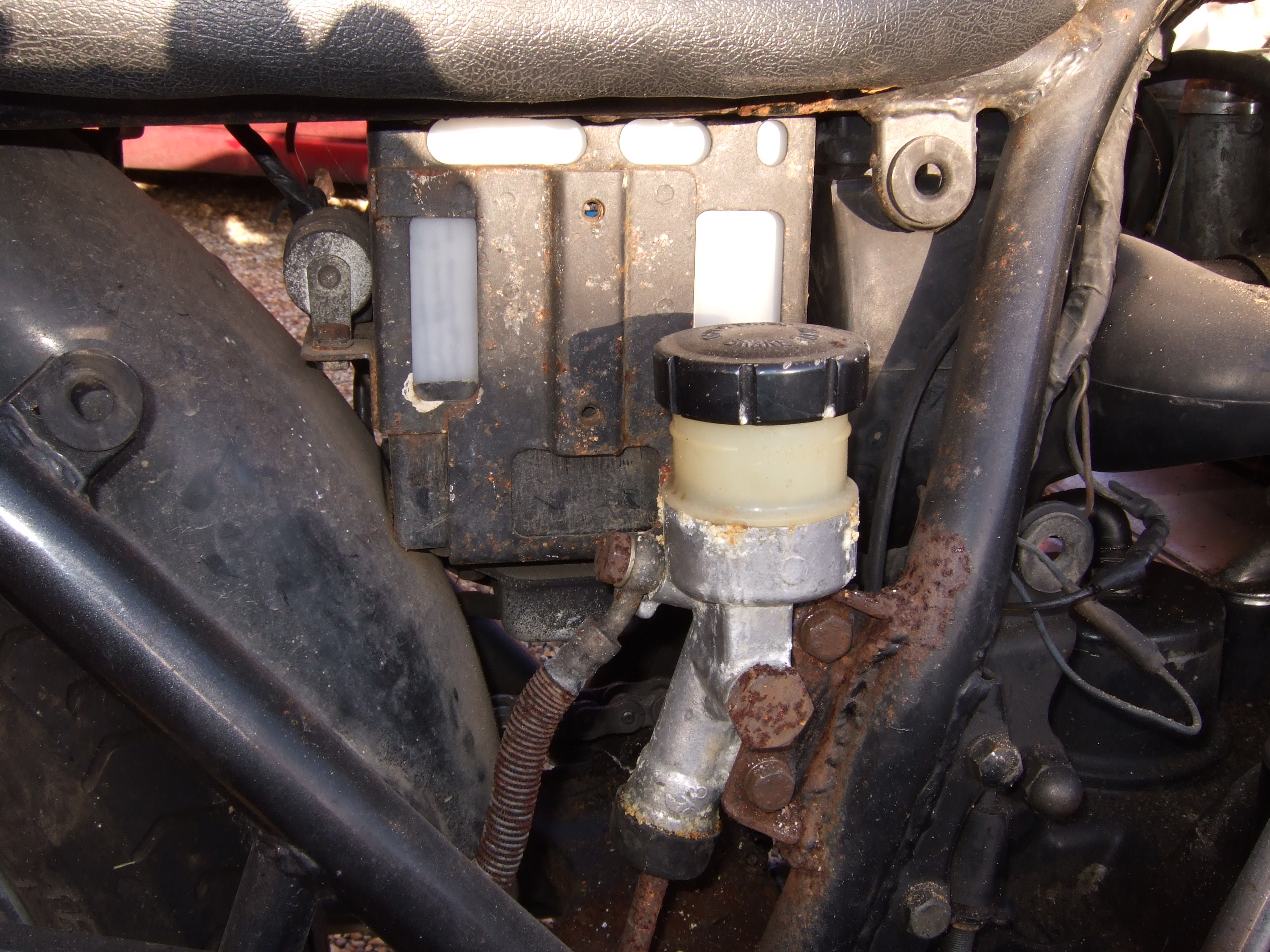

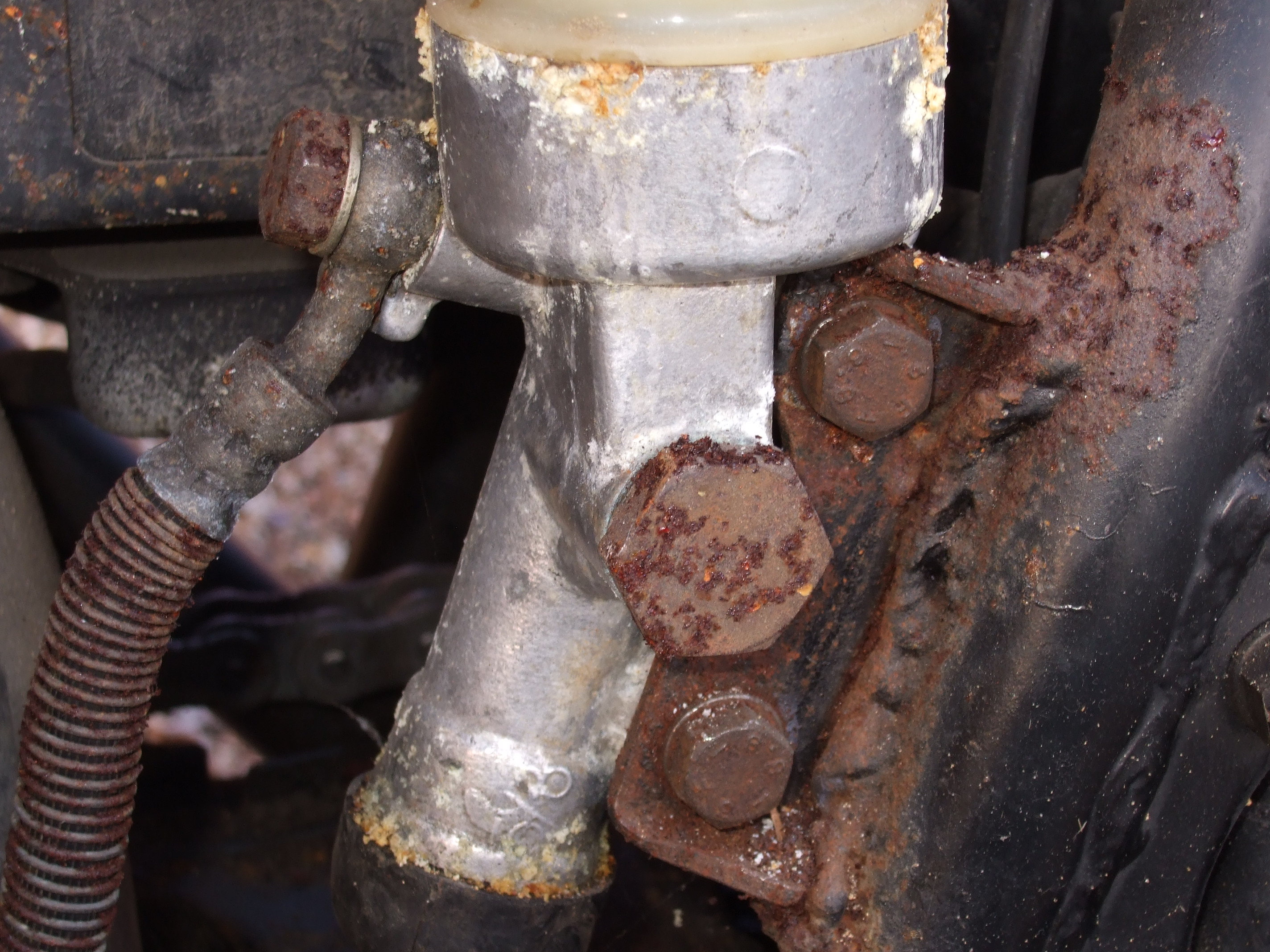

Phillippe, do not panic the only bit that is going to get the grinder treatment, will be the rear master cylinder bracket at some point.

Chris unfortunately that part is not going to be for sale, but other parts will be, I will be looking for a UK spec speedo to change out the european kph one.

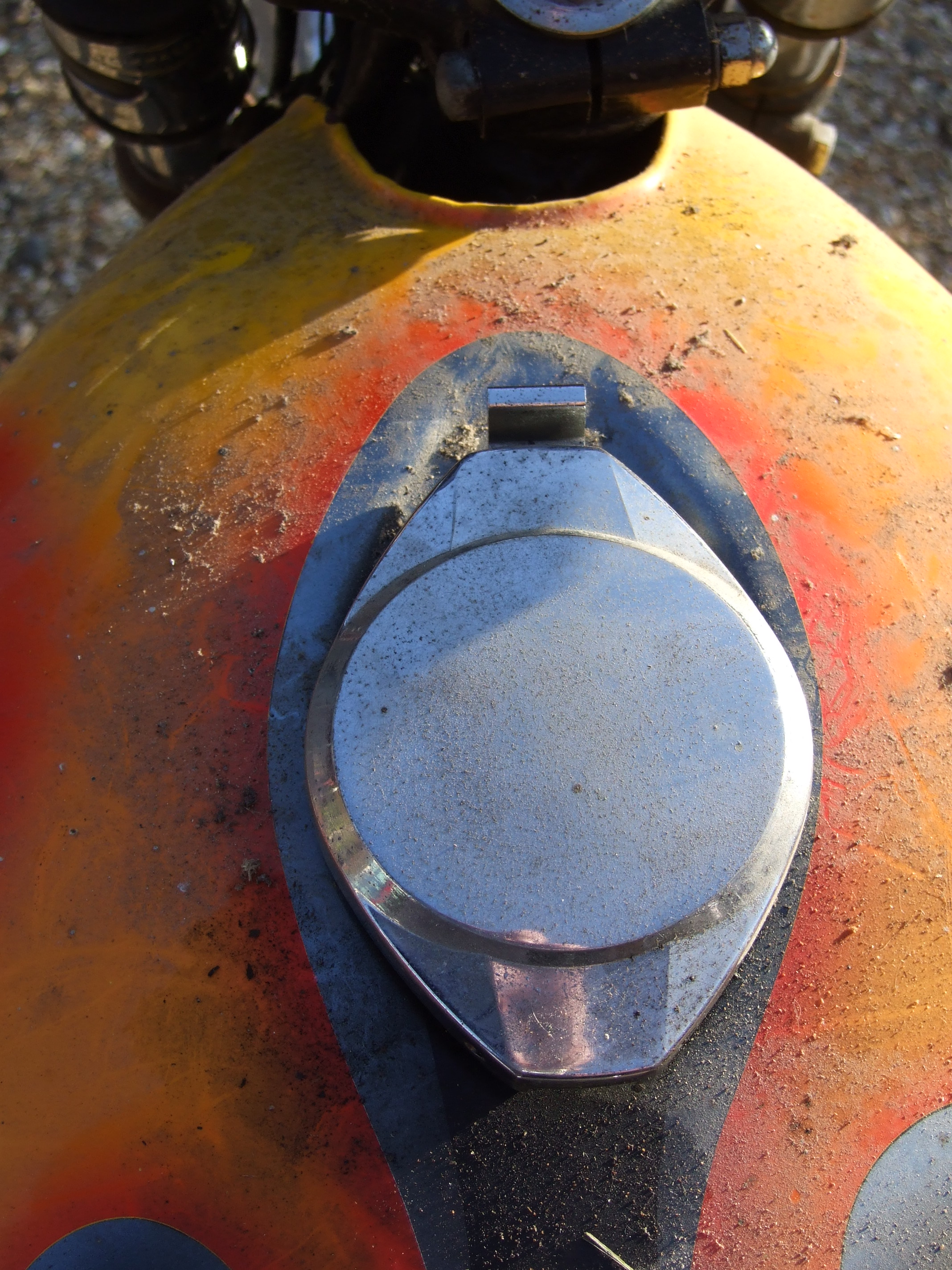

No paint is staying as is & not going to retrofit a drum brake, will probably fit a xjr 1300 arm later on when i finally decide what way I will go with the project
I will put the tank, tailpiece & panels to one side. I will use aftermarket panels tailpiece, my friends son will make an alloy fuel tank for it, as that what he does for a living, but first I will smoke it around as is

If your rear master cylinder is too far gone. I have a spare one you can have.
saltflatracer
- Regular Poster
- Posts: 37
- Joined: 21st Dec 2017
- Location: By the sea in Dorset
Re: Mishmash Zed
Thanks Adrian I will let you know as soon as i have checked it out, but I suspect it's not going to be serviceable.

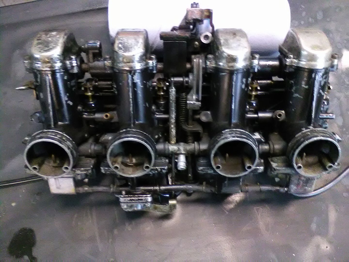

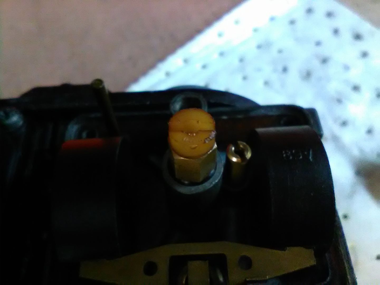

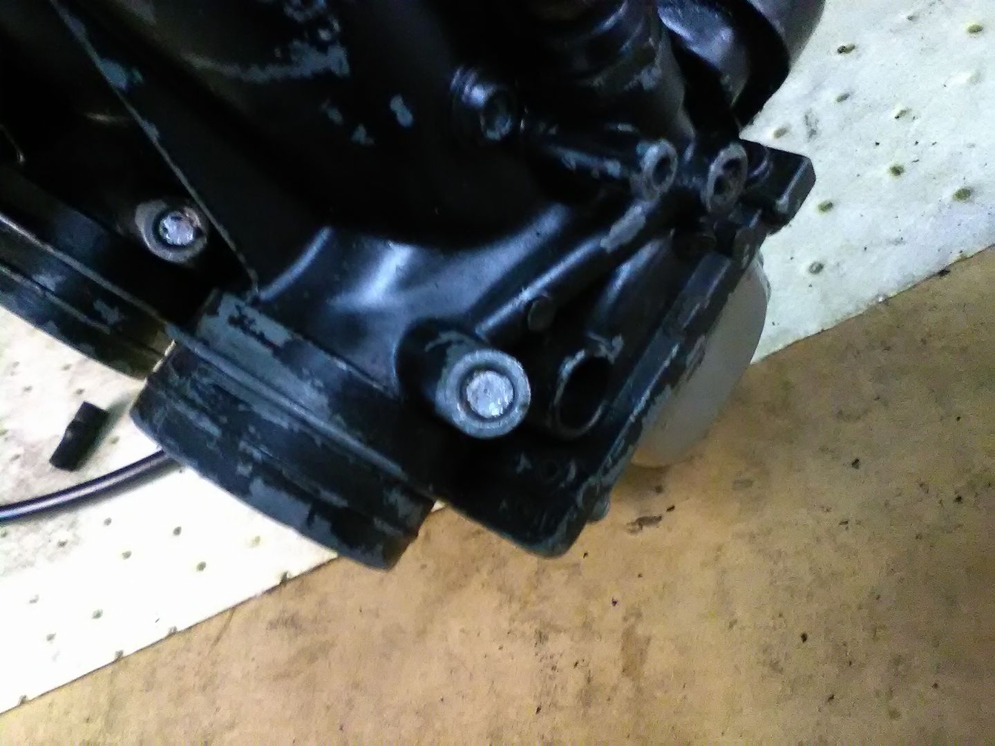

Funny ol'day today. I had a chat the other day, with a chap I know about my Z1. Well today he comes in to see me, with a bank of carbs in a carrier bag. Asks me if they would be useful to my project.
Well it looks like I now have what I think are US spec 28mm Z1000 carbs. Apart from being matt blacked & chrome carb tops & float bowls everything works fine.

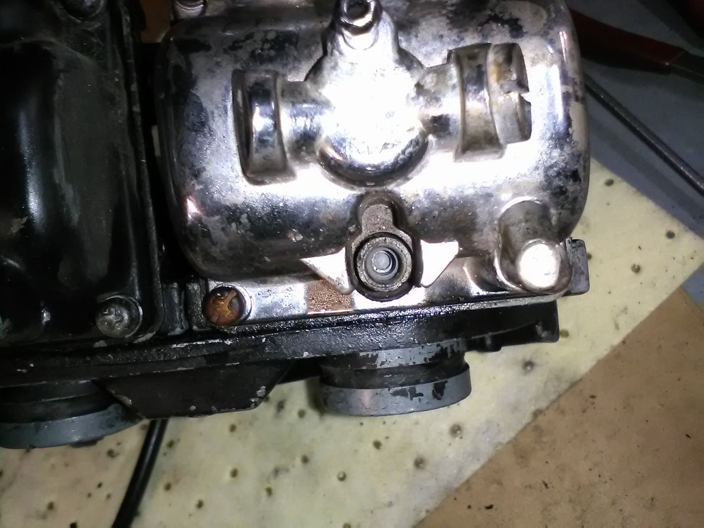

I took the float bowls off & I must say I have never seen nylon main jets before, also the mixture screws appear to be blanked off so you cannot adjust them, other than the usual varnish all looks ok, I will strip & put them in my ultrasonic cleaner then reassemble & put in the goodies box h
Re: Mishmash Zed
Nylon jets aren’t uncommon, had a few sets and never had any problems.
