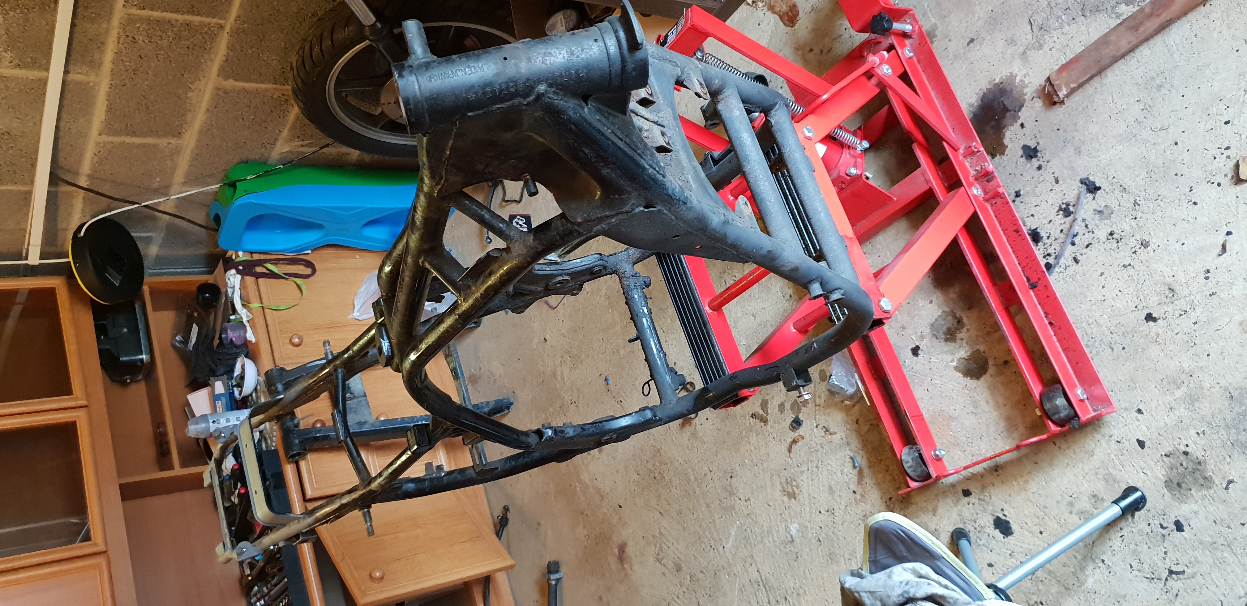

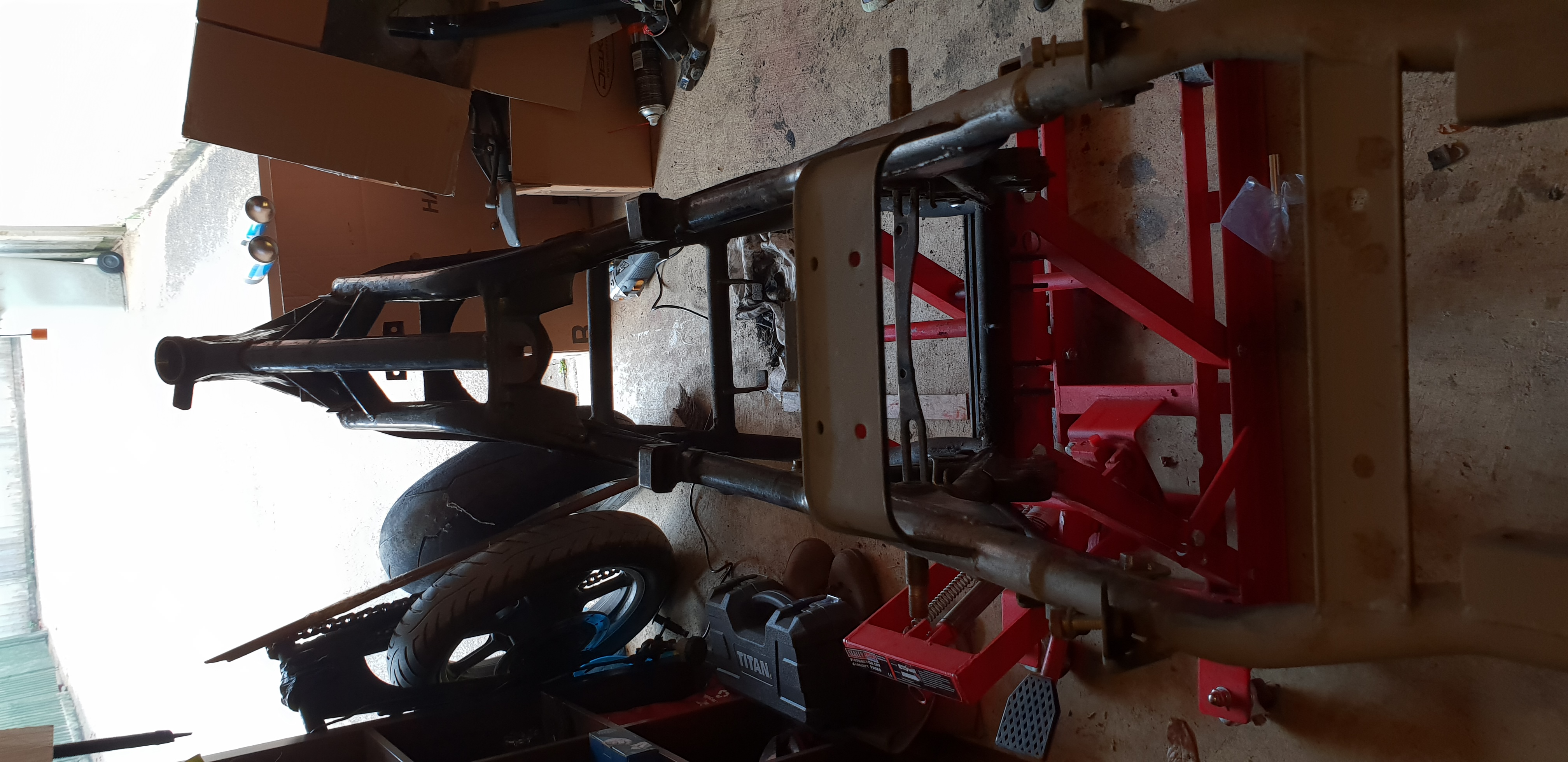

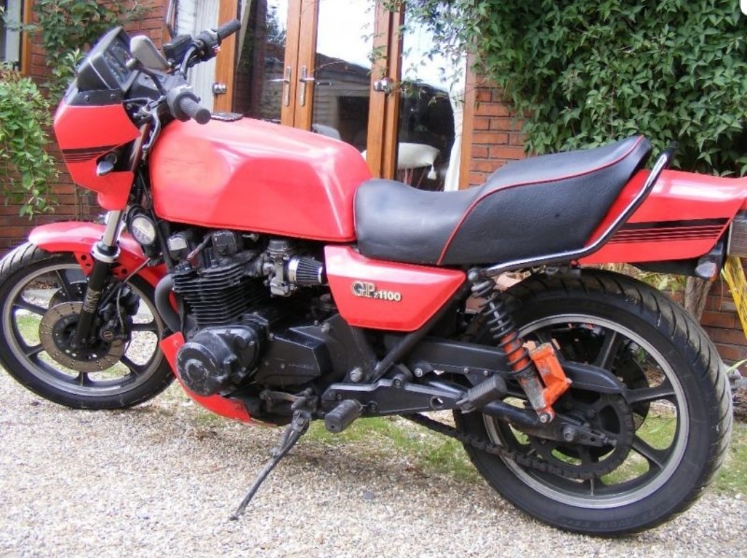

Here's my 1100b1
This is how I got it after a long time looking ....
And now so far ..
Just stripping and mocking up

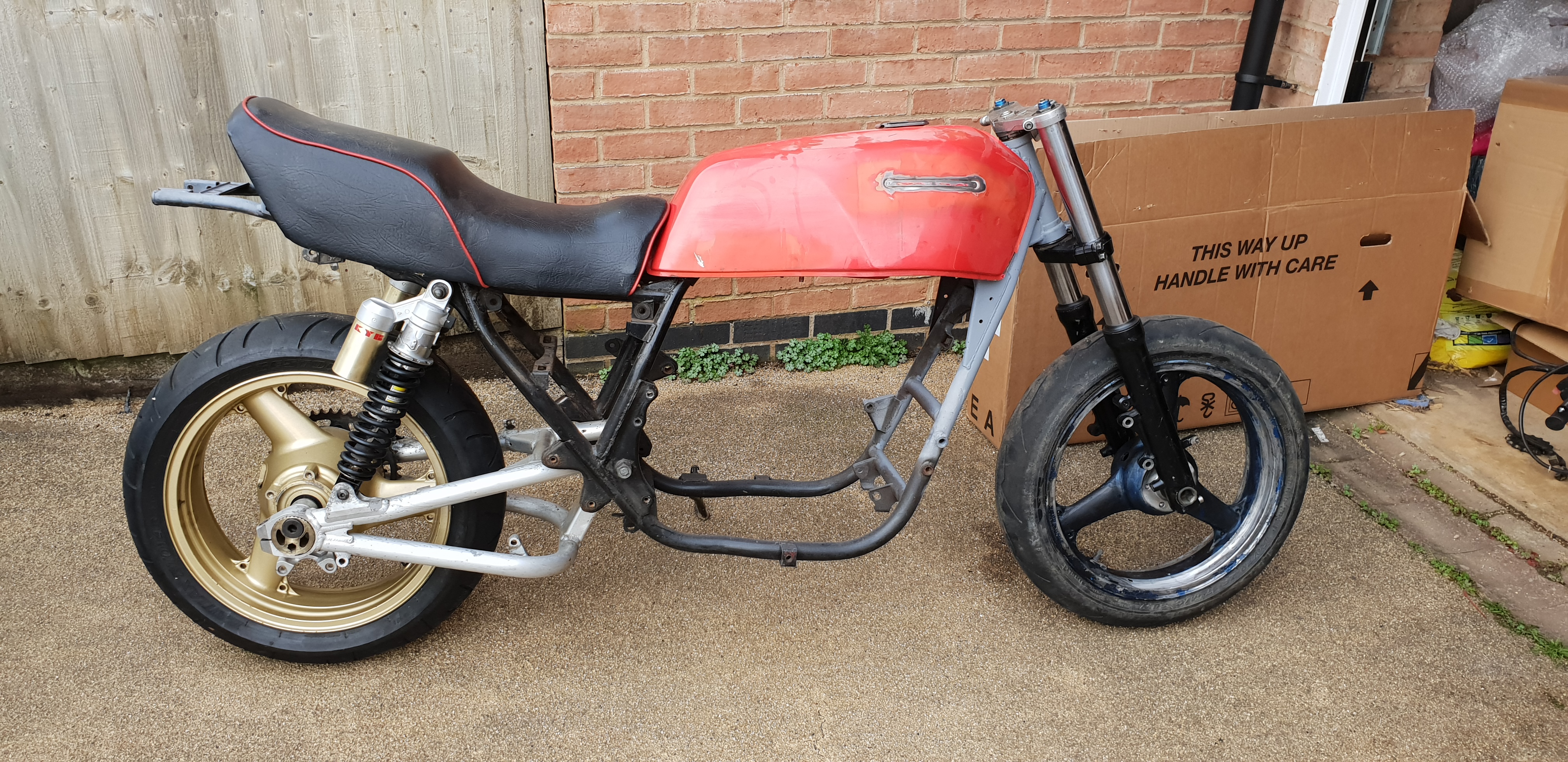

Spec.
Std engine
Gsxr flat slides
Zx9r f model forks love the 46mm forks.
Zrx 1100 rear end inc shocks
More pics next week

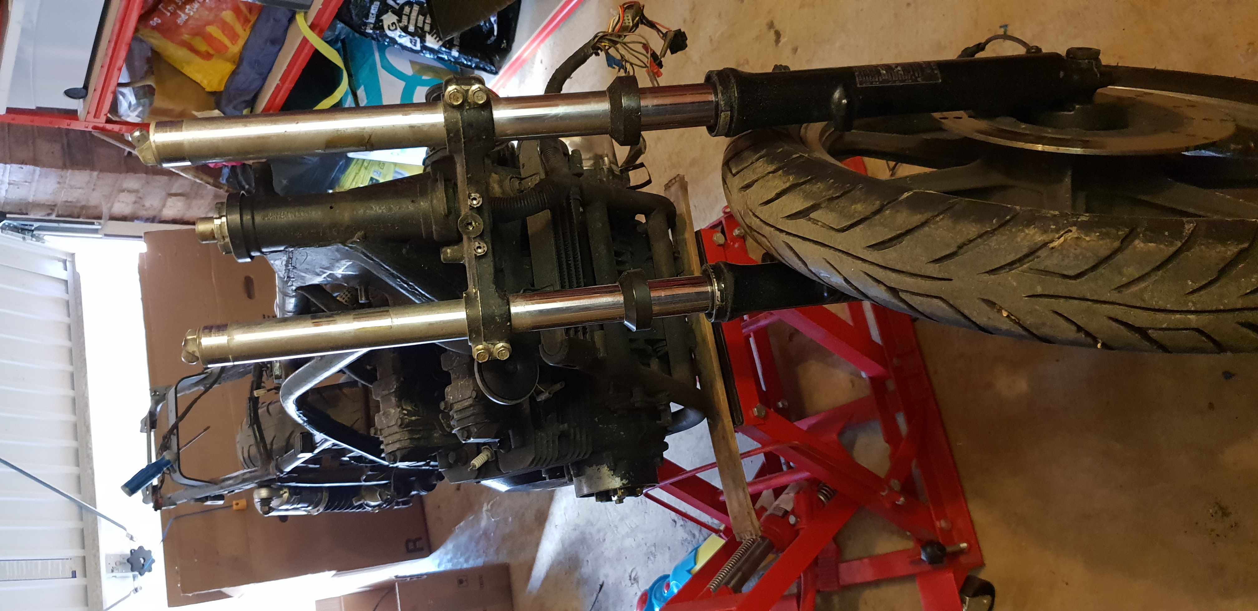

Thanks I have no intention of changing anything so that the original parts cant be re fitted and they are staying with the bike . The only exception to this is the rear shock mounts which I'm having custom made and I will have to cut the old ones off but sympatheticily .my zx9r E forks have had the stem machined to take std size gpz bearings . I'll post more pics ..later ..

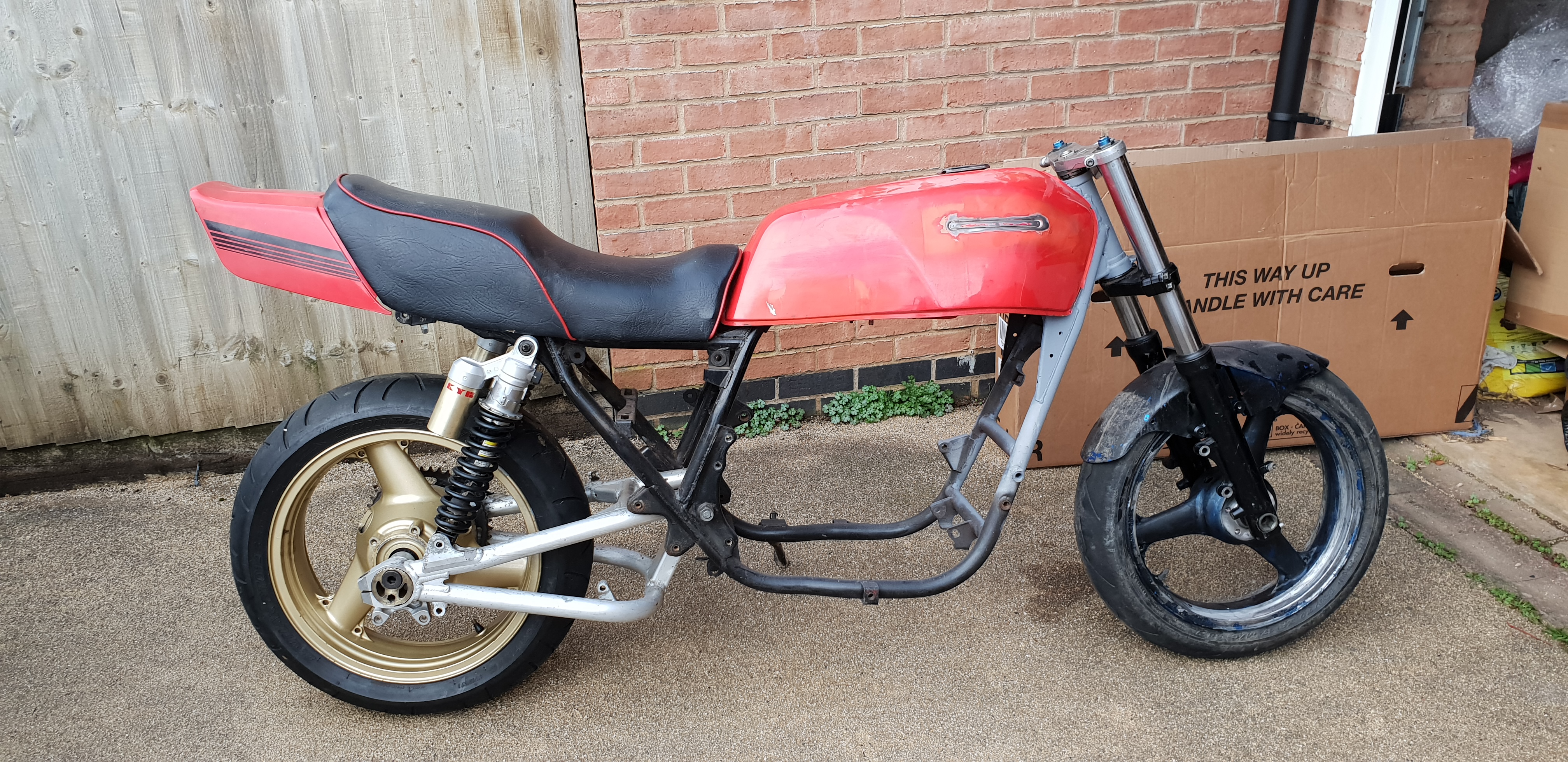

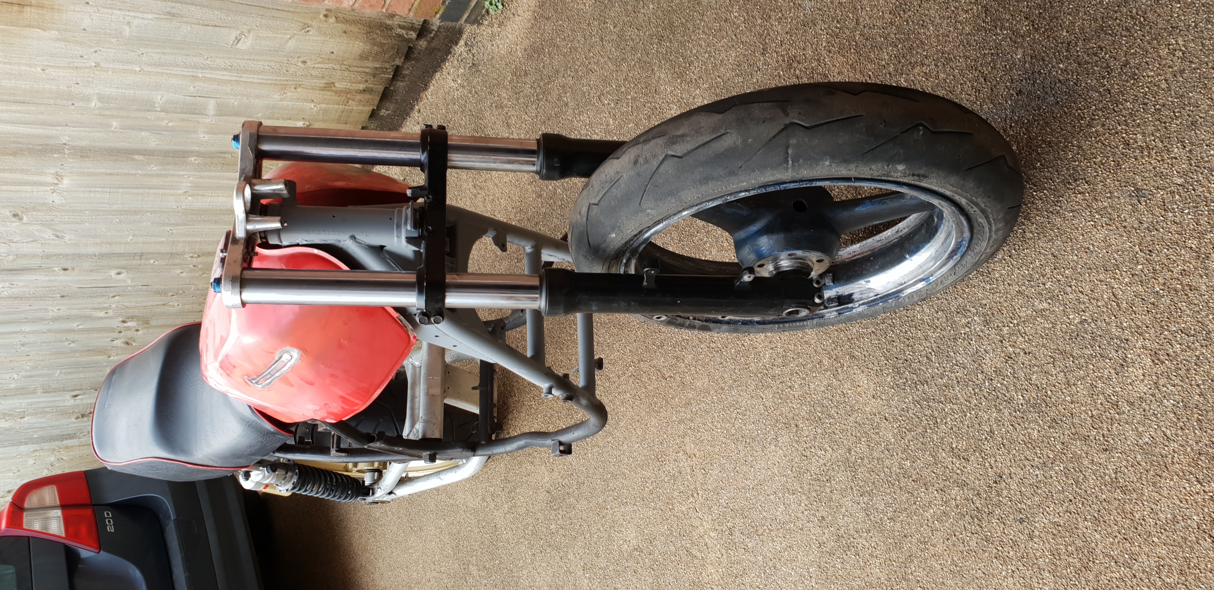

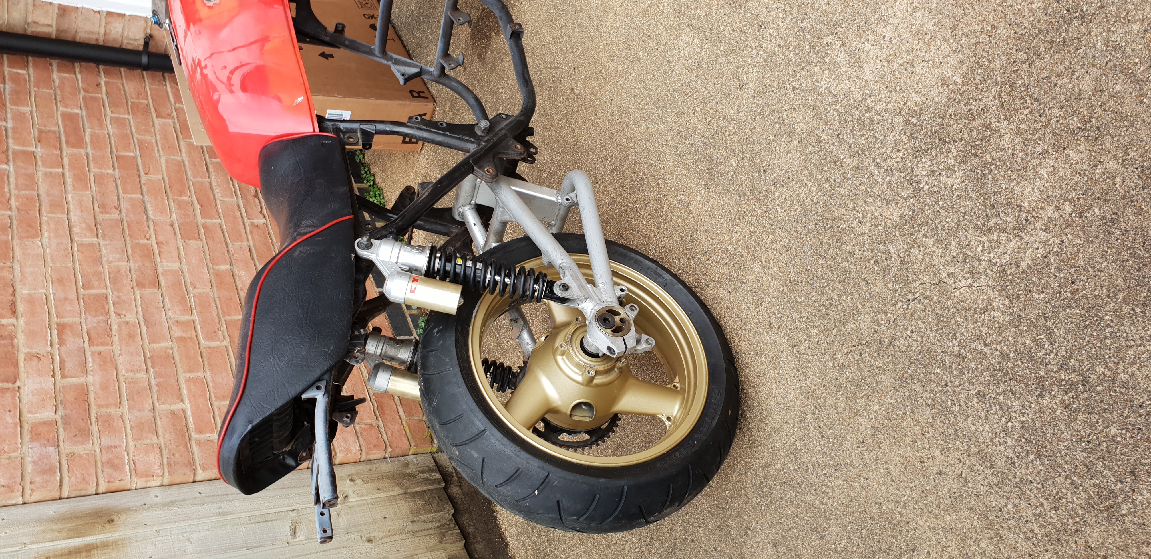

Slight progress head stock machined and swing arm and wheels mocked up for fit ..

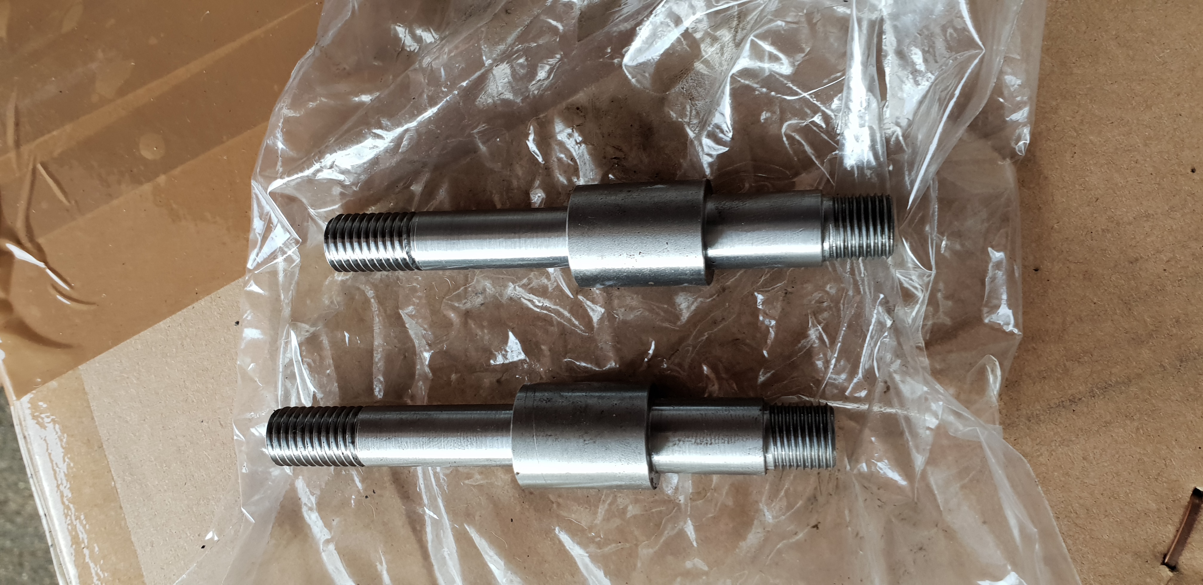

Rear shock extenstended mounts collected . Hopefully done so they look stock and bolt in as apposed fo weld in a little machining and back to std .

#9 PostAuthor: VinnyE » Tue Dec 11, 2018 9:35 pm
I like what you have done so far MrC !
If you don't mind me asking, who made the rear shock mount adapters?
