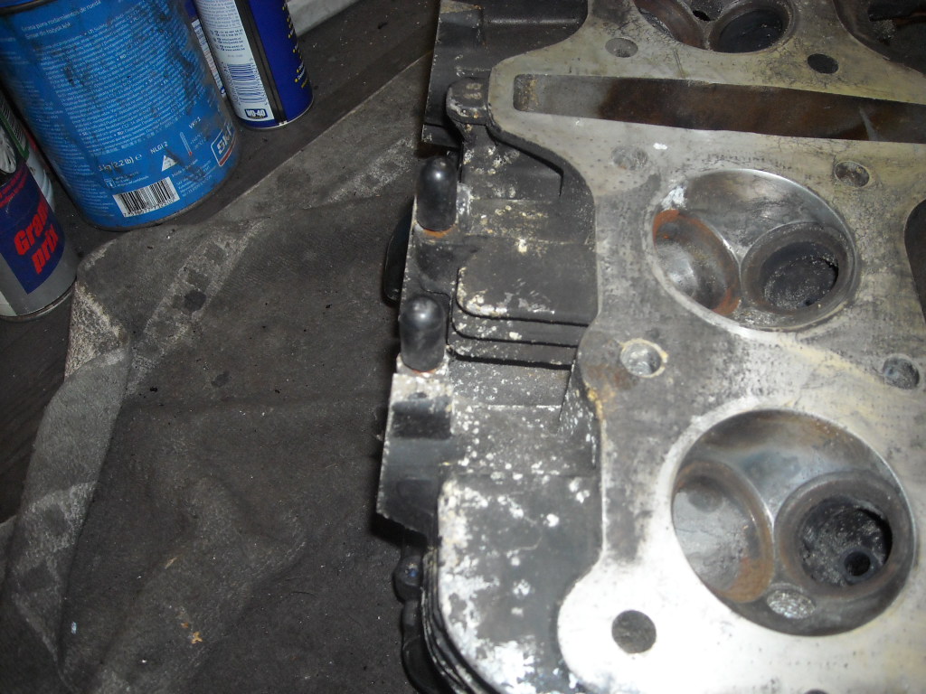

Hi RAYZ1
as promised, some pictures of the dirty, dusty '72 Z1 head with the original colour on.
I think that the paint is black, I rubbed the dirt and grease off at one spot.
the intakes for the vacuum meters
As you can see the intakes for the vacuum meters are in the head itself, it's not the first model Kawasaki used, after approximately engine number 2200 they changed the intakes for the vacuum meters to the carb holder rubbers.

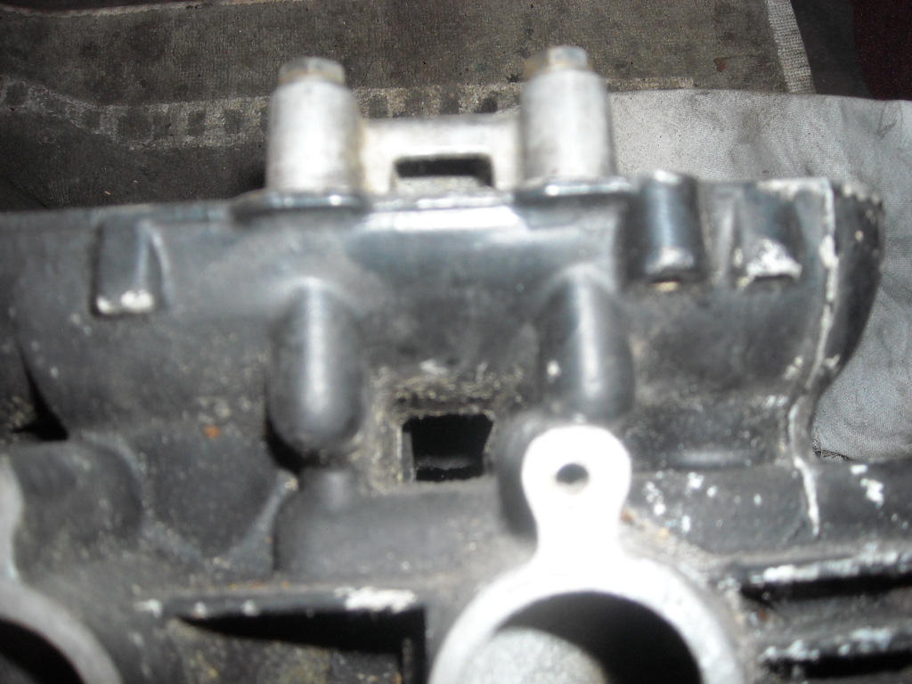

the original "black" paint
Here you can see the original paint, it's at the backside of the head.
As far as experimenting with paint by KHI is concerned: everything is possible !
I think the frenchies repainted the head, and when you remove the valve buckets you could find TWO shims on one bucket. It happened to me before! A 0,05 mm shim under a 2,15 mm shim. I gues they were short on 2,2 mm shims...
They're nice people but they do some mechanical things "the French way". :eek
