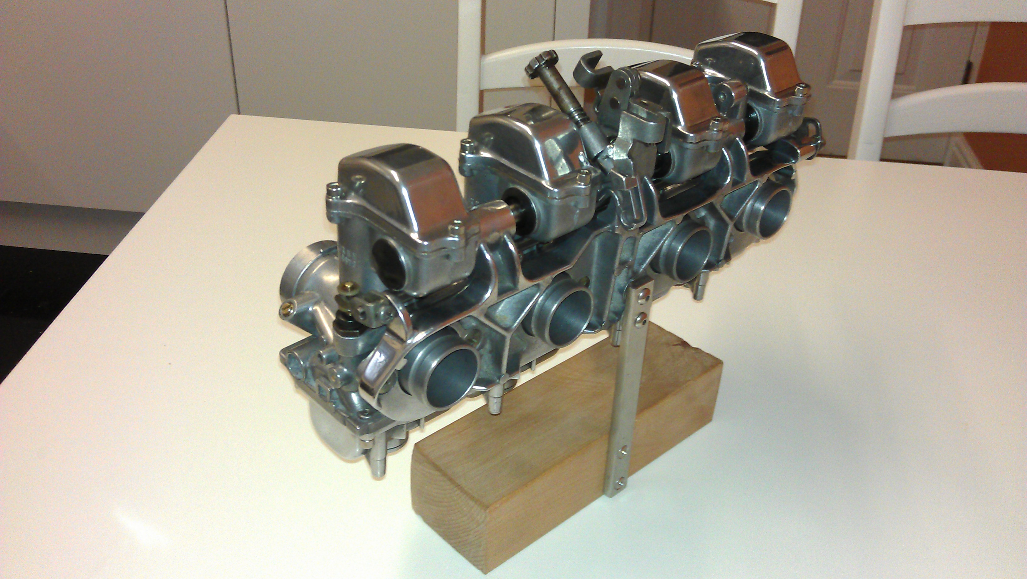

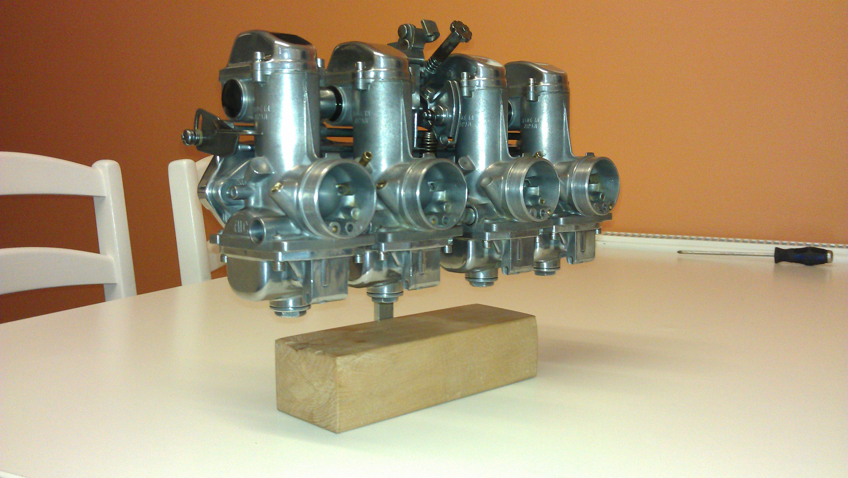

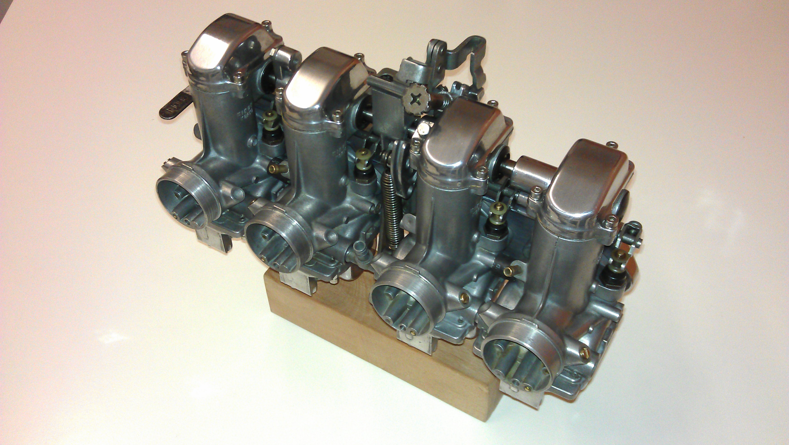

I was playing in a band which took a lot of my spare time and was one of the reasons it took me so long to get round to the project. The first thing I decided to work on was the carb’s. Back in 97 I’d stripped ‘em down cus the Zed had stood with fuel left in it for a while before I dismantled the bike. The petrol had evaporated and left a kind of lacquer residue behind, so I’d started cleaning them up but that’s as far as I’d got. Fast forward to 2016. I like carburettors. They’re nice to mess with. I managed to clean all the nasty off and got em back together and they look great. I just hope they work as good as they look. Mind you, all the carbs I’ve ever messed with, I find that as long as they’re all clean and nothing obviously worn out they work. I even balanced them. I come across this somewhere. Get 4 ball bearings Ø3 or Ø4 and put them in the intake against the slide. As you raise the slide slowly with the tick over screw, the ball bearings drop through. . Adjust the slides so that your balls drop simultaneously when the slides open. I know each cylinder sucks different, but it’s got to be a good starting point from a rebuild. Oh yeh! DON’T do this with carbs on the engine. You don’t want balls in your head.

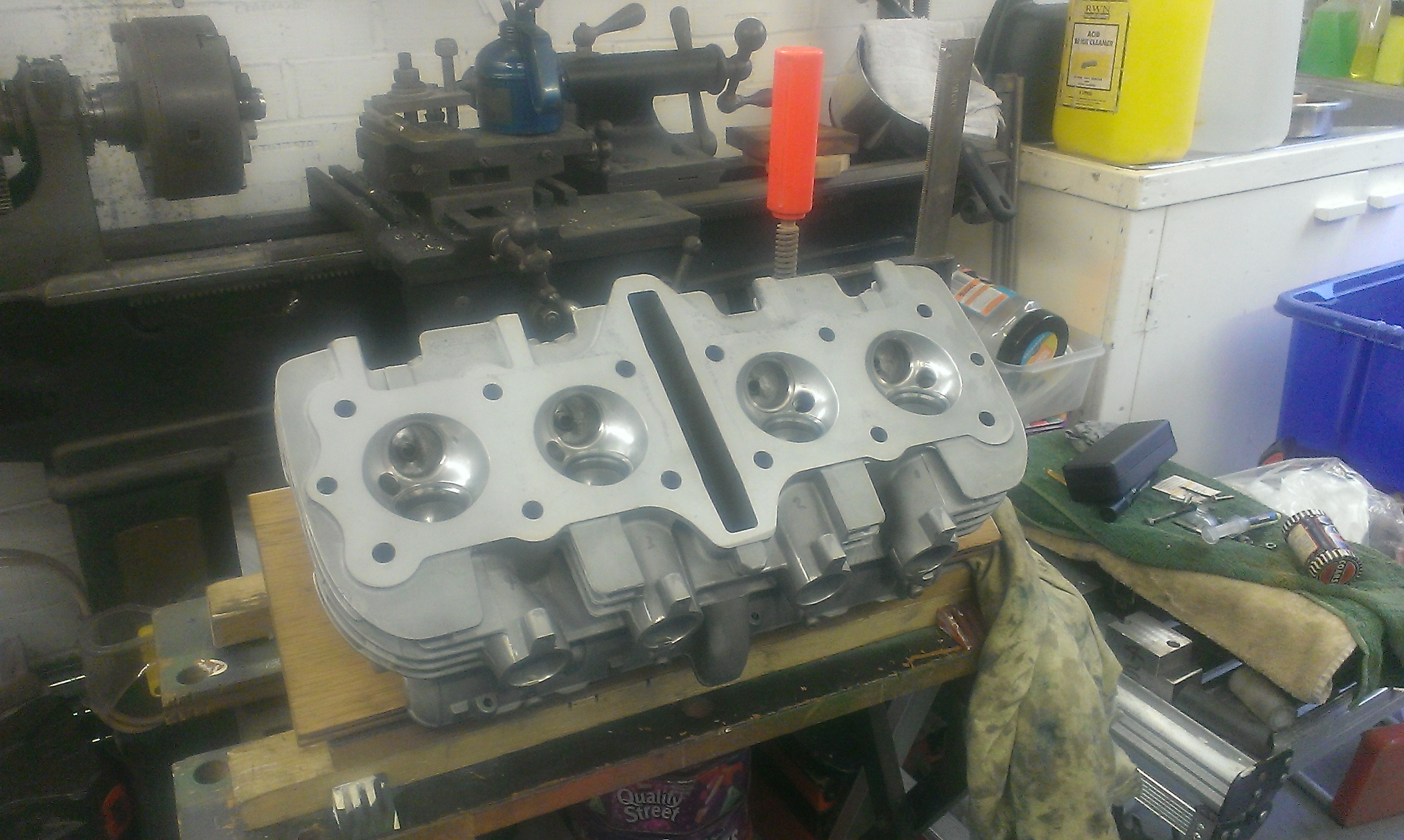

Next up - Cylinder Head

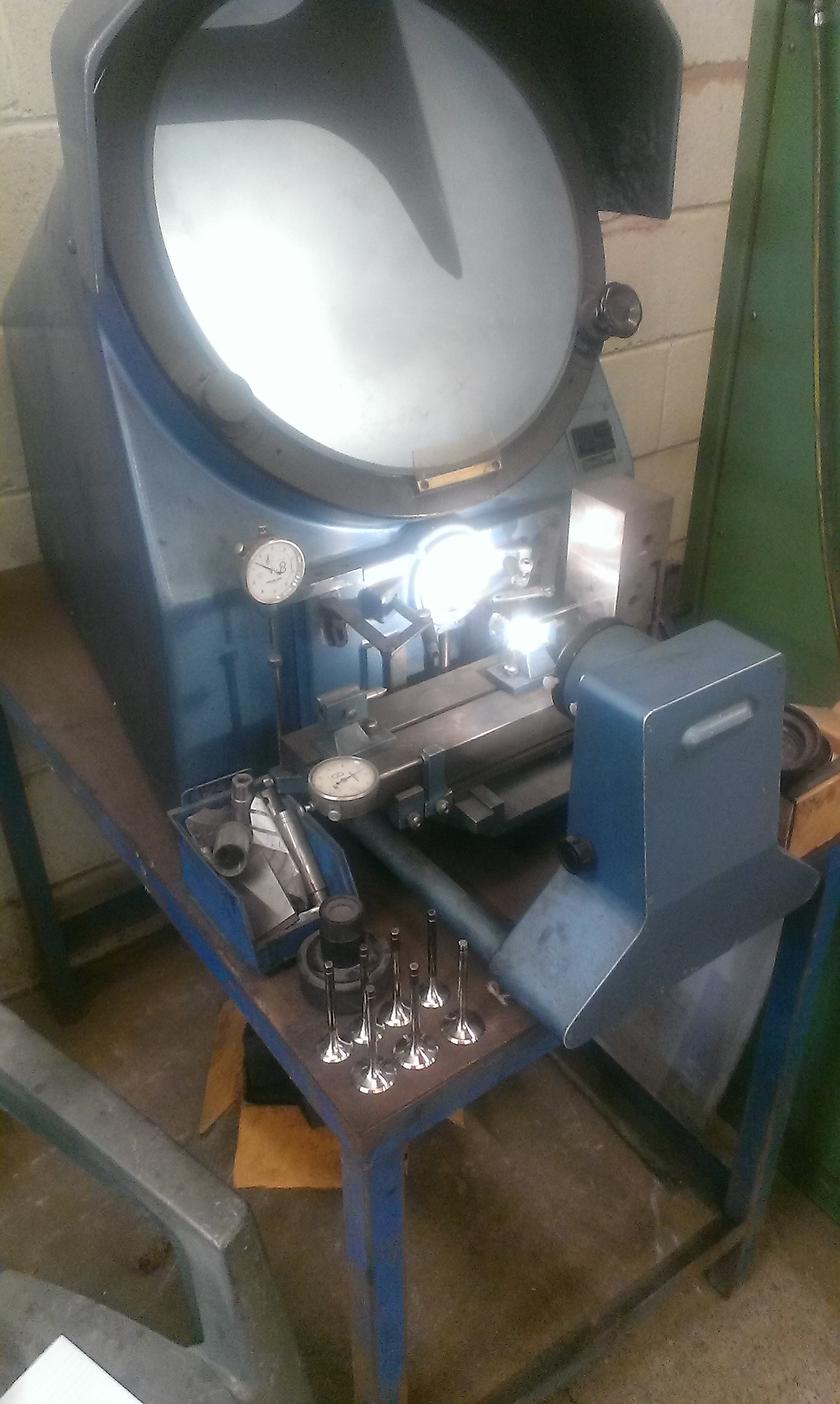

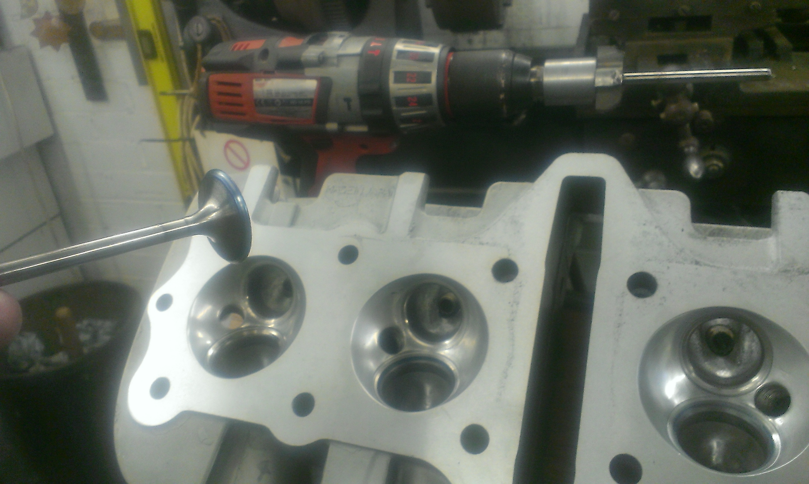

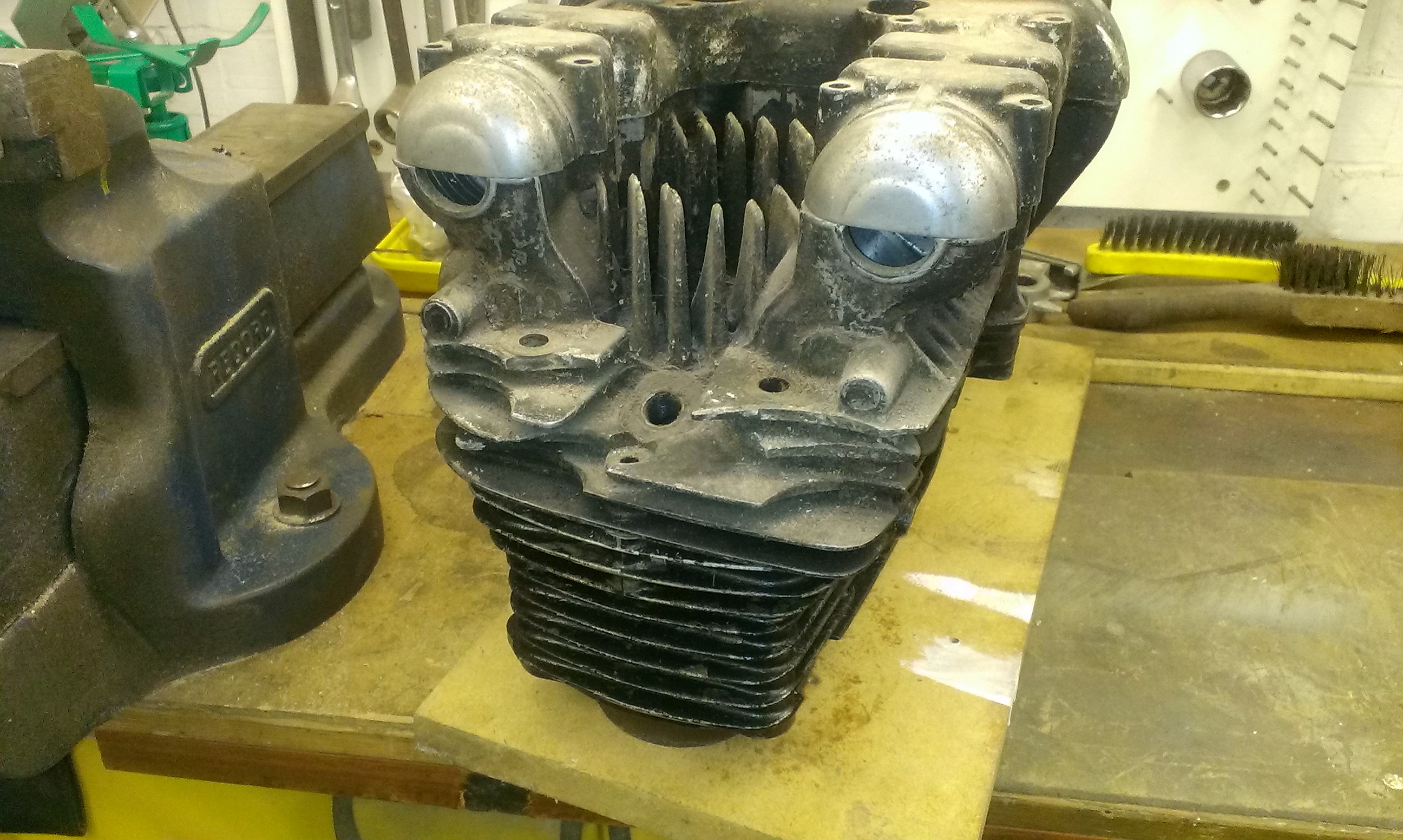

Bob the welder did the fins.
I cleaned up the valves and checked them on a shadow graph

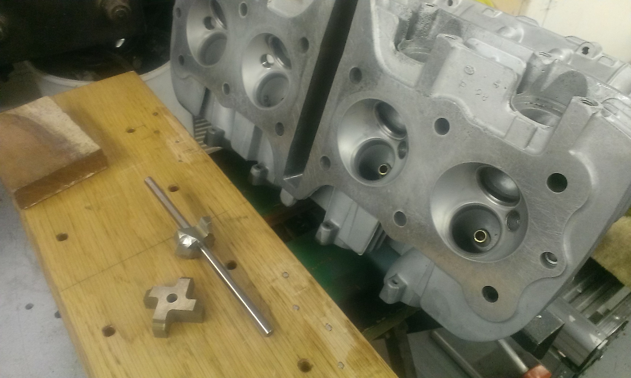

The guy on the wire eroder at work made me a valve seat cutter - 3 angle job
Got em all blued in nice.

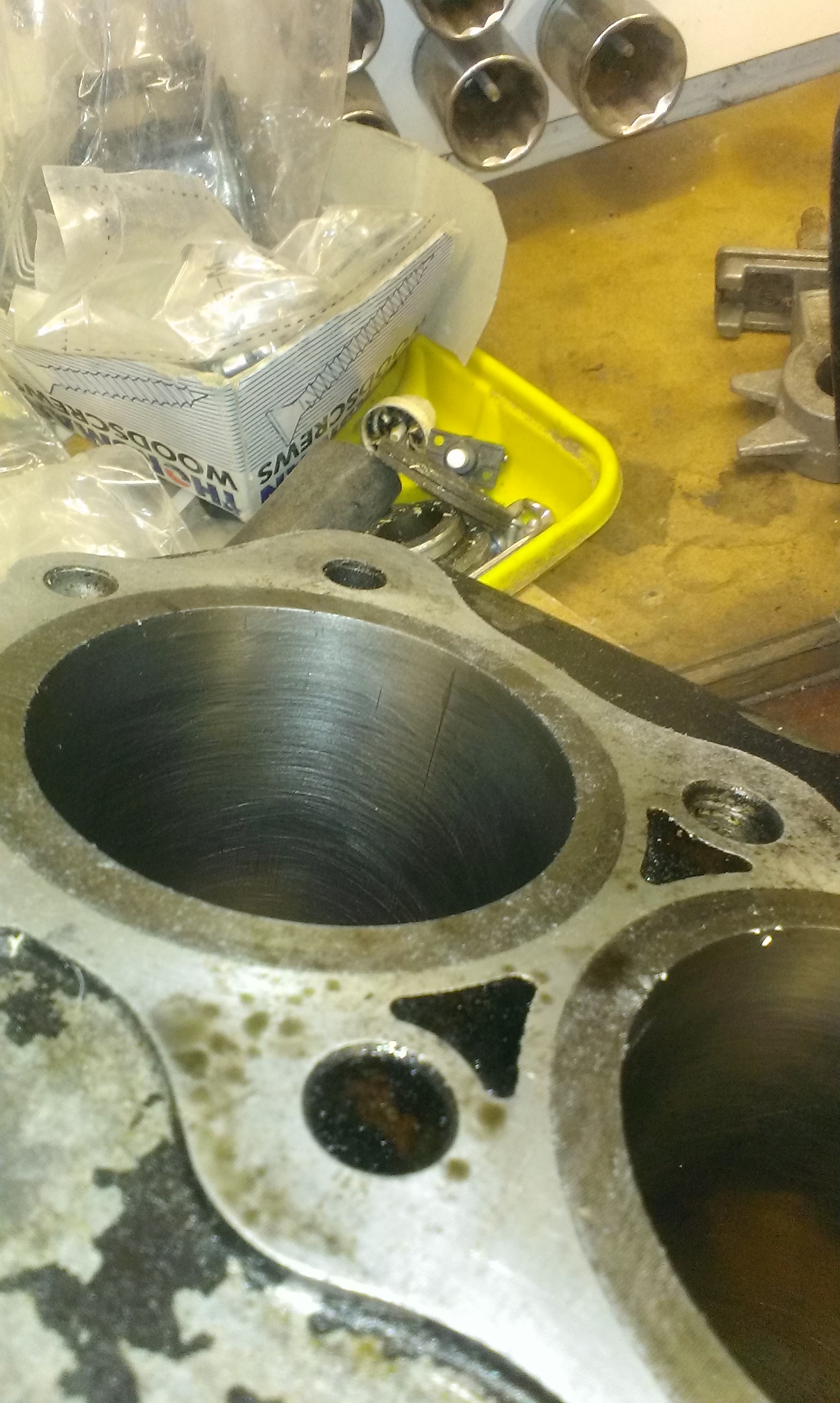

Barrels next. Nasty score (like Wolves 0 - Huddersfield 2)
Already on top limit so only 1 thing to do. New liners

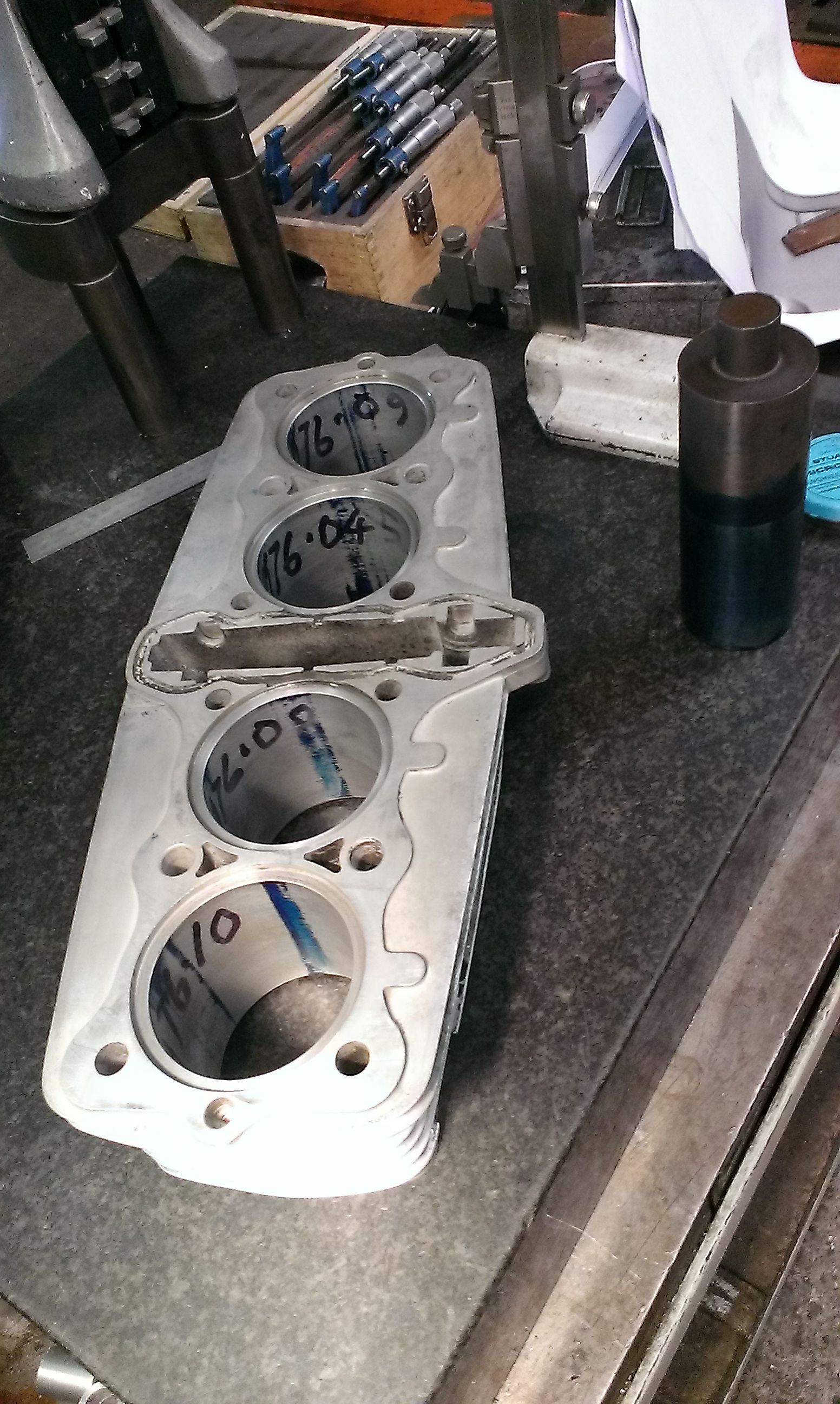

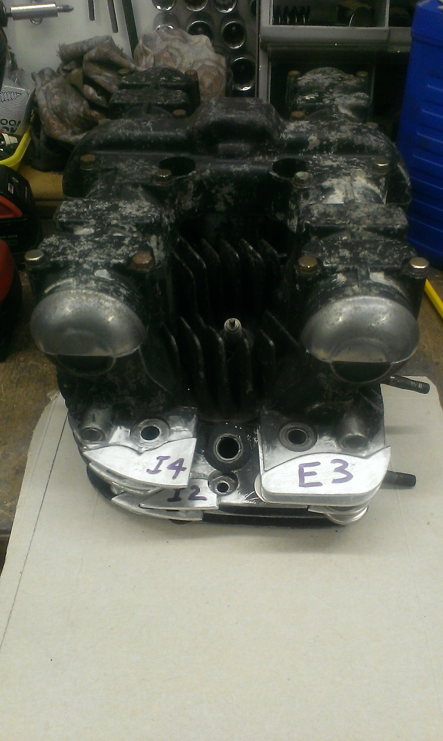

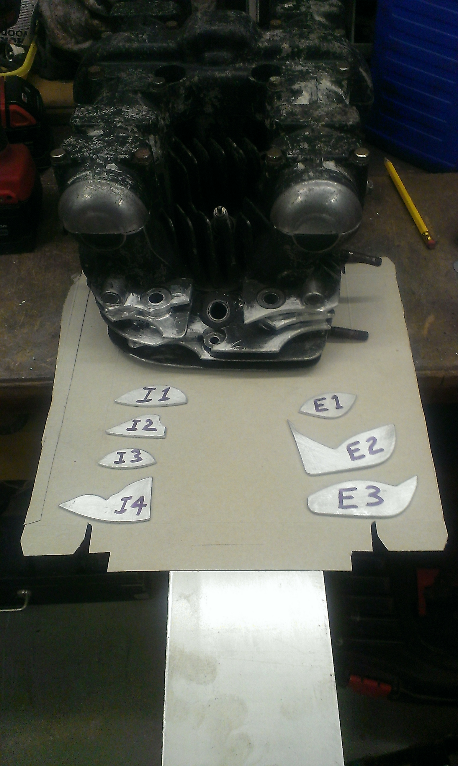

The old liners came out quite easily with a flat block of wood and a mallet
Then I checked to make sure the bores were square to the base and got sizes for the new liners

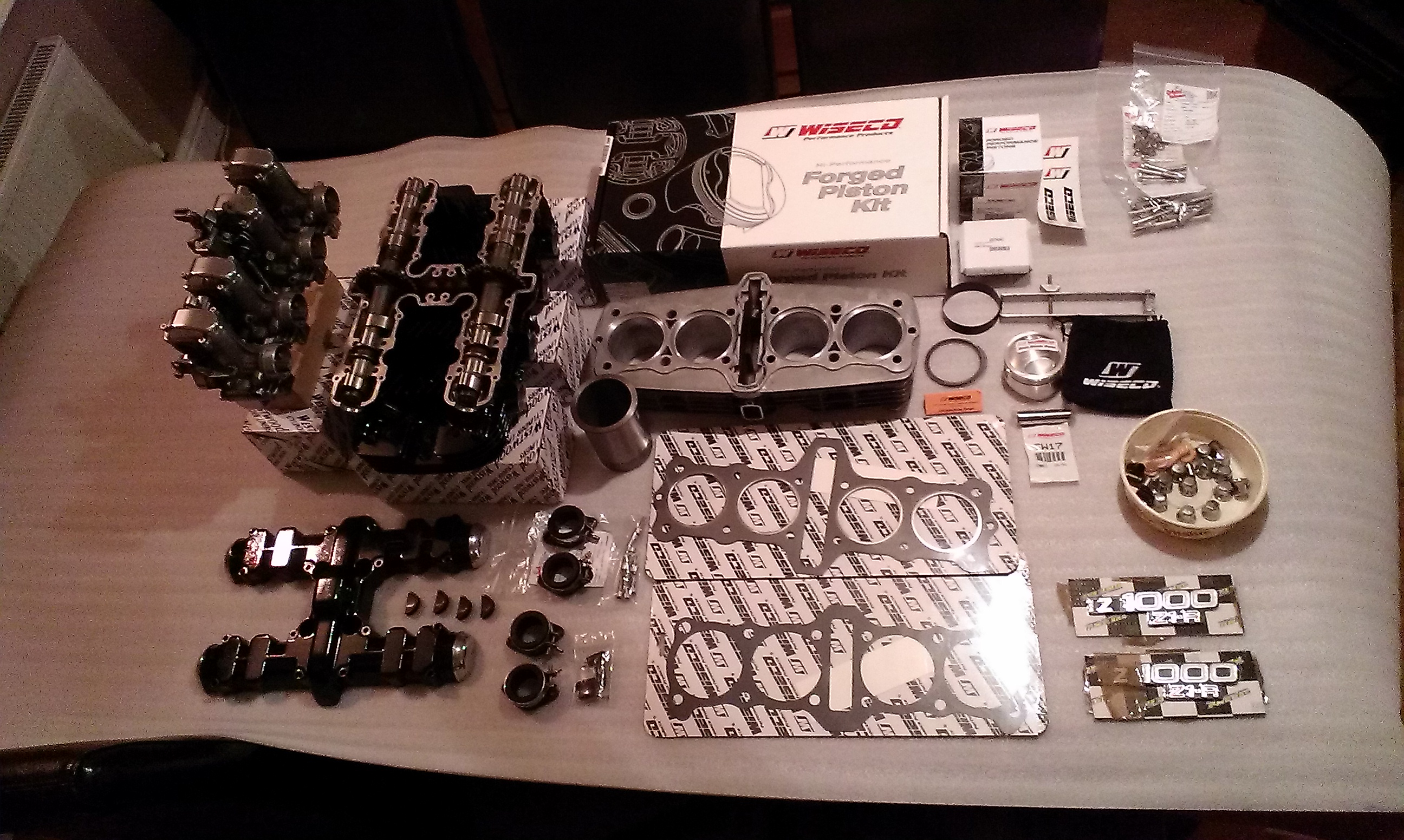

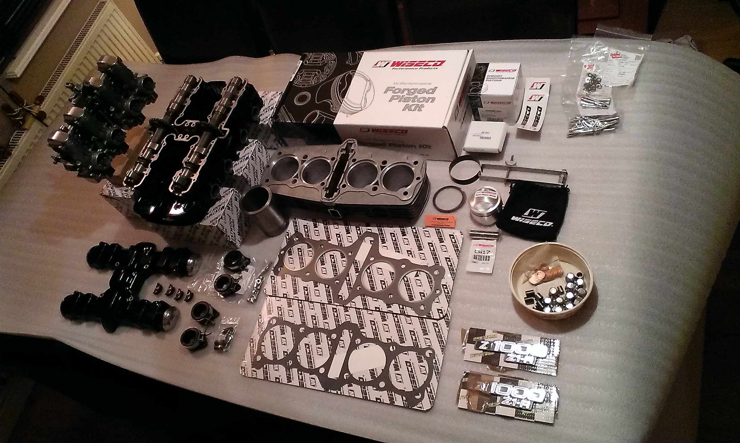

I've done the carbs, head and barrels and started buying new stuff.
Lovely!
I went for 73mm pistons. 1105cc
Lovely!

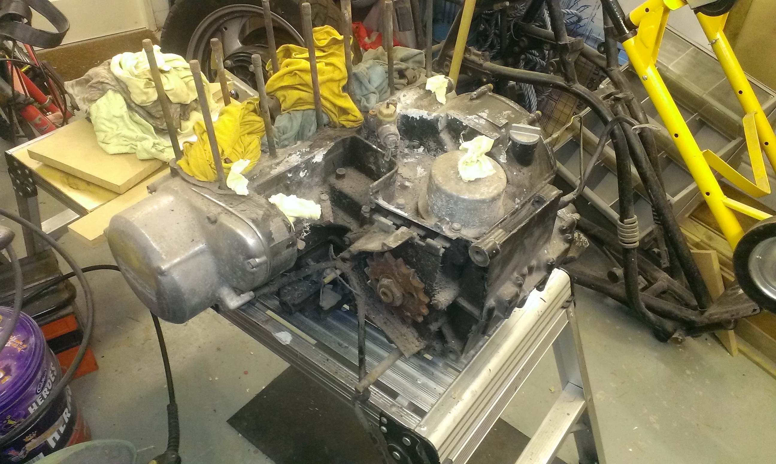

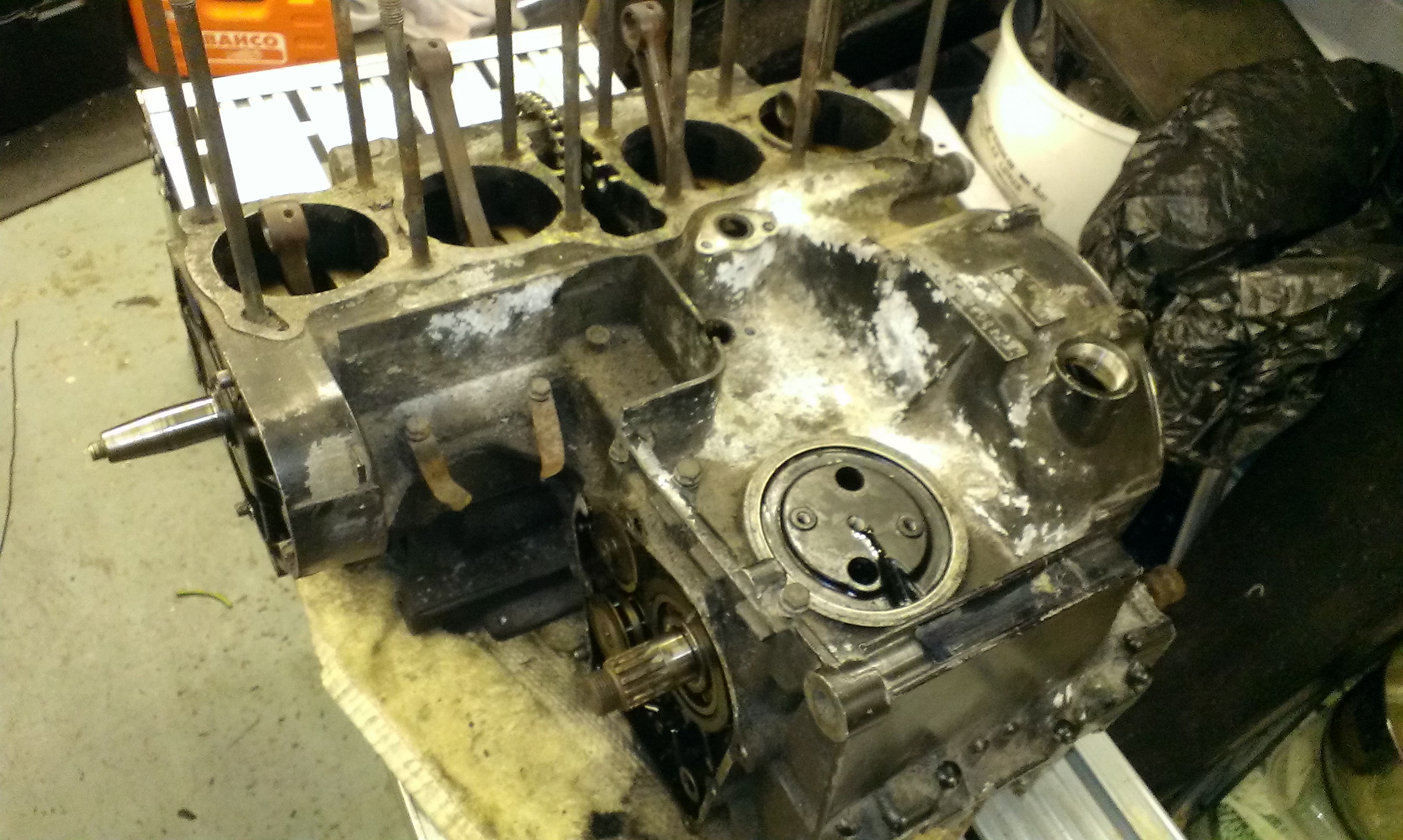

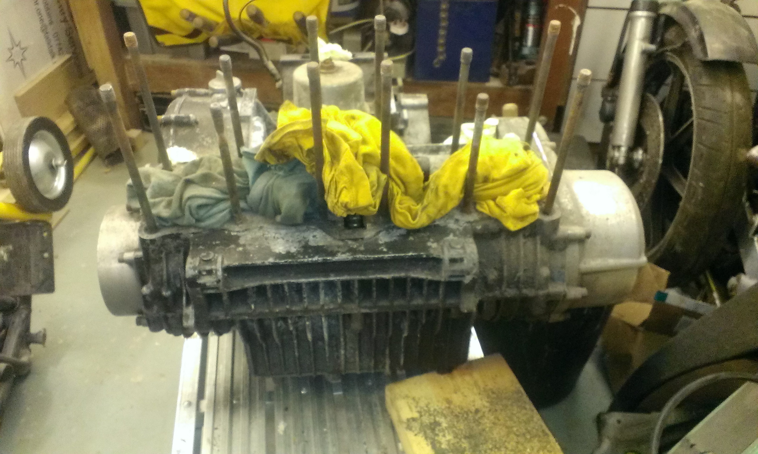

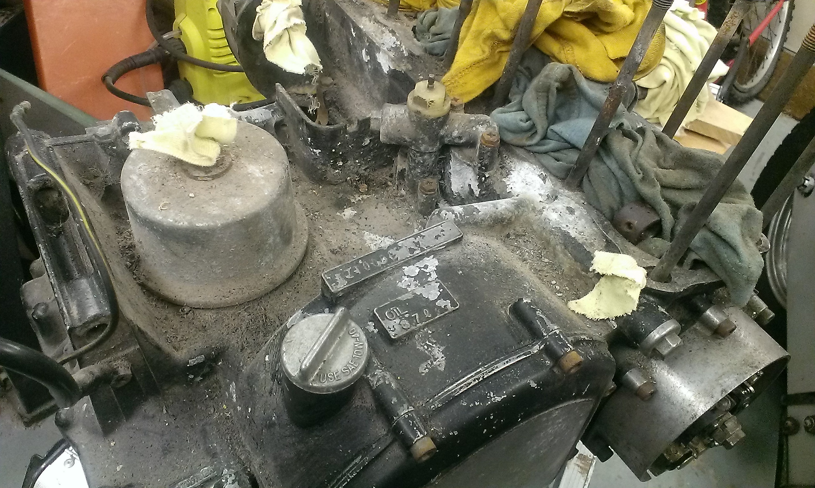

Bottom End
I'd forgotten how bad it was.
Check the front end out on the right. Hmmmmm Z1R front ends!
Notice the improvised tank rubber
It ain't as bad as it looks - honest
