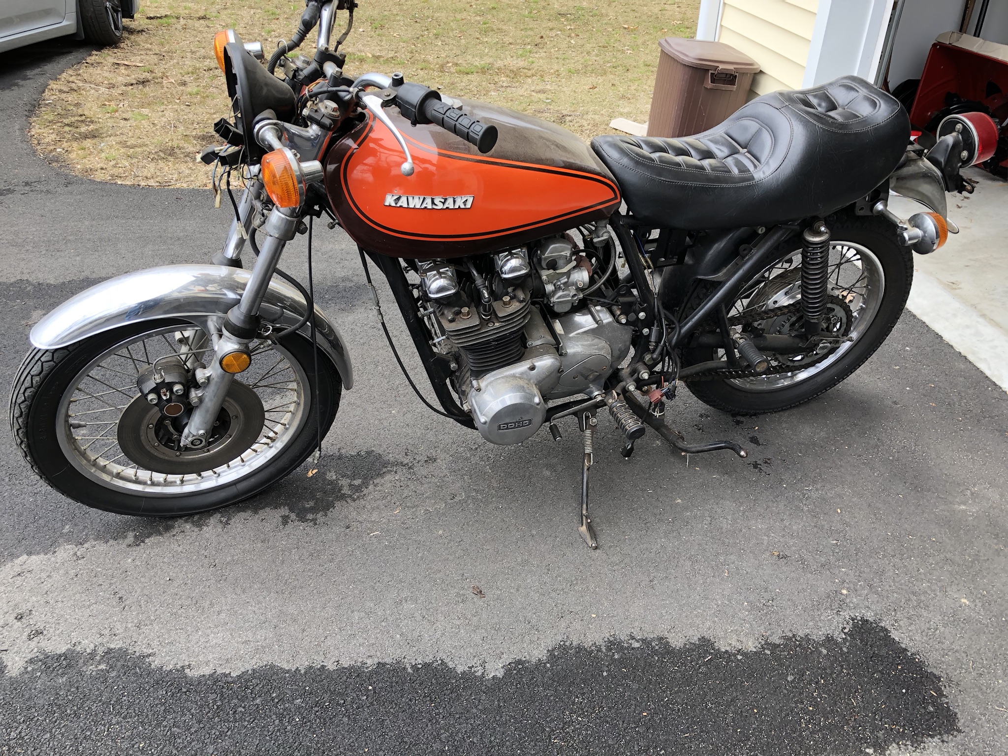

As-found condition in the US...

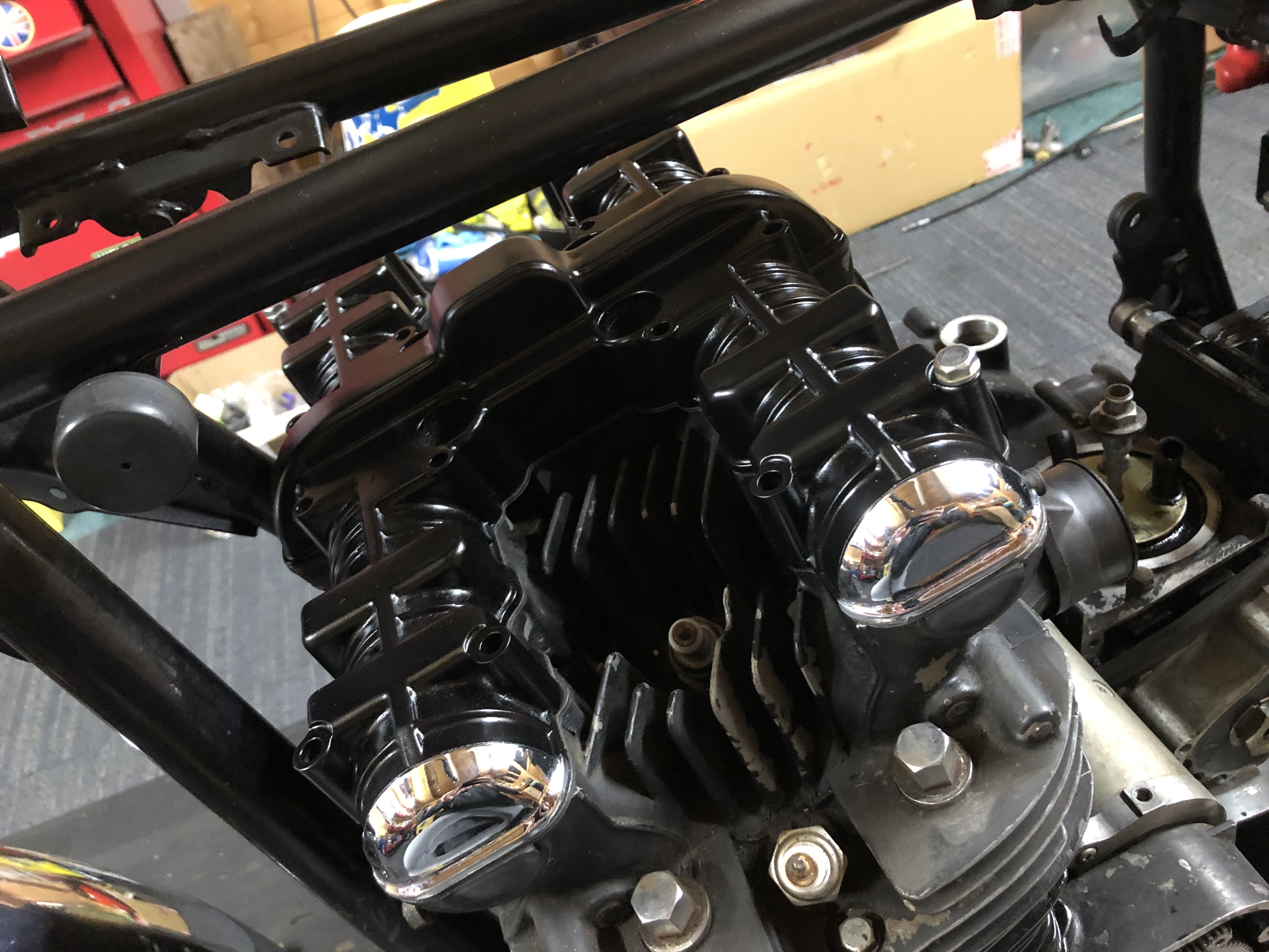

So the bike is in the workshop and have stripped back to the essentials so I can clean her thoroughly and prep the engine for paint.
I’ve removed the cam cover which the PO told me was ‘chromed’ early in its life. Was a good test sample to see how the satin black finish would look. Pleased with the result/finish.
All of the cam lobes look in great condition. The oil that came out of the engine was golden and clear. Will drop the sump over the Christmas break and check for sludge/clean the oil pickup strainer.

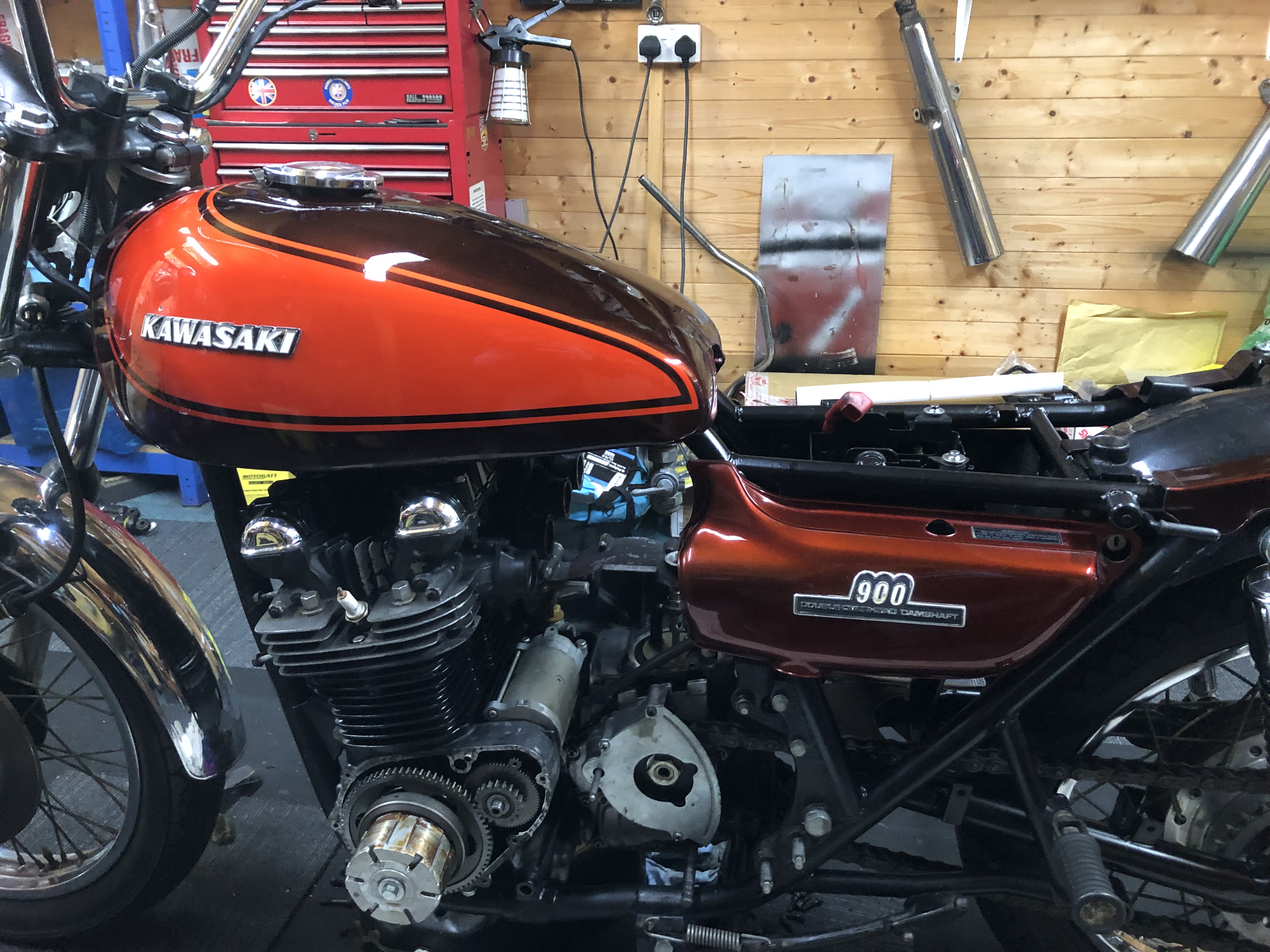

I also couldn’t resist seeing how the original paint would respond to a light correction with my DAS-6 pro polisher. The panels were degreased, clay barr’d, then gently polished with a finishing pad.
I did a 50/50 on the tank to show the effect - difficult to see in artificial light but the photos show how lovely and original the paint is. There are chips, dents, marks here and there but that’s part of the charm I guess..

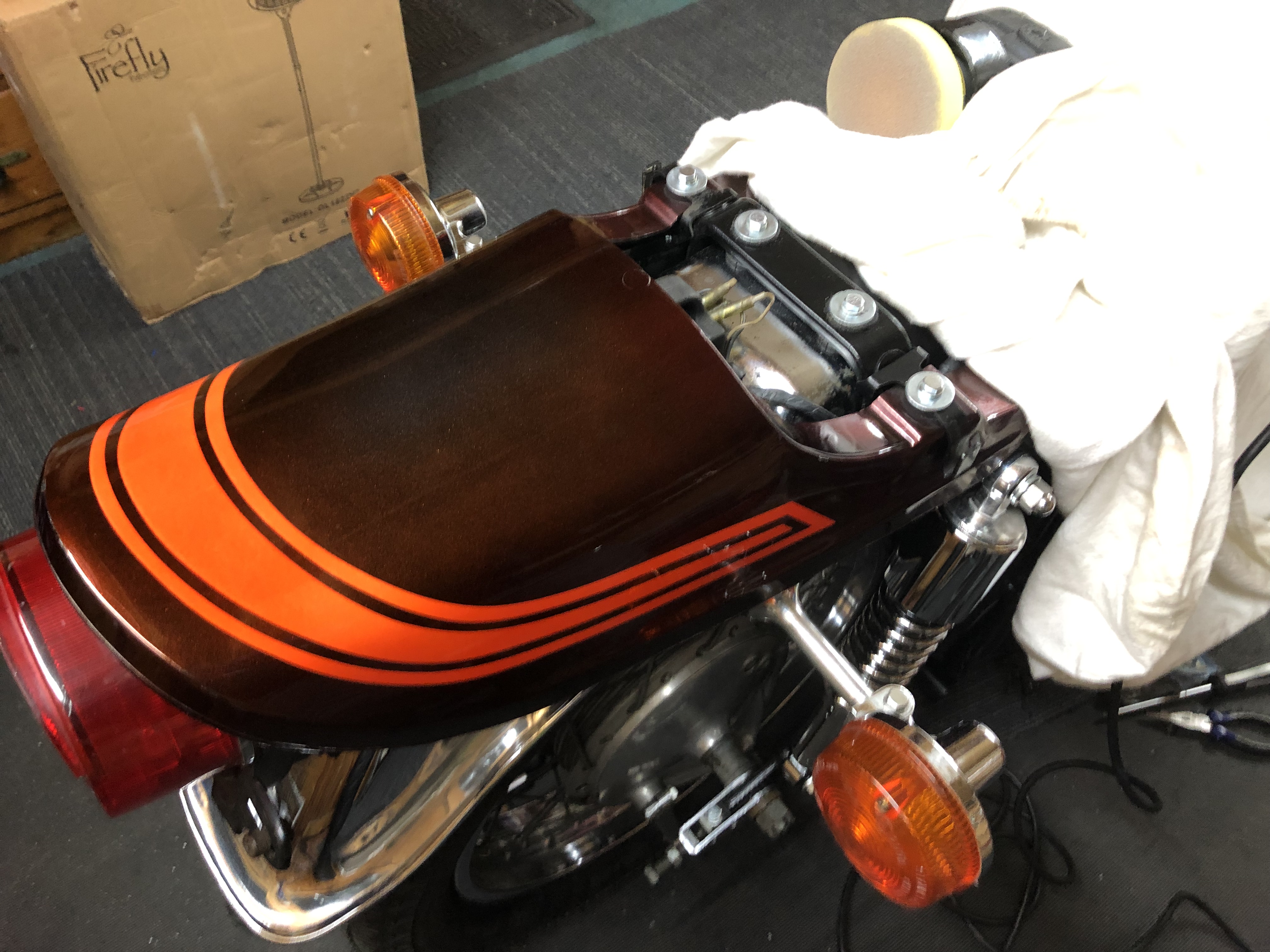

Tail section rebuilt, polished and refitted..

Author: JamesH_Sussex
Polished and test fitted all of the original paintwork. Have to say I’m feeling slightly chuffed with the finish - she’s going to turn out nicely I think. Not bad for 44 year old paint eh..!
Note: rear shocks currently fitted are UK spec units (Z-power shipped the wrong ones and I fitted them, then had the ‘what’s not quite right here’ question in my head before realising where the f*ck are the bloody reflectors ??).
I’m so used to working on Hodna CB750’s I didn’t notice at first..
