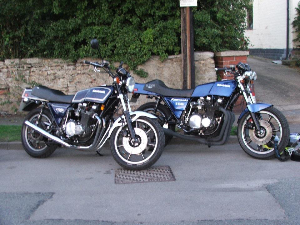

I purchased the bike in the mid 90’s form an import company based in Harlston Norfolk a few years later 2000 I sold it to a friend, in December of last year it came home, unfortunetly it has been stood in his garage for a few years so needs a bit af TLC
Pics of its last day on the road
Z1000 MK2

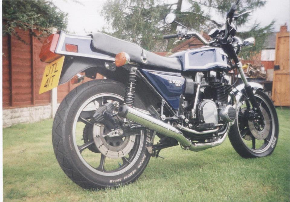

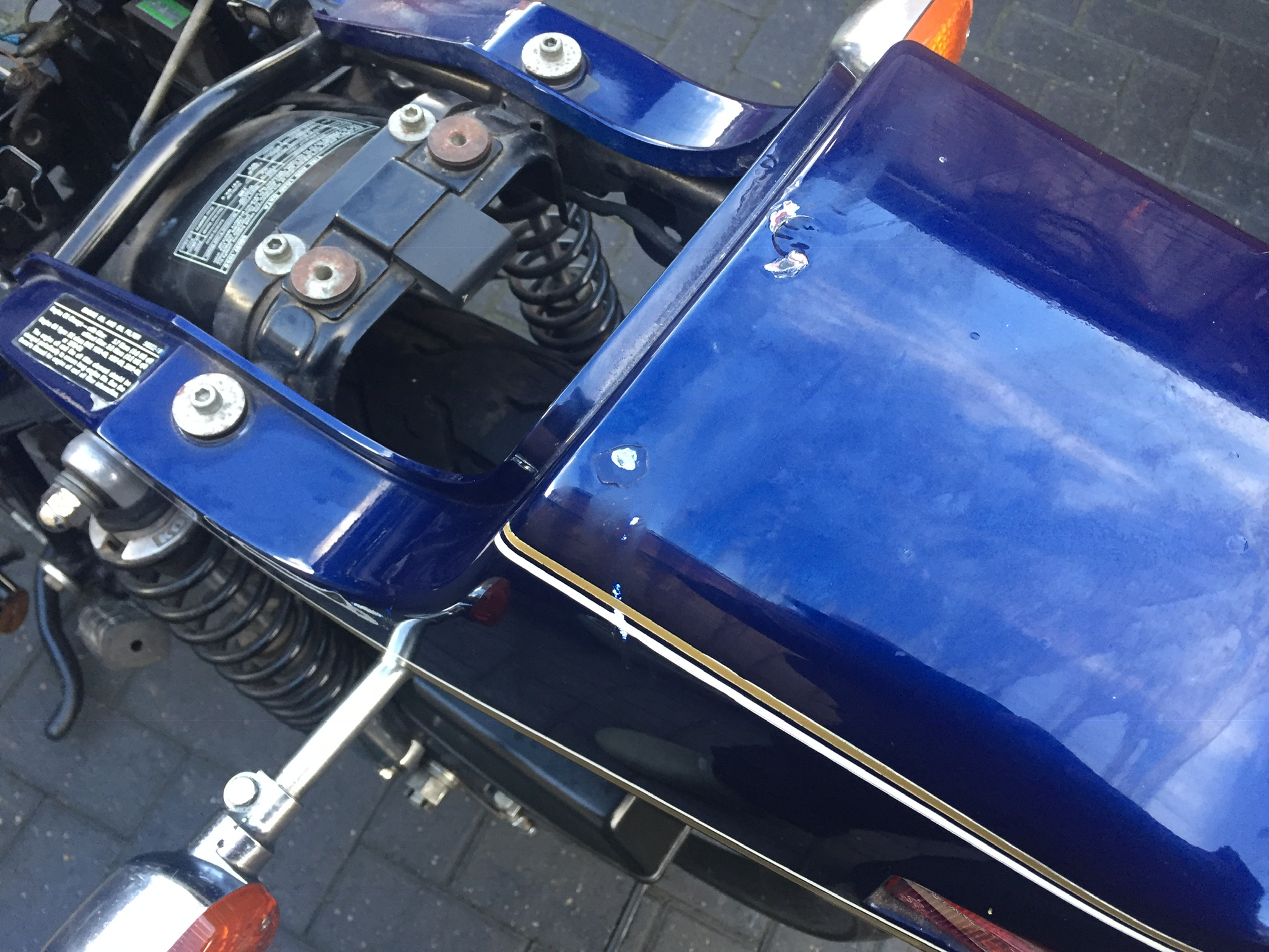

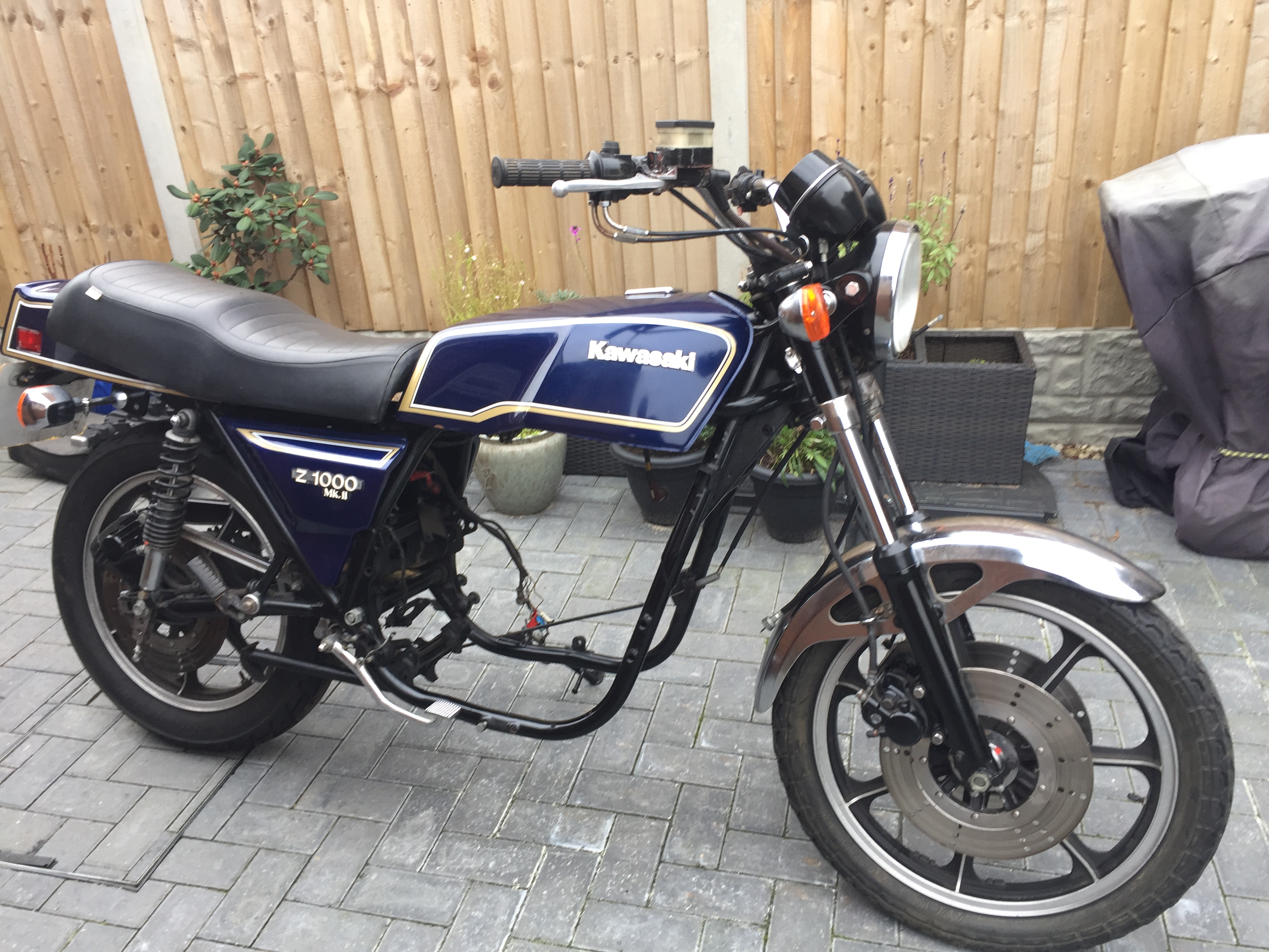

#2 PostAuthor: Gavin » Tue Jan 15, 2019 11:51 pm
It’s first day home after it’s time away

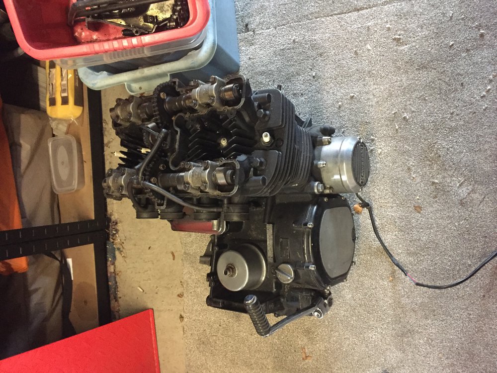

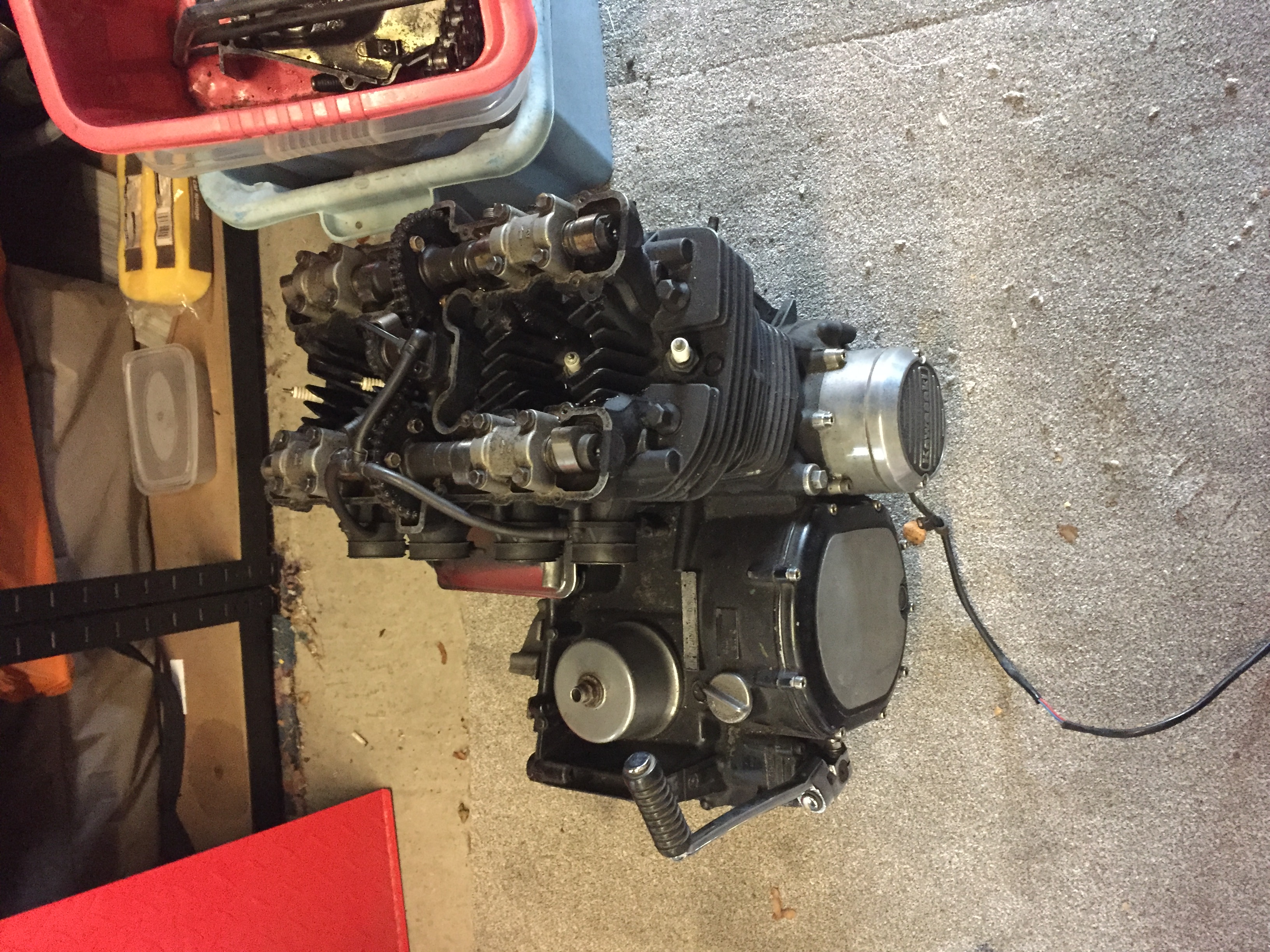

#4 PostAuthor: Gavin » Wed Jan 16, 2019 12:00 am
The start of the investigations

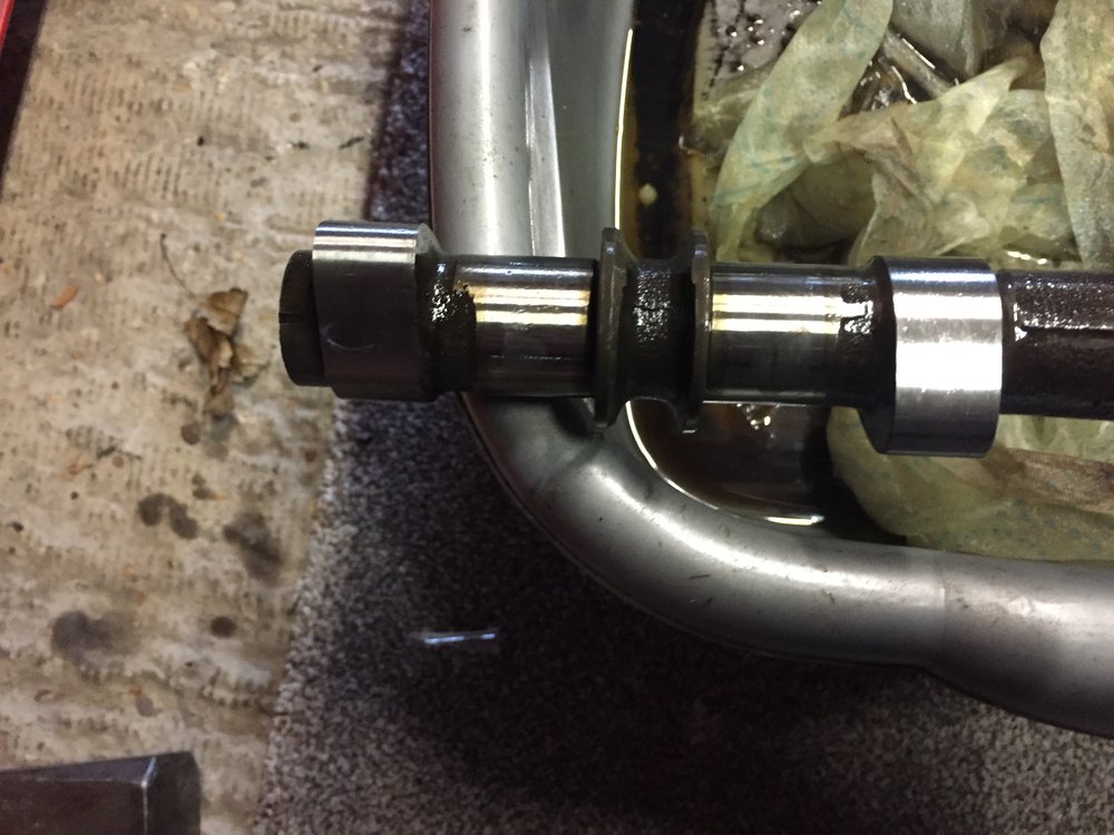

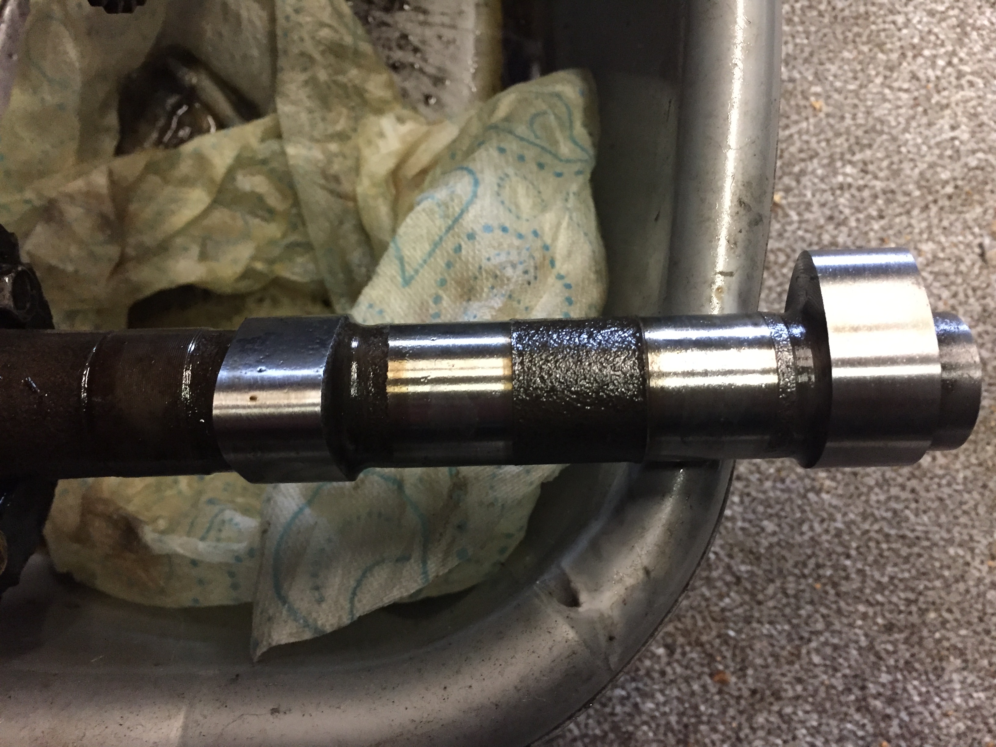

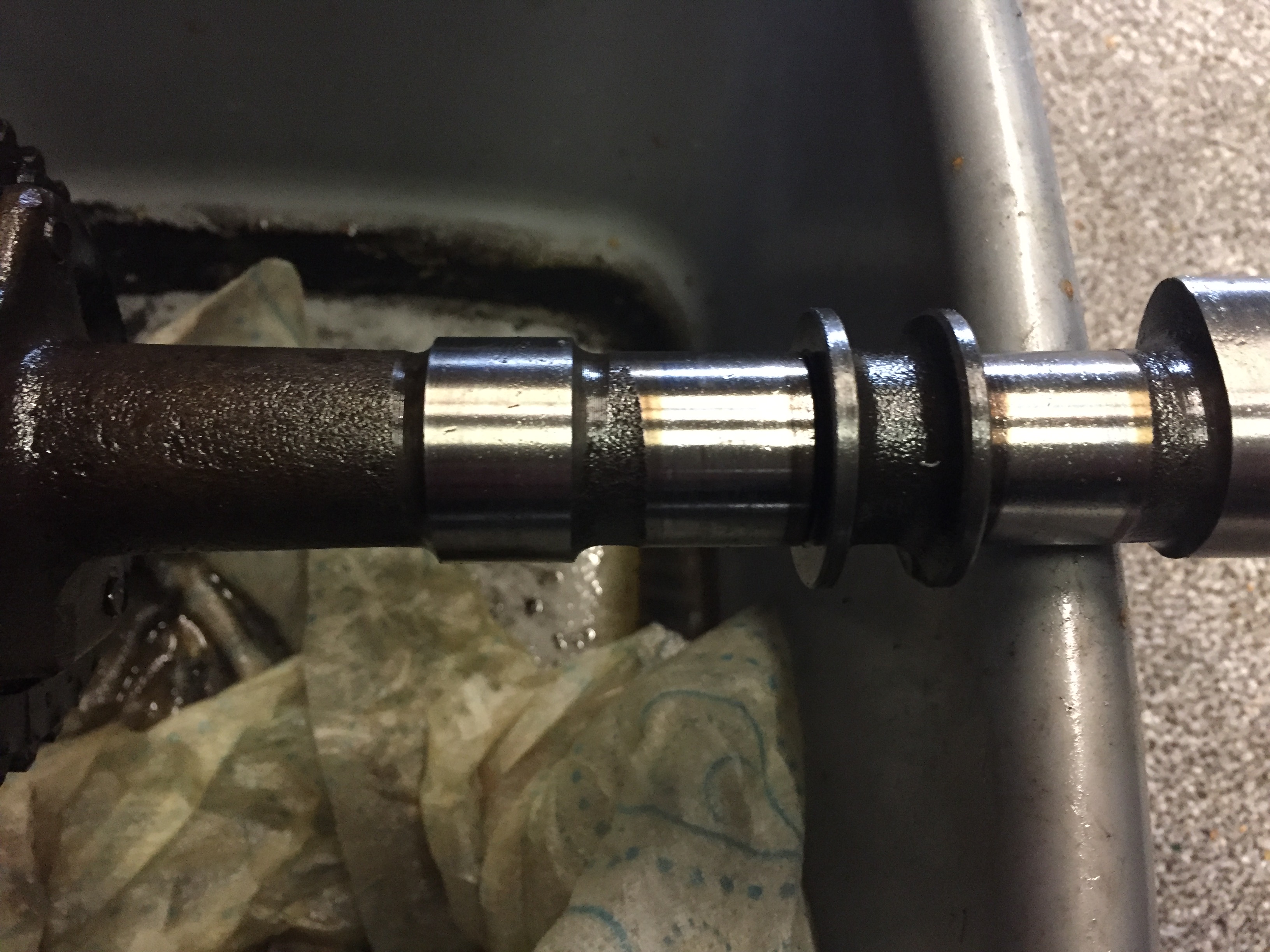

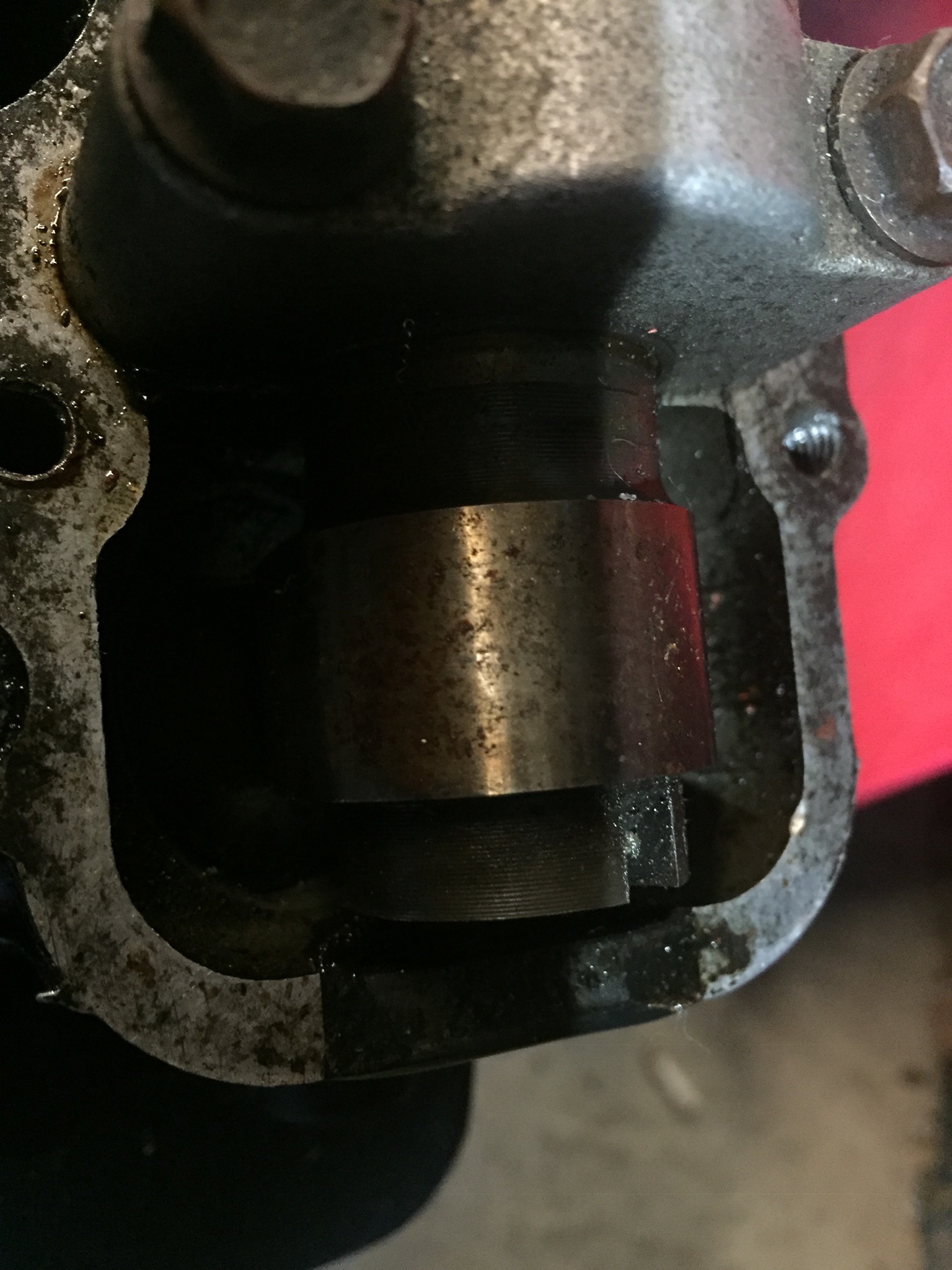

#5 PostAuthor: Gavin » Wed Jan 16, 2019 12:03 am

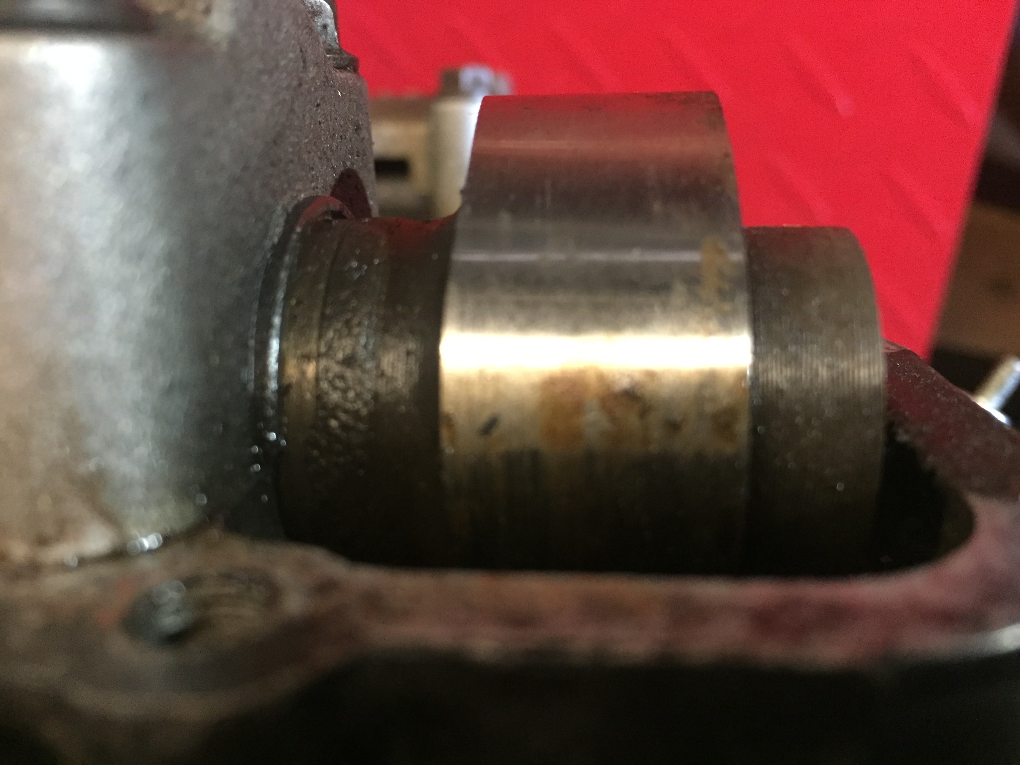

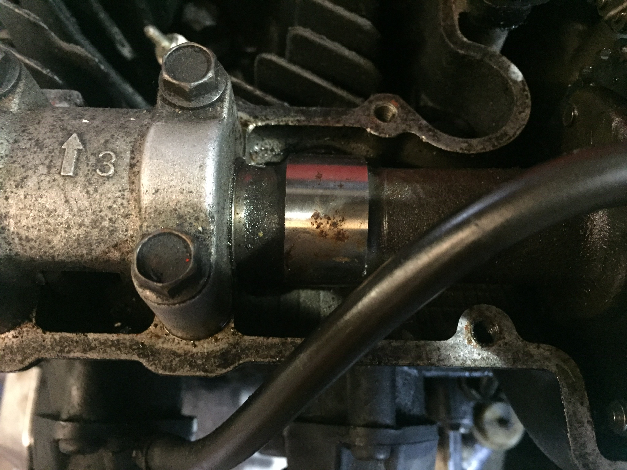

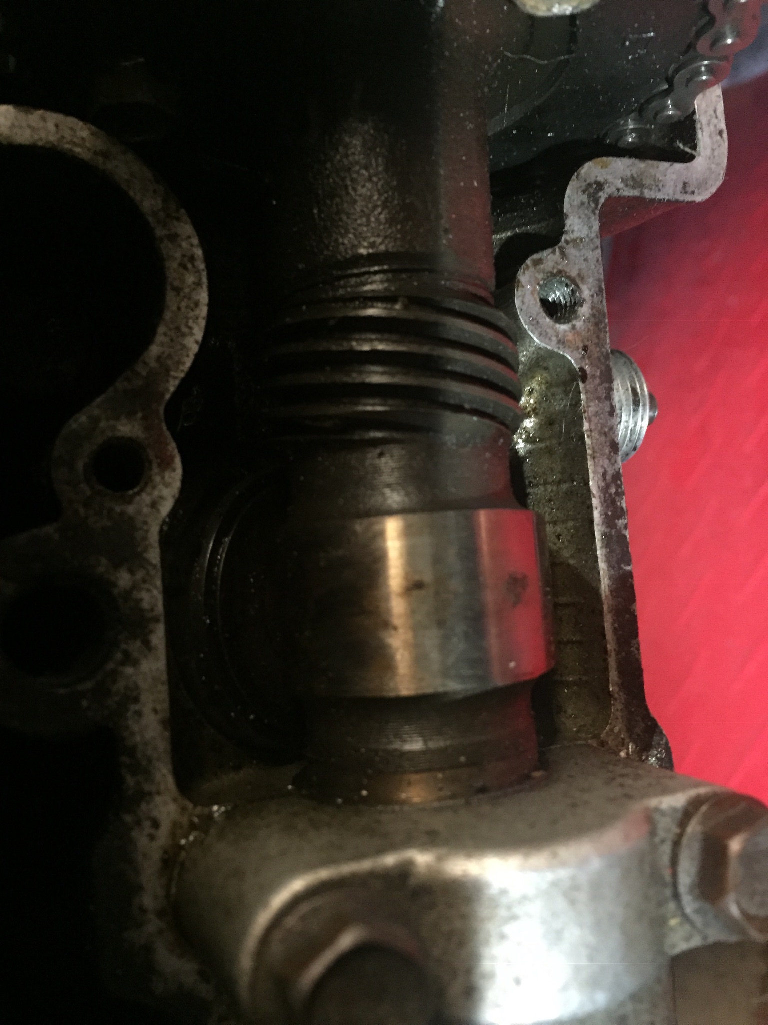

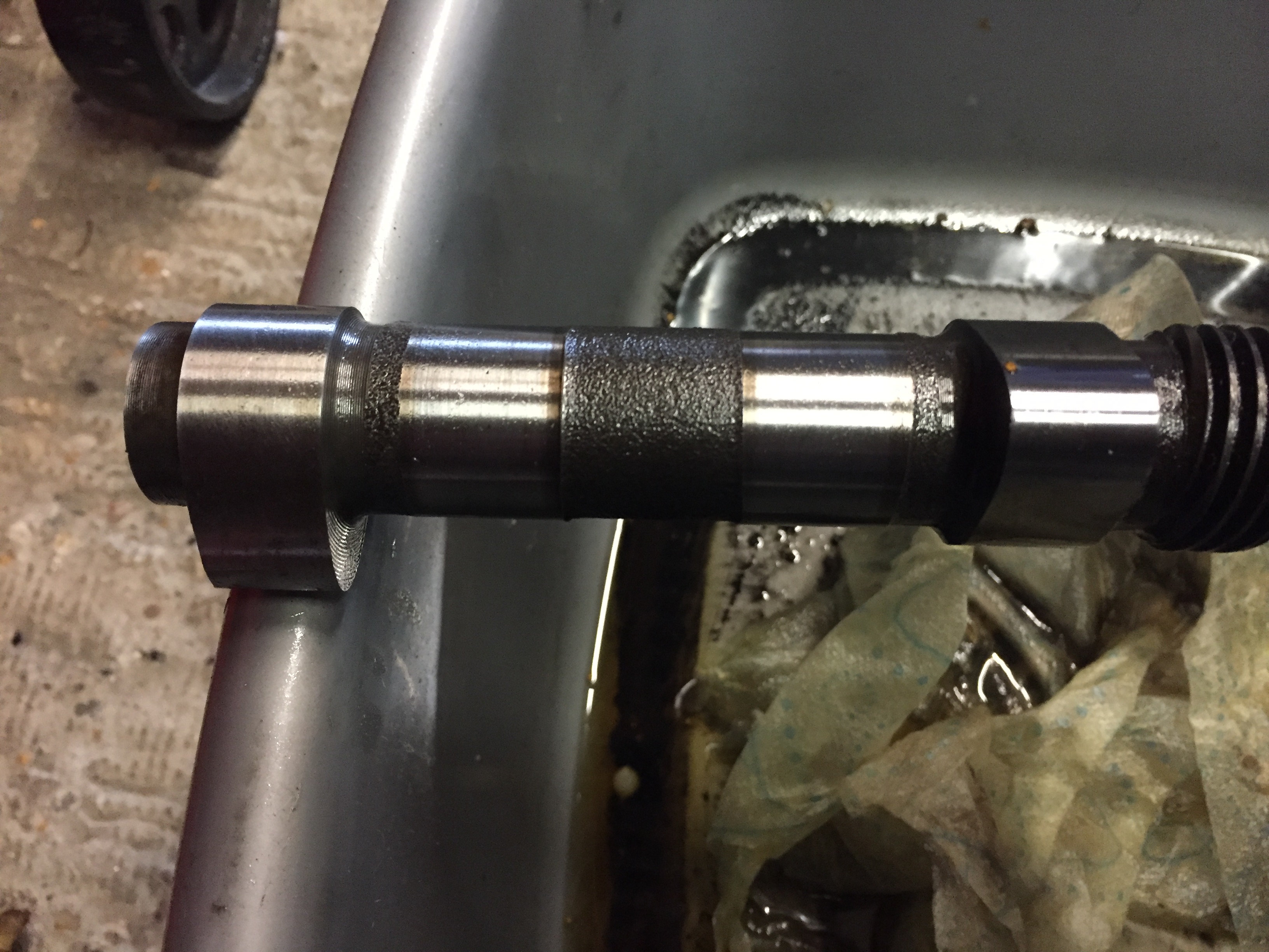

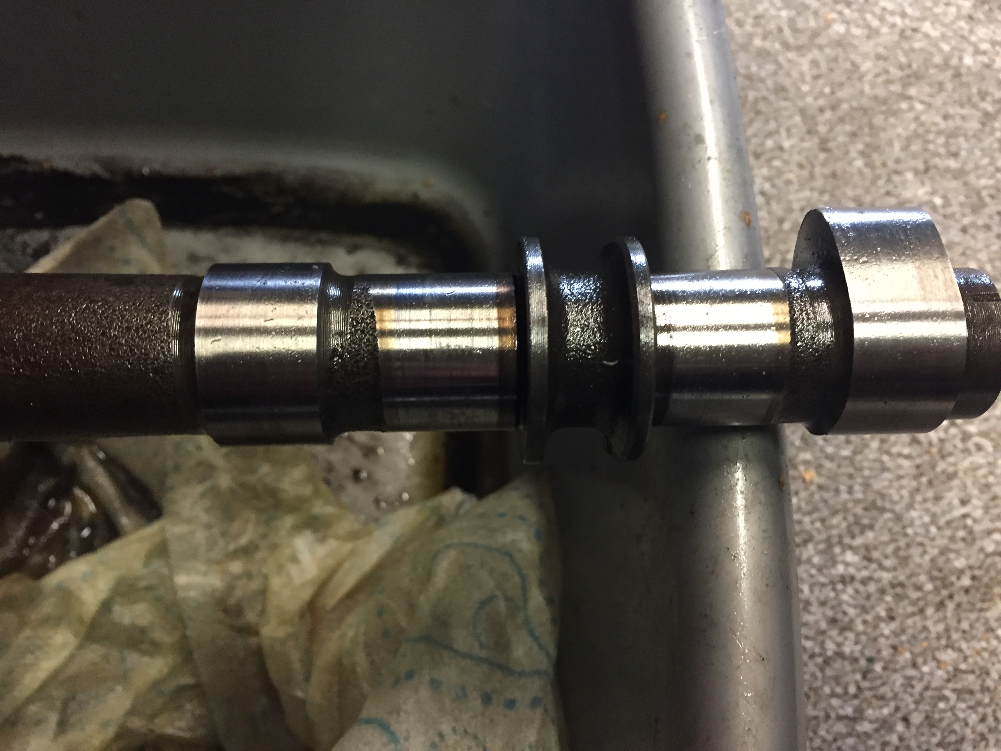

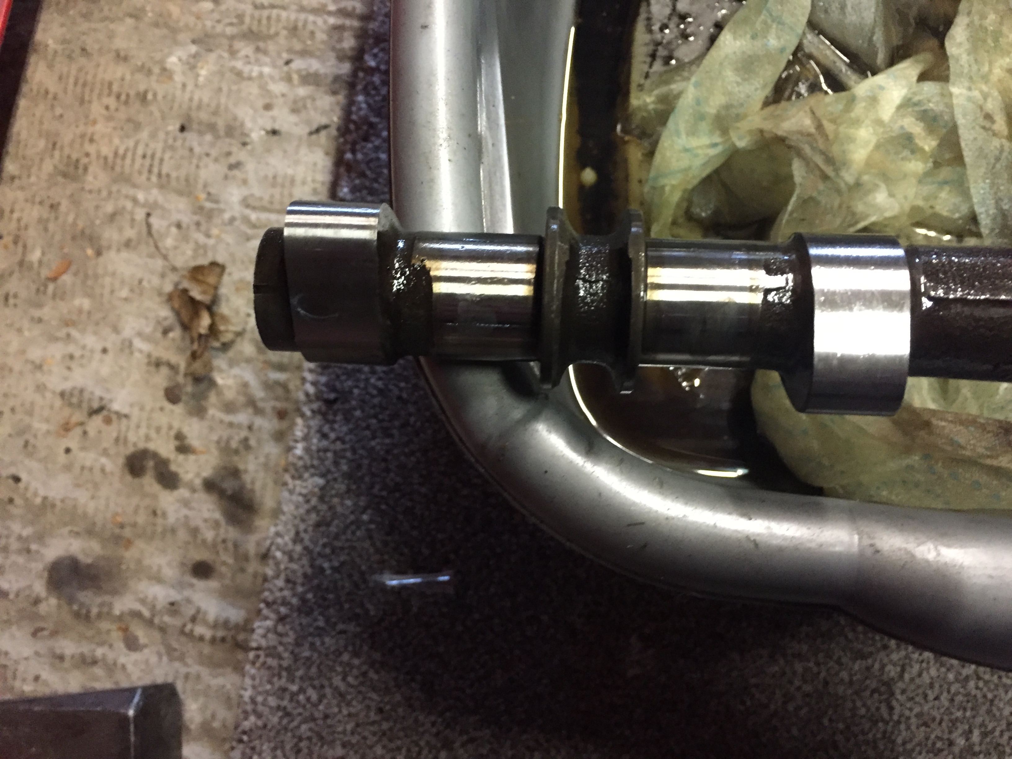

After some advice from Mark regarding the corrosion on the Cams a little oil and a scotch rite pad
Z1000 MK2
Z1300 DFI
8 Valve Mark
Posts: 968
Joined: 3rd Nov 2016
Re: 1979 Mk2 restoration (Operation Boomerang)
#6 PostAuthor: 8 Valve Mark » Wed Jan 16, 2019 12:37 am
they came up well gavin. :lol: lookin forward to the next installments.. m
#11 PostAuthor: rickm » Thu Jan 17, 2019 3:58 pm
Very impressed with how those cams turned out :up
Initially I'd have taken them for scrap !
#12 PostAuthor: Gavin » Fri Jan 18, 2019 7:45 pm
Ricky
Took advice from 8 valve mark
Oil the cams wrap in oiled kitchen roll for a few hours then I used a scotch rite pad to clean them up,
Z1000 MK2

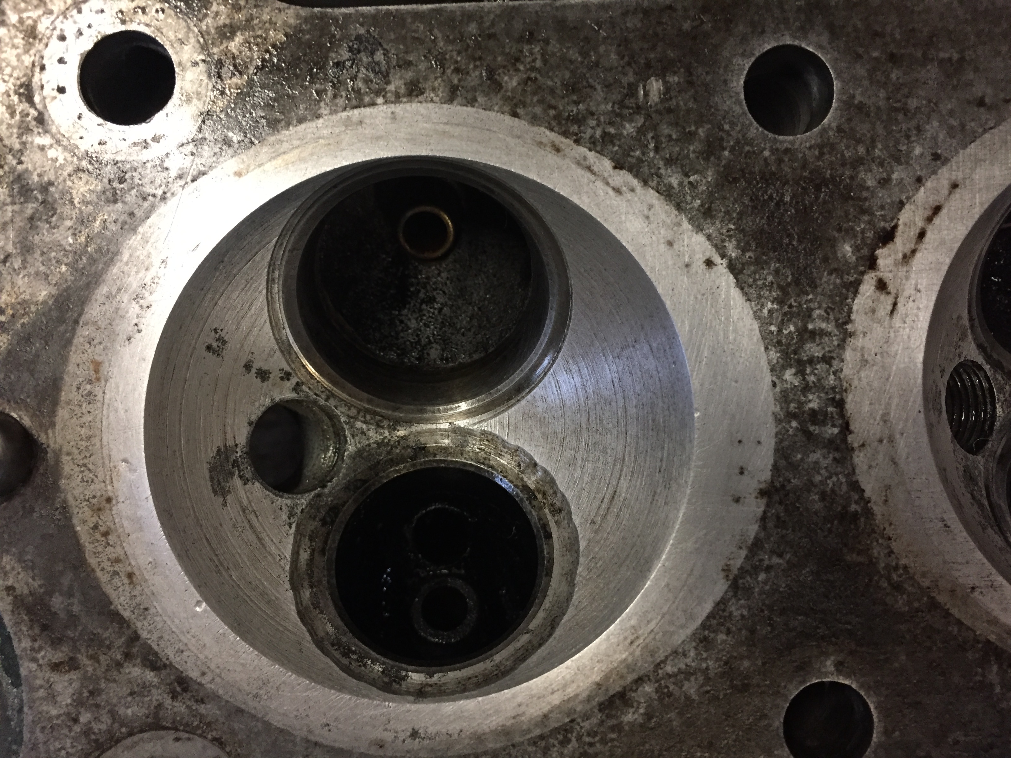

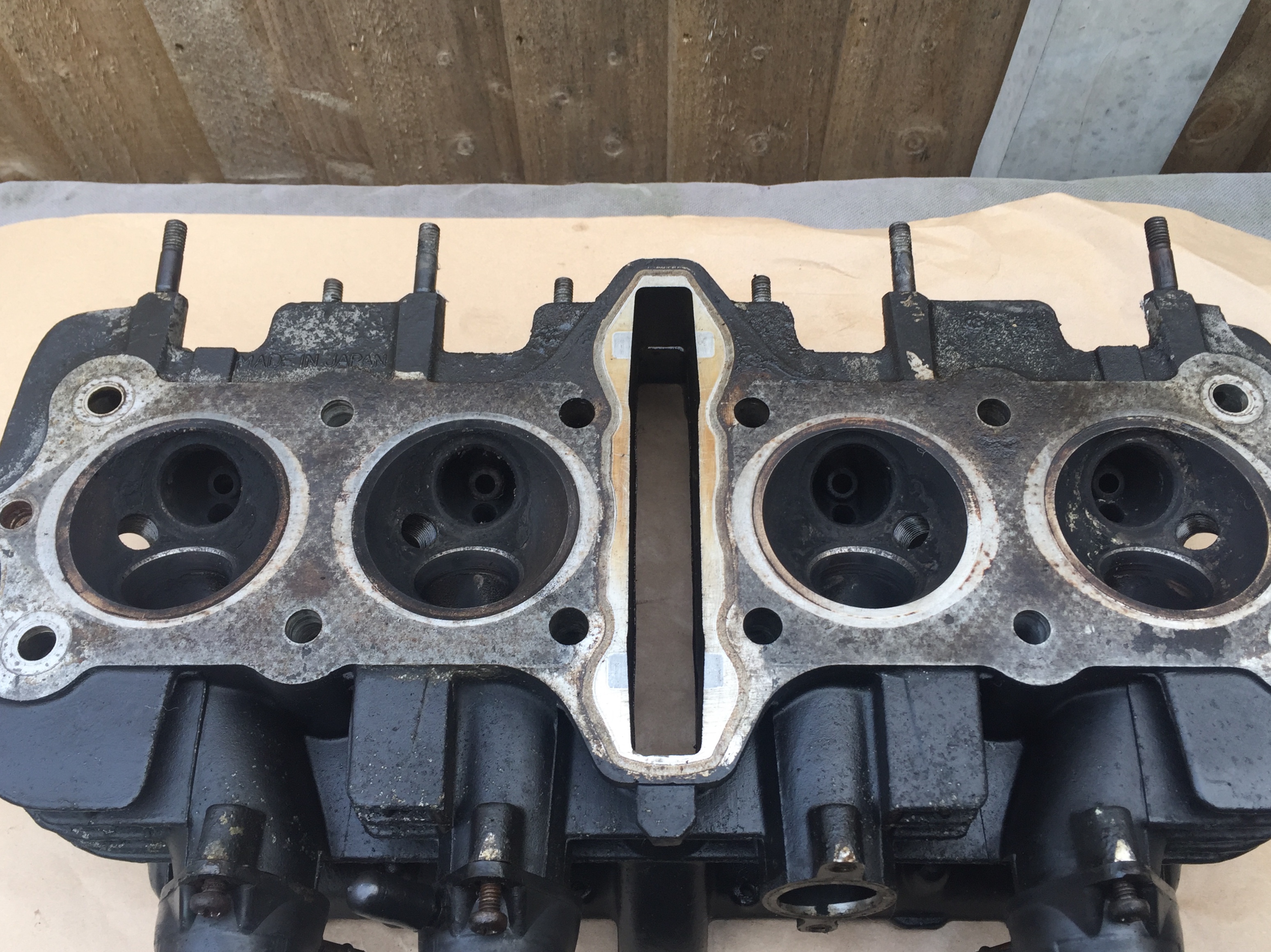

#14 PostAuthor: Gavin » Sat Jan 19, 2019 12:09 pm

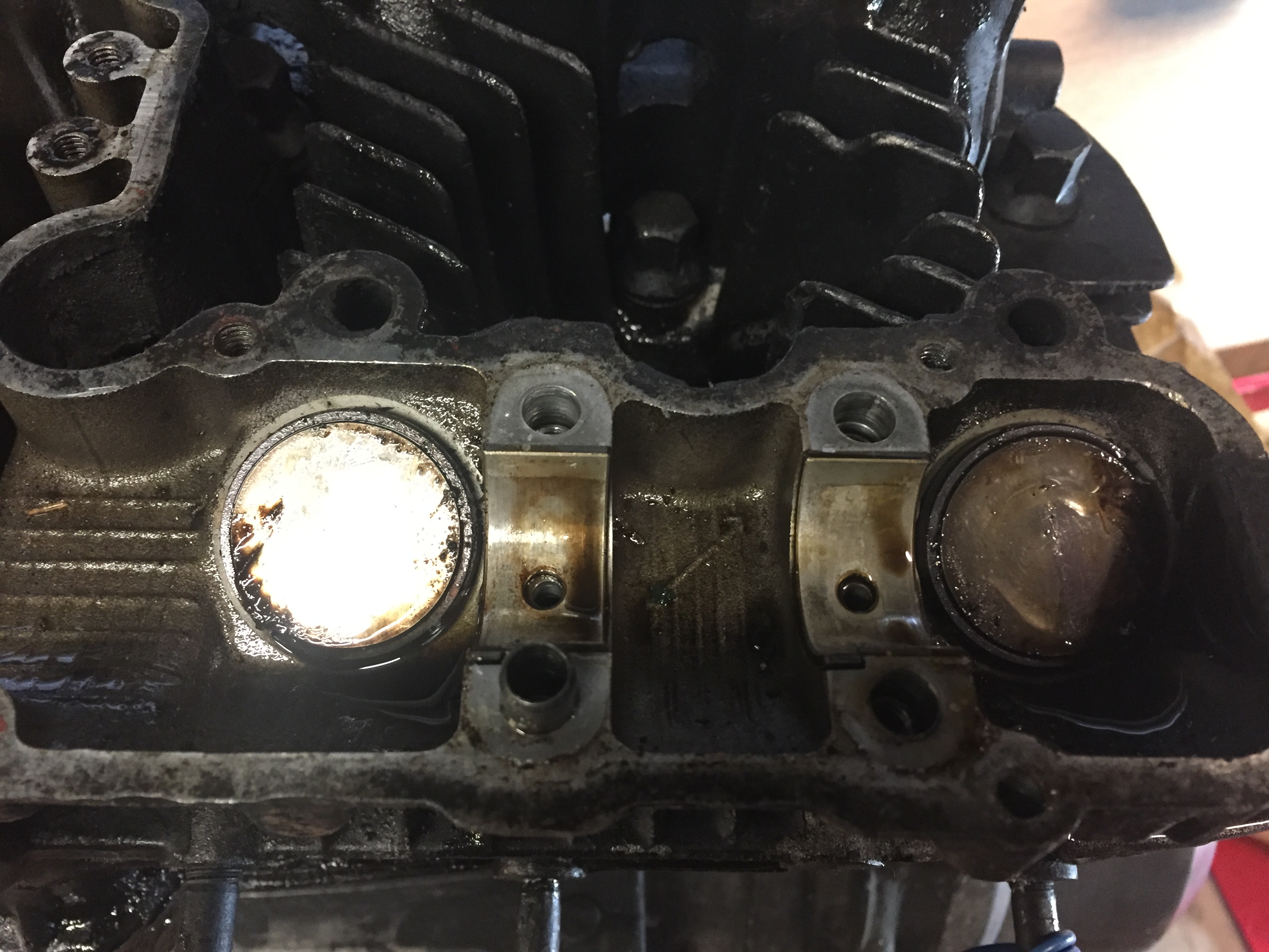

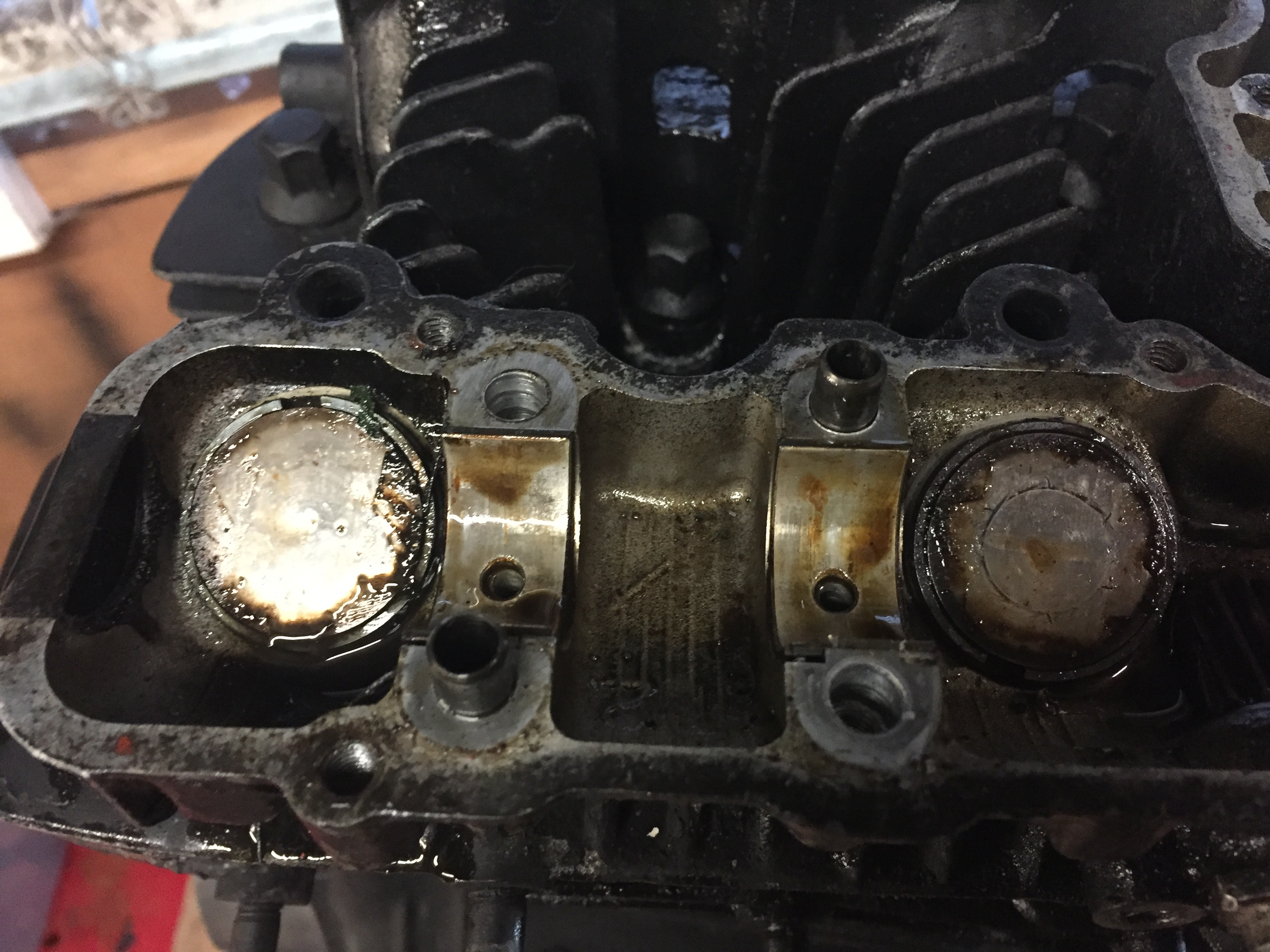

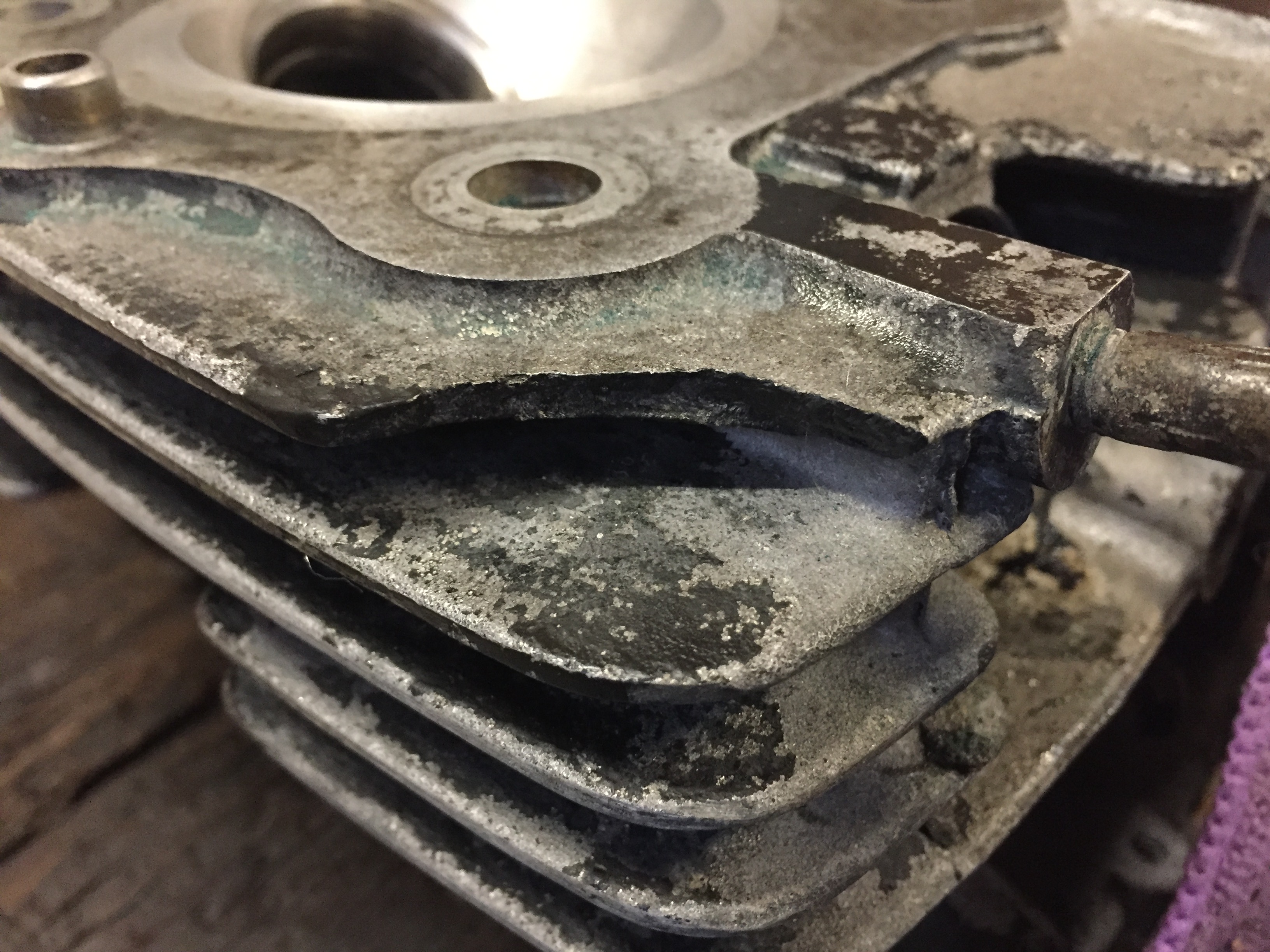

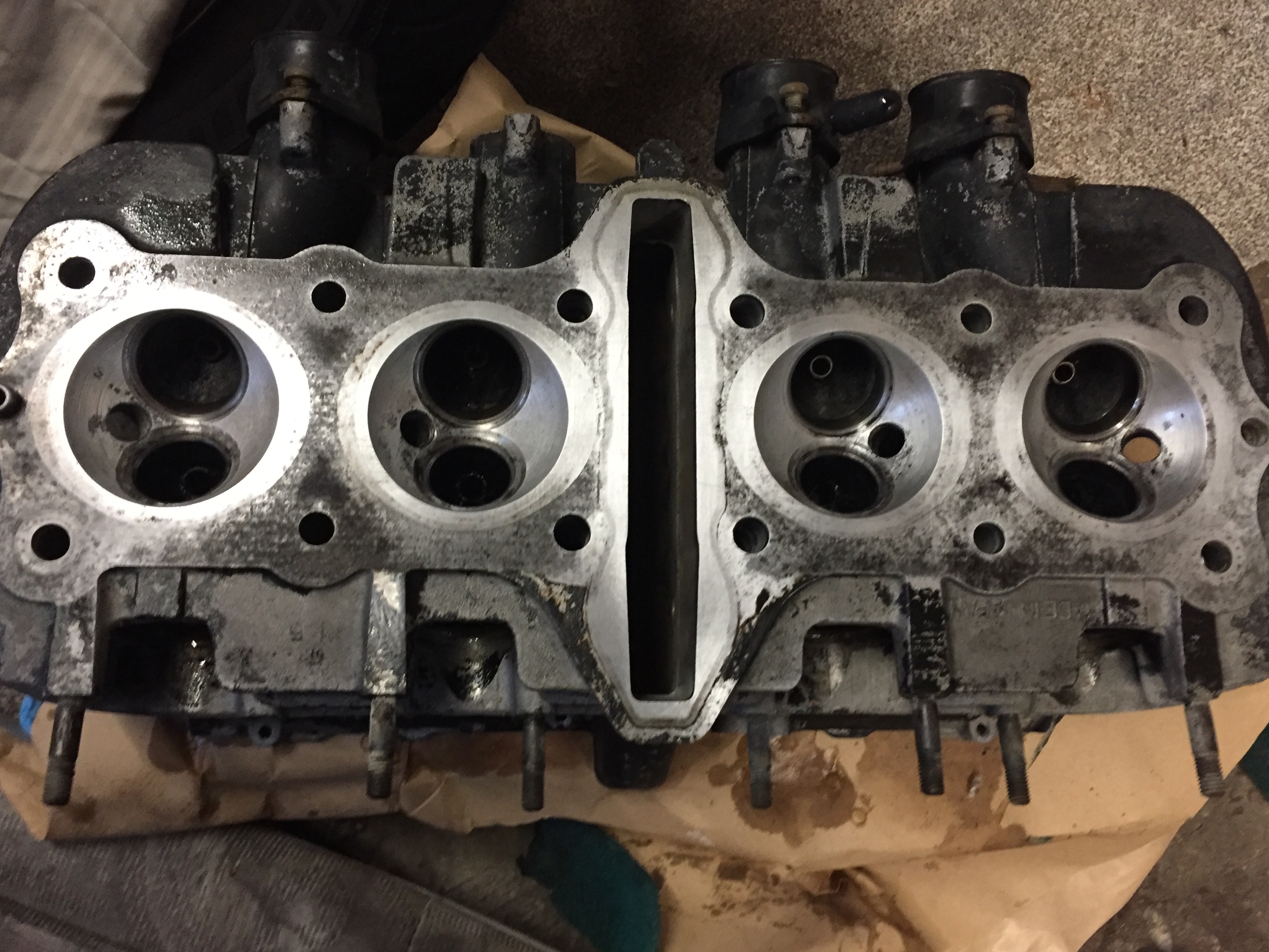

Taken a look at the cylinder head over the last couple of days a good degrease a coat or 2 of a good paint stripper (the original coating is proving to be stubborn)
It appears the exhaust valve clearances where virtually closed because of the carbon build up, I also believe the head has been off at some point due to a broken fin where you would have expected it to happen, definitely not me or the previous owner because neither of us has ever stripped the head off the bike and it looks like old damage
Z1000 MK2
Z1300 DFI
Gavin
Posts: 871
Location: Scunthorpe

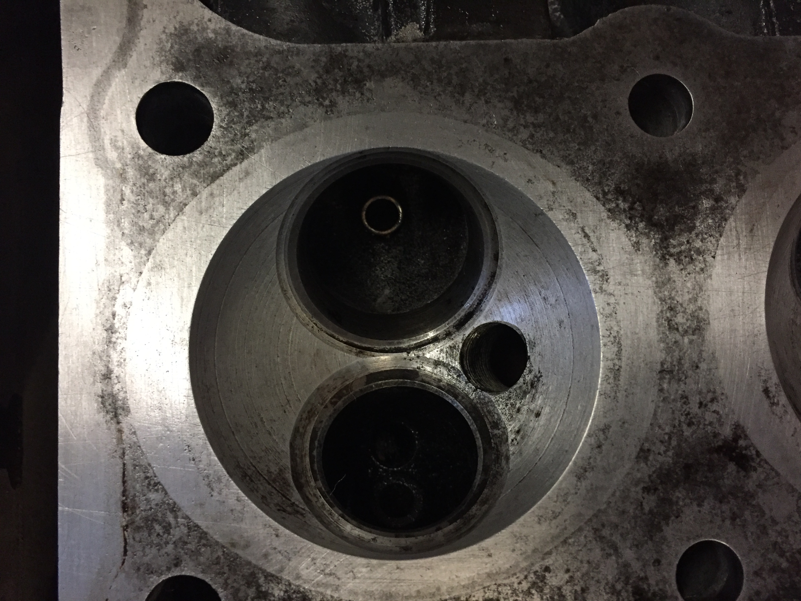

#15 PostAuthor: Gavin » Sat Jan 19, 2019 12:19 pm

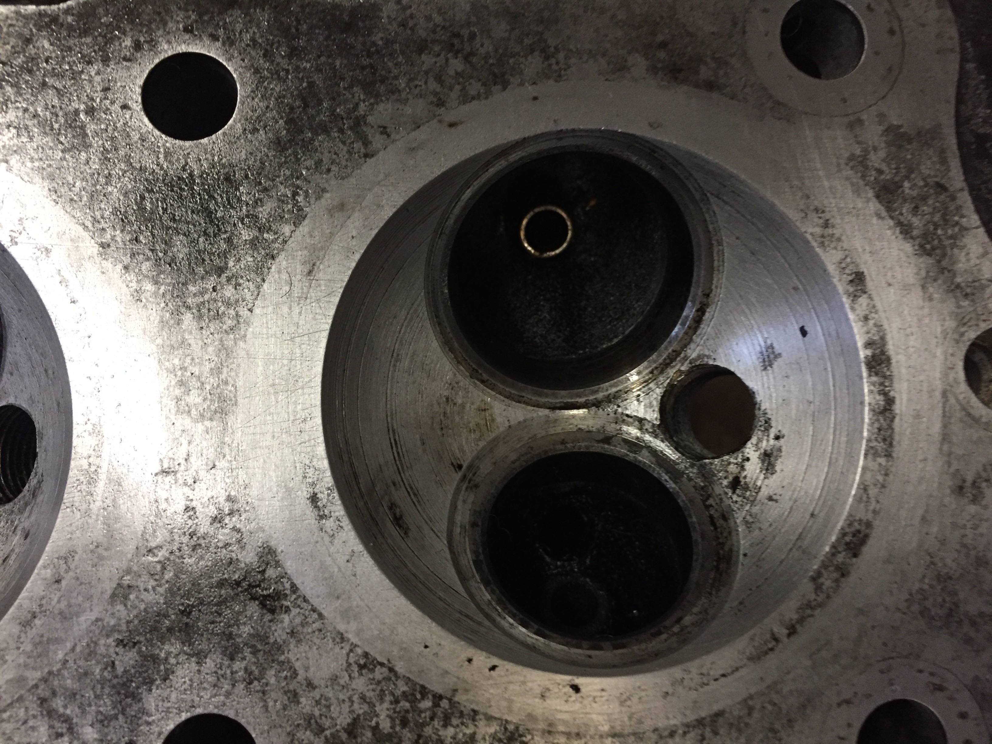

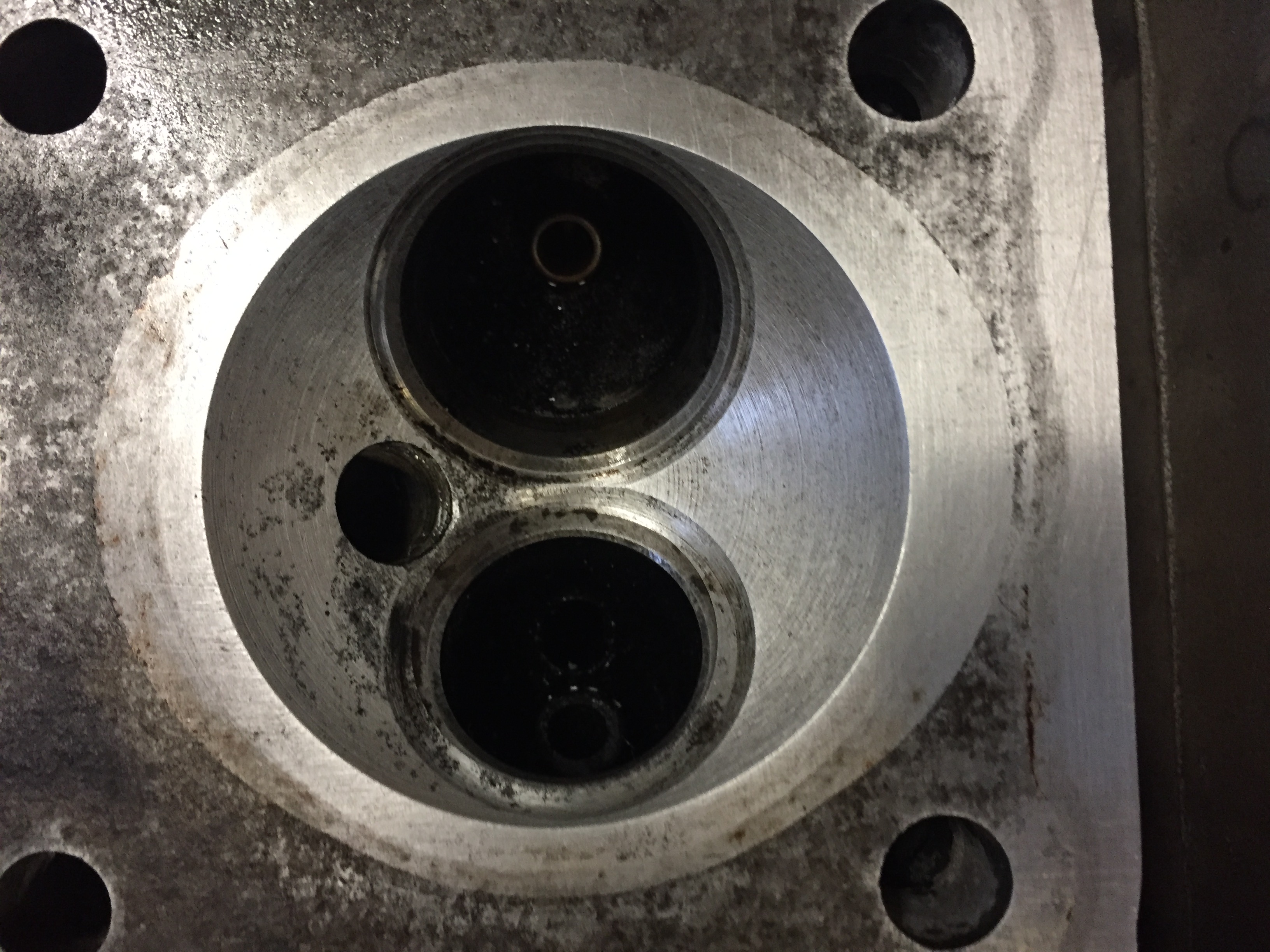

Gave the the carbon build up a clean with a fine scotchbrite pad soaked in oil, needs more work but only spent just over 5 minutes per cylinder to get to this stage, had give up before hypothermia set in, (the trouble with concrete garages this time of year )
Also noticed the valve cut on No1 exhaust looks a little odd and this is the one on the test I did the liquid just drained out in under 30 seconds, which again makes me believe the had has been off before.
Thinking back to when I originally bought the bike around 1995 every gasket was new and there was blue gasket sealer visible.
