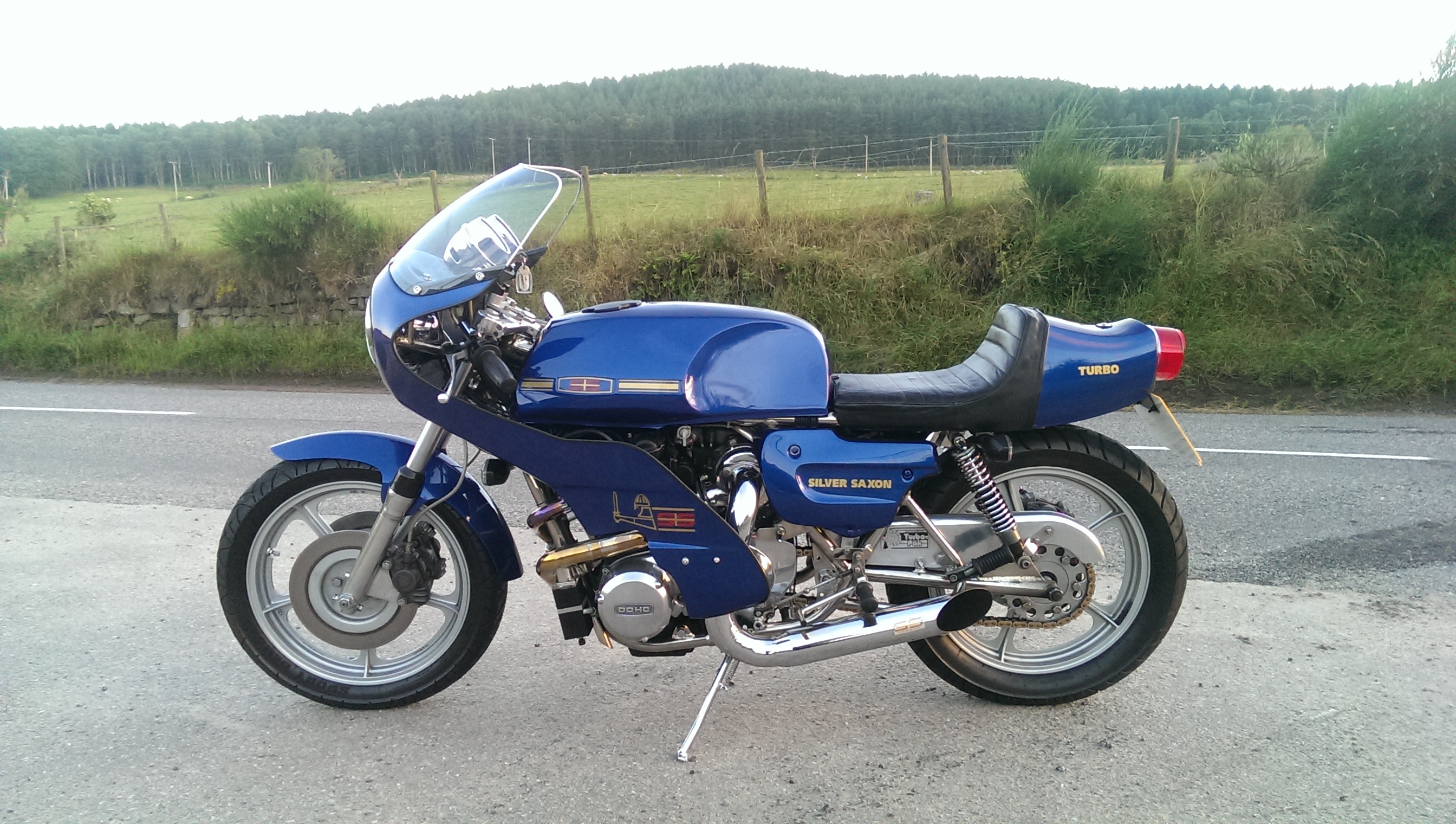

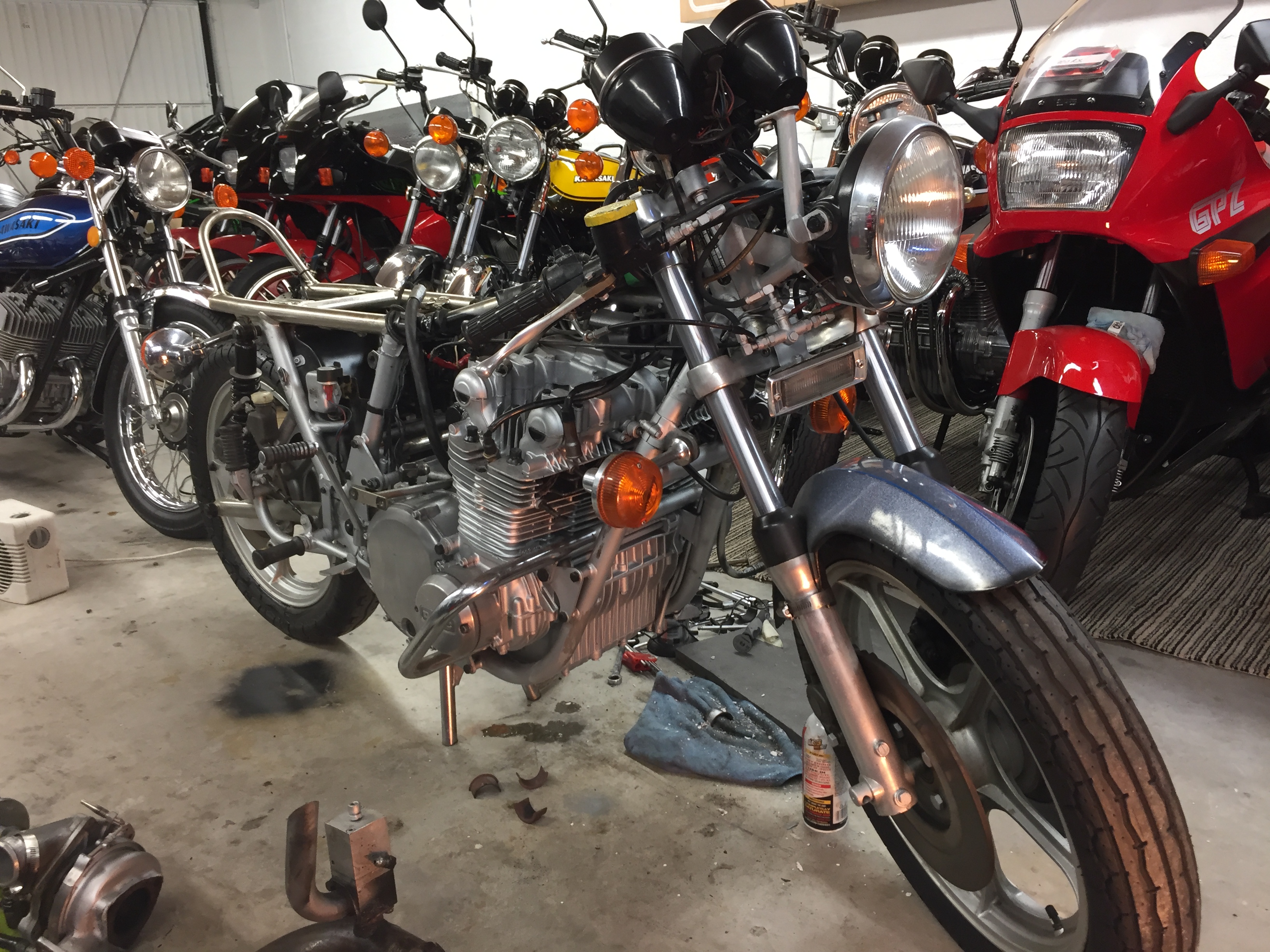

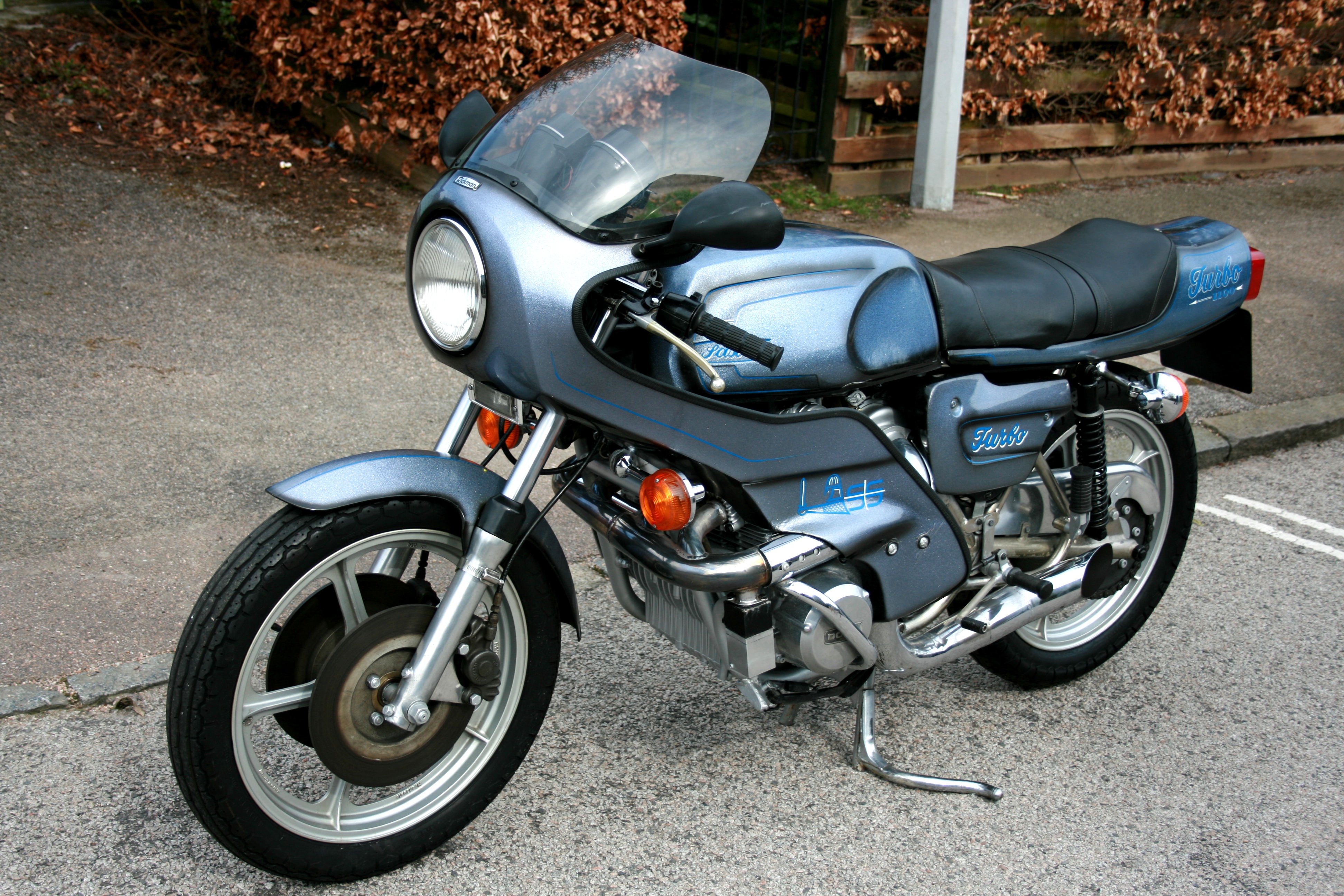

Most of everybody in the bike world will know Wills (Big Fluffs) Blue Saxon featured in many mags, pictured below. I bought the fabulous bike off him a few years ago whilst I had one of the "standard" silver Saxons in the back of the garage for some years. I think the standard one was bike No. 8 of 9 produced +prototype (Wills)
Anyway I have been discussing with Will its resto and he very kindly offered to sort it it out for me , I had done several standard bikes before and wondered if I was just chickening out !, anyway right or wrong I decided to clean the bike up myself, its turning into a Saga for sure - Will feel free to jump in anytime very much appreciated
History of No8 - for sale about 8 years ago in Panorama Motors , South Coast , was up at 12k or so but when I called priced had dropped to 7k which seemed sort of reasonable for such a rare bike, at this point Will had already visited the garage and verified its authenticity on this forumm, it had 2 previous owners and a letter from the last long term owner (30yrs plus)

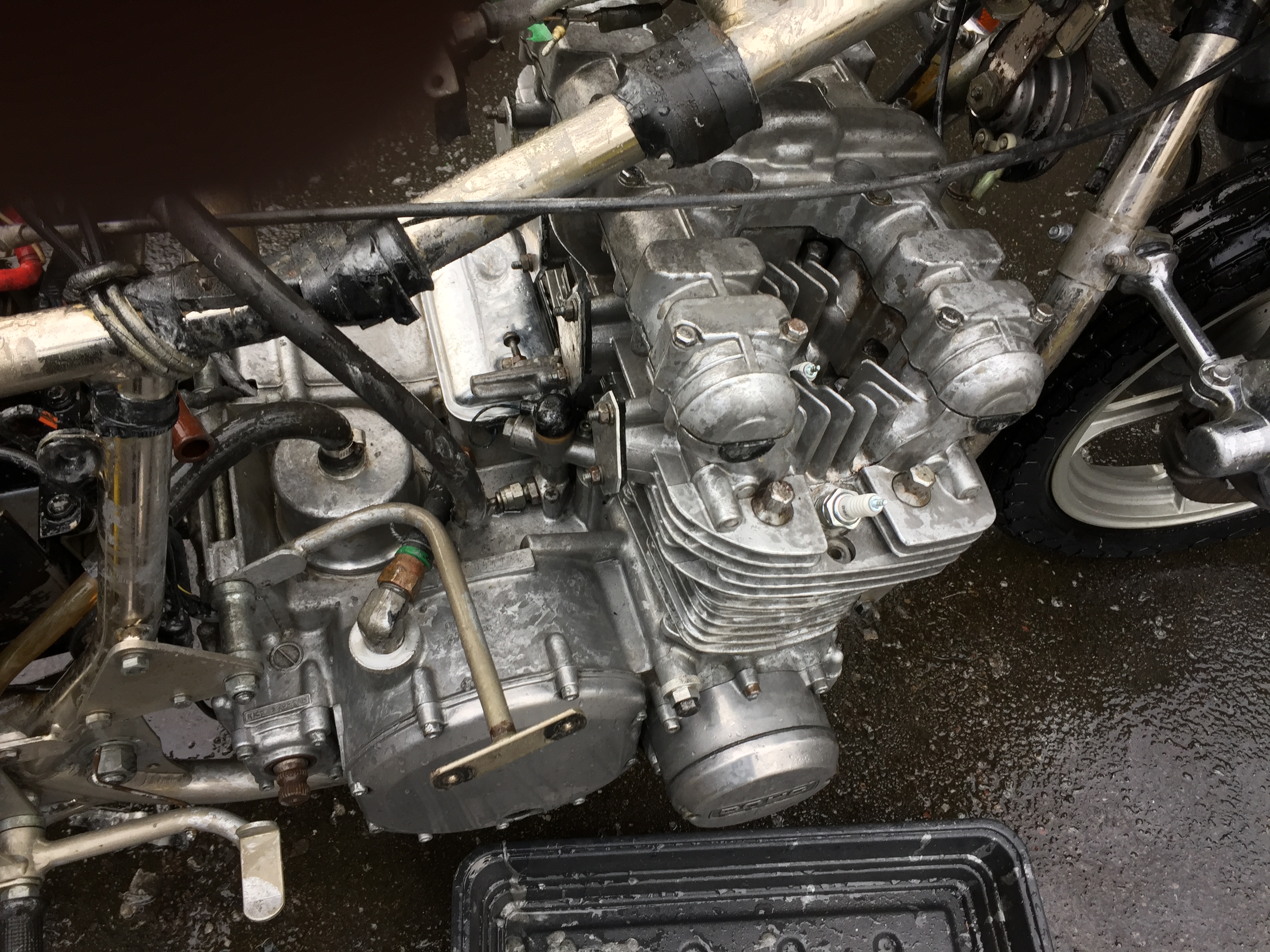

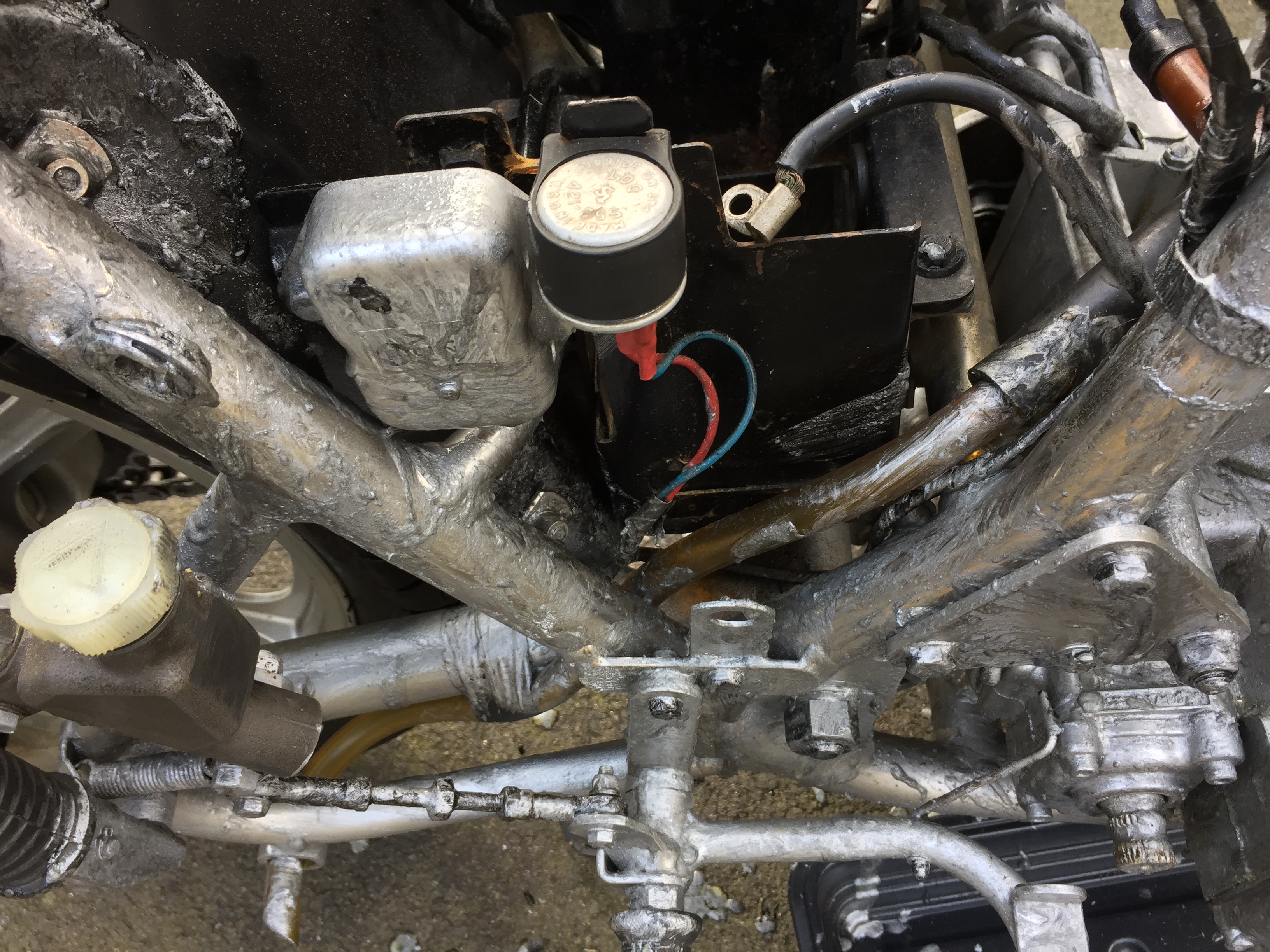

The bike was actually quite shockingly painted all over with aluminium paint - all the frame /engine / nuts and bolts , it ran well, a very quiet engine mechanically.

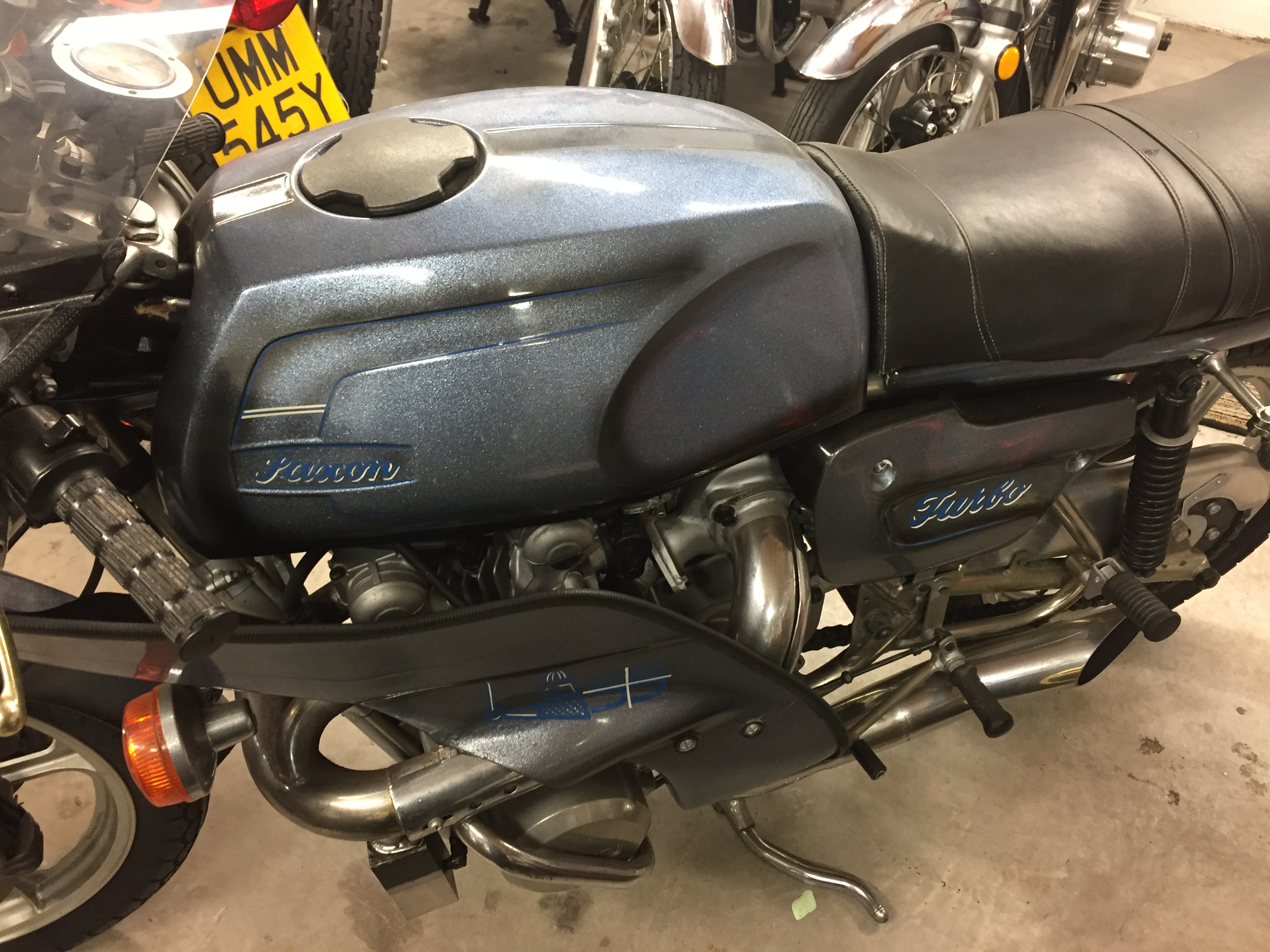

The origianl glitterflake paint from 76 will stay, it probably the only original one left with original paintwork - I have grown to like it - it is the bike , mind you it took a few years

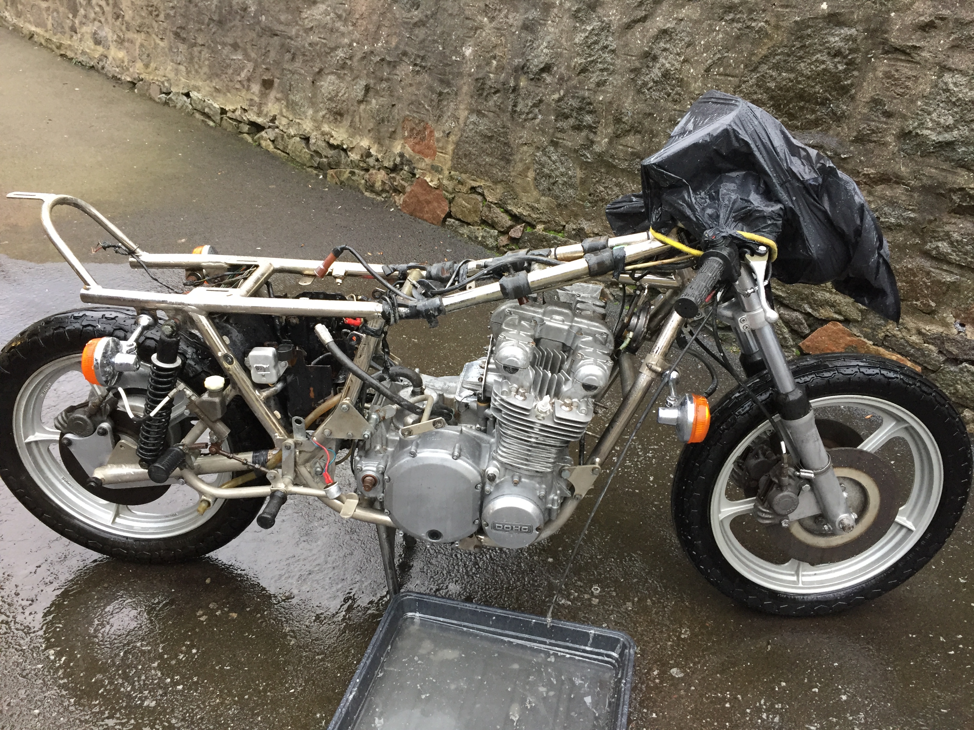

check the silver paint, frame, whole engine, turbo, nuts & bolts

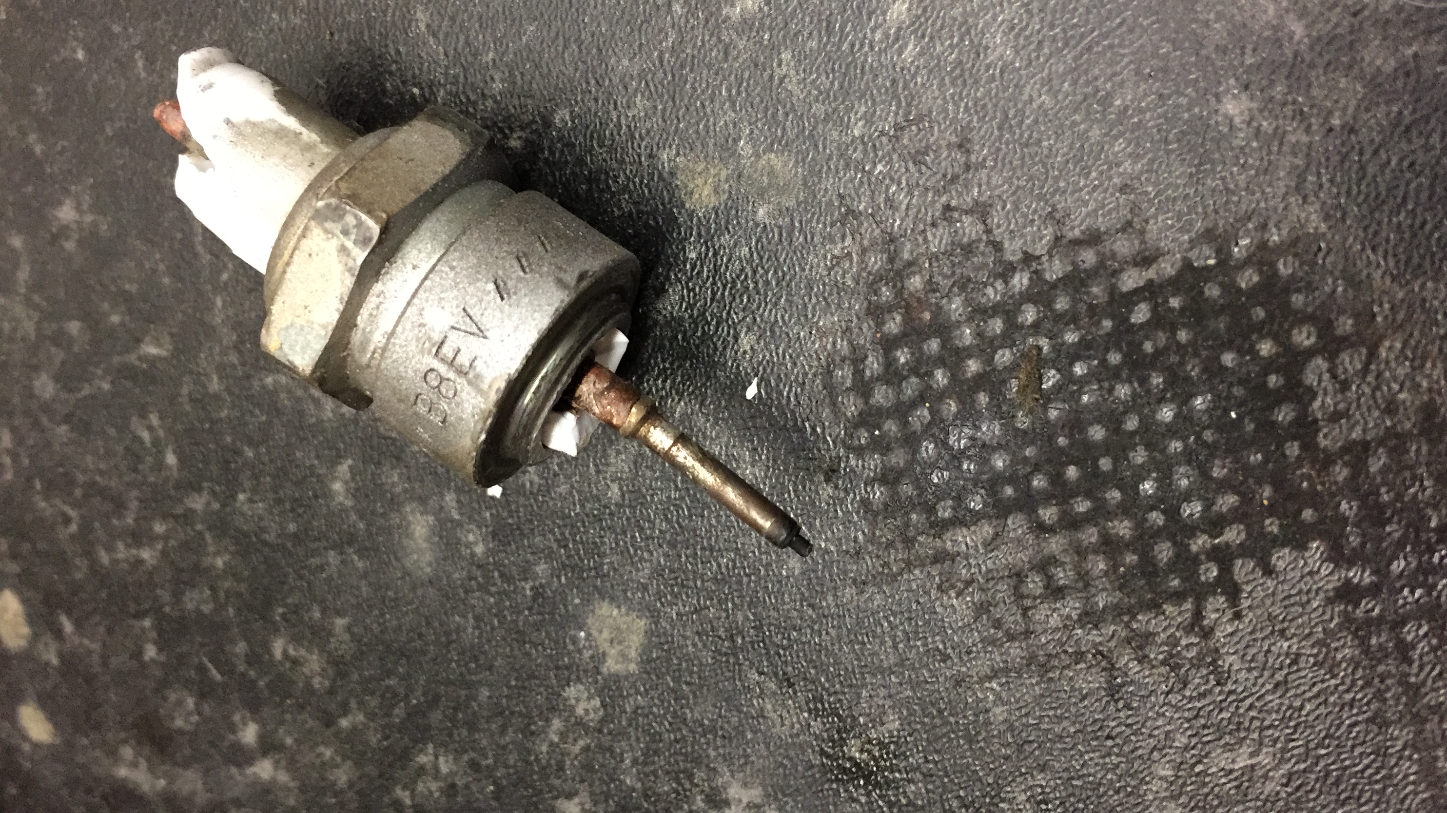

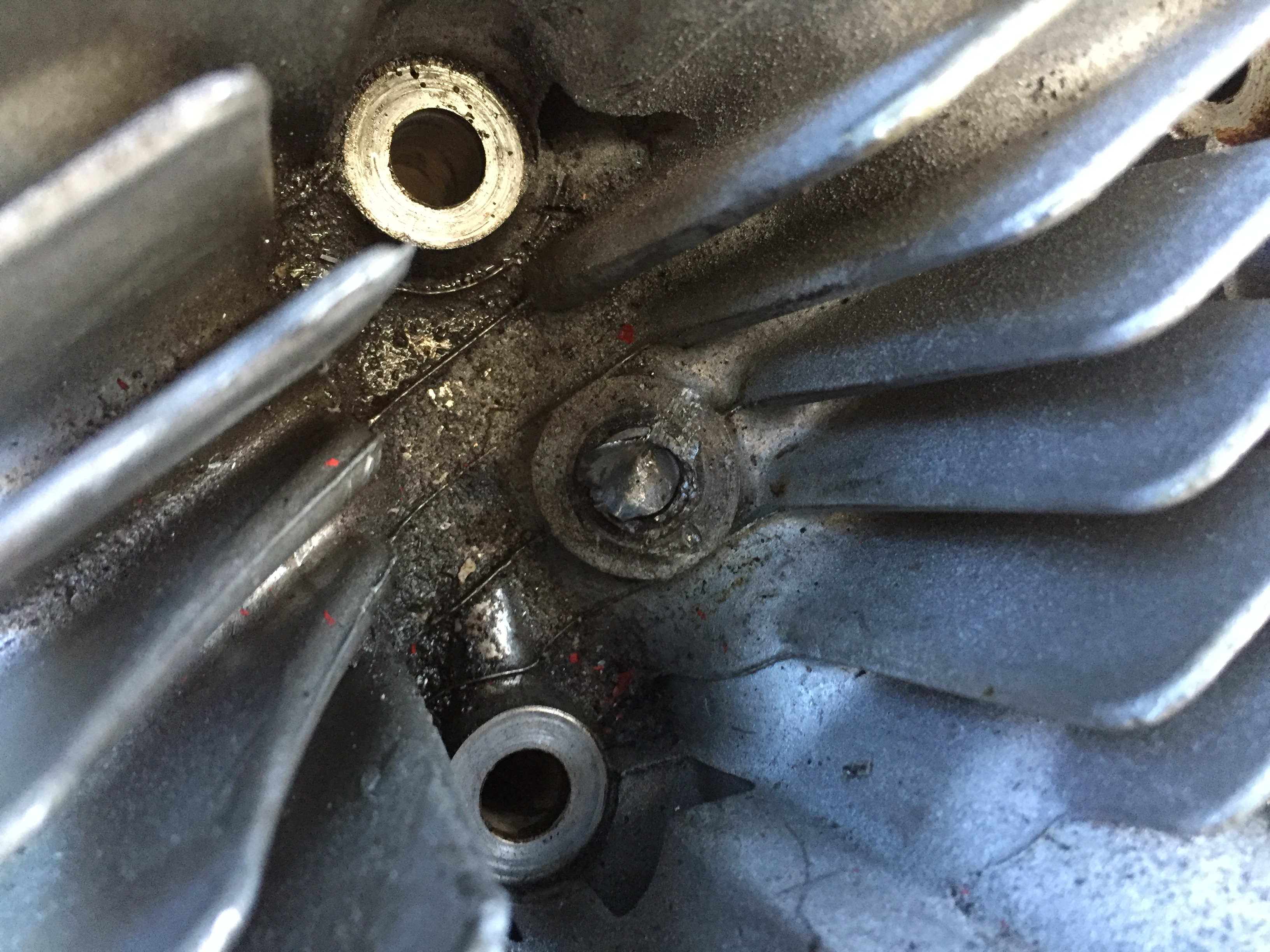

and the snapped plug, the bottom half is lodged in No3 head, been torqued down on wrong thread I suspect other 3 were easy - it gets worse

How often do you wash your bike with paint stripper ?

by the style of them turbo headers id hav thought that was a early bike like the way the fairing wraps round the side pipe,,to get that frame renickled wont be cheep ,once had a Rickman turbo probably 30yrs bac ,neva eva heard of a silver saxon bac then ,

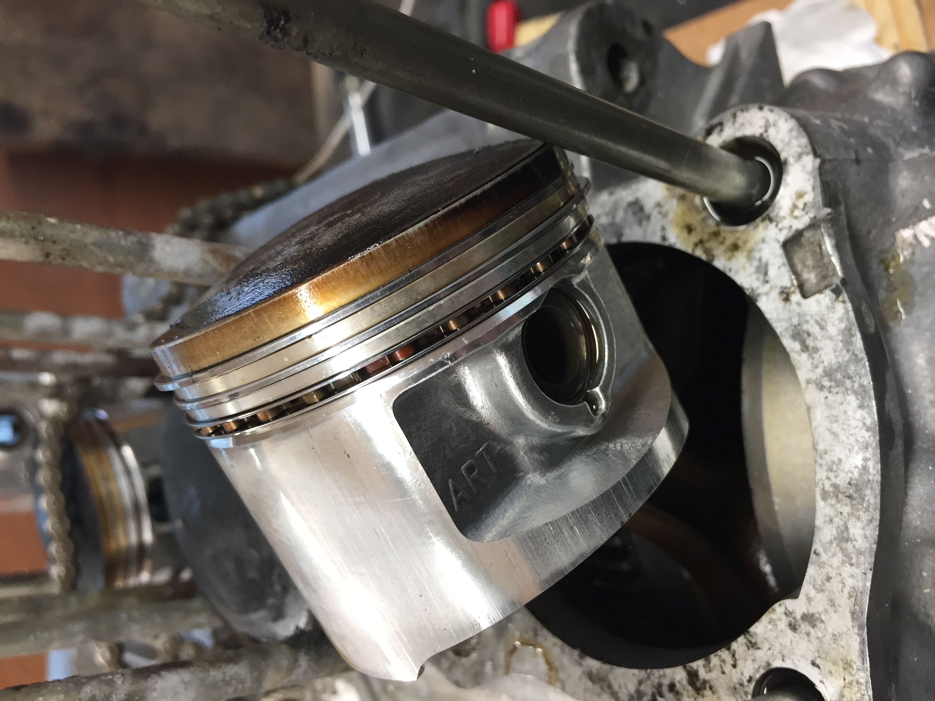

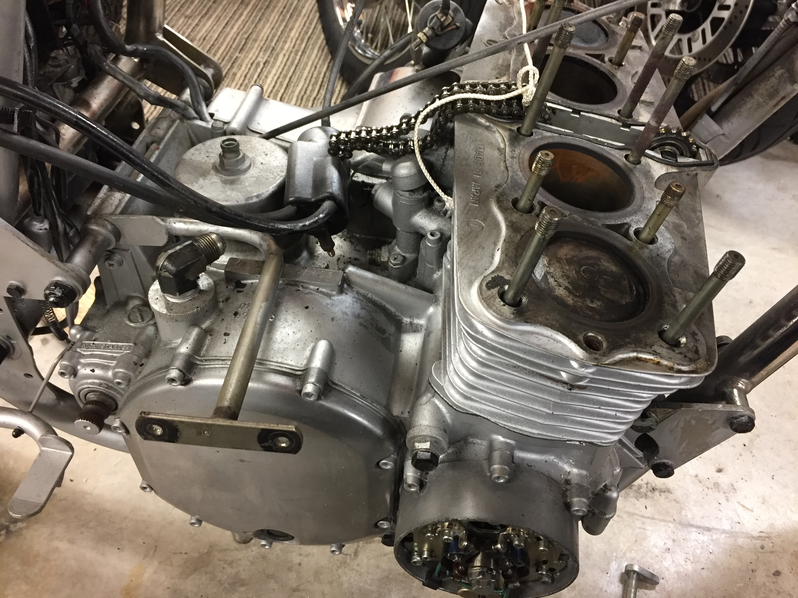

I thought they lightly worked the engines for the turbo but they look like STD pistons??

garyd wrote:I thought they lightly worked the engines for the turbo but they look like STD pistons??

Flat tops to lower compression. Will can advise... He has changed a few
Re: S&S Silver Saxon #8
Yes the top end of the Engine is standard pistons , all the standard versions used them , bored to 1000cc, set to 5psi or so to give a claimed 160hp. I suppose S&S destructed the prototype as much to understand what it would take as they were to continue building these as production bikes ? Z1r turbo was the same . Problems arise when the easte gate was screwed shut, anyway took barells off and no blow back on pistons at all , in 40 years , mind you only 8000 miles

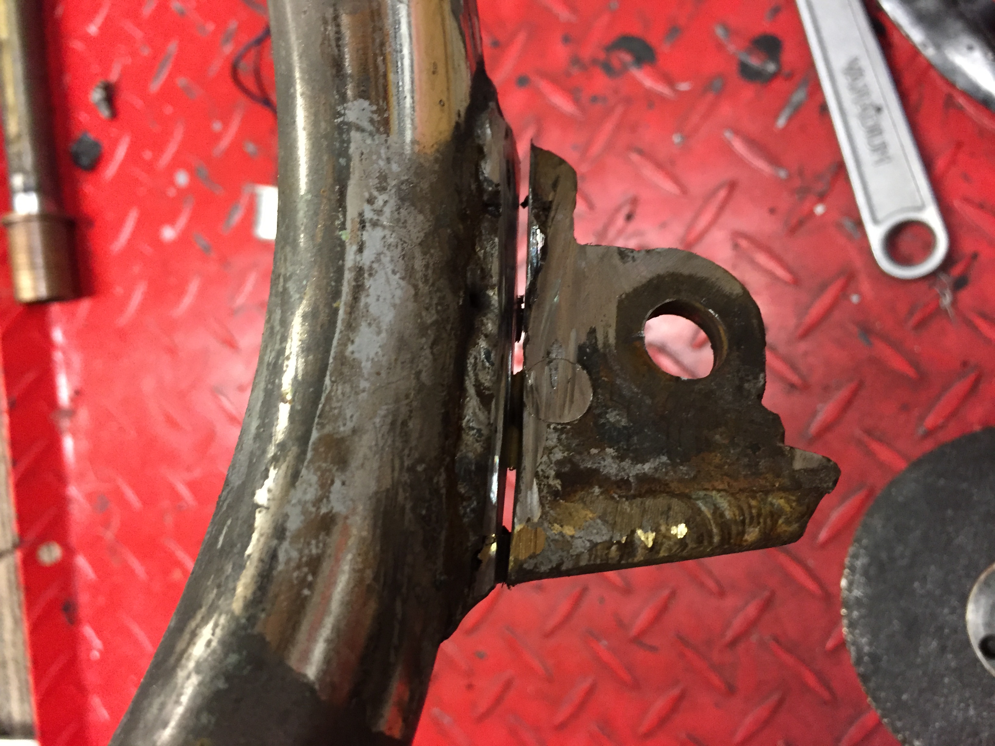

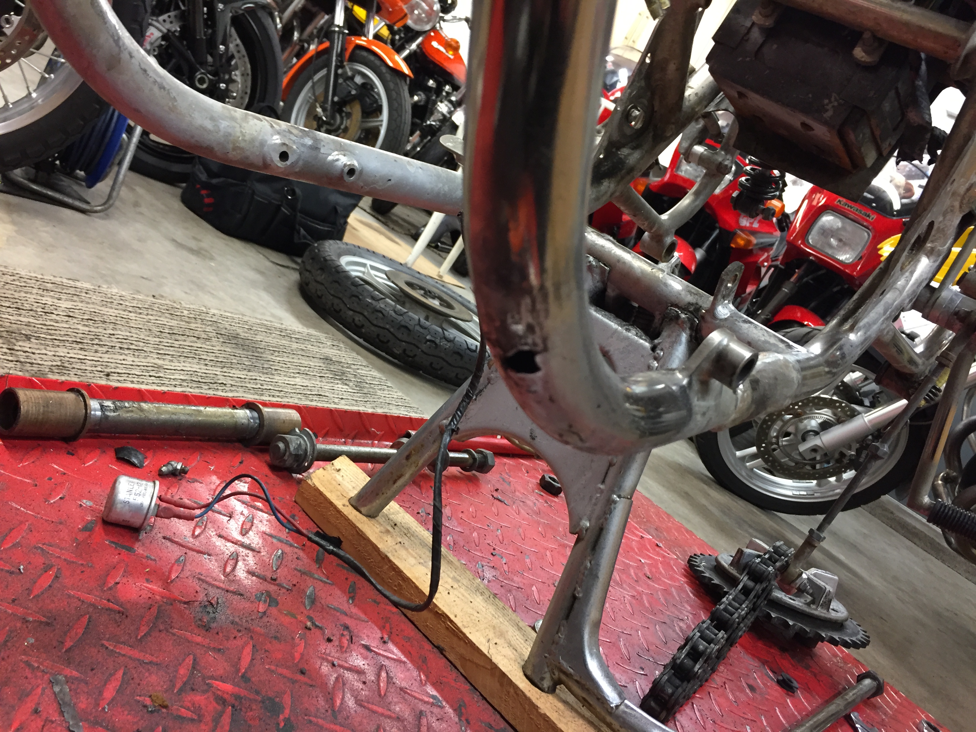

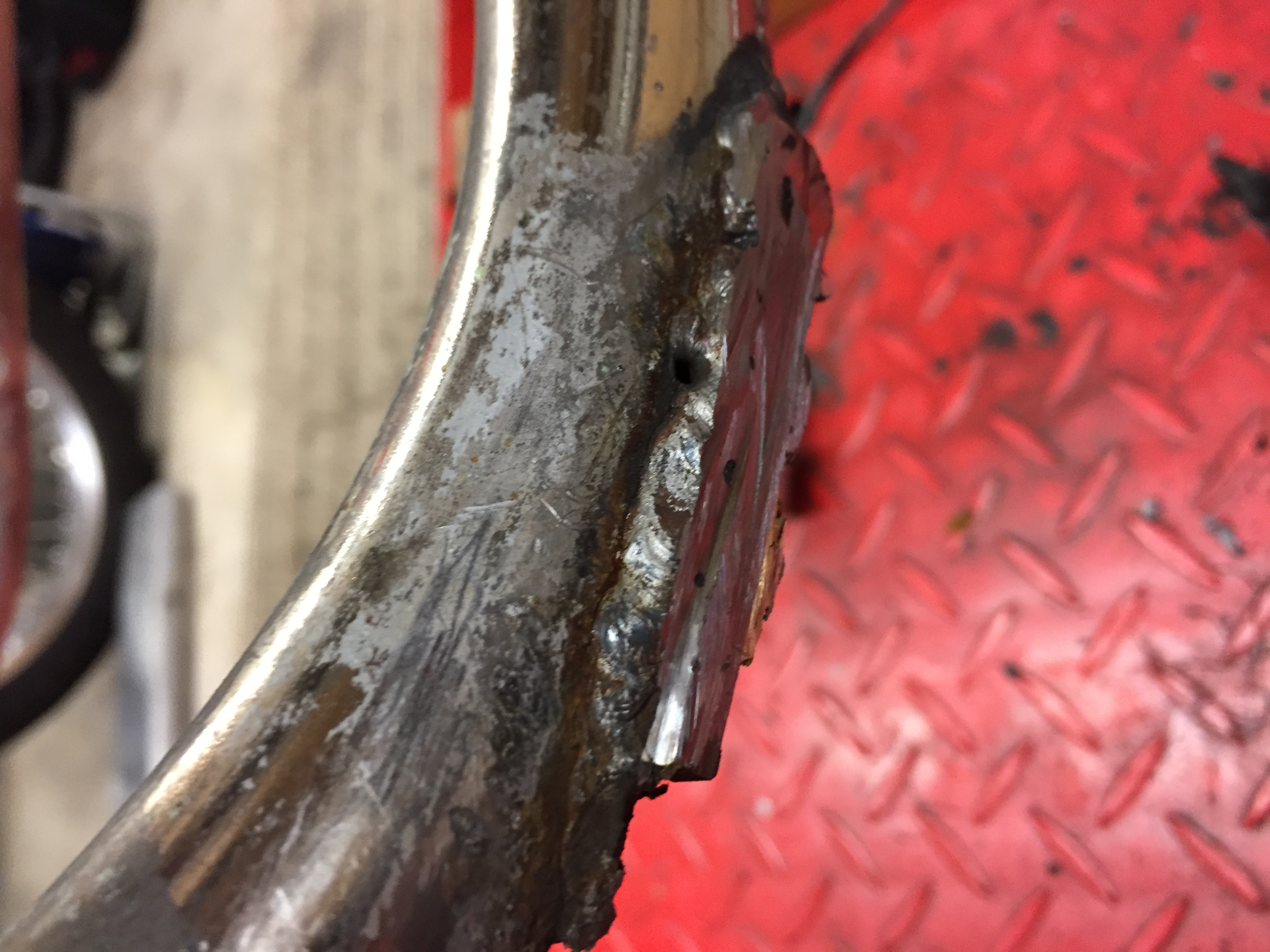

More issues , previous butcher had pig welded a kawa side stand to the Renyolds 531 tube at the corner of the cradle, apart from extreme ugliness, it brittled the tube and the stress pulled a hole in the frame. The bit where the weld is being cut was ok after it was ground and filed off , the frame has been NDT dye tested , and have fitted a strengthening elbow with tube from Renyolds, who advised to TIG weld with pure argon , which is how they do it nowadays.

Personally, after seeing the mess of the last two TC engines I’ve had to rebuild, I certainly wouldn’t stick with cast pistons. For trouble-free enjoyment I would highly recommend the following: APE cylinder studs & nuts, 75mm MTC forged piston kit (7.8:1 CR), MLS head gasket, APE valve springs, one of my wastegate modification kits, Dyna 2000 ignition, one of my boost retard kits, Dyna coils, oil sump anti-surge modification, top oil feed to turbo. Other extremely worthwhile mods are welded crank (if going over 10 psi), Mikuni HSR carb plus one of my HSR deep air filters, and a decent crankcase breather flame trap.

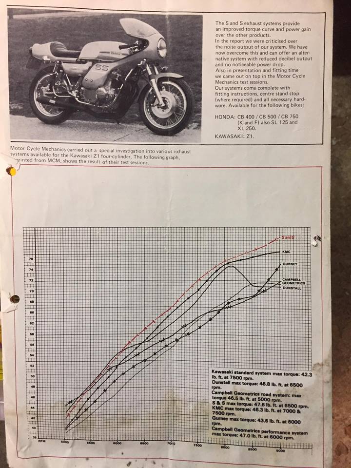

Here's a bit more about S+S in their non-turbo days too, in particular order
- Attachments
- SS4.jpg (141.12 KiB) Viewed 17707 times
- SS3.jpg (123.65 KiB) Viewed 17707 times
- SS2.jpg (148.94 KiB) Viewed 17707 times
- SS1.jpg (108.89 KiB) Viewed 17707 times

some issues to date...
I used an easy out to try and remove the plug...wrong it snapped, so made it worse. I have now thrown out all my easy outs - my fault I googled a soloution .... Went to a local engine shop (60 miles away) - spark erroded it out and did a quality insert

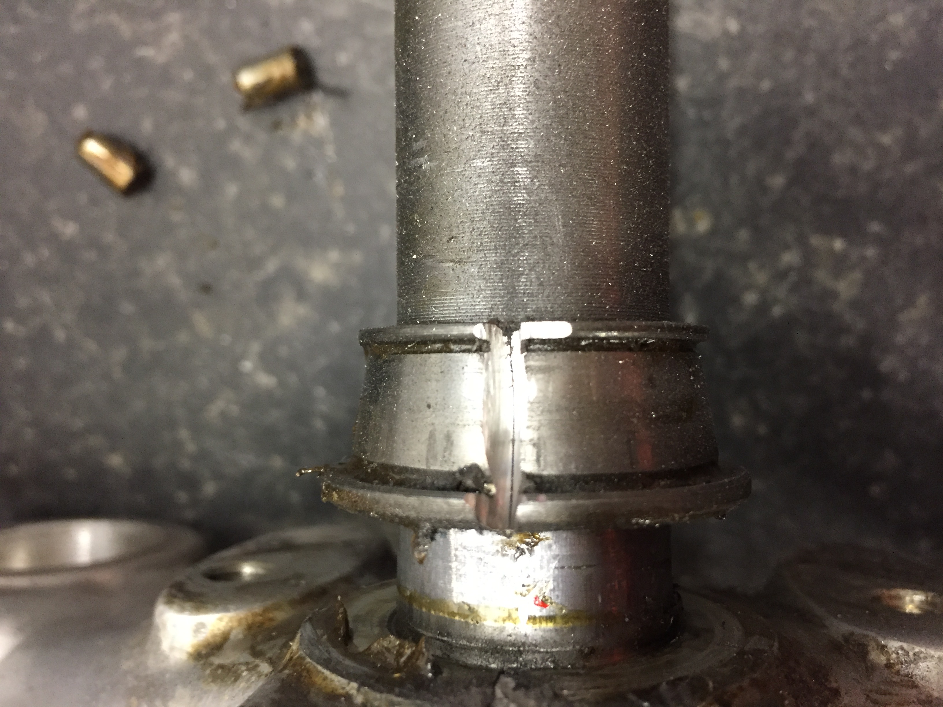

baffle was completely rusted in slash silencer, eventually came loose in the wrong direction ..and went past the elbow in the silencer - nope not coming out now - 4 hours of pulling , tools , jammed solid - recip saw finished it off

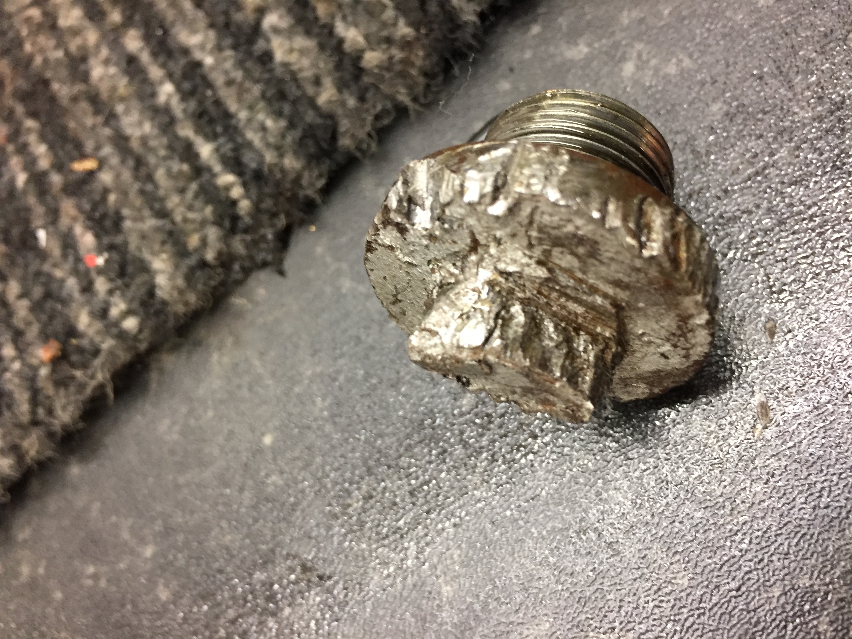

Sump plg !, I couldn't find it ...then I saw a bit of metal hacked to death .. had to cold chisel the rim to get a turn , so overtorqued / seized - new one bought
6mm bolts each side of head - threads in barrels stripped, 2 x helicoils fitted , 2 cam cover bolts the same

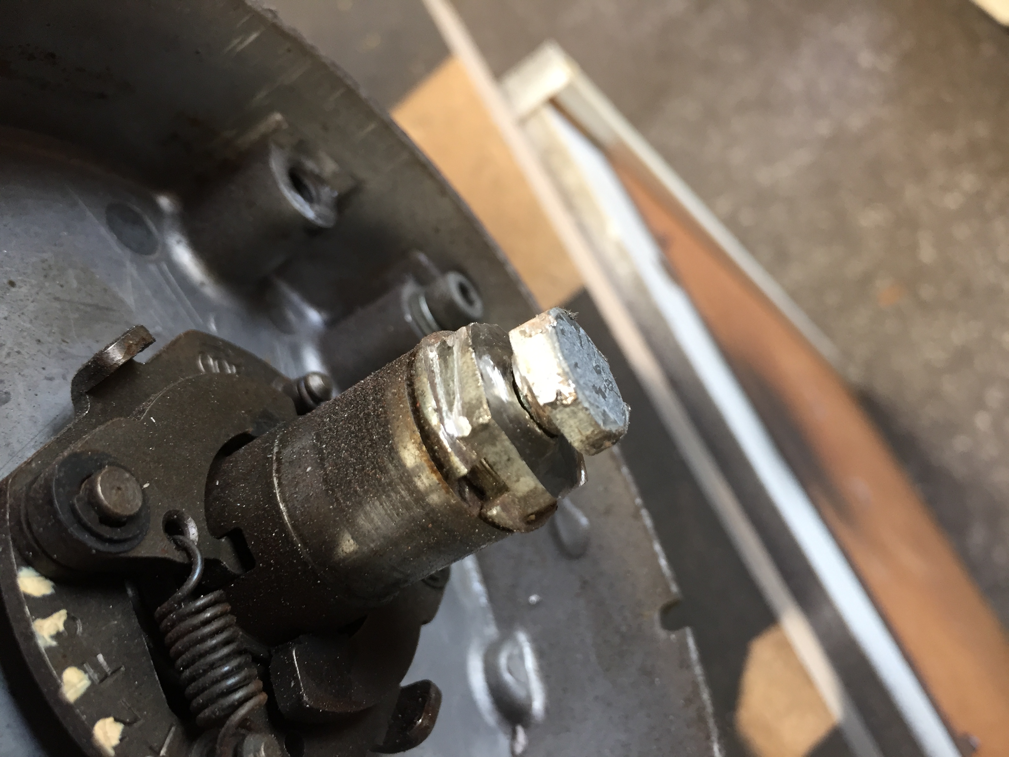

Crank auto advance bolt - was so tight was going to snap most def trying to undo - so I cut a slot between the small and large nut to relieve the compression/tightness and it came off with a spanner no problem , thank you dremel - it cost £23 for a new bolt - so much better that a snapped bolt in the end of the crank
