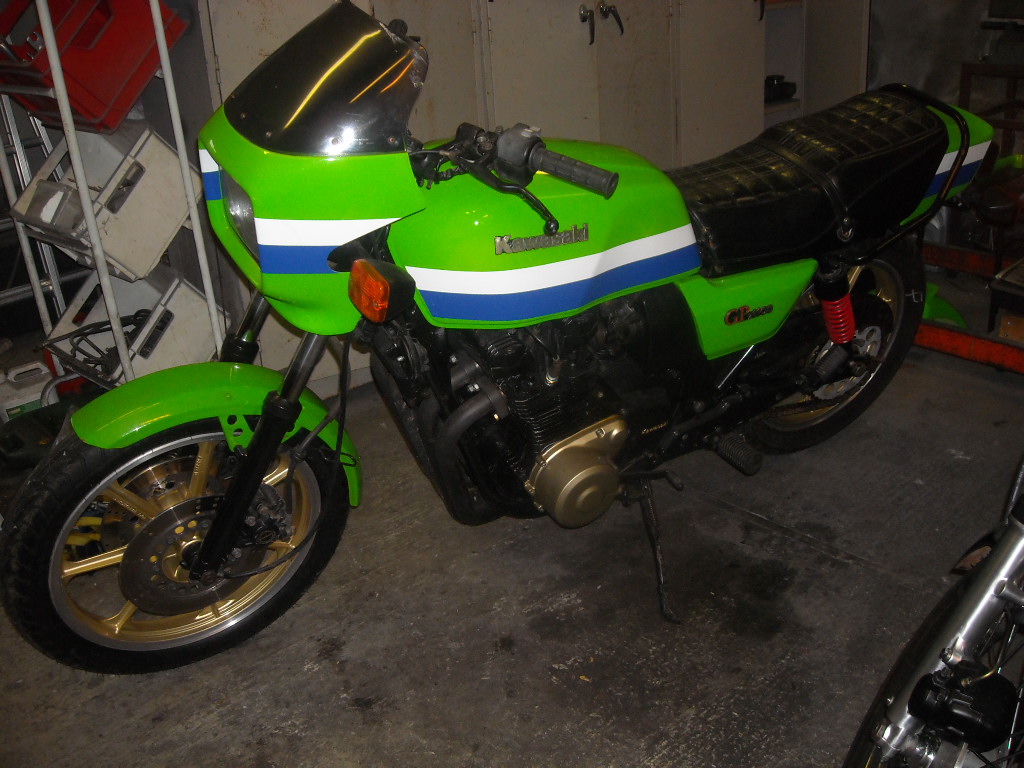

This is how the bike was when I bought it last week.

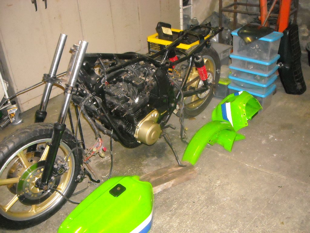

And this is how she's now...
She looks a bit naked now but she'll get nice repainted cloths and other bits and bobs to make her shine again.

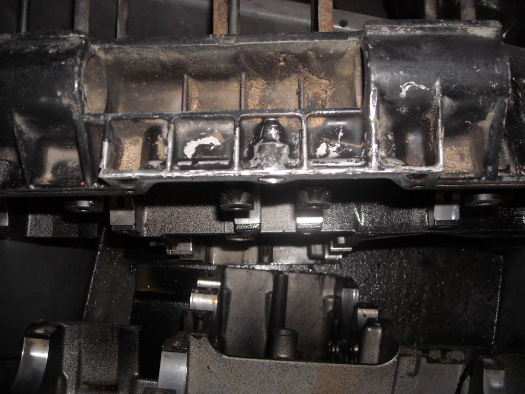

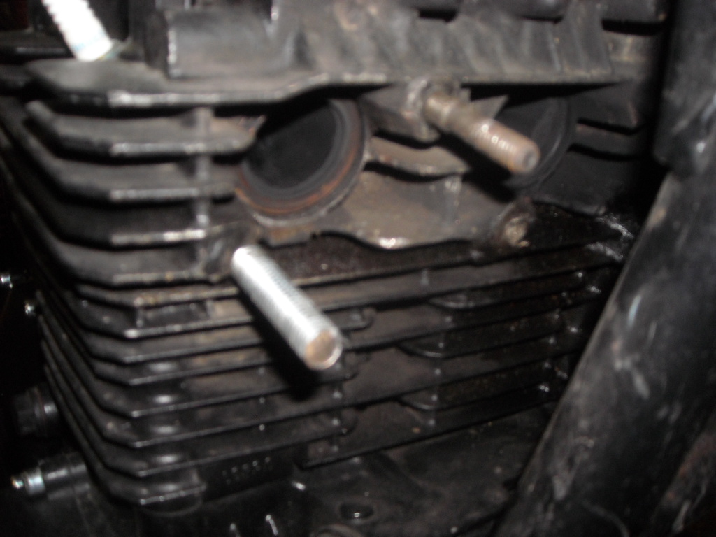

I promised you some pictures of the horrors I discovered while dismantling the bike (after all, Haloween isn't that long ago).

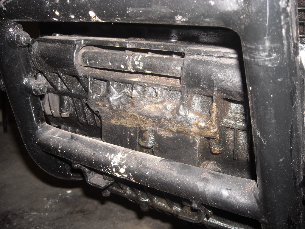

The major horror I discovered was a lump of resin at the front of the engine, just where the two cranckcase halves meet.
I was expecting the worst but hoping for the best...
It turned out that a bolt broke off and the broken off part remained in the upper cranckcase half...why they putted a blob of resin on there I don't know. Anyway I removed the broken off part, tapped new thread in the hole, inserted a powercoil and the problem was fixed. I was happy there was no major damage to the cranckases.

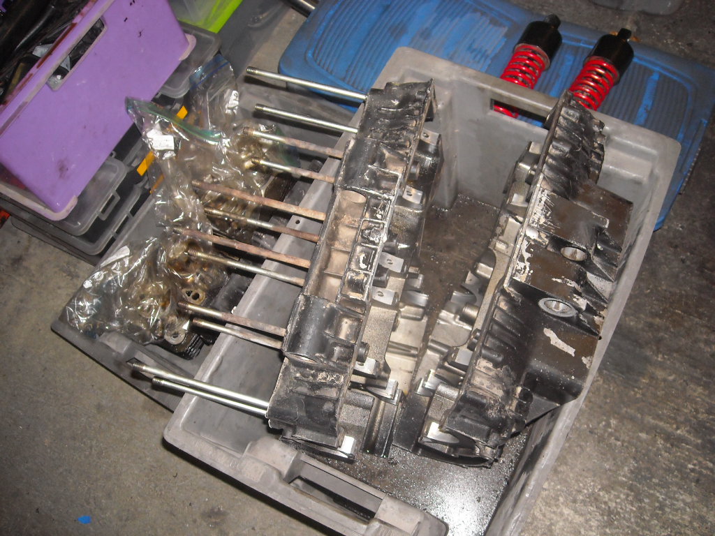

Another discovery was a piece of M10 threaded bar in the cylinder head ... it can be solved but...
when removing the cylinder head it turned out to be a ZX10A (GPZ1100 Uni-track) head with the valve shims under the buckets...
On the outside the cylinder heads look the same, on the inside the valves, springs, valve retainers, shims and buckets are different.
I have no spare Gpz1100B2 cylinder head but I have a complete ZX10A for spares so I'll probably use the decent looking spare ZX10A head. I know, it's not correct but nobody will see it an I'm sure none of you will tell it to someone, it's our little secret.

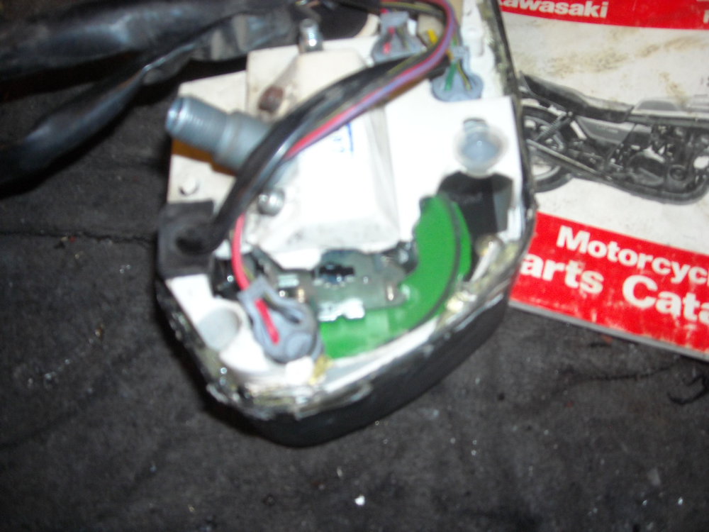

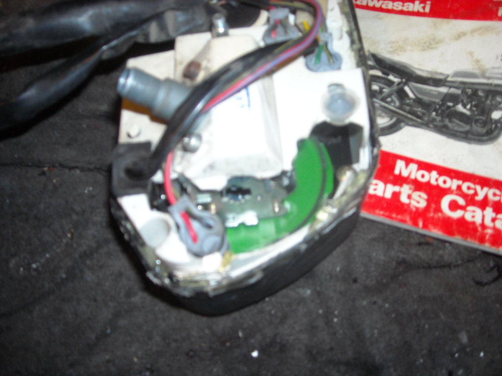

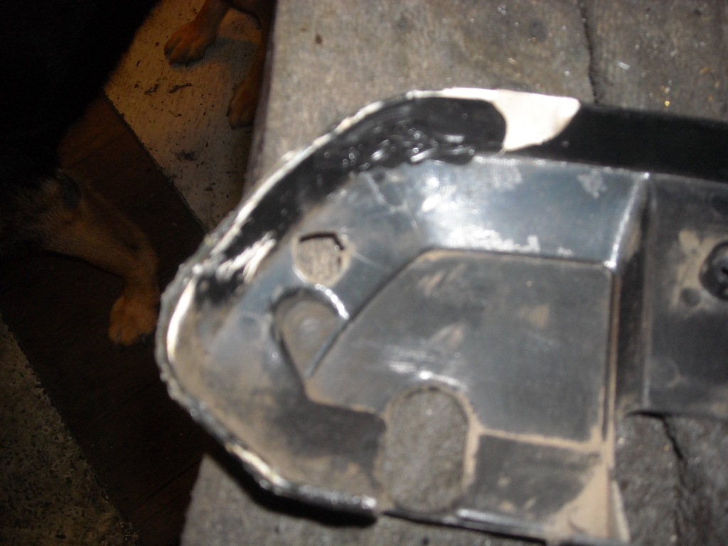

The next bad surprise was the housing of the clocks. They looked OK as long as they were mounted but when I removed them ...pure horror for me. The two halves were taped together, glue was used to keep them in shape and when I opened them a big part of the inside had disappeared.
OK what are we going to do now? The solution came from the French forum. The clock housing of a Z550GT is exactly the same and rather easy to find. So I found one in Germany and it's coming my way. I only have to swap a few parts and the problem is solved.

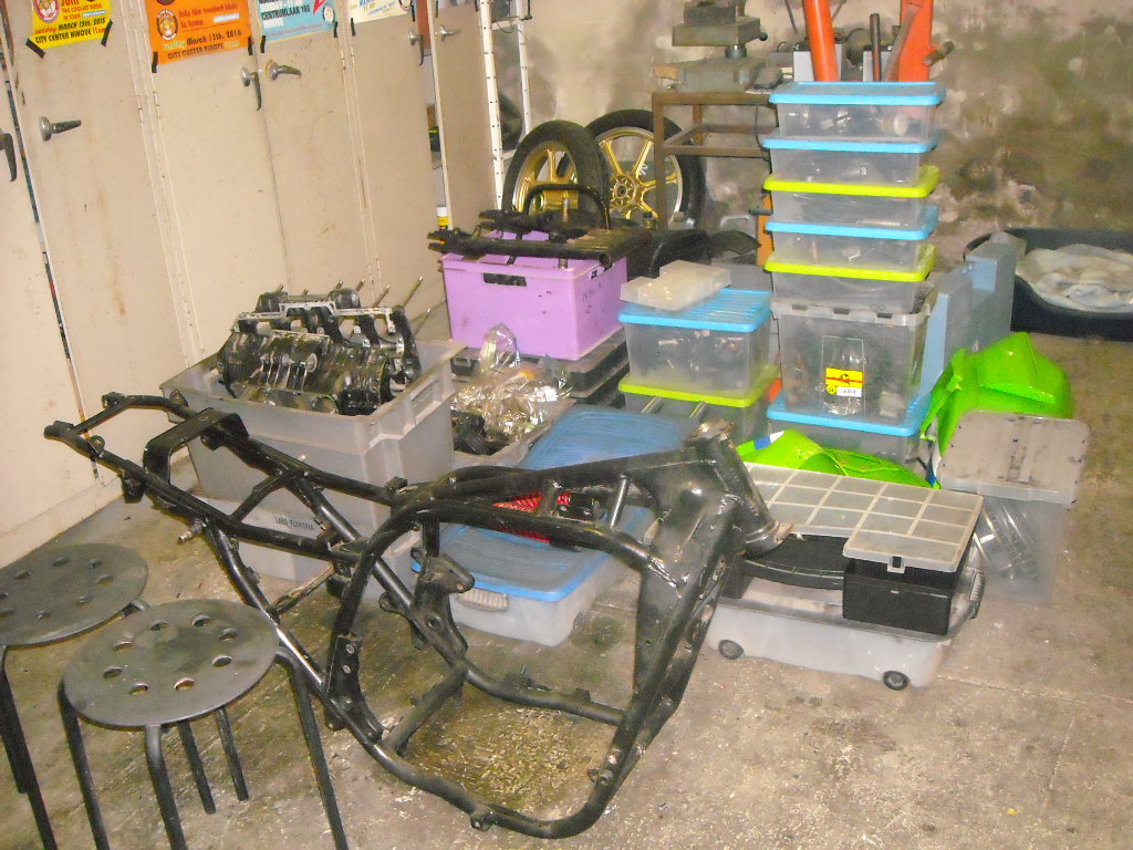

For the moment the whole bike is taken apart, most of the parts are stored in boxes waiting for preparation and or repair.

Just curious, what pistons was it running?
I believe the valve angles are different in the uni-track heads (compared with the twin-shock bikes) which is ok with standard pistons but can cause issues with some of the higher compression aftermarket sets.
Looking forward to the fuel injection set up.

Fairly sure that one of the front bolt holes is designed to be used to split the cases. Maybe something happened there with a previous owner not undoing all the bolts that hold them together.
Its the exhaust valve angles only which are different as Rick says. They are laid over flatter than the inlets of the Unitrak head and both those of the J and B and 1000R etc. They can cause serious problems with higher comp pistons but you can have the valve pockets machined to offset the problem. Shouldn't be an issue if its been running though.
Sidestand brackets are a common fault and tend to rotate or split away from the frame on the underside. The LHS frame tube (lower rail) that the bracket is on also tend to suffer with rot. The flattened top surface of the bracket should be horizontal when the bike is bolt upright,yours might be a little out of position.

@ rickm: I think that it has pistons of a ZX10A, they are marked "ART 114" but I have no experience with the "younger" bikes so any input is welcome, they have the standard size: 72,5 mm. But they look like high compression pistons...
@ uli: thanks for the offer but I'll stick to a ZX10A head, perhaps you can help me to find some other parts if necessary.
@Al: the engine ran with no issues so I think it's OK. As far as the lower left hand frame tube is concerned: it seems to be allright. I'm aware of the rotting problem that's caused by water getting in the tube and not able to get out anymore. The little plastic cap was still on the tube where the anti theft device was kept so I hope the water didn't get in...time will tell.
thanks a lot for your replies!

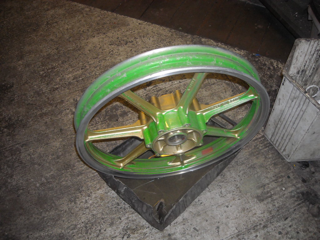

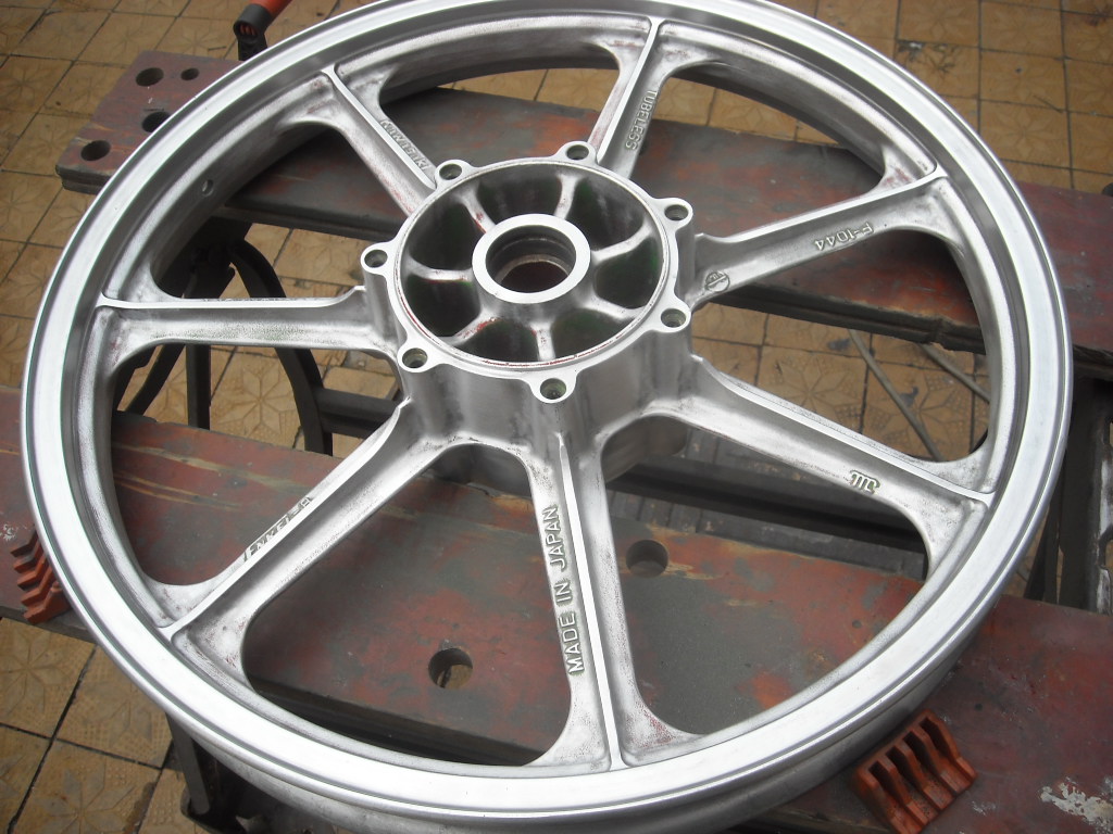

It was too cold to paint and I couldn’t strip paint off from the steel parts because they would start to rust, so I continued on the alloy parts.
The wheels had a gold paint on them under which I found a green paint and finally I reached the original red paint. It took me several days to prepare them for painting.
As usual I soften the paint with thinner and remove as much as possible with some sort of scotch brite. The remaining paint is removed with several nylon brushes on a drill.
I was able to order the red paint for them just before the corona lock down, lucky me !

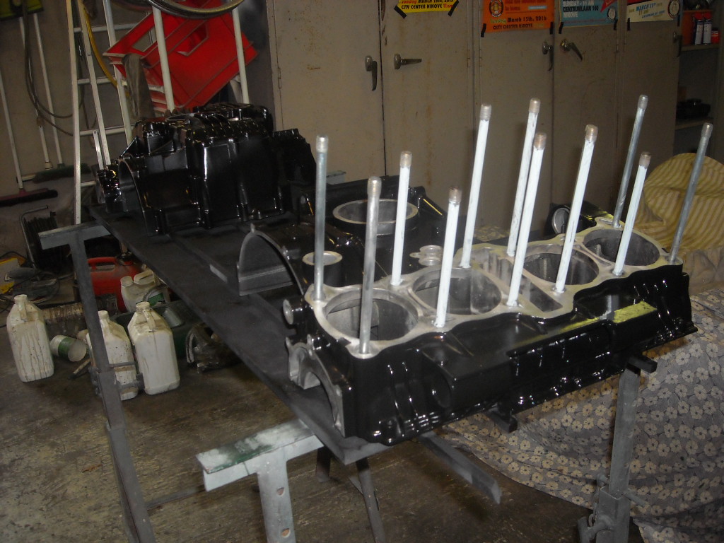

I also stripped the paint from the engine and painted it during a warmer day in february.
The engine is partially reassembled and I’m waiting for new piston rings to continue.

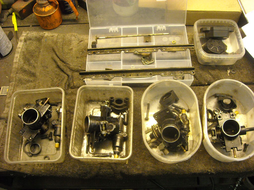

Other alloy parts were prepared, among them the injector bodies.
I stripped the whole ramp until I ended up with a bunch of parts...then I realised there’s no explanation in the workshop manual to reassemble them...but I bought 2 Uni-tracks last summer and the injectors are the same as the ones on the B2. So I had an example to help me to sort it out.
As time went by and the temperatures got up I was able to spray several parts among which were the injector bodies.
They each consist of a lot of parts and all 4 of the injector bodies are different.
A lot of parts are the same but the most important of them are different.
The valve axles have different alloy parts and the third has the throttle cable control on it.
The axles of body 1,3 and 4 can be removed without a problem. The number 2 axle needs a bit more work in order to remove it.
You’ll see it in the next episode.
See you soon!
