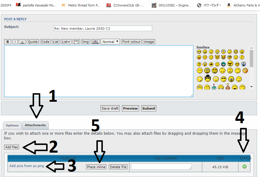

P.S. Would do photos but after trying to upload them, I gave up.
Add pics from pc.png (44.57 KiB) Viewed 7820 times
Re: Gpz1100b1
Posted: Sat May 09, 2020 2:16 pm
Author: Pigford
Once you get to #4...... use mouse to click in the comment box (eg "X" marks the spot) then do #5 to place photo's where you want them to go. :lol:
