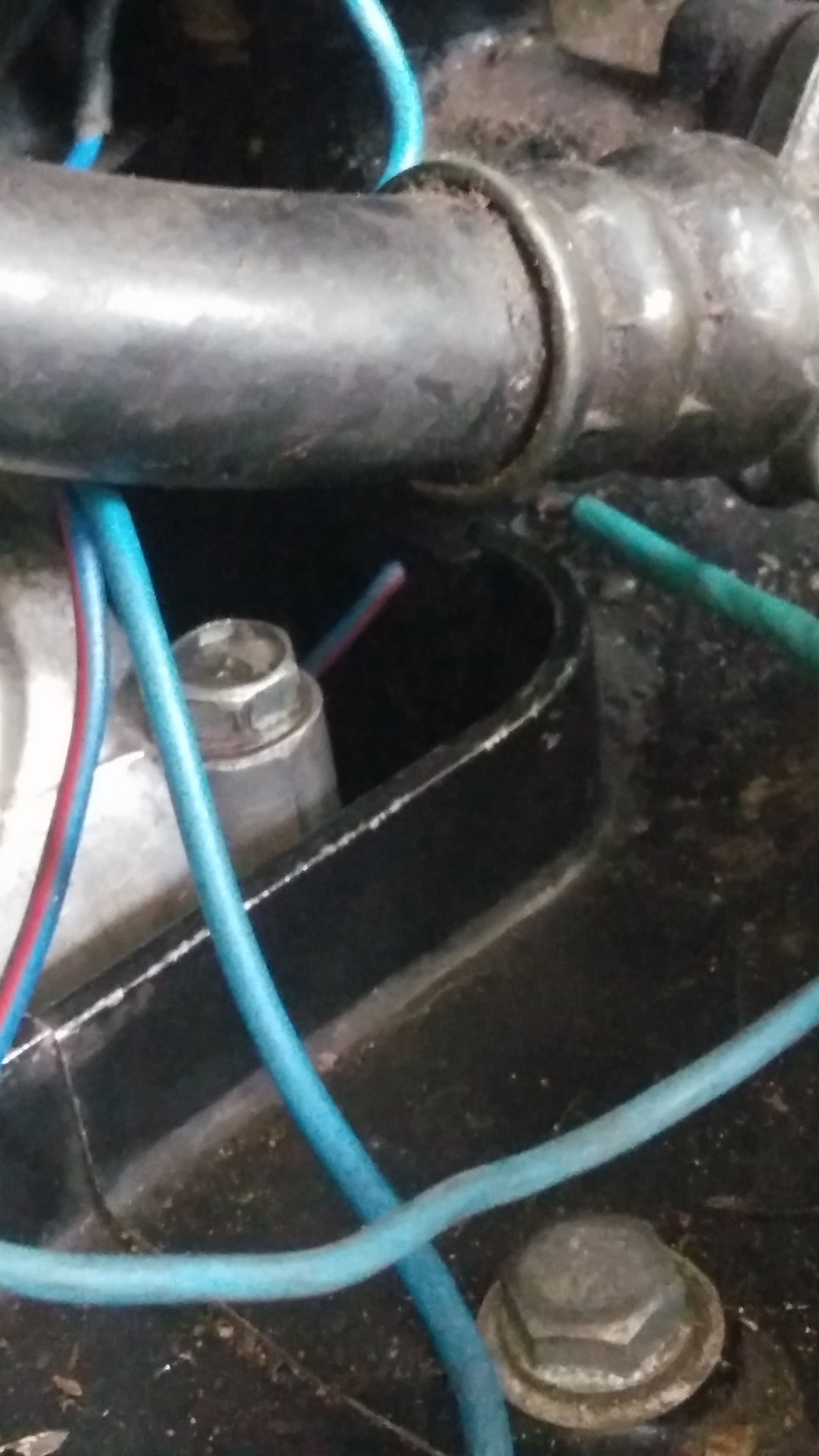

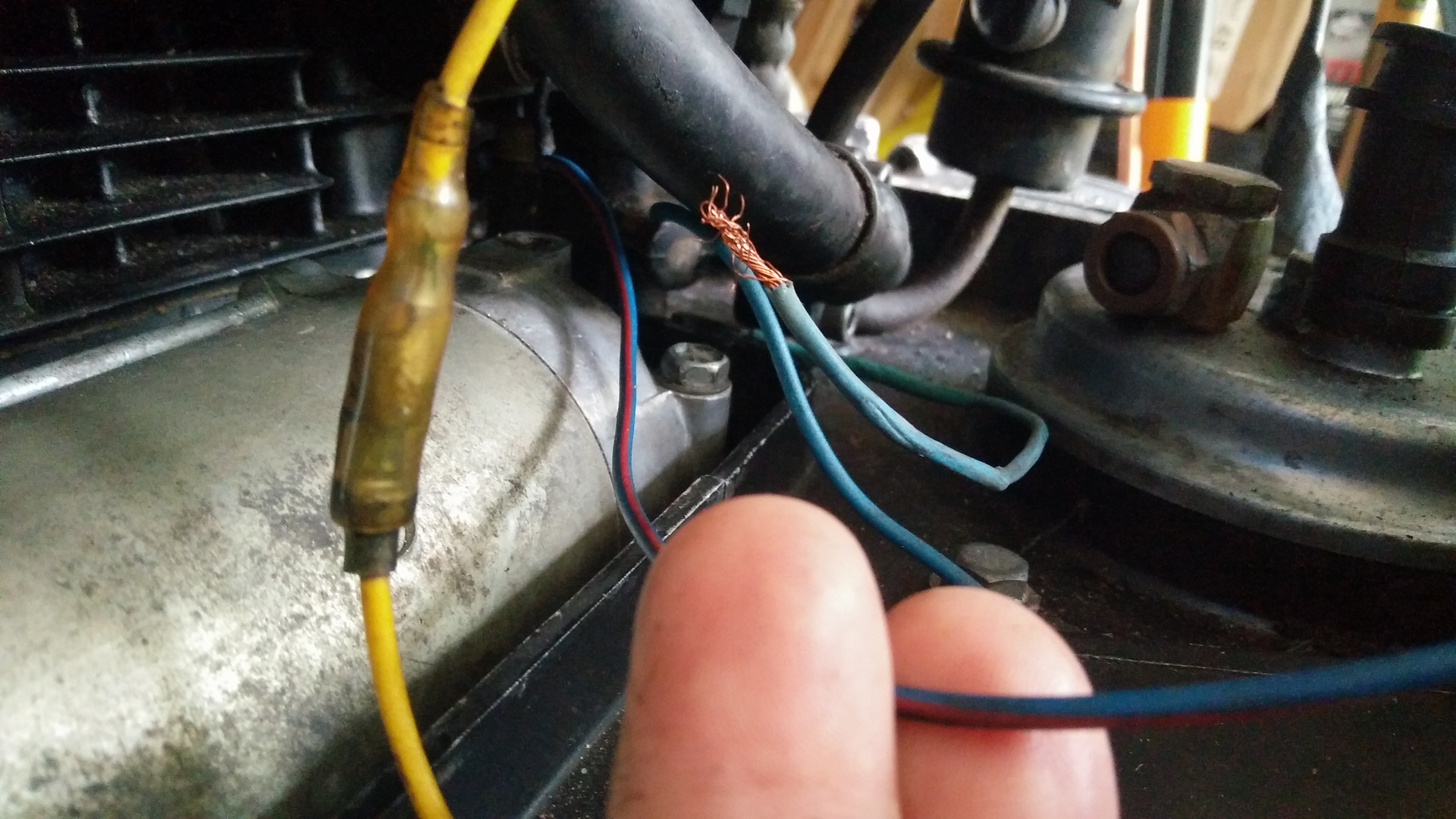

Thanks for that but i already have a blue with red stripe going there, the One i am holding Is from the loom to the oil pressure switch, the other photo just shows another Blue with red stripe coming out of the crankcase, albeit i have had to solder and shrink wrap a new extension on It...

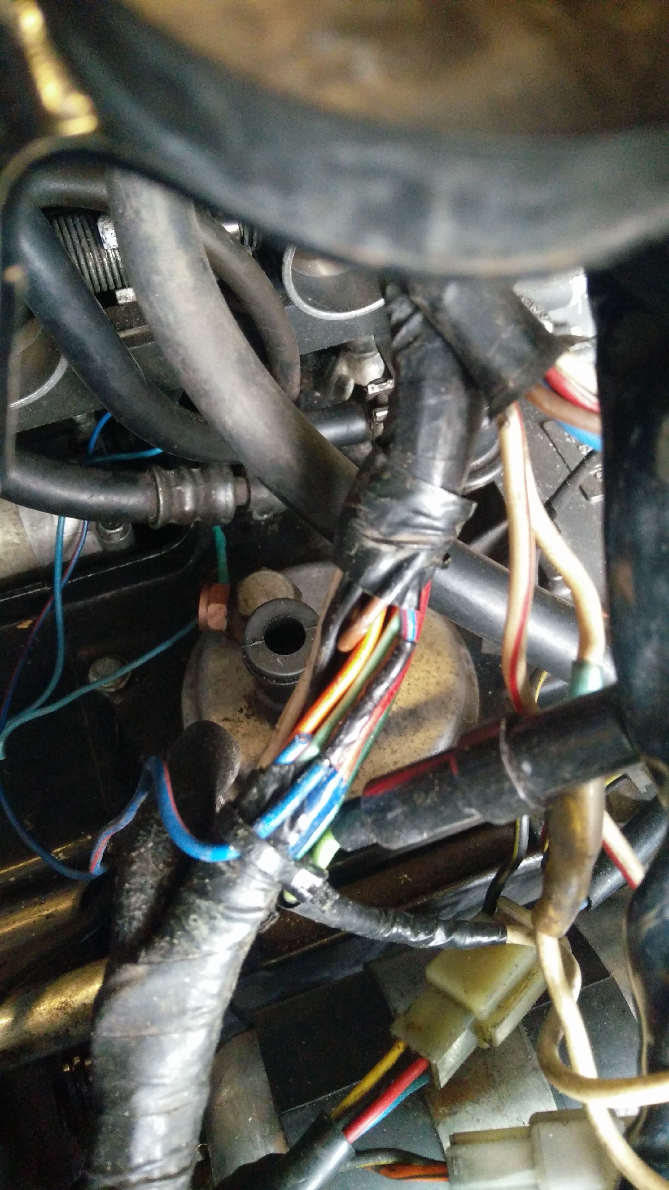

The RED/BLUE wire from the oil pressure switch goes from the switch itself, through that little rubber grommet, under the starter motor and into a thin 'sub loom' which has in it; three yellow wires and one from the neutral switch. That wire is pictured in place in youre second photo.

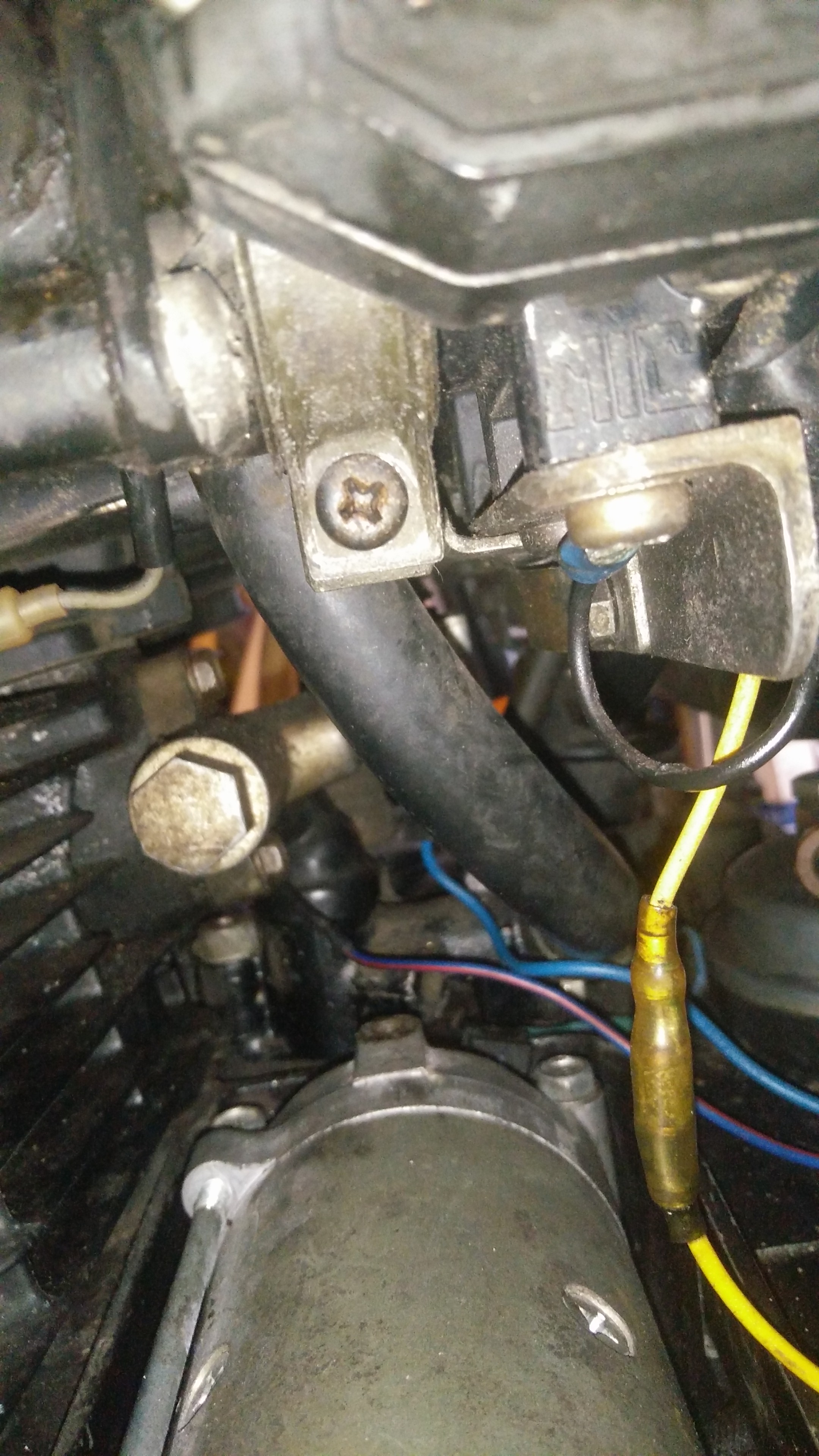

Ok, Will try to explain what i have found, on mine the oil pressure switch Is located on the top, at the rear of the crankcase. The cable Blue/Red stripe, goes from this then down into the crankcase, then CES back up the loom at the top of the plenum chamber. The last photo i poster shows the Blue/Red cable spliced with shrink wrap connected to the Blue/Red cable that comes down the loom, you can see in the loom where the stub of the Blue/Red cable still exists, this Is the original bit that goes down the loom, and comes up behind the starter motor, out through the Rubber grommet then into the pressure switch. Not sure of that all makes sense...but all working now.

Now I see it! OK ! So they swapped the oil departure of your B1 with an oil departure of an older Z with an oil cooler. That way they could measure the oil pressure on top of the crankcase while leaving the original switch in the sump. They had to connect the wire of the "new"oil pressure switch with the wire coming from underneath.
As long as it works it's fine. Thanks for the additional picture! One pictures says more than a thousand words!
If you want to swap it to original you need a working B1 oil pressure switch in the sump and an original oil departure on top of the crankcase and change the non original parts with those and connect the original wires again.
