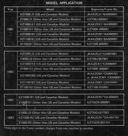

Frame number looks to be a 'Euro zone' 1983 Z1000 R2.
Model ident.png (317.29 KiB) Viewed 6493 times

As AL says - it's a European Z1000_R2 1983

The 1000Rs went up to about 6500 or thereabouts the prefix was different for US and Europe - JKAKZ for US, KZT00R for Europe. So yours looks like a Euro R.
It would be unusual for a ELR’d J to have details like a black chrome grabrail and black labels on the callipers but then J clocks... My R had GPz A1 clocks on when I got it, luckily I got most of the originals too they’re quite hard to find.
