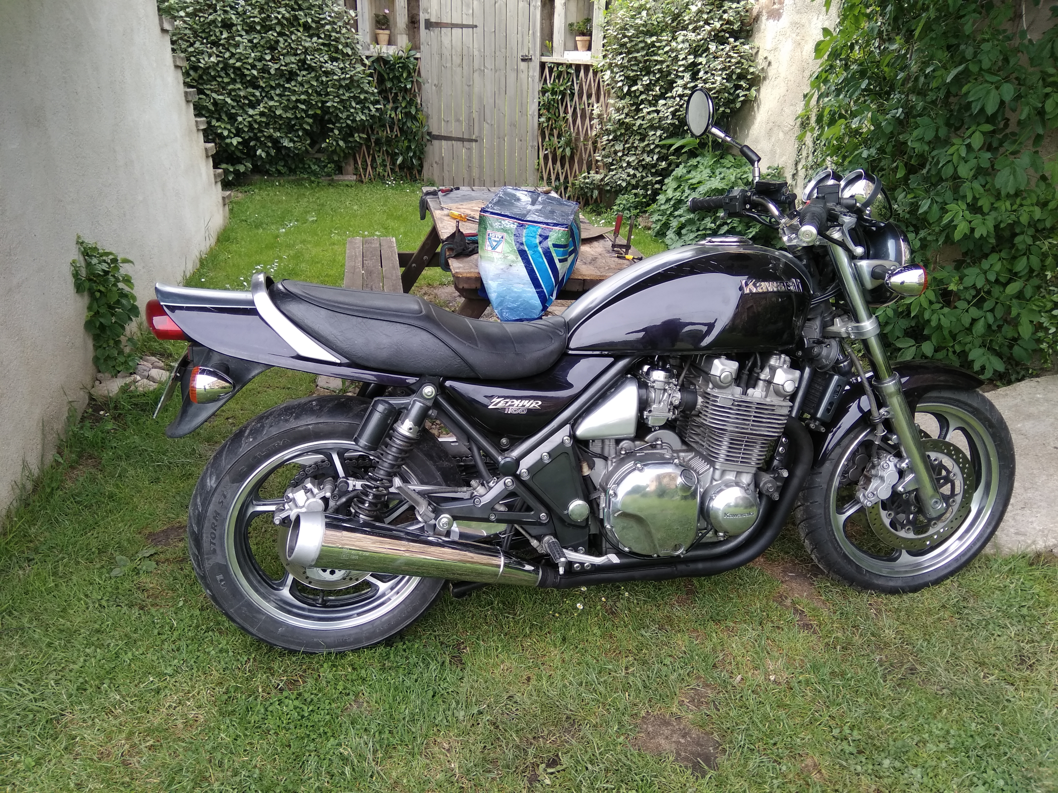

Found this
I had one when I was 23, sold it for a Blackbird, wanted more speed. Hankered after another for a few years.
First bike I've bought for 20 years that starts, stops and brakes with forks that don't spew their liquid. I saw the money they're going for in the UK..........
I'm in effect the the 3rd owner because the lady that I got it from was given it from her Dad but it was too heavy.

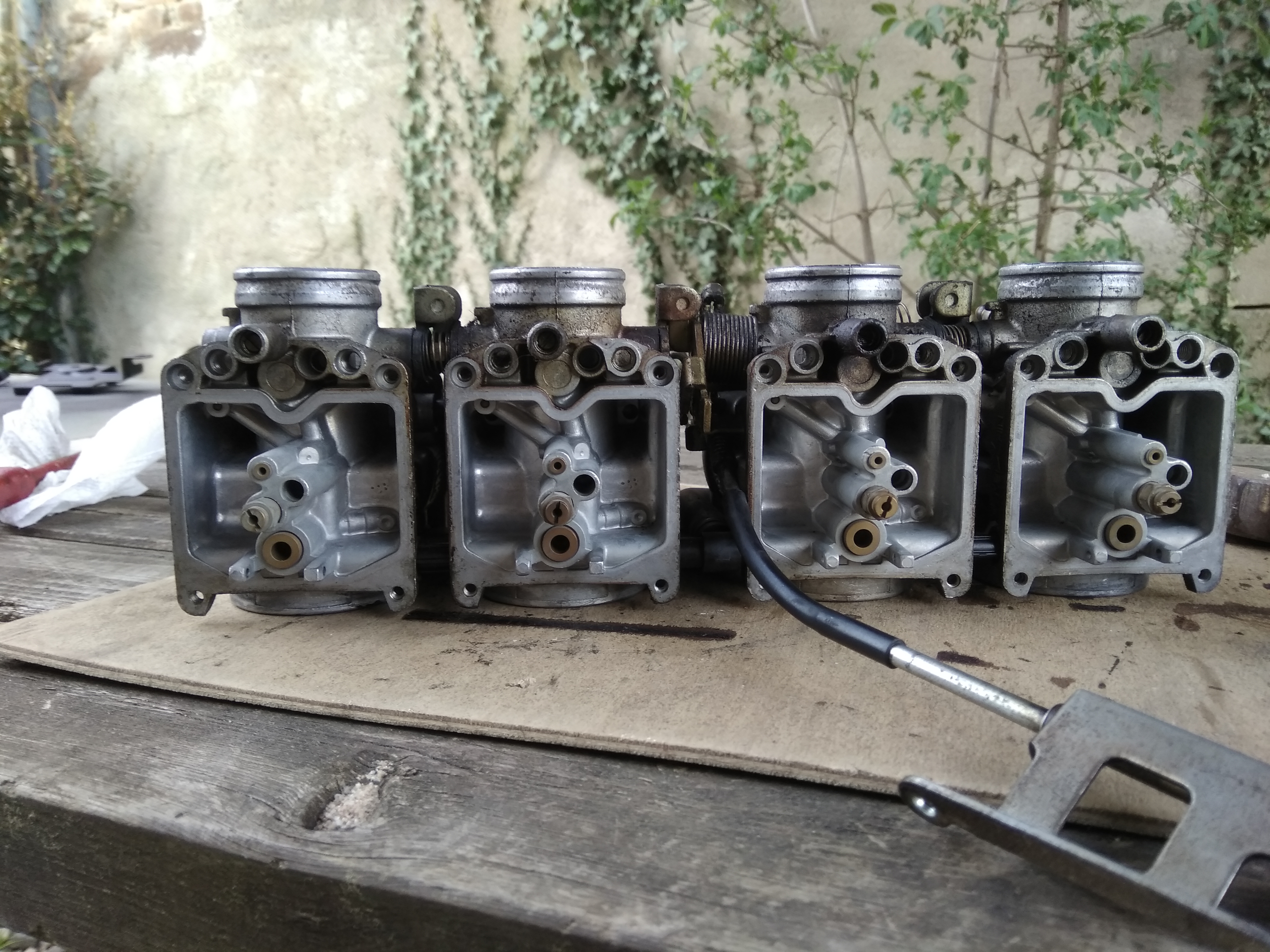

Bad bits--Carb 3 leaks outwards, carb 2 leaks inwards and filled the sump with an extra 2 litres of petrol. It's been on it's side but stationary, not sliding, no marks around the steering stops. One horn is knackered, It hasn't got the grab, bungy handles due to it having a back rack. And someone has put some go faster stripes down the middle of the tank and rear fin.

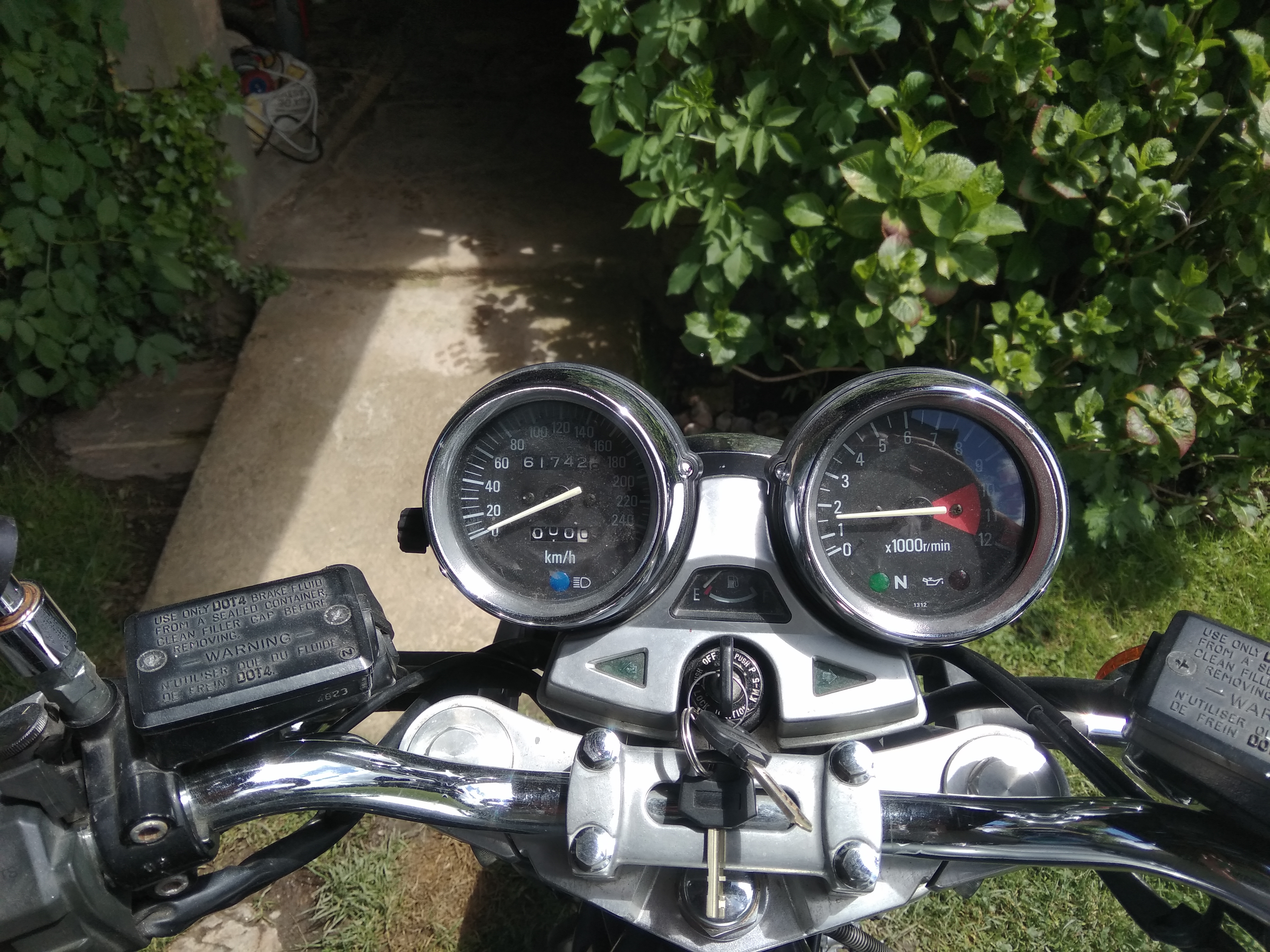

Good ponts--It looks like it just needs a bit of TLC, Original Exhaust, no rattles, took the carbs apart and the are mint inside, and for a few float bowl gaskets will run and ride. 61000 km so 40000 miles.

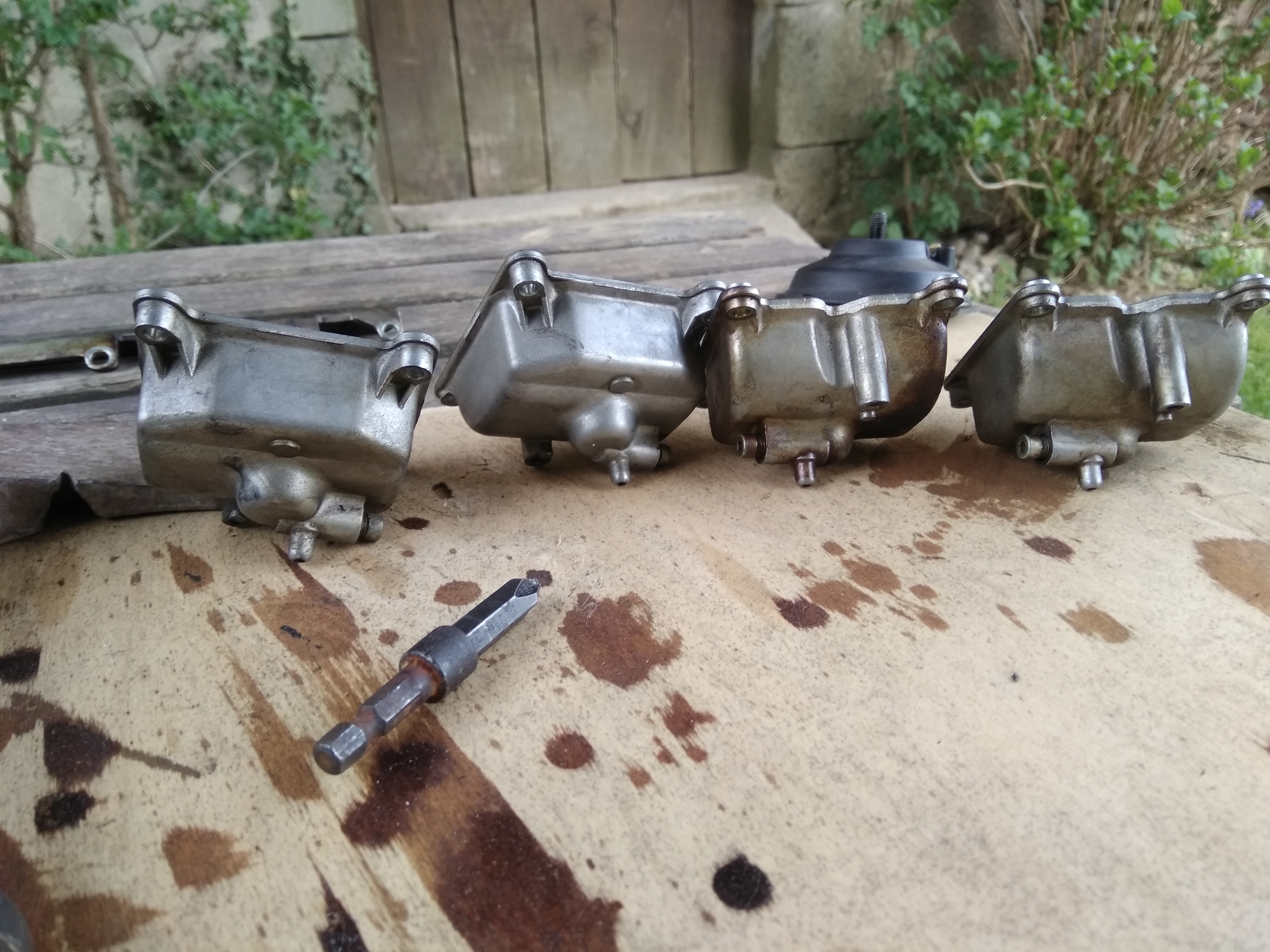

The fuel tap didn't turn off, took it apart, it was clean put it back together, now it works properly. The carbs were very clean inside
Though no.3 was manky on the outside, all had a good clean, just waiting for some joints.

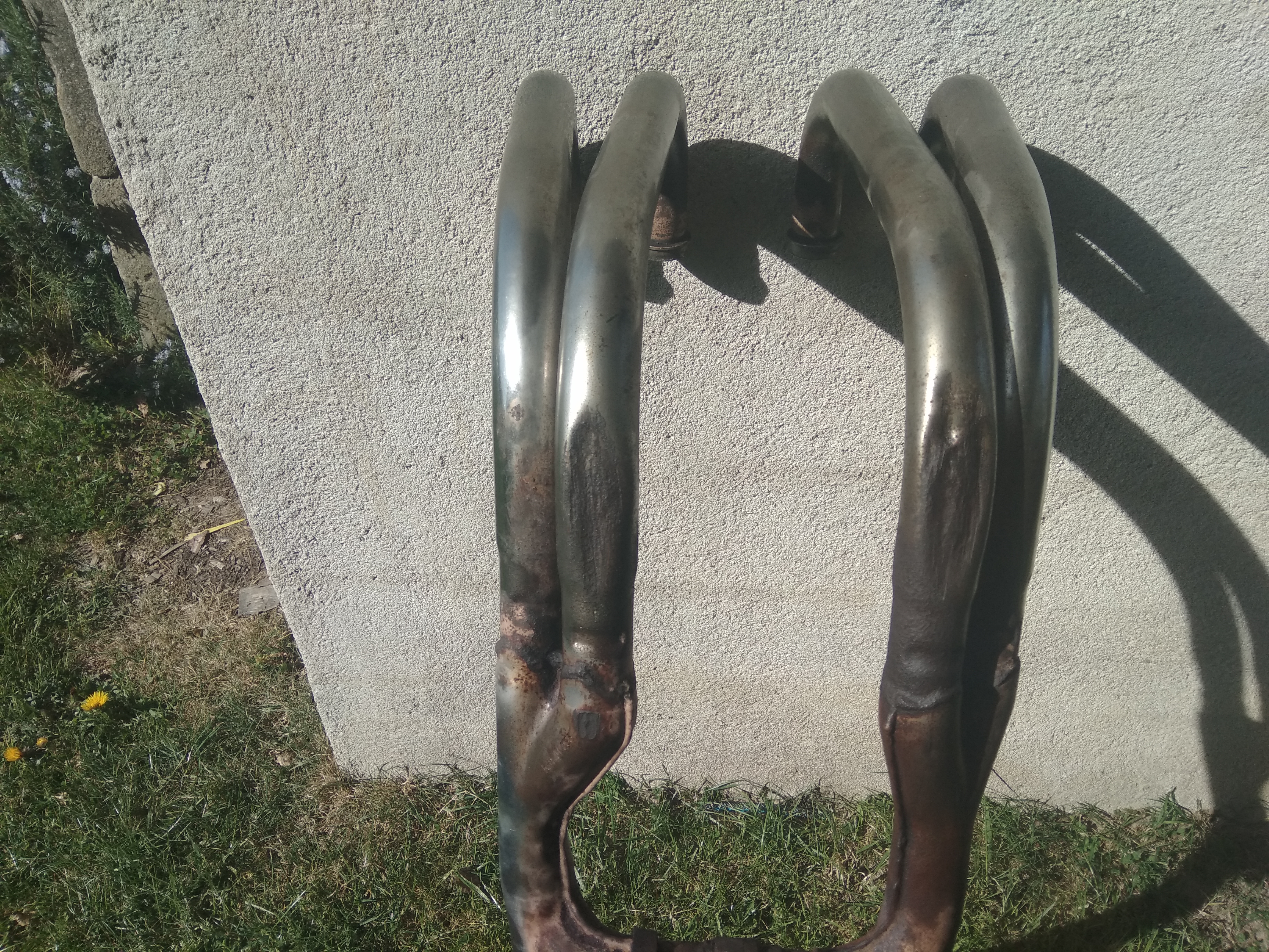

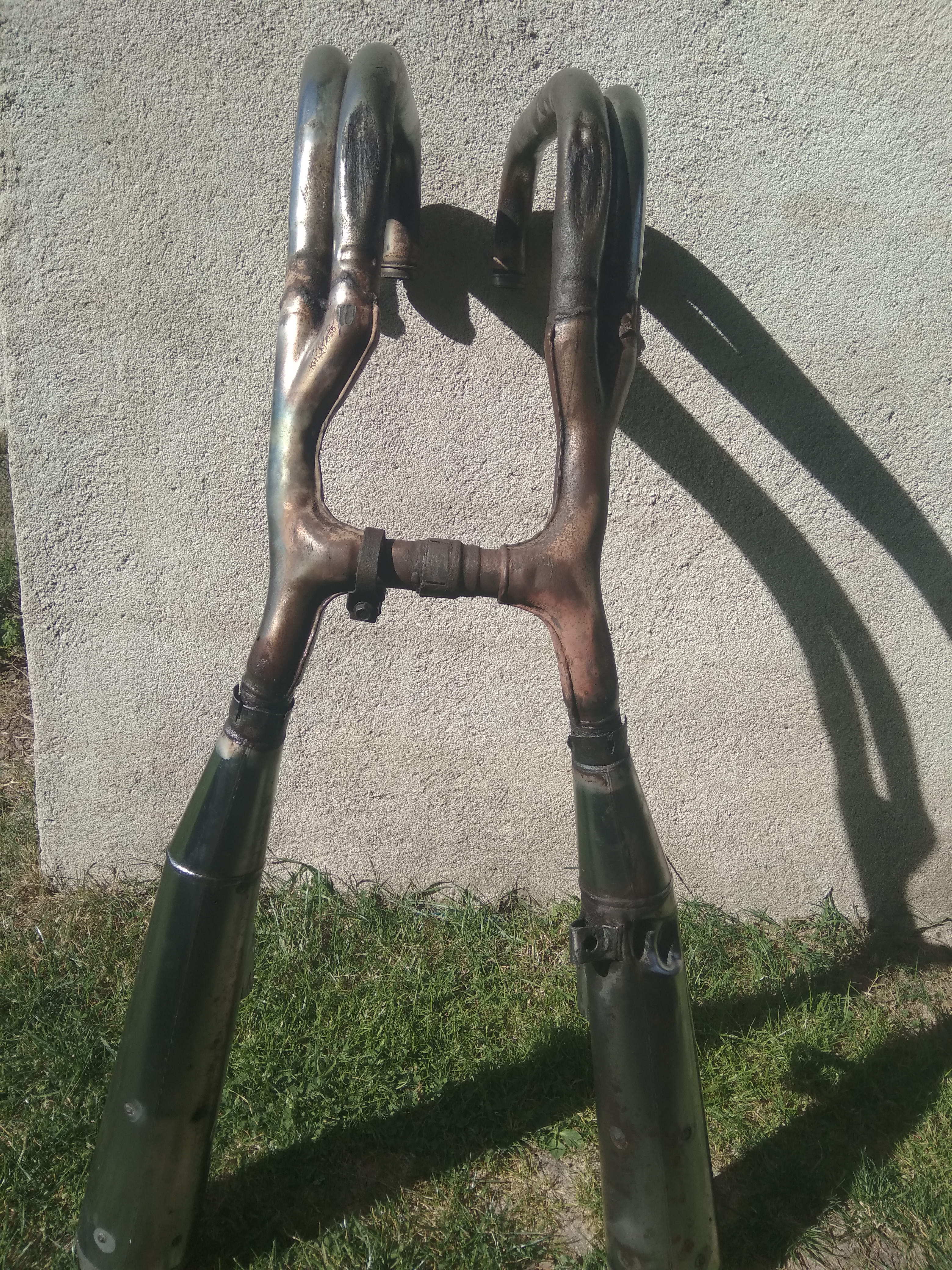

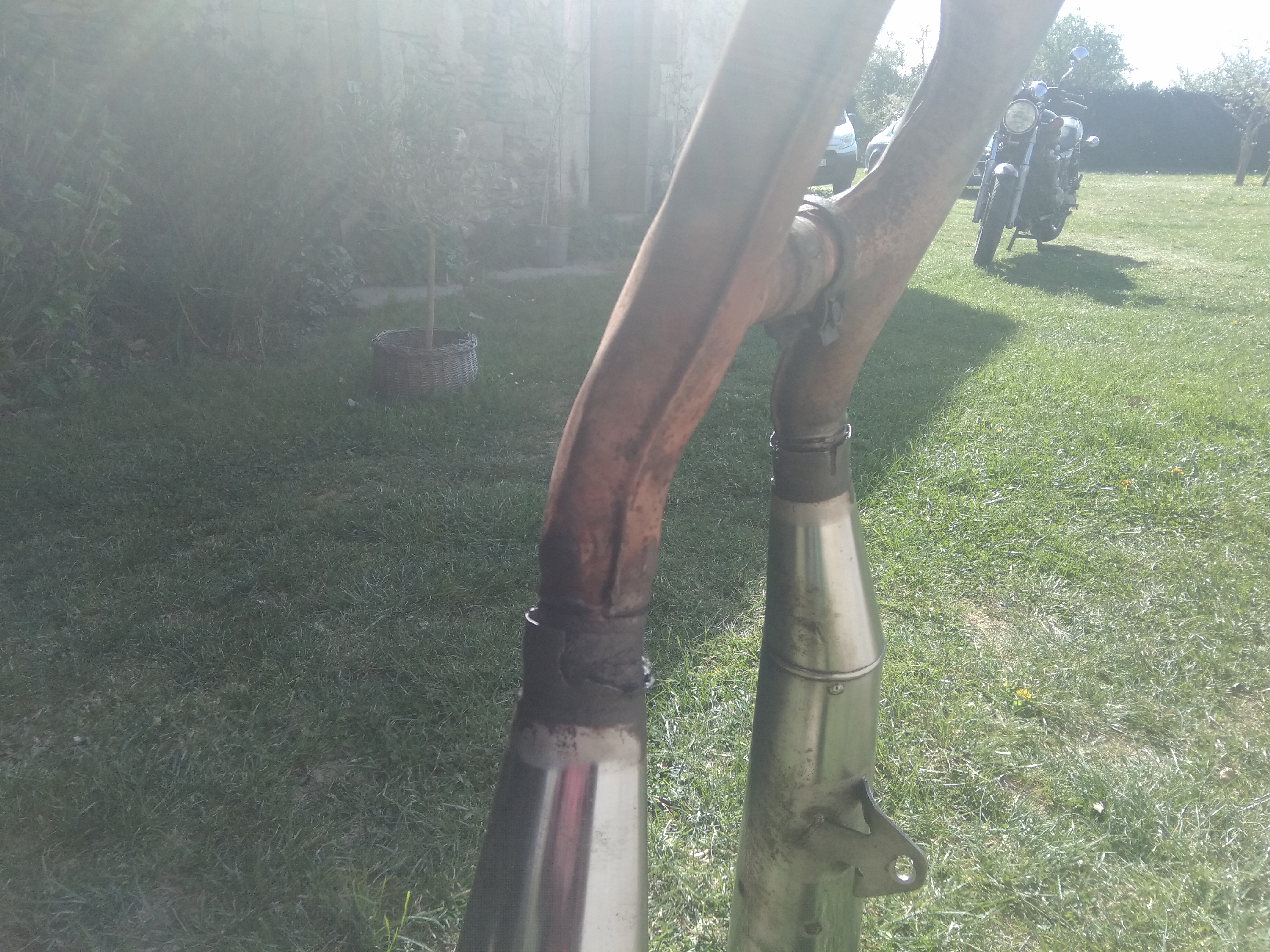

Bad news, the original exhausts are near their end.
They've been 'kerbed' but more importantly I tried to dismantle them in situ, no chance. Choice remove front end to slide them out or maybe taking the centre stand off may allow them to come out sideways, luckily the 2nd option worked. Lots of releasing fluid and wire brushing and teasing later and the won't budge. I'll wreck them if I continue so going to autosol the silencers, treat the balance pipe area then paint black and depending on the downpipes they may become black as well.
I've looked on the Delkovic site and they only do cans so going to try and save these for a bit longer.
There is a pilot jet o-ring, looks like it'll need a pick of some description to get those out?
Any clues anyone?

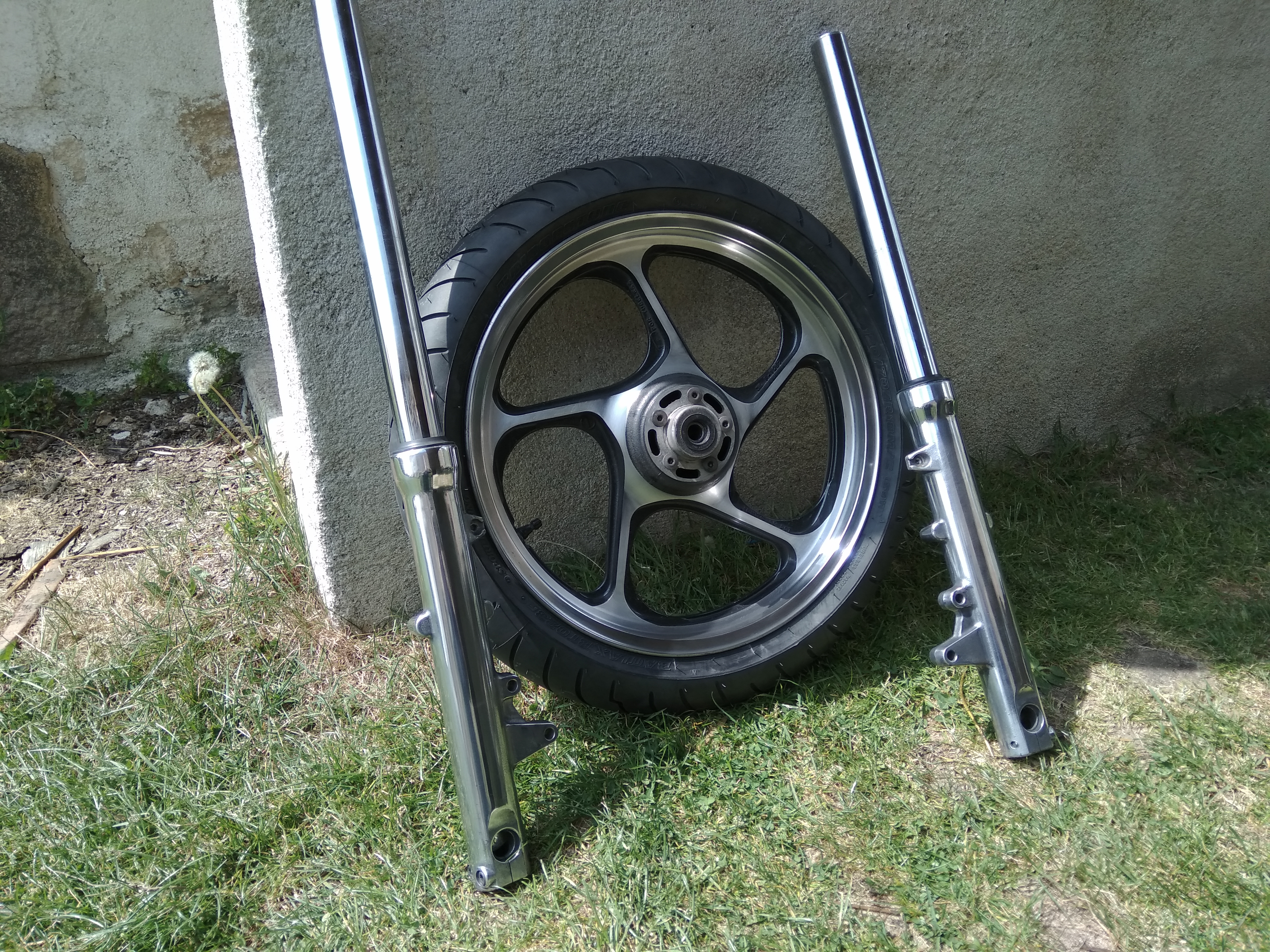

Then it was time to clean up the ally.

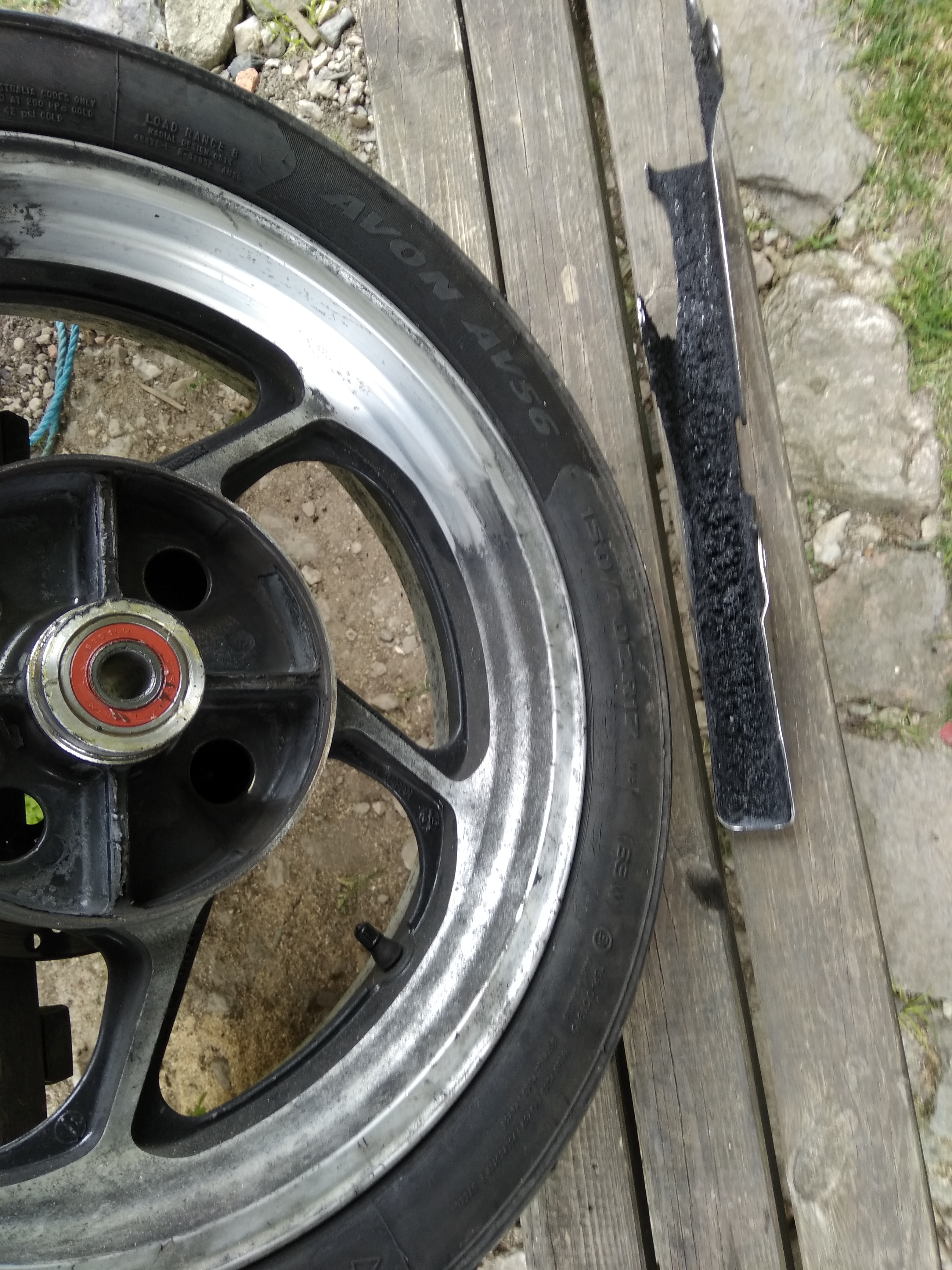

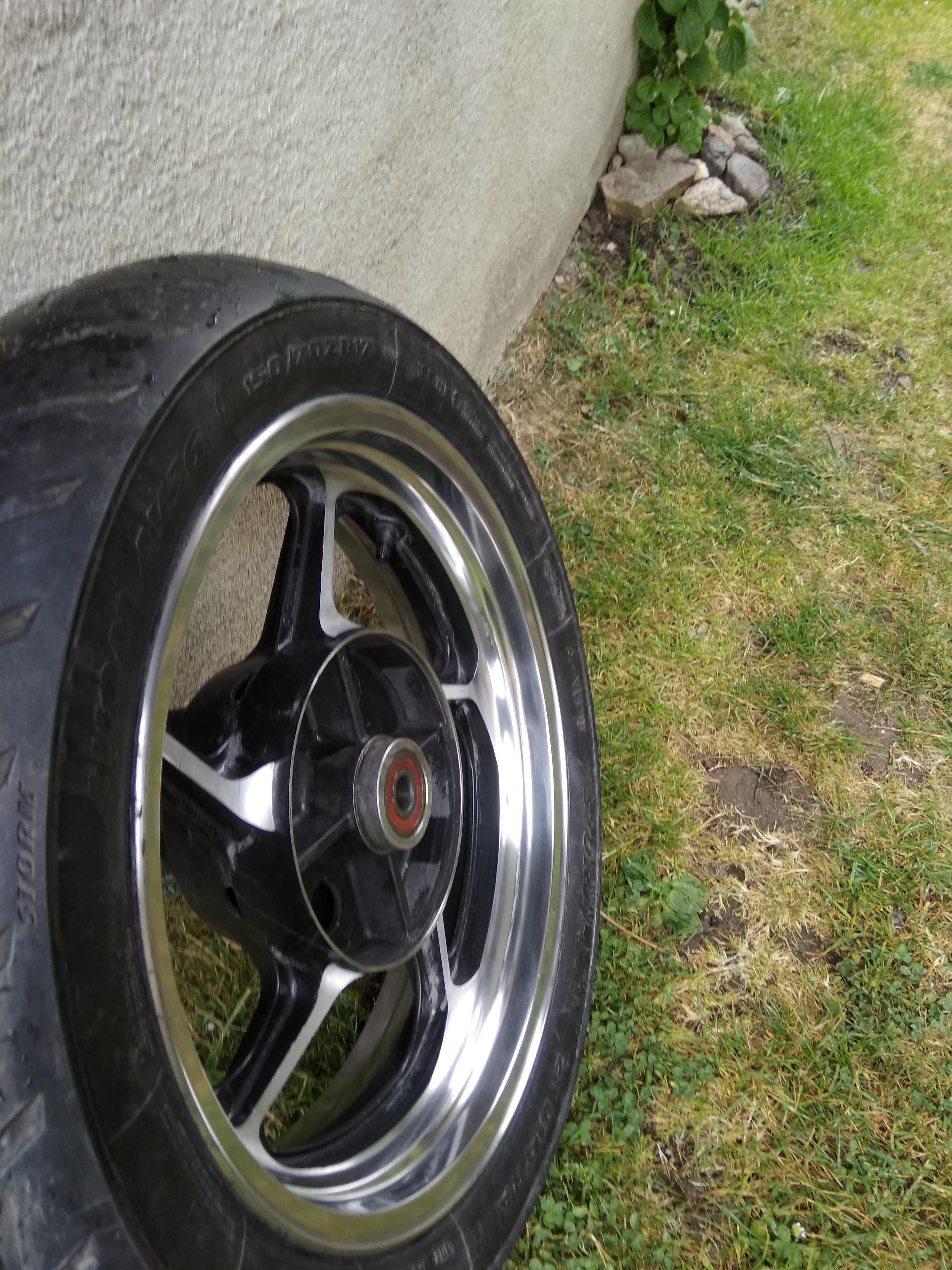

The wheels were looking a bit sorry for themselves.

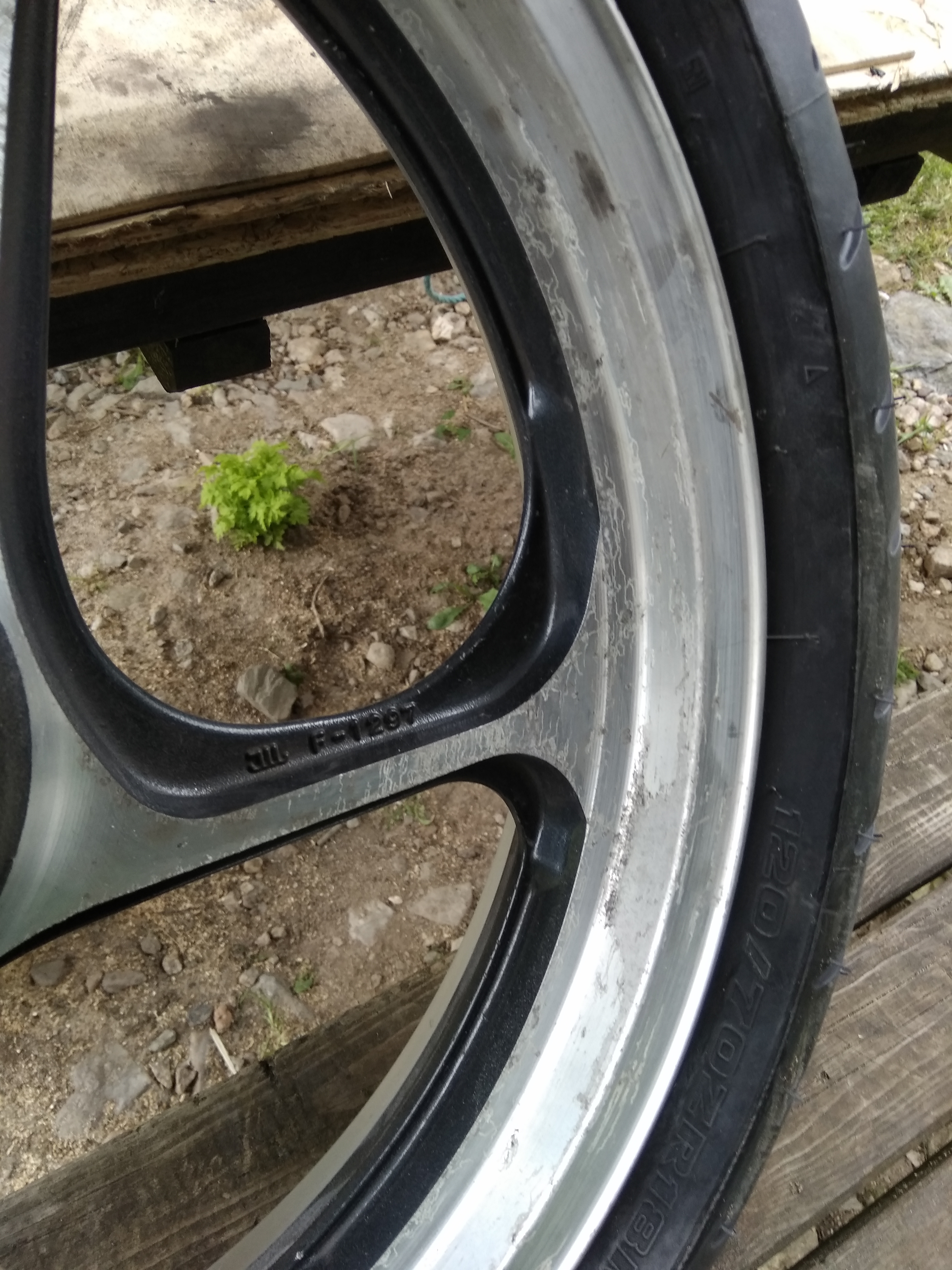

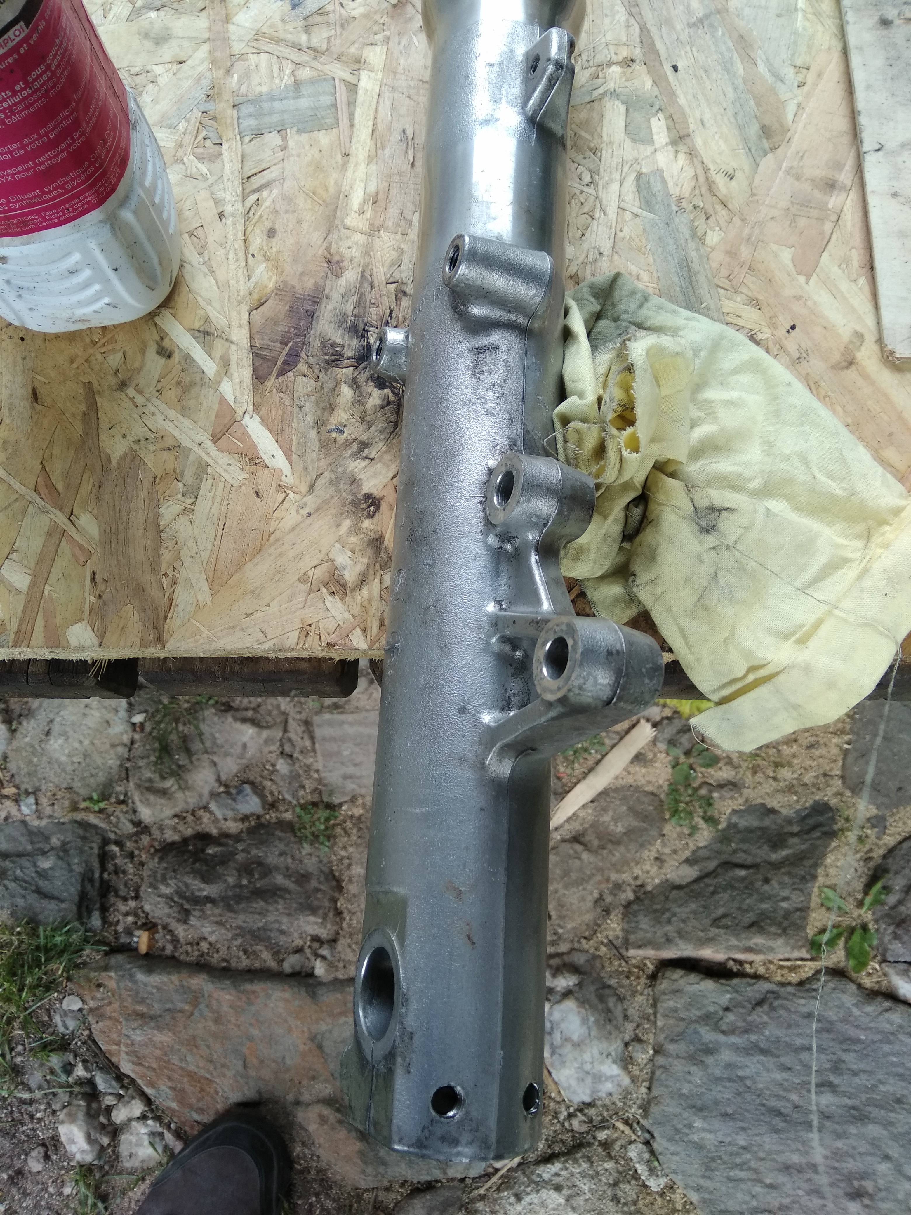

As were the forks
After a good degreasing the laquer was sanded away with 150 wet and dry in soapy water followed by some 400 grit, then the mop.

As were the forks

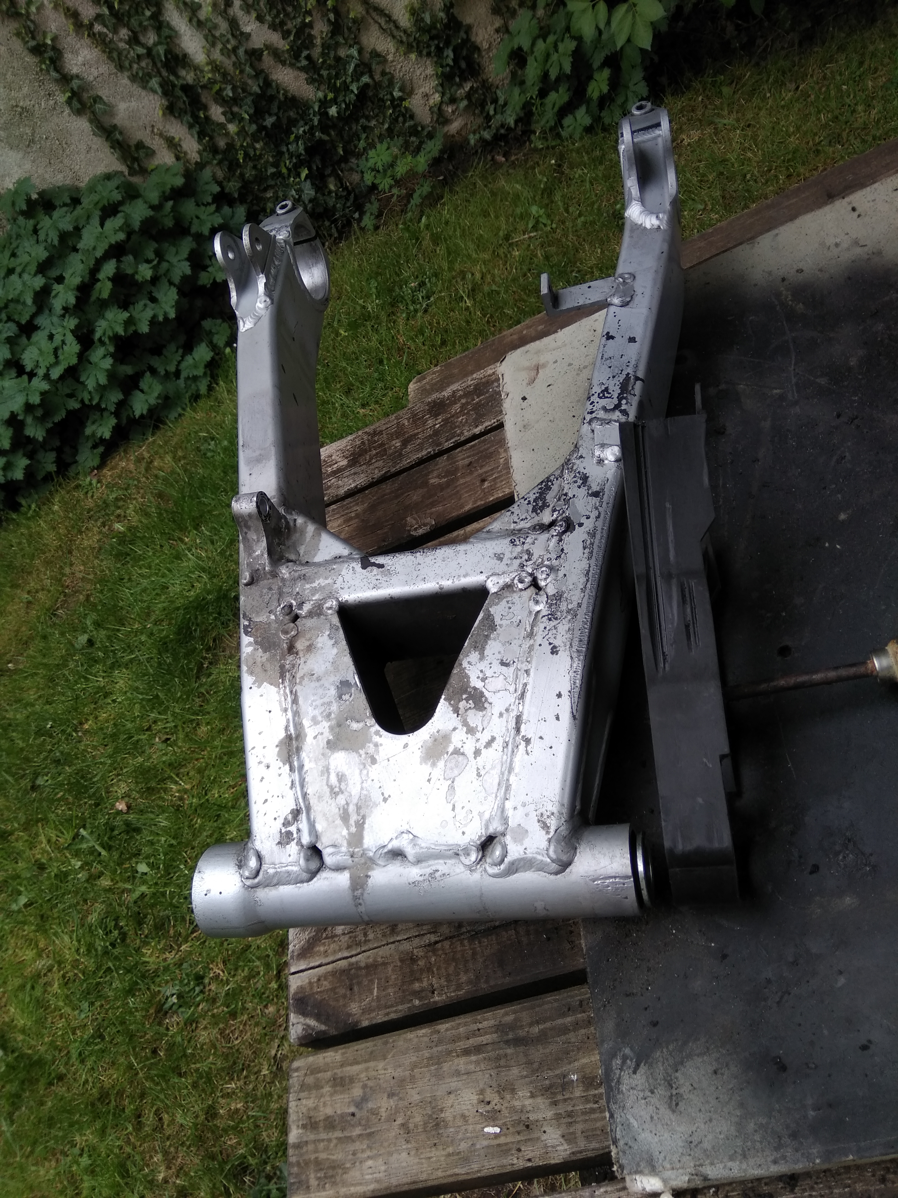

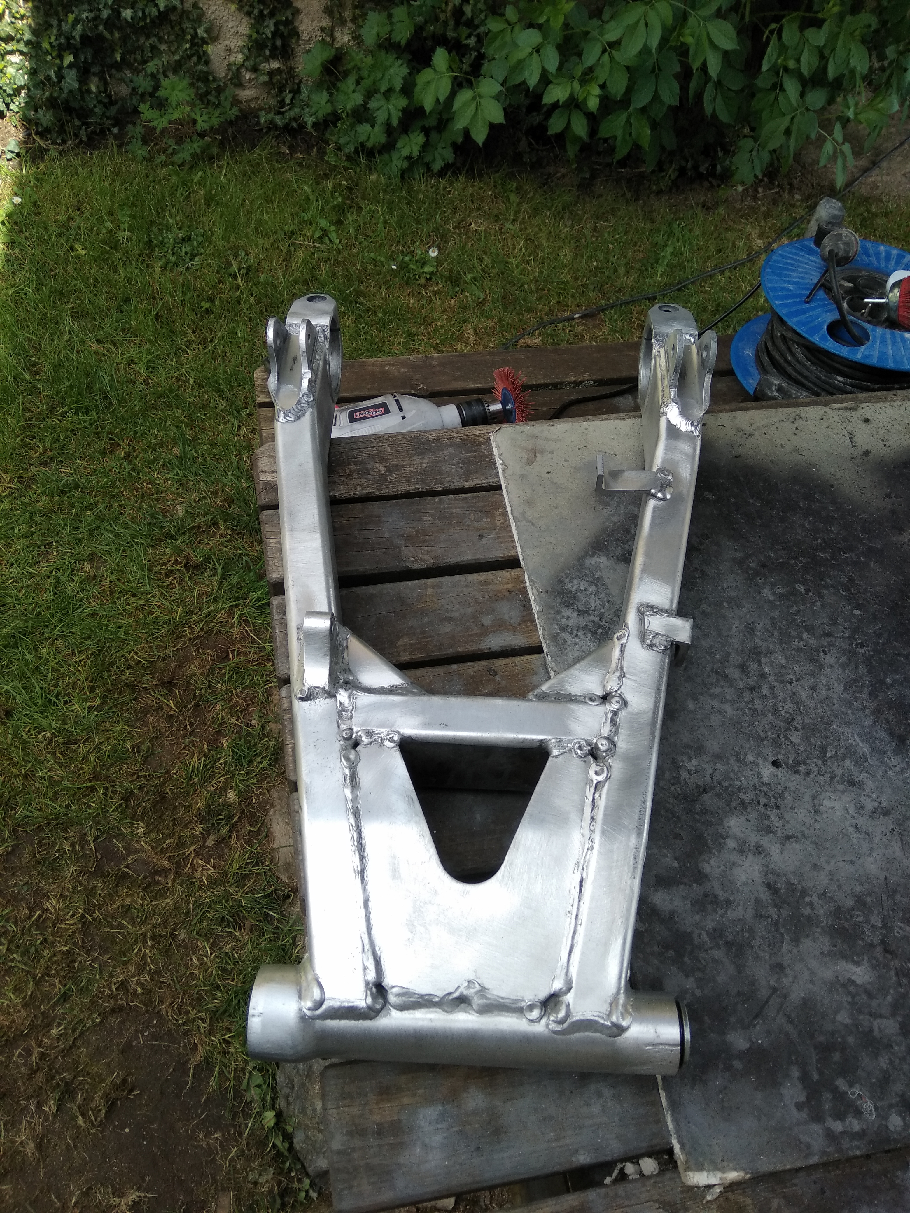

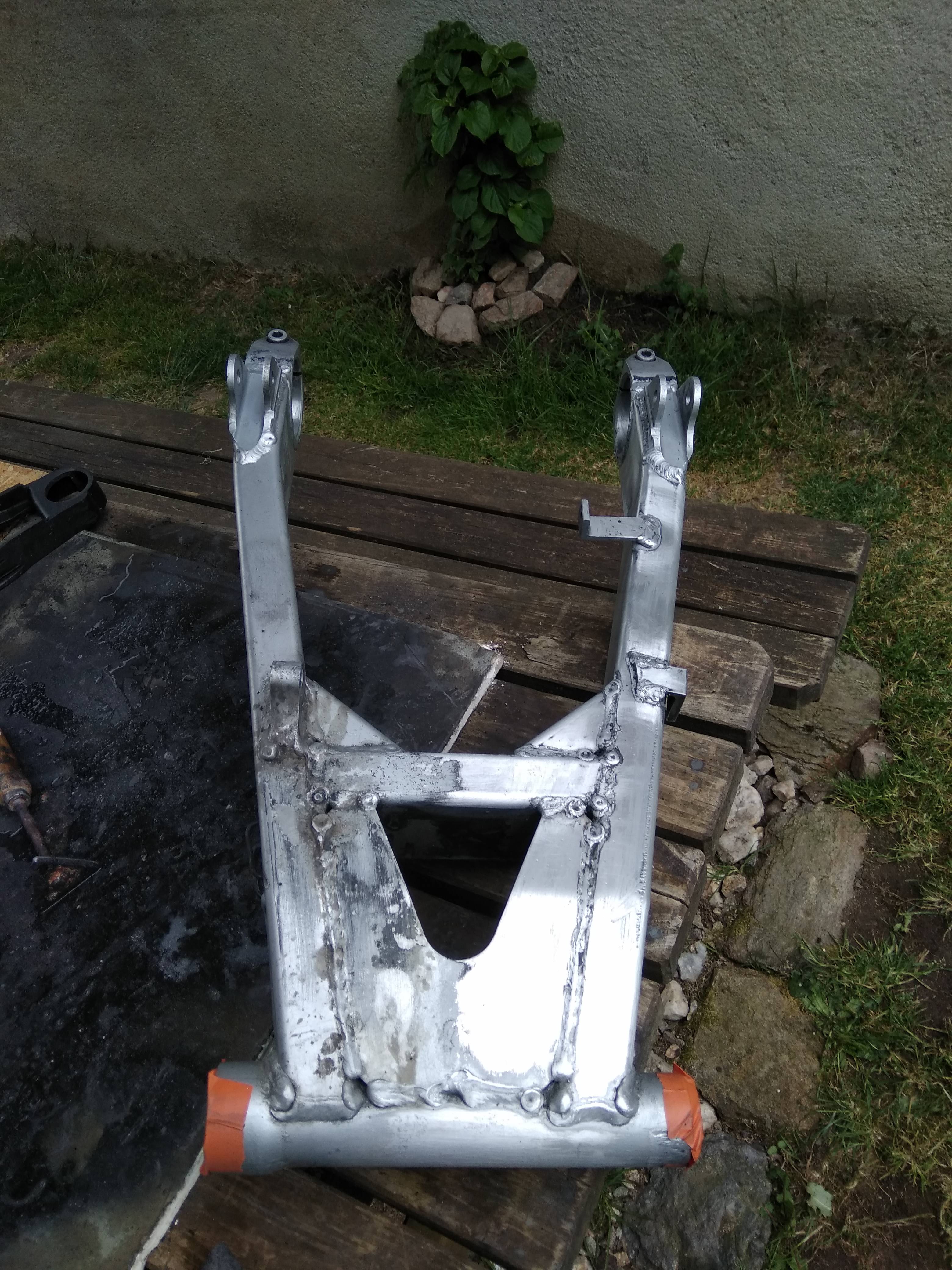

Swing Arm came off.
Lots of black marks, lots of scuffs from an un tensioned chain and some acid burns. Thinking the black marks must be tar or something I tried some thinners. No change. Can't have it like that so it got some 150 grit abuse.
It turns out that the black marks are the primer! Mr Kawasaki, in his wisdom, decided to primer an ally swing arm black then paint it silver so that every stone chip shows up??
Anyhow it's now back to this.
It doesn't lend itself to be polished like a deep brace Metmachex but this year it will be.

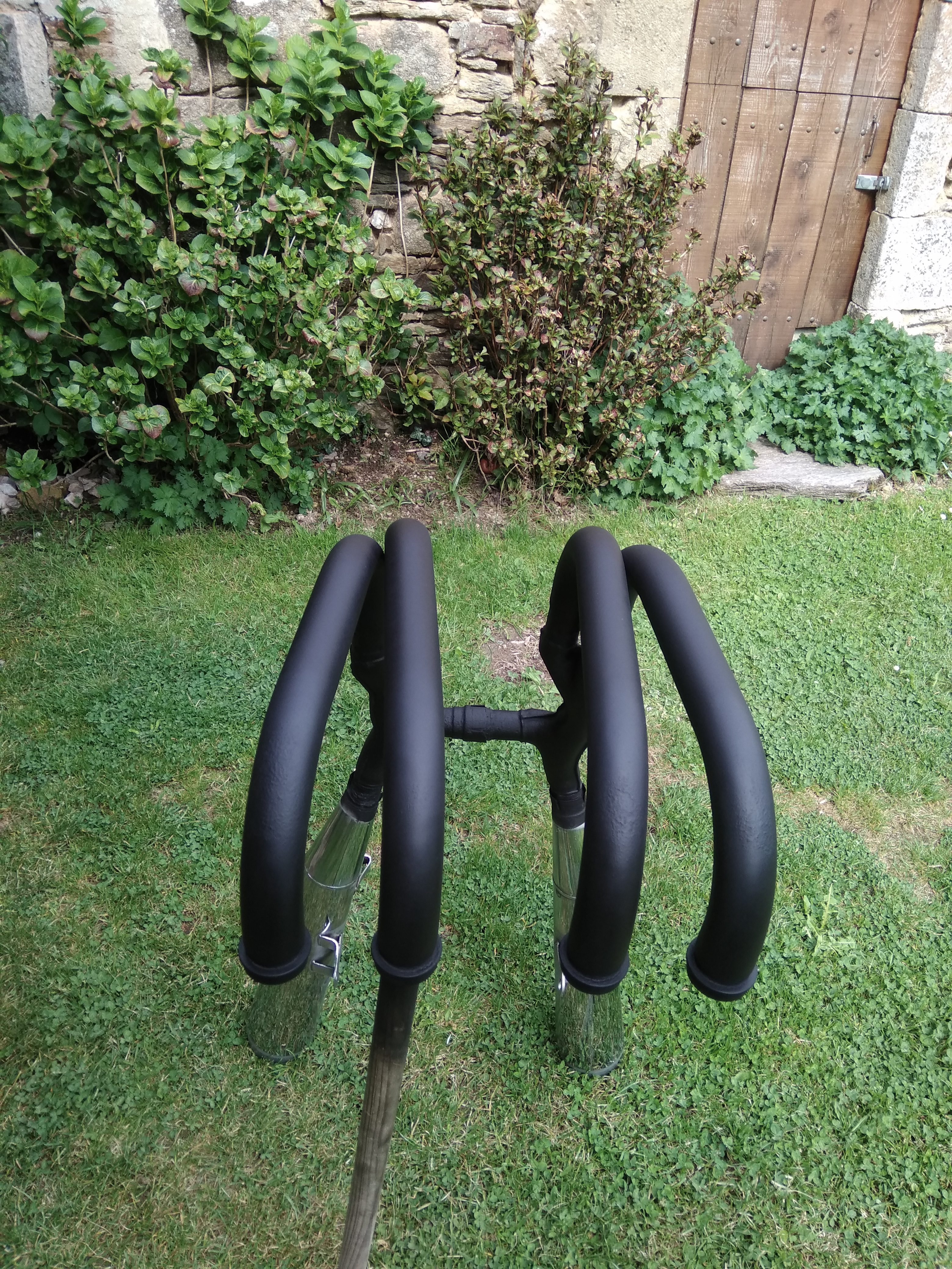

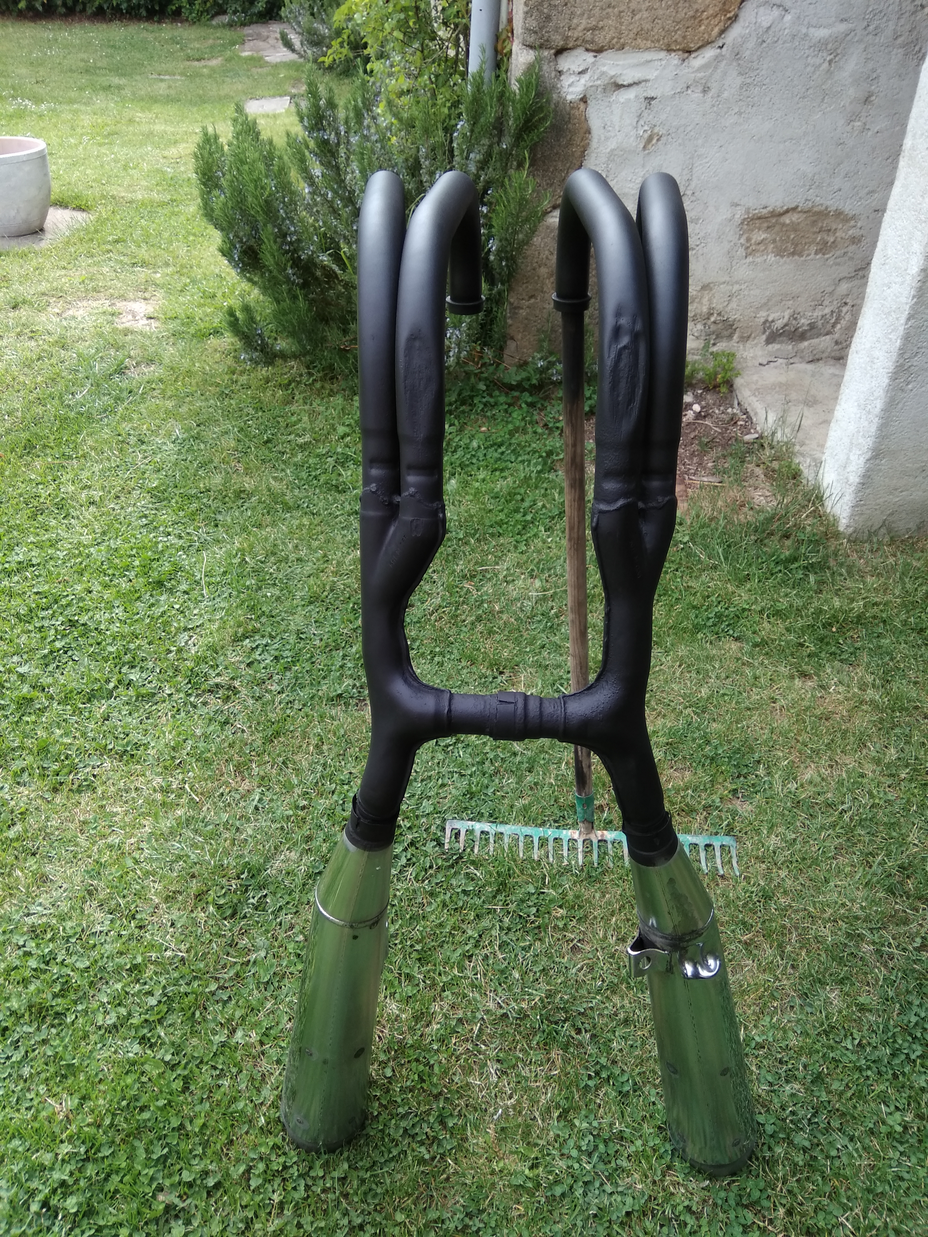

Matt blacked the downpipes with log burner paint. Much better than how they were.

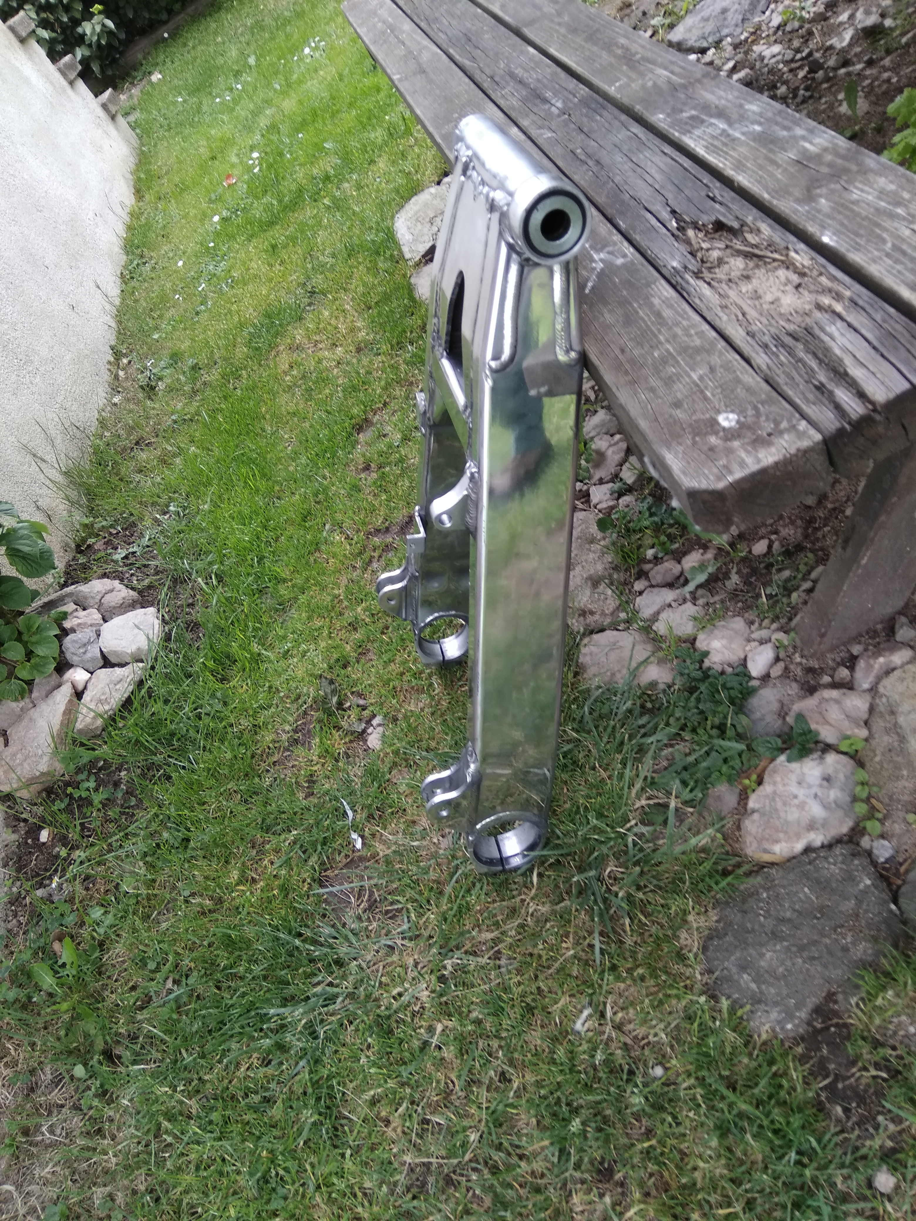

Also got the mops out on the swinging arm so that can now go back in after a Belgum Alu and get it back on it's feet.

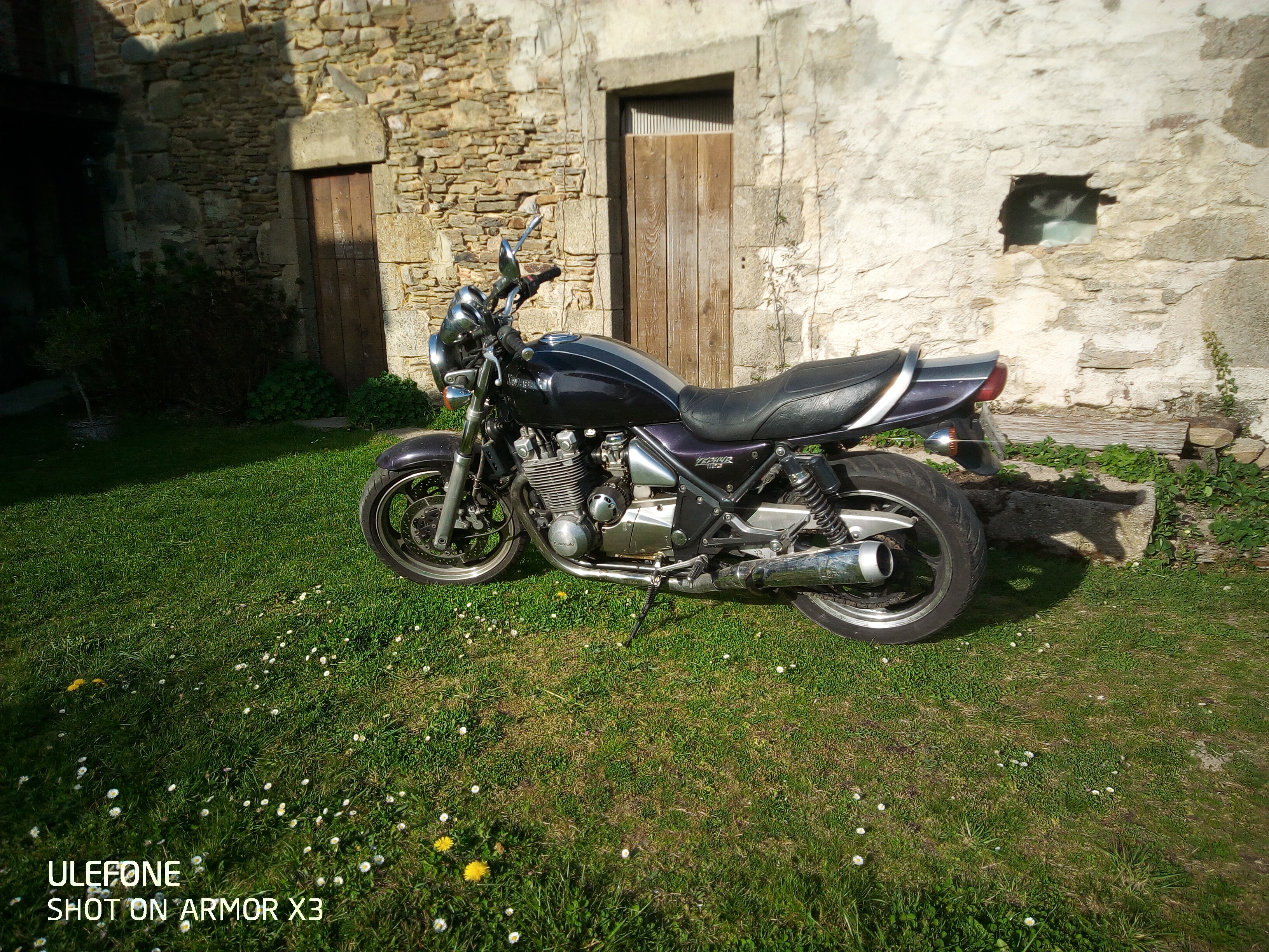

Back on it's feet
I think the matt black exhaust downpipes don't look too bad. Wished I'd fitted the chrome trims before the exhausts were fitted (which is a pain as they're not take apartable) the sidestand switch stops the left one from being retro fitted, so can stay of at the moment.
Fitted some new genuine carb to air box rubbers to suit the carb to head rubbers. I'd forgot how much swearing is involved!
Just waiting on an oil filter to arrive now.
It's needs the grubby finger marks cleaning from the reassemble and the front engine mounts need taking off and respraying but that can hang on. It's not pristine but a damn sight better than when I picked it up. The polishing isn't great 'cause I have 'lost' my unstitched mop and should have spent more time getting the scratches out...but
