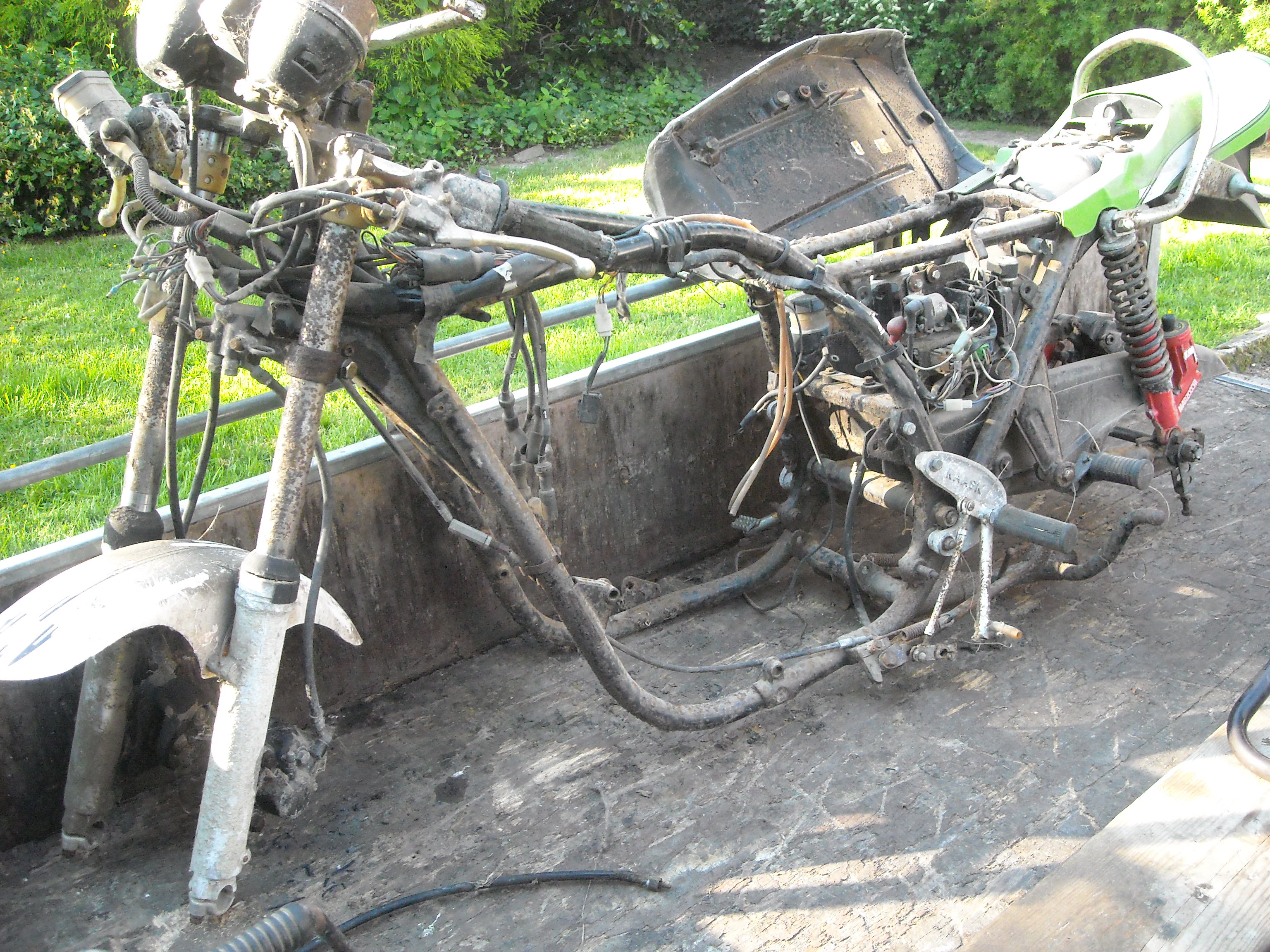

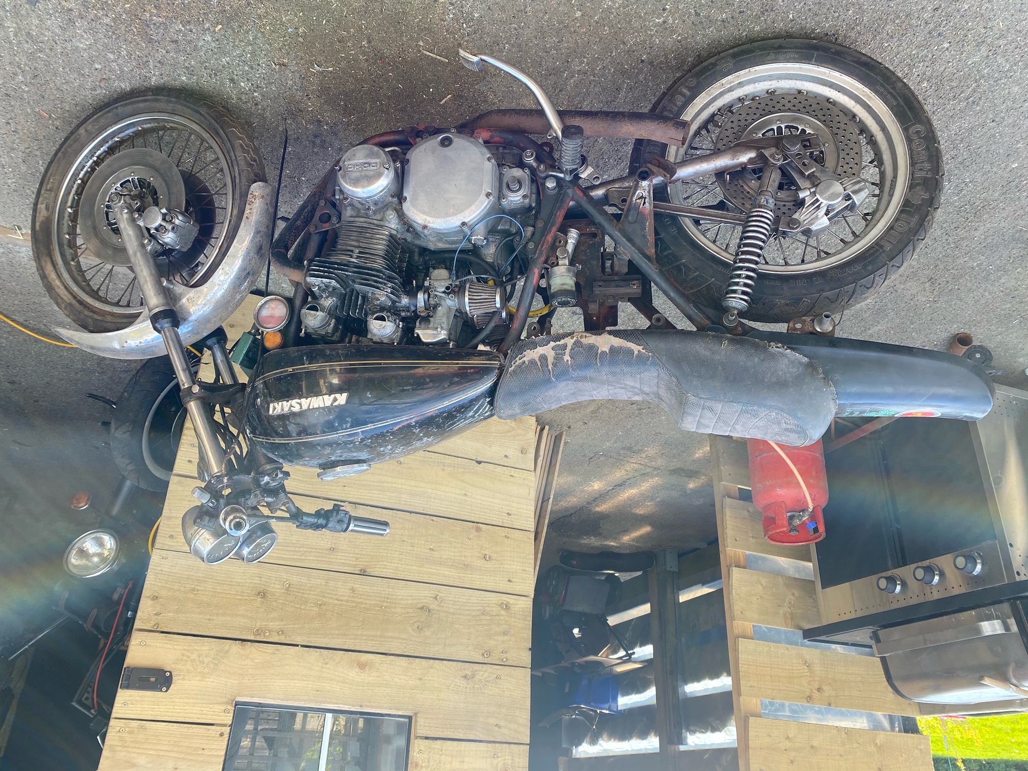

Just to freshen up your mind a few pictures of the bike...or what's supposed to become a bike

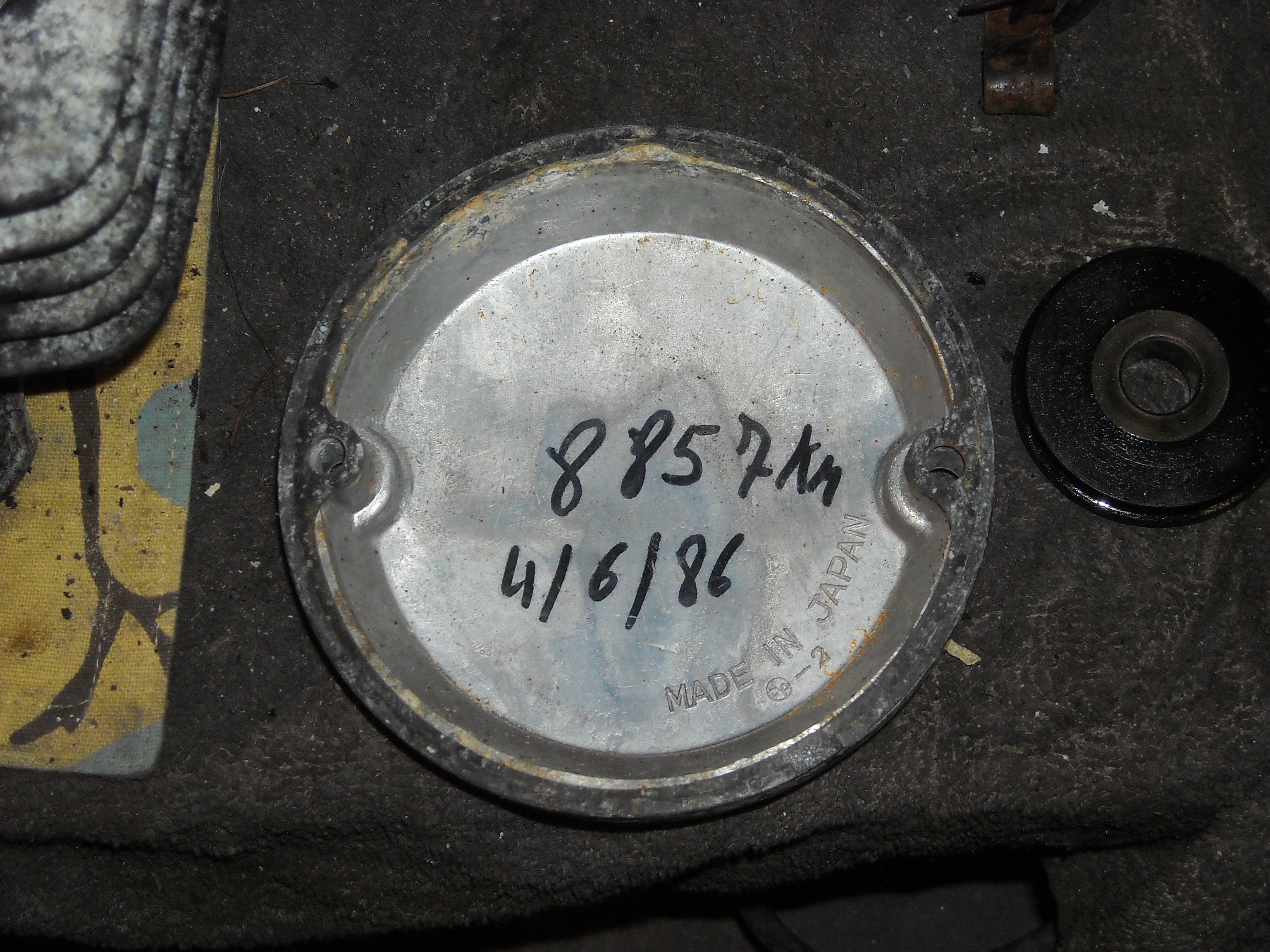

As you can see she only ran for about 9700 Km...a bit before that she was transformed into a "racer" but as far as I know, only on the outside.
Then she stood under a shelter for a bit more than 30 years, collecting dust and rust.
The engine was taken out and that stood in a garage .
The engine was painted black and never got back into the frame after the "artwork".

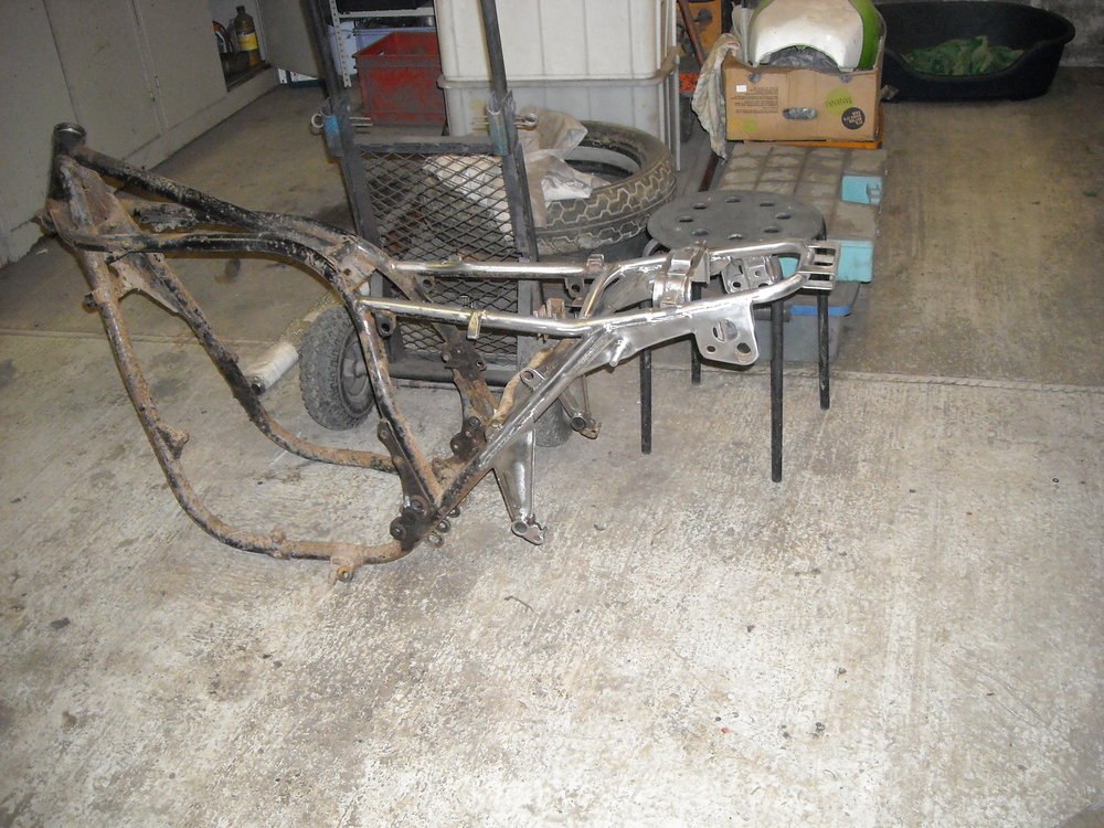

So today I removed the last rubbers from the frame, the original steering head ball bearing shell and the footpeg bolts and started to clean up the frame.
I started removing the old paint and rust from the rear side, that's where most of the work has to be done, a lot of small parts, a lot of welding seams and a lot of RUST ! But, nothing we can't handle.

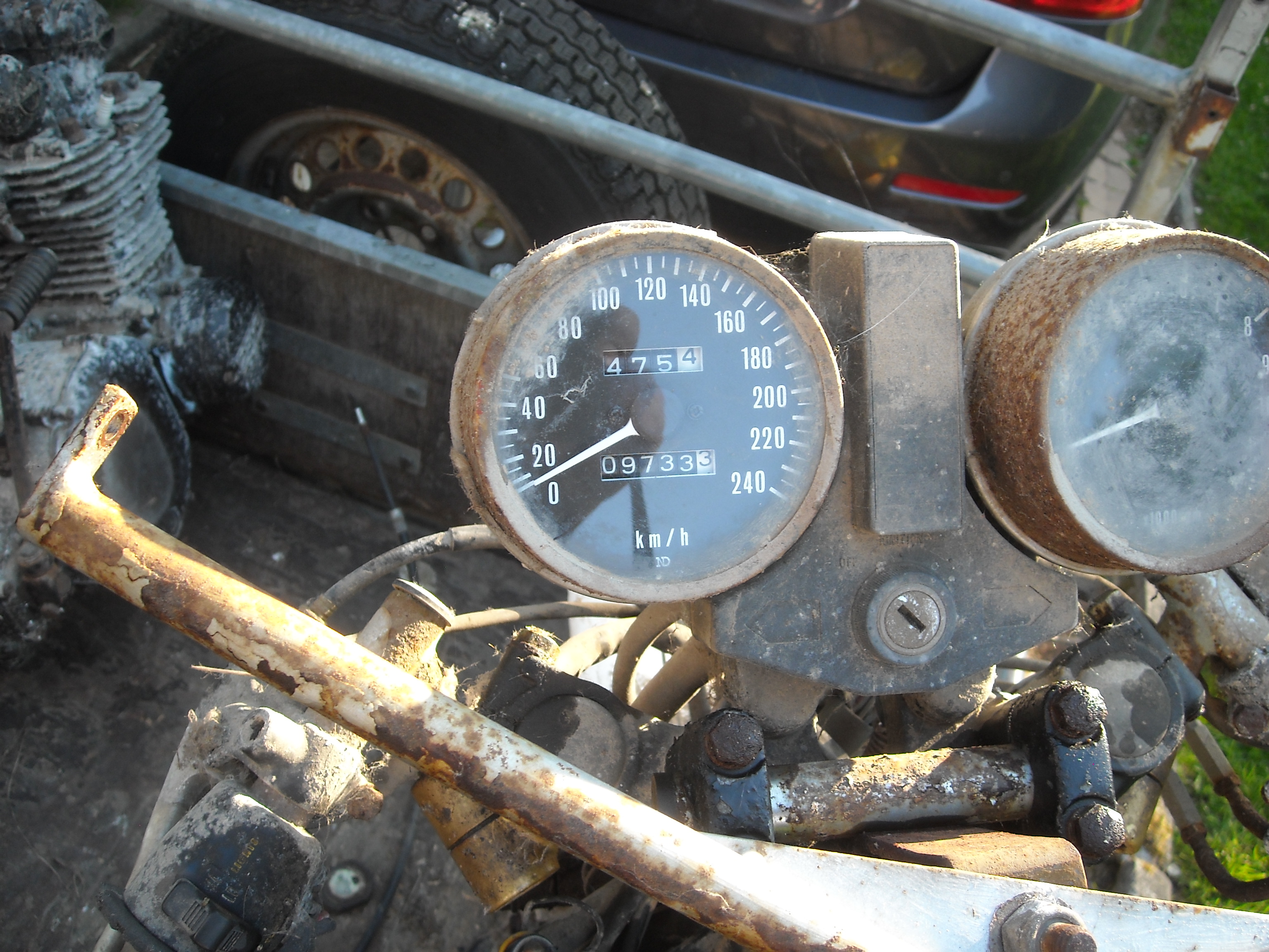

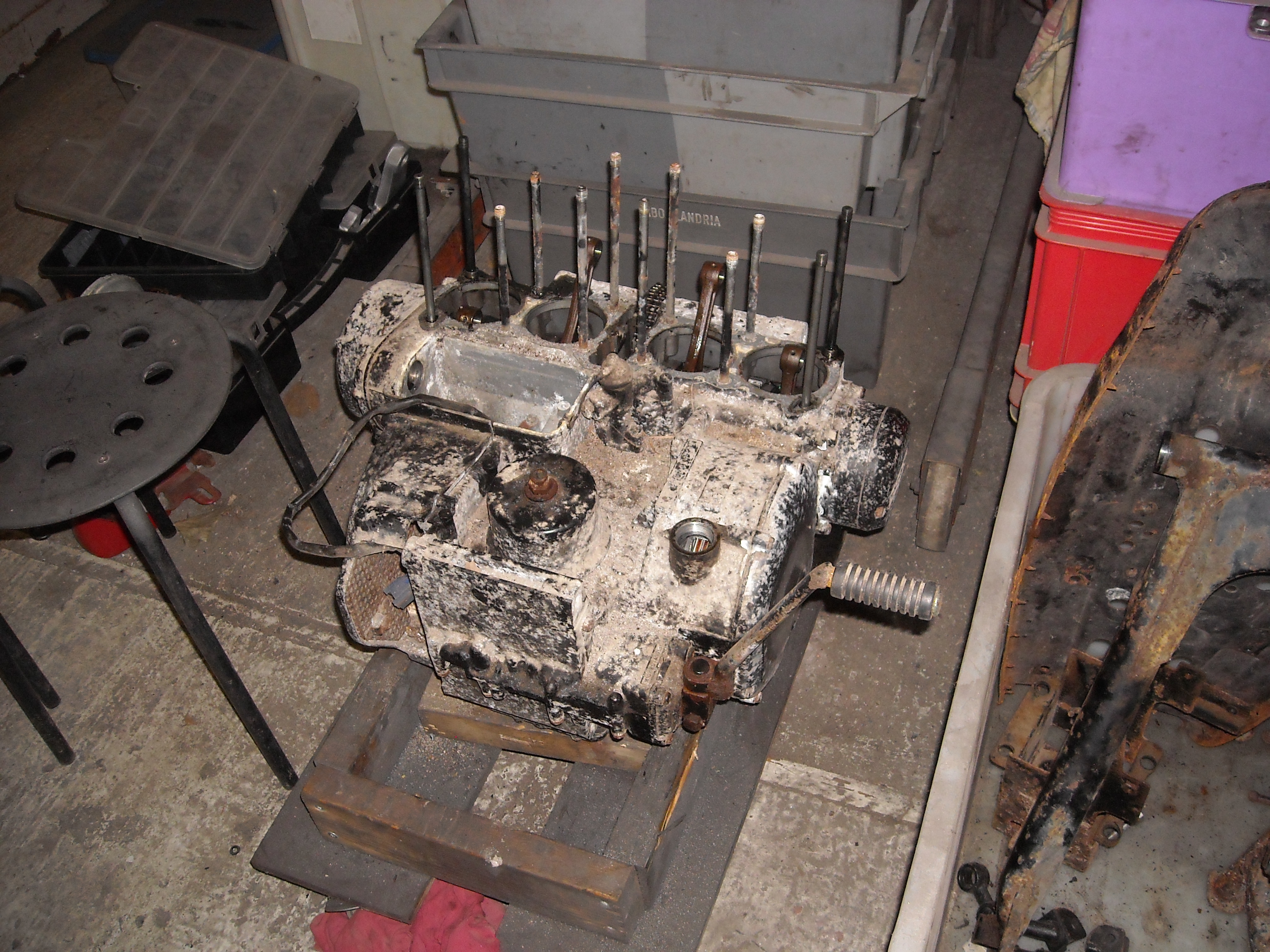

It's not seized, I can turn it around with the kick starter and it moves smooth.
We'll see what time did with the barrels and with the pistons.

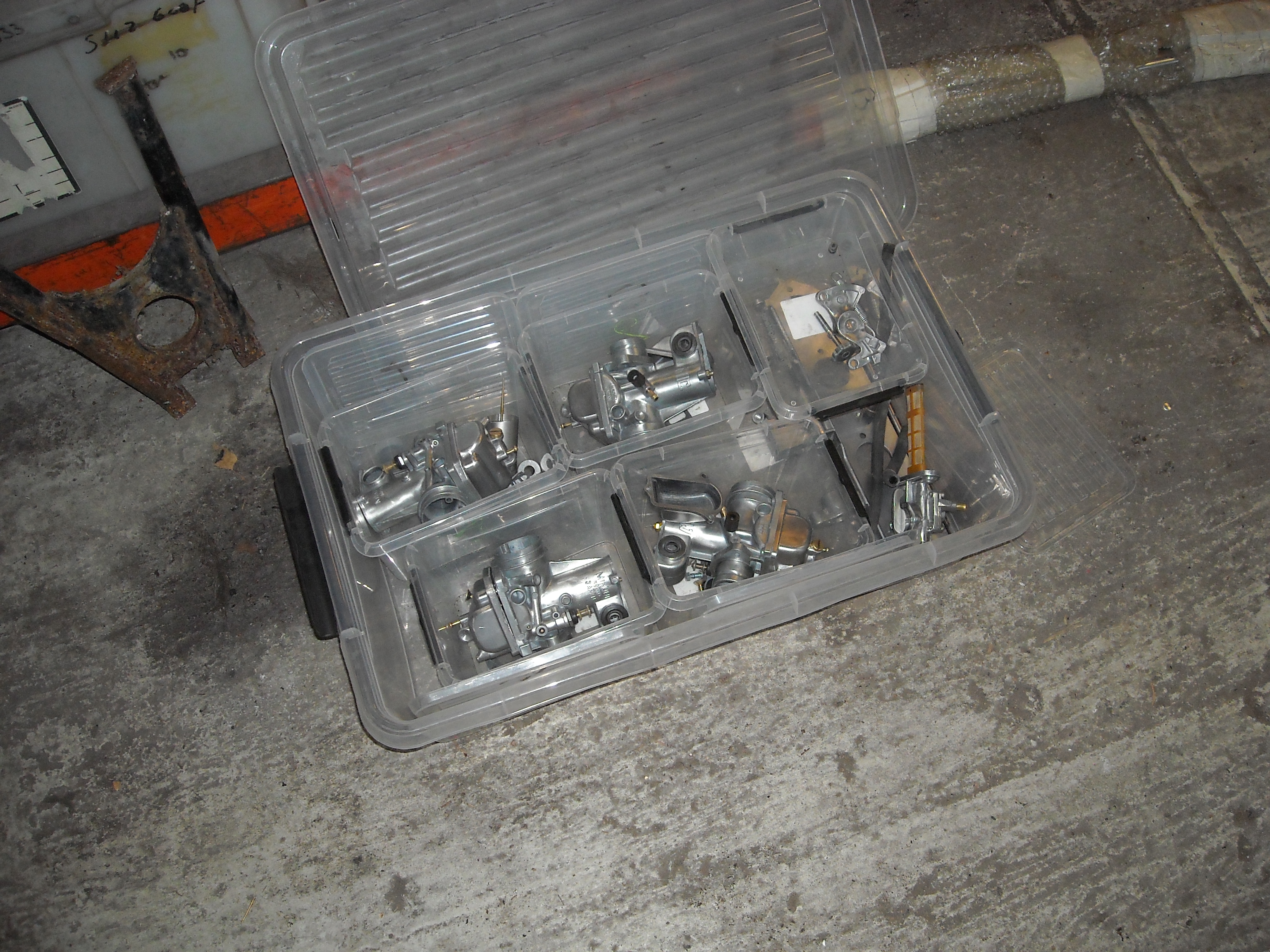

Today I took some pictures of the work I did yesterday and during the past months.
To start with:

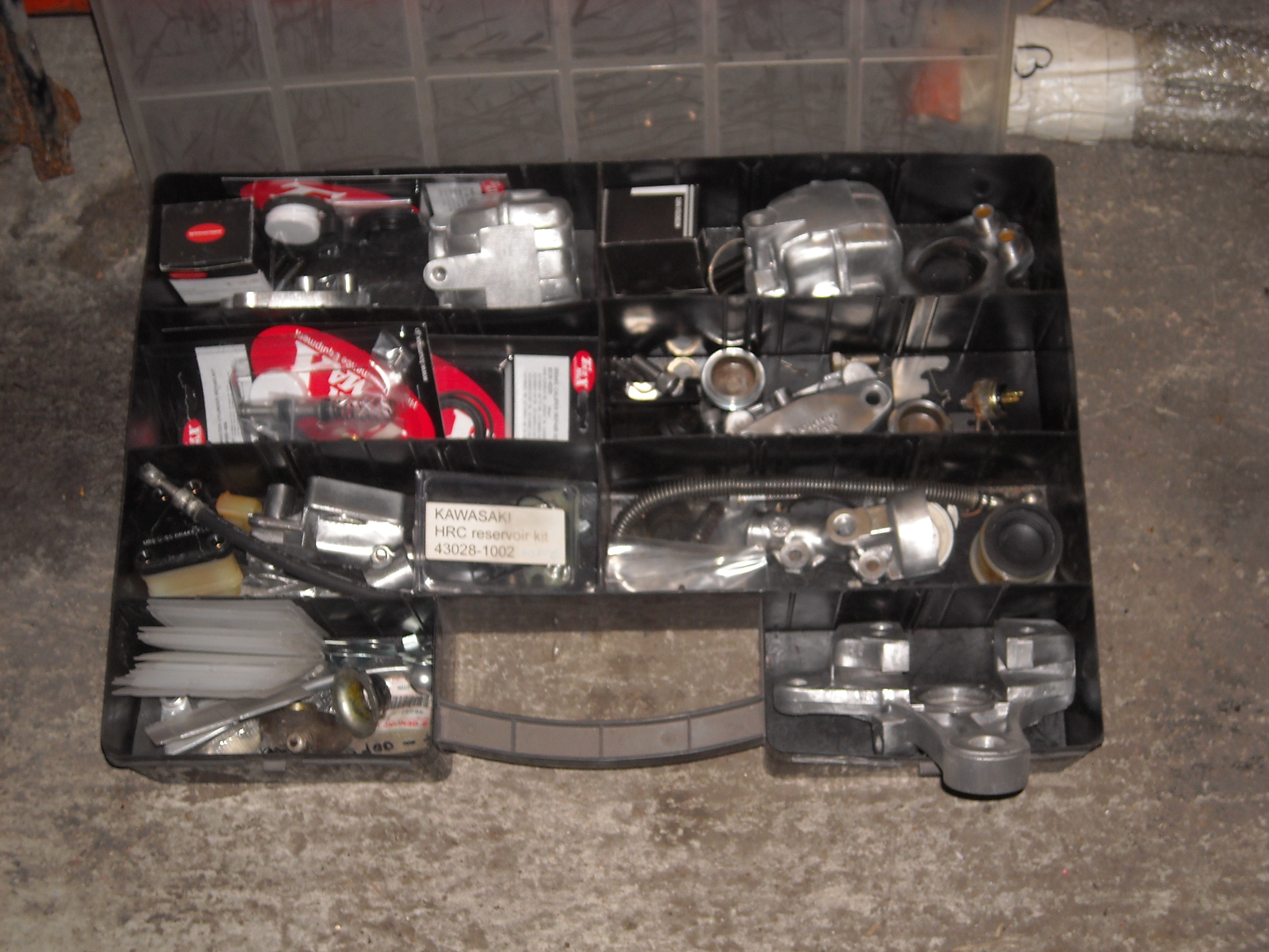

* the carbs: they're taken apart, ultrasonically cleaned, polished and they received new Keyster parts.
Once the parts that needed new plating are finished, I'll assemble them.
* the brake parts: those were also taken apart, cleaned and the old paint was stripped off using formic acid.
They're waiting to be repainted and then they'll receive new rubbers and all the other stuff that's needed to perform properly.
To start with:

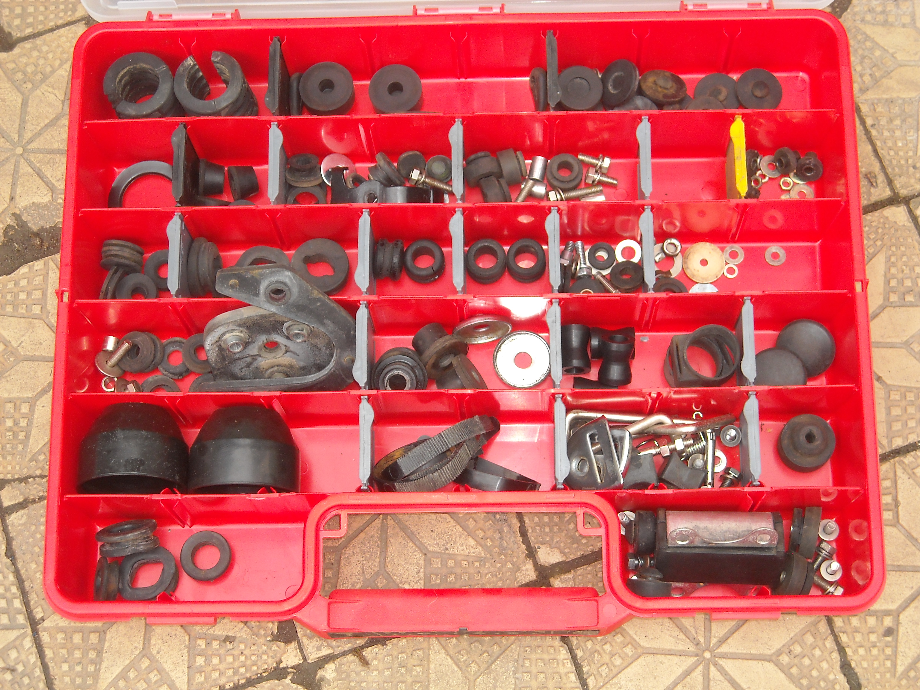

I promised to show you a picture of the rubber parts of the Z1000.
Here they are, not all of them but most of them:
They're outside but they're safe!

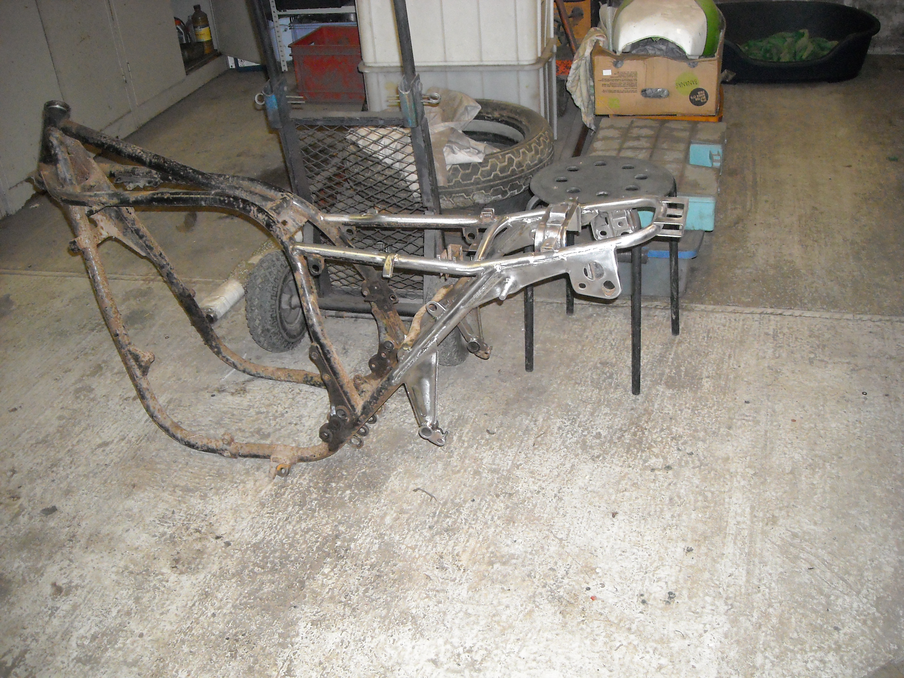

Gentlemen
after six and a half hour of grinding today this is the result:
an almost completely cleaned frame, only the inside of the headstock must be cleaned and afterwards I'll have to do something against the rust which has pitted the frame and remains in the metal. I think I'm going to use sandblasting but I'm not sure about it. Time will tell.

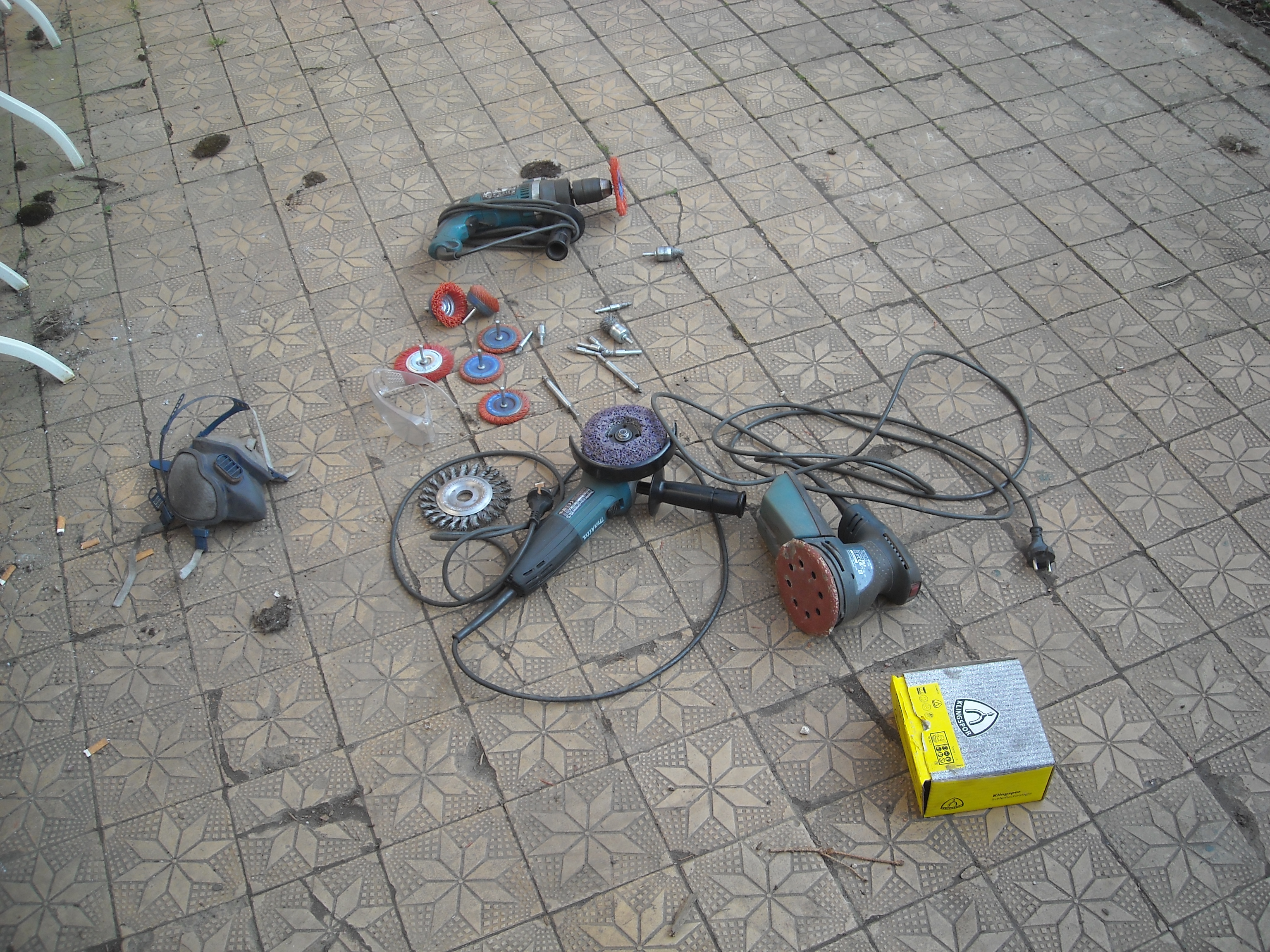

These are my "weapons of choice" to deal with the old paint and rust.
As you can see I use a lot of little metal brushes to reach those hard and very hard to reach places on a frame.
The drill is a few years old and I've replaced several times the carbon brushes of the electrical motor.
As long as she works, I keep her.
The circular sander is also a few years old and didn't let me down so far.
The angular grinder is used to remove the first coat of rust and paint.
Protection of the lungs and eyes is also important. That's why I use an old paint mask and goggles for protection.
So, perhaps next week I can finish the frame and paint it. Again, it will all depend upon the weather conditions.

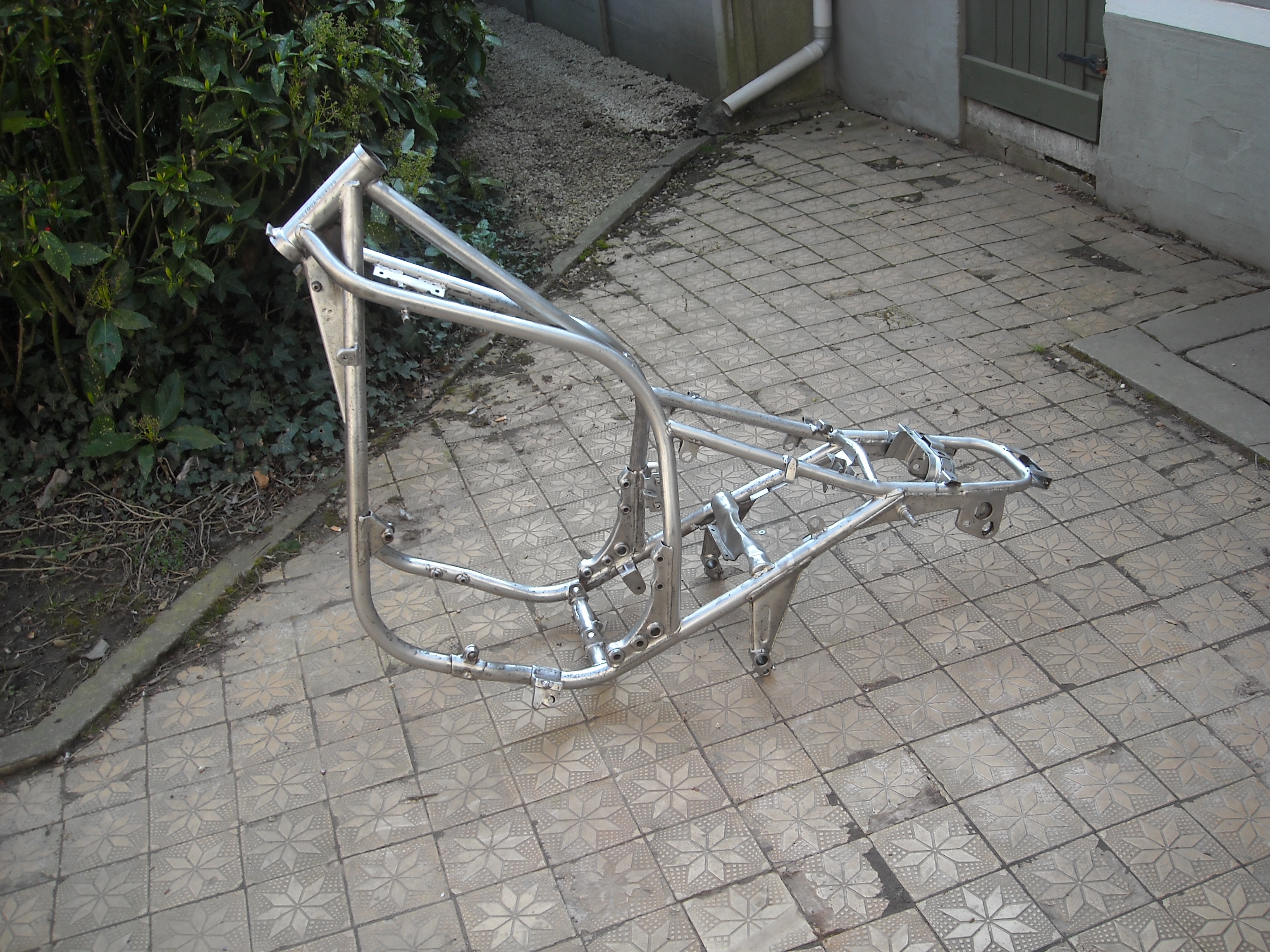

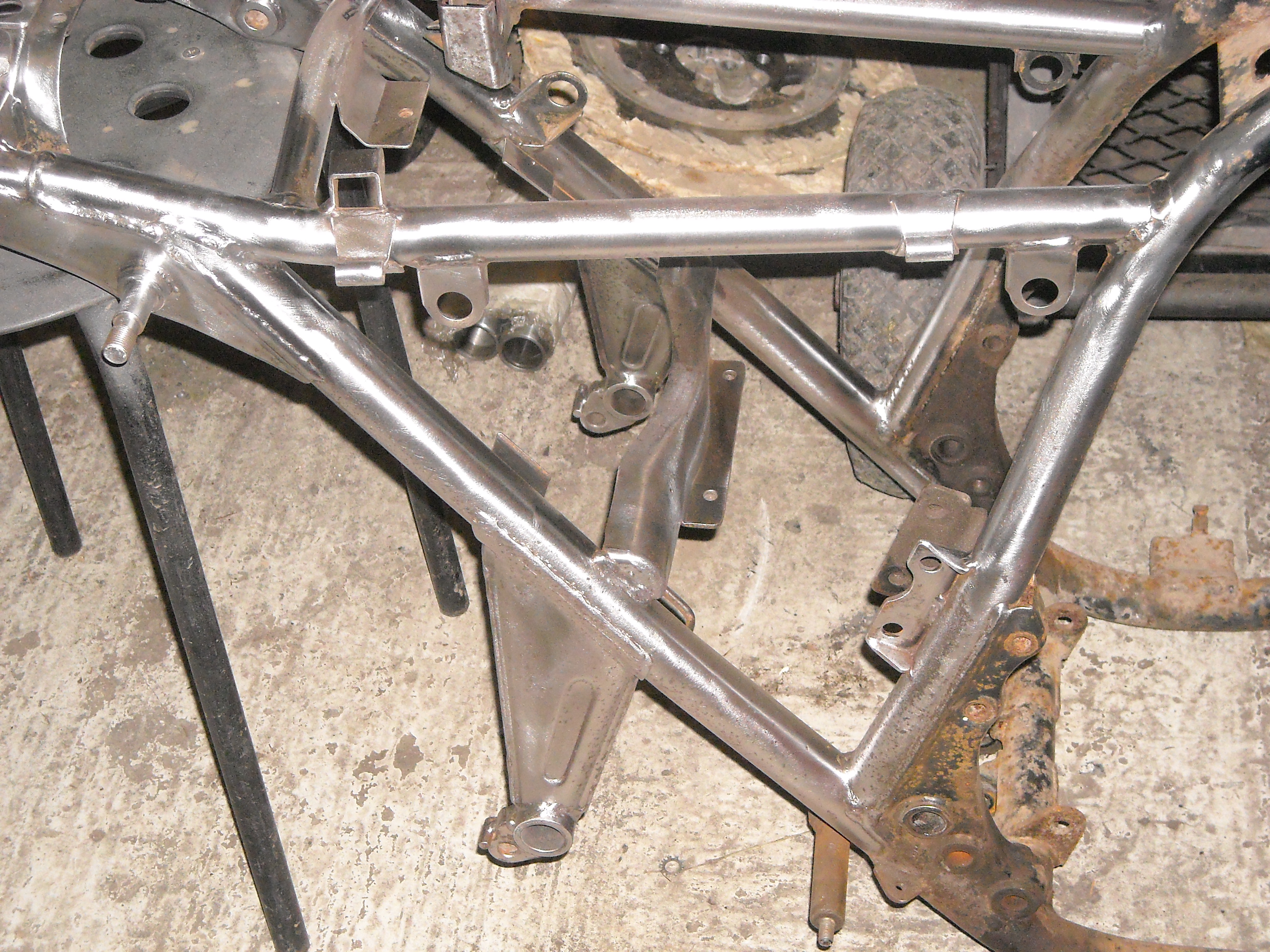

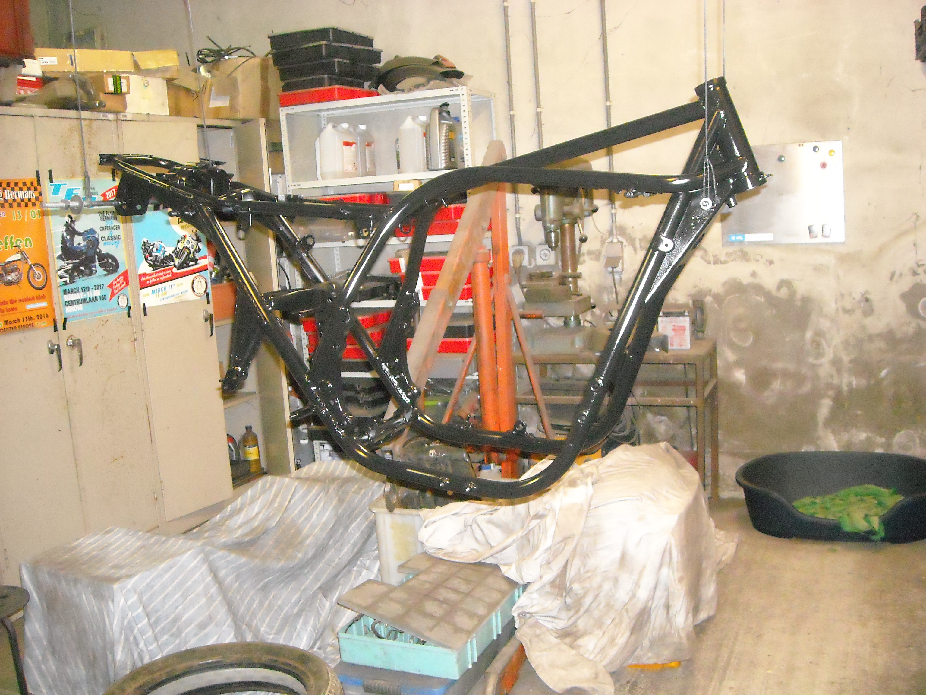

Hi men
this morning I spent another 2 hours on grinding and sandblasting the inside of the headstock, where all the frame tubes are joined, in order to get it clean.
In the end it worked out well and this afternoon the frame was degreased and hung on a few ropes.
It took me about 1,5 hour to paint it and I must say that I'm pleased with the results.
I couldn't hide the rustpitting in the frame tubes but it's far better than I expected.
See for yourself.
There's still a long way to go before the bike is finished but it's a start.
Tomorrow I'll start cleaning other frame parts and as soon as those are ready the painting will continue.

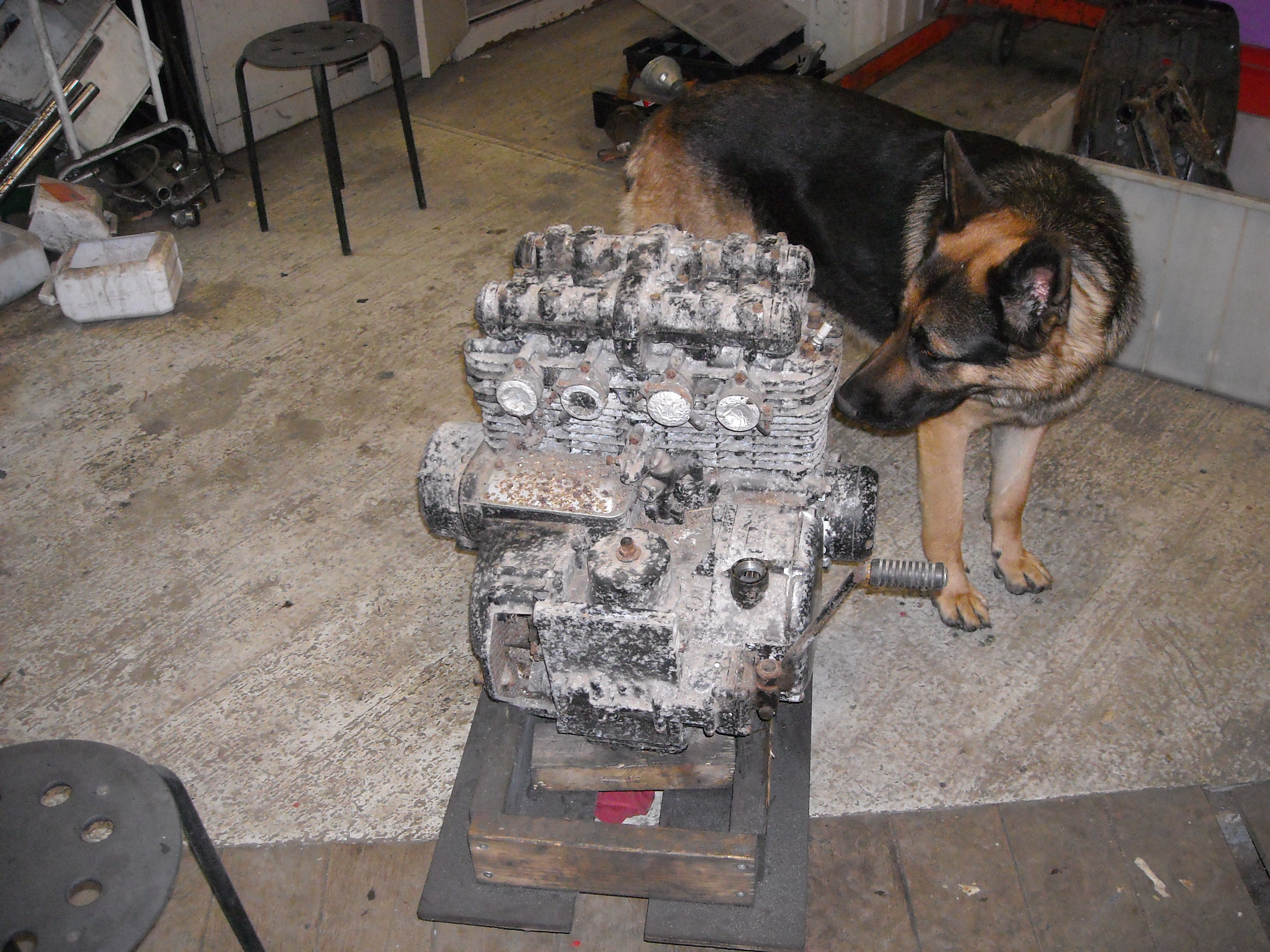

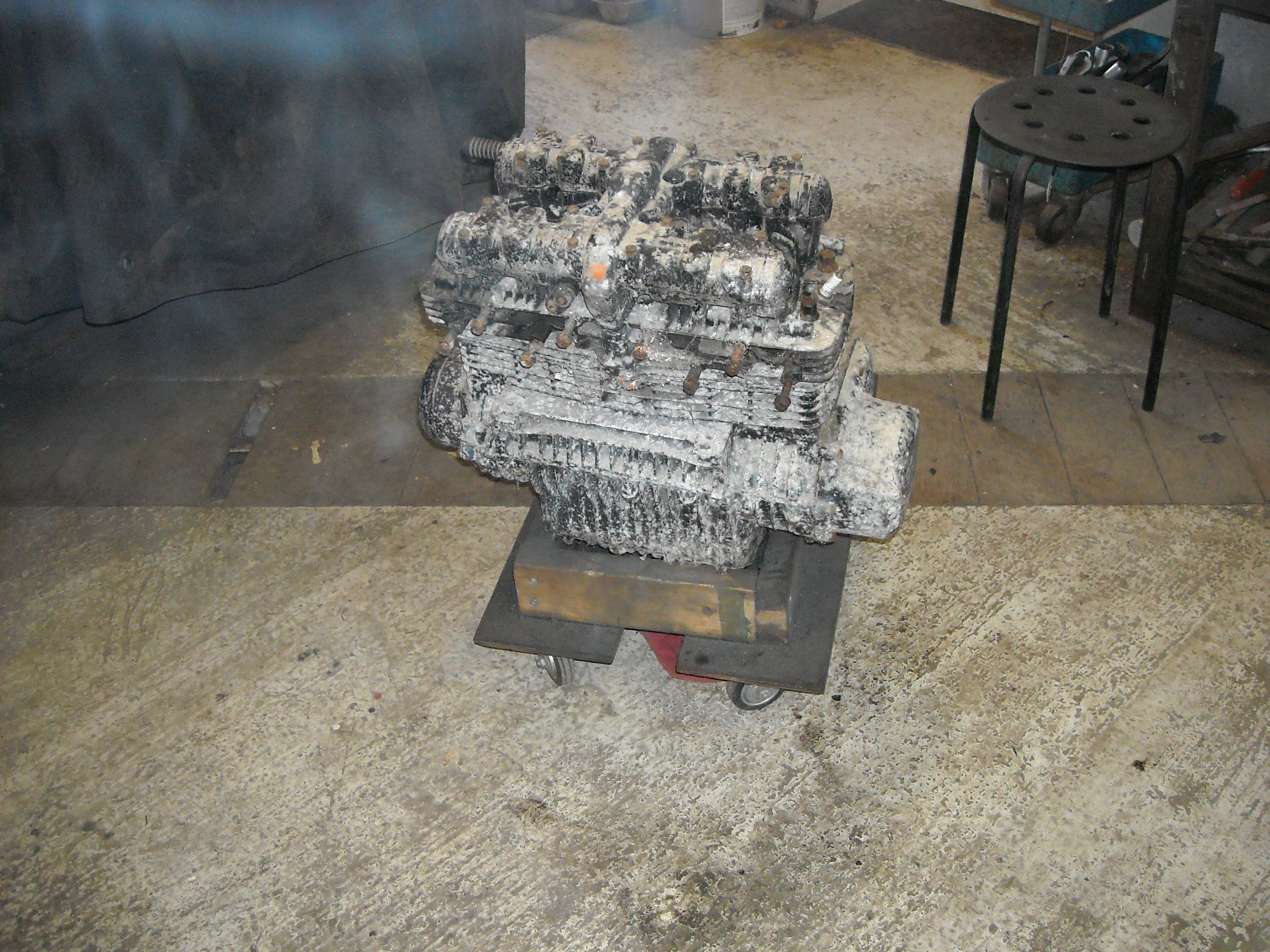

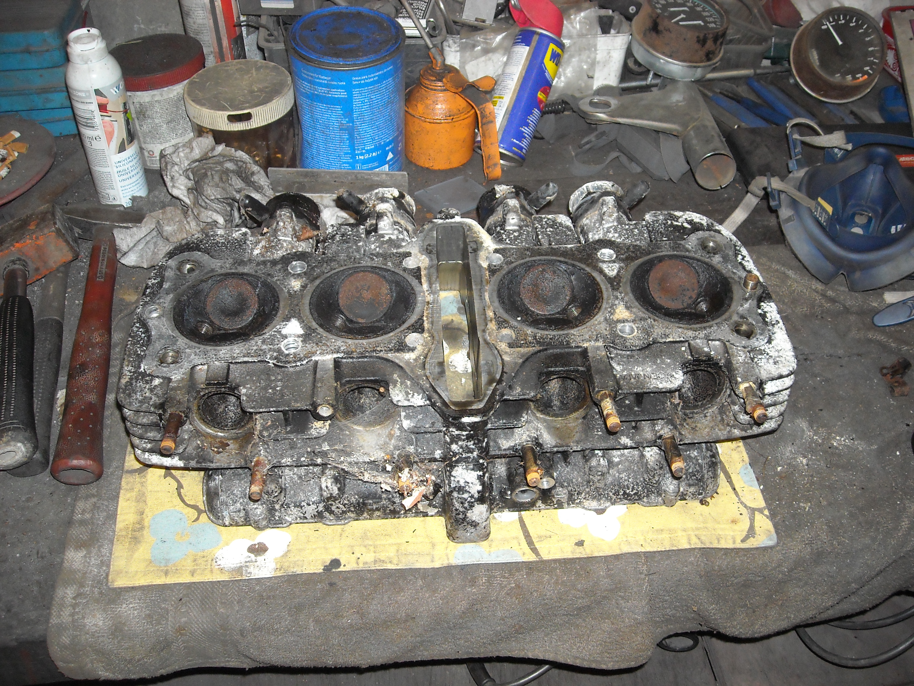

Hello men

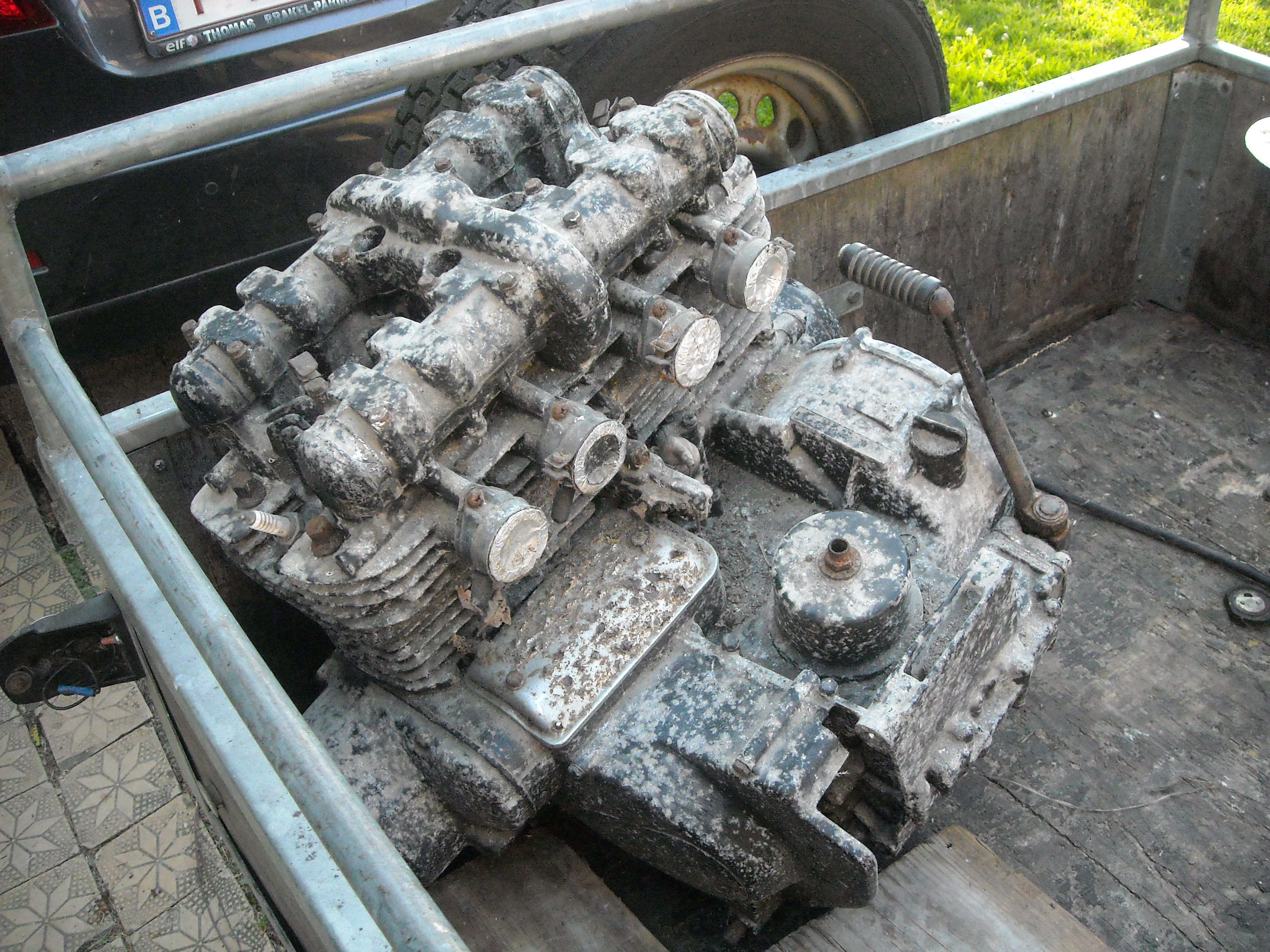

yesterday afternoon I took the engine into the workshop... what a heavy lump of metal when it's complete.
just a few pictures to show you what it looks, it's like it's been used as a U-boat, oxidation all over the place.
The disassembly started and the cylinder head and the barrels were taken off.
As you can see a lot of burned oil and dirt.
The barrels show small traces of rust and I hope I can remove them by honing the barrels.

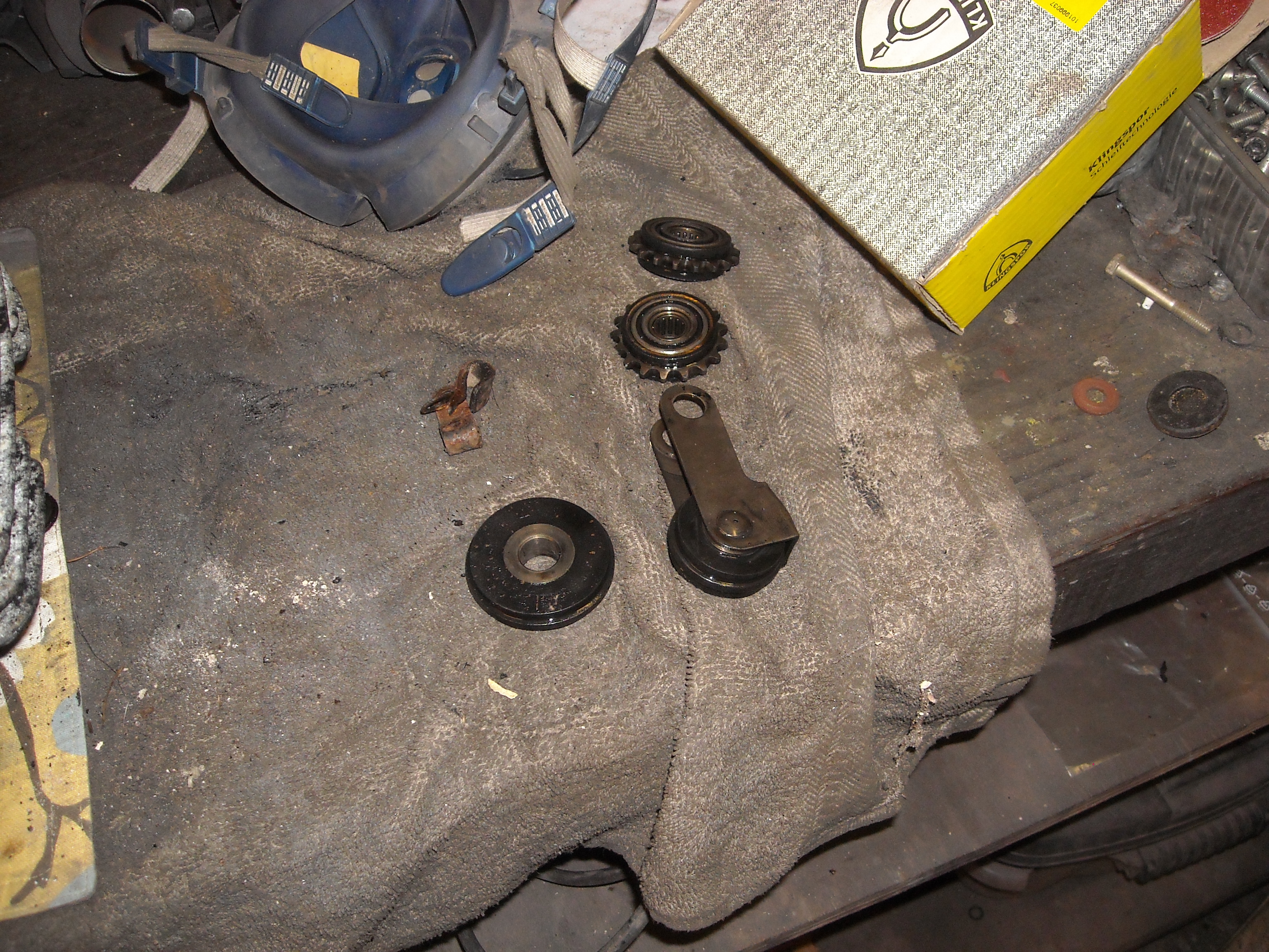

After a few hours this was the result:
The camchain sprockets show no sign of wear but i'm going to replace them anyway, they're 45 years old.
the other rubber parts looked also very decent but here it's the same: they have 45 years of age and will be replaced by new parts.
This morning the dismantling continued.
On the inside of the points cover there was a pleasant surprise:
The last time the points were inspected was 1986 !!!
More to come this afternoon!
