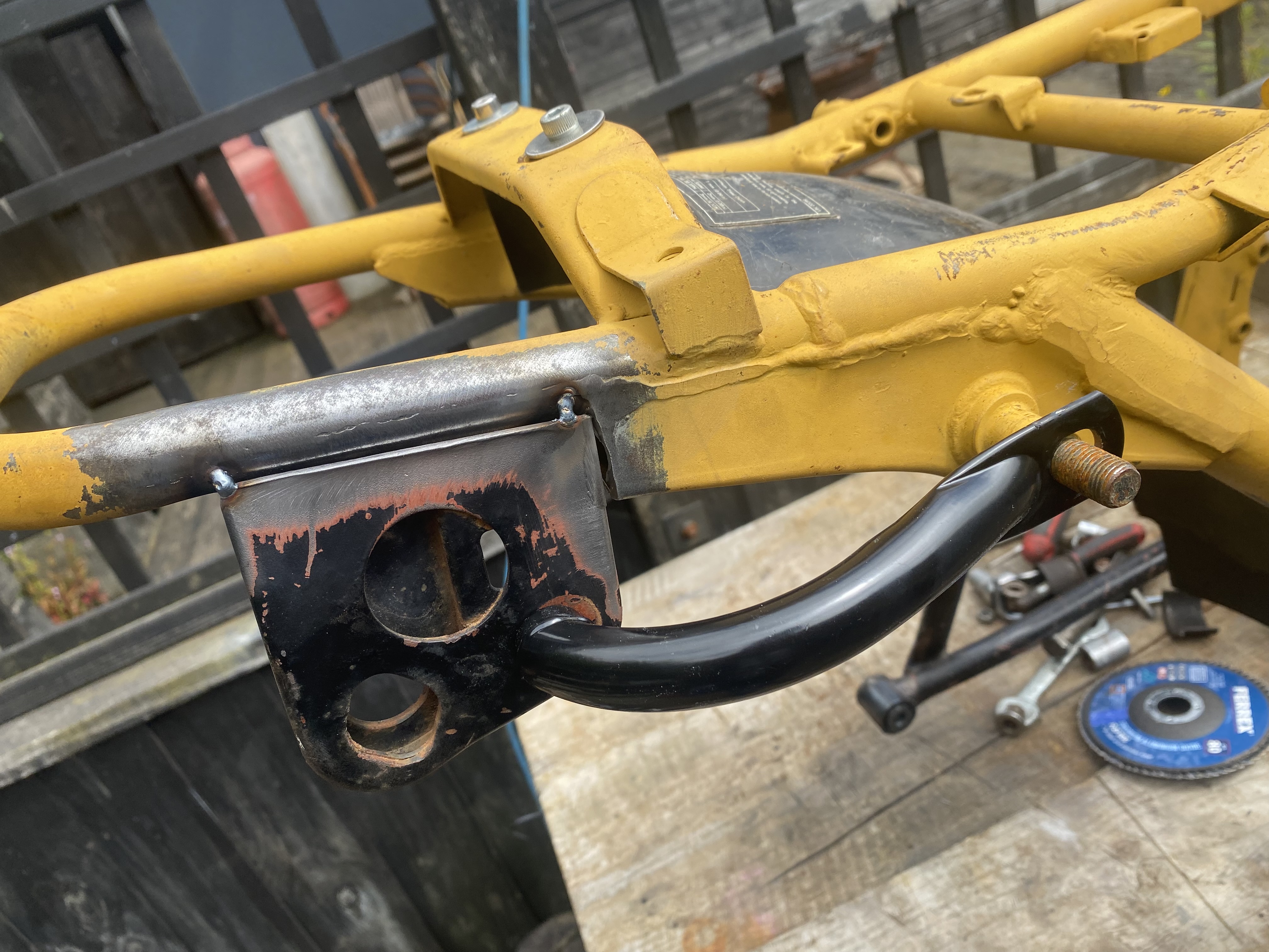

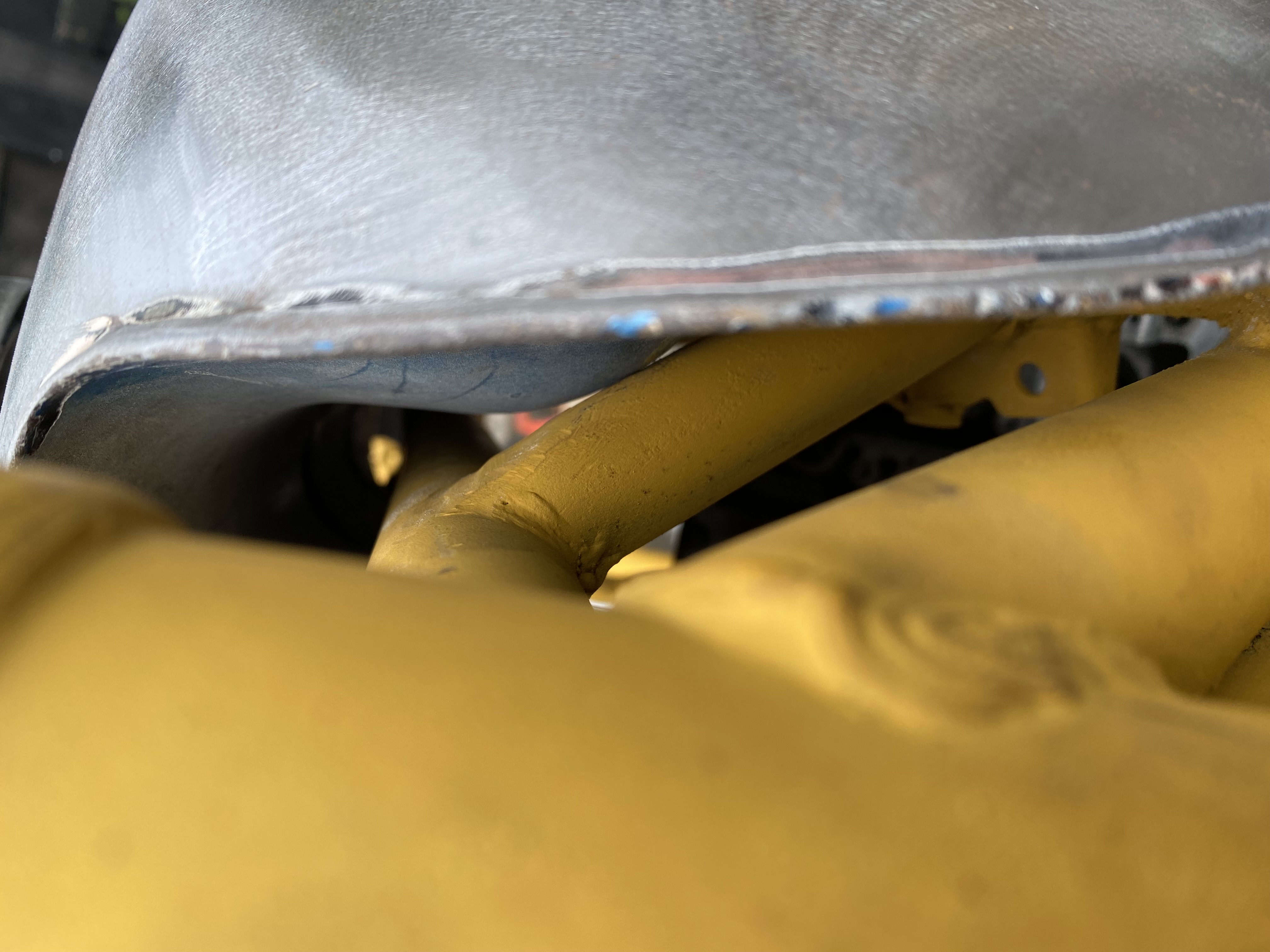

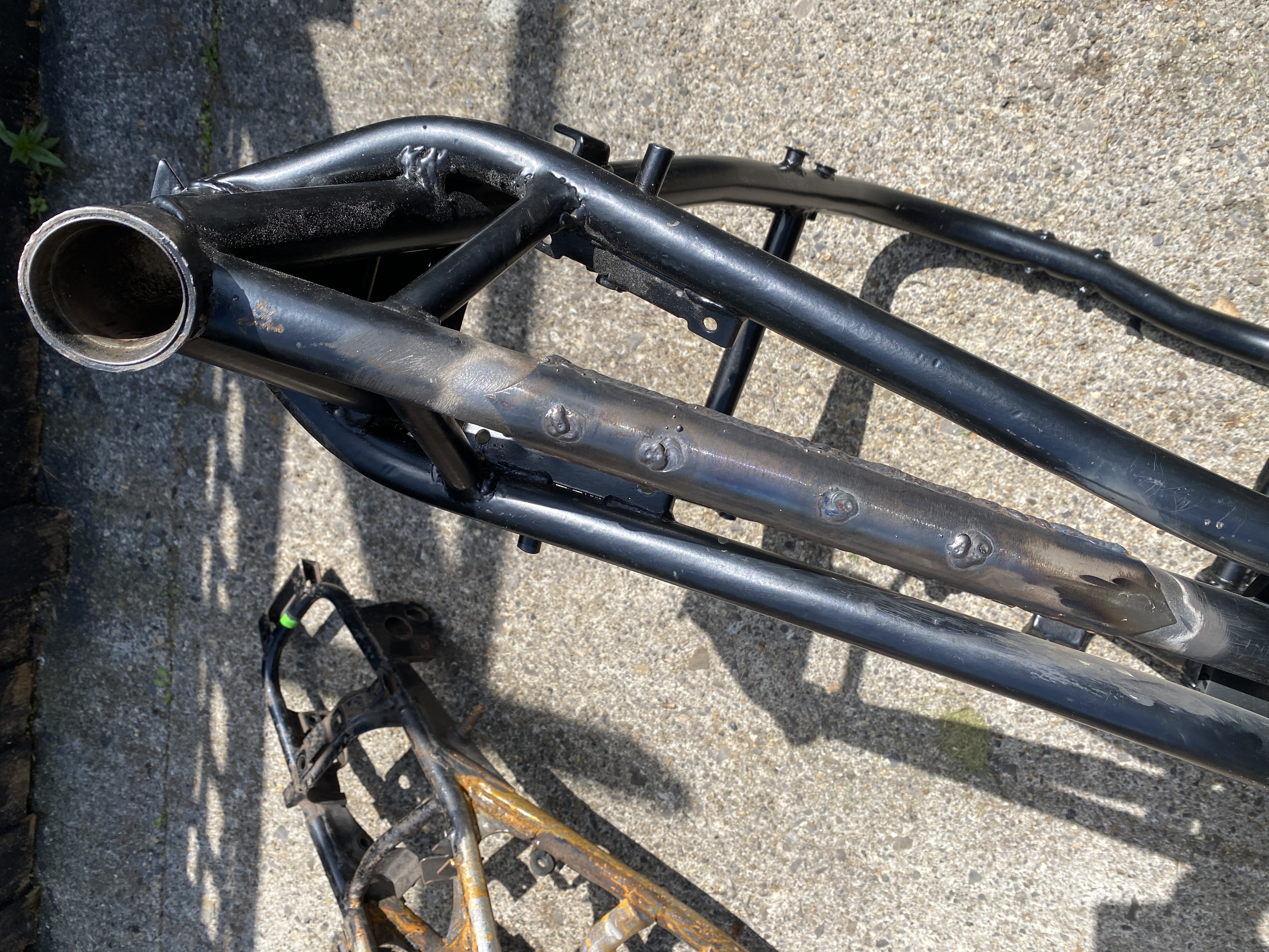

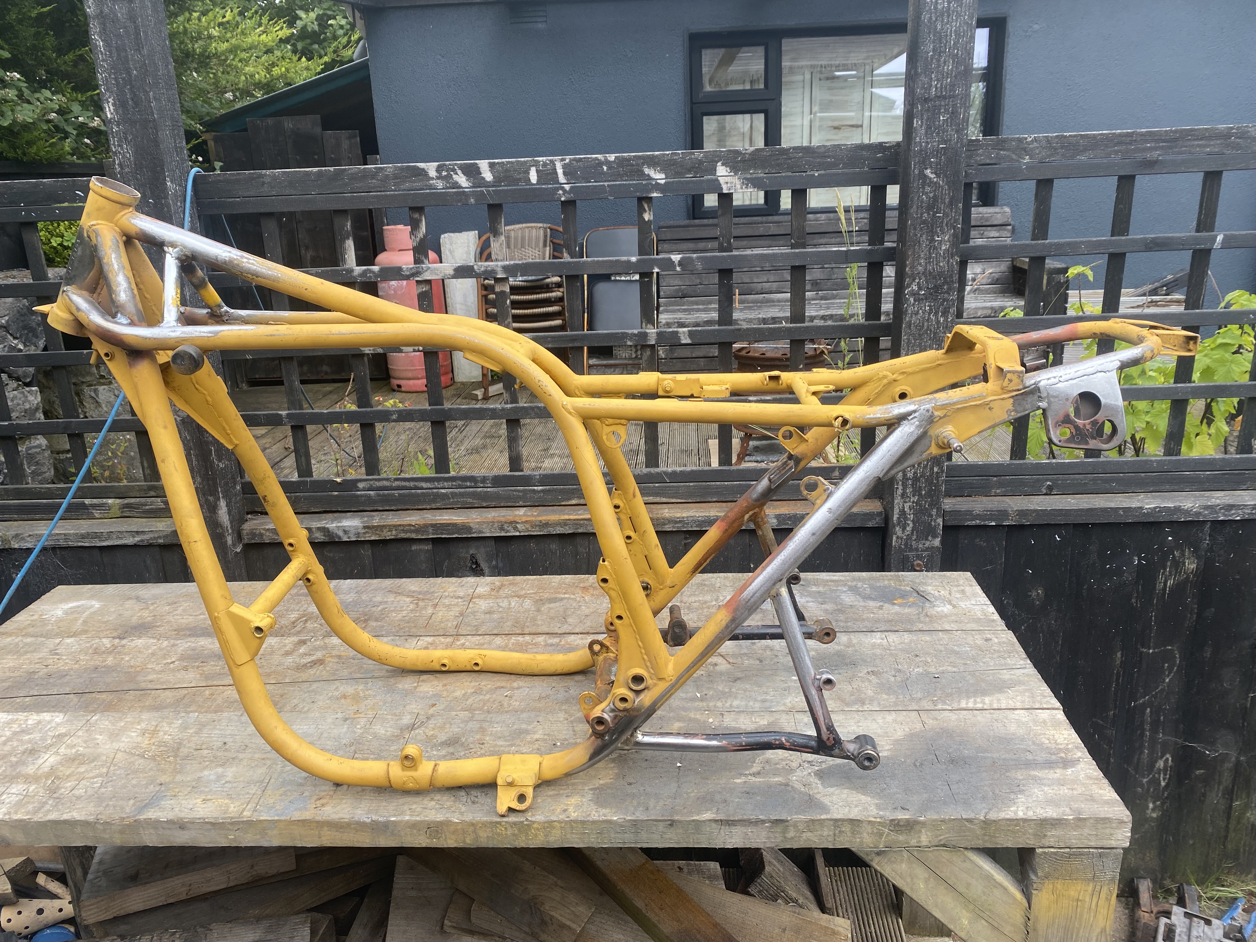

Redemption is the key word for my three Z1b projects. They have had a colourful past life and im trying to bring them back from the edge, they will never be 100% stock and OEM but one will get fairly close, probably closer than the second. Bike two will be a stock build to a point.. the frame is an Ebay purchase "slightly molested" as is the engine case and the rest well from various places. Bike three will be a close to stock but will veer off to a theme.... and the theme is "early Yoshimura race bike" in the Japanese style of building. But.. back to bike two, its been a bit of work to return the frame to stock from what you see below.
Frame was braced but in a way that the tank wouldn't fit on any more, so that all had to be redone.

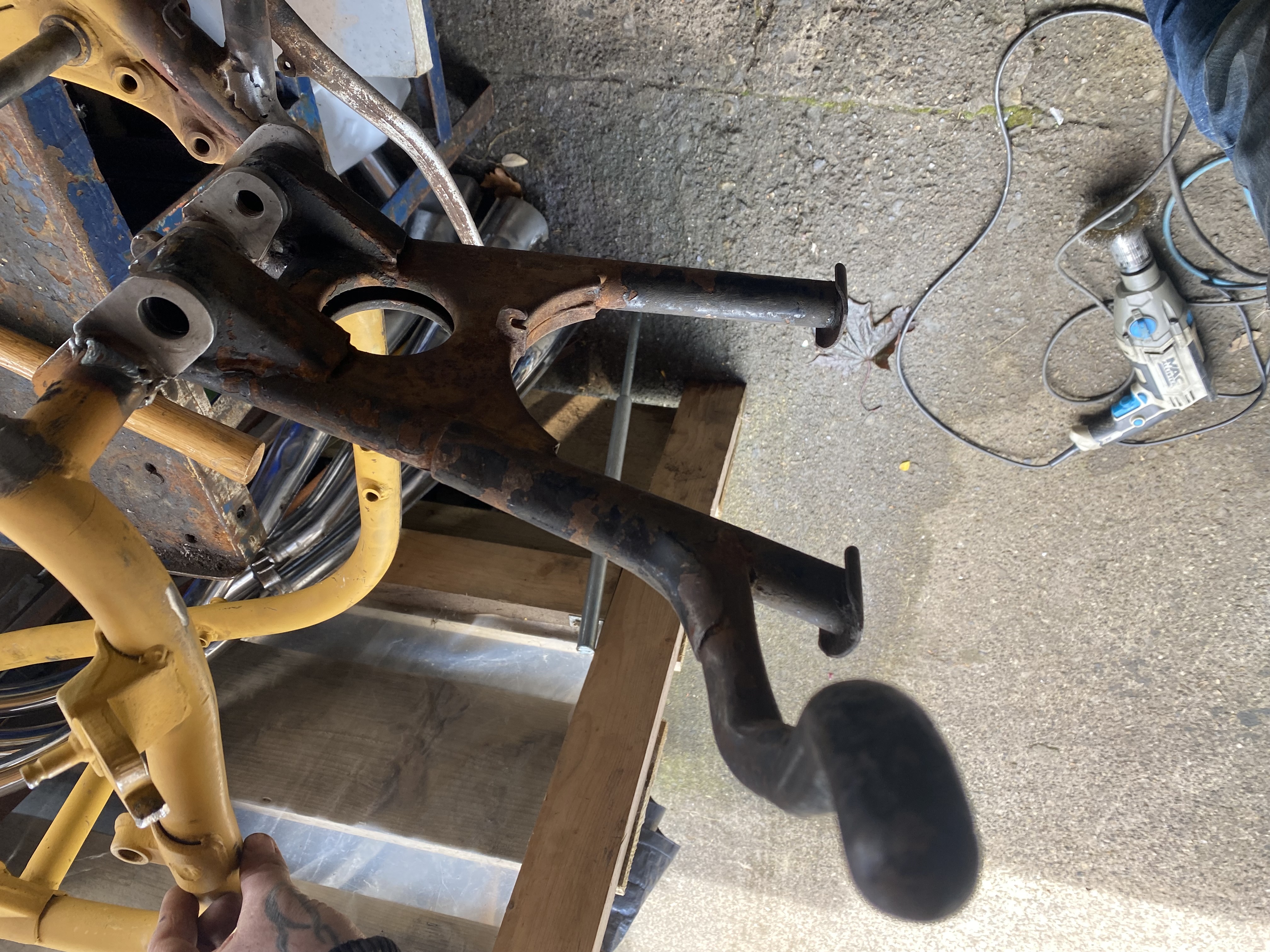

#2 PostAuthor: Z1streetfighter71 » Sun Jun 11, 2023 6:35 pm

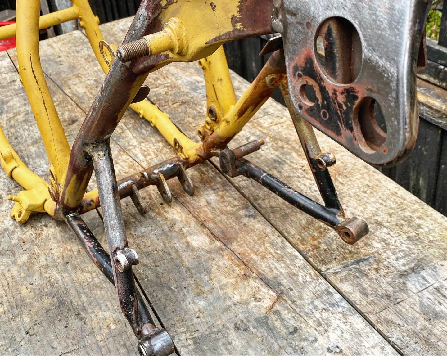

First thing as to sort out the center stand.

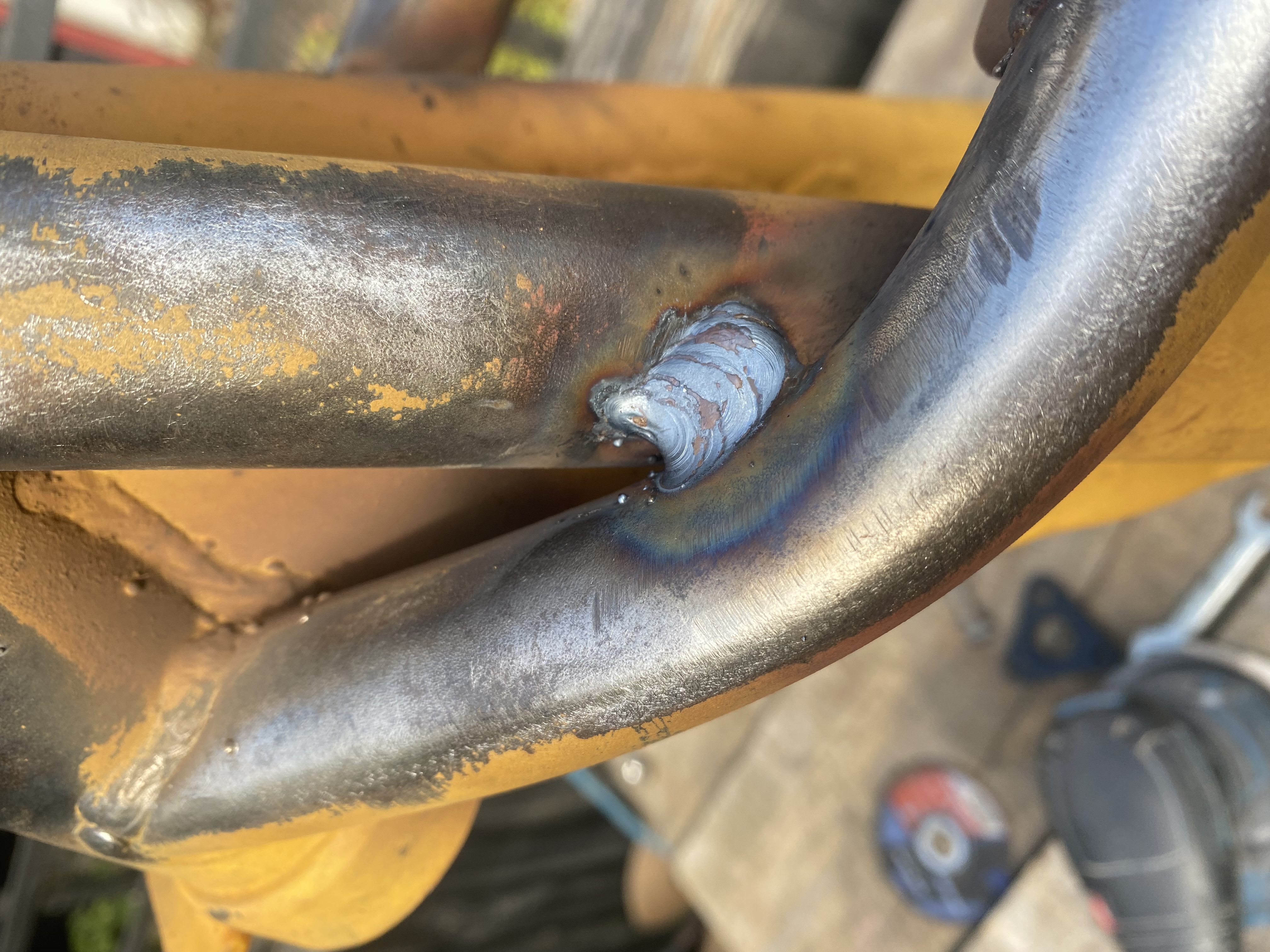

#3 PostAuthor: Z1streetfighter71 » Sun Jun 11, 2023 8:59 pm

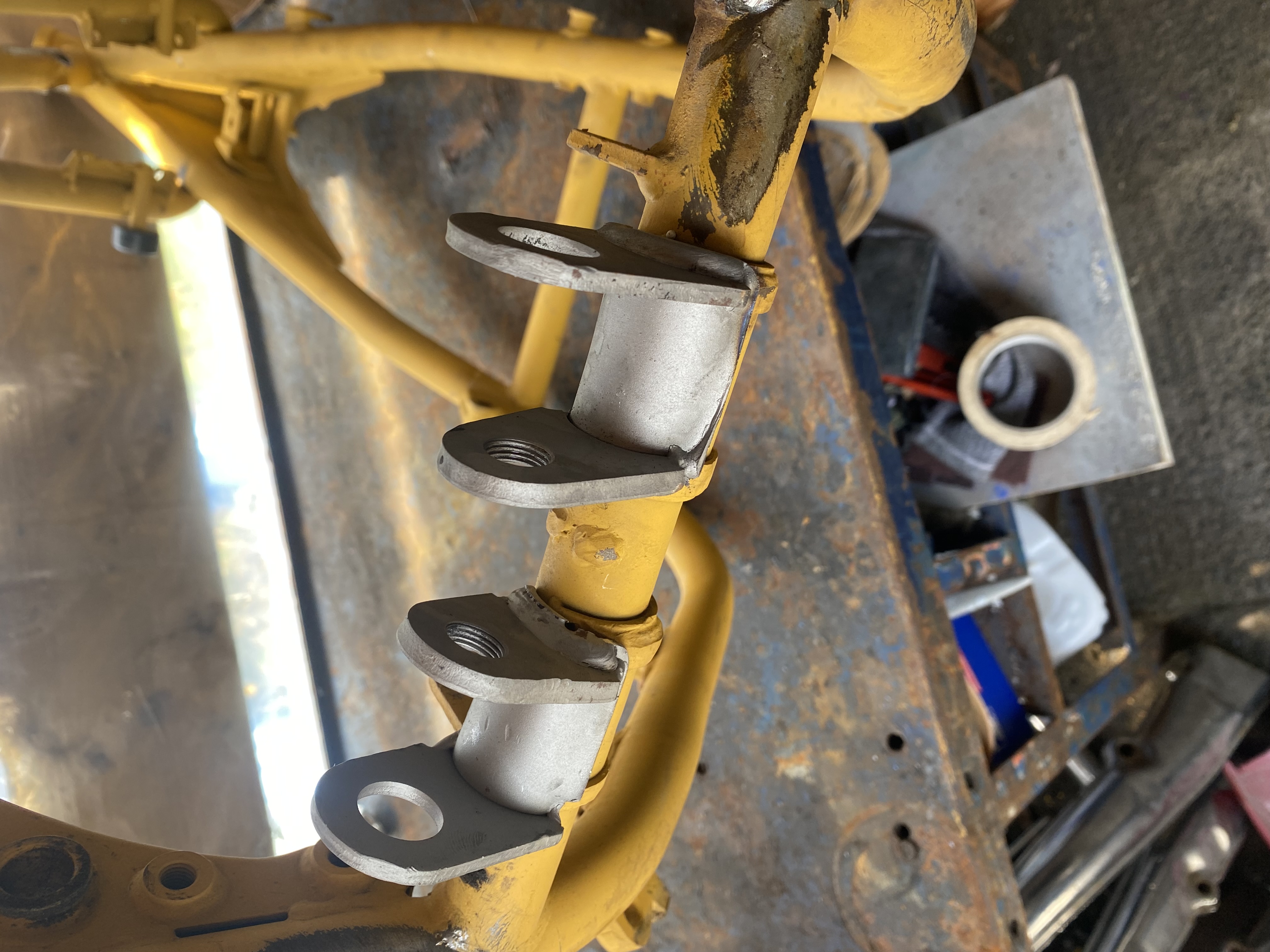

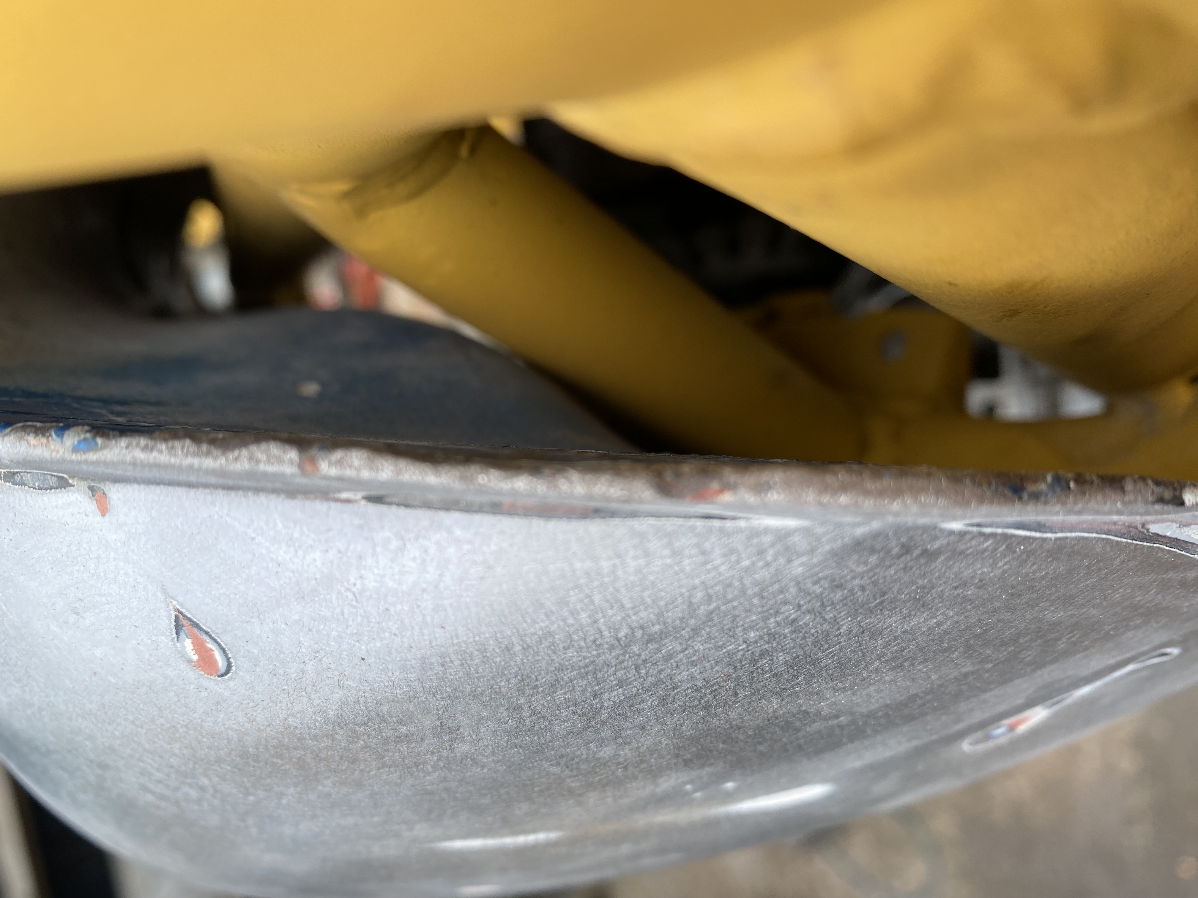

So then it was the turn signal ears and the exhaust hangers and a few well purposed welds to strengthen the frame.

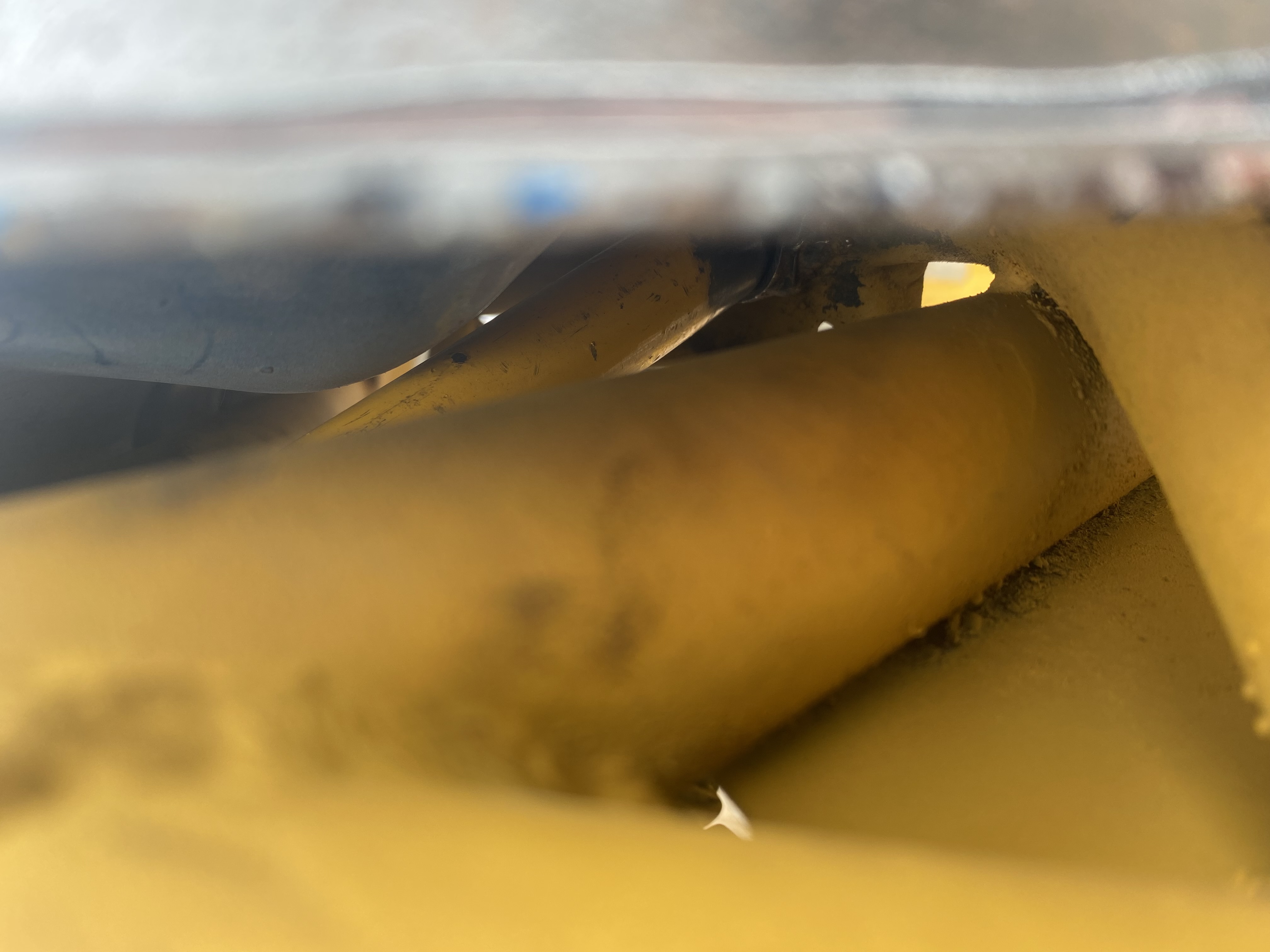

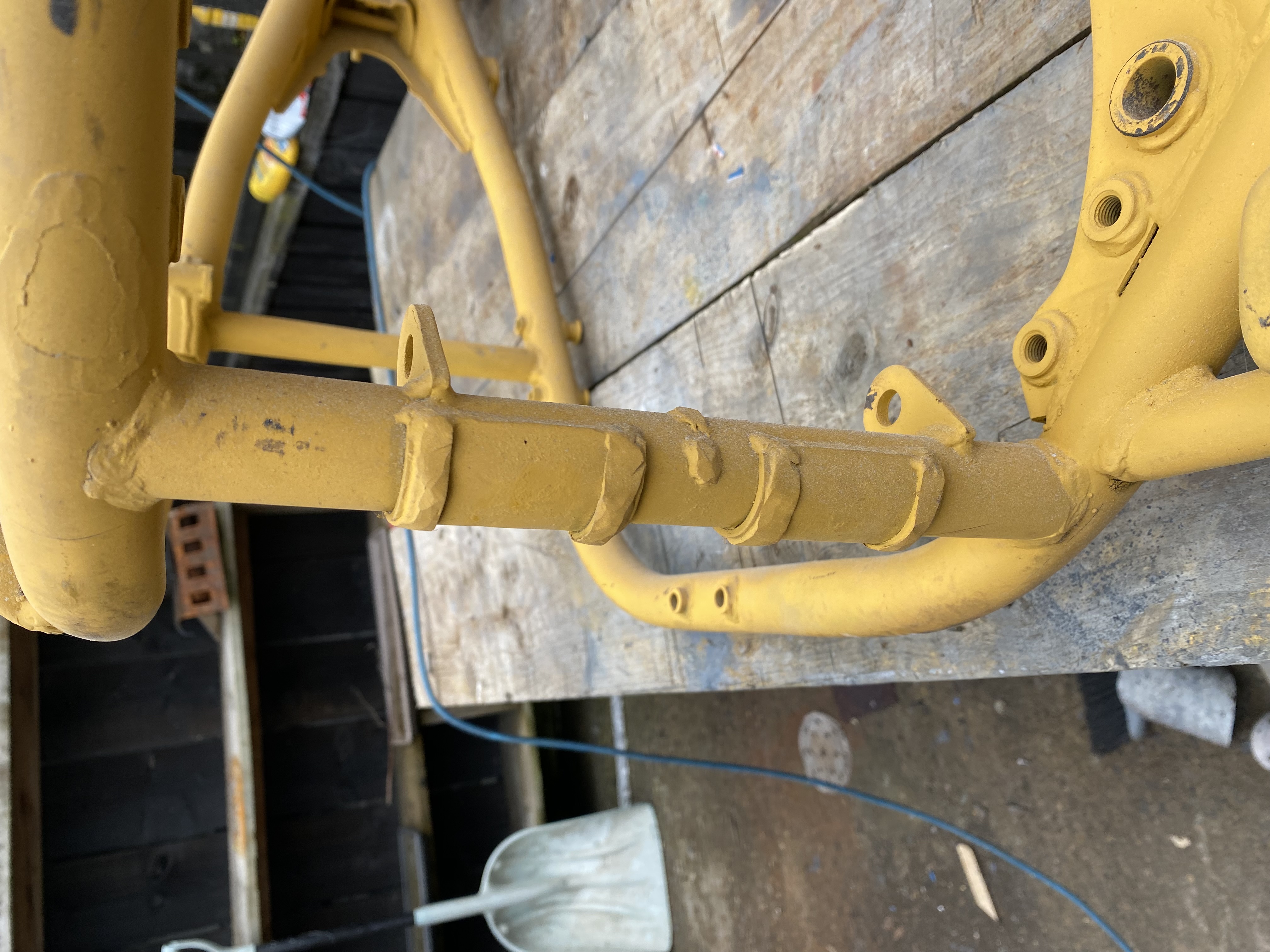

#4 PostAuthor: Z1streetfighter71 » Sun Jun 11, 2023 9:00 pm

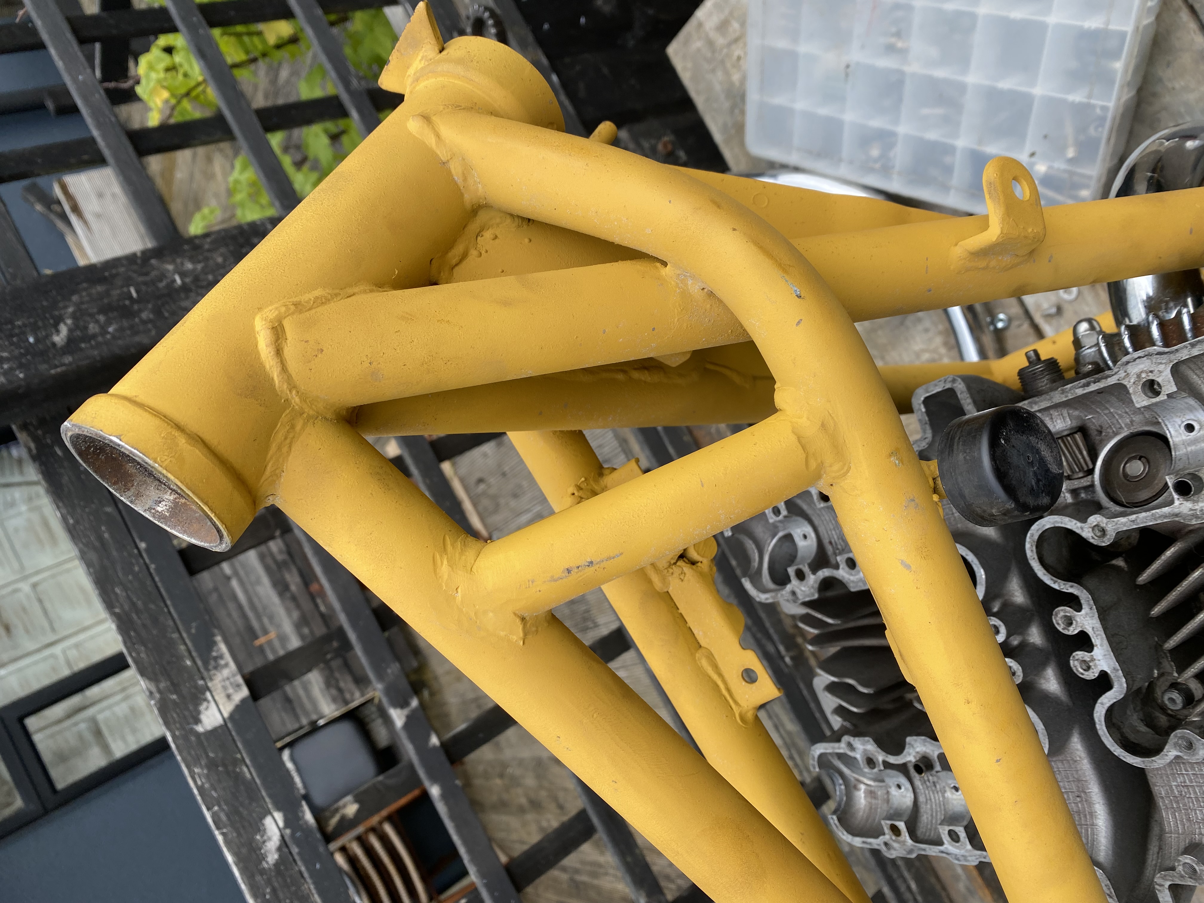

Relocating the bracing on the backbone and the tank fits now.

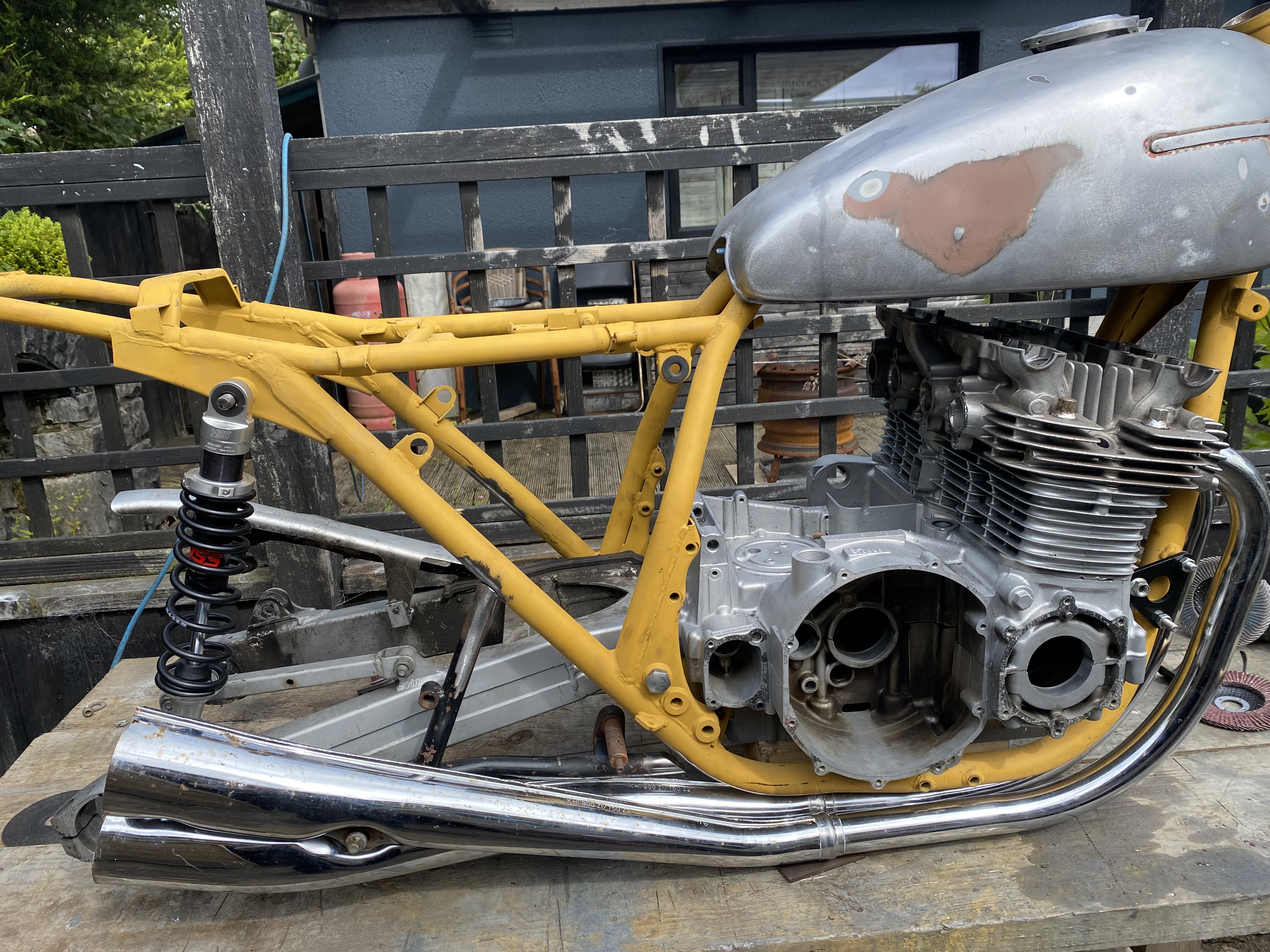

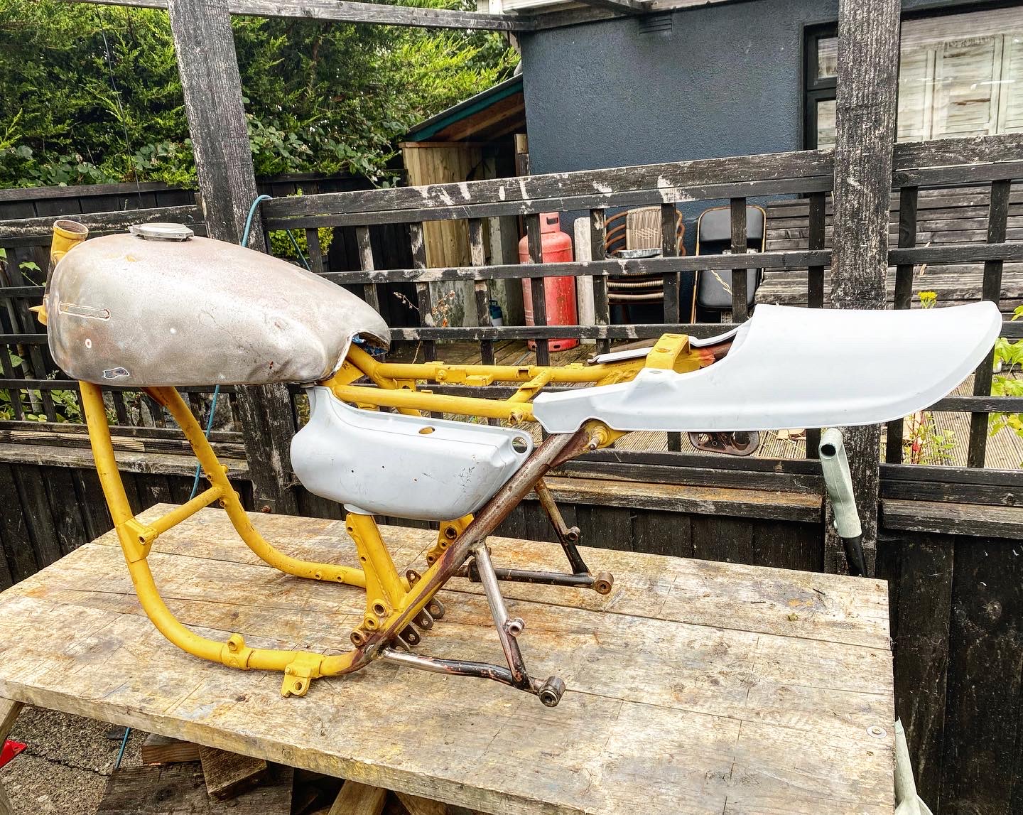

#5 PostAuthor: Z1streetfighter71 » Sun Jun 11, 2023 9:04 pm

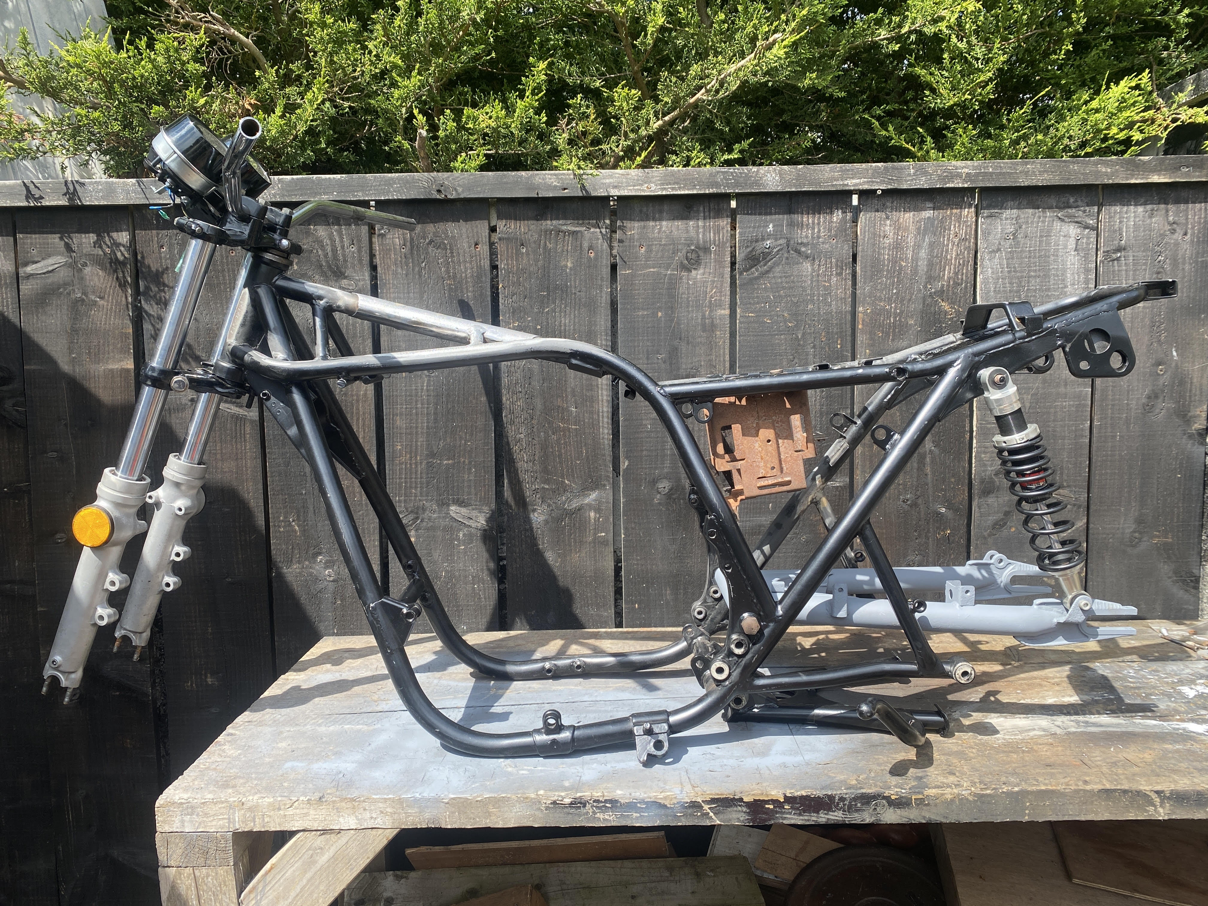

Wee mockup to see if everything fits.
I got a set of Z1 junker stock pipes off ebay for under a hundred bucks to make sure everything fit.

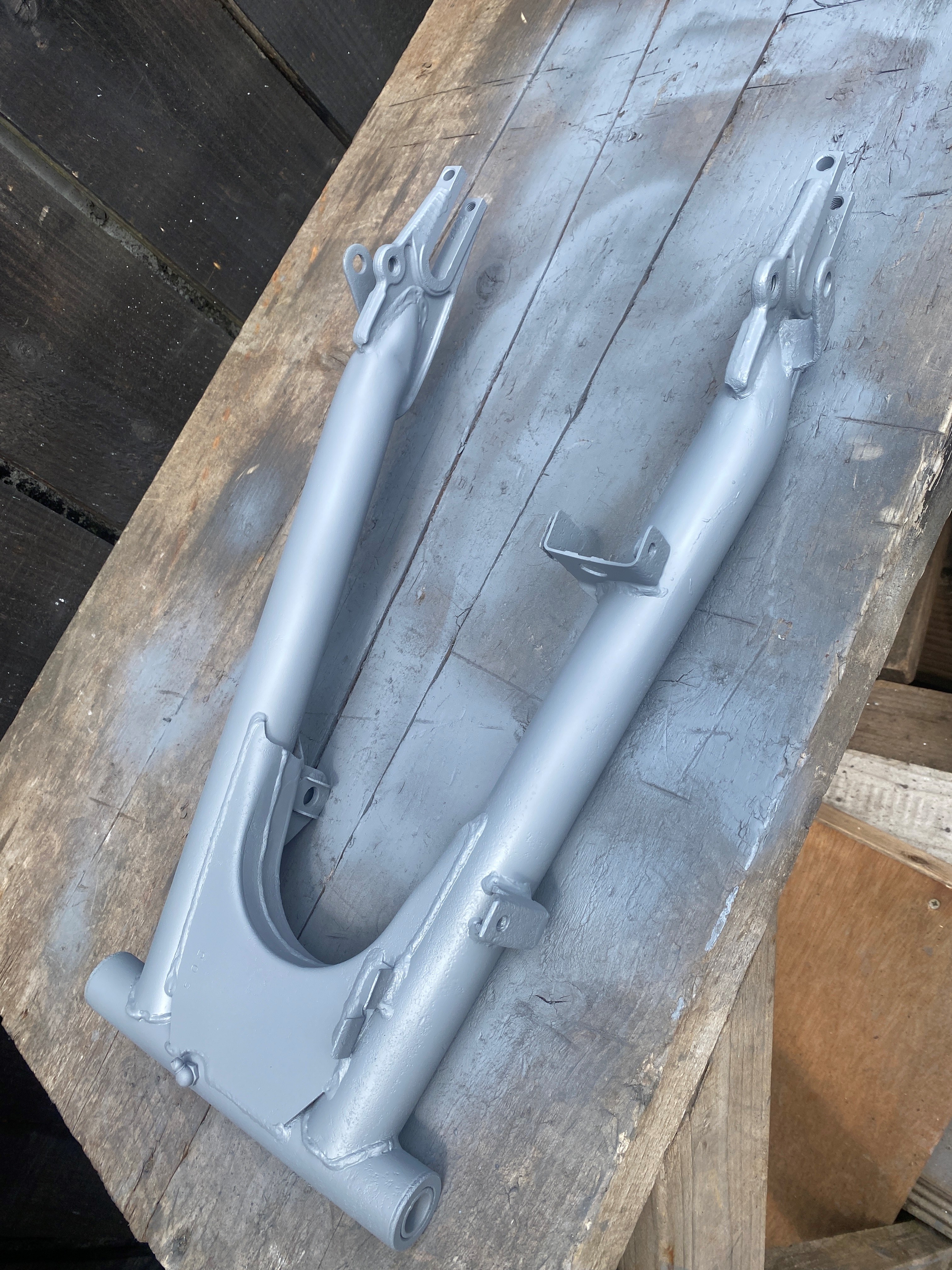

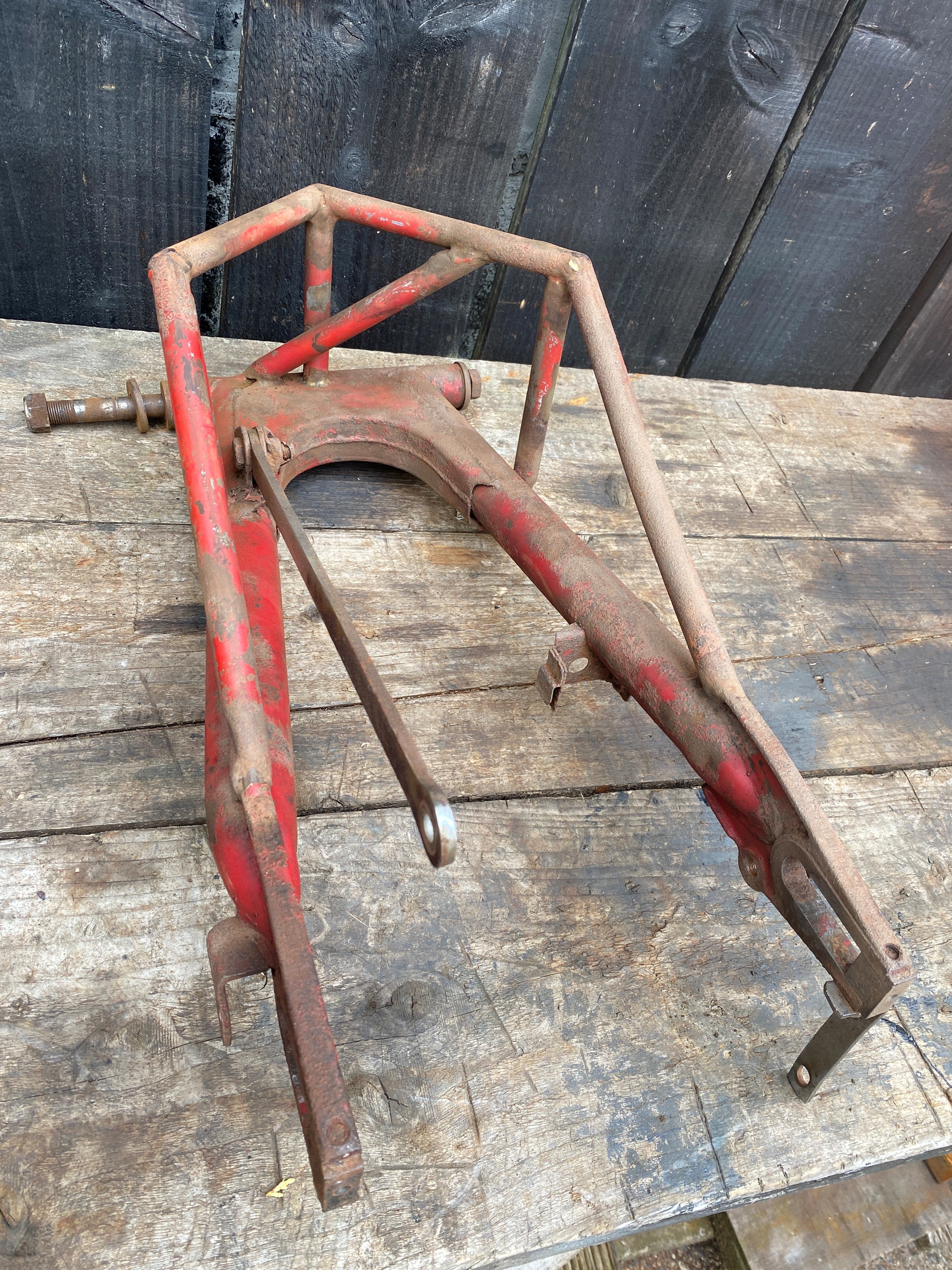

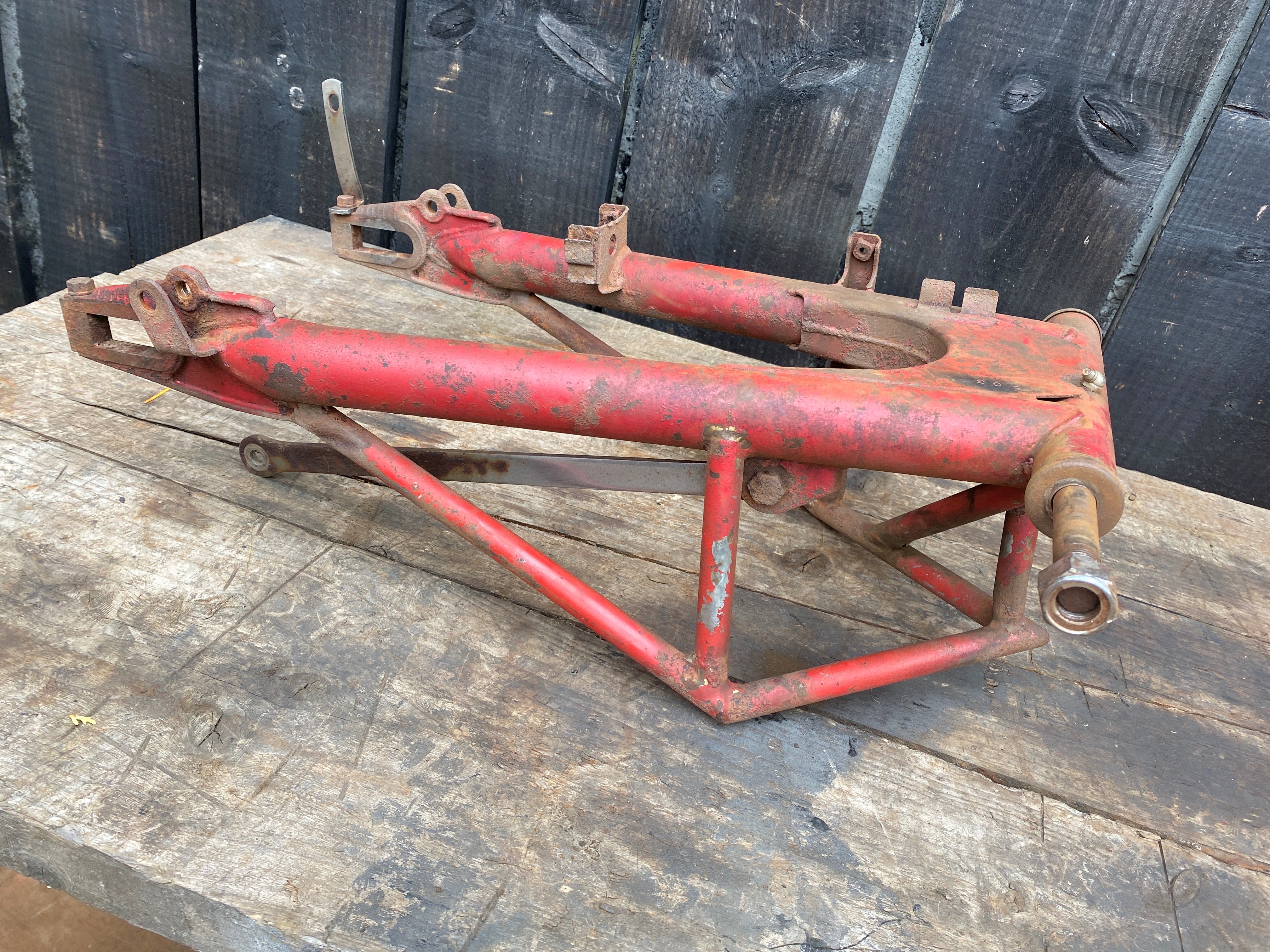

#12 PostAuthor: Z1streetfighter71 » Tue Jun 20, 2023 2:27 pm
Scored a z1 swing arm finally..took about 3 weeks to get from the States. Had some kind of railing welded to it but a few hours later its all good, quick spray of etch primer to keep it from rusting again.

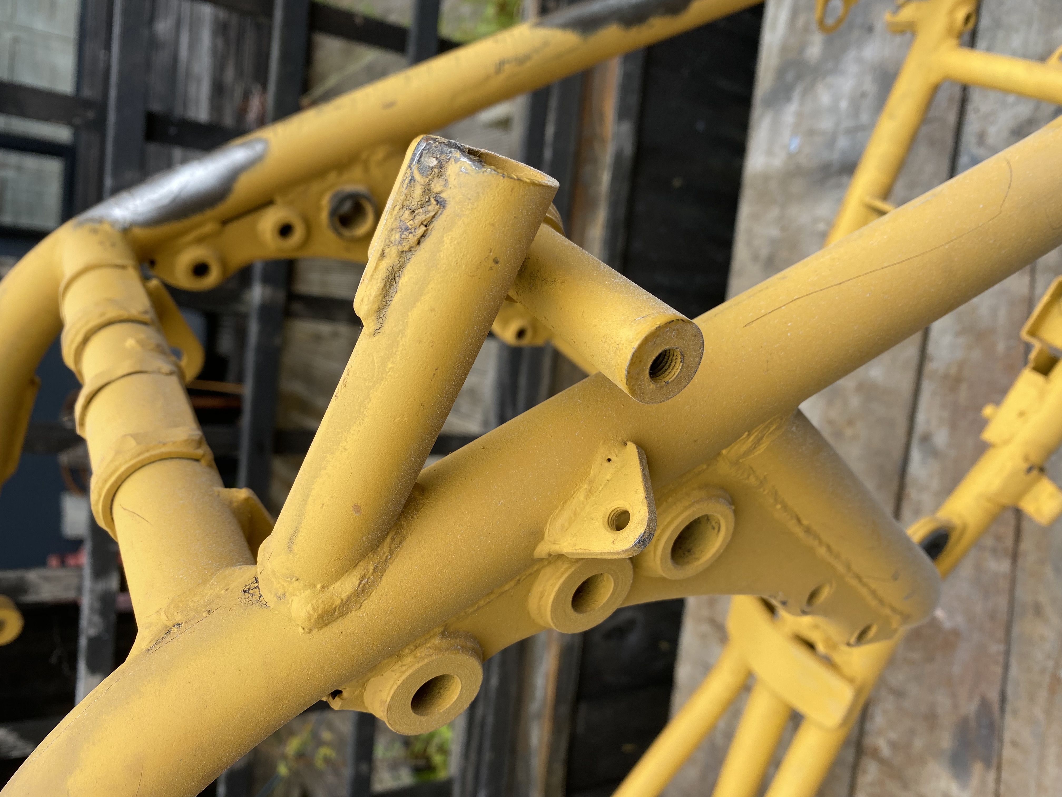

#13 PostAuthor: Z1streetfighter71 » Tue Jun 20, 2023 2:58 pm

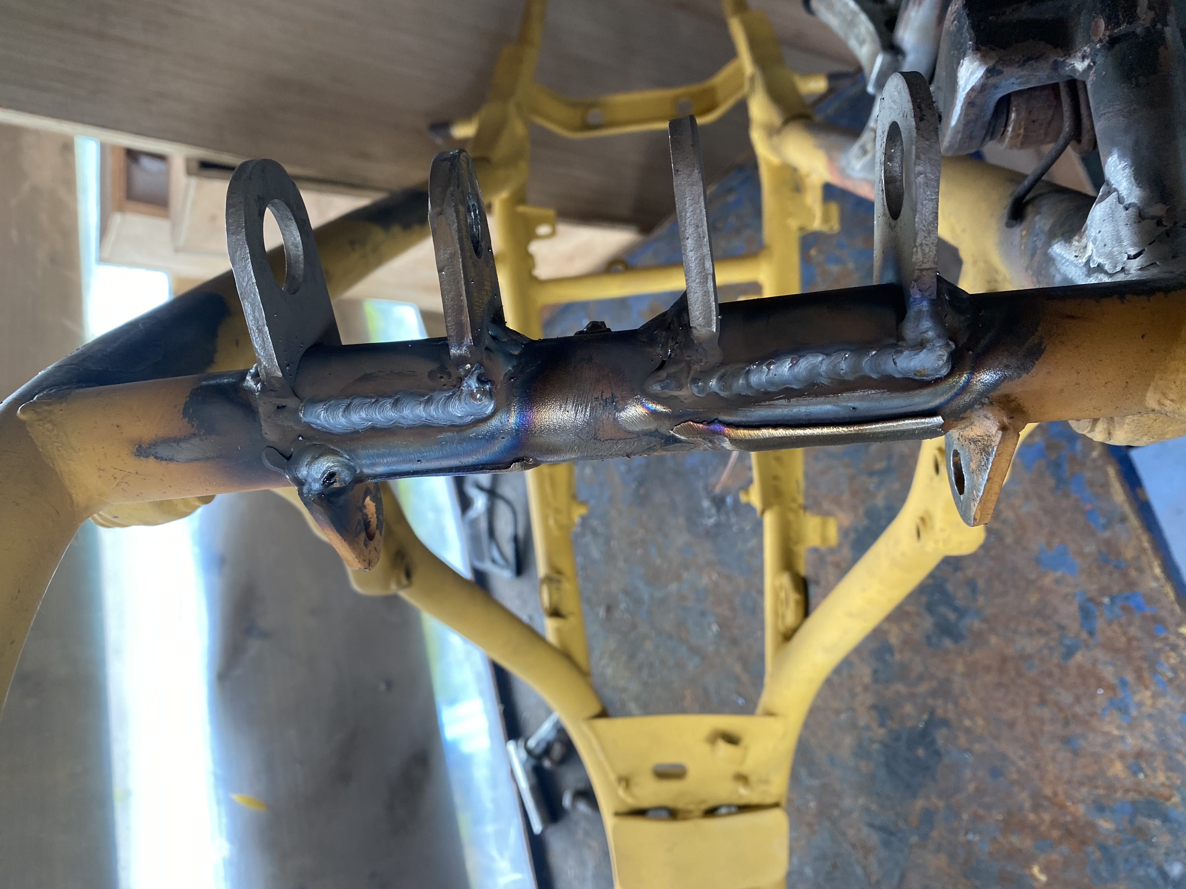

So were i stand right now.. 2 steps forward 1 step back, the frame was powder coated but only after it was done did i see that the backbone tube had been thinned out at the sides, couldn't let this go so did bicycle style strengthening gusset and bracing. I have my Z1b fork stem and forks, tubes brand new. Frame will be made ready for 2k paint and time to sort out the wheels in the week or 2 ahead.
