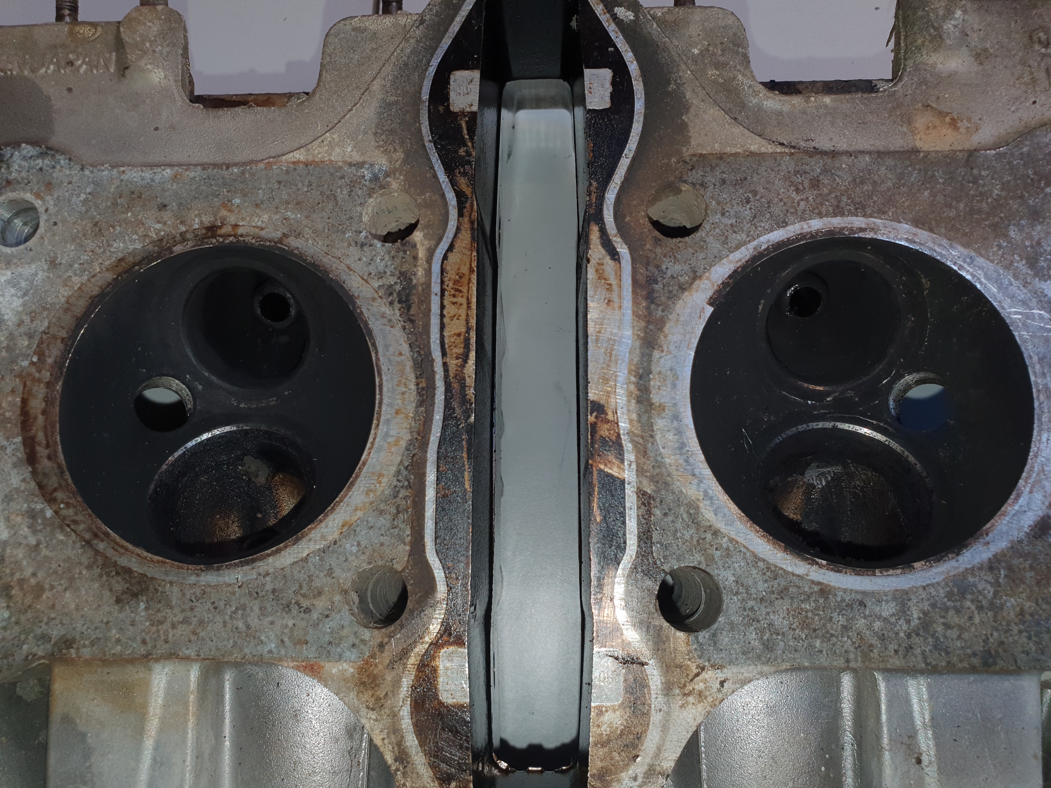

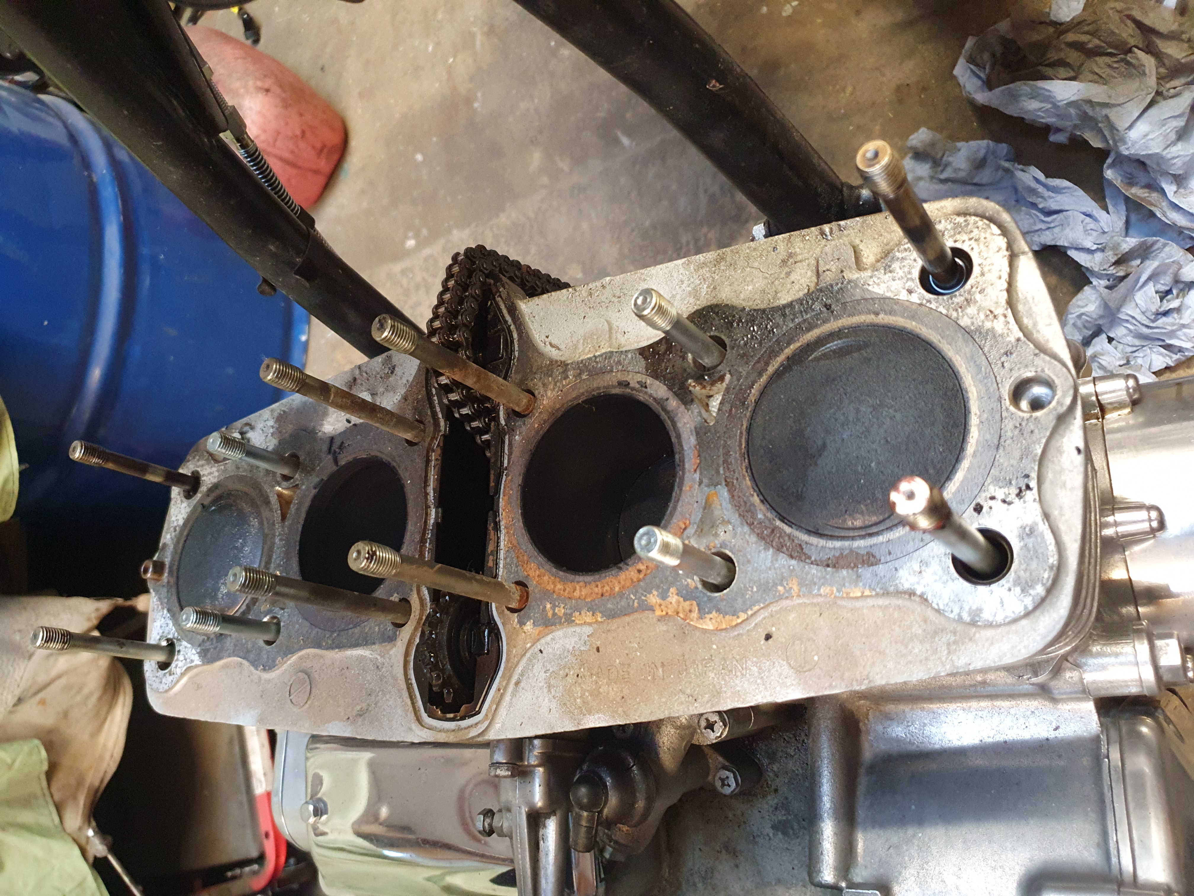

Good job I did though, what I found was it was massively coked up and 2 bent exhaust valves! The cam shells were also going through to the backing as well.

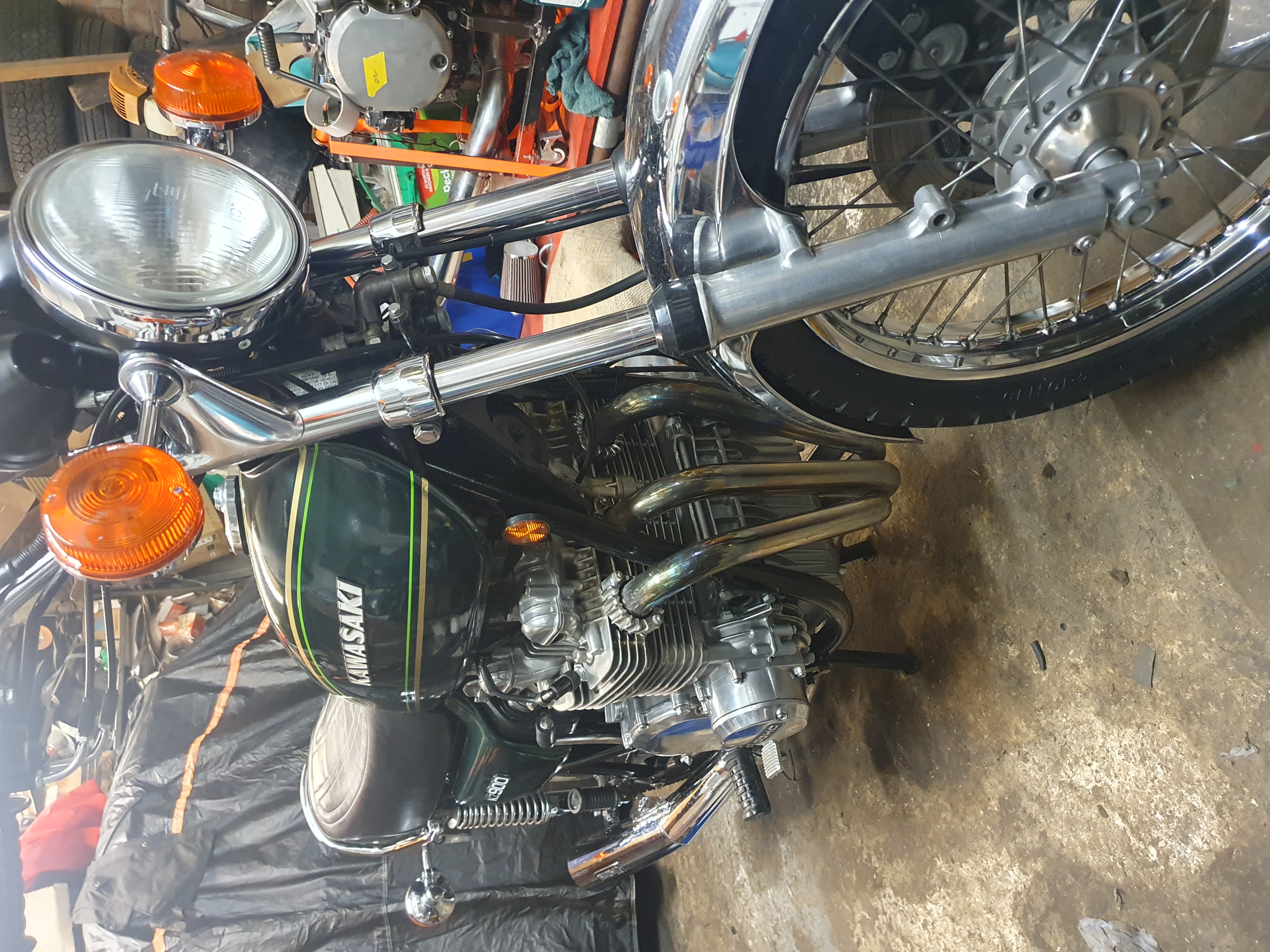

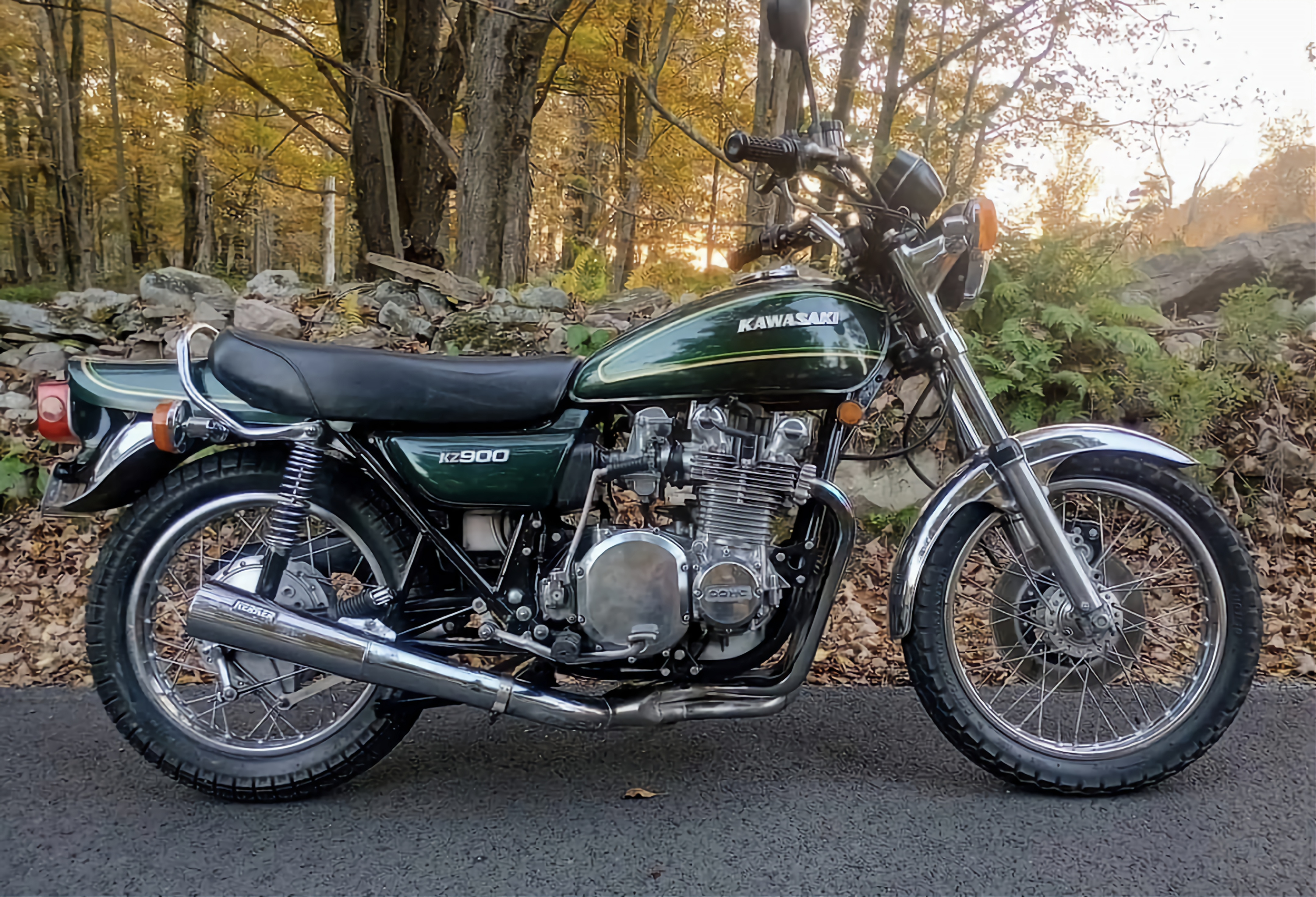

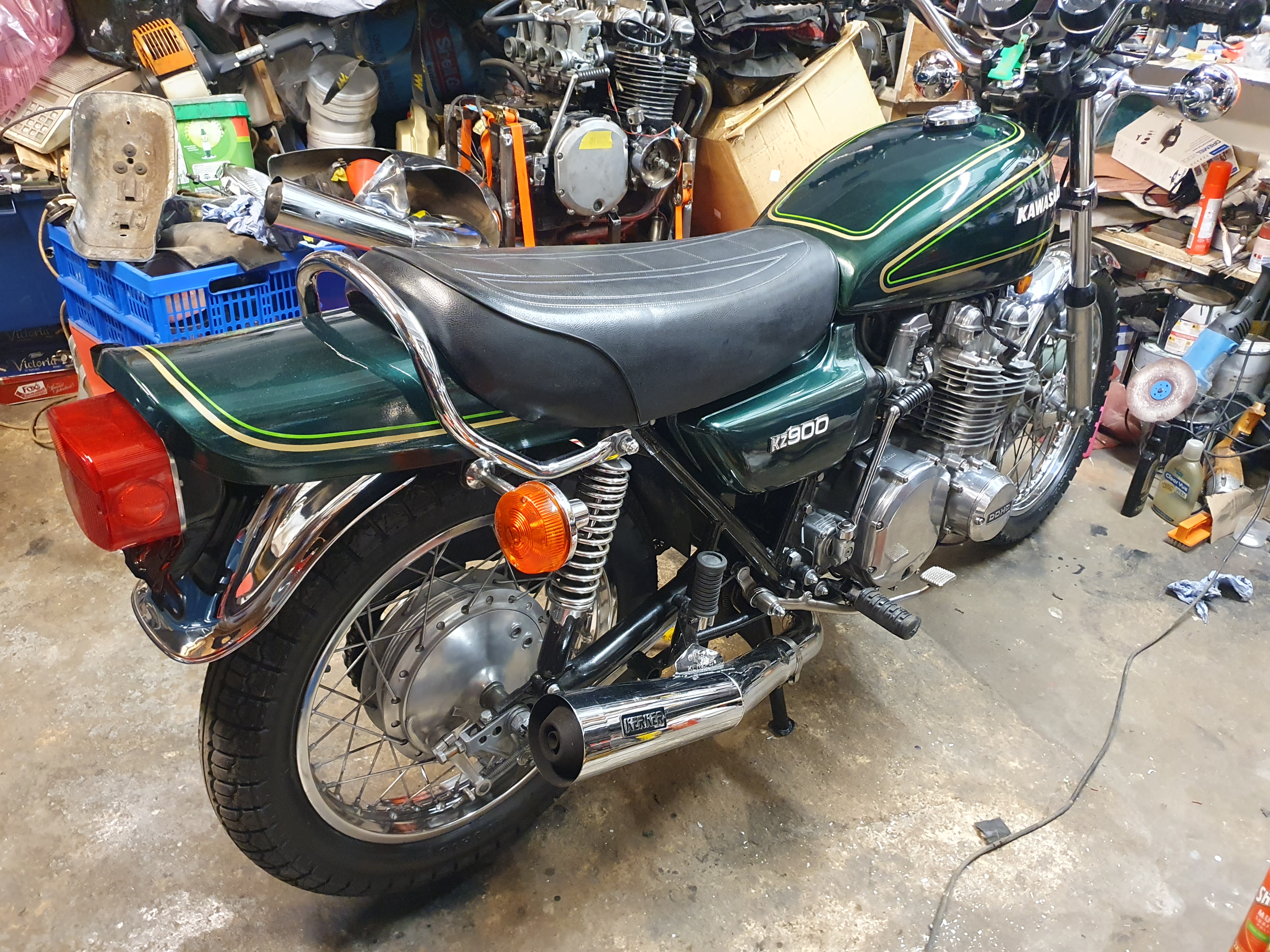

So what started as getting a 900 to ride for the summer that I knew would probably need a bit of work has become ANOTHER project. All parts to fix are on route, Kawasaki valves and shell bearings, gaskets and a valve guide that was worn as well. Here is some pics of it as was when it arrived and now :sad

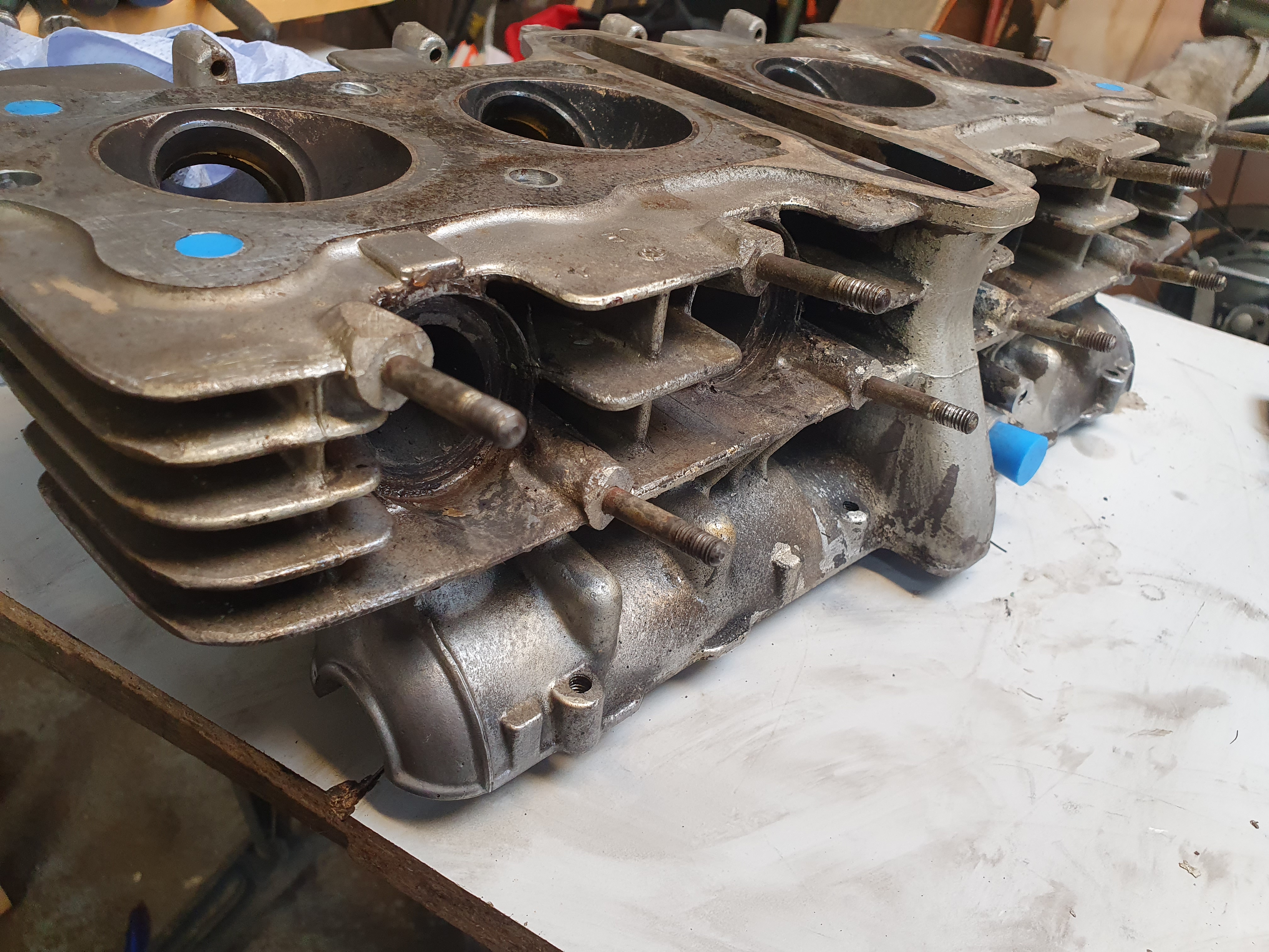

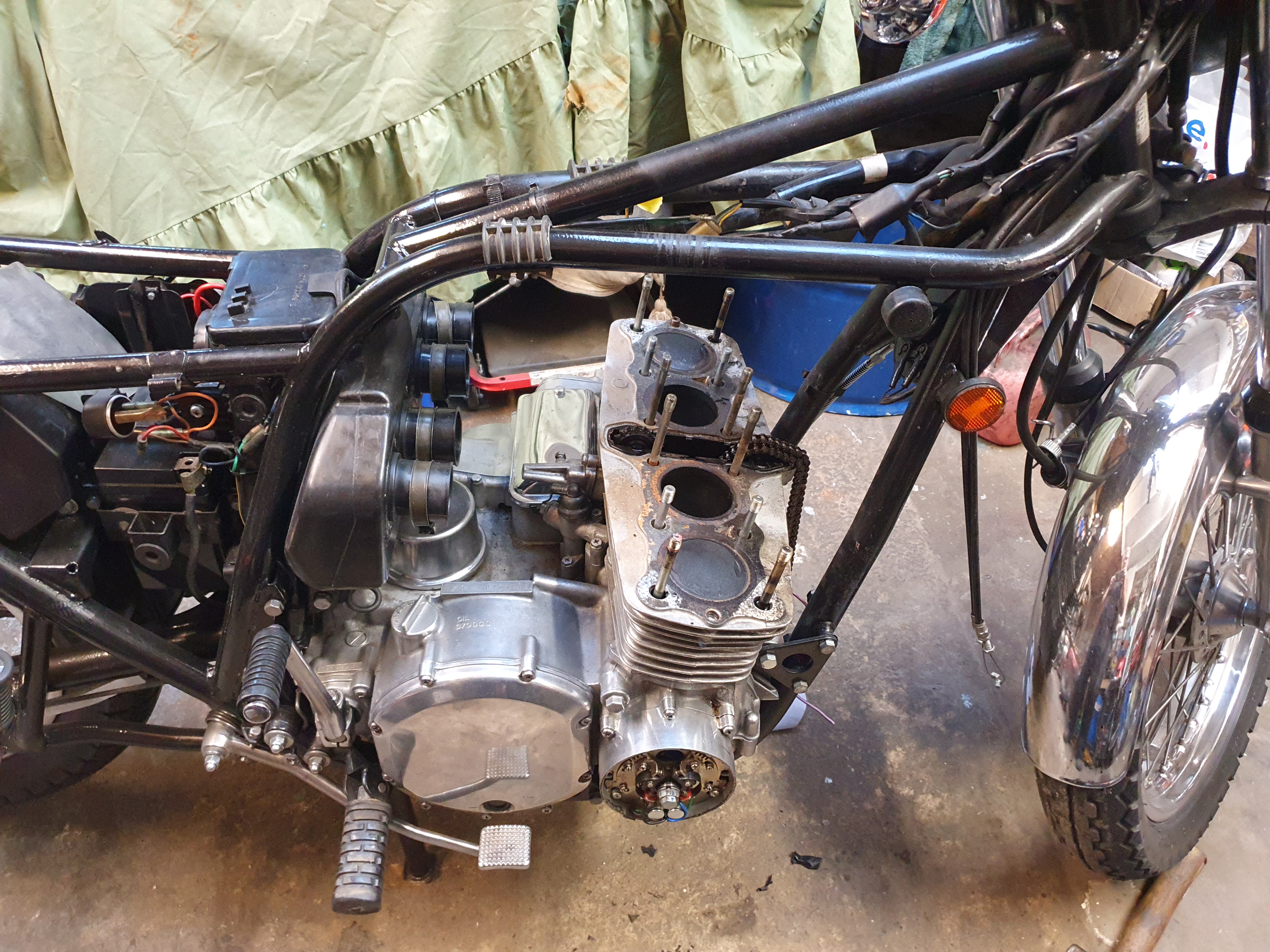

Stripping head back It's a bit of a mess really. Going to vapour blast it.

Just a thought - as it's so coked up it would be worth checking out the carb jet sizes. The Yanks have a habit of up-sizing the jets at any opportunity to cure all ills !
