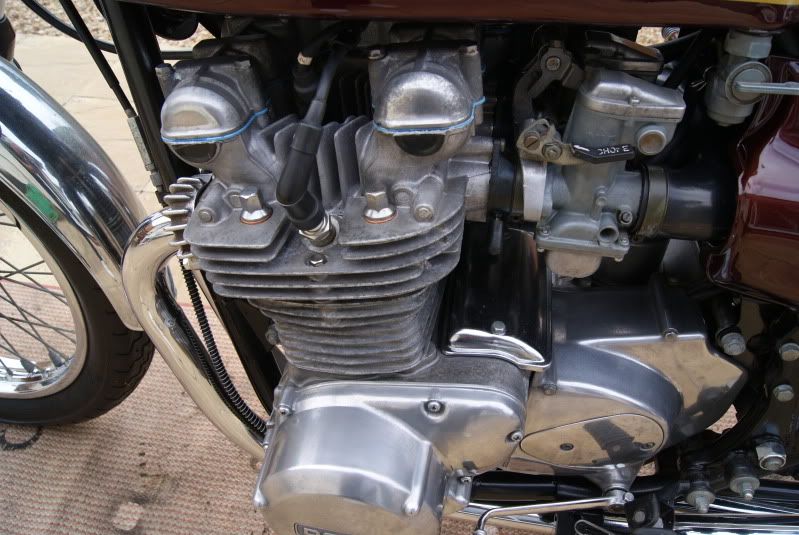

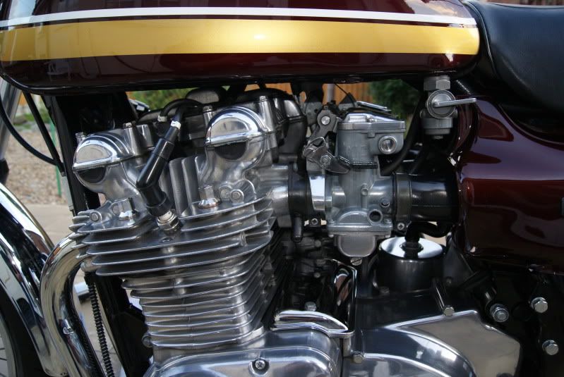

Re: Z1000 LTD to standard
#15 PostAuthor: Garry.L » Sun Sep 29, 2024 2:19 pm
Cant beat a good hand job -just takes time effort....
Before...
After.....
