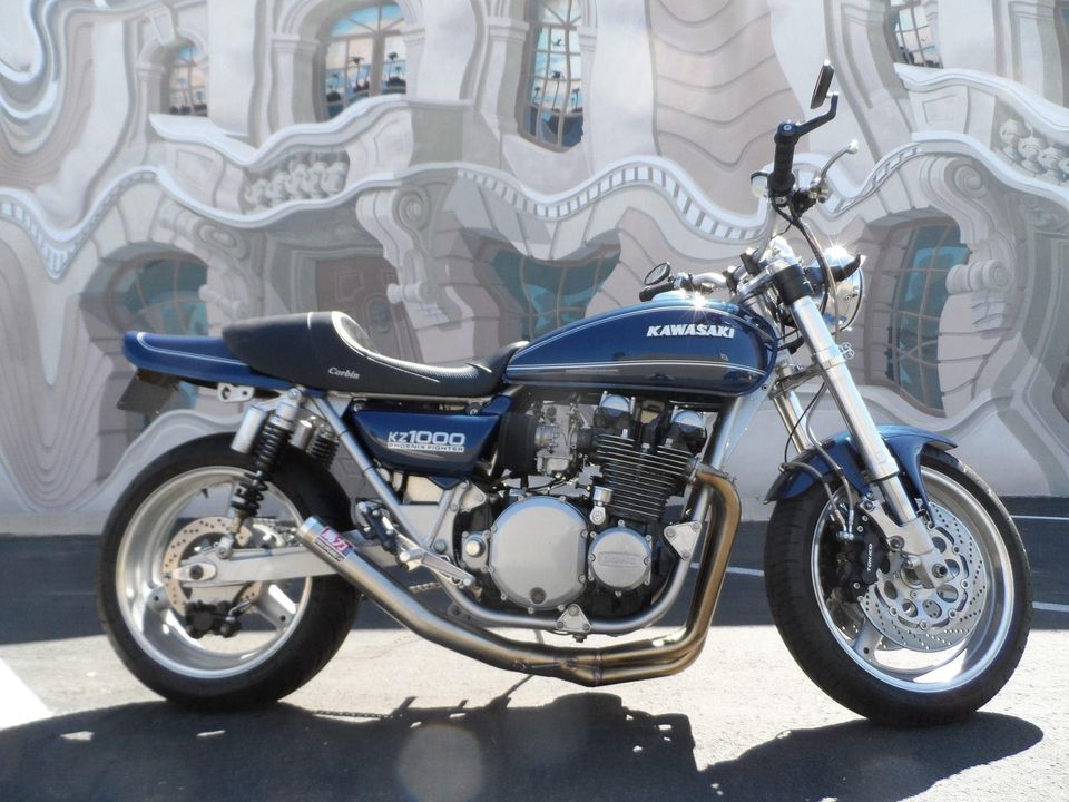

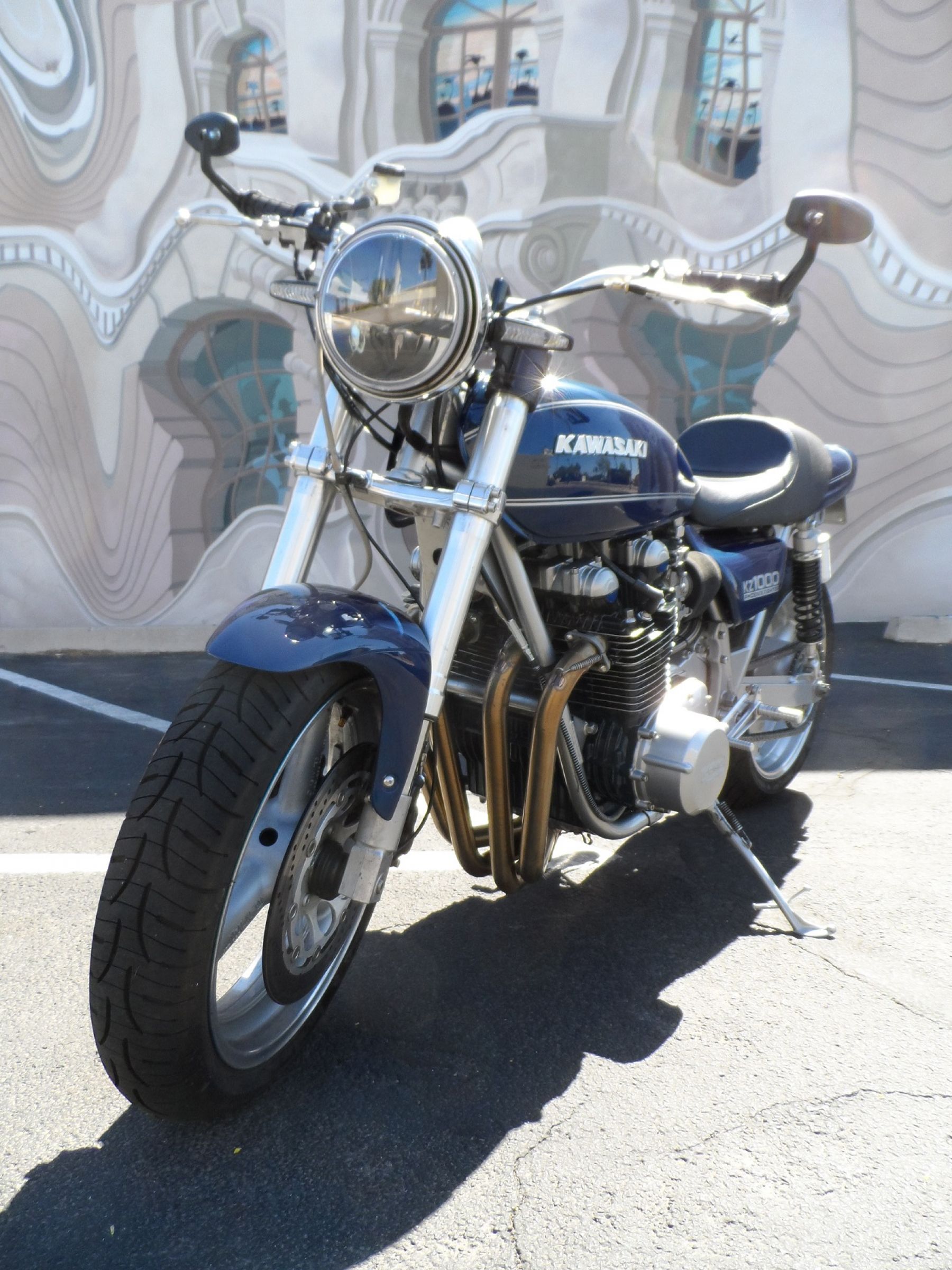

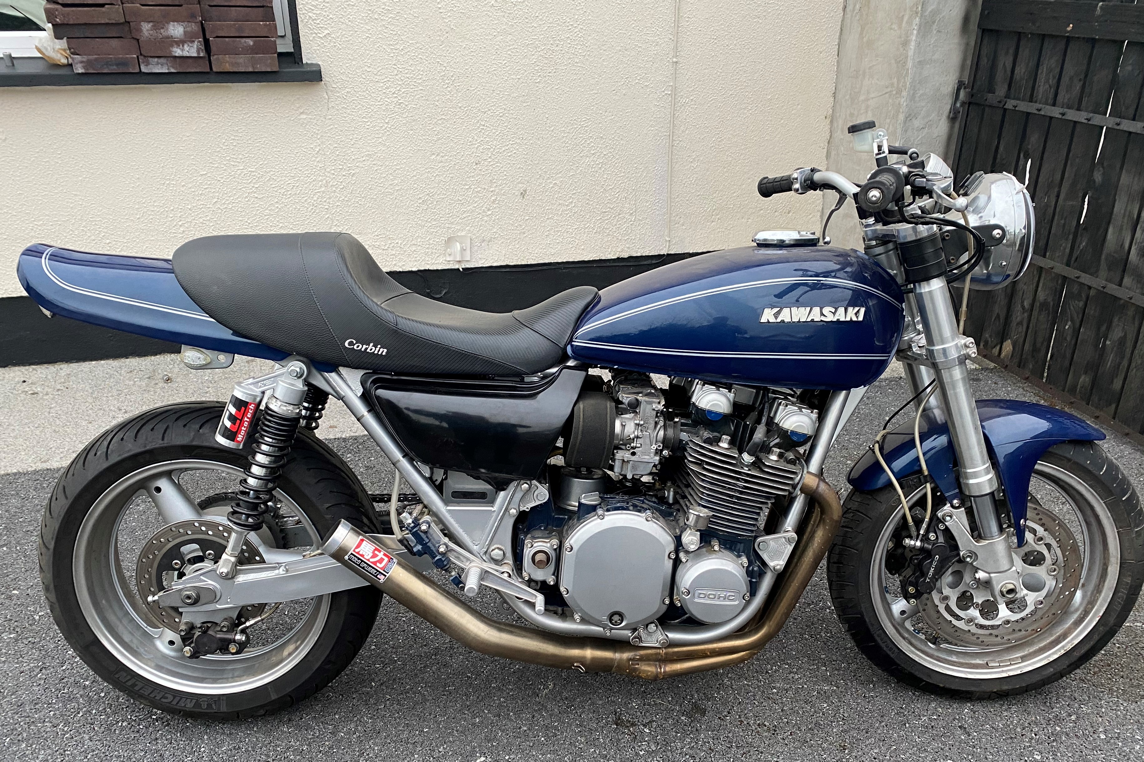

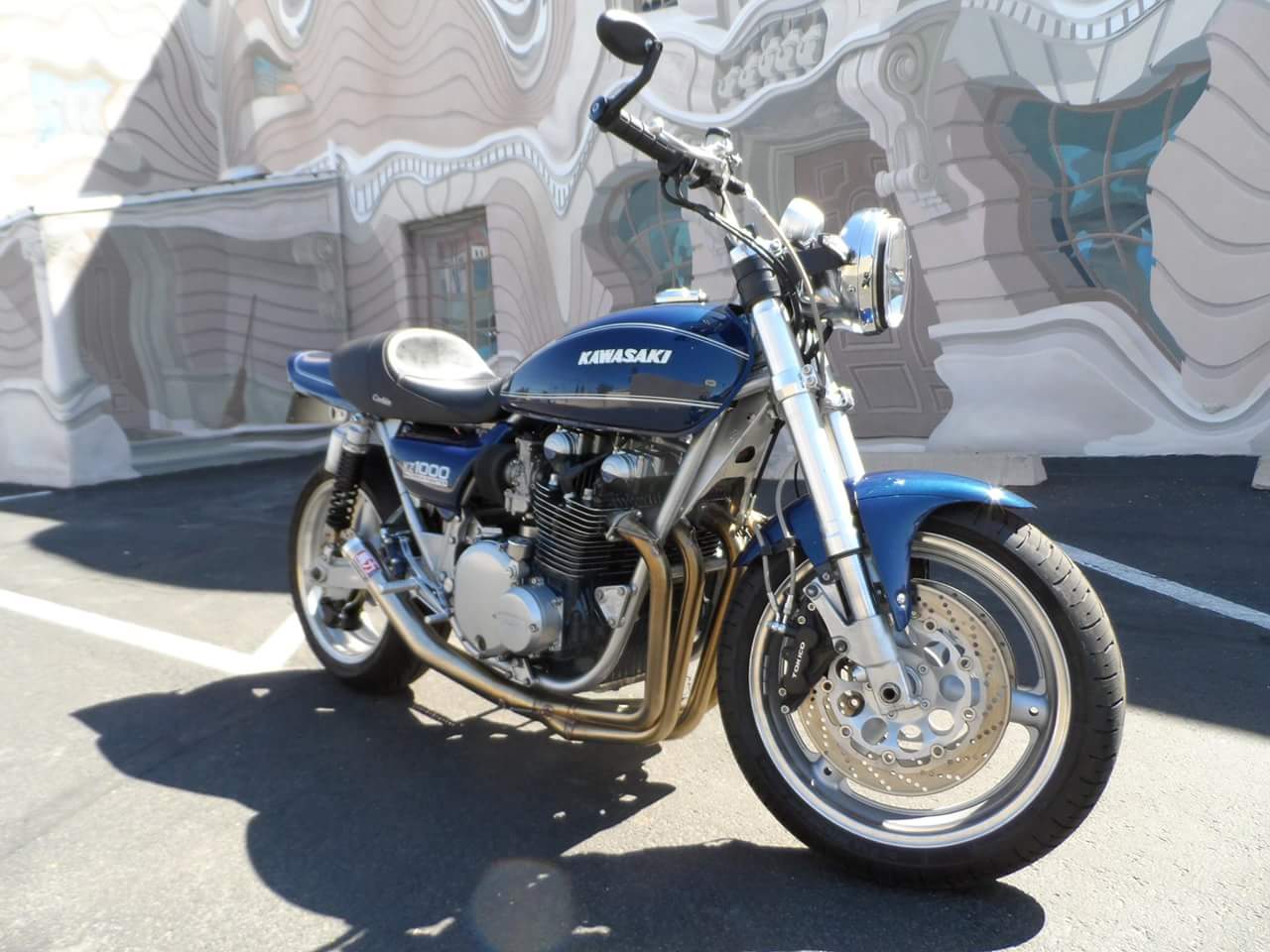

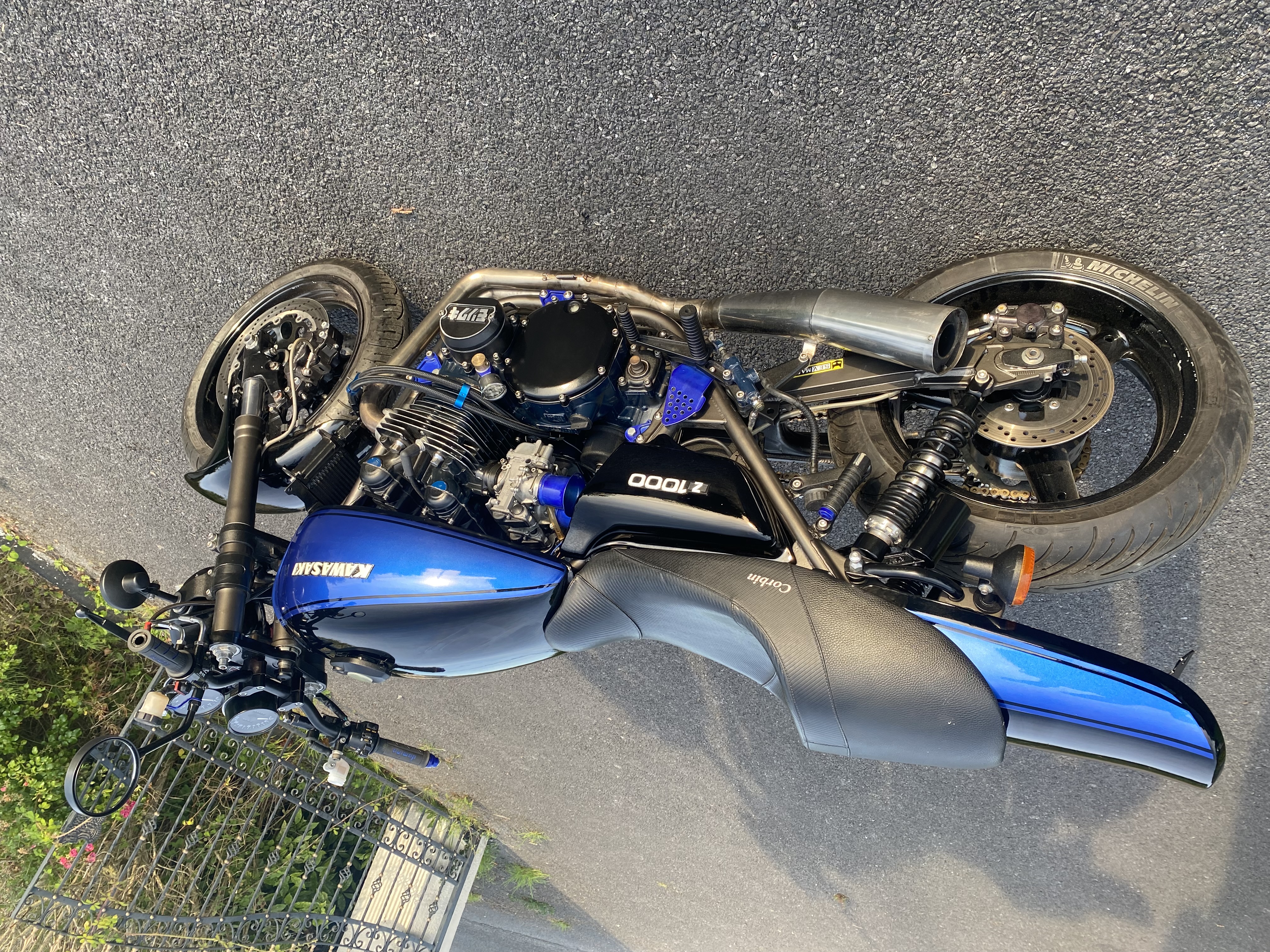

This has been in the brew for a while now. Around the tail end of covid lock down i was on the PC fairly early one morning. Fella name of Jon in California was on at the same time over in the states on a US version of this site. He posted up that the first interested party who would be keen to buy his fairly well know bike the "phoenix" for $2500 could have her. Turns out on her maiden "ride out" he came a cropper on her and his pregnant wife to be was none to happy. I remember the build thread and jumped at the chance regardless of how much it would cost to get her all the way to Galway. This was her just after "completion" and ill use that term loosely..
Posts: 1044
Re: A tale of two Z1000's
#2 PostAuthor: Z1streetfighter71 » Thu Feb 27, 2025 9:48 pm
Anyways about 4 months after paying the sale price of $2500 i got her back to Ireland after paying just a tad over the price i paid to buy her to get her back..So $5000 to the door. She was fairly bate up. The crash happened because the forks used were way to short, Typical slap on a pair of GSXR forks and away you go..Plus the turning radius was tiny. Long story short on a long ride he was fatigued, went to avoid hitting his mate in front of him, grabbed a handful of front brake and turned, bike bottomed out and locked in the left turn. Basically flipping the bike.

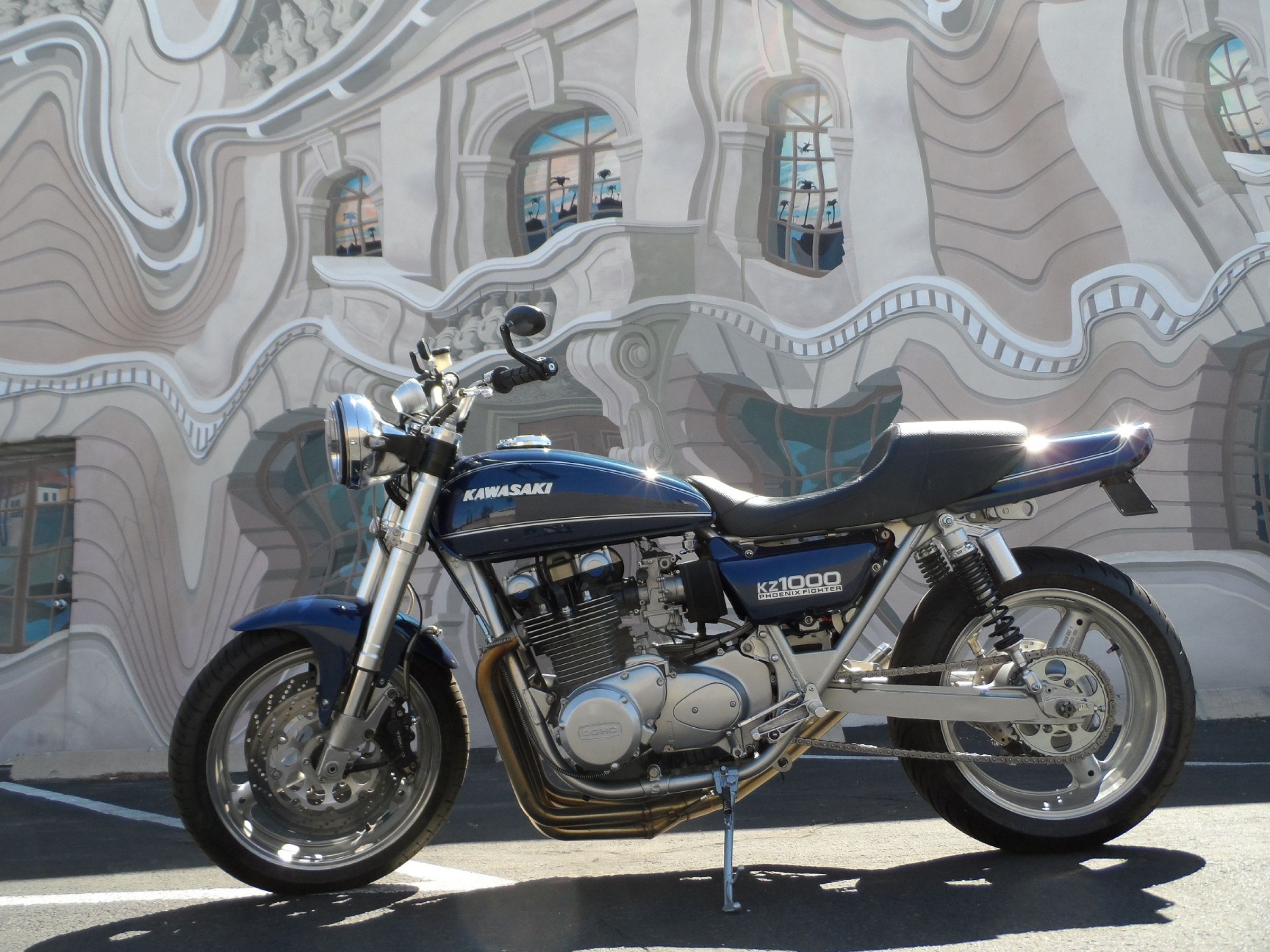

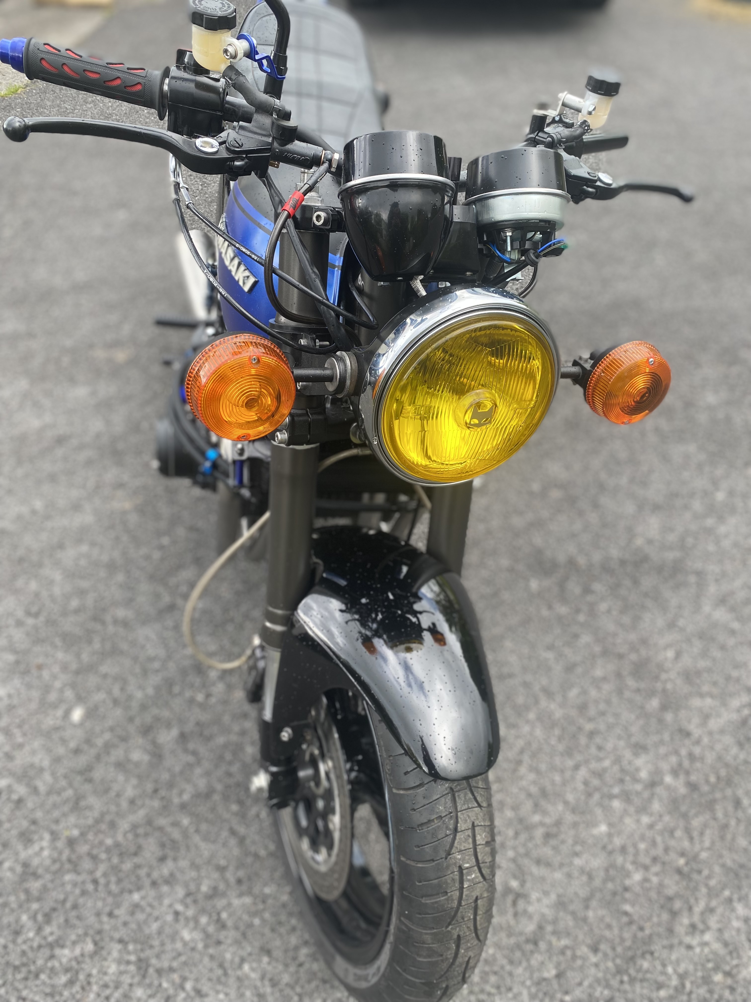

This was her on day one. Poor lass was bruised but not out.

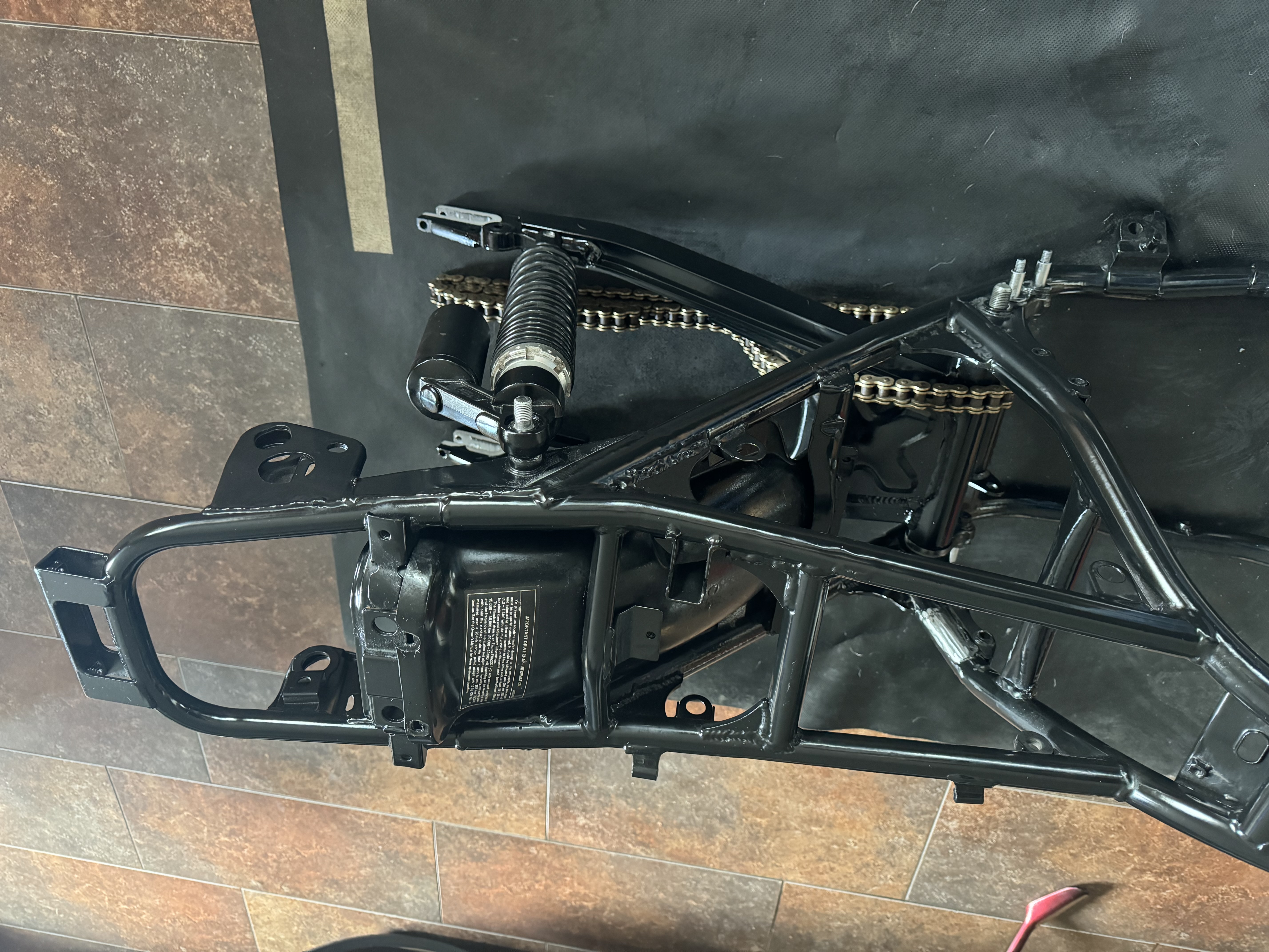

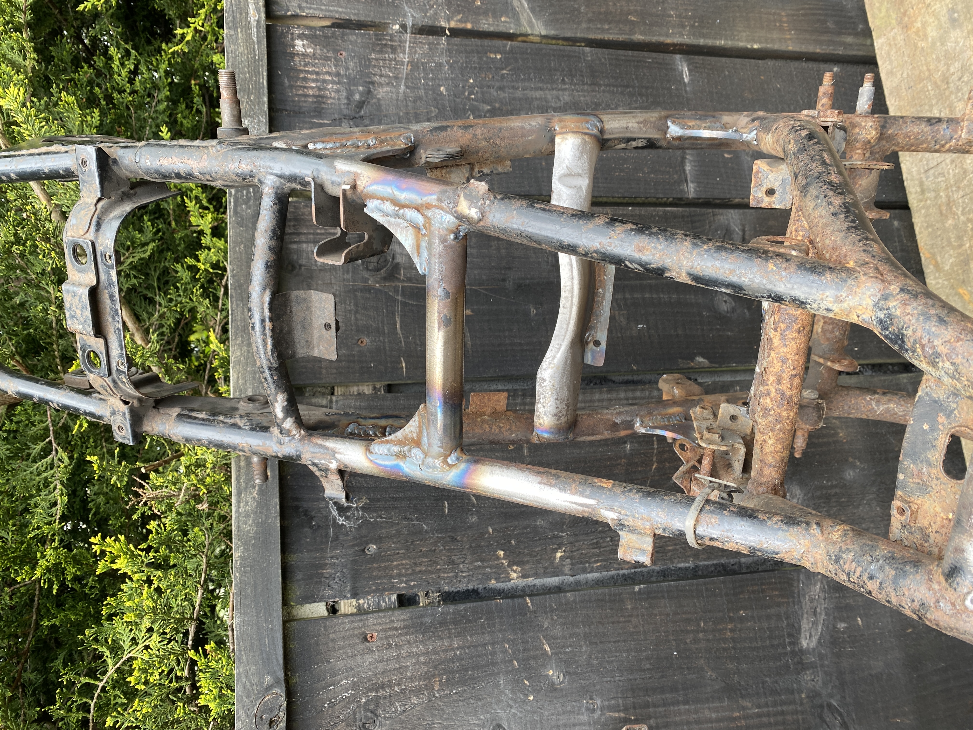

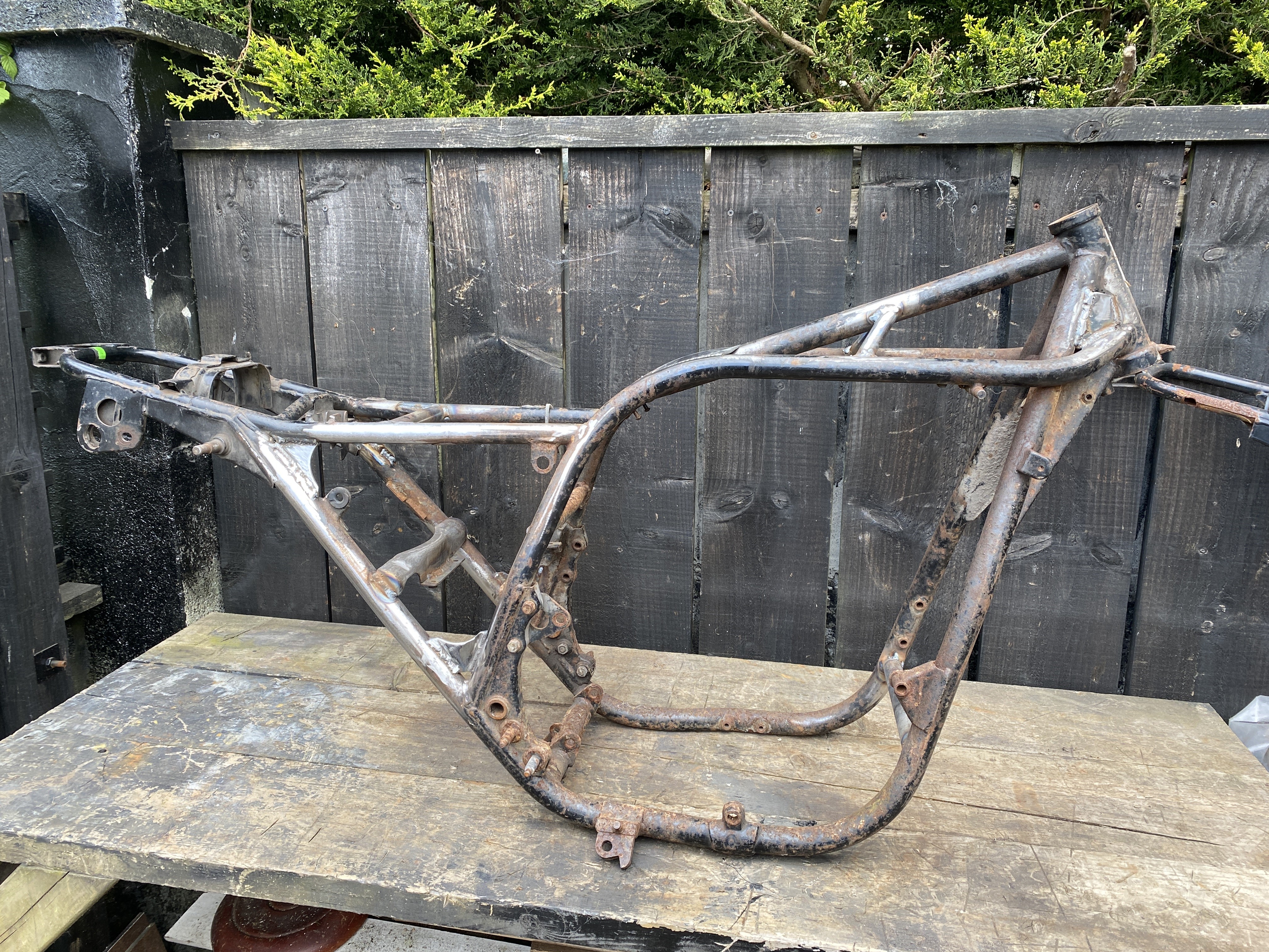

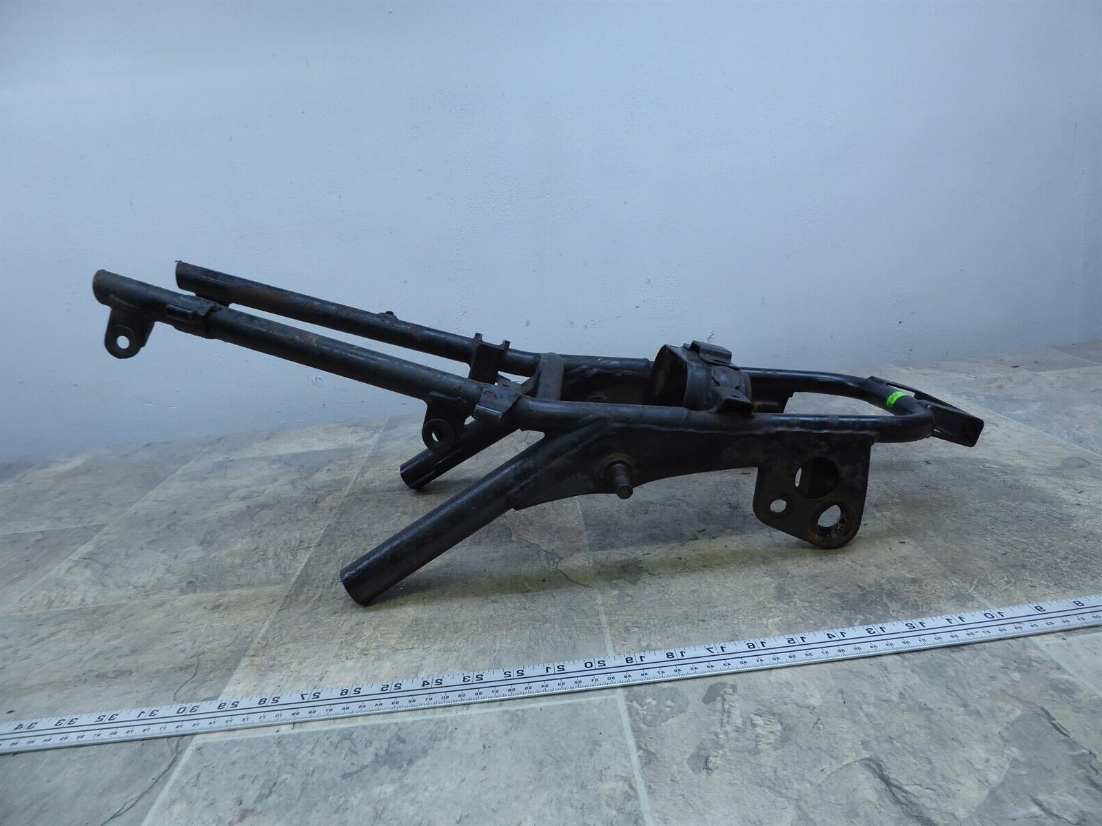

So she is a 77 A1. Now moving on to bike 2 i bought this frame on a whim for 150 euro. She had been butt f*cked by some one trying to do a streetfighter left for dead and buried in a shed for 10 years.
Posts: 1044
#5 PostAuthor: Z1streetfighter71 » Thu Feb 27, 2025 9:59 pm

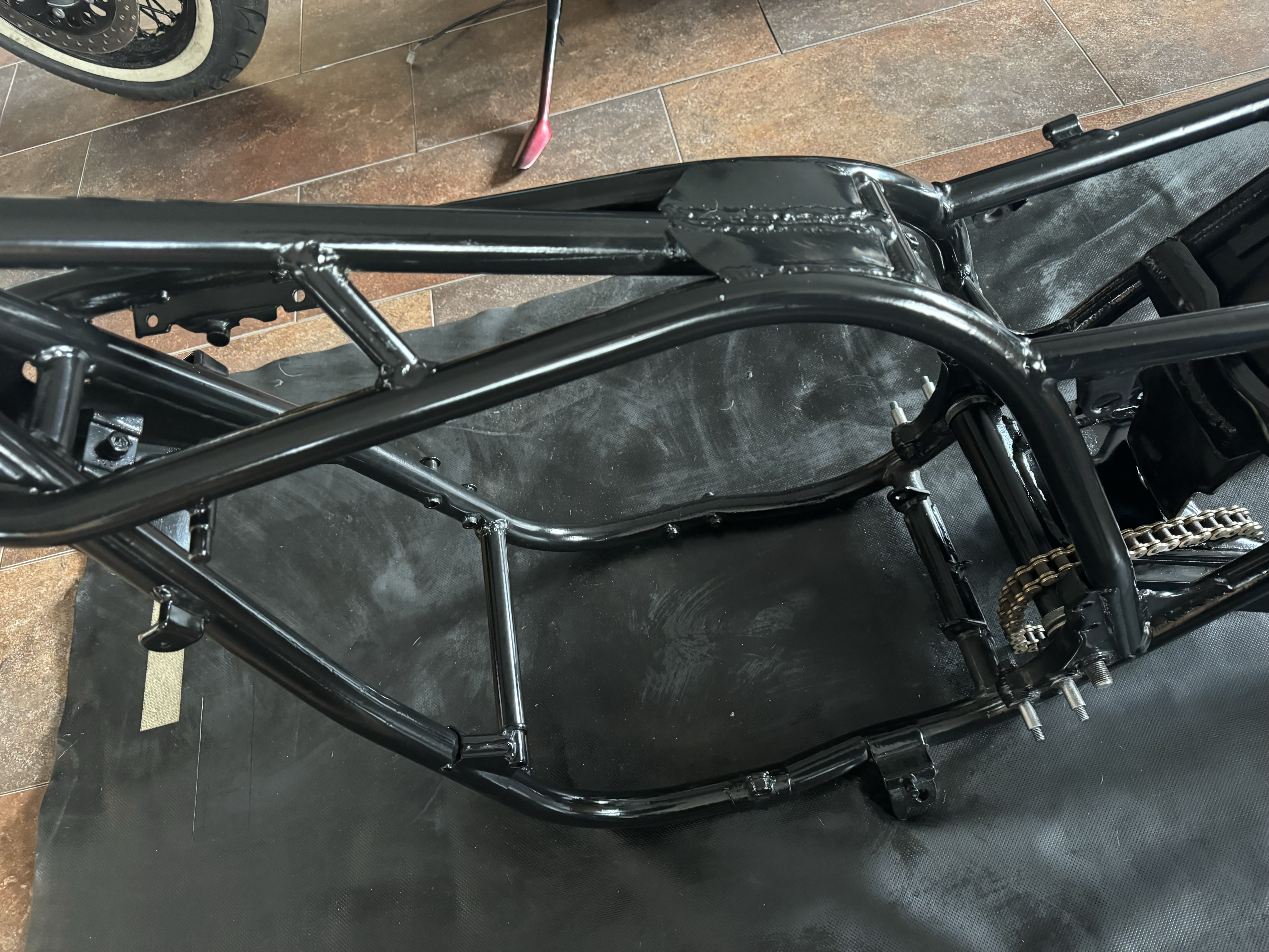

Bought a subframe off a scrapped bike and did a transplant and have been sitting on that saved frame for over a year and a half.

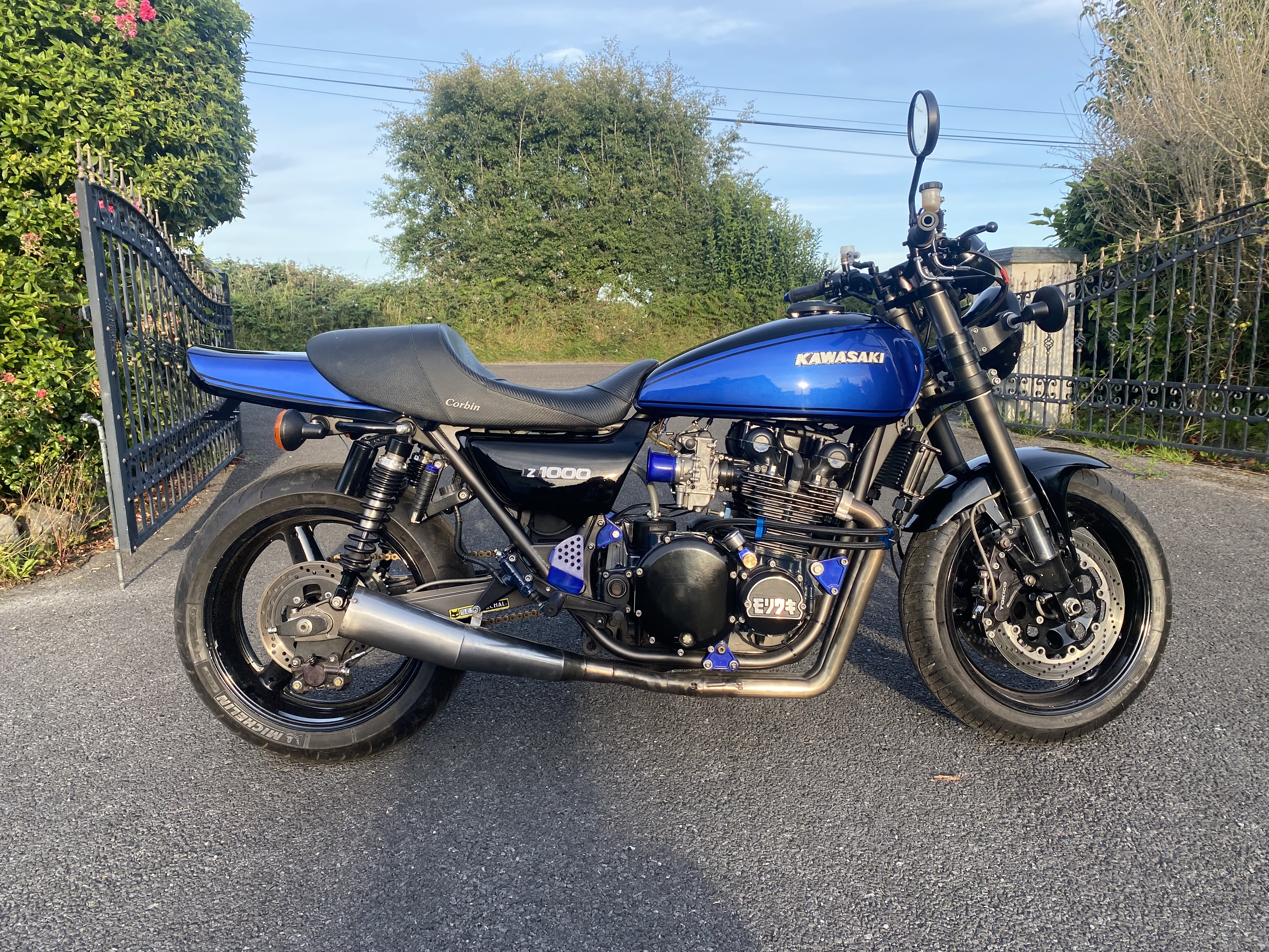

Over the tail of the covid holidays i set about sorting out the "phoenix" and as the onion layers were peeled back so was how she looked, finished her off last year and took it for a few spins but never got around to insuring her so she got garaged.

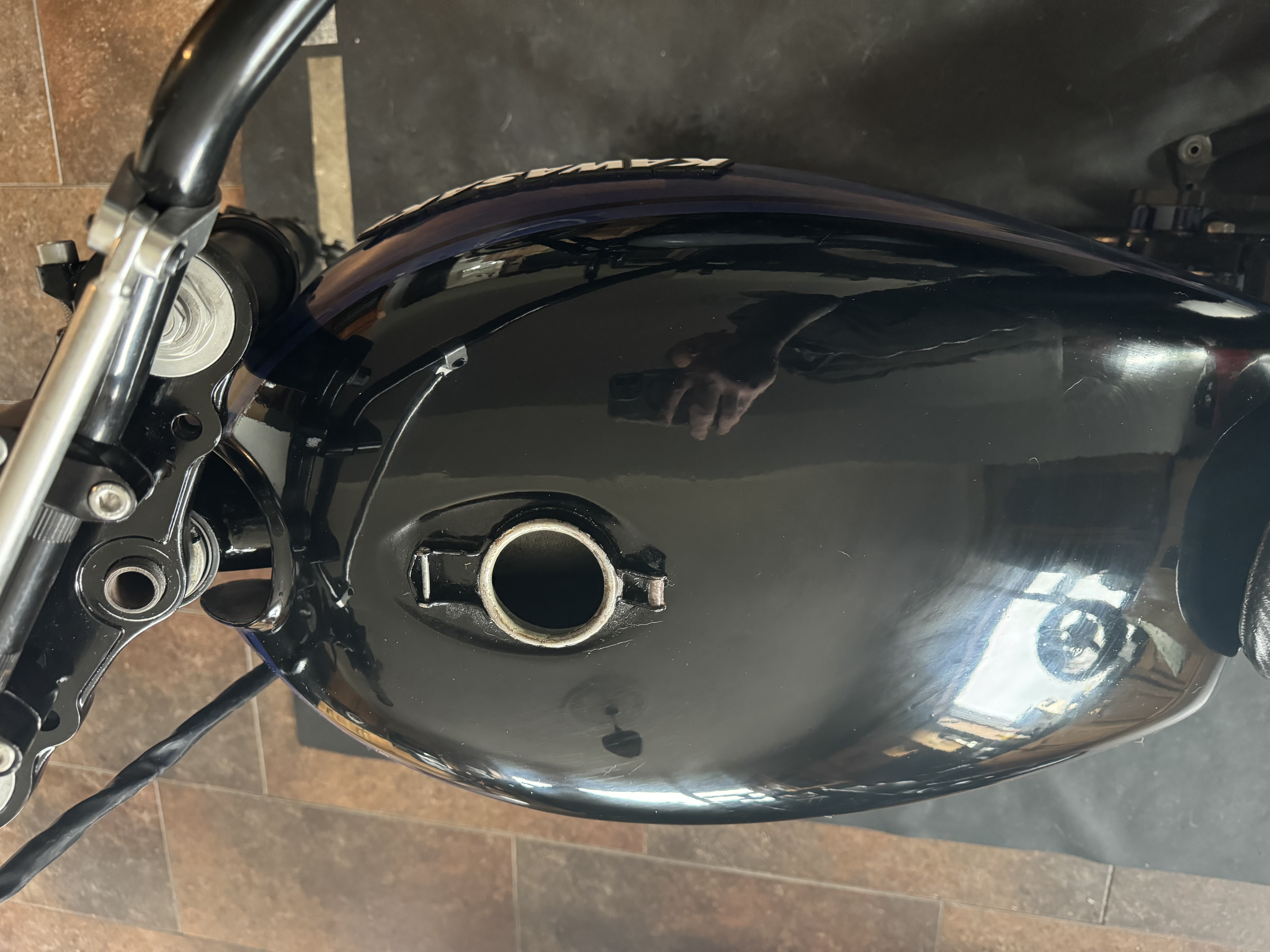

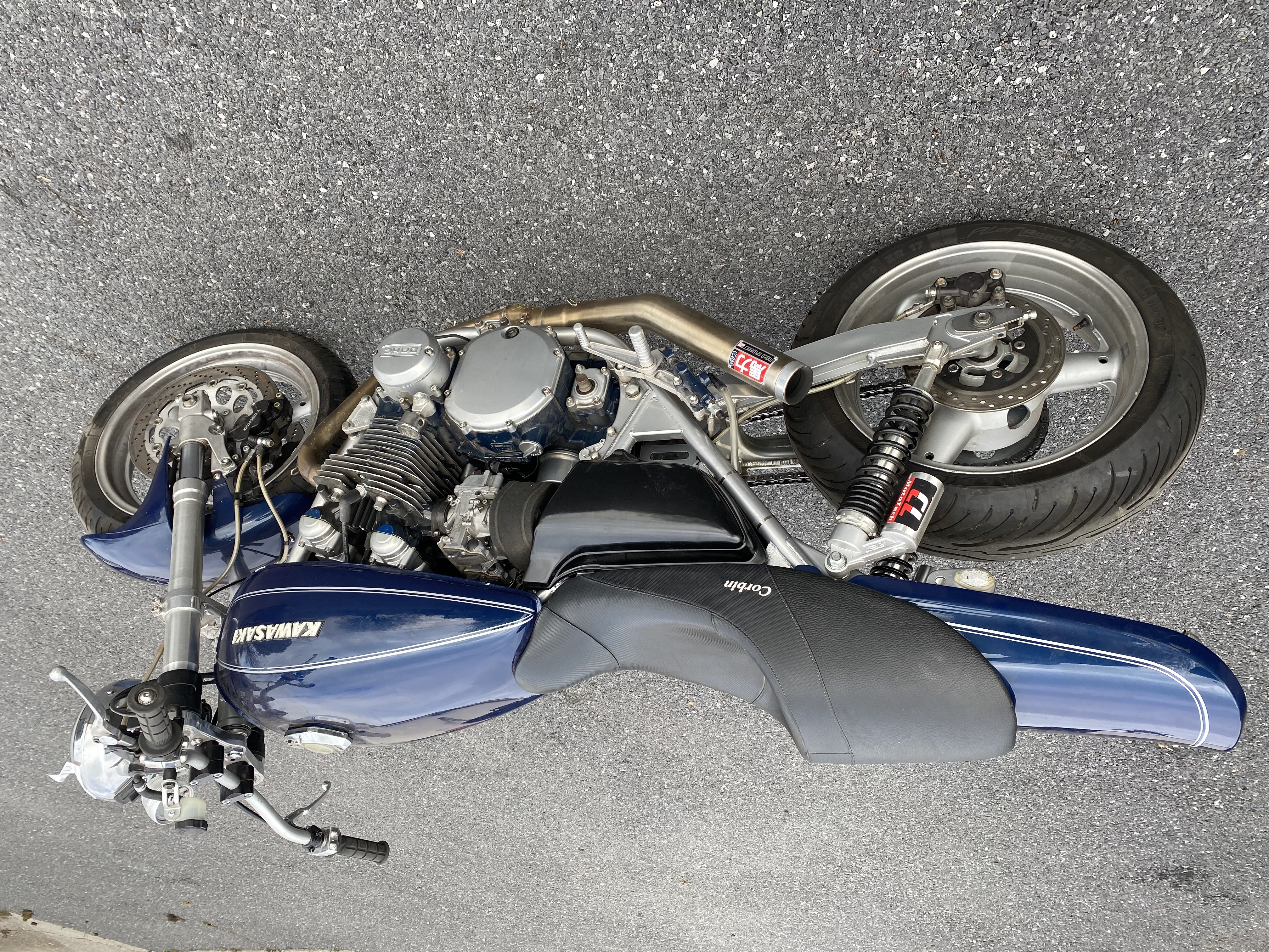

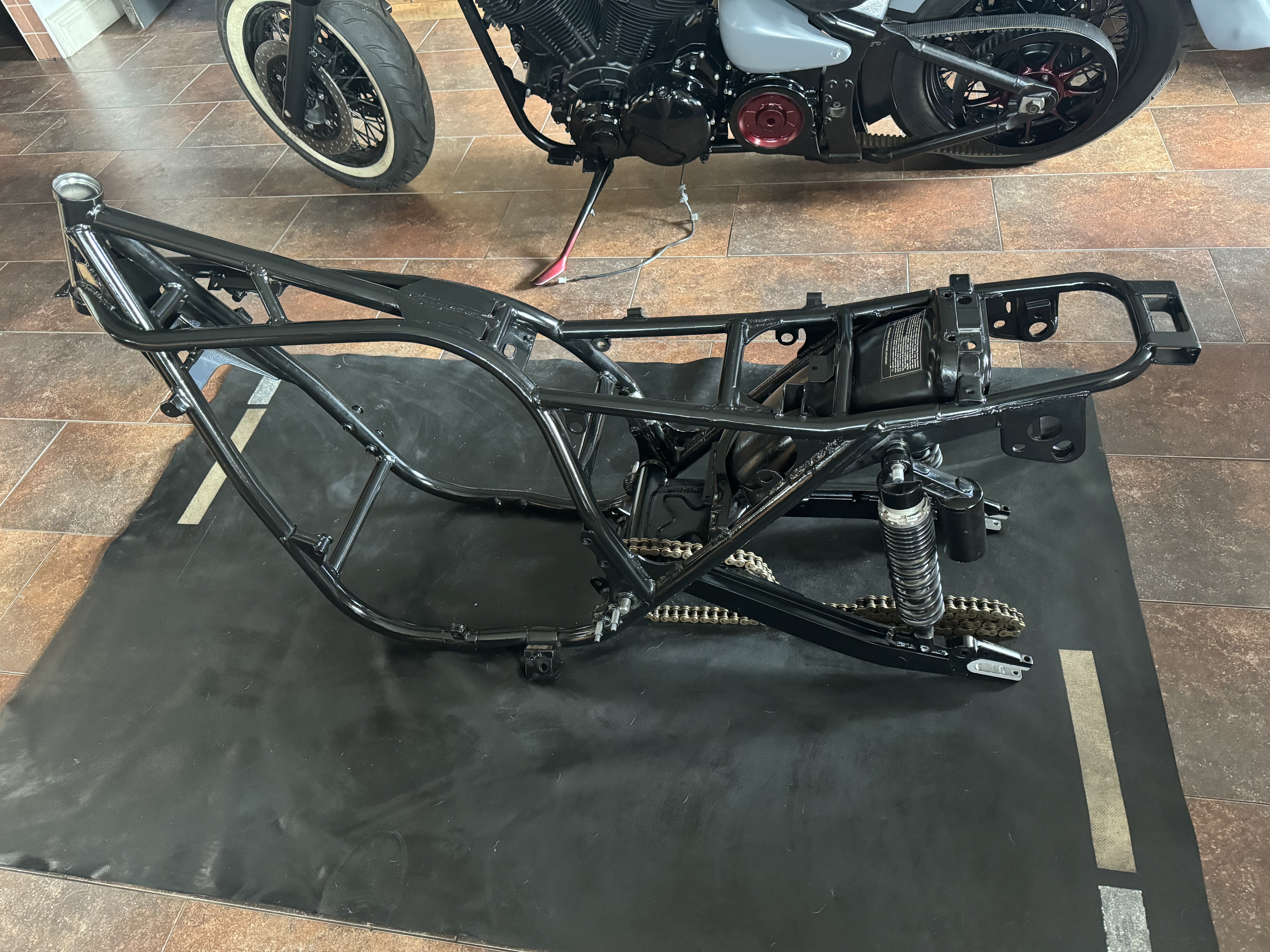

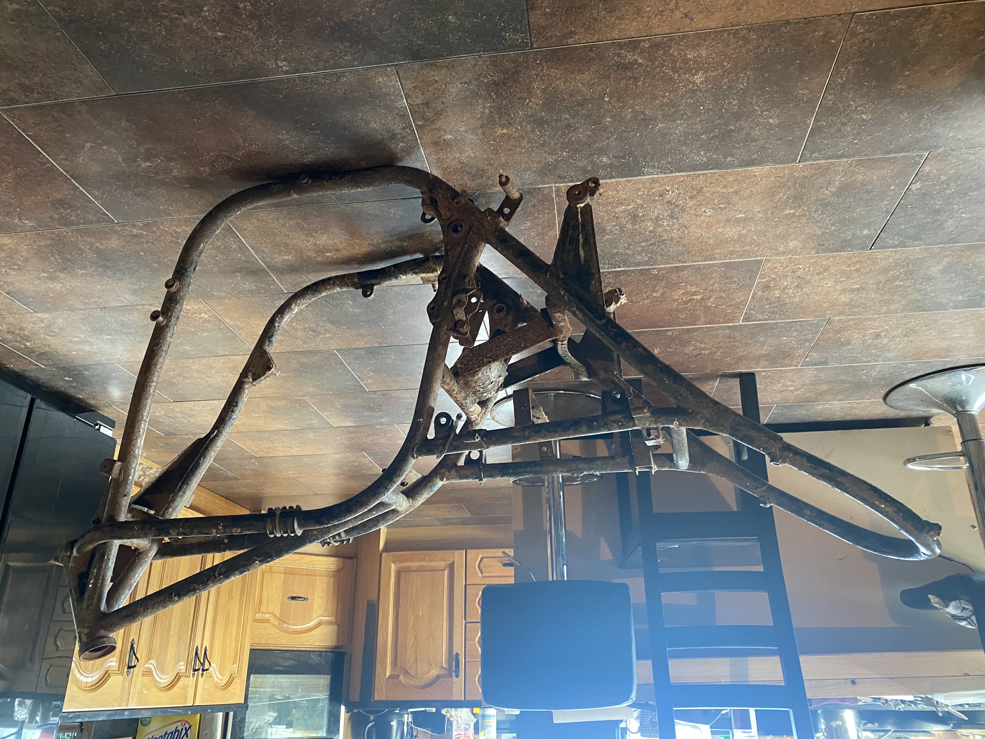

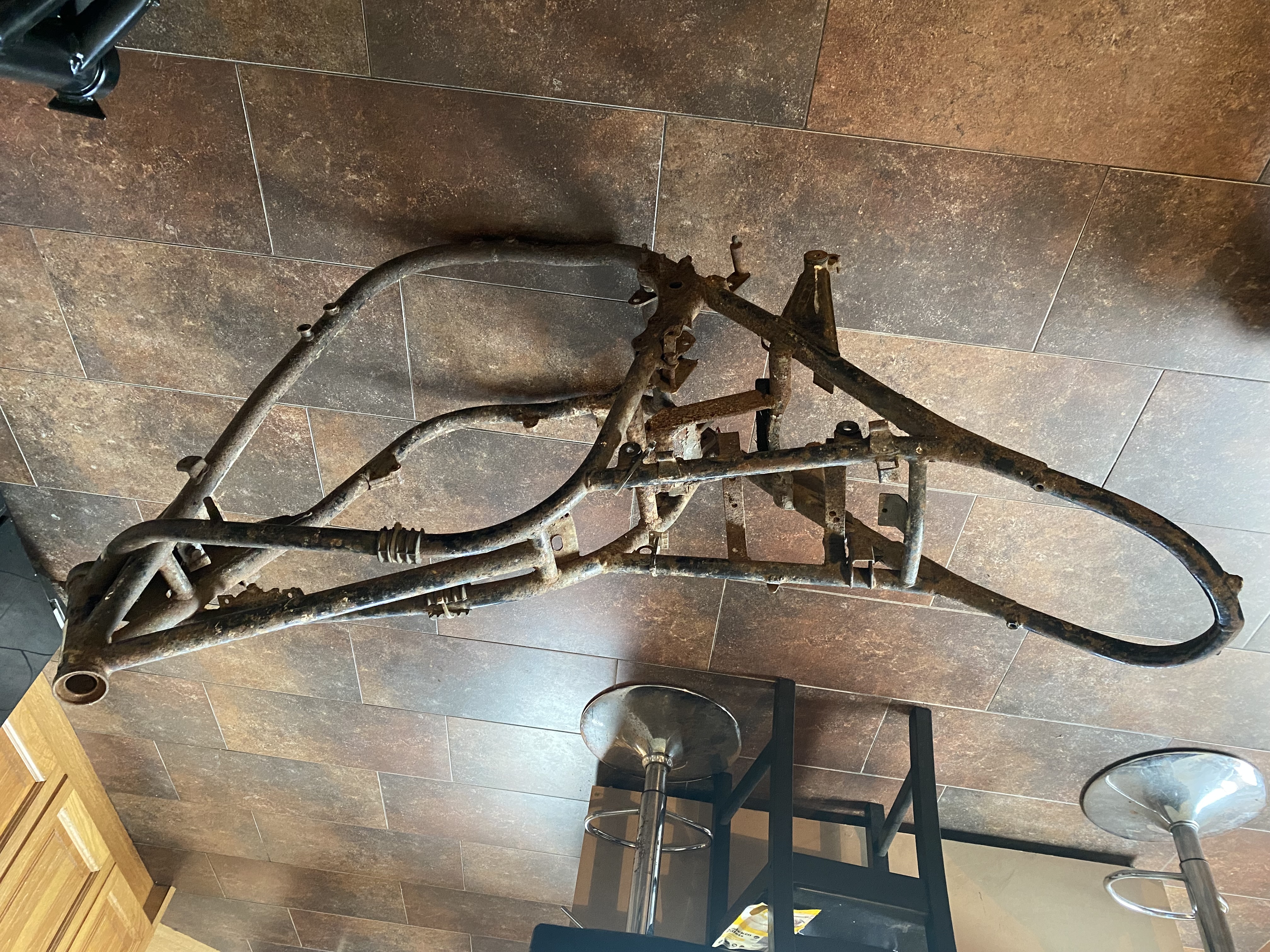

So the plan is to move everything from the 77 A1 "phoenix" to the 78 A2 frame and build the 77 back to a stock.."ish" bike. The 77 frame is braced and hacked a bit so ill redo all the weight loss to get her back to a sense of herself. But..the 78 first, the work began this week and this is the 78 as she stands now.
Posts: 1044
#8 PostAuthor: Z1streetfighter71 » Thu Feb 27, 2025 10:15 pm
Excuse the kitchen photos but the workshop is full of other projects and cold... More to come.

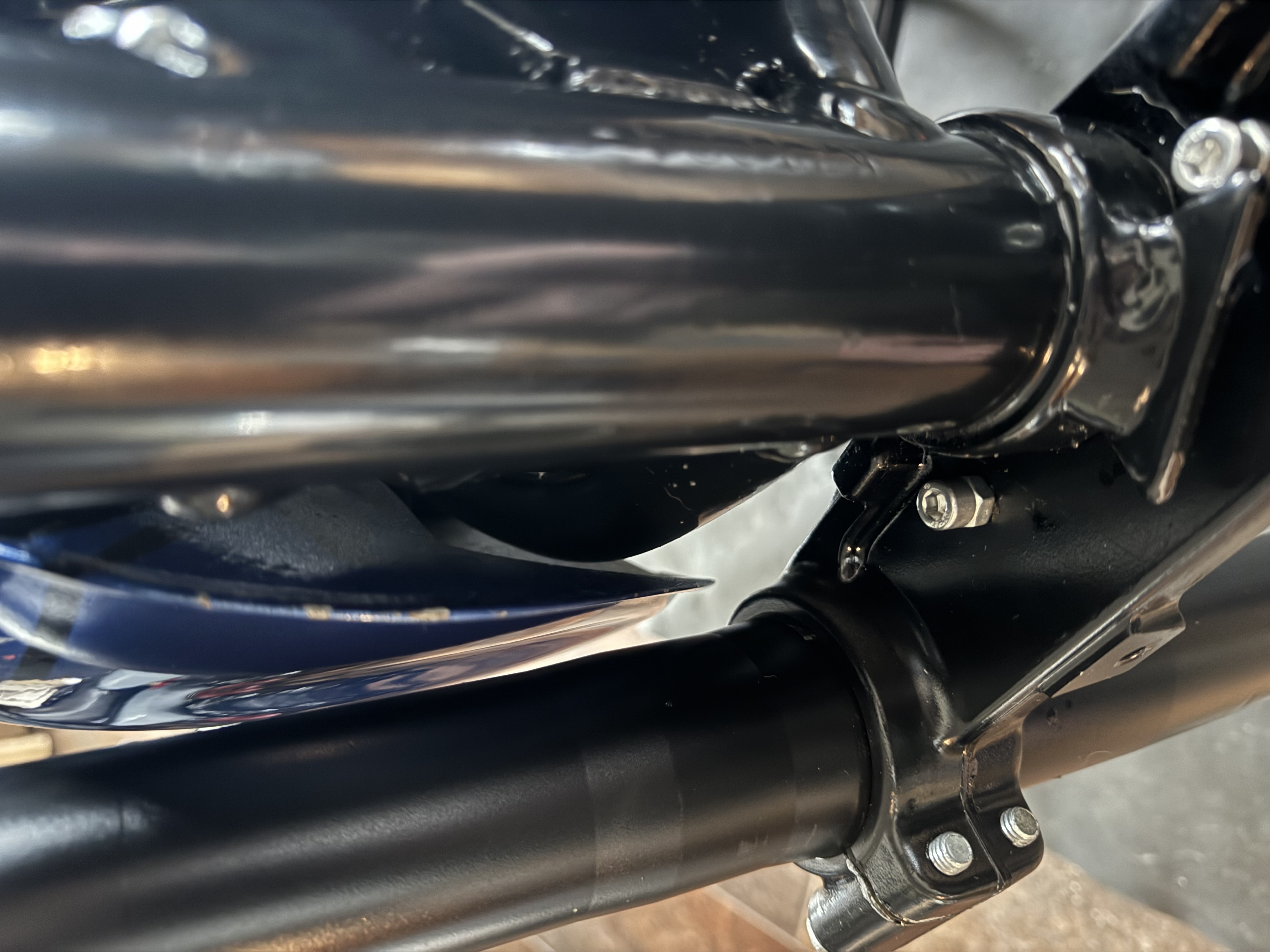

[/quote]are you using the same yokes with the limited lock or going for more offset ?[/quote]
Iv made a fair few modifications to insure full lock, ill post the pics if i get the fork on tonight. Not a lover of a bike that cant turn properly ... :D
Posts: 1044

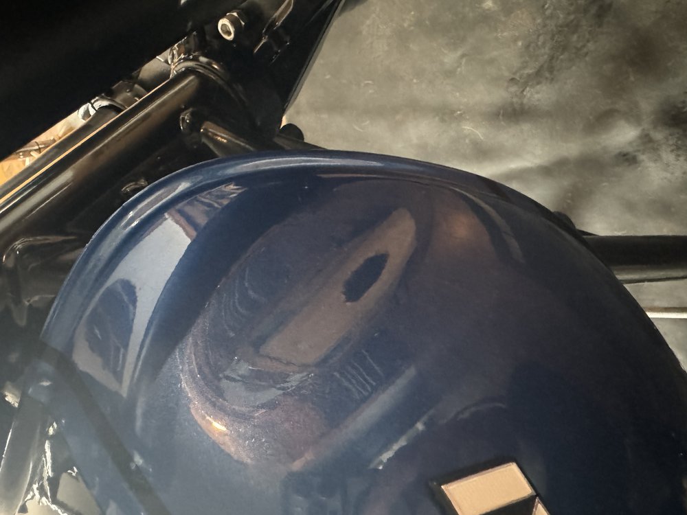

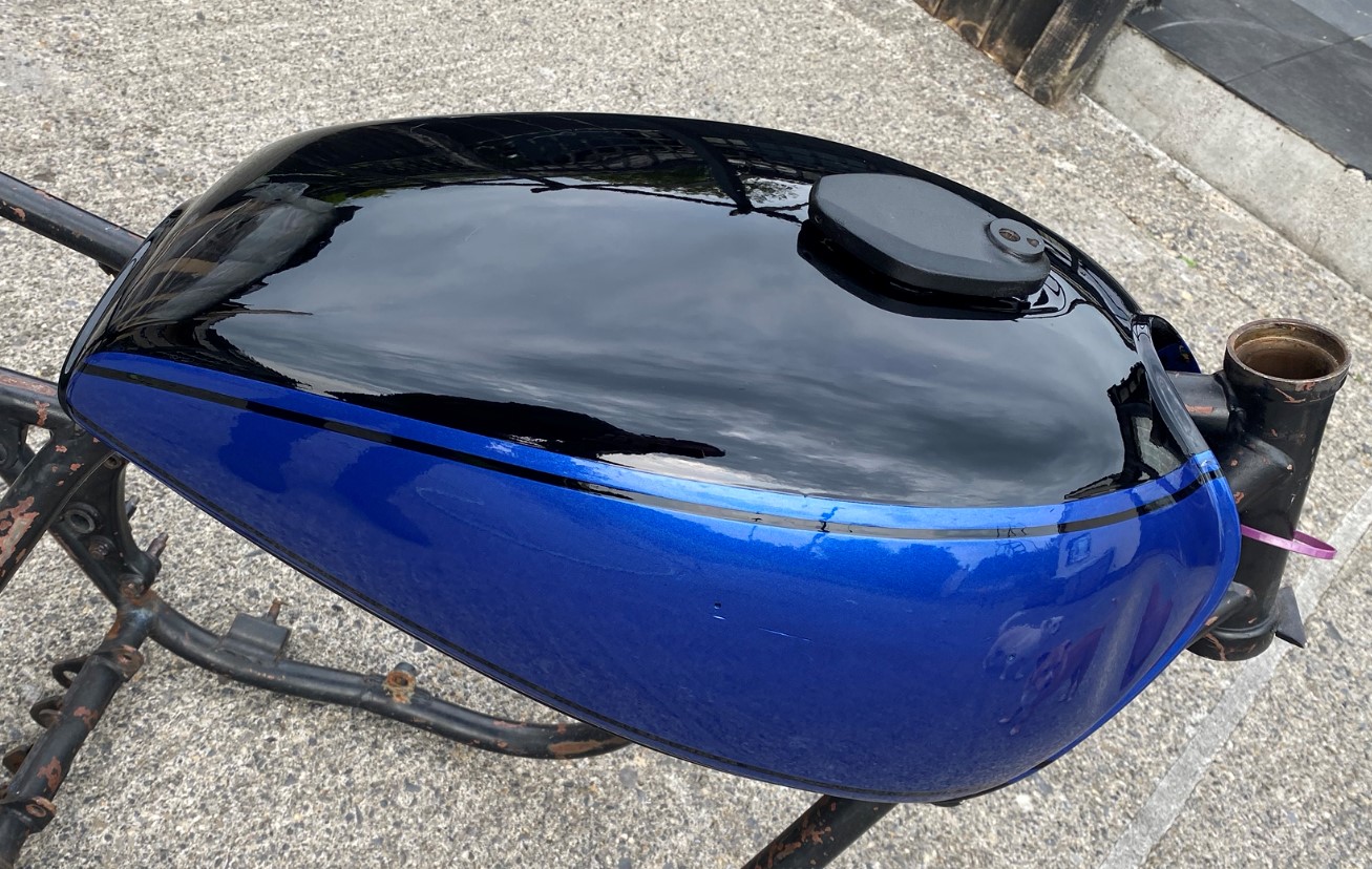

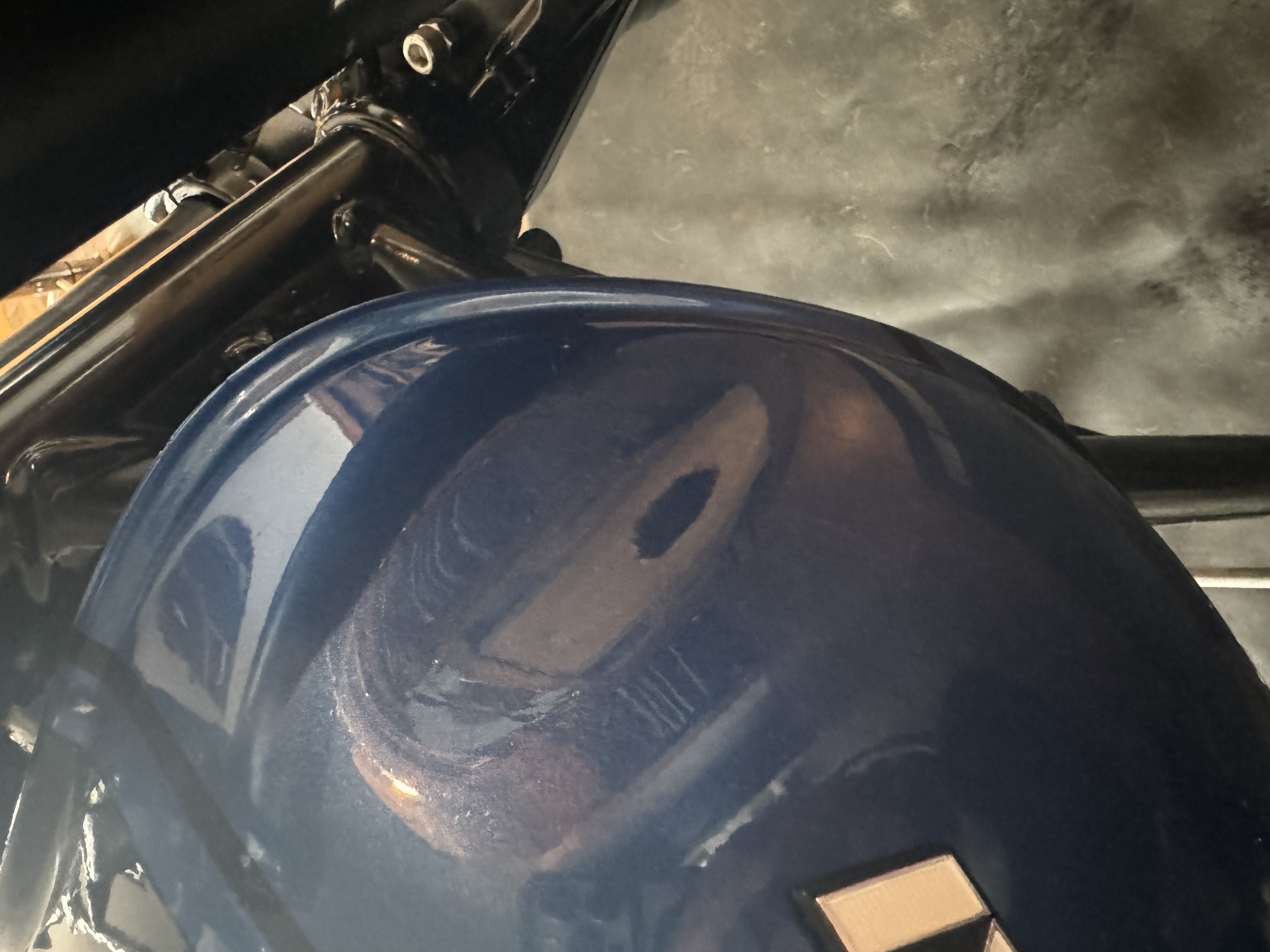

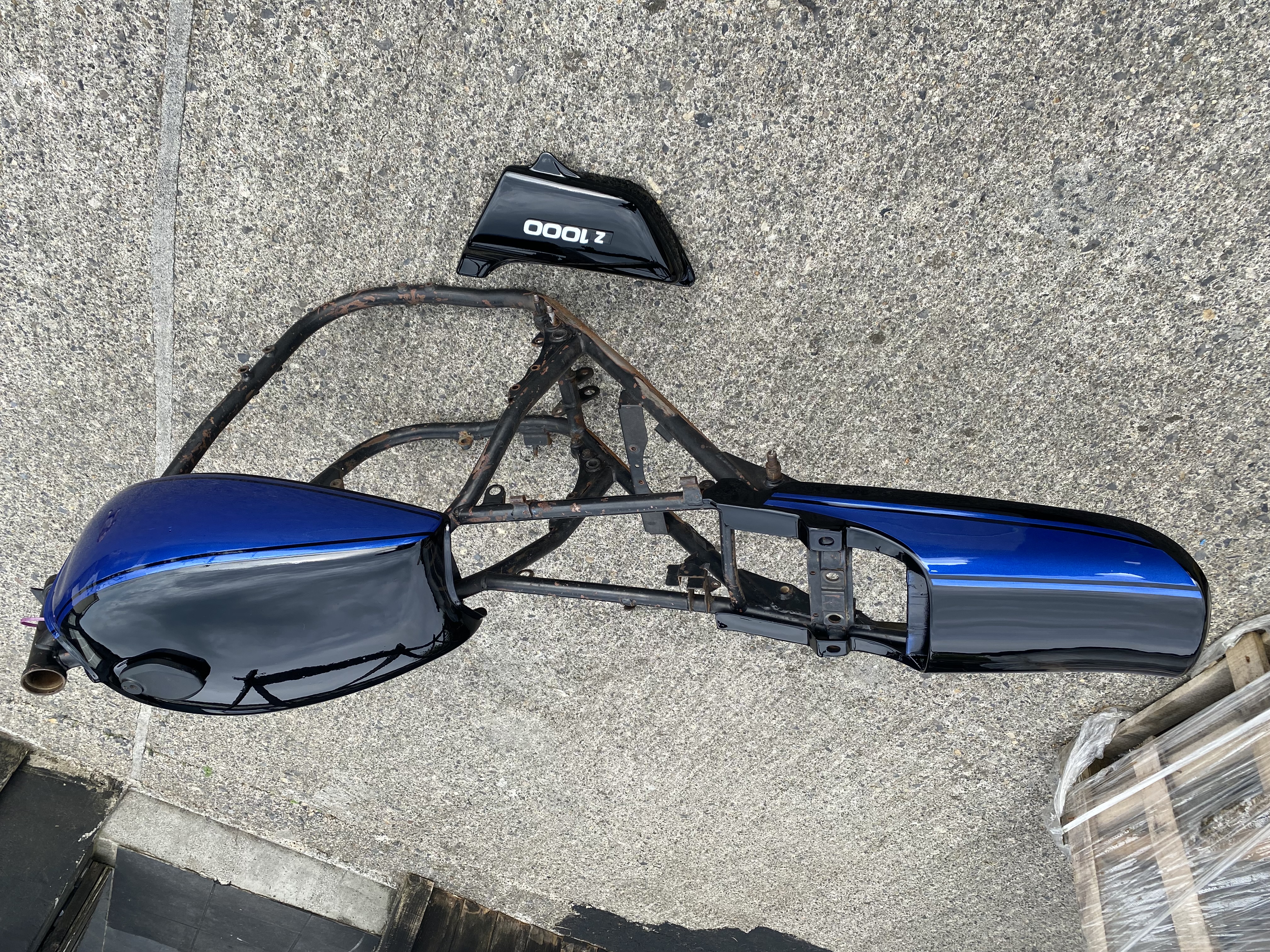

#13 PostAuthor: Z1streetfighter71 » Sun Mar 02, 2025 11:27 am
Here we go Hard Road, so the tank is dimpled which was done last year, on full rotation the forks are around five mil from the dimple in the tank. If the dimple wasn’t there, there was no way I would’ve got full rotation in fact on the original bike it barely moved a few degrees left and right. The setup gives me close to full rotation that you would get on a standard bike.
Posts: 1044
#14 PostAuthor: Z1streetfighter71 » Sun Mar 02, 2025 11:37 am
The dimple is fairly hard to see and the paint job i did is to hide it in the blue, the paint scheme is a nod to the blue z1000 A1. Here it is after clear coat last year, you can just about make out the dimple.

#15 PostAuthor: Hard Road » Sun Mar 02, 2025 3:49 pm
that idea crossed my mind on another Zed i built, but for me just knowing the dimple was their would do my ed in :?? for me the tank has to be perfect, but if it works for you then spot on mate, :wink:
