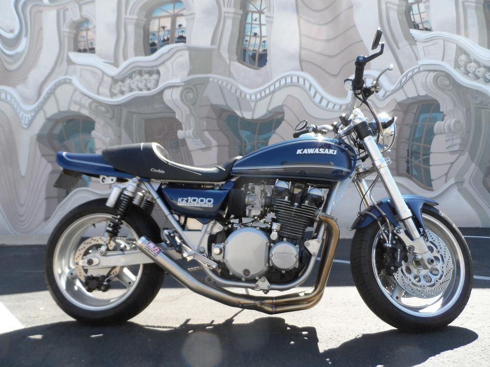

This has been in the brew for a while now. Around the tail end of covid lock down i was on the PC fairly early one morning. Fella name of Jon in California was on at the same time over in the states on a US version of this site. He posted up that the first interested party who would be keen to buy his fairly well know bike the "phoenix" for $2500 could have her. Turns out on her maiden "ride out" he came a cropper on her and his pregnant wife to be was none to happy. I remember the build thread and jumped at the chance regardless of how much it would cost to get her all the way to Galway. This was her just after "completion" and ill use that term loosely..
Re: A tale of two Z1000's
Posted: Thu Feb 27, 2025 9:48 pm
Author: Z1streetfighter71
Anyways about 4 months after paying the sale price of $2500 i got her back to Ireland after paying just a tad over the price i paid to buy her to get her back..So $5000 to the door. She was fairly bate up. The crash happened because the forks used were way to short, Typical slap on a pair of GSXR forks and away you go..Plus the turning radius was tiny. Long story short on a long ride he was fatigued, went to avoid hitting his mate in front of him, grabbed a handful of front brake and turned, bike bottomed out and locked in the left turn. Basically flipping the bike.
