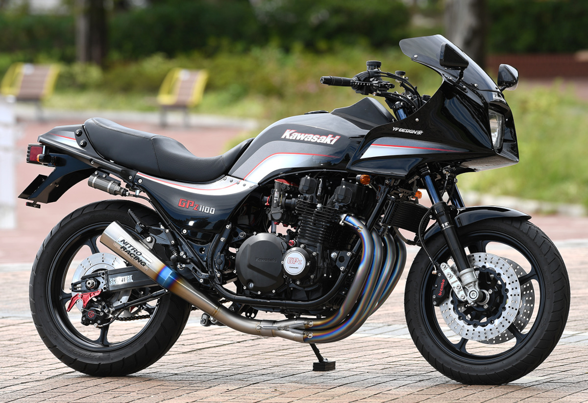

Something like these

#12 PostAuthor: Sifu » Tue Dec 30, 2025 4:01 am
That’s very nice

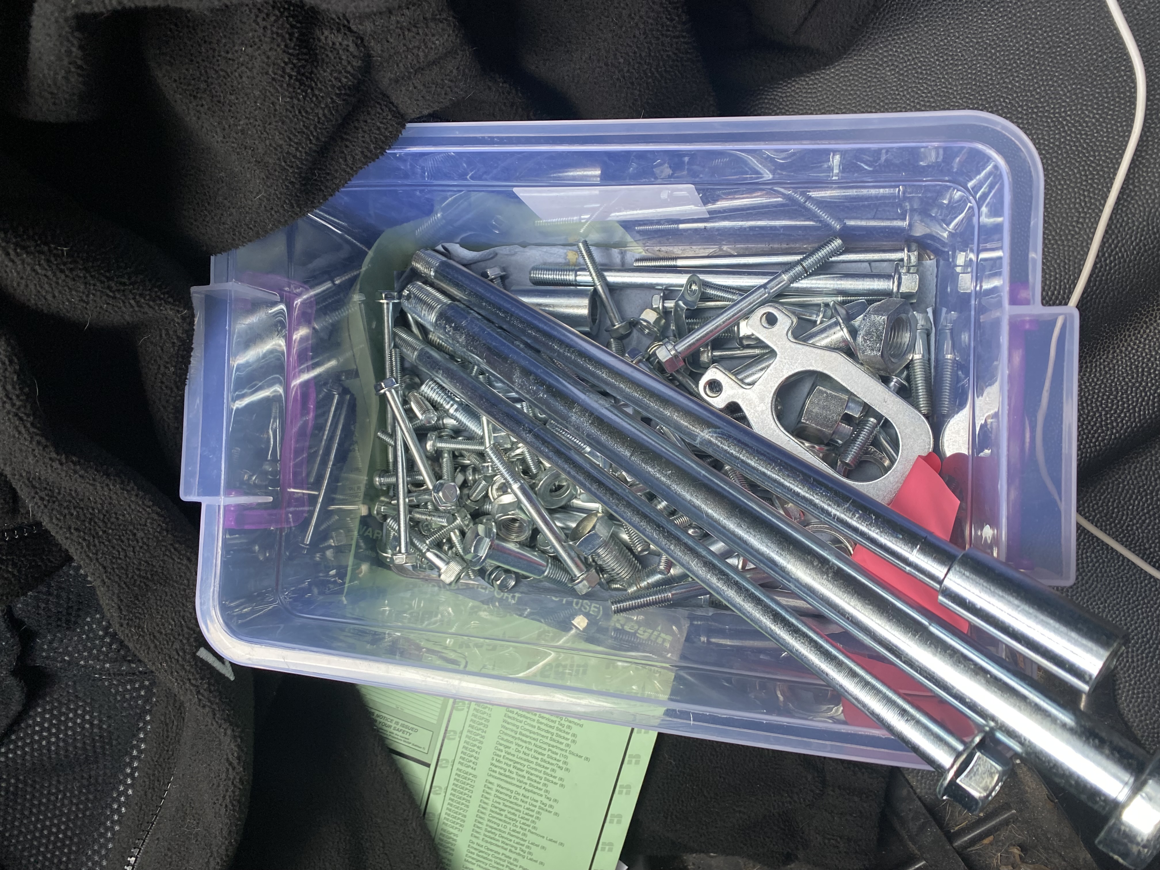

Getting ready to close up the bottom end, I’ve got to get the fastners plated first so im going through them and find these 2 m8x80 i think they are for crank support what is the wasted part for (where do these go?)

#14 PostAuthor: DeadZedDave » Wed Jan 21, 2026 10:34 am
If my memory is correct, the 2pcs. M8x81mm bolts go in the lower crank case on the ignition side - first pair inboard of the ignition housing mounting face. The "wasted" design is used widely in engineering and often seen in automotive application. Type "Wasted Bolt Design" into your search engine and you can read all about it. Suffice to say its for engineering reasons.
