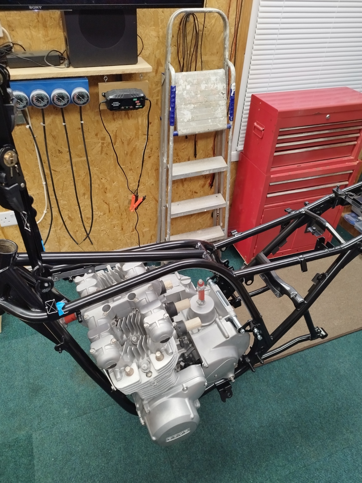

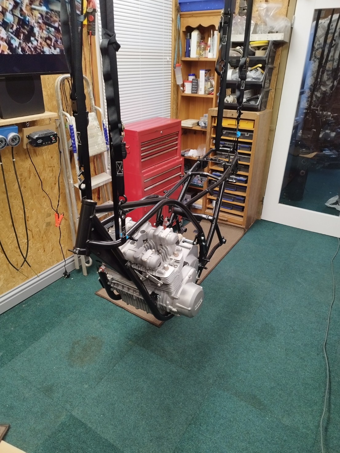

Ground up build of a slightly knackered z1000. Intention is to build to remind me of my youth, which was some time ago, to what I would call old school modified. Period parts to be sourced.

Solid start! Period factory parts or Period performance parts?

Carpet tiles in the workshop very posh

#4 PostAuthor: pegleg » Mon Dec 01, 2025 6:59 pm
Period performance. The sort of stuff we used to do back in the seventies. Lots of stainless, Harris, Seat, oil cooler, to name a few.

#5 PostAuthor: gray » Tue Dec 02, 2025 6:33 pm
braced frame was a worthwhile period mod, especially if you're going to try and add power but looks like it's too late for that now. sorry to piss in your chips.

#6 PostAuthor: DeadZedDave » Thu Dec 04, 2025 3:08 pm
It'll be good to see an old school 70's style Zed !
So many get "restored" these days.
I for one don't remember ANYBODY riding about on a STANDARD Zed back then. It was part of what owning a big Zed was all about !
Good luck with the build !

#8 PostAuthor: gray » Sat Dec 06, 2025 7:55 pm
I know you can get kits of thicker engine mount plates - that would stiffen things up , and would be easy to add at the stage you are at now.

#9 PostAuthor: gray » Sat Dec 06, 2025 7:56 pm
+ box section swingarm.

#10 PostAuthor: pegleg » Sat Dec 06, 2025 11:32 pm
Bracing was considered but i am an old fart now so a bit more cautious how I will ride . Been 4 years since Ive been on a bike so sensible head will prevail. Metmachex swing arm ready to go in.

#11 PostAuthor: DeadZedDave » Sun Dec 07, 2025 11:00 am
A word to the wise maybe but take care when you first fit your Metmachex swinging arm, especially if it the less common shallow braced style - the rear frame / footrest / exhaust hangers on the type of frame you have can produce clearance problems. Nothing which can't be sorted out but all too easy to put a bad scratch on a nice polished alloy swinging arm. As for frame bracing - nice to have - always important in the pub on a Saturday night - but probably 99% of all of the Zeds you ever saw back in the day managed to get along the road well enough without it :D
