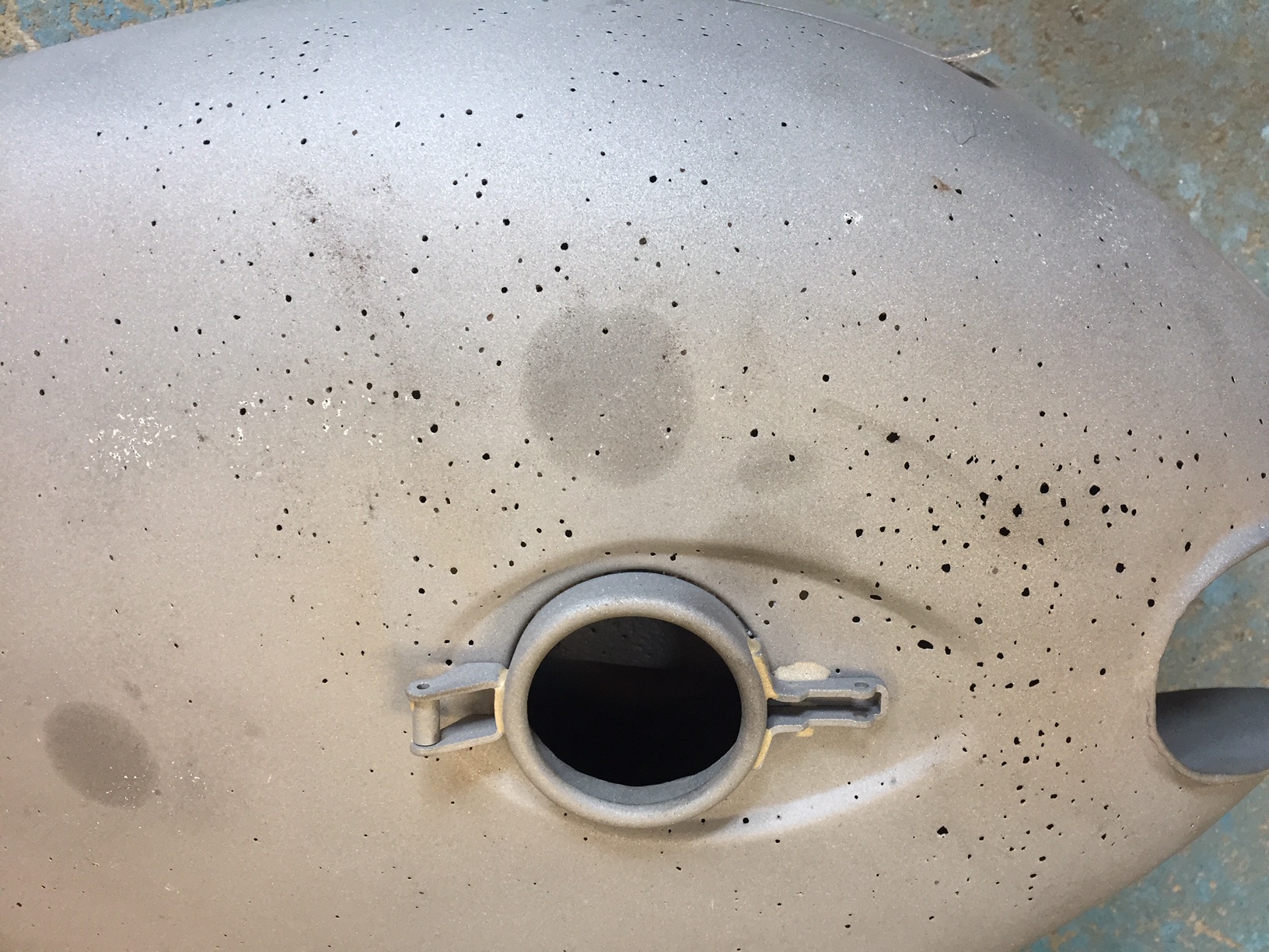

I was about to send the paintwork off for a respray when I had second thoughts on the tank so just for good measure I had it blasted. OMG what a mess ...hundreds of pin holes in the top and the curved bit underneath which fits over the frame tube. Amazingly the bottom was virtually hole free and it might have patched with a good coat of epoxy liner and some filler but did I really want to risk a (at some future date) £20k bike under a leaky fuel tank. hmmmmmm.....NO. dk came to the rescue with a nice one (albeit a Z1a) so now just need to get the badge mounts modded.

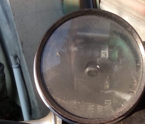

Following my last post here is a pic of the original tank and the sad state of the speedo ! The drive connection on the back had come loose and wrecked the internals. Despite this I am on with restoring it..with the correct face!

hi Craig, happy to hear the manual is well received :lol:, the speedo reminds me of triggers' broom... or it will once it's done. i recently sold one to a member for his project. the tank is a bit of bad luck but it sounds like you'll sort a replacement ok. i too love the last pic:it could have been taken in the late 70's. well done so far. m

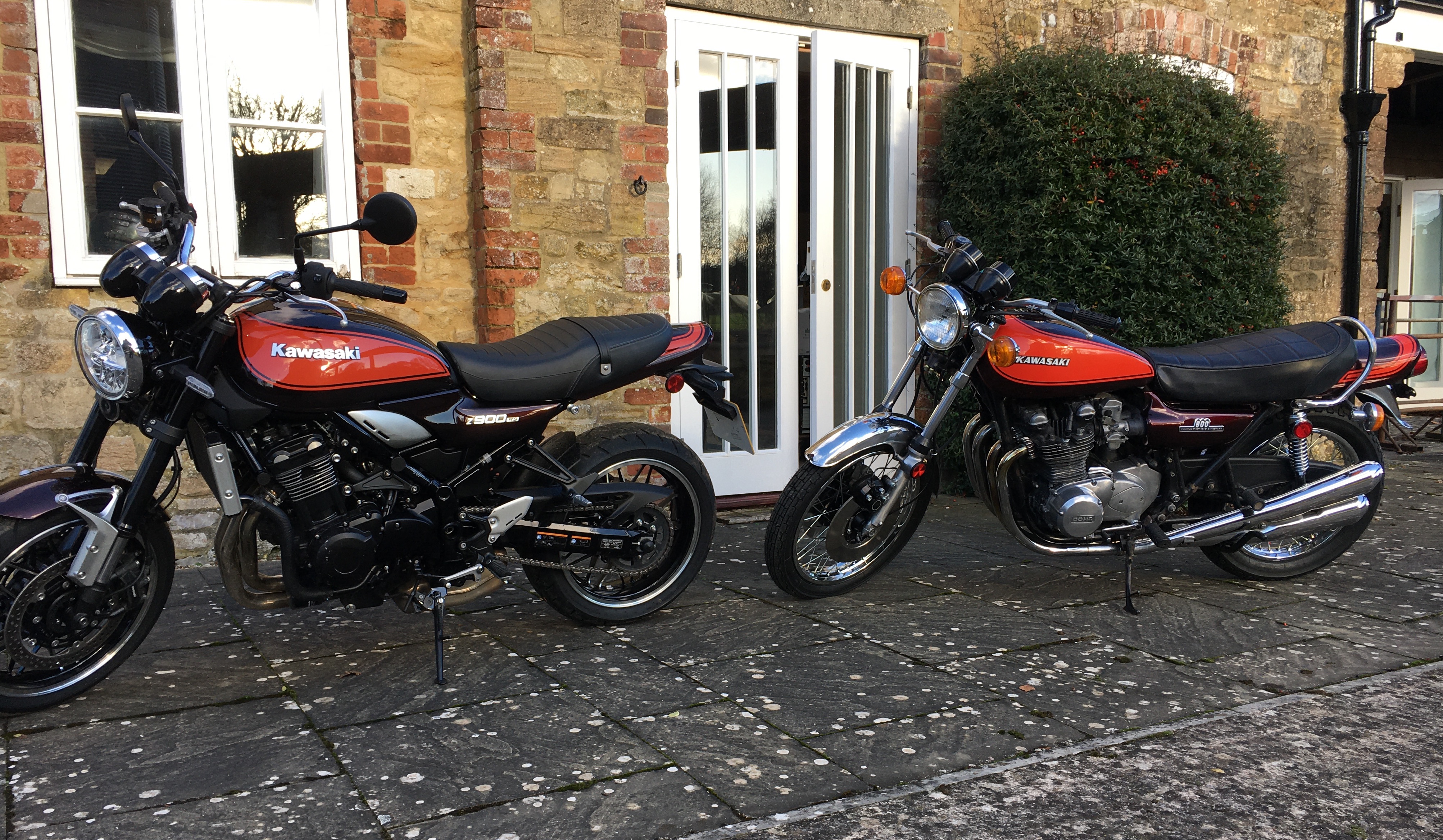

Anyway, Father Christmas brought an early Christmas present (900RS) so though I had better have a pic. of the old and the new.

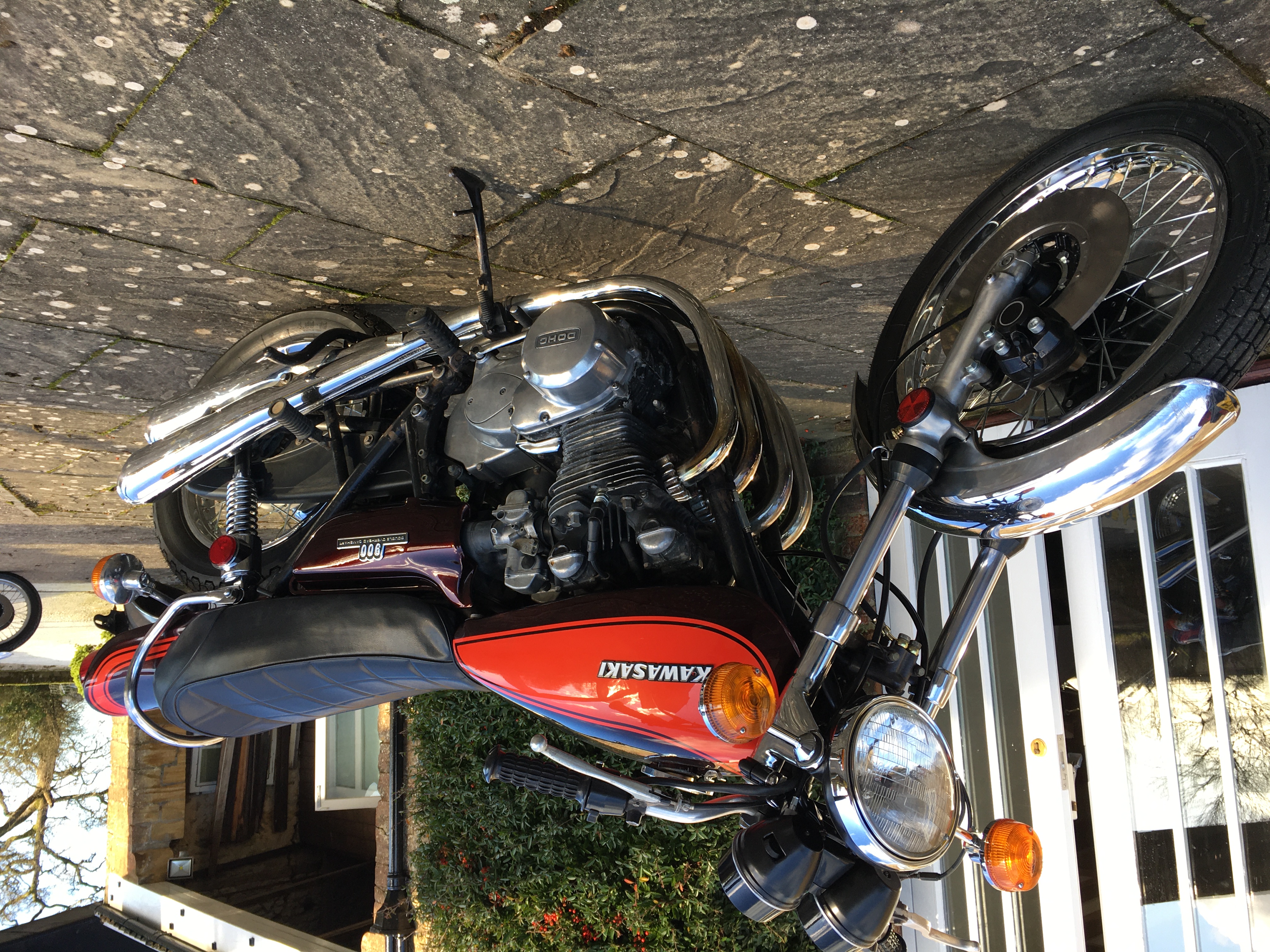

The Z1 is more or less "corrected " now. Front end has been replaced, wheels rebuilt, clocks rebuilt and electrics overhauled and of course paintwork. It was quite hard bolting spanking shinny parts to a grotty old frame but I wanted to keep it mobile. To finish it off fully it needs all the black parts doing, accessories chroming/plating and the engine either tidying up or rebuilding...I haven't decided which as it actually runs quite nicely.
