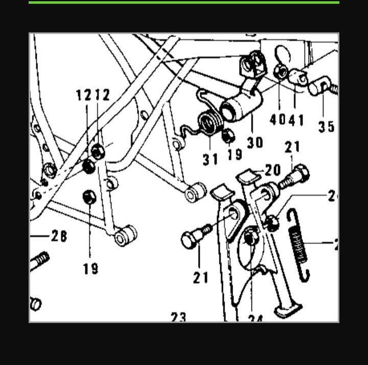

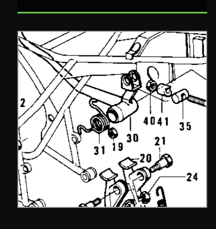

So here is the latest headache, I am fitting the rear brake foot pedal, it has a large spring that looks like one end fits into a hole, does anybody have a close up please so I can see its orientation as after two hours I have not worked it out and am trying to protect paintwork.

If your talking about a circular spring with a hook one end and a pin the other I'd guess your working on a 650?
If so it fits on the brake pivot with the hook around the pivot arm before the pivot pushes through the frame. The pin then locates into a hole on the inside of frame brake bracket swingarm side.

Its a 1976 Z900 A4, I took the pedal off myself so I know it is from the bike its just that it was a few years ago and I have no recollection how it fitted.
Thanks for the reply

https://imgur.com/a/ZSiNT0s
Thanks Warren, it looks different or am I just not interpreting the picture.
Not able to work out images but here is the link above
Thanks for your time.

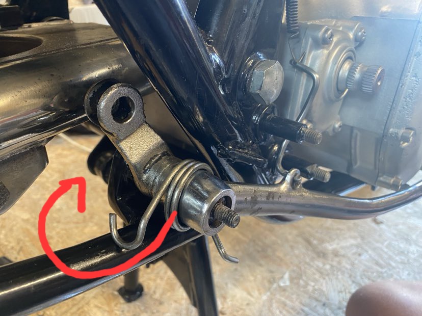

It fits on the inside of the frame. Take the pivot out, put the spring on it, put the pivot back through the frame. Ie spring fits on the inside of the frame.

Thanks for your help with this Warren, for clarity does the curly end with your red arrow wrap around the internal part of the frame and the straighter end fit into the small hole in the frame lug?
This must seem laborious but sometimes the simple shit is the hardest to work out, I imagine you are doing this -
