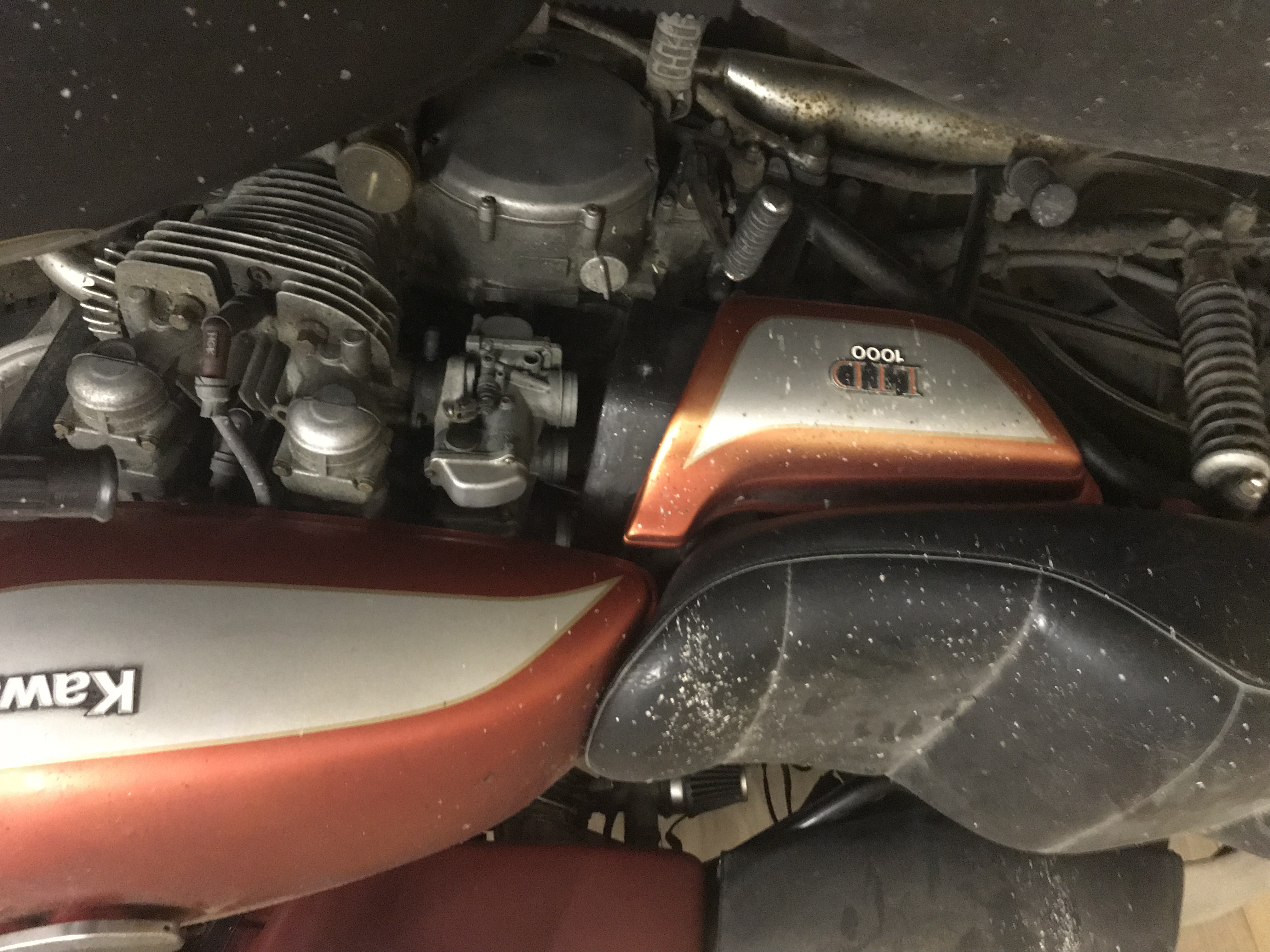

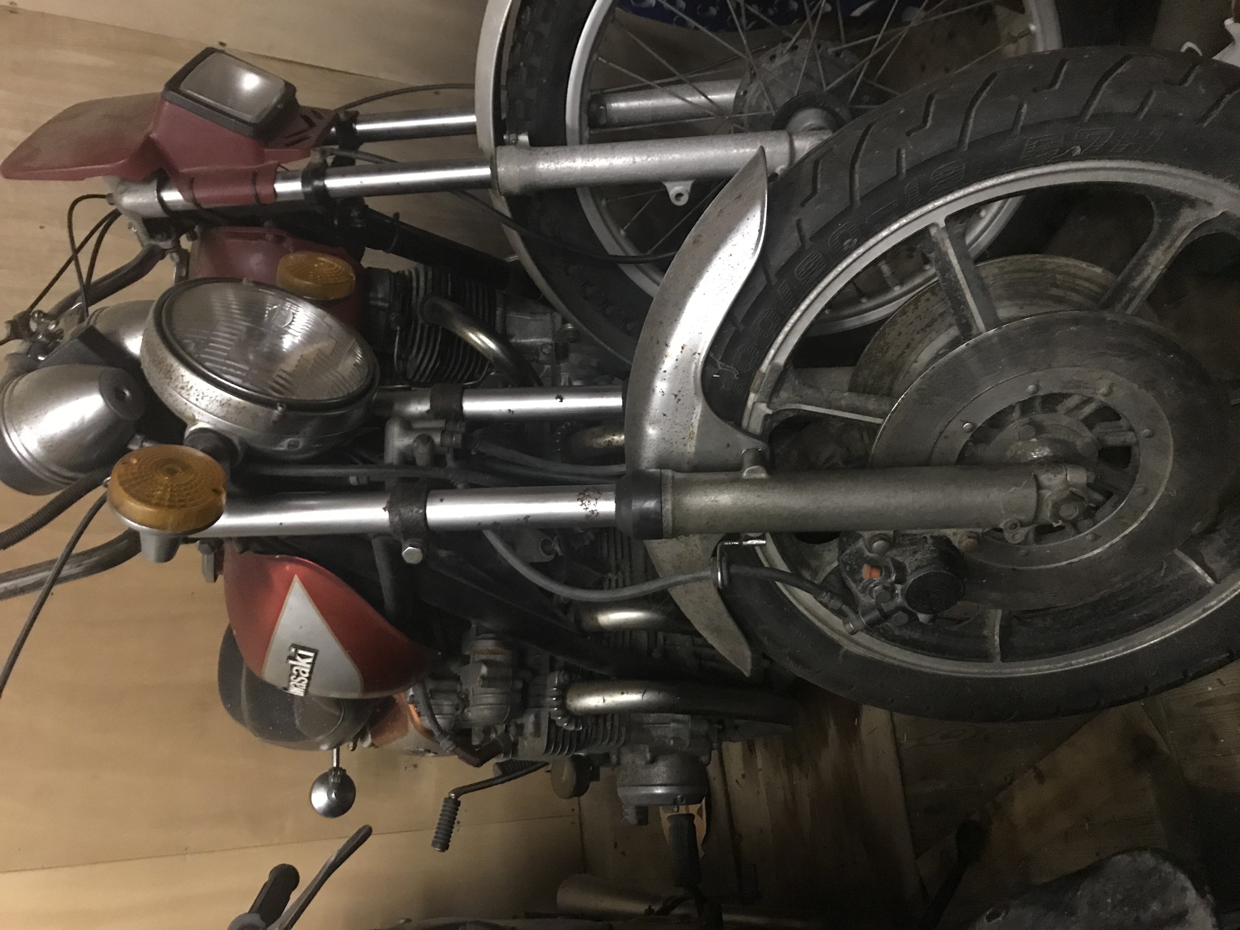

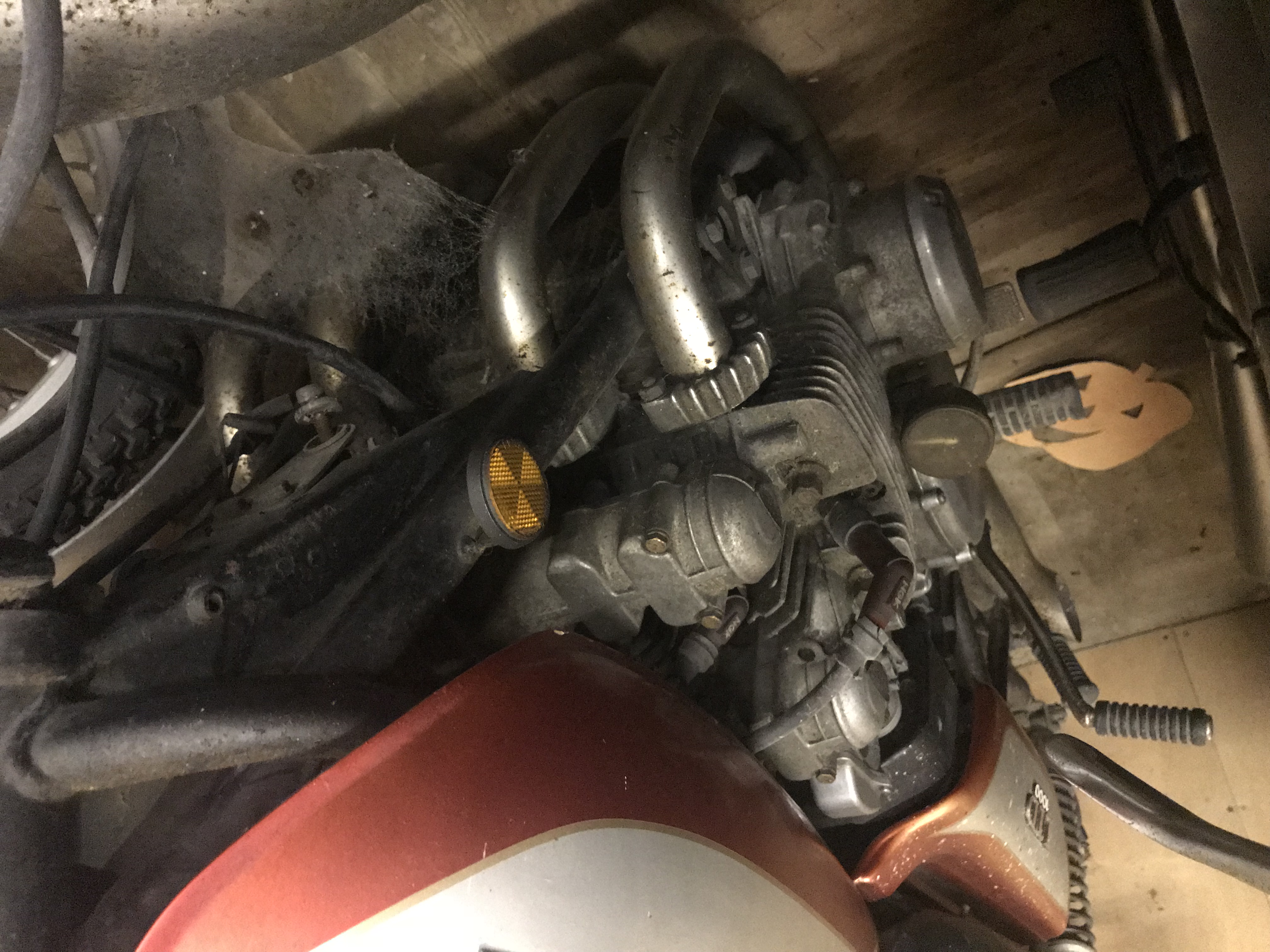

Hi Chesil
thanks for the pics! She doesn't look too bad! Get the dust and the cobwebs off, clean up the chrome bits, put a new horn, tires and intake rubbers on, change the fork oil, engine oil and the brake fluid and get it on the road again. She'll need a new battery and a tuning to perform well. Please don't let her rust away. Since there's only 10.000 miles on the clocks, go for it and enjoy!
