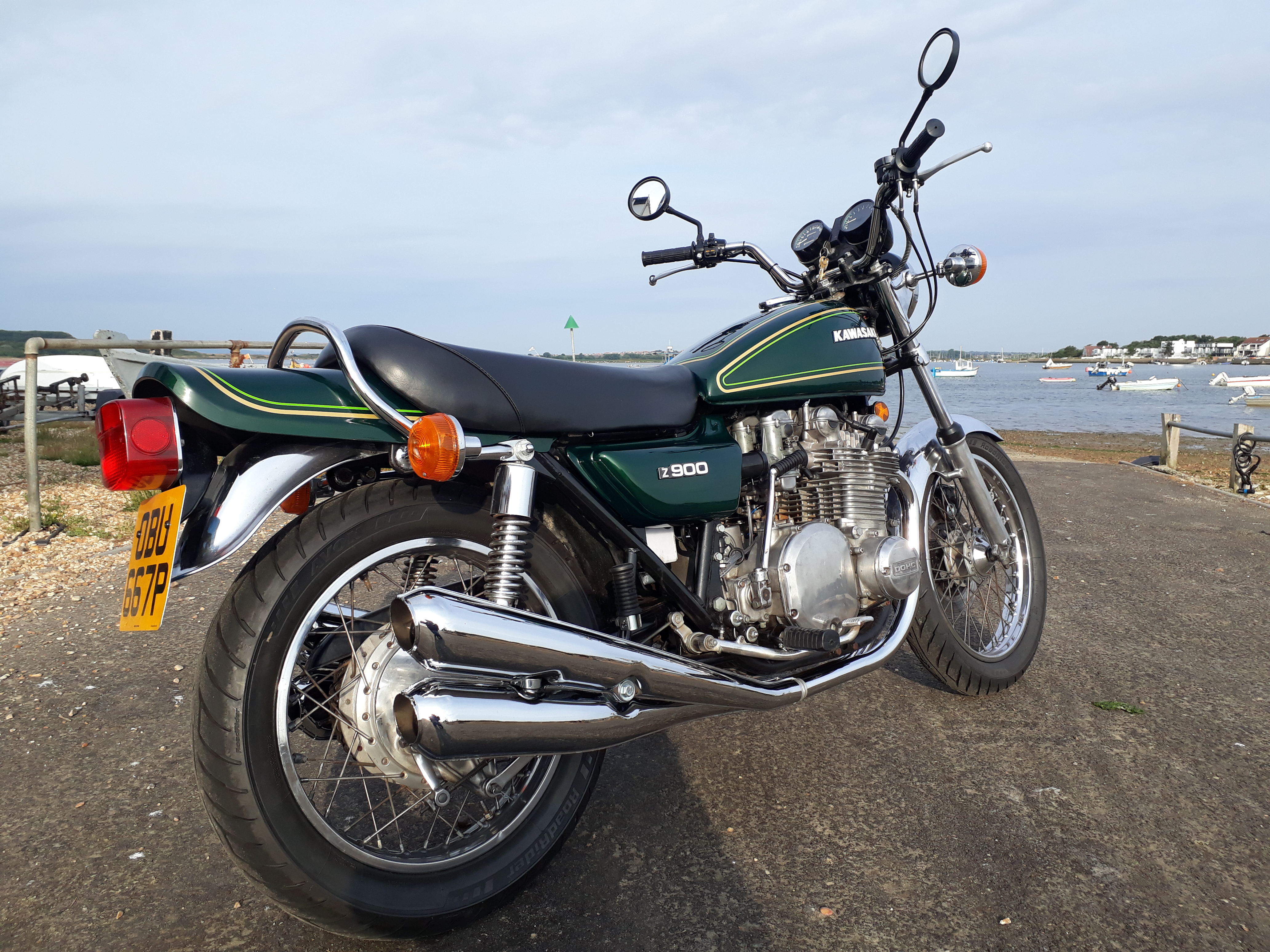

I've been on here a long time ago (over 10 years) when I had a stock kz900. Although I only had it a few years, I was quite happy with it, until I was suddenly smitten with a Jota, so the Kawa and I parted company, and after many happy times trying to hang onto the wild italian beast, I've caved in and bought another Z900-A4. It's been a very happy homecoming, and boy are they beautiful bikes.
In many ways this one's better than the last one because someone hasn't made a pig's ear of the bits they have restored, so I'm happily working my way through it. So a few questions in no particular order:
1) Carburation seems very wrong; she fluffs and pops on take-off, settles down nicely around 2,000 rpm, is fine up to 4,000, but from there onwards it's like I have one huge flat spot. So far (after reading various posts on here) I've done the low voltage feed to the coils with a relay mod, had the carbs off and cleaned each main and pilot jet, reset float heights, flushed the tank, replaced the petcock and put two inline filters in (So I'm pretty sure there's no clag in the bowls) Plug chop at 5,000 suggests mixture is fine, so I'm wondering where the issue is. There's no undue sign of wear on the mains or needles.

HI there & a Lovely looking Z9 you have there
Re: Hiya from Bournemouth
Nice z9 indeed.
That’s an odd running problem you have. You seem to have covered most of the bases in the carbs, I take it the air filter is also new and the main jet is the original spec? The low speed fluffing and popping could still be partially blocked pilot passages they are notoriously awkward to clean out and can take several attempts but it’s hard to see why it would be flat over 4000 if everything else is right. Maybe check the cam timing?
