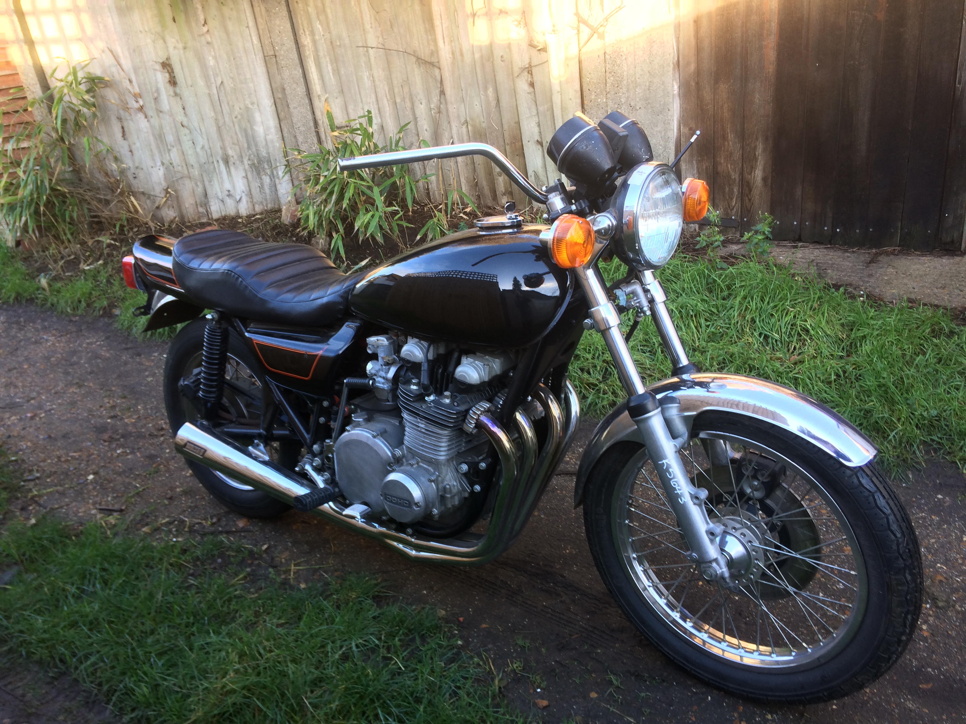

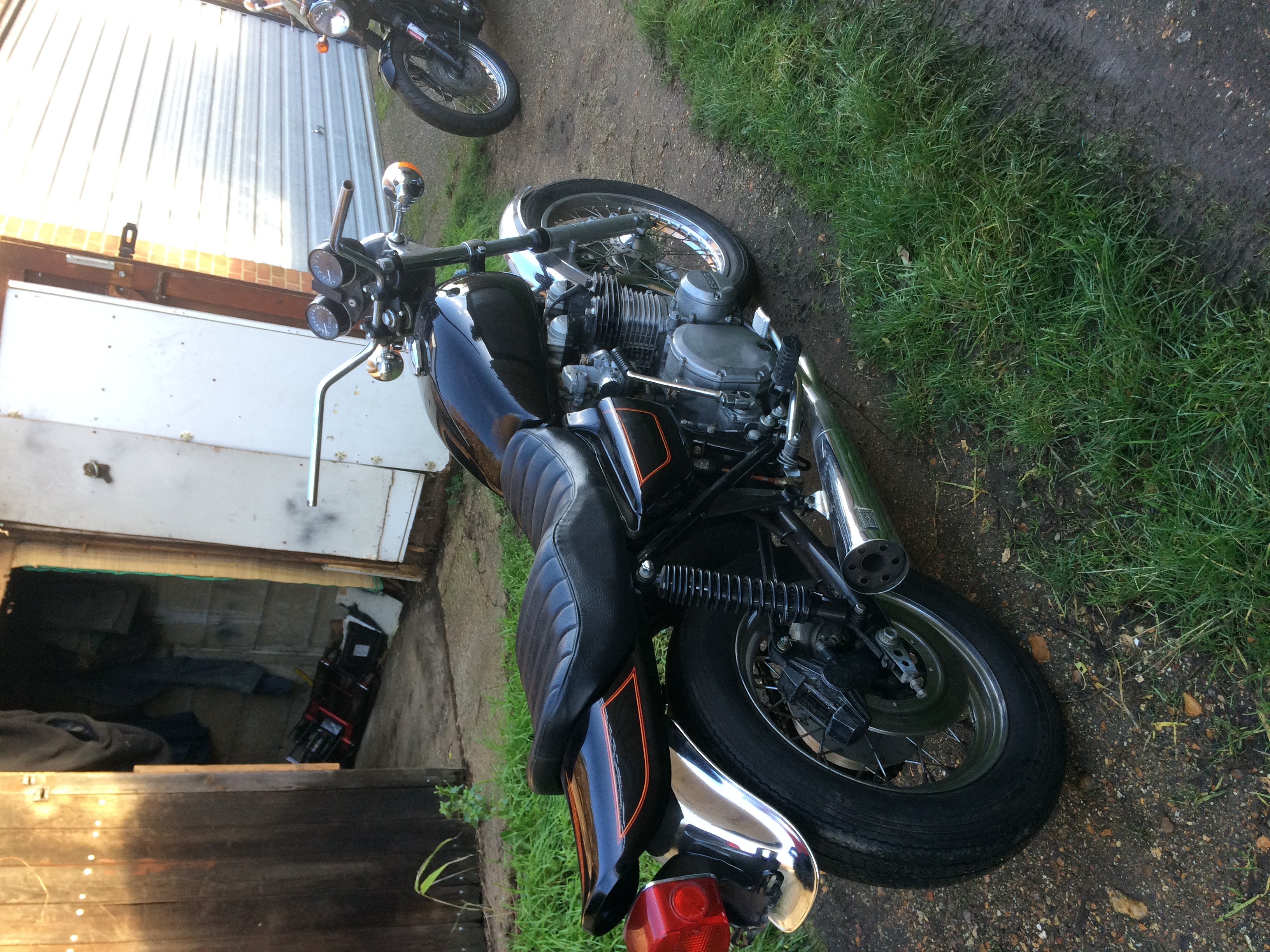

I have recently bought another A1 project bike as can hopefully be seen in the pictures (I expect plenty of you saw it on ebay) and will be getting this roadworthy over the next few months. At the moment, I am just getting it roadworthy and not bothering about the cosmetics (except where there is rust etc.). For once, the bike actually looks better in the flesh than in the ebay photographs :shock: I won't be returning it back to standard so the 'wrong bits' do not matter to me.

Nice pictures of your Z1000! A lot of work to do on it but a good base to start from.
I noticed that the front mudguard is mounted incorrect, you have to turn it the other way round.
I allso notice that you have Z1A or B carbs on it. They're 28 mm but difficult to balance. If you want to use 28 mm carbs to get more performance use those of a Z1R, Z1000ST or Z1000MK2, much easier to synchronise.

Thank you for the welcome and the advice :D I have sorted the mudguard out - so obvious once pointed out :oops: Thanks for the info about the Z1A/B carbs - not sure where I will go on that one yet...
